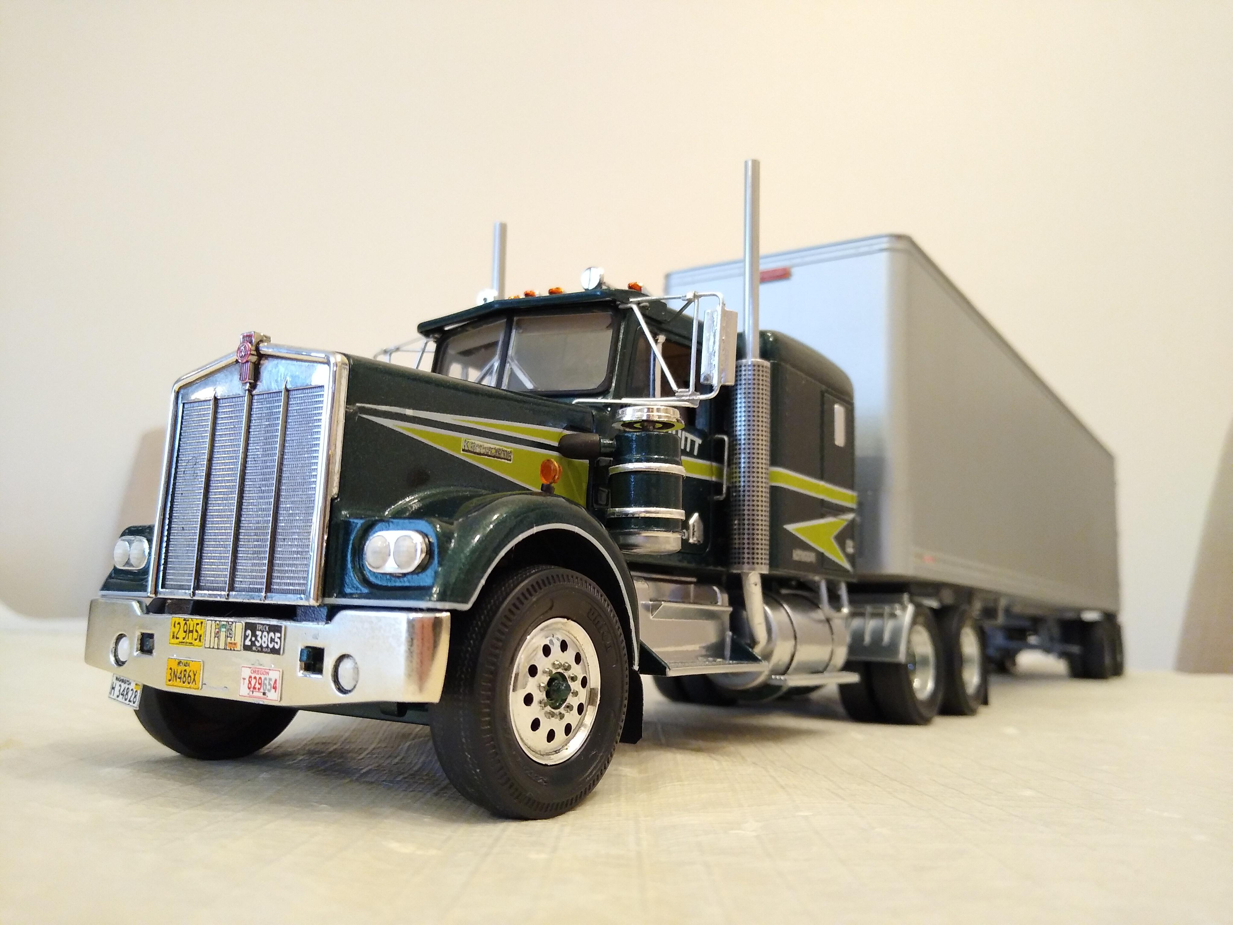

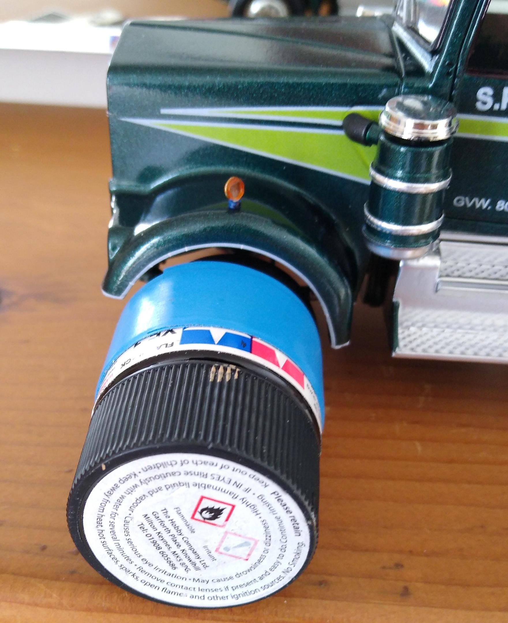

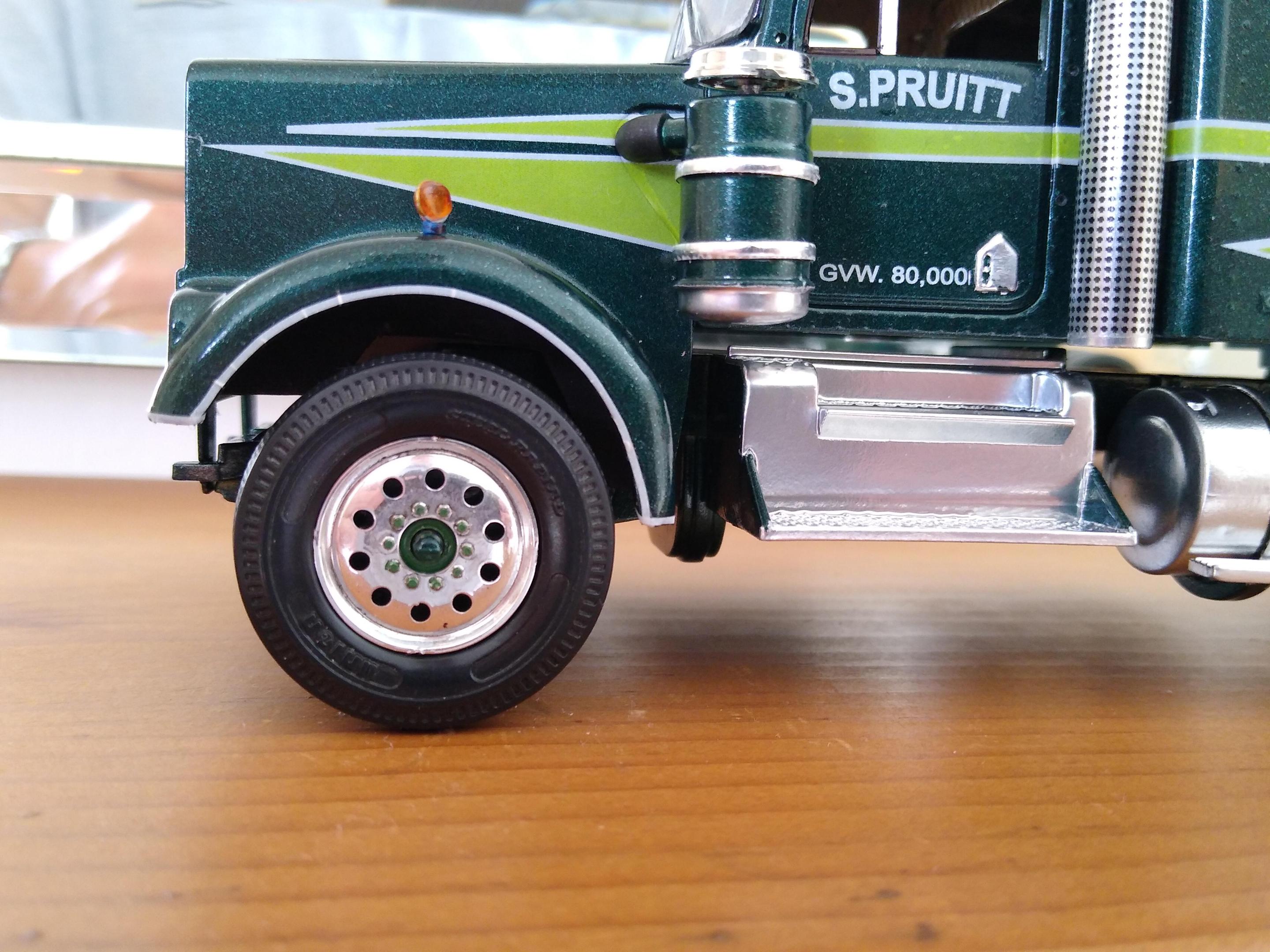

I decided to try and apply the white stripe on the wheel opening. I found a Tamiya paint bottle was slightly smaller than the arch, so I wrapped it in tape until it fit snugly. I trimmed the stripe decal right at the edge on one side but left a little film on the other side for support.
After soaking the decal I laid it on the arch and wetted it with a brush to keep it floating, then teased it around the arch against the bottle. Pull the bottle away and it looks passable. Then there's the straight sections. I'll let it dry and try the other side tomorrow.
Will it stay on? We'll have to see. I wish I could paint it but shaky hands. Other option is white electrical tape cut to 1mm.

Looks really nice!
Have you tried to cut it out of a wide tape or sticking foil?
I know it's not exactly easier than how you did it (and that was great) but it might work too!
Use the prepared bottle as a template, draw the circle on the foil and lengthen it according to the shape of the fender before you cut it out of the foil!
Then you can use a brush and paint the white stripes!
Just an idea! But yours worked Out pretty well! ?
  • Thanks 1
  On 6/18/2024 at 3:22 PM, Jürgen M. said:
Looks really nice!
Expand
Good suggestion.  If I'd had thought about it before paint I'd have used 1mm square rod, then rubbed it right down until it was just proud. Then a little fine sanding after paint would bring a nice clean white line out. Never mind, it's on. I might paint the edge of the wheel opening white too.

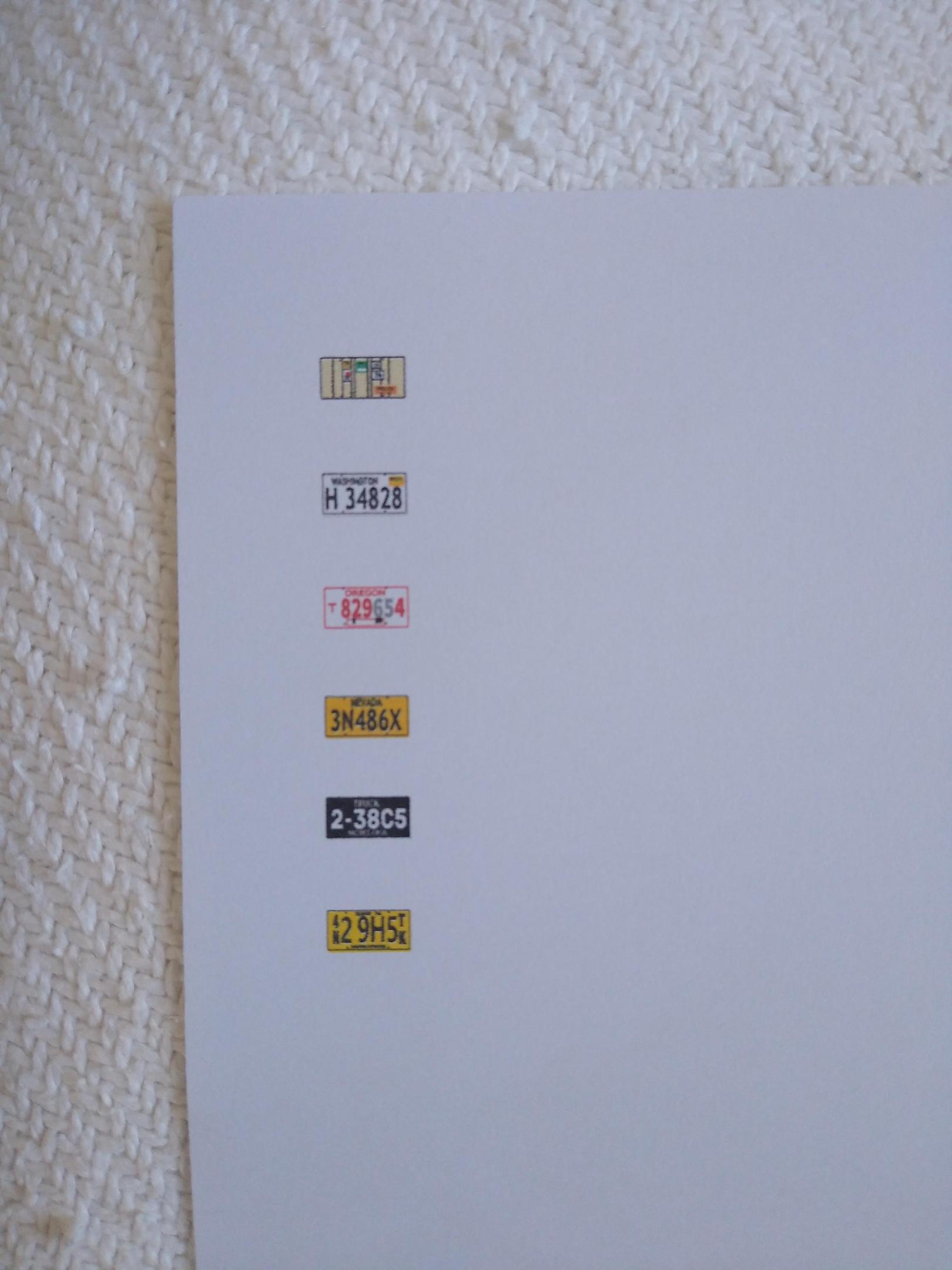

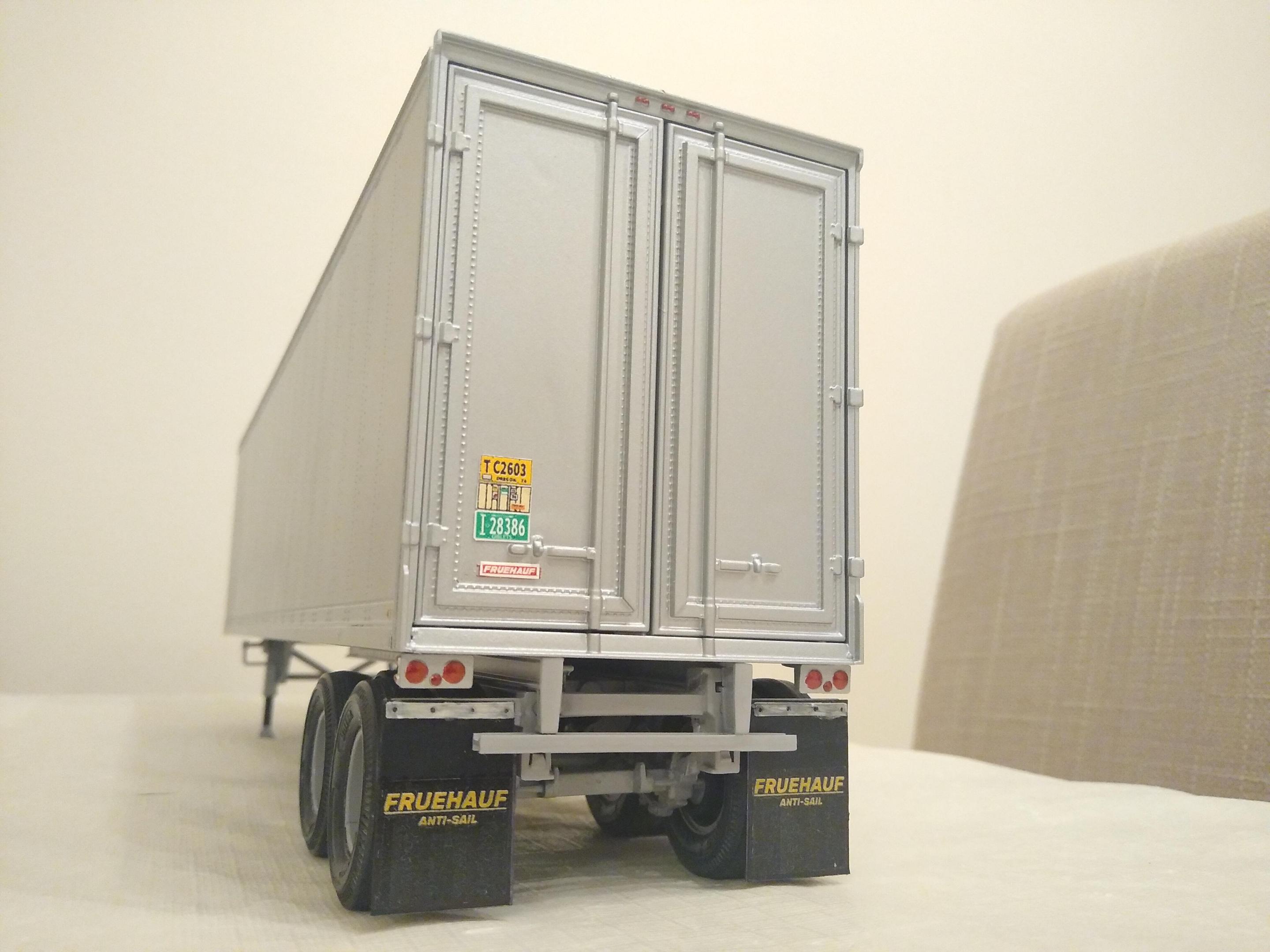

This is now on the verge of completion. The main issue is licence plates.
Using a still photo Force sent me I copied the plates on the front of the truck. There's a shot of the trailer too with 3 plates so I made them. I draw them at 100% and print them at 3%. They come out very crisp. Here's my test prints:-
Tomorrow I'll use decal paper for a sharper image.

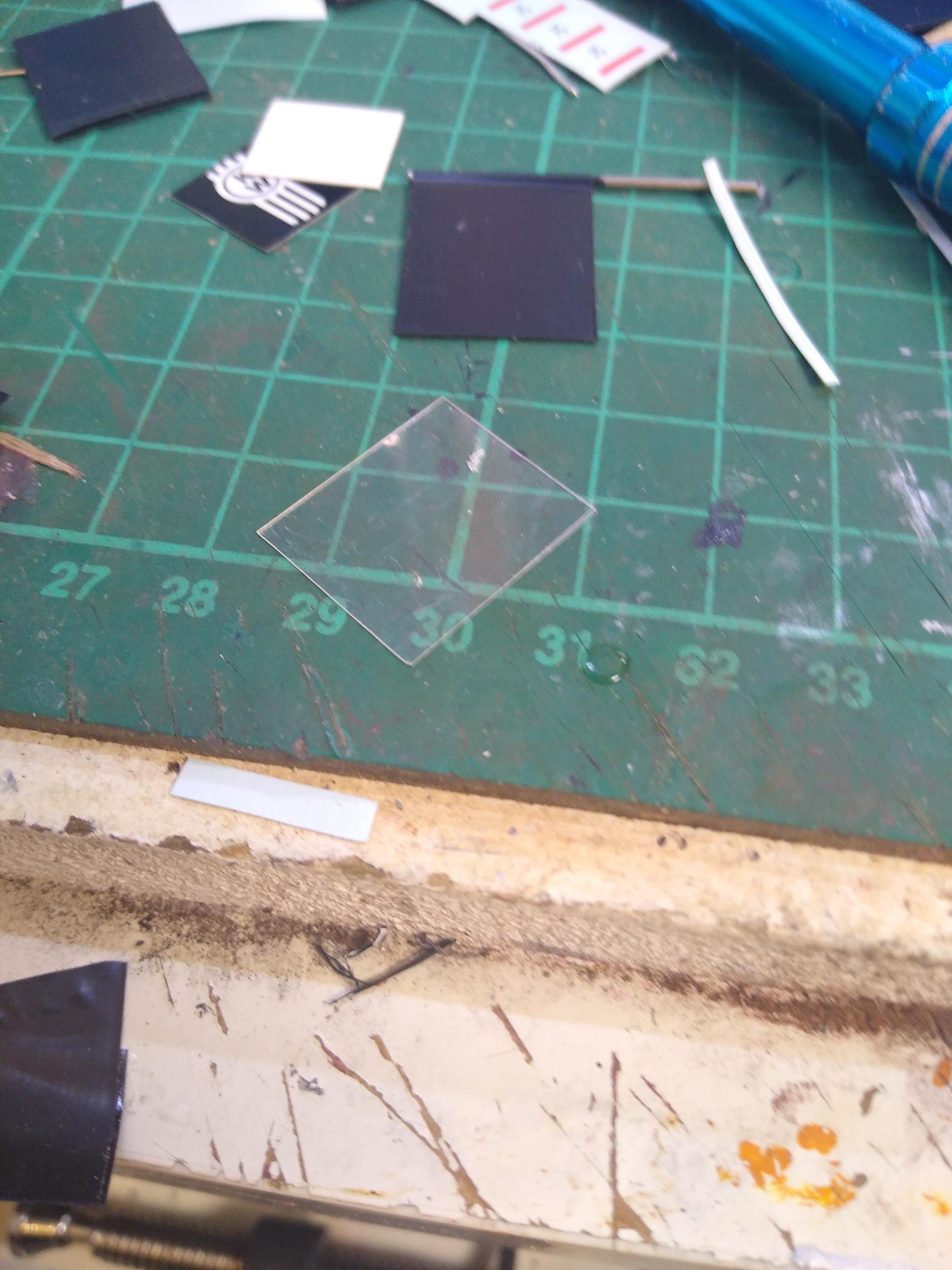

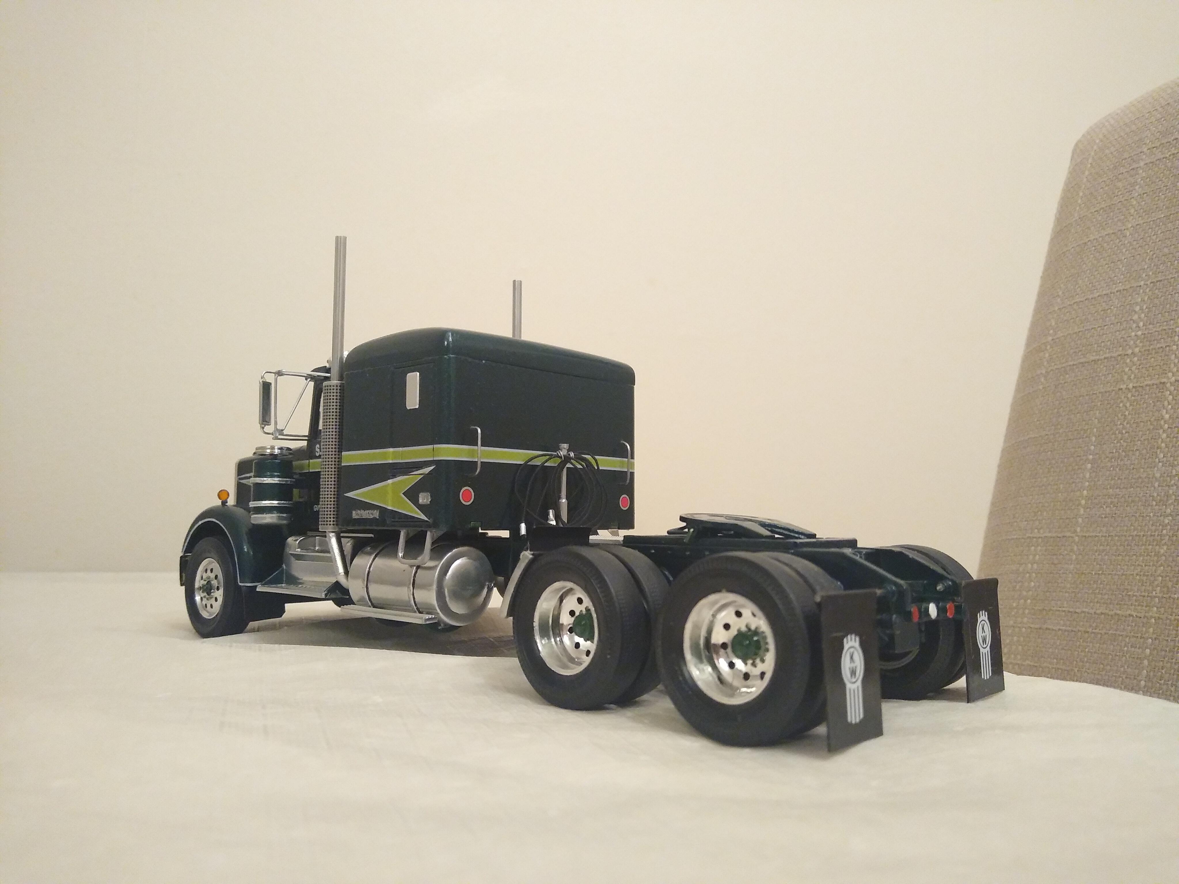

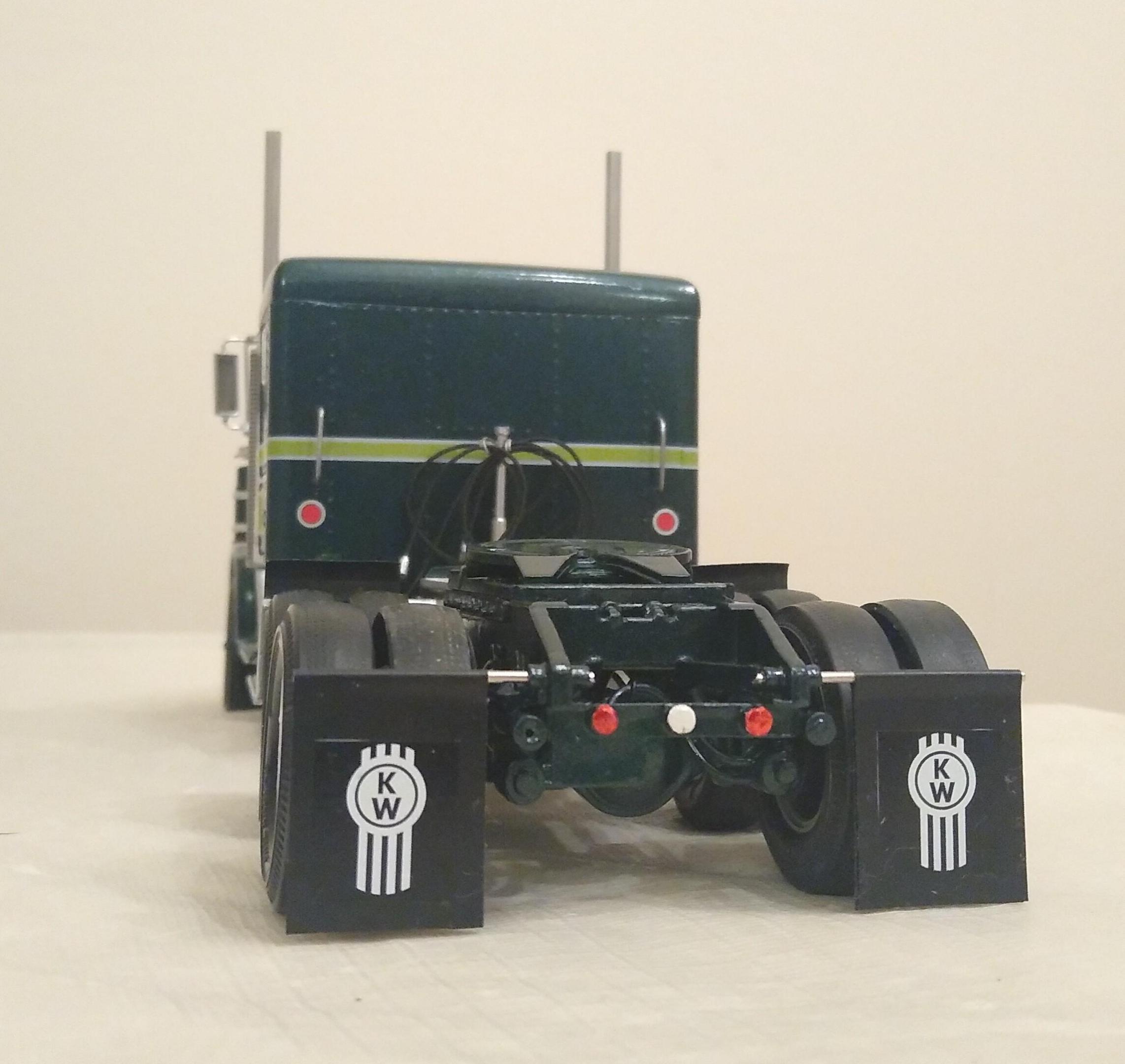

I found some KW emblems for the mudflaps. They were from the green T600 version from Revell AG. However, the mudflaps I'd made would curl up if I applied them so an alternative was required.
I salvaged some clear acetate from a box . It was only 0.25mm thick. I wrapped it in electrical tape with the bracket included at the top. The final width was only 0.5mm so looks nice and thin still. Then I could add the KW decals. Look good. IMG_20240629_131418977.thumb.jpg.ff3af88565ff4d1a4209f292285789fb.jpg
Also added the trailer mudflap lettering and license plates. I printed two "FLEET FLYER" insignia but they just shriveled up when I soaked them. I'll try again on my next print.

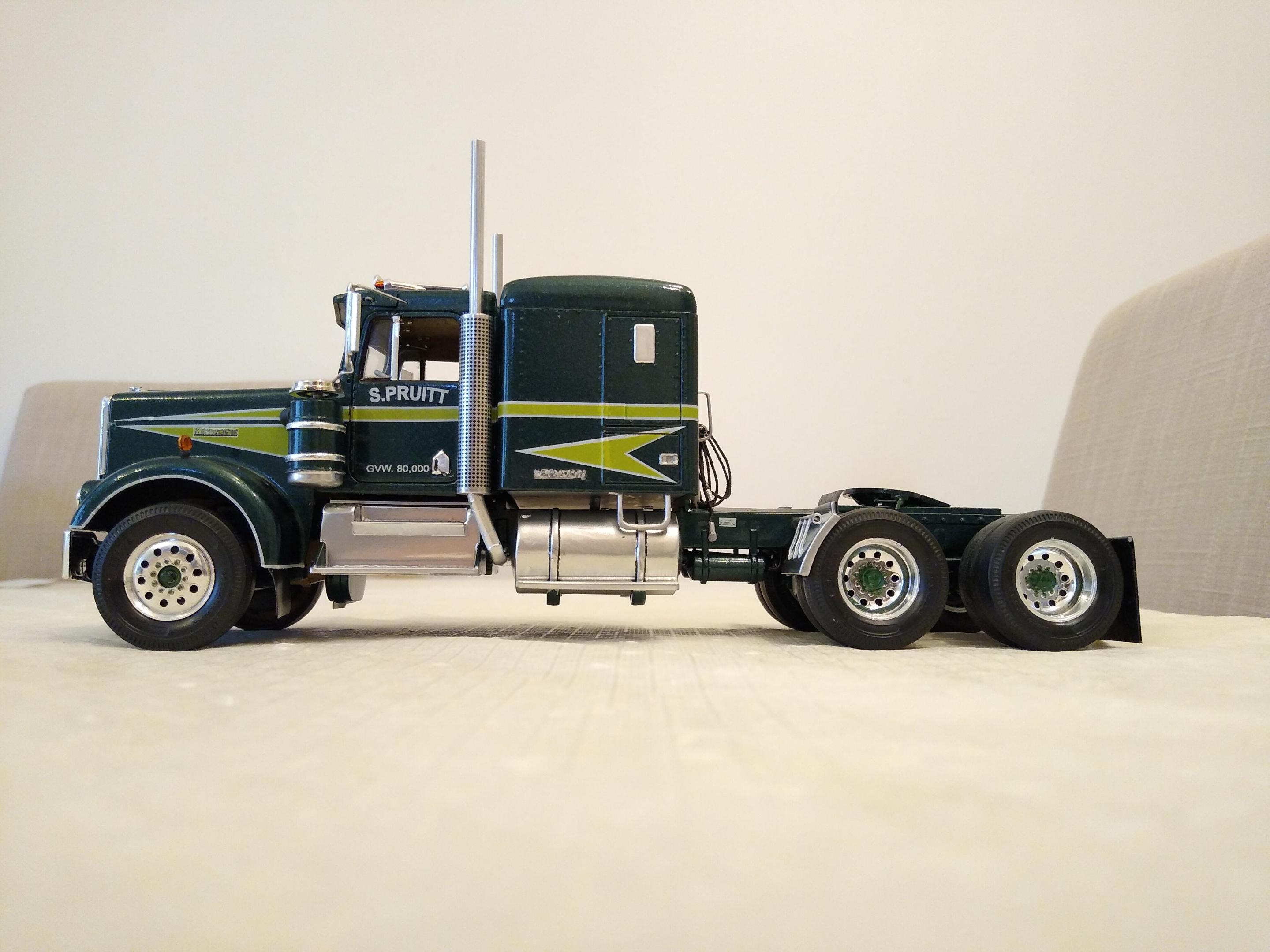

Well, I think I'm at the point where any more fiddling around with it will just cause me to damage something and I won't be able to live with myself! It looks good to me. So I'm leaving it here now and posting it in Under Glass.
Still can't quite believe that I've done it after 50 years.
