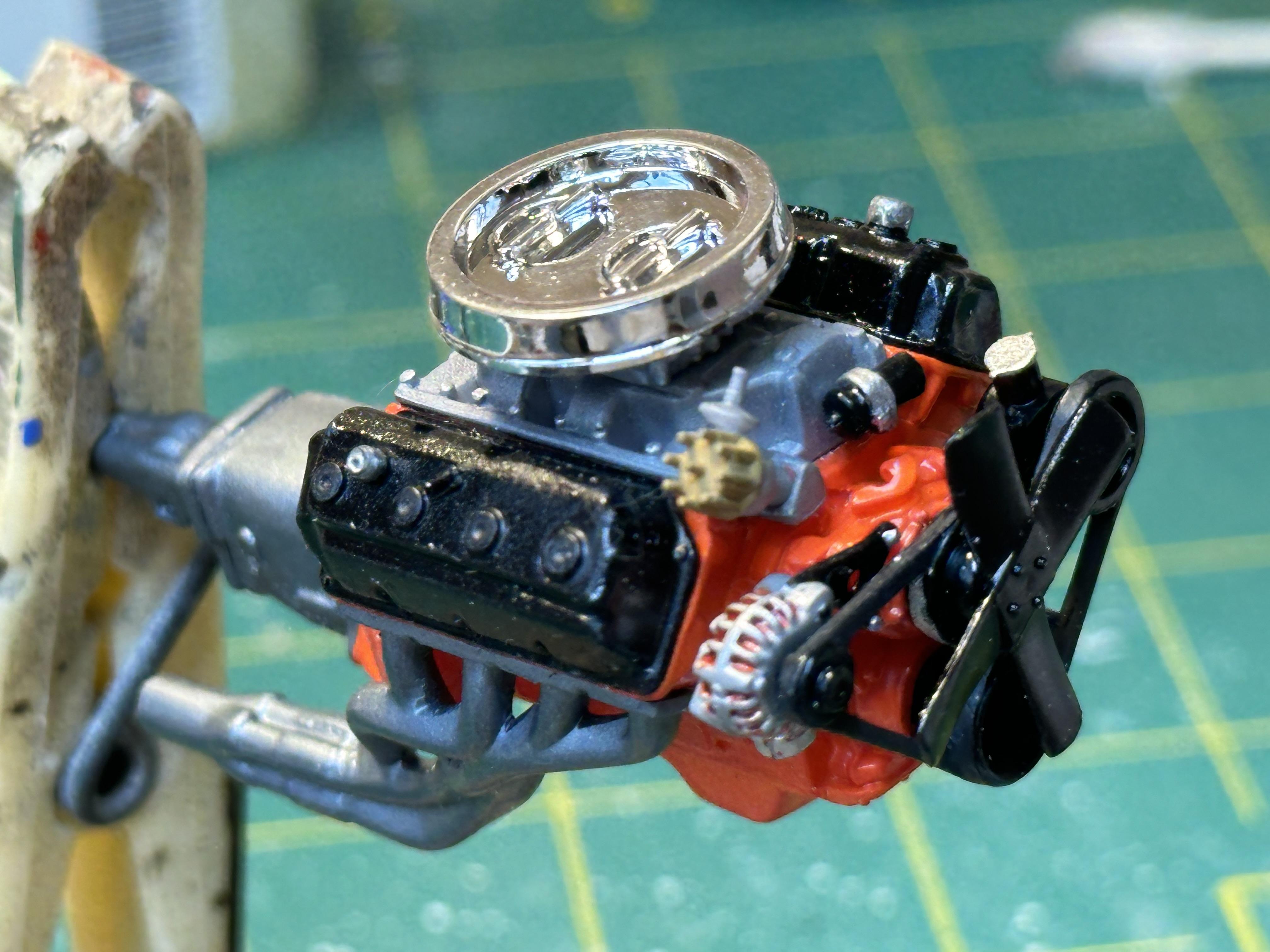

As mentioned in the last post I tried for a better pix of the motor

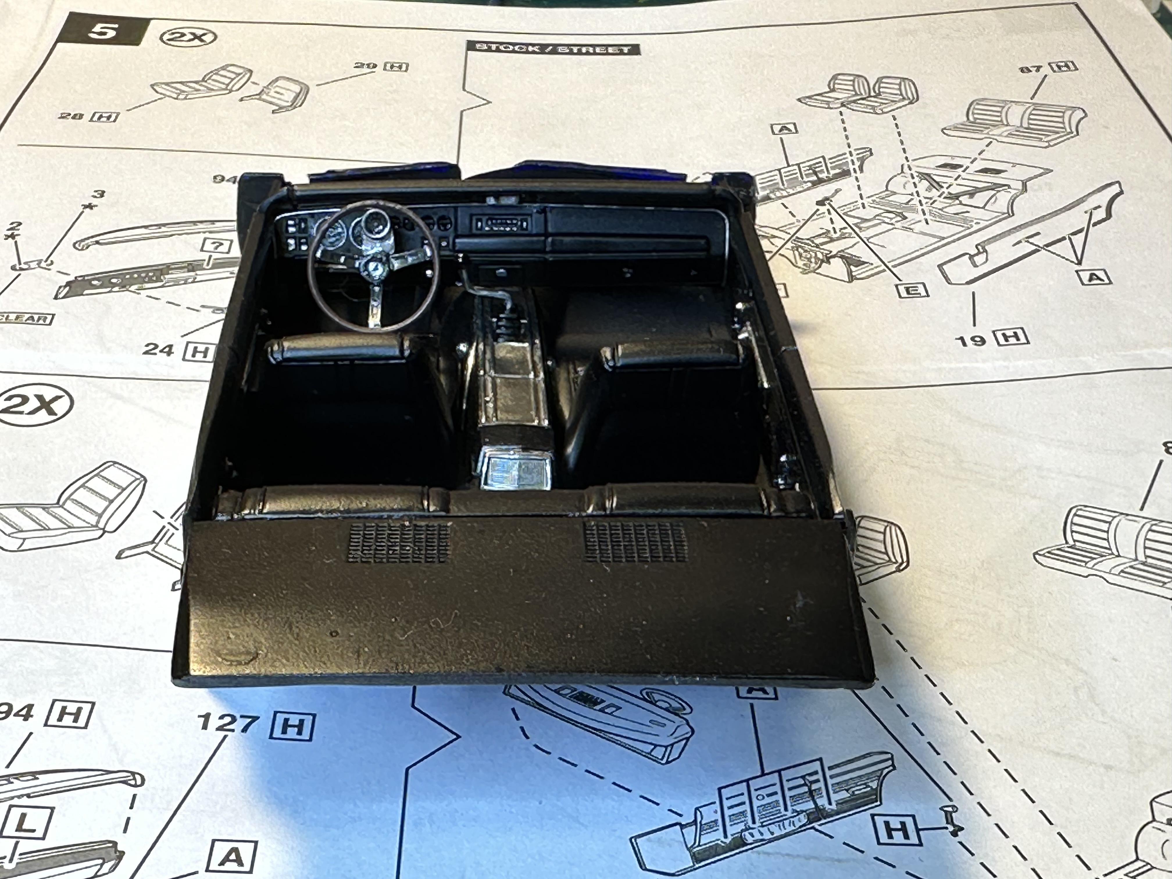

I have finish detailing and assembled the interior

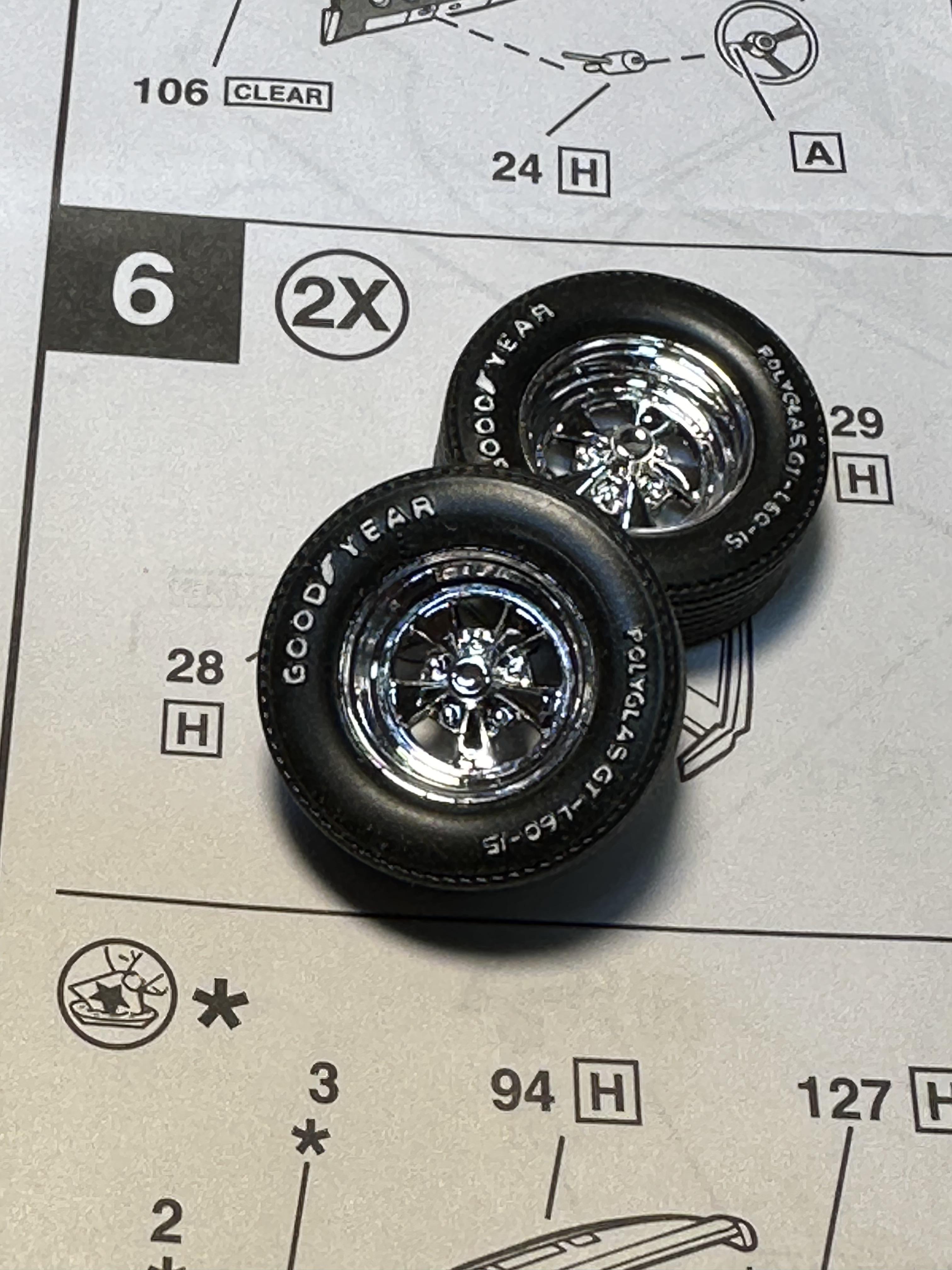

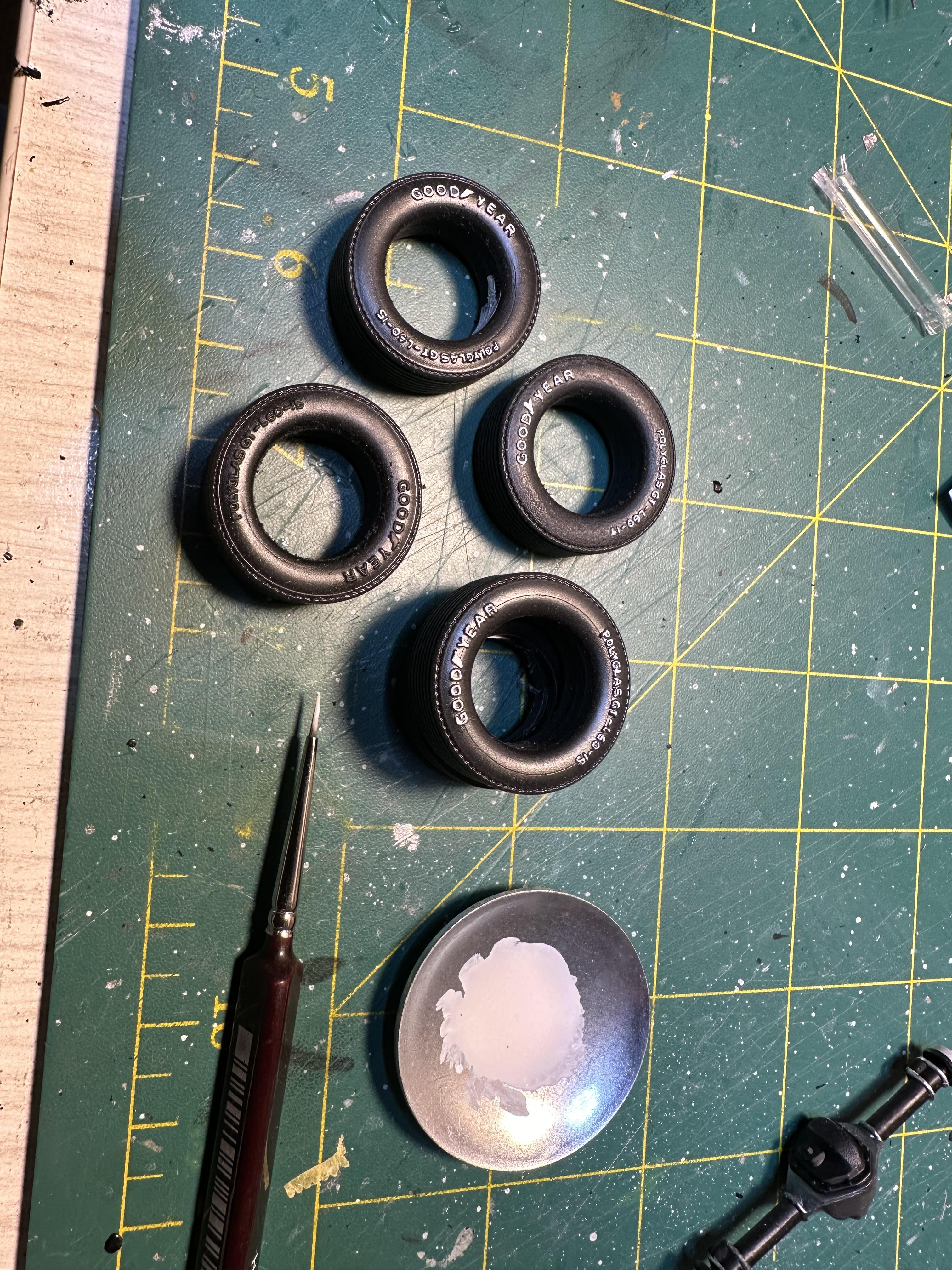

And painted the raised lettering on the tires. I use Humbrol flat white thinned a little with enamel thinners and what seems a largish brush. You lay the paint on with the side of the brush not the tipimage.thumb.jpeg.ea620d53fc39622f2eabd76ae0a66bd1.jpeg
And assembled wheels and tires

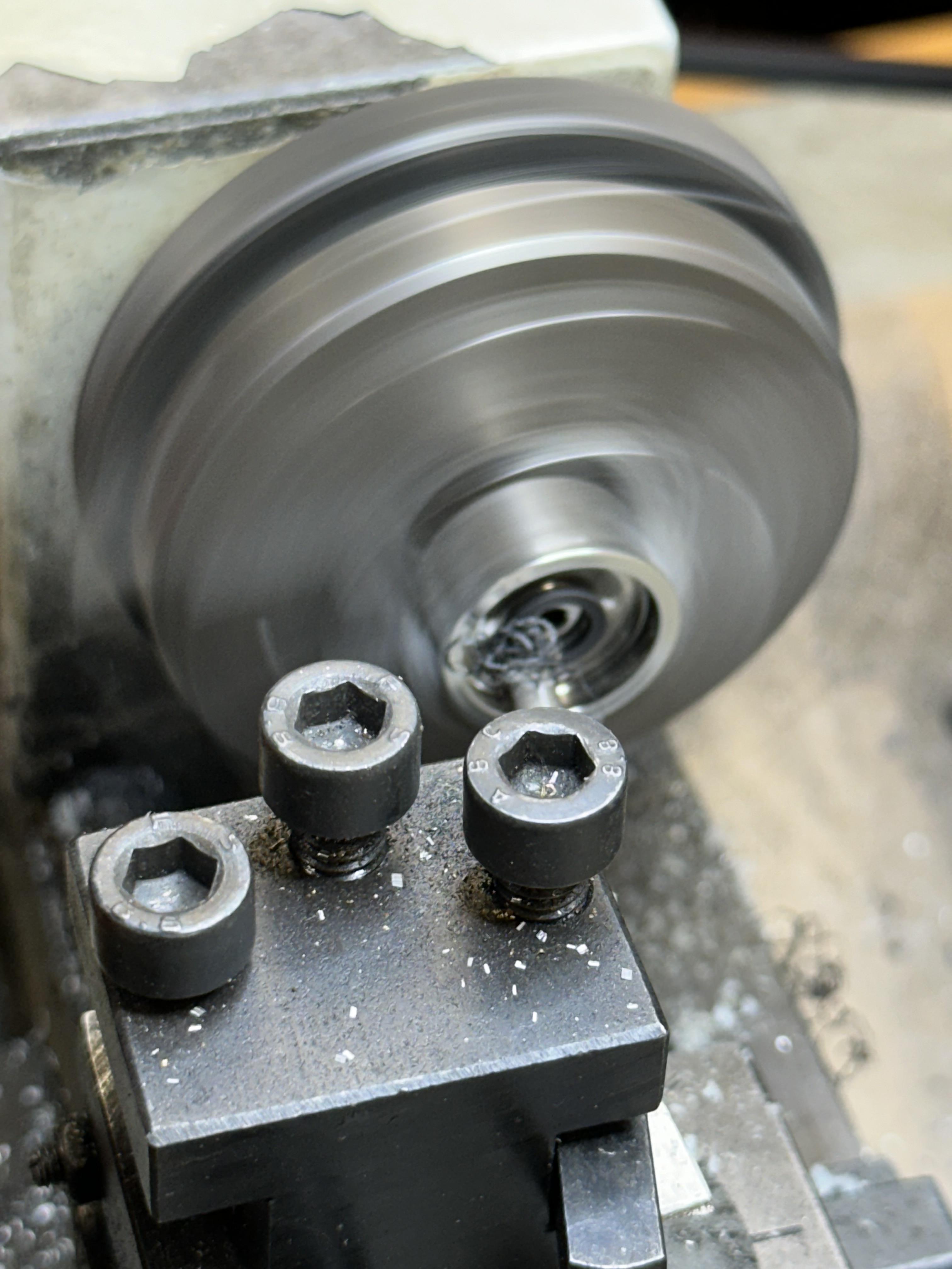

When I was getting the wheels fitted up onto the diff I had issues with fitment of the kit drum brakes so I machined some up from ally - no pix sorry

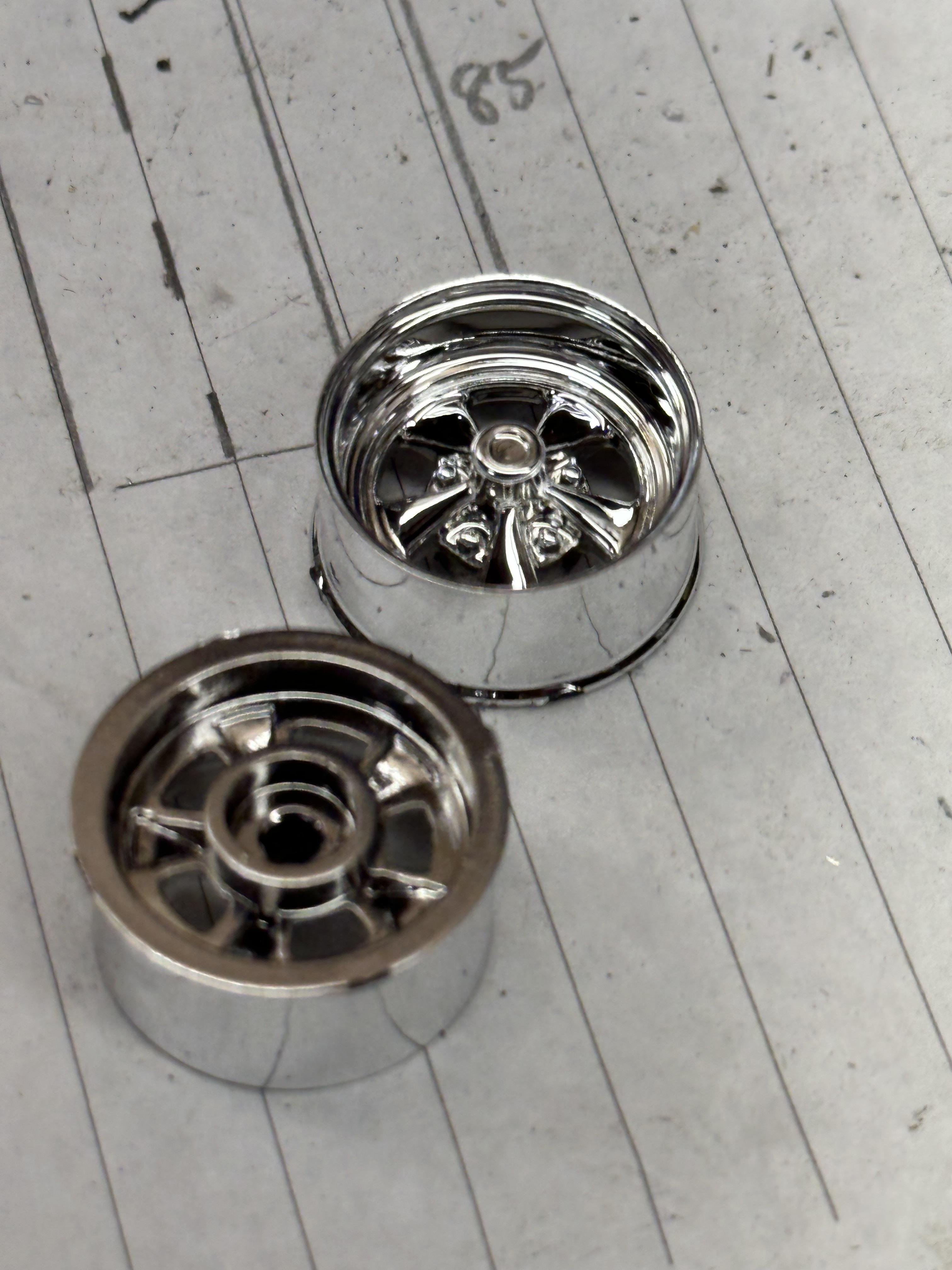

The front end posed some issues with the boss at the back of the wheel making the wheels stick out too far so I machined the bosses off. With a bit off faffing around and trimming I got the wheels to sit inside the body

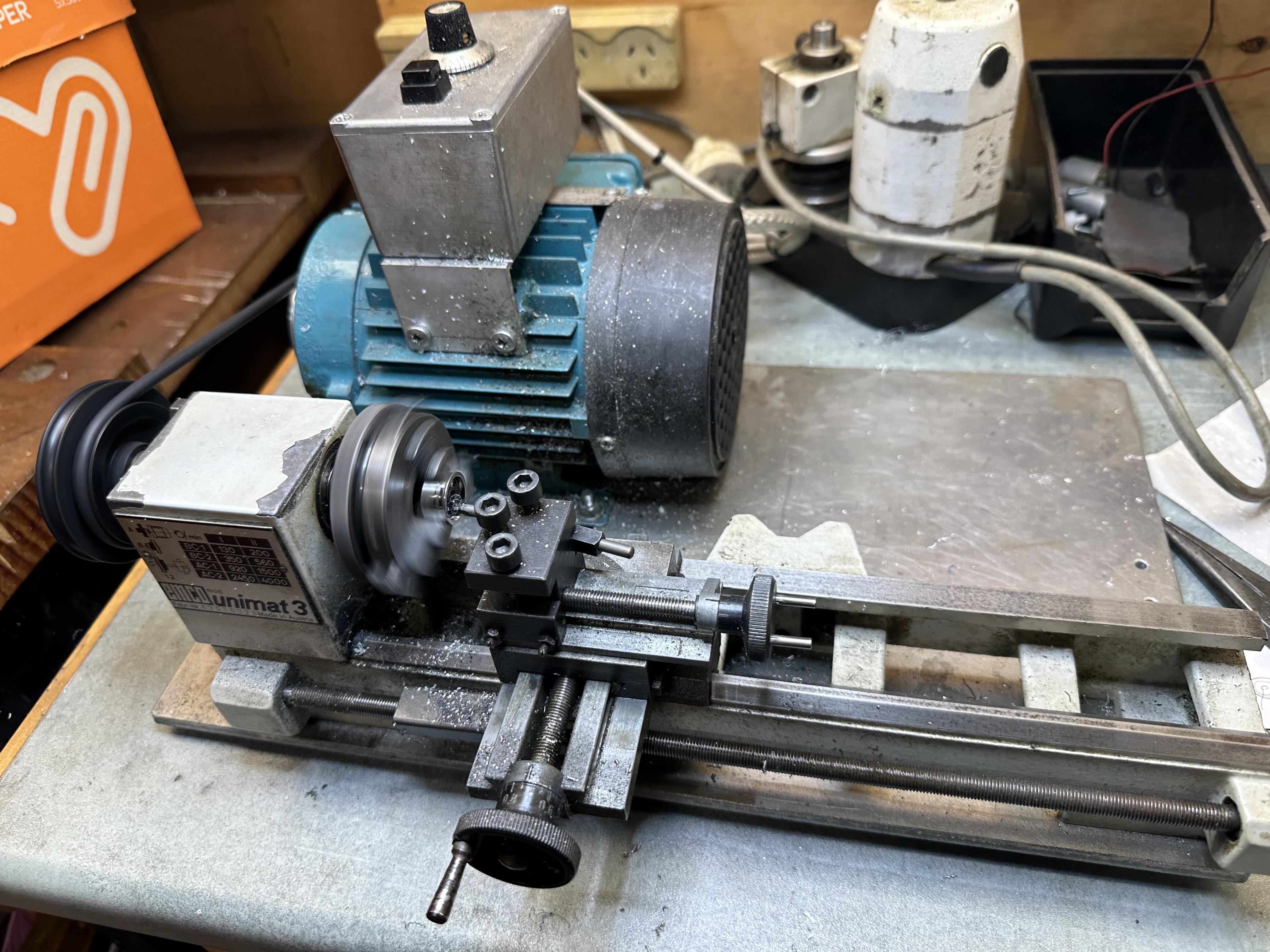

The lathe I use is a Emco Unimat III that has had the motor upgraded to a small three phase motor with VFD speed control
The original sewing machine motor can be seen as the white blob in the background and its use is now relegated to the mill head

22 hours ago, Noah H. said:
This build is looking great. I like all of the detail throughout, particularly the copper color used on the alternator to suggest copper windings within the alternator.
Thanks Noah. The copper colour is actually Tamiya clear red. The windings often have a clear or red enamel insulation over the copper wire so clear red does the trick

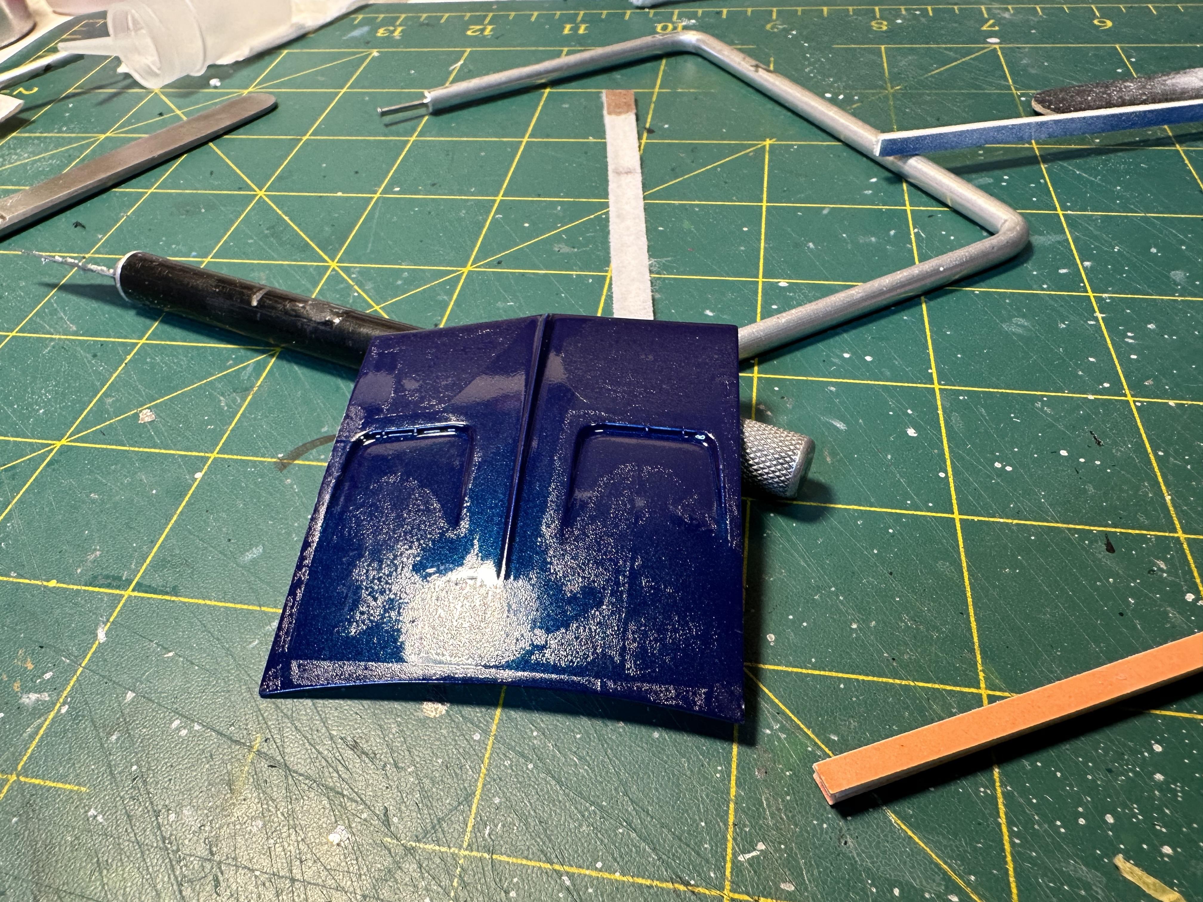

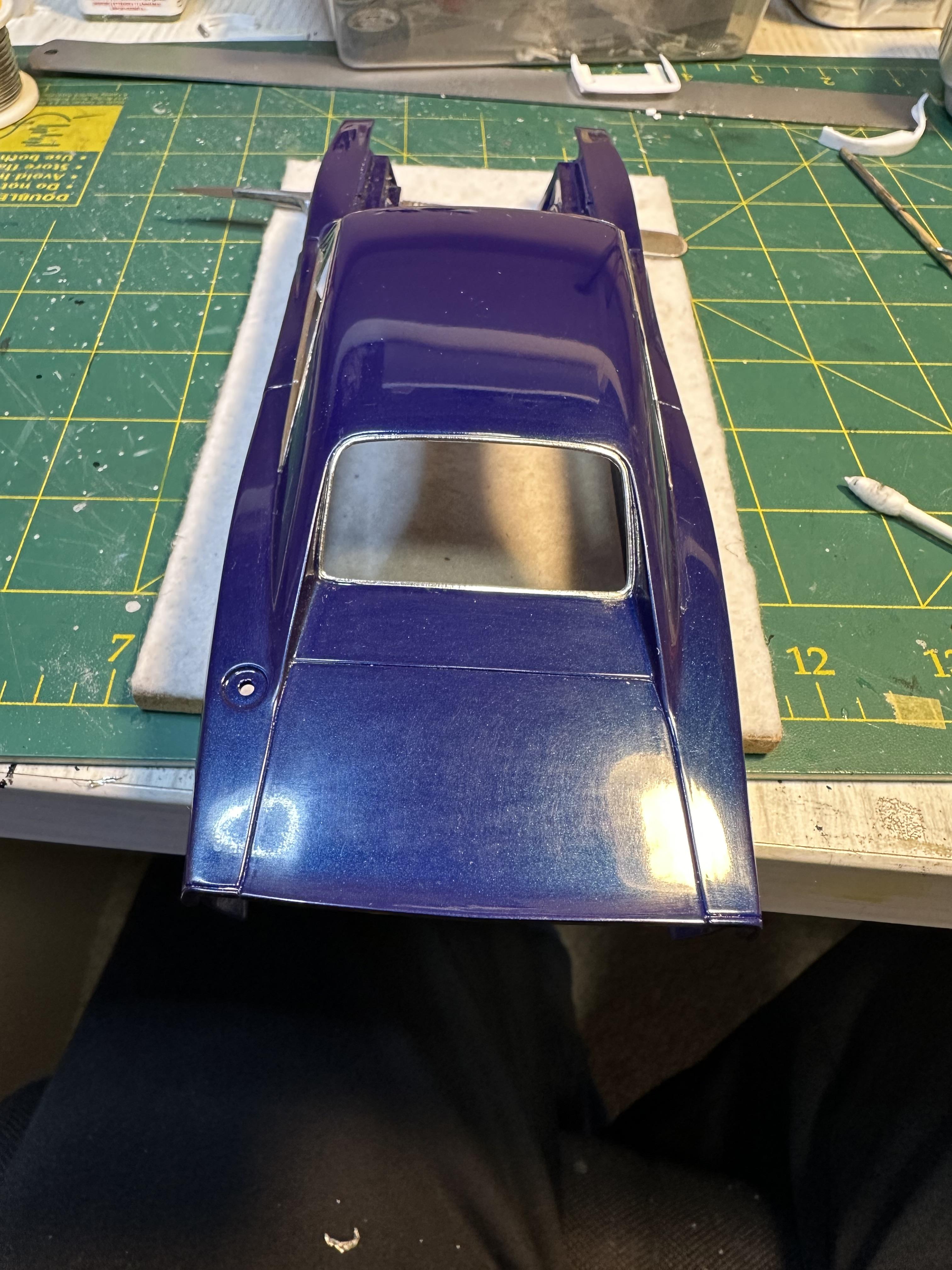

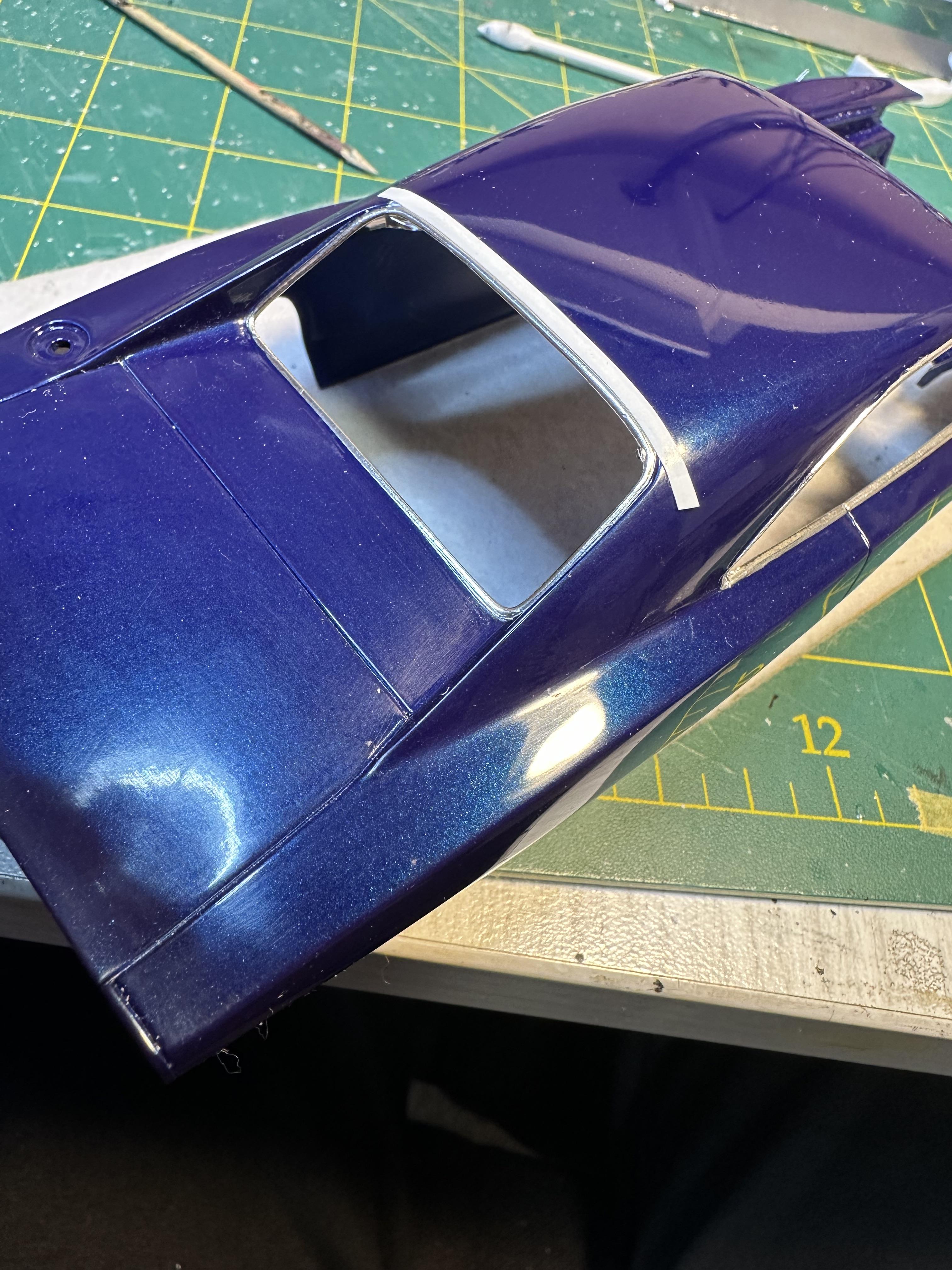

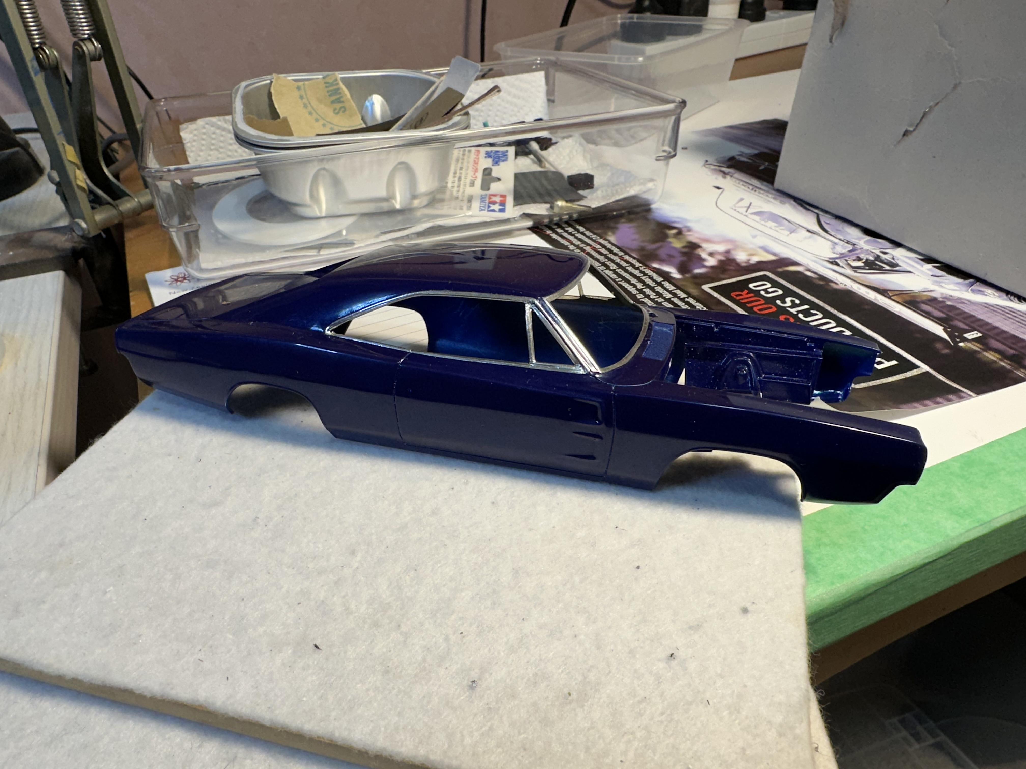

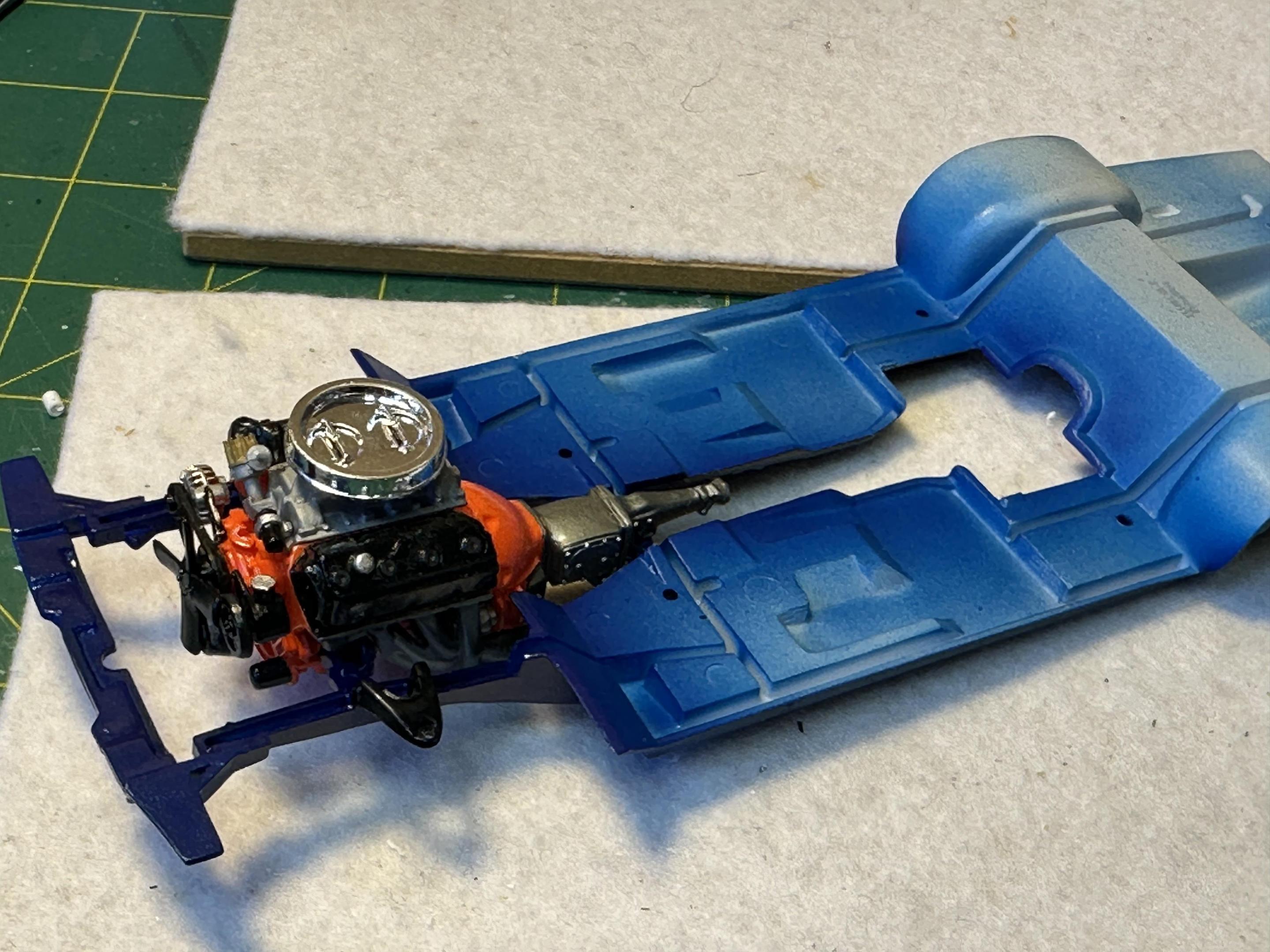

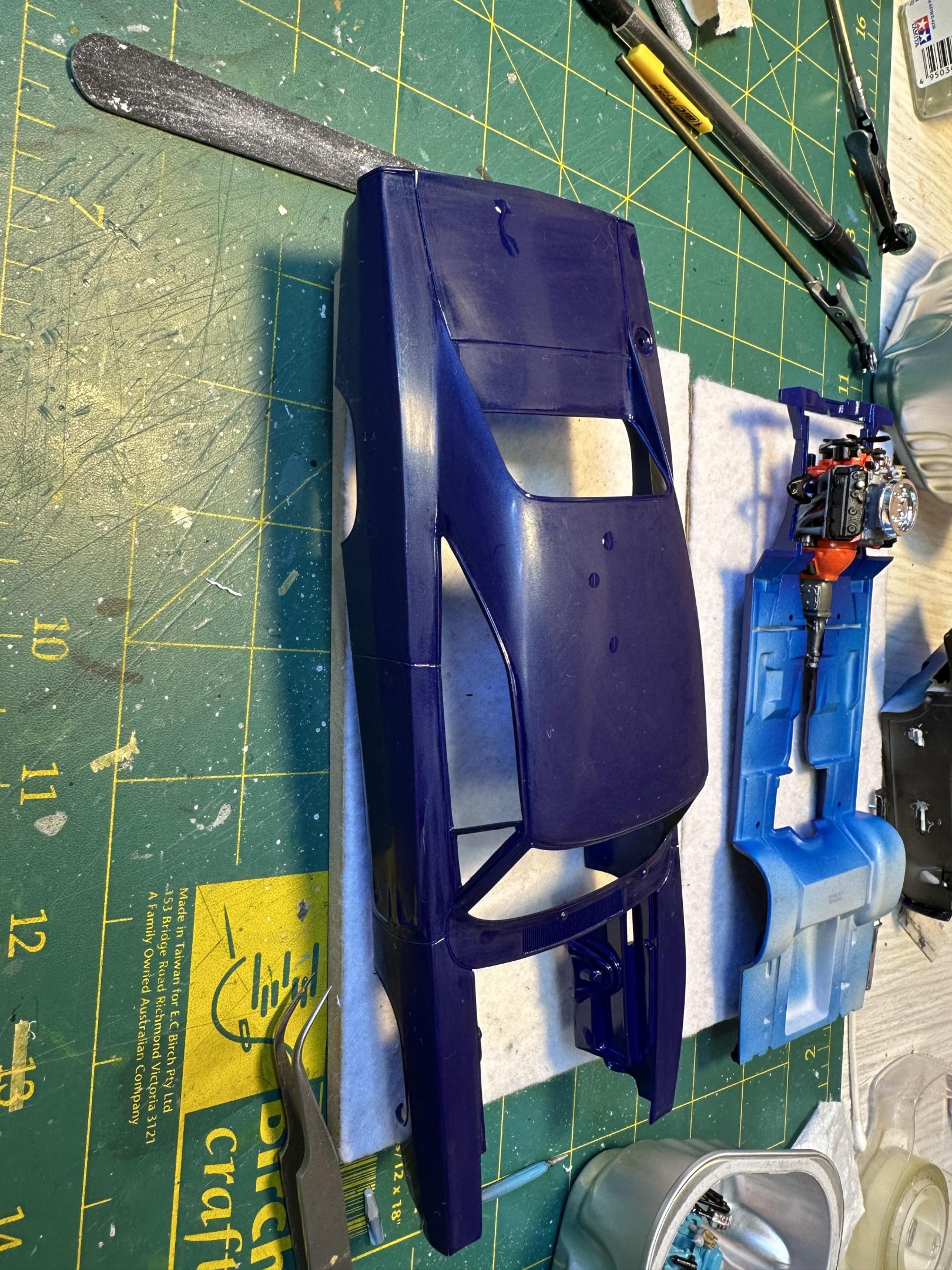

Engine and interior mounted to chassis and body colour sanded to 12000 grit
IMG_9057.thumb.JPG.75c822fedb9a37e83845889b7b21c04d.JPGIMG_9058.thumb.JPG.fa168f56d9fa5ff8a7ede33d0039ae8c.JPG

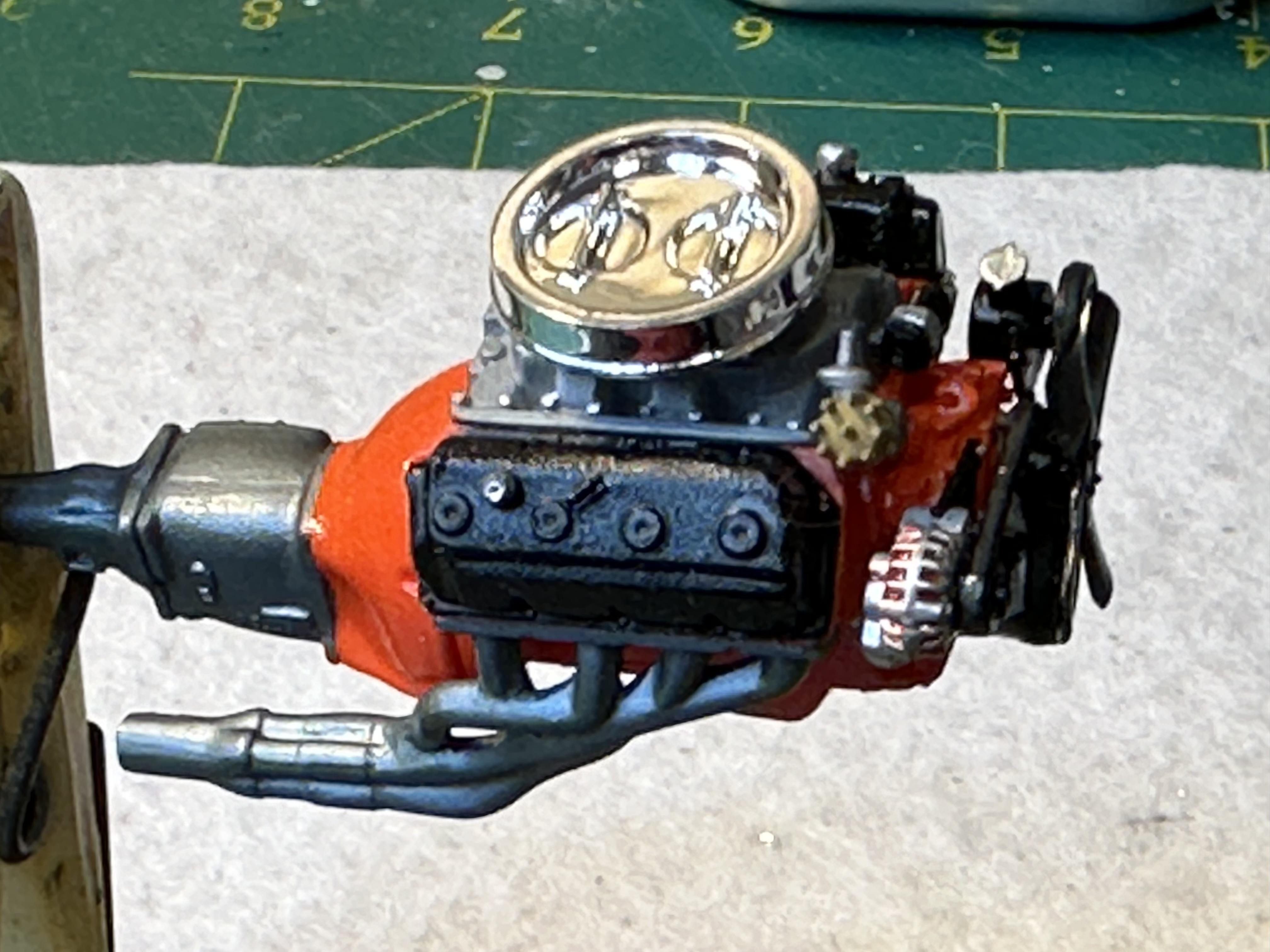

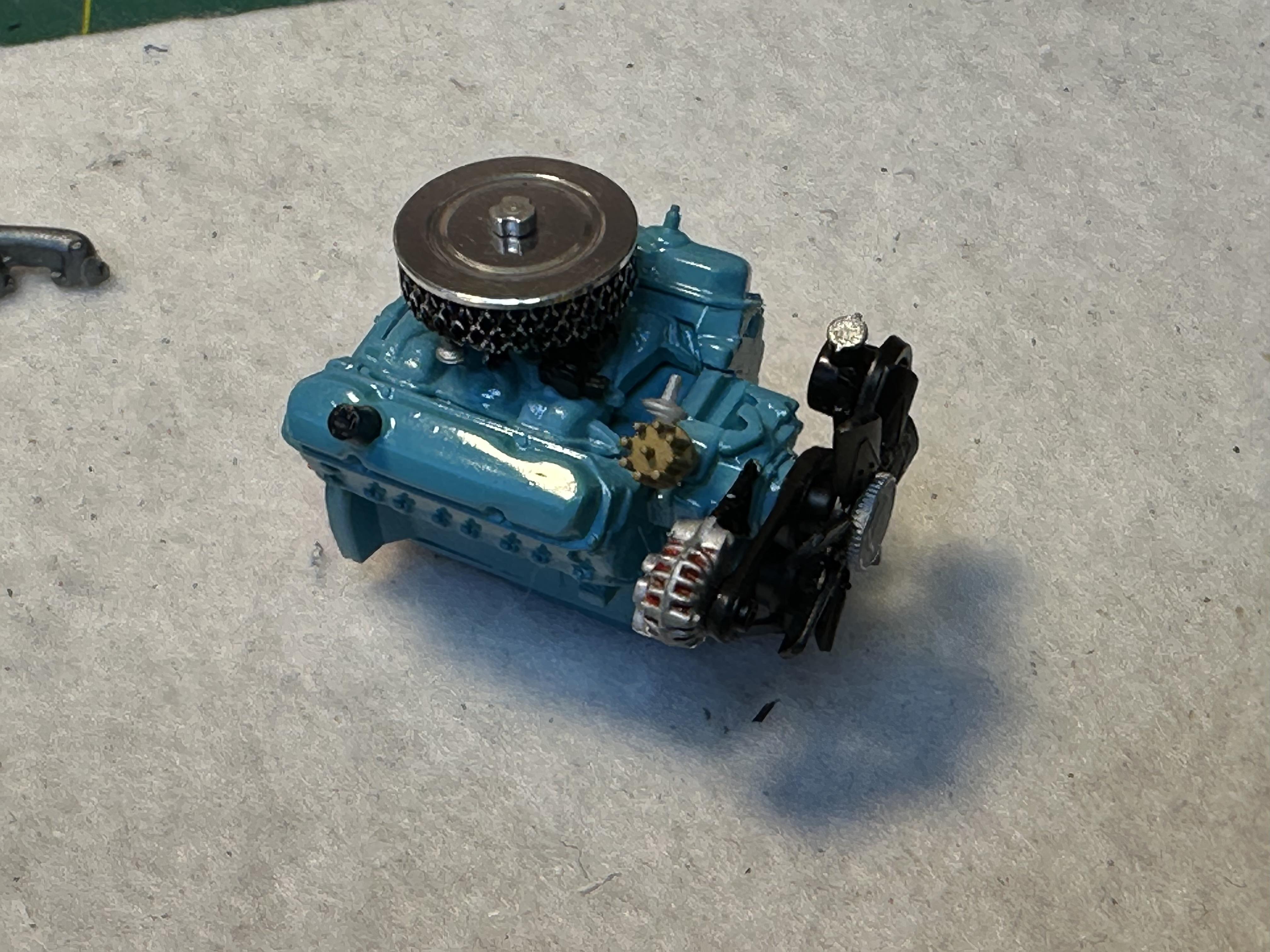

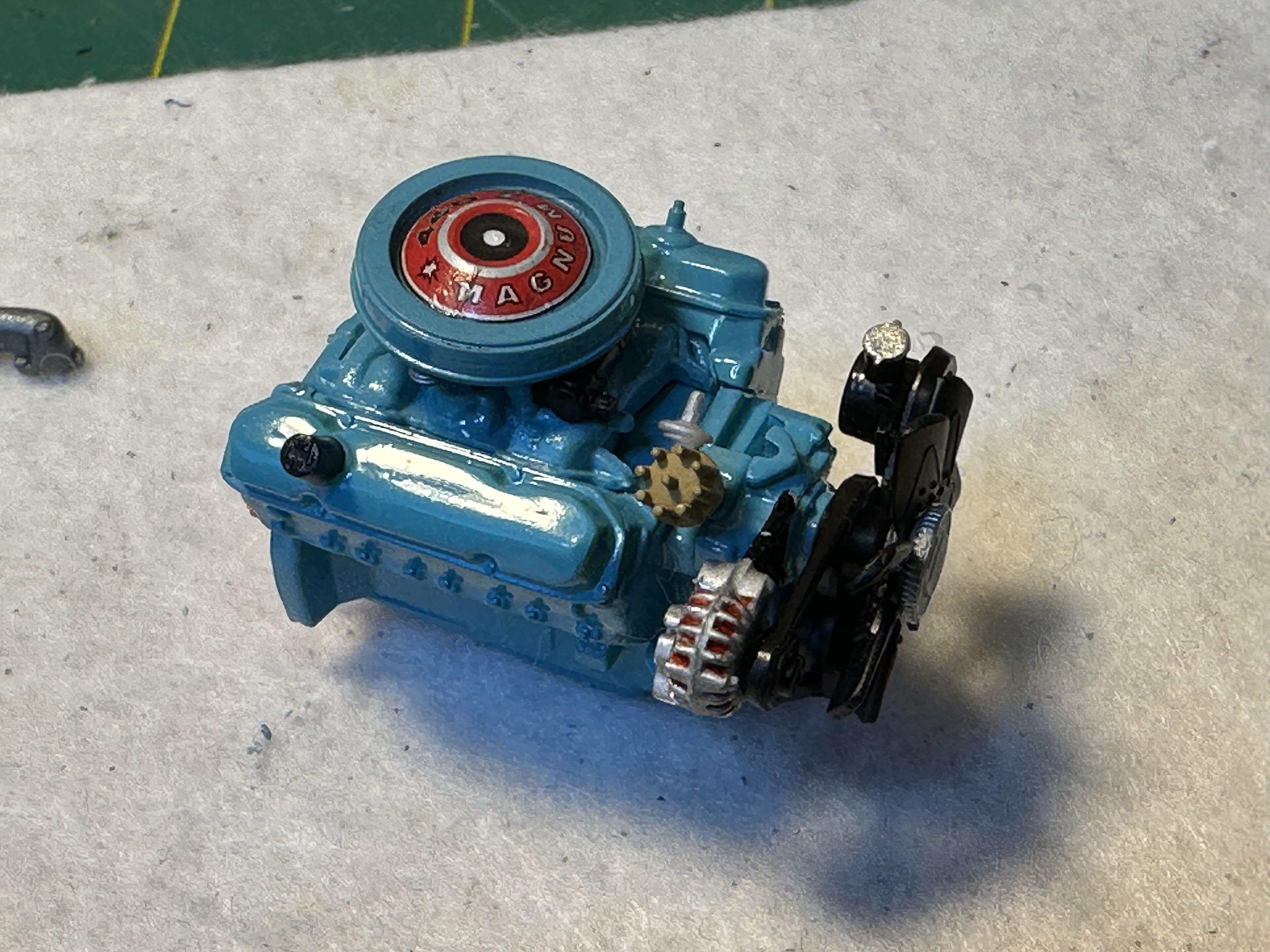

I finish assembled the spare 440 wedge engine. I had some issues with getting the air cleaner decal to soften. I think my setting solution is getting too old - I dont do much decalling
To stay with the day two theme I machined up an air cleaner from ally. The filter element is knurled in a cross hatch pattern with semi-gloss black washed into low areas. Cleaned up the cross hatch in the lathe with a file. Also made a knob to hold the air cleaner in place
Before and after comparison pix
