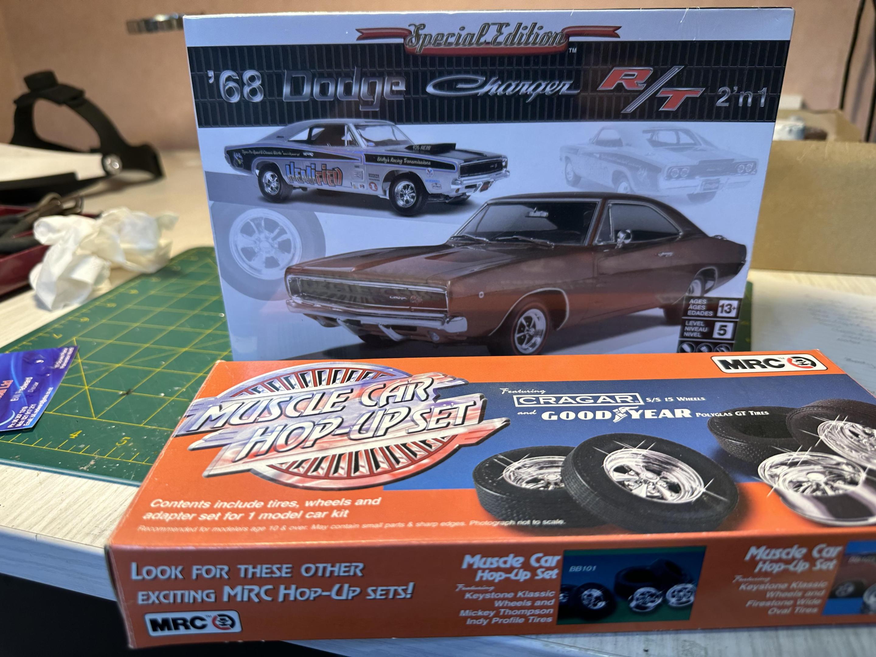

bill-e-boy Posted November 4, 2023 Share Posted November 4, 2023 Now that the Chopped and channeled 32 Coupe and the Tim Boyd 29 A pickup tribute build are done and dusted and on the shelf I think to myself what next. One of my all time favorite cars is the 68-69 Dodge Charger. The only problem is that I have never got around building one -till now. The candidate is a Revell 68 R/T Charger. On opening the box it was a bit of a surprise to find so many parts espicially after working on early rods for a bit. This not to say that the Revell 32's dont have a lot of parts, they do have a good parts count but the 32's are a basic car so there are a lot less parts to work with. The Charger has an option to build a 440 or a Hemi which is correct for the R/T model. Choices, choices. I will build both up to see which I prefer but the bias is toward the Hemi. I spent an evening or three on the interweb researching things like component colours, interior options and what is peculiar to an R/T variant over the base car. I have a set of MRC Cragars and Goodyear white letter tires that I am considering for a day two car. Being of a hot rodding nature I have an issue with leaving things as it come in the box so the wheels may fly as the kit tires are rather blah. The colour choice is Tamiya LP47 Pearl Blue The Hemi motor and the manual have been cleaned up and shot with Testors 1127 Orange from the little jars that I have been hoarding forever Next up is the clean up of the 440 ready for paint. I could not find any turquoise in the paint stash so mixed some light blue with green as turquise comes somewhere between the two colours. When experimenting with a couple of drops of both colours I found I had to go easy with the green The marks on the side are for thinning - Testors enamels - 1:1.5 paint to thinner ratio for airbrushing has been my go to for a very long time I will post results of the outcome of the paint mix next time Thanks for looking 5 Quote Link to comment Share on other sites More sharing options...

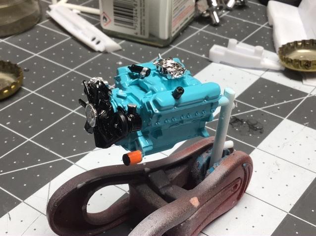

NOBLNG Posted November 4, 2023 Share Posted November 4, 2023 This is a nice kit and I think you’ll enjoy it. One thing I did was cut the radiator shroud in half horizontally so the bottom half could be installed after the chassis and engine go in. i used Tamiya TS-41 coral blue with a touch of white added for my engine. 3 Quote Link to comment Share on other sites More sharing options...

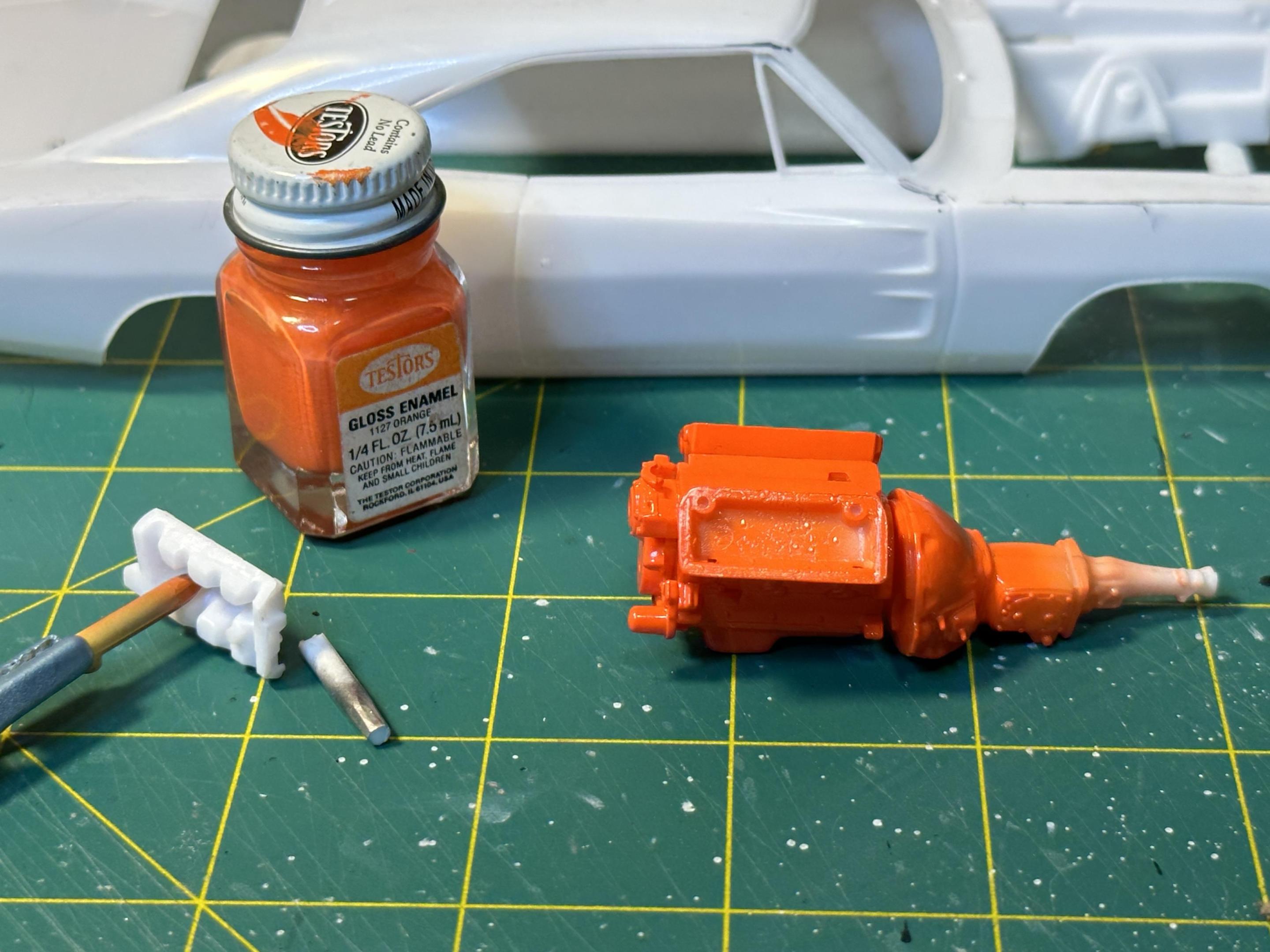

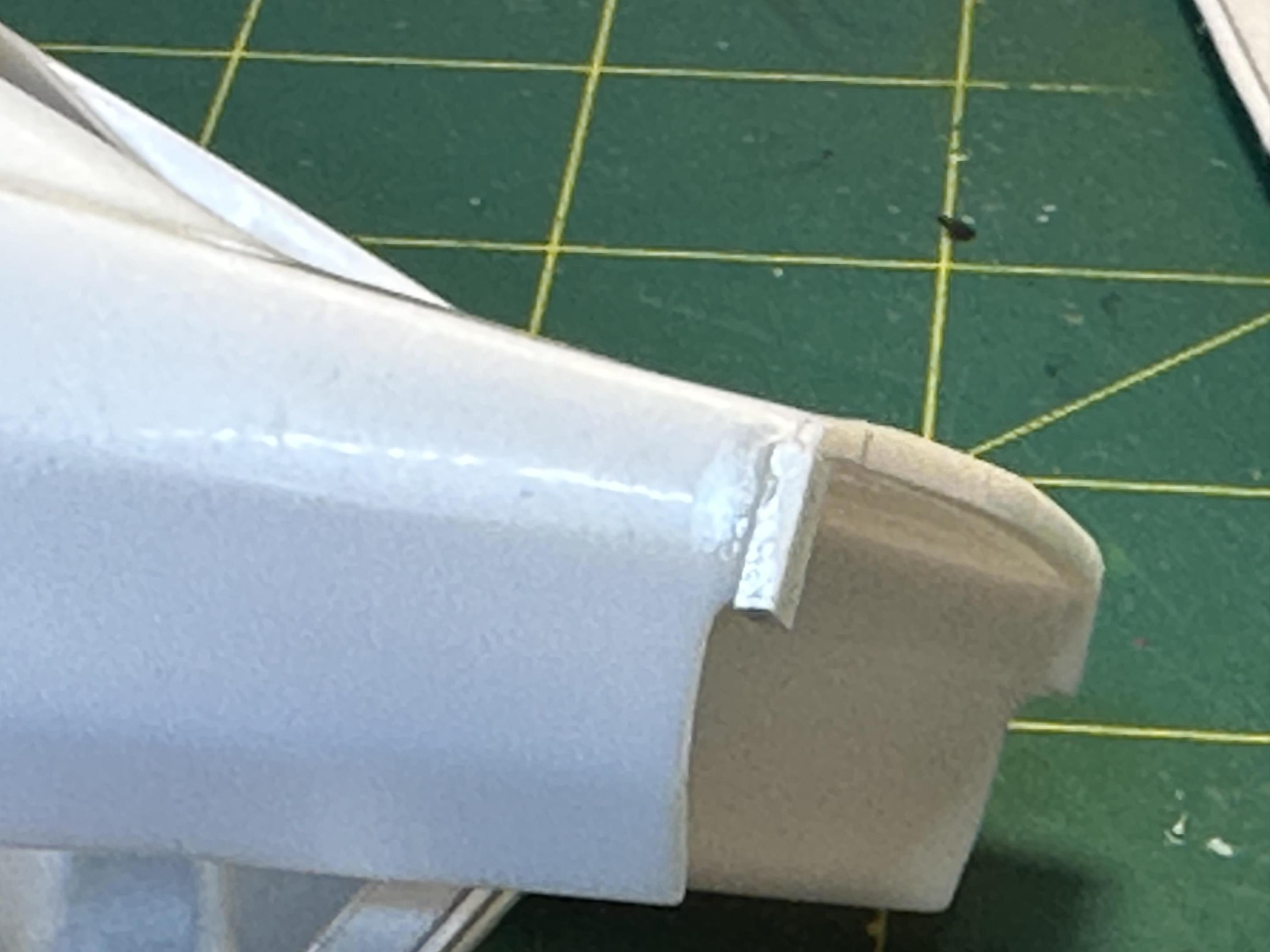

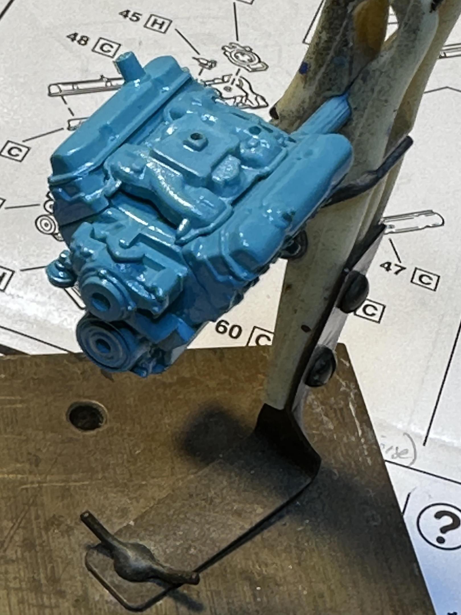

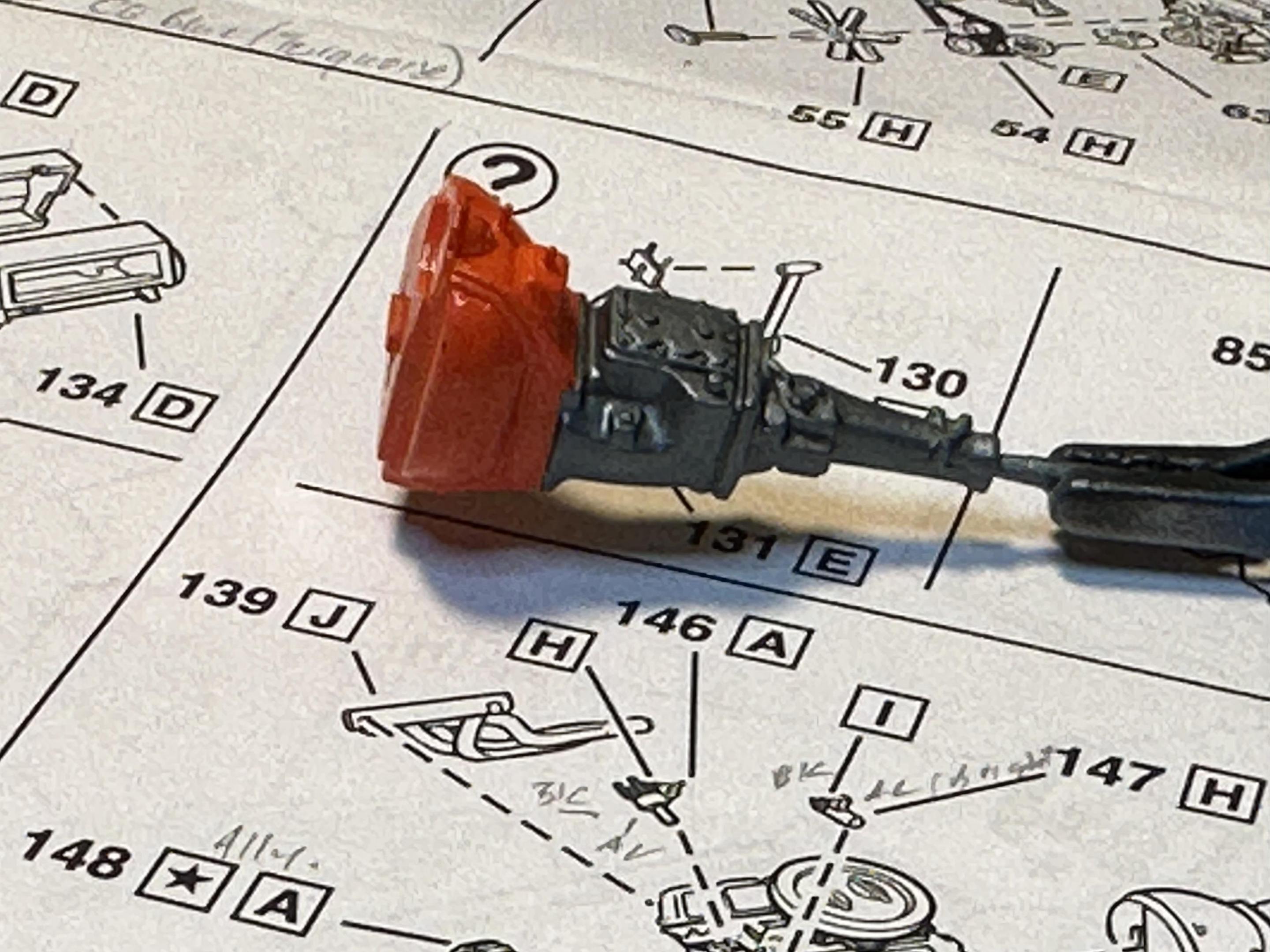

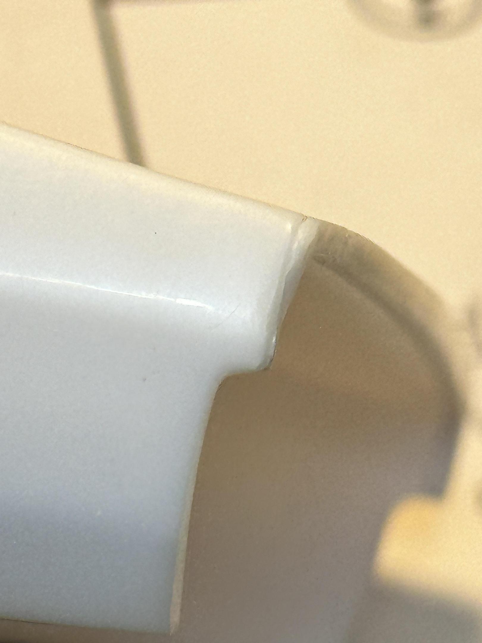

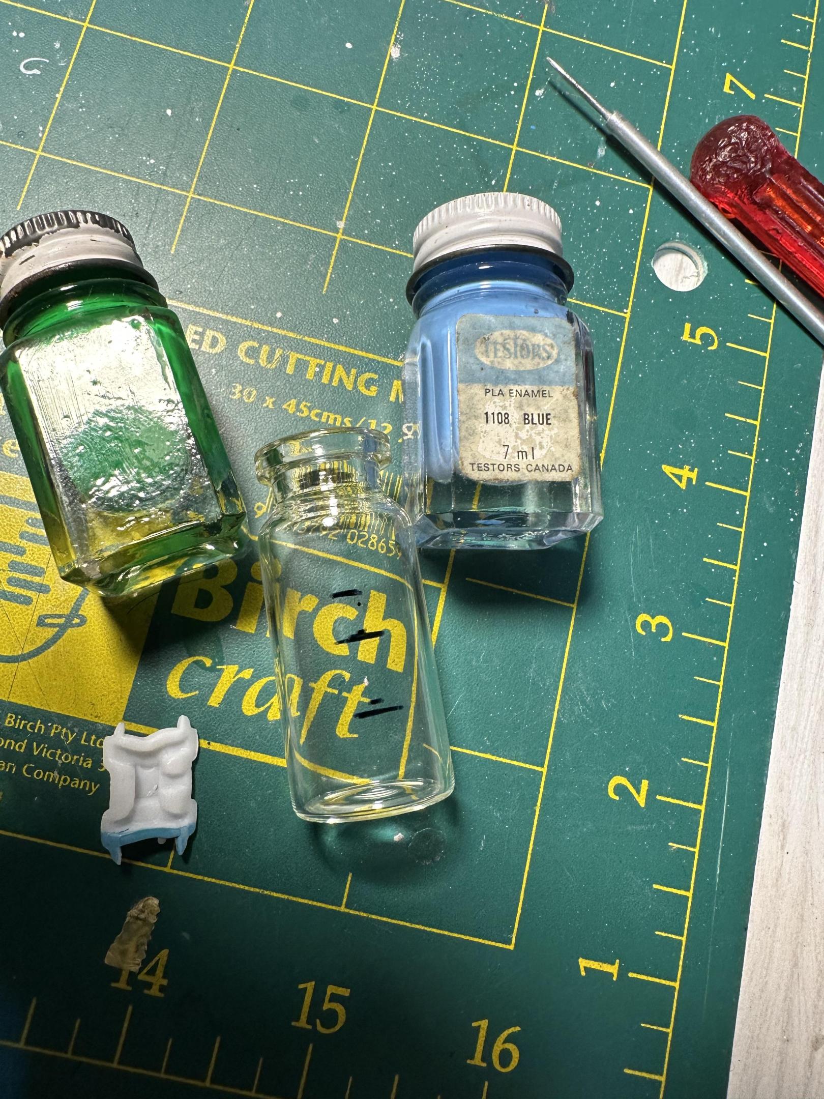

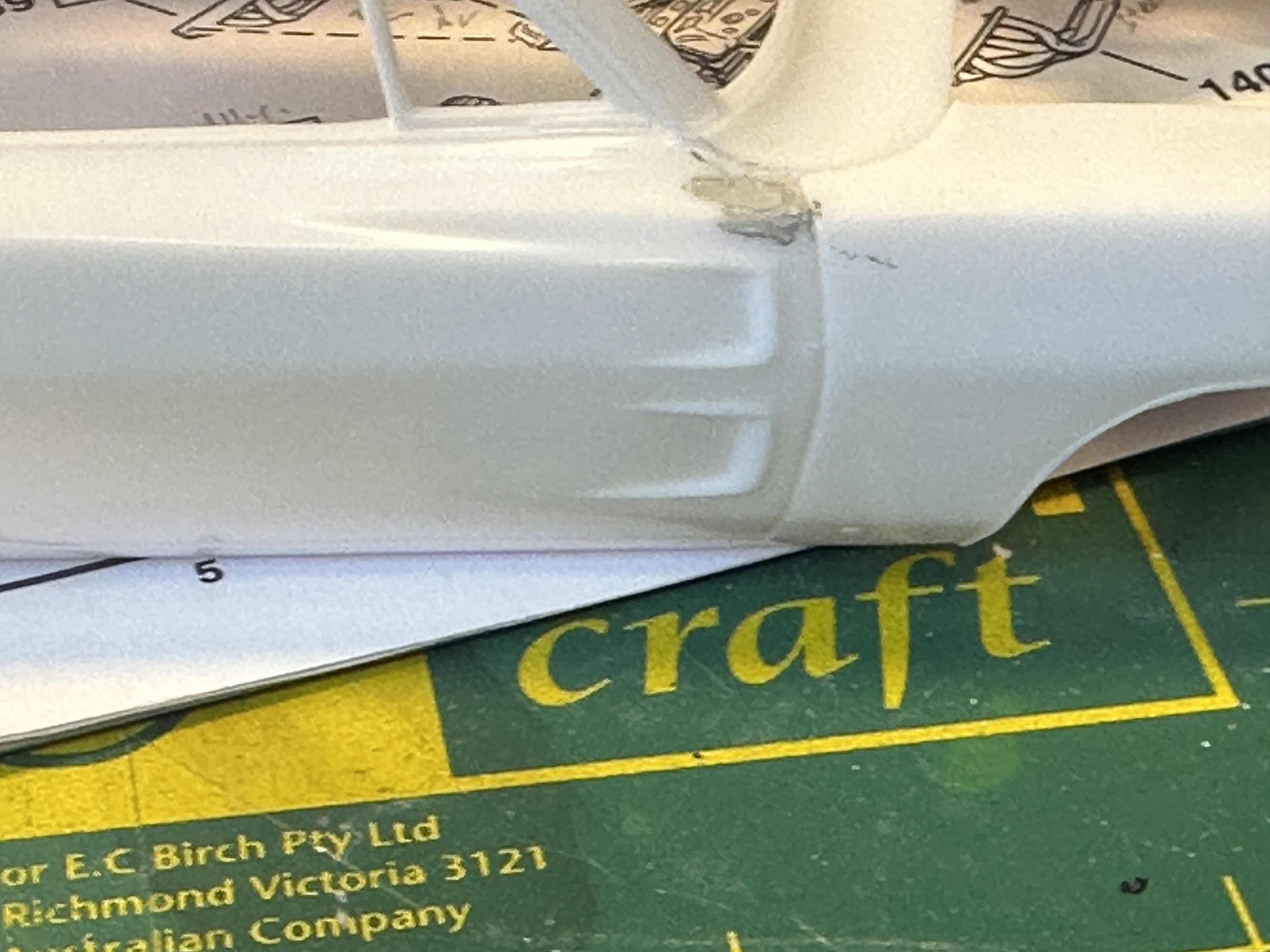

bill-e-boy Posted November 12, 2023 Author Share Posted November 12, 2023 Thanks for the kind comments guys. Greg - I will use the tip to cut the fan shroud in half as I get a bit testy when things don't go together well especially when you are at that stage of a build. The last installment left things hanging a wee bit. I mixed the green into the blue one or two drops at a time. I thinned the paint first as this made the mixing a lot easier. This is the result - Looks a little lighter in the pix but I am happy with the results. I moved on to the manual trans and painted that with Testors xxxx and sealed with a little clear shot from a distance so that it is not tooo shiny and I can handle it without the paint rubbing through- gee I love these paints, just a pity they are no longer available. I painted the 440 exhausts too. While the paint was drying I started on the body. I thought this would be a quick tidy up of the mould edges but I found some alignment issues at the left rear wing and passenger front door to cowl junction. Took quite a lot of clean up with some filler needed on the passenger door - cowl area Worst of all was a short shot on the drivers side rear corner This was filled back and a filler piece added that is now awaiting some shaping Thanks for looking 2 Quote Link to comment Share on other sites More sharing options...
slusher Posted November 13, 2023 Share Posted November 13, 2023 Testors still has the small jars of turquoise if you want a jar. I have a bunch of the little jars new saved before Rustoleum just for convenience. Nice mixing you did." Quote Link to comment Share on other sites More sharing options...

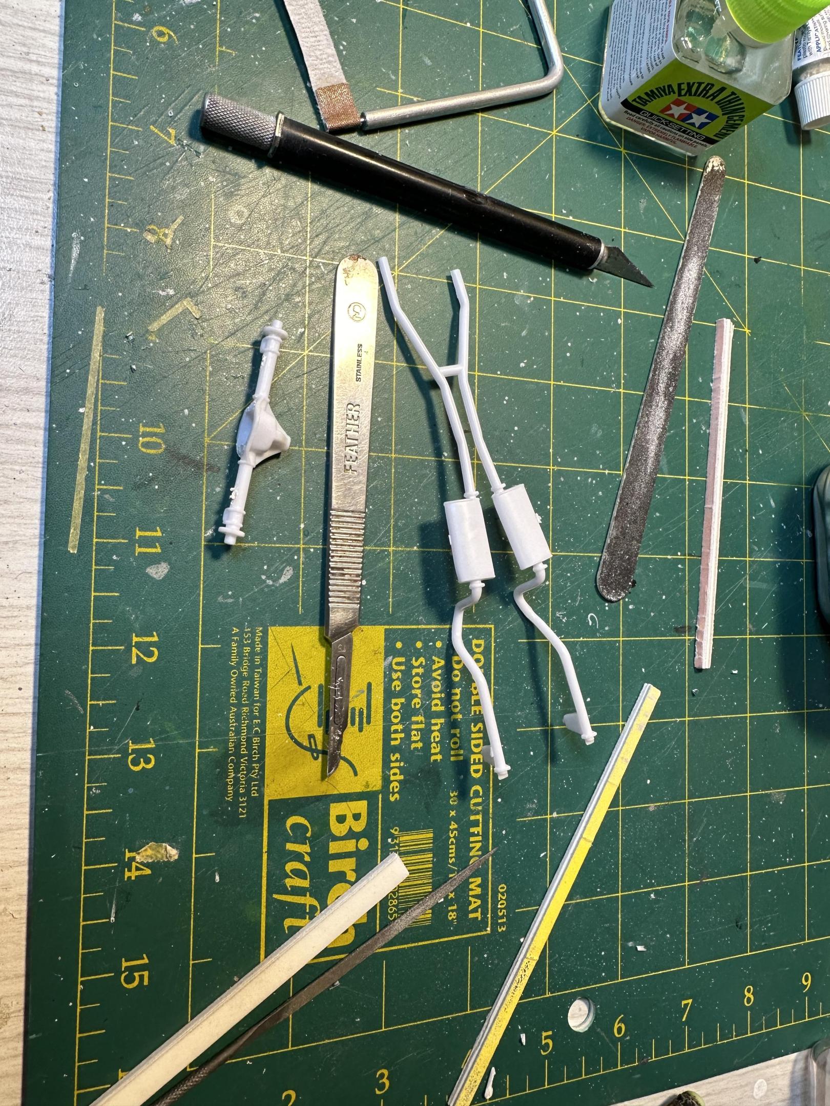

bill-e-boy Posted December 5, 2023 Author Share Posted December 5, 2023 Got the rear quarter fixed up. And spent more time on the grungy bit on the sail panels - same thing both sides Also had to fill in a bit of a gap in the rear panel parts - this is before I fixed it up The rest of the time between the last post and now has been spent cleaning up mould lines, ejector pin marks and sharp edges. I was taught very early in my modeling life that time spent on clean up and getting all the knarly bits sorted before paint is what makes the difference between two kits when judged side by side. As this is a box stock build this is every much as important as a in a super detailed build Tools for action - and there is a lot of it - I think I said in an ealier post that there are lots of parts in this kit and they all need attention . And Hemi vs Wedge Thanks for looking 4 Quote Link to comment Share on other sites More sharing options...

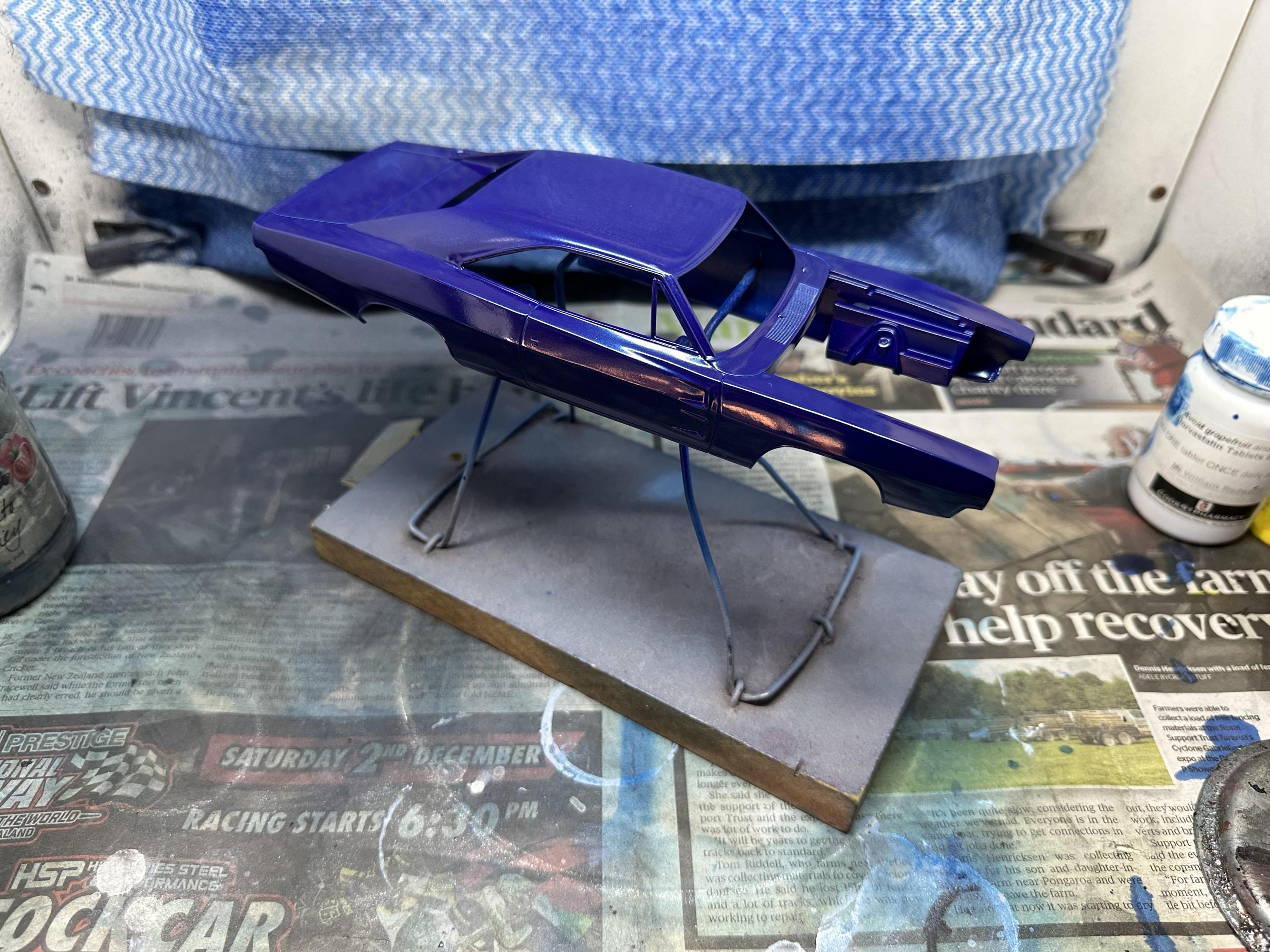

bill-e-boy Posted January 21 Author Share Posted January 21 Getting paint on it. Tamiya LP47 Pearl Blue Quote Link to comment Share on other sites More sharing options...

slusher Posted January 23 Share Posted January 23 Great shade of blue, look real nice on your Charger.. Quote Link to comment Share on other sites More sharing options...
bill-e-boy Posted February 5 Author Share Posted February 5 Catch up time. I have been away for a couple of weeks looking after the grandkids for the last two weeks of their summer holidays. Got some clear on the body and other body parts and they are curing ready for colour sanding and polishing. This is straight off the gun Masked up the fuel tank ready for paint. and painted I have also been working on interior detail and assembling the engine. More to come, thanks for looking 5 Quote Link to comment Share on other sites More sharing options...
