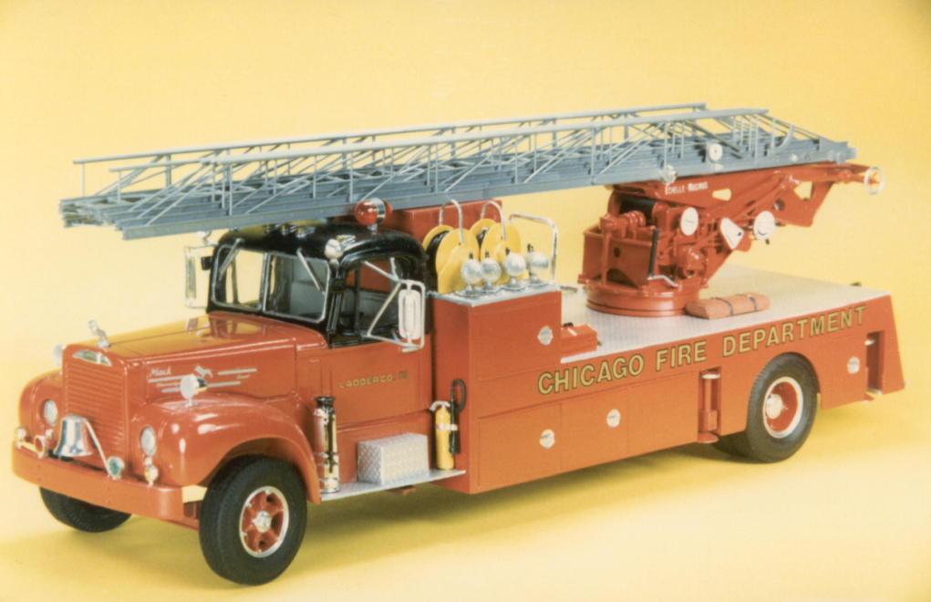

spencer1984 Posted November 8, 2023 Posted November 8, 2023 I haven't tried the movie truck yet, but I did build one inspired by the book: 2
