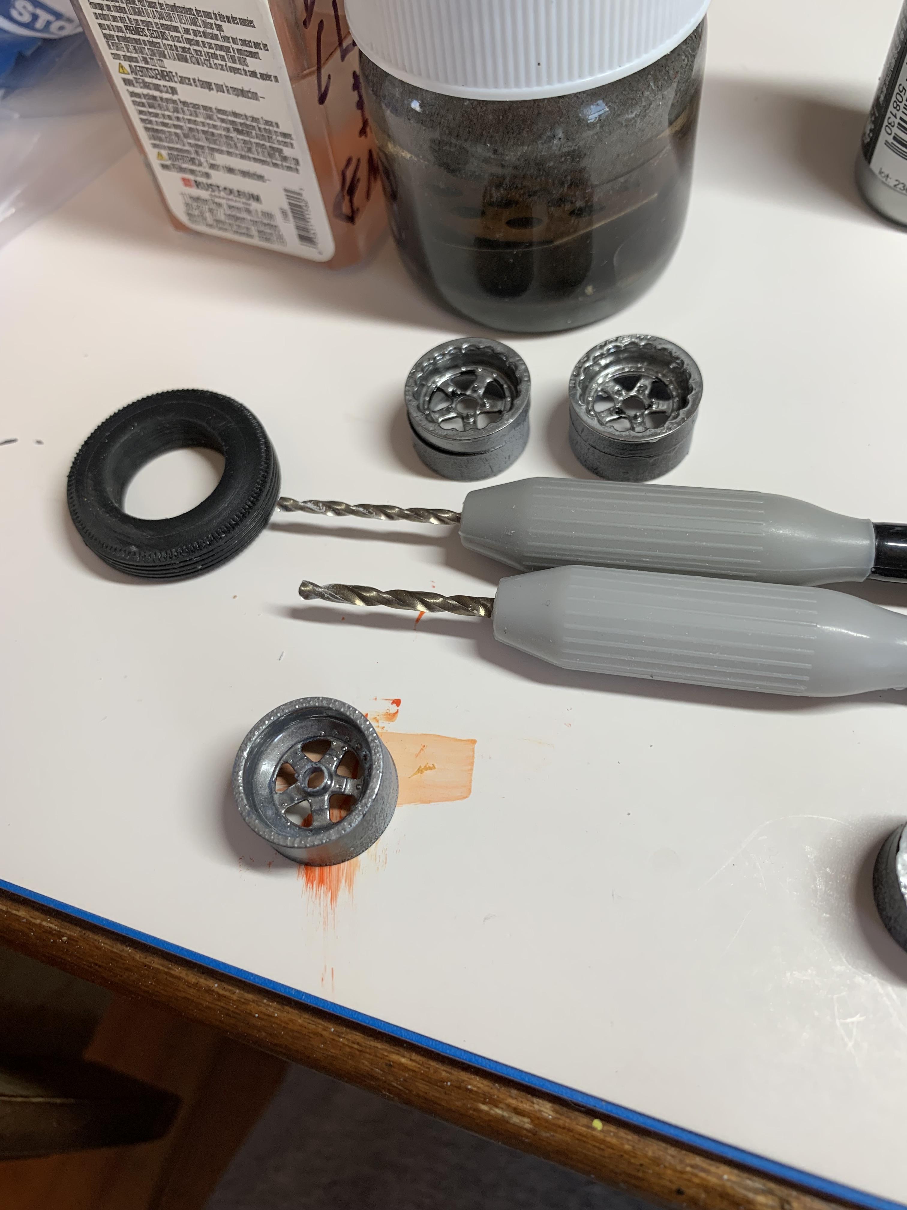

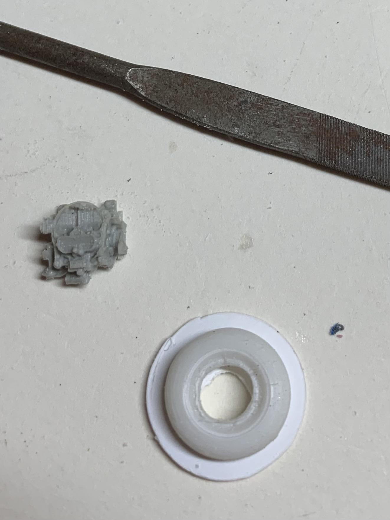

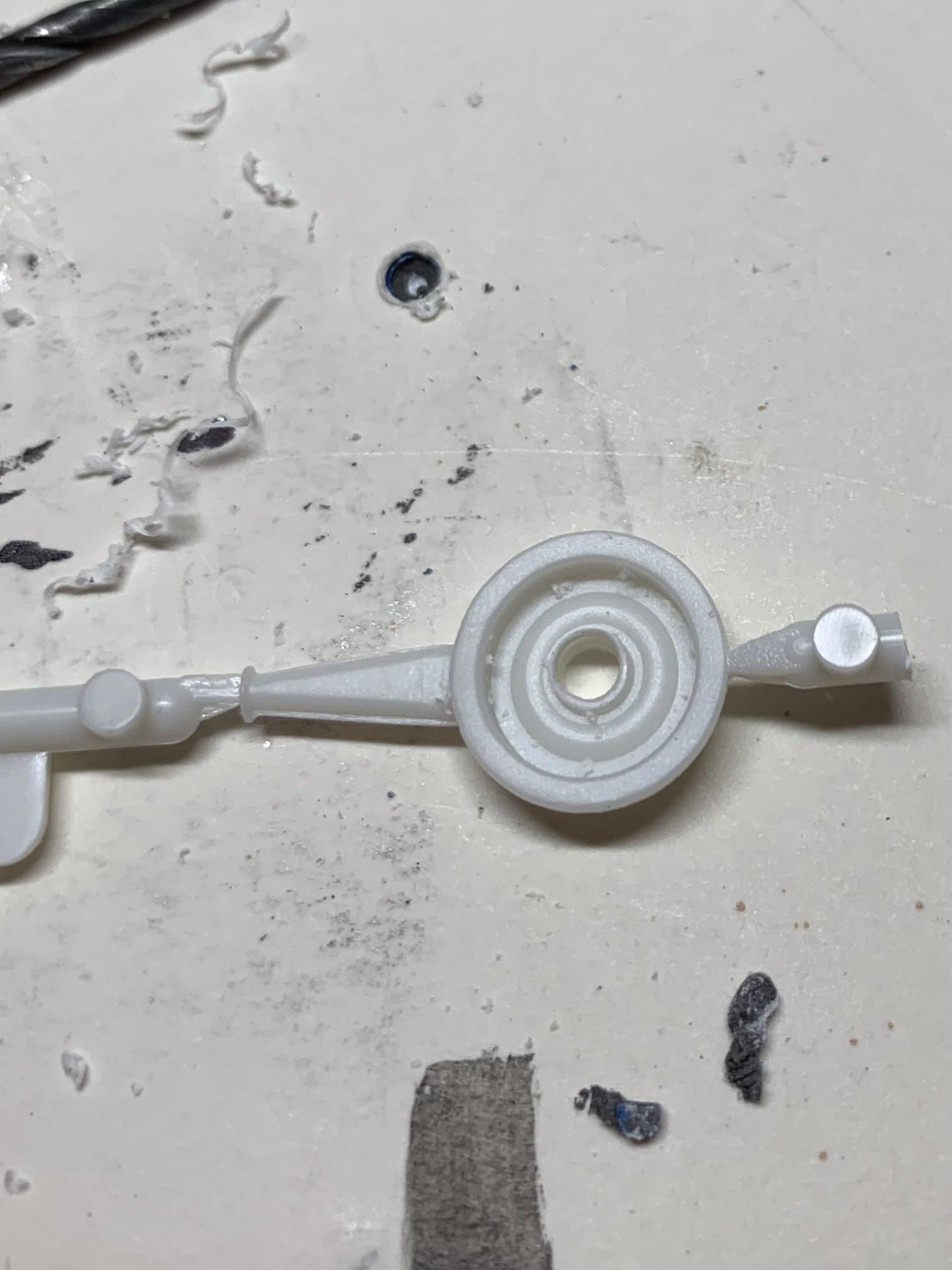

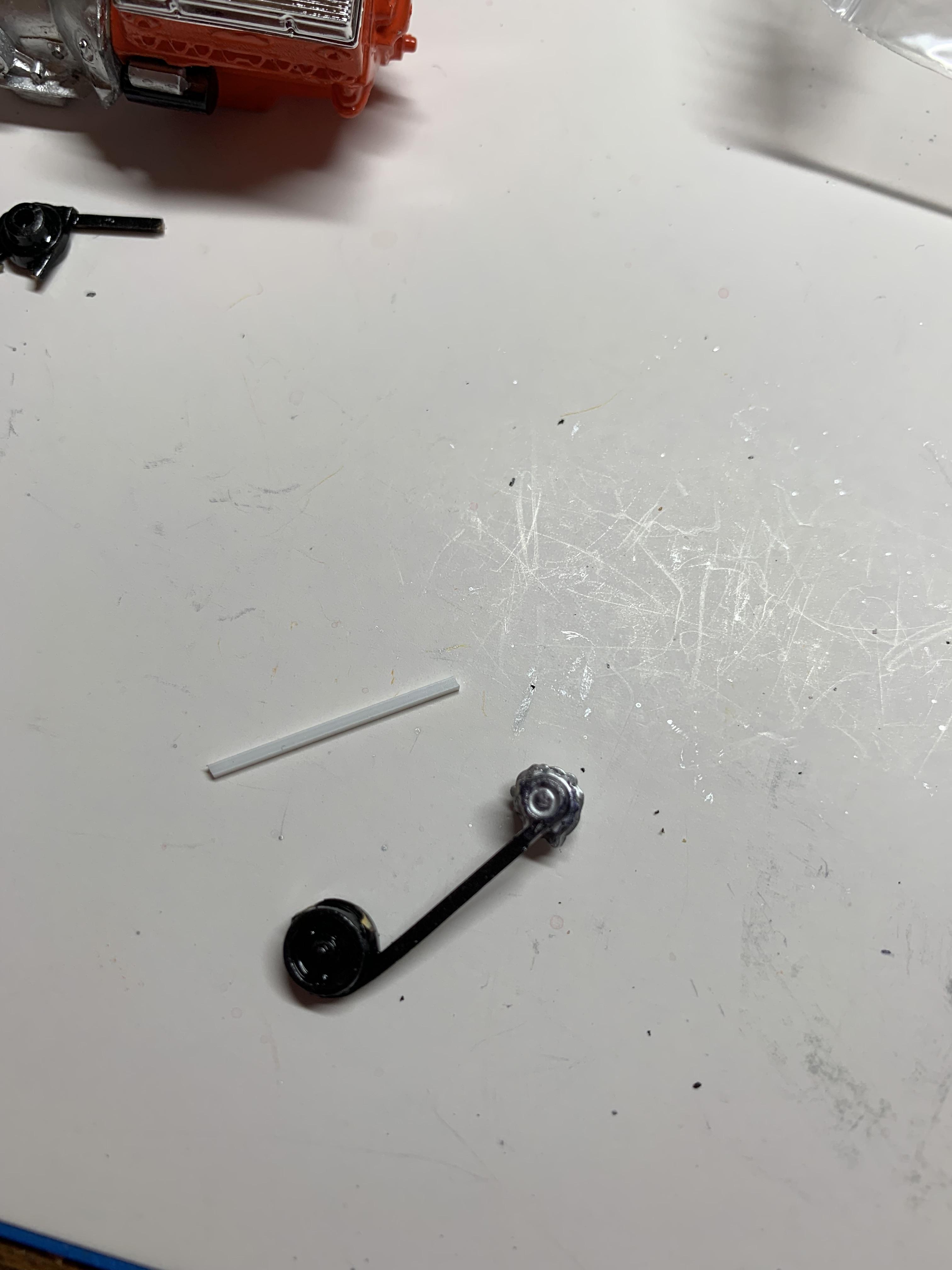

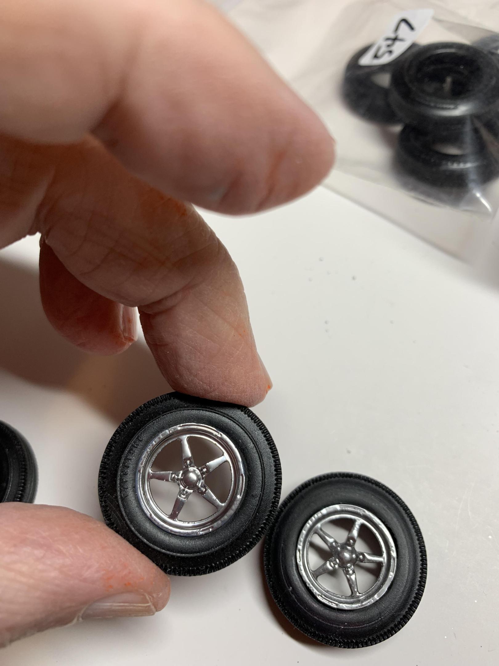

Sort of a ho hum day.  The closest wheels (Alumastar, that is) i can find measure about .660” o.d.  That means the I.d. of the tires i have in my parts box have to be opened up about .060”.   Well, after scrounging around, I came up with a 5/8” (.625”) drum sander.  By “drilling” it out, holding the tire with one hand and drilling with the other, a shaky proposition, and not one I recommend.  Then, working the drum around the inner circumference of the tire (a tedious procedure with lots of measuring thrown in) we arrive at an I.d. of .660”.  I am not thrilled with this procedure, as I would like to “make” about 15 of these for future Stocker projects.  I am considering using 15 and 16mm sanding flaps.  If anyone has any better, simpler, safer, etc., ideas , I am all ears.  I also did some sanding on the sidewall of one tire to more closely approximate the racing front tires used on Stock and Super Stocks.  They are smooth and have no side tread ribs.  Oh, yeah, I did find in my cheapie Harbor Freight grinder a 3/8” drum sander that you walk around the circumference of the tire a little easier but, kinda slow going.

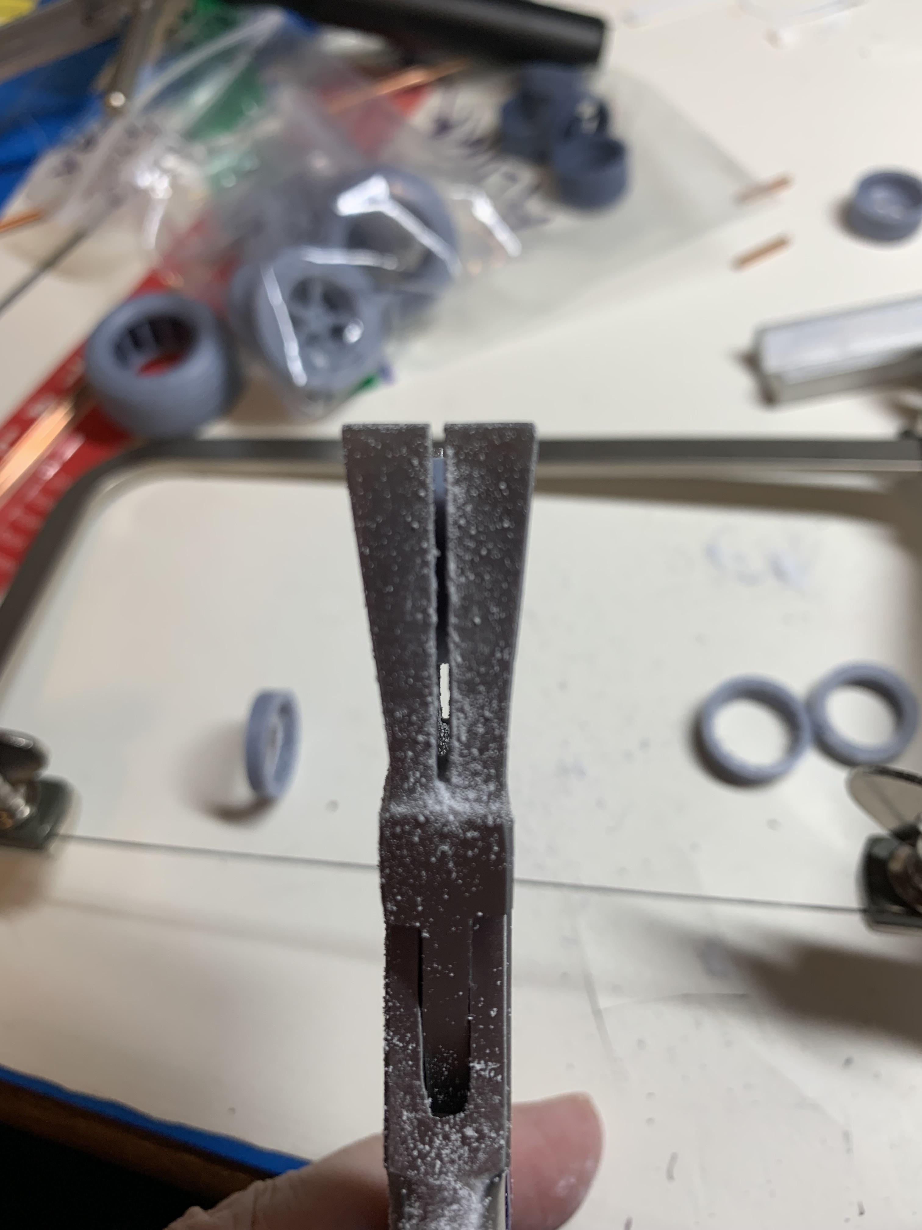

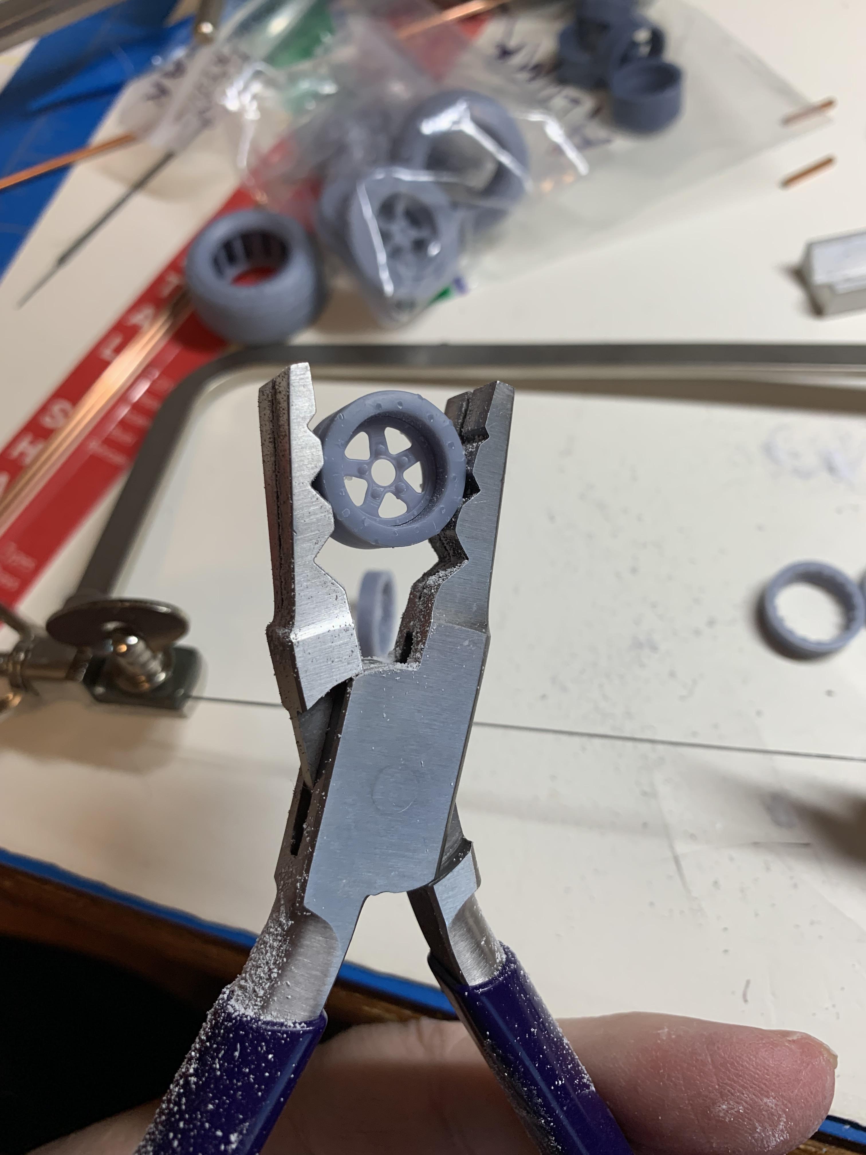

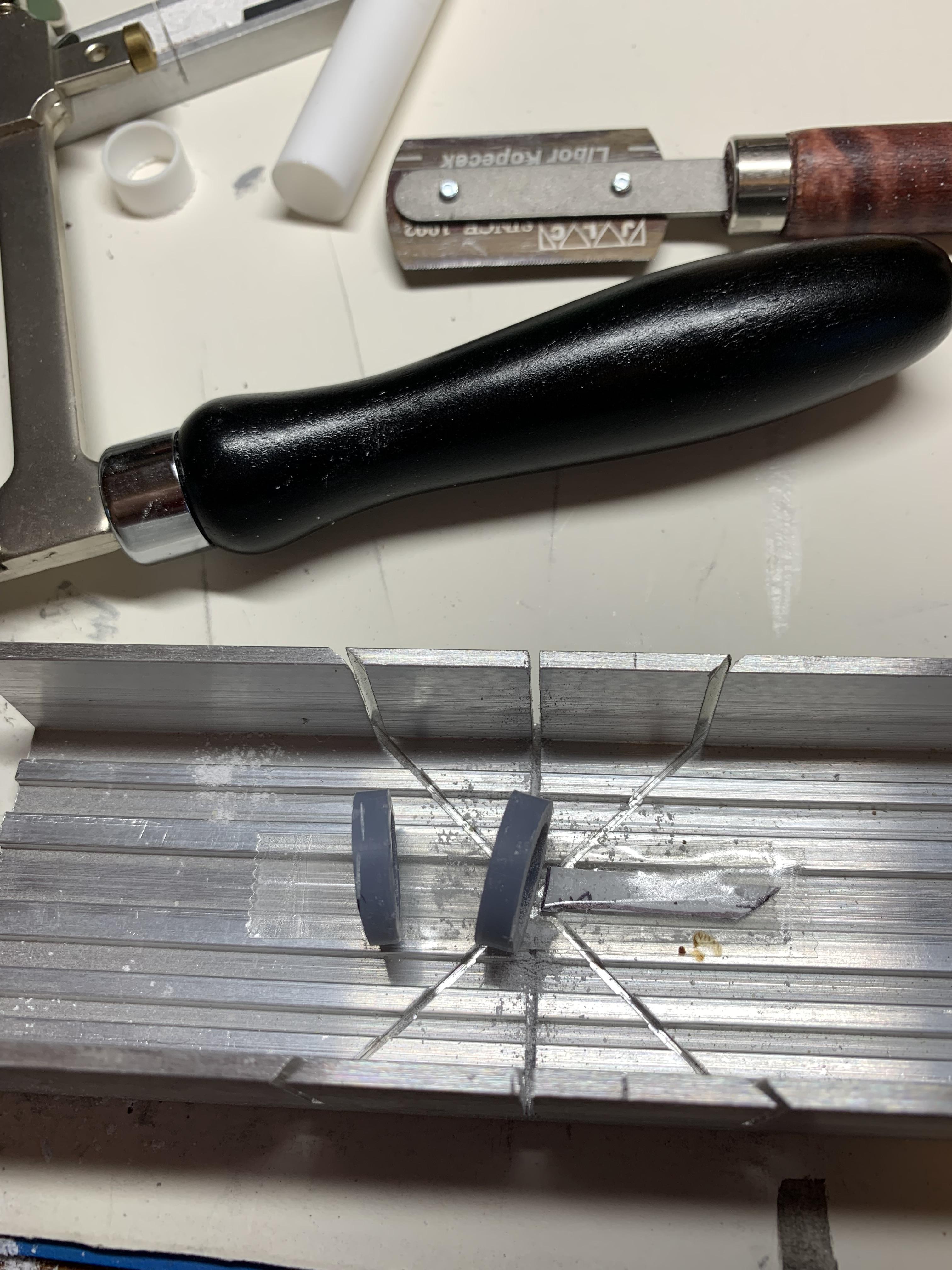

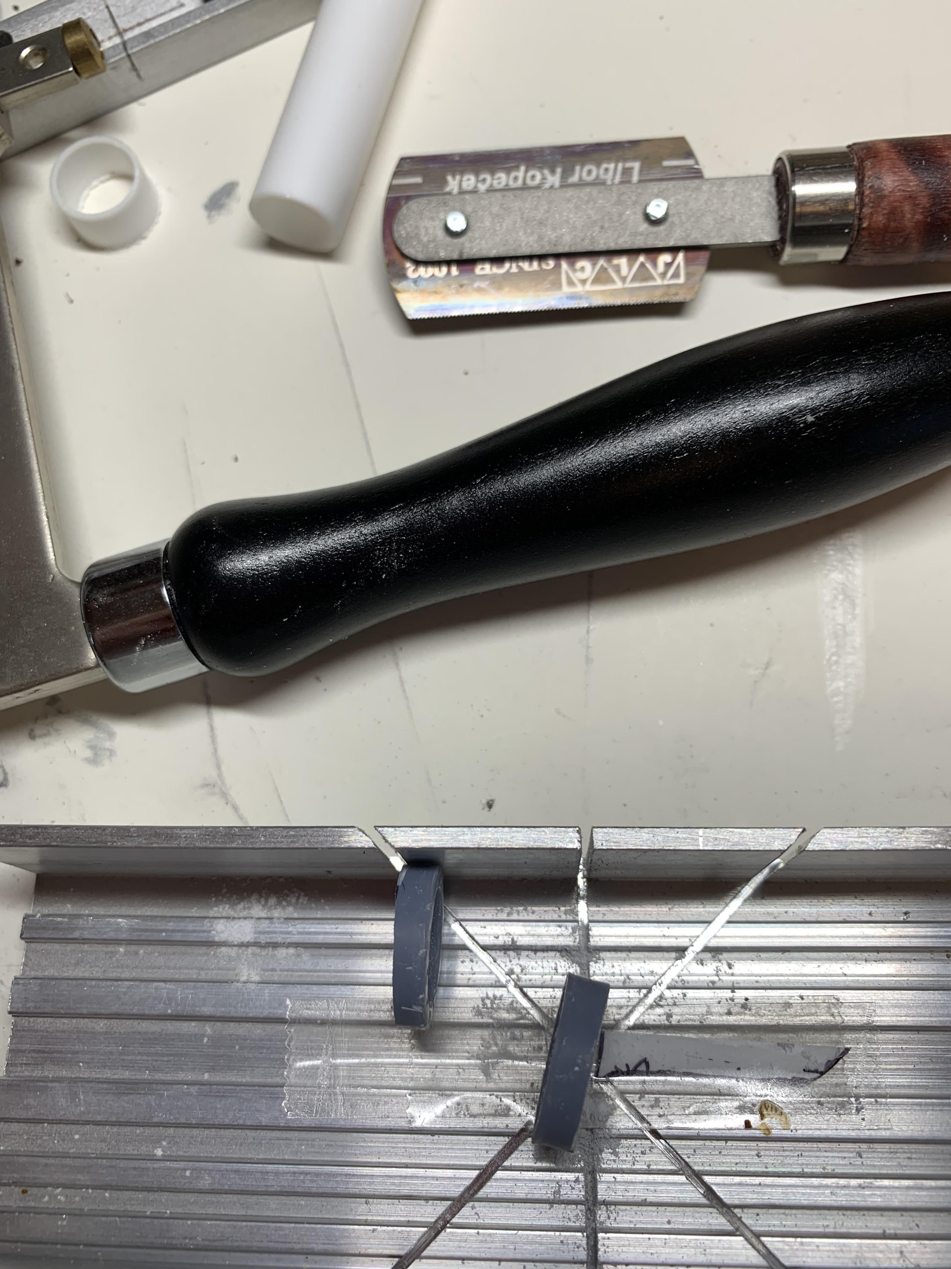

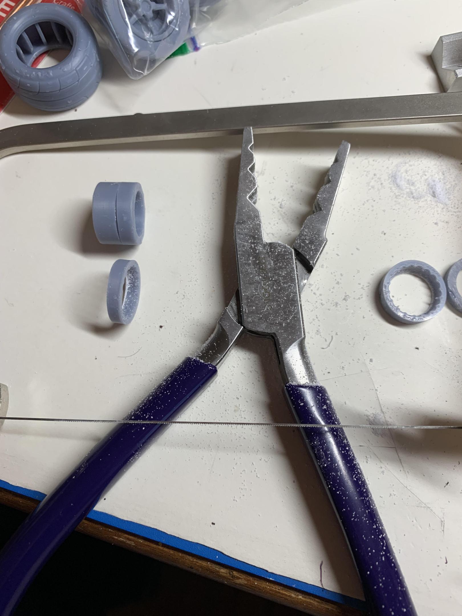

Anyway, after a break of a few days, I am back at it making the 14” (1/25 scale .560”)  resin wheels into 10” Stock Eliminator wheels (1/25 scale .400”).  I have done this on other wheels (narrowed them) in a miter box with double back tack to hold them in place and did so again on these, but did not like the results.  The razor saw(s) always seem to cut crooked and require a fair amount of truing up.  Looked for something better and my new specialty jewelry pliars and saw worked much better.  Hopefully, you can see the difference between them.
  • Like 1
Well, after bragging about my new tools for cutting straighter lines, the next 2 wheels turned out worse and varied about .030” from one side to the other and required tedious hand sanding to straighten them.  If anybody has any suggestions, let’s hear them.  Good old coarse sanding stick to the rescue.
On 12/11/2023 at 9:42 AM, dwc43 said:
I have one of these. The slots in that box are very tight and it makes for a straight cut with a stiff back saw like the one in the pic.
Midwest Easy Miter Box Deluxe 83277 | Zoro
And Micro Mark has this handy electric one.
MicroLux® Mini Miter / Cut-Off Saw (micromark.com)

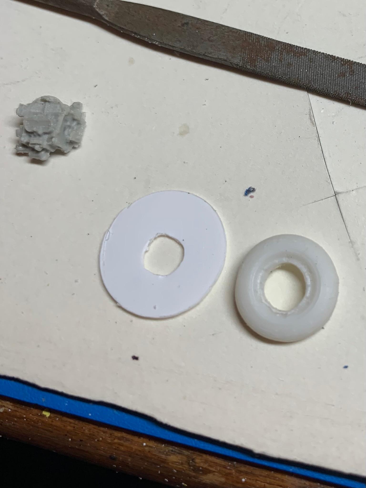

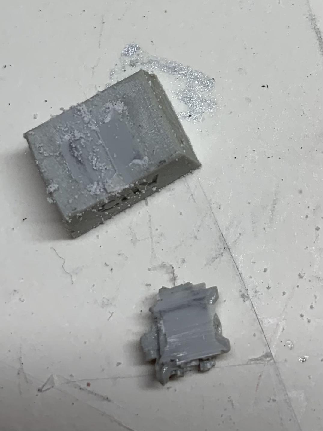

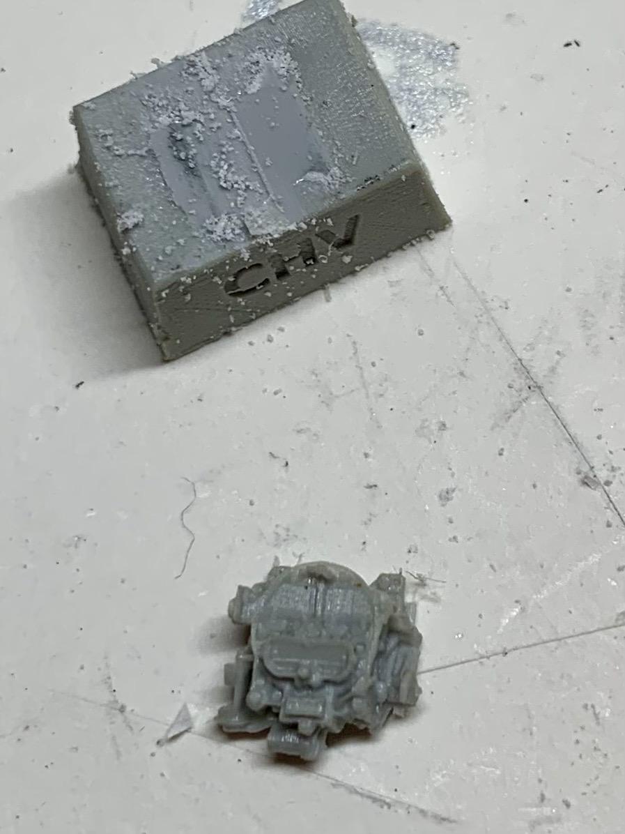

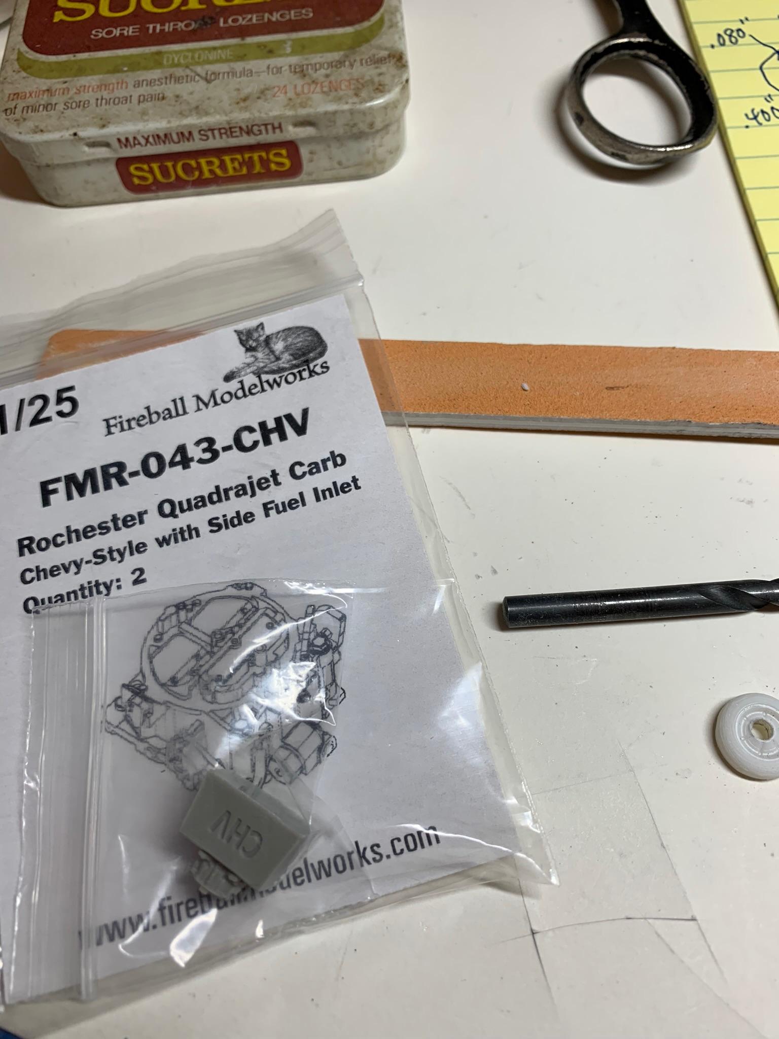

Your input is much appreciated.  I have the Zona 35-241 thin slot on order.  We shall see how that works out.  Spent some time fabricating a performance air cleaner base that a lot of guys use and is worth as a tenth of a second on some cars.  Used the stock air cleaner from the Moebius Chevy 2 kit and some .010” styrene.  I plan on making a mold and casting a few for future builds.  Still have some finish work, but almost there.  Also, cut off the Chief Joseph quadrajet (great carbs, as almost everyone knows) with that great cutter I got from UMM-USA.

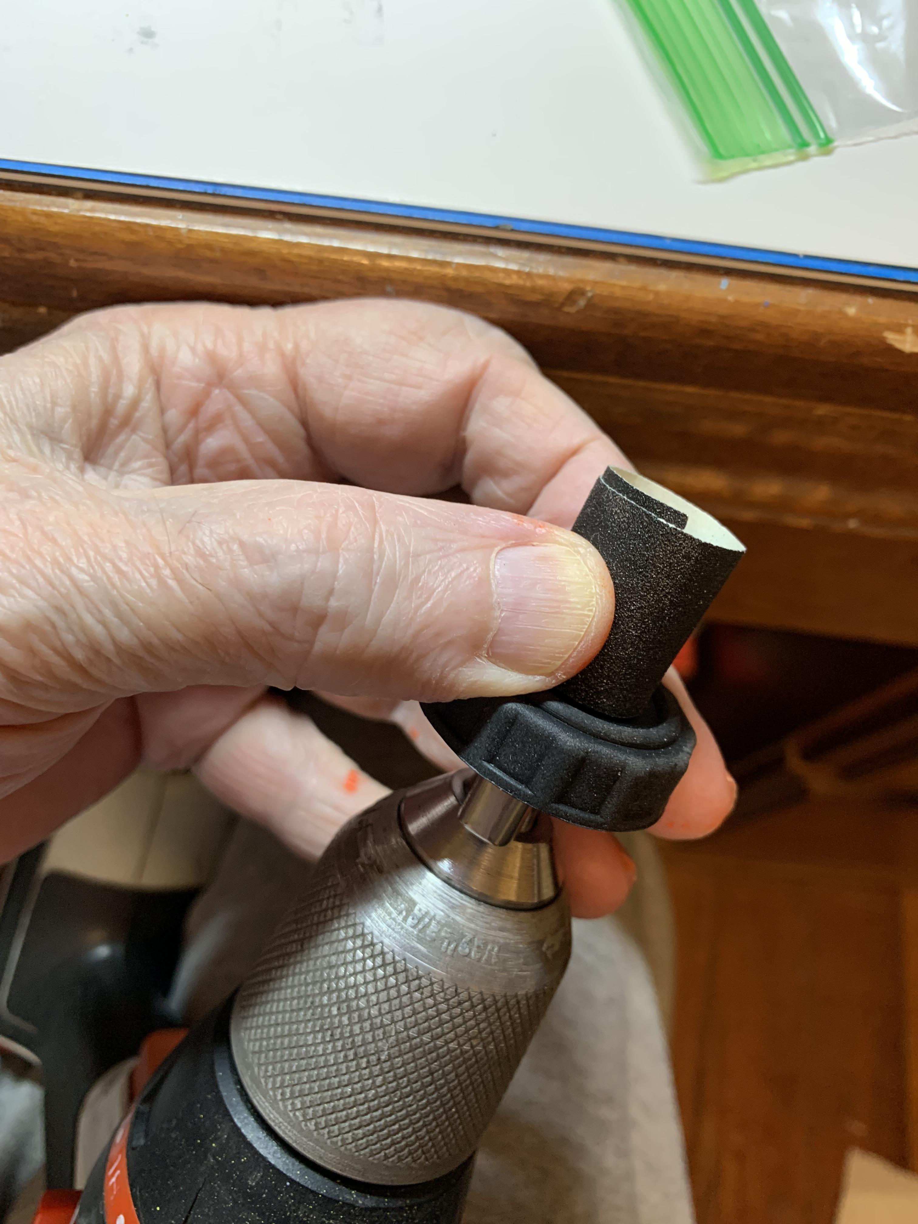

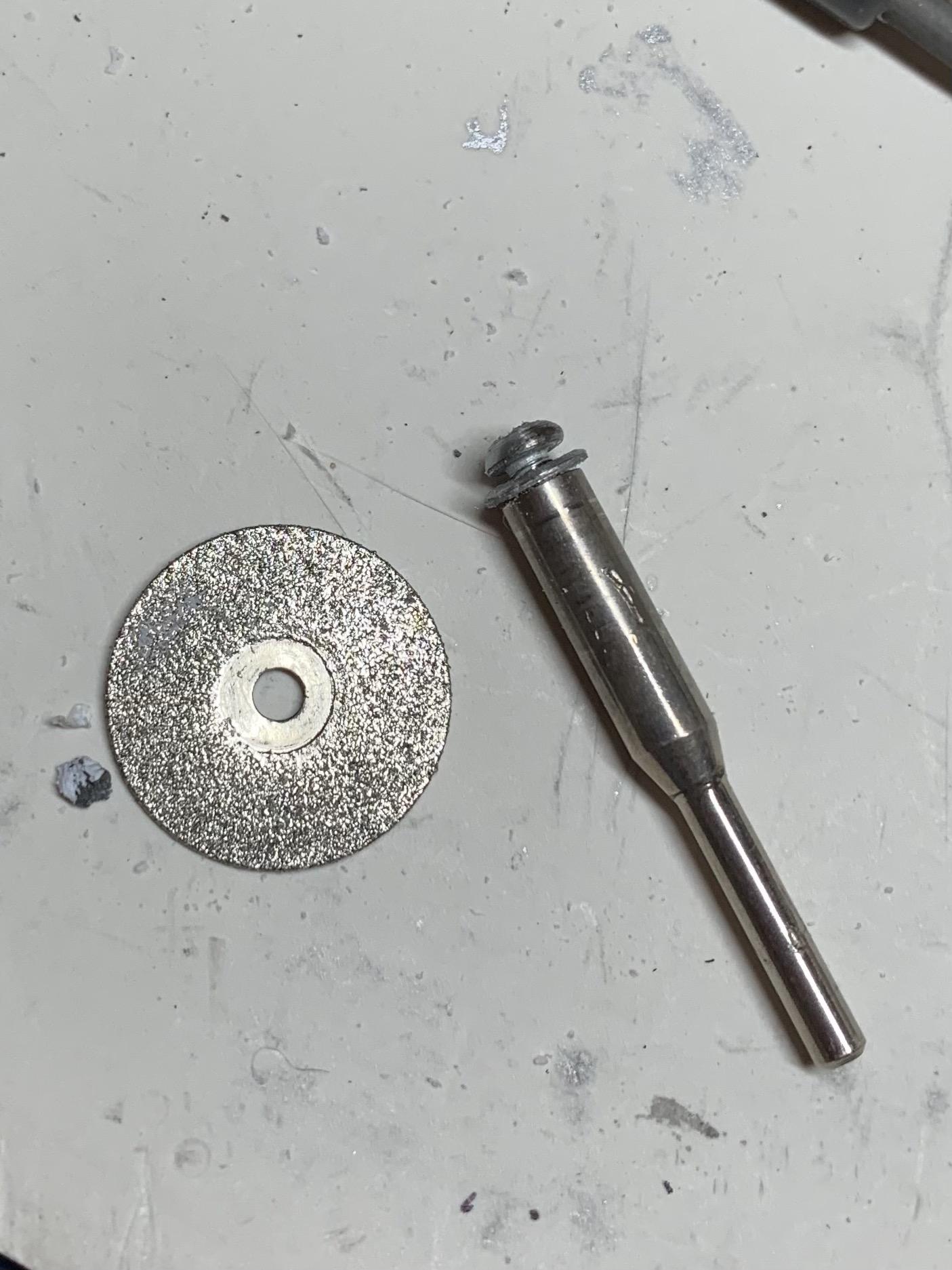

By the way, I used this adapter for a cut off wheel out of a Harbor Freight cheapo grinder set, drilled a hole in the air cleaner the size of the screw, and mounted it in my cordless drill.  This allowed me to sand it down to the shape of the air cleaner base.

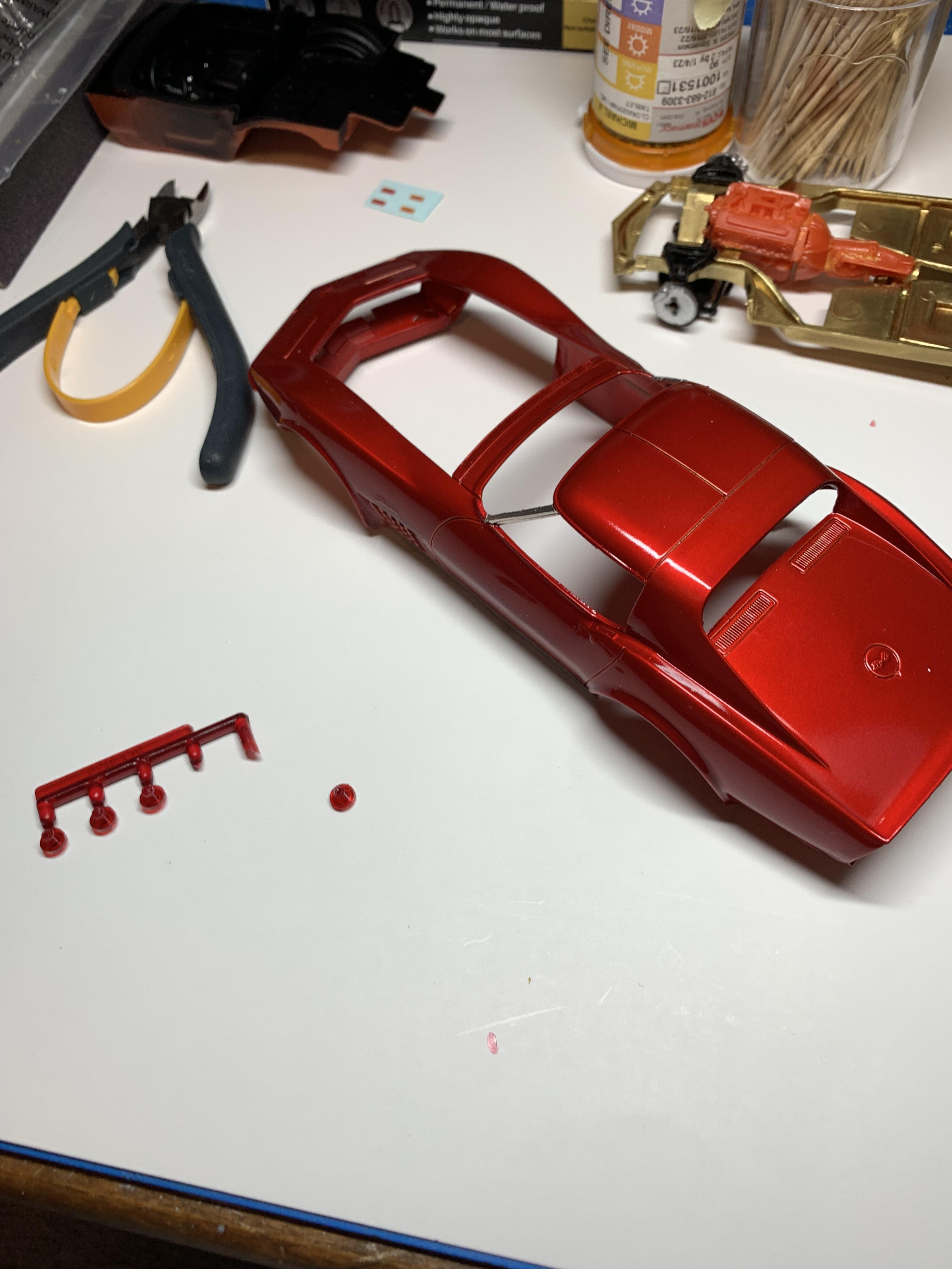

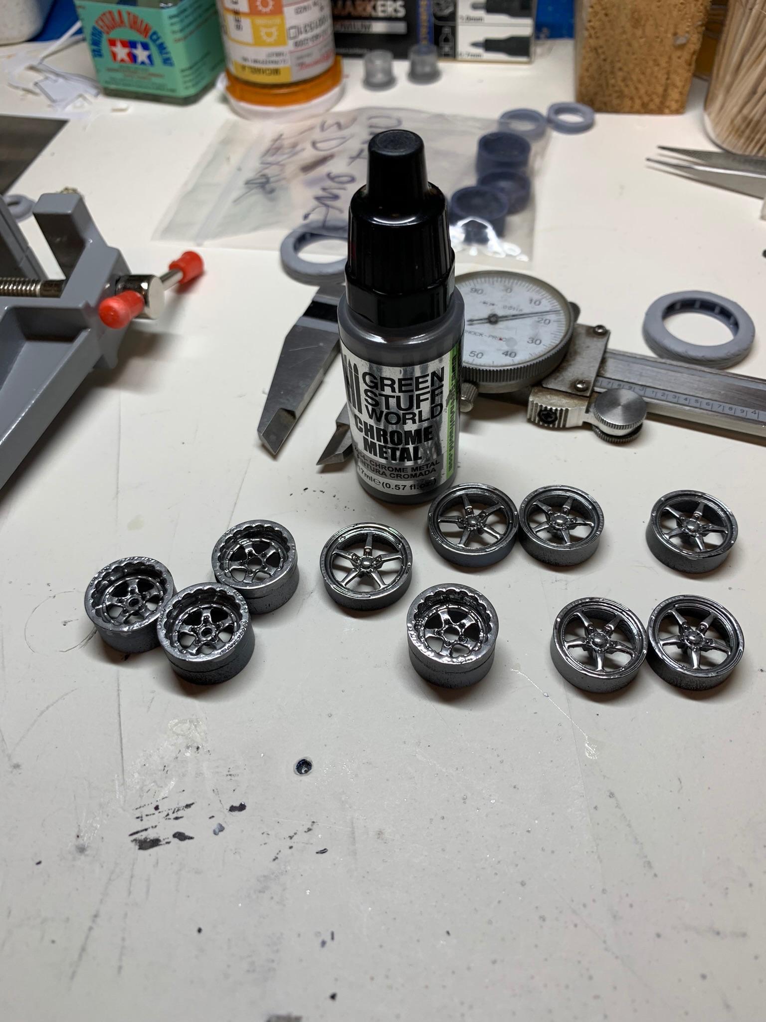

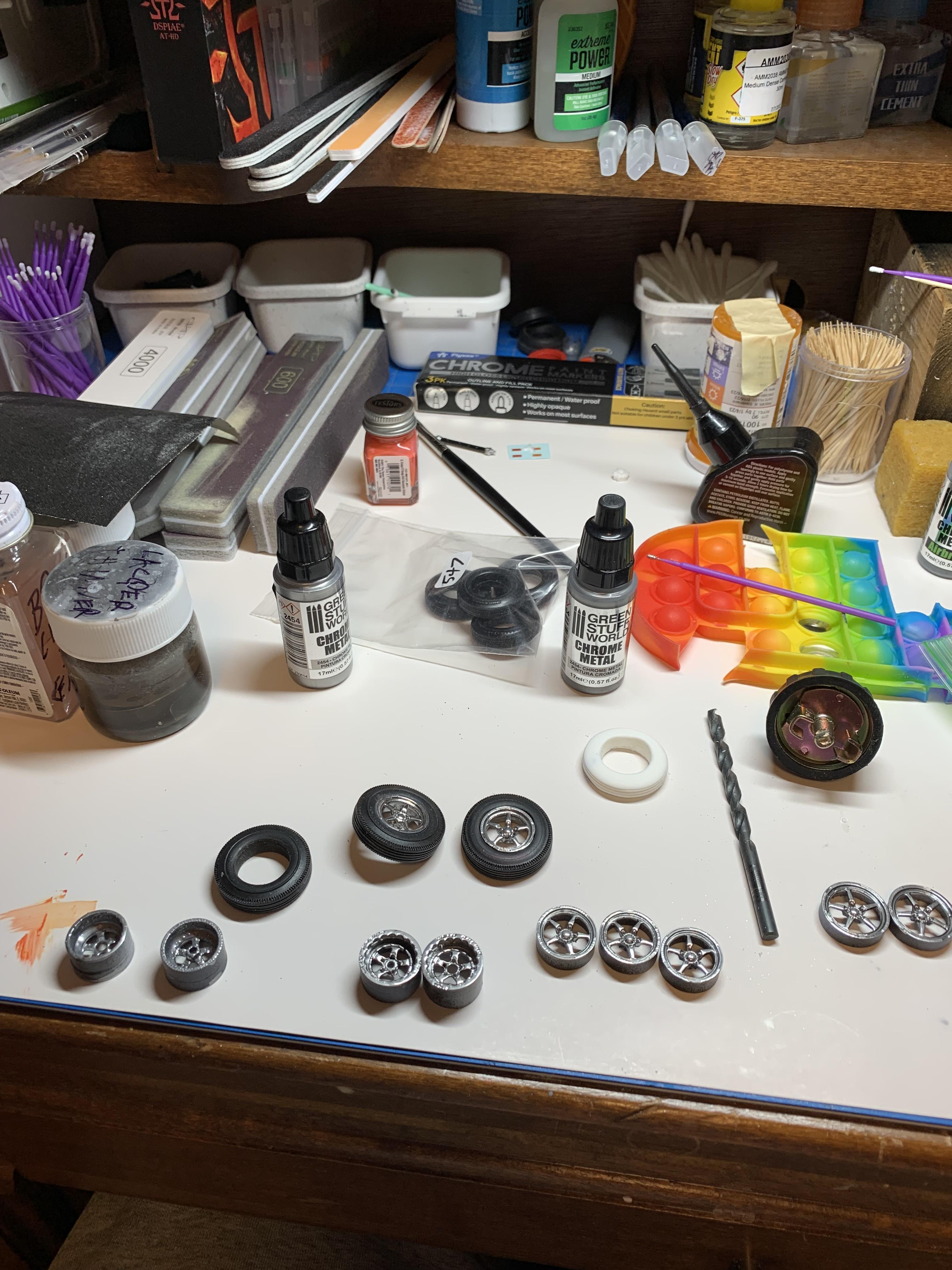

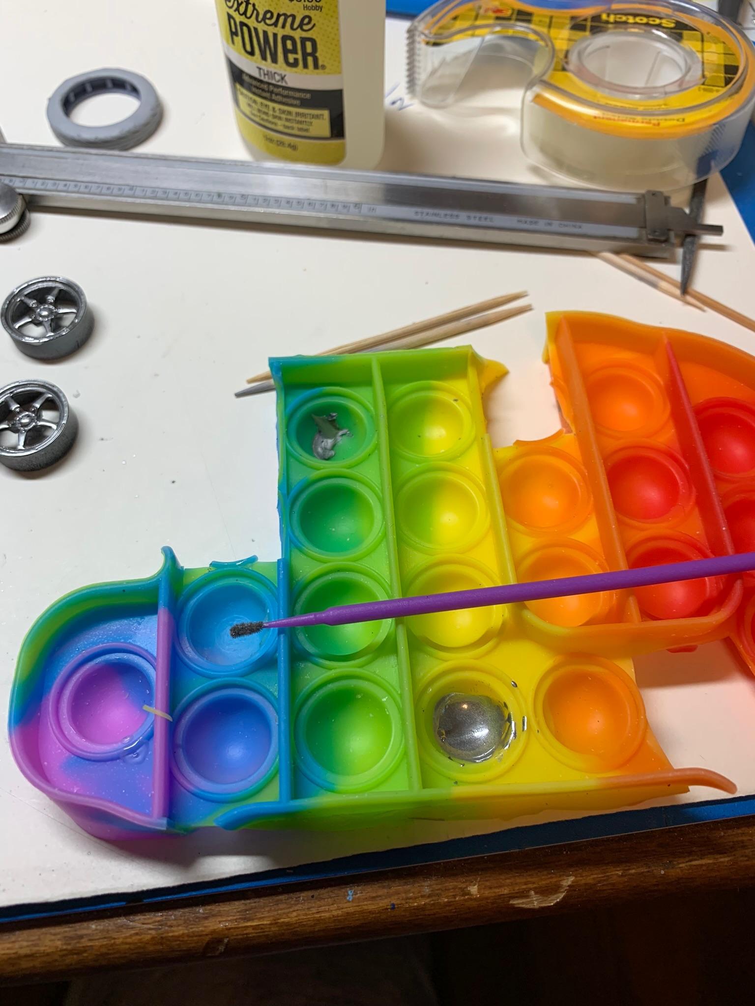

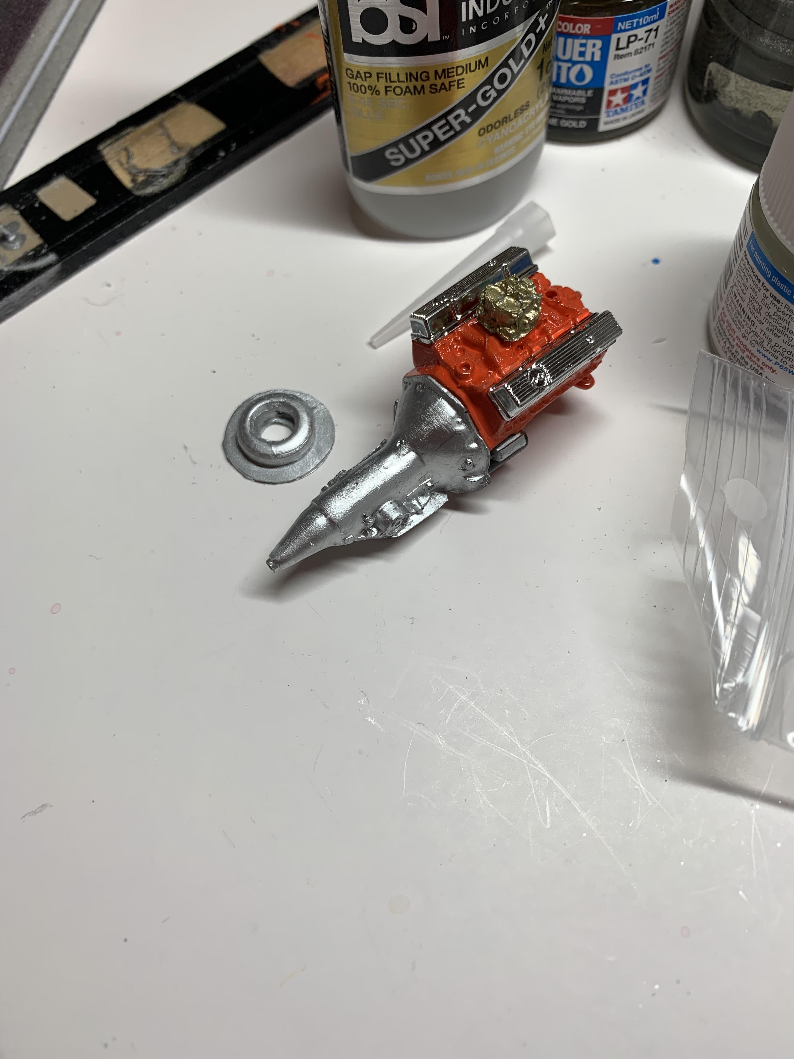

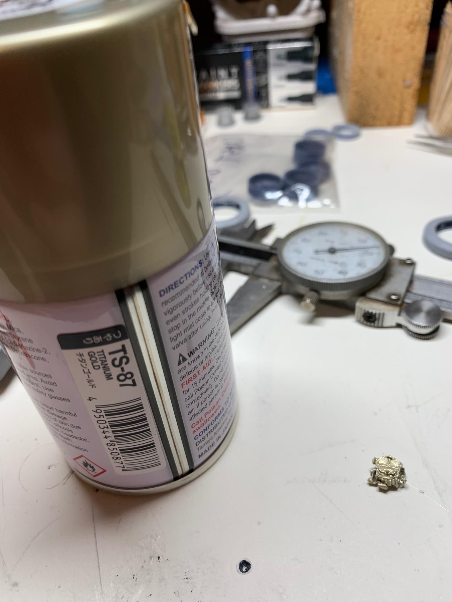

Slow going.  Decided to get a bunch painted at once for future builds.  Primed some wheels and rotors and the Quadrajet, then some gloss black.  Some Titanium gold for the carb.
Then some stainless steel for the rotors and GreenStuffWorld chrome for the wheels daubed on with a micro brush.  Next step is to make some molds and castings of headers, trans, tire, and air cleaner base before I can finish the model.

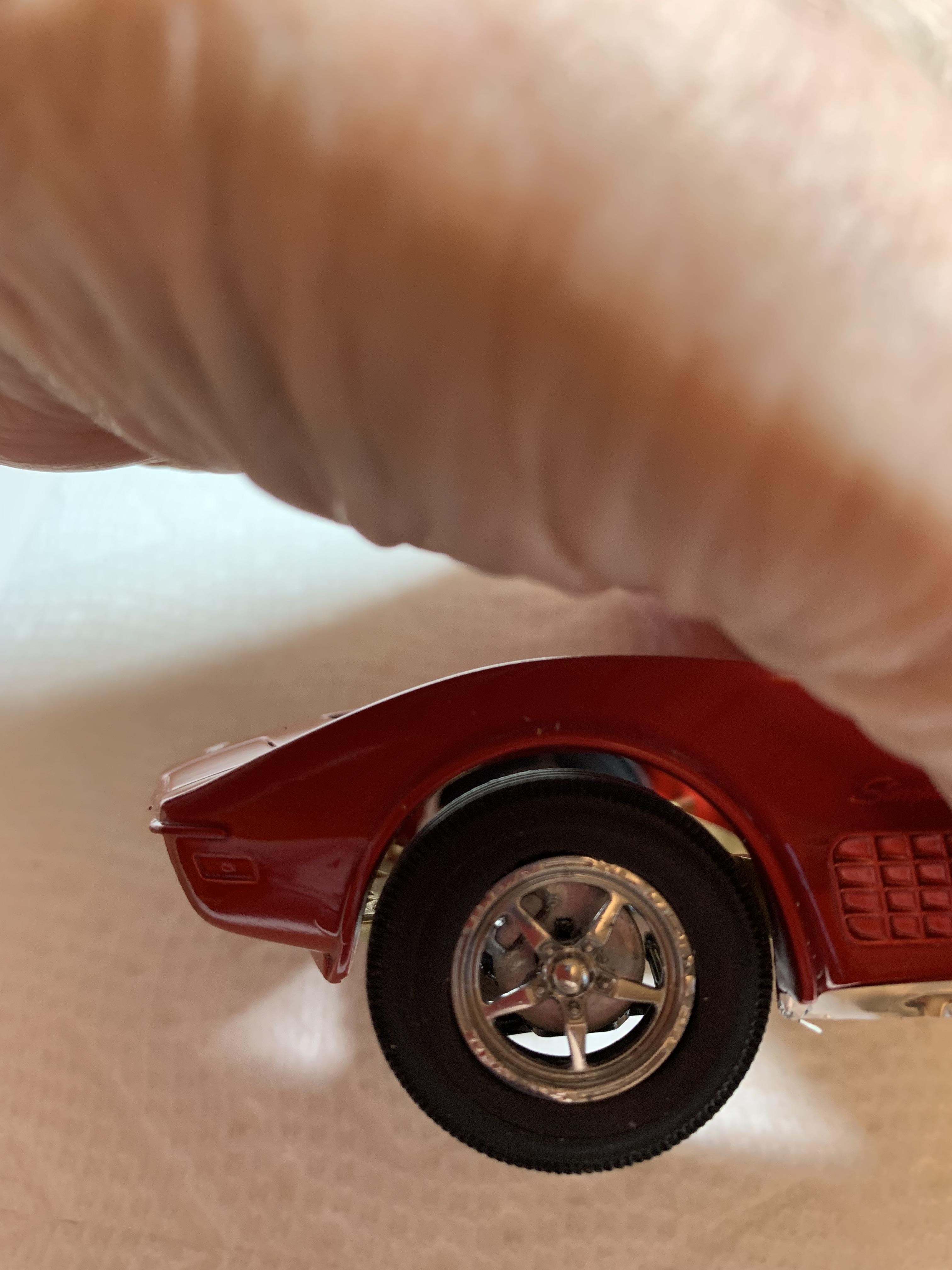

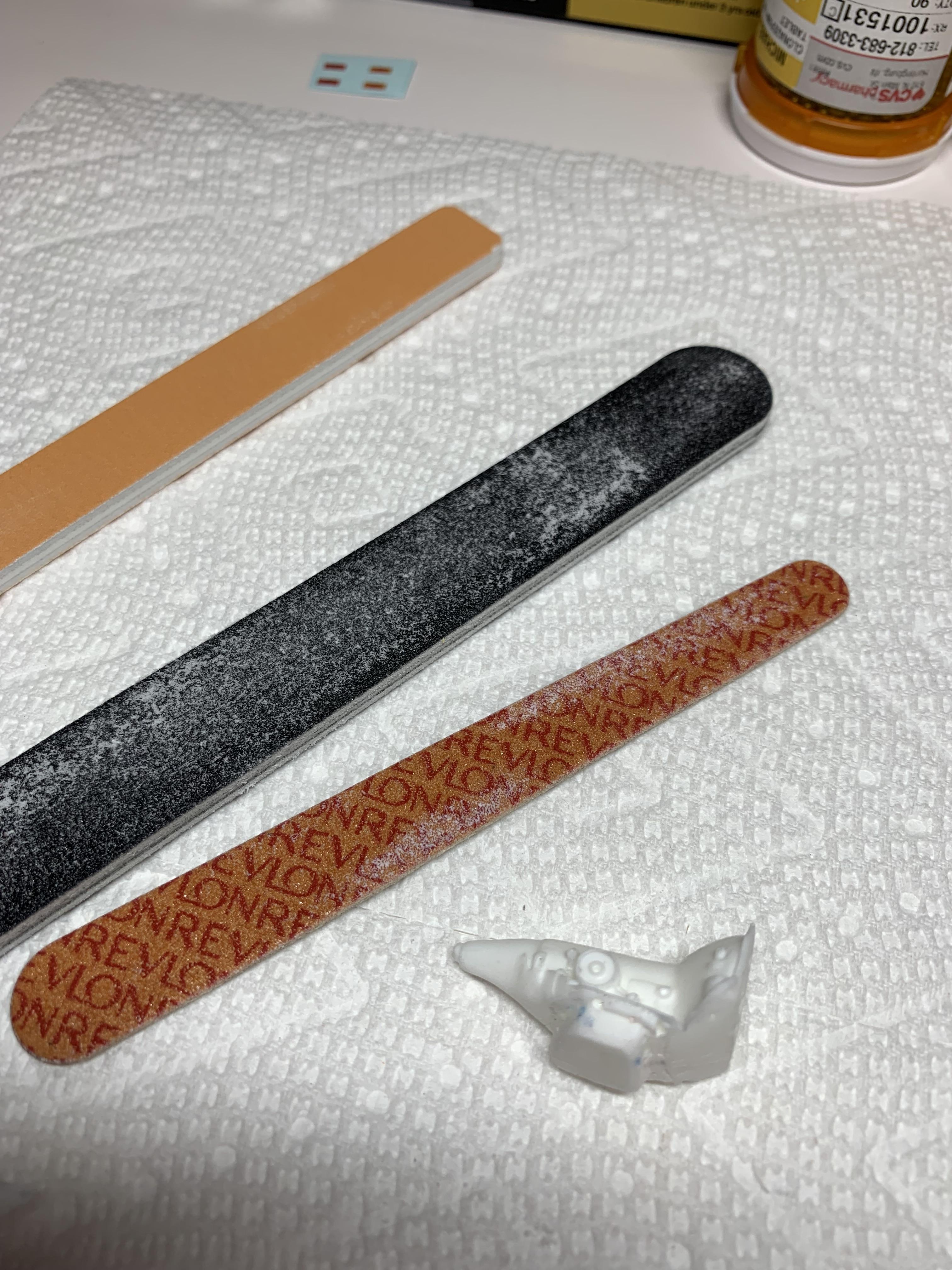

For sanding wheels thinner, and/or opening up the holes, I tape some 180 grit sandpaper to my hobby desk under my bench towel. I just hold the rim and make circles and figure 8s until I get them where I want. If I have a lot of material to remove, say all I want are the hoops, I use my palm sander. Now that I have a mini lathe, I actually make custom hoops from genuine aluminum tubing. Opening the ID of a tire, I usually use a hobby knife. Generally I do not have to because I have 4 overflowing model boxes of tires. Over the weekend I used my lathe to carve groove in the side wall of some tires to make perfect big and littles white walls.

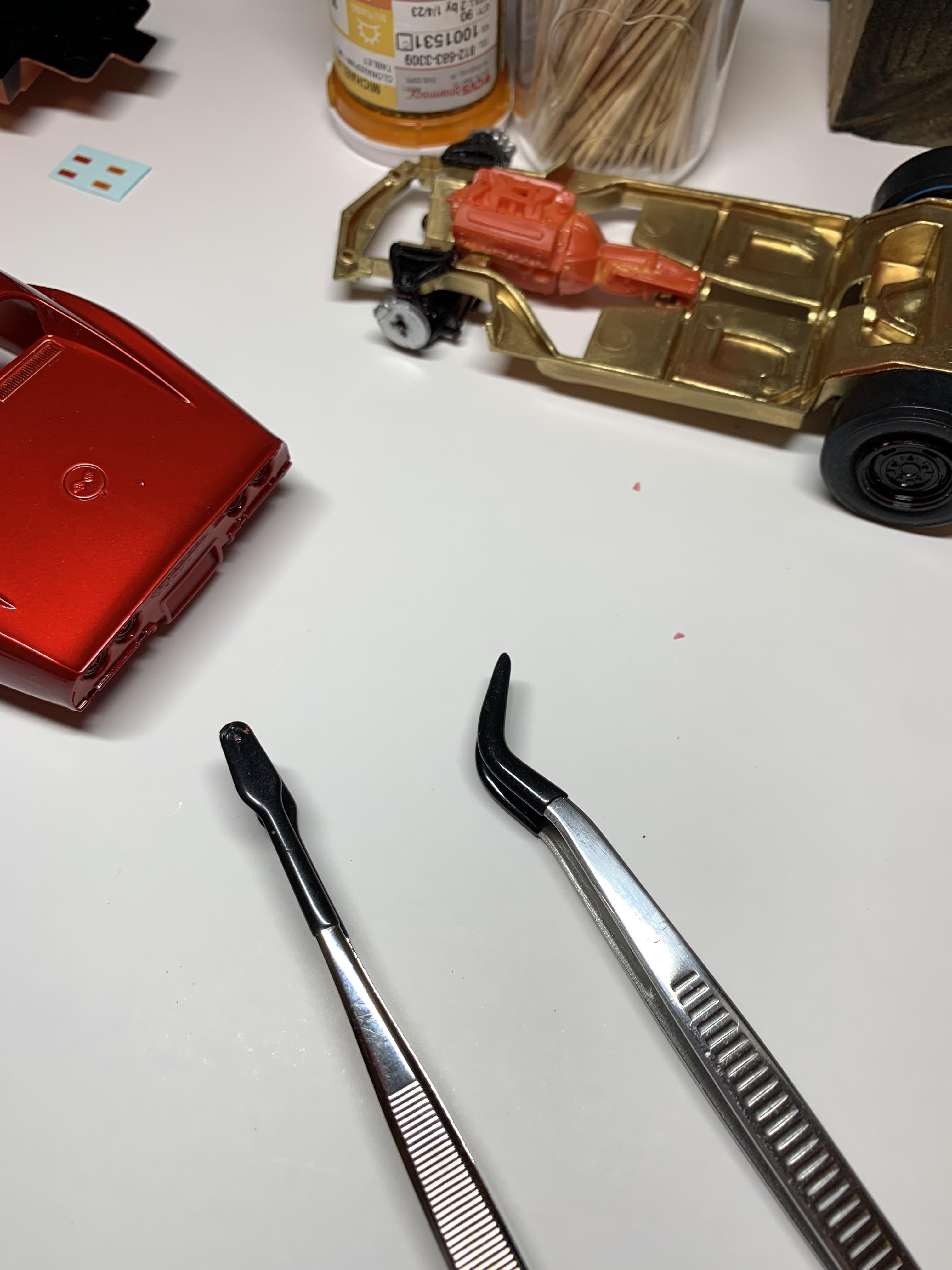

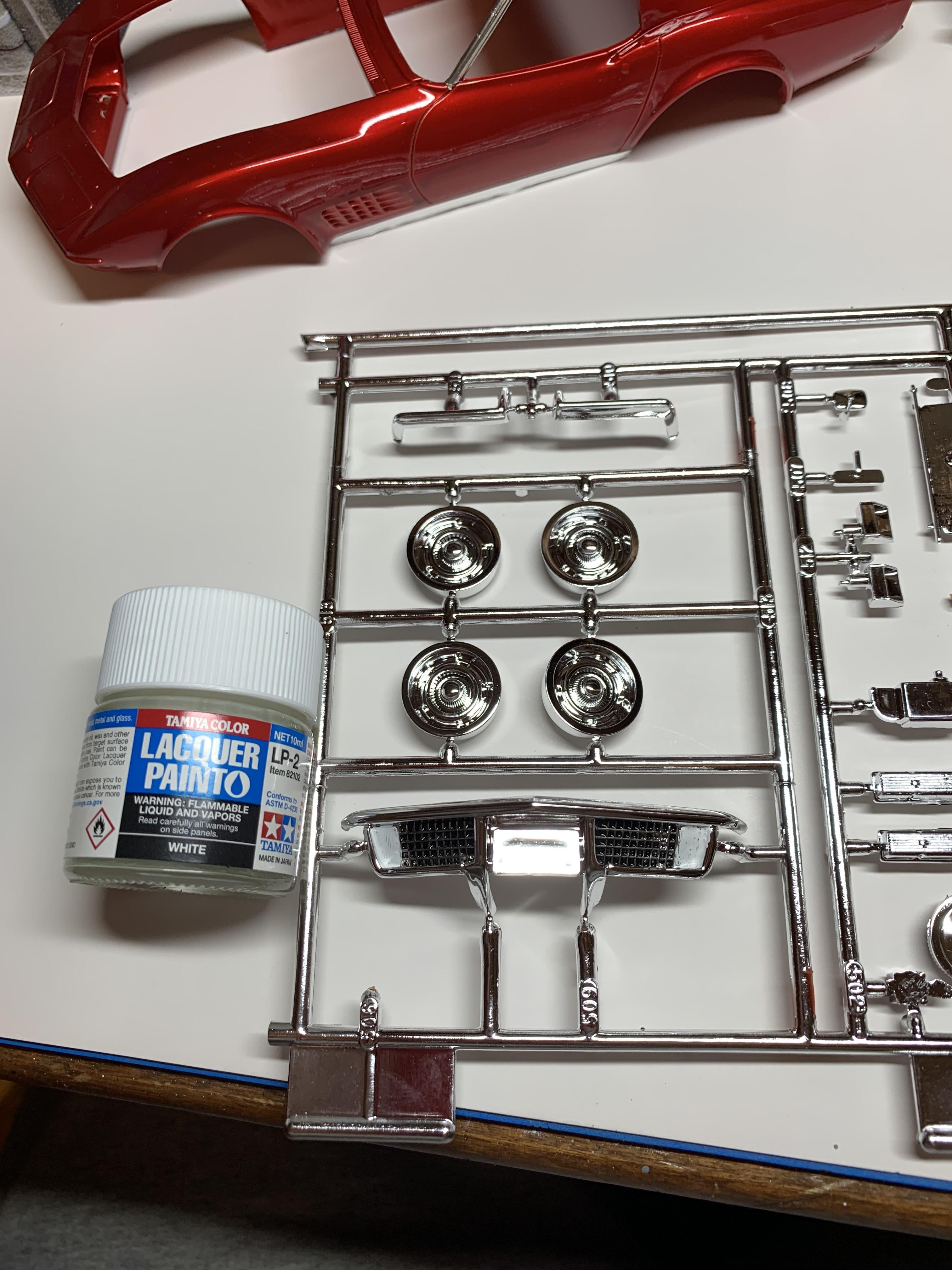

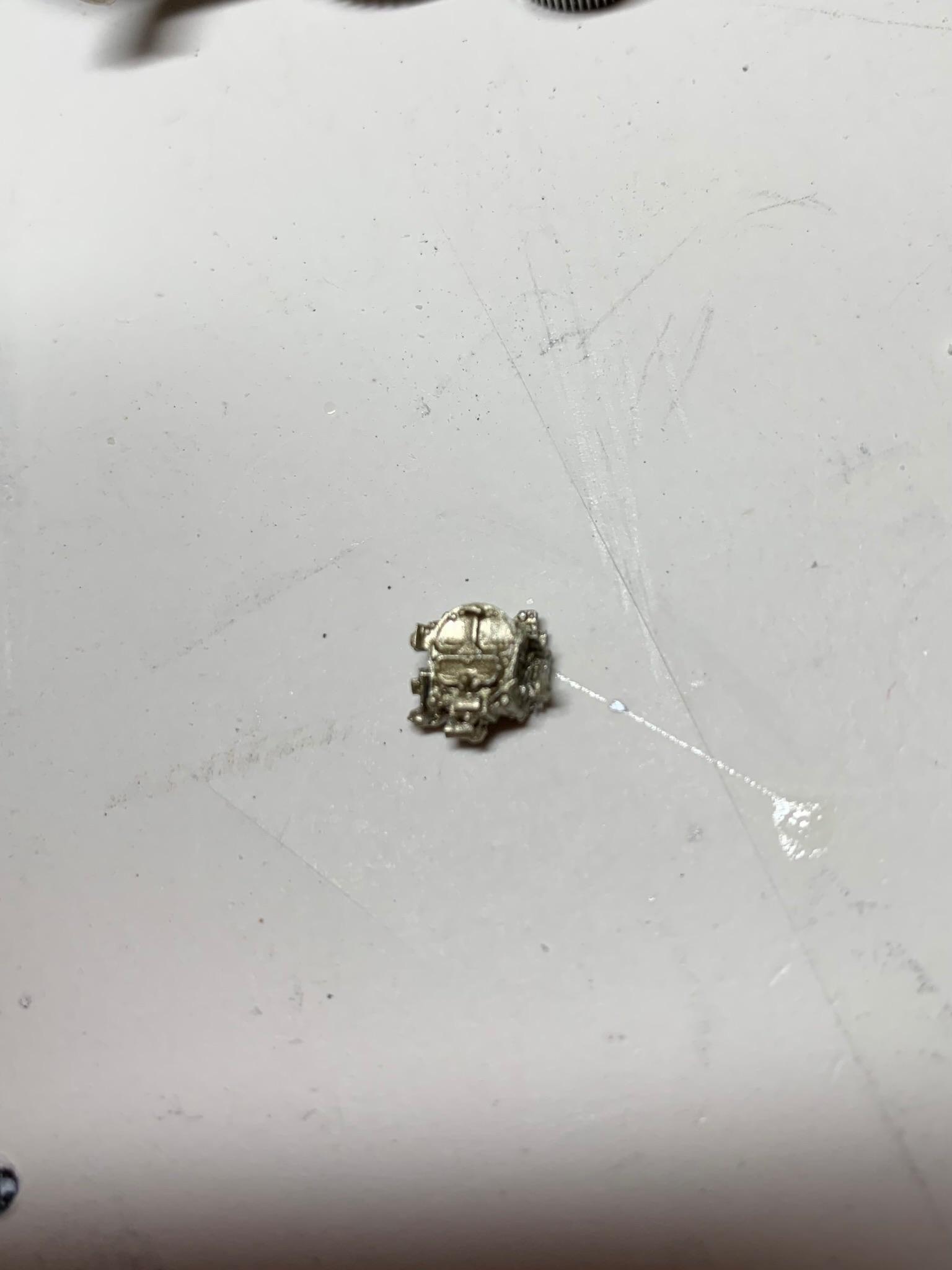

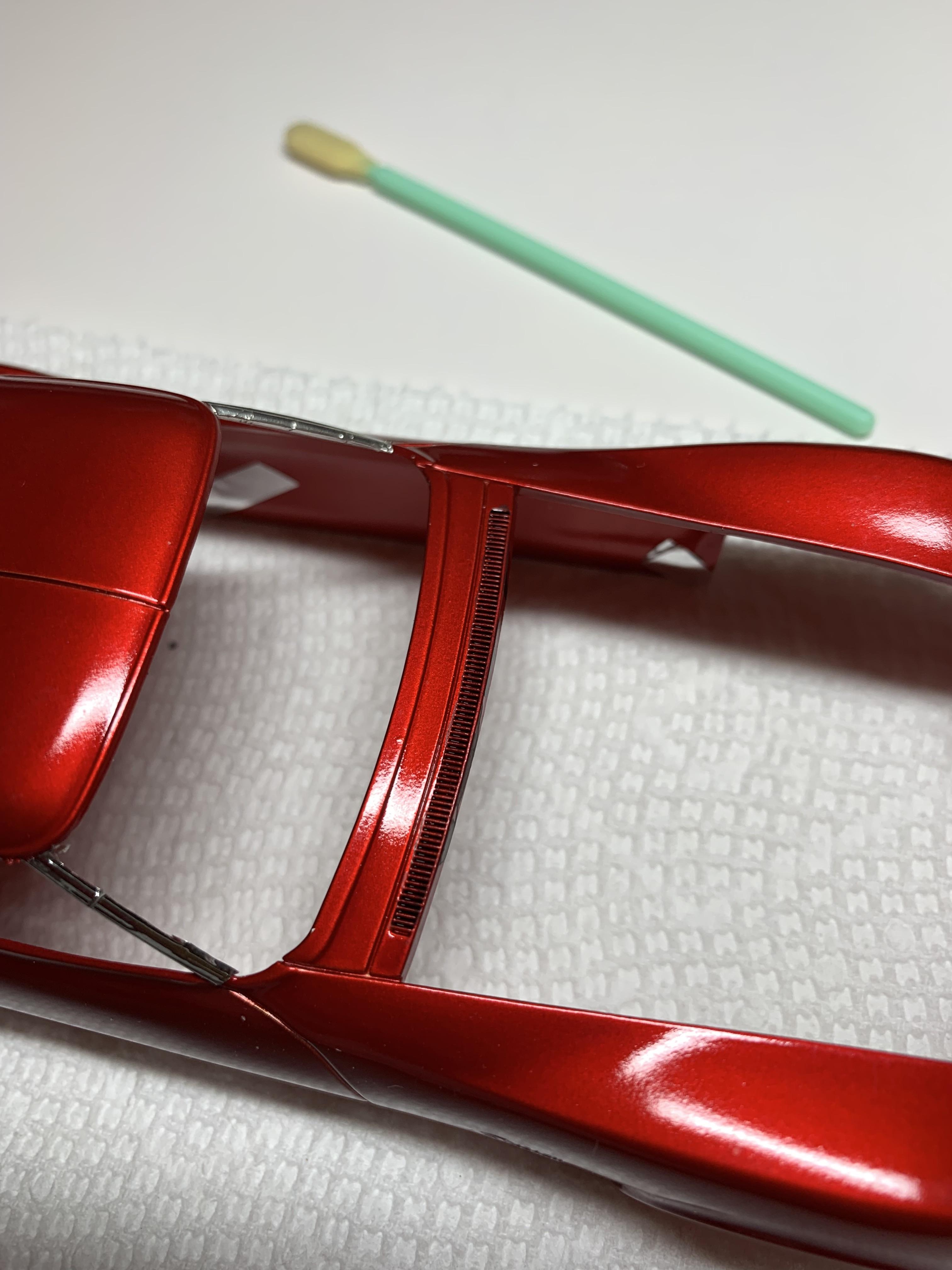

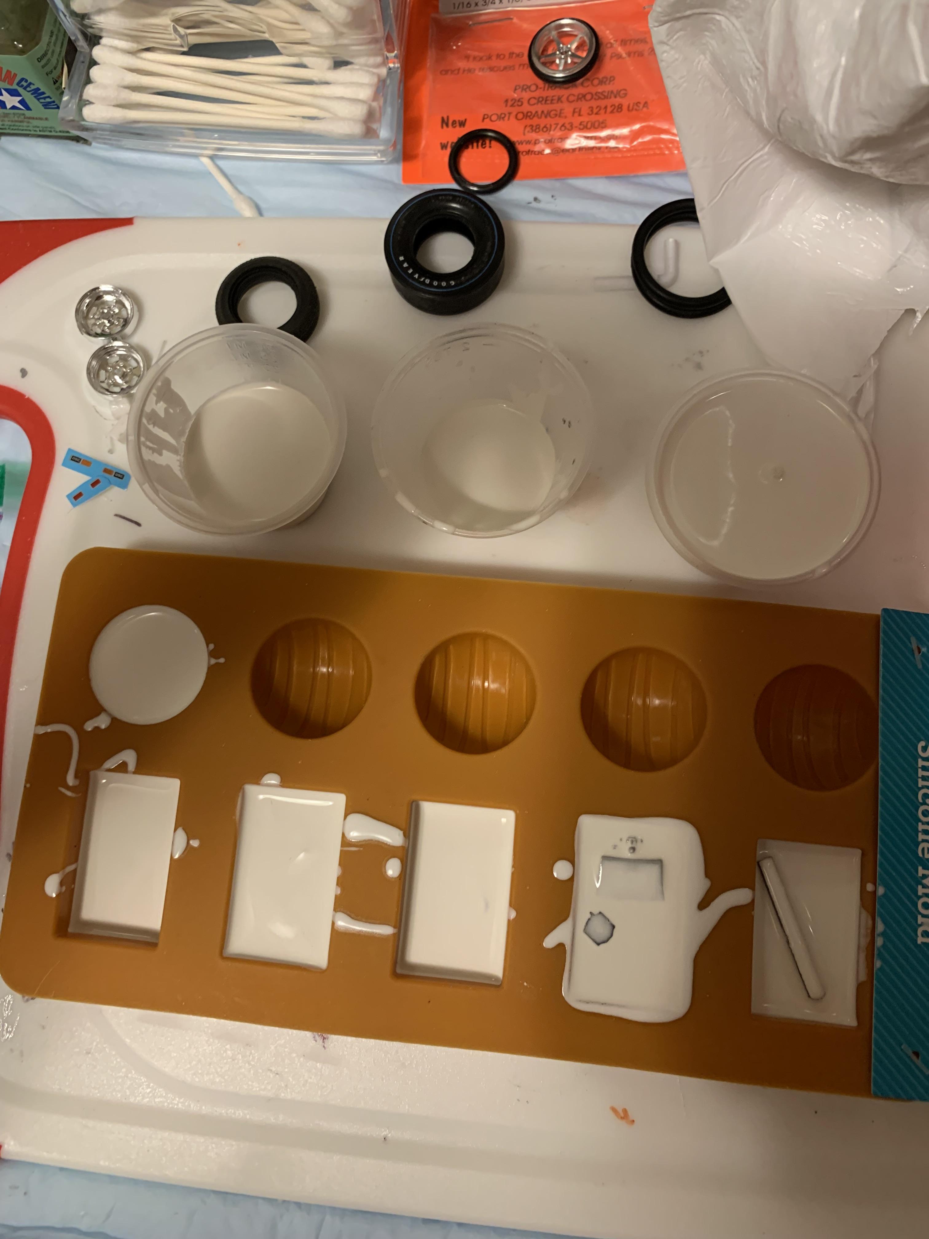

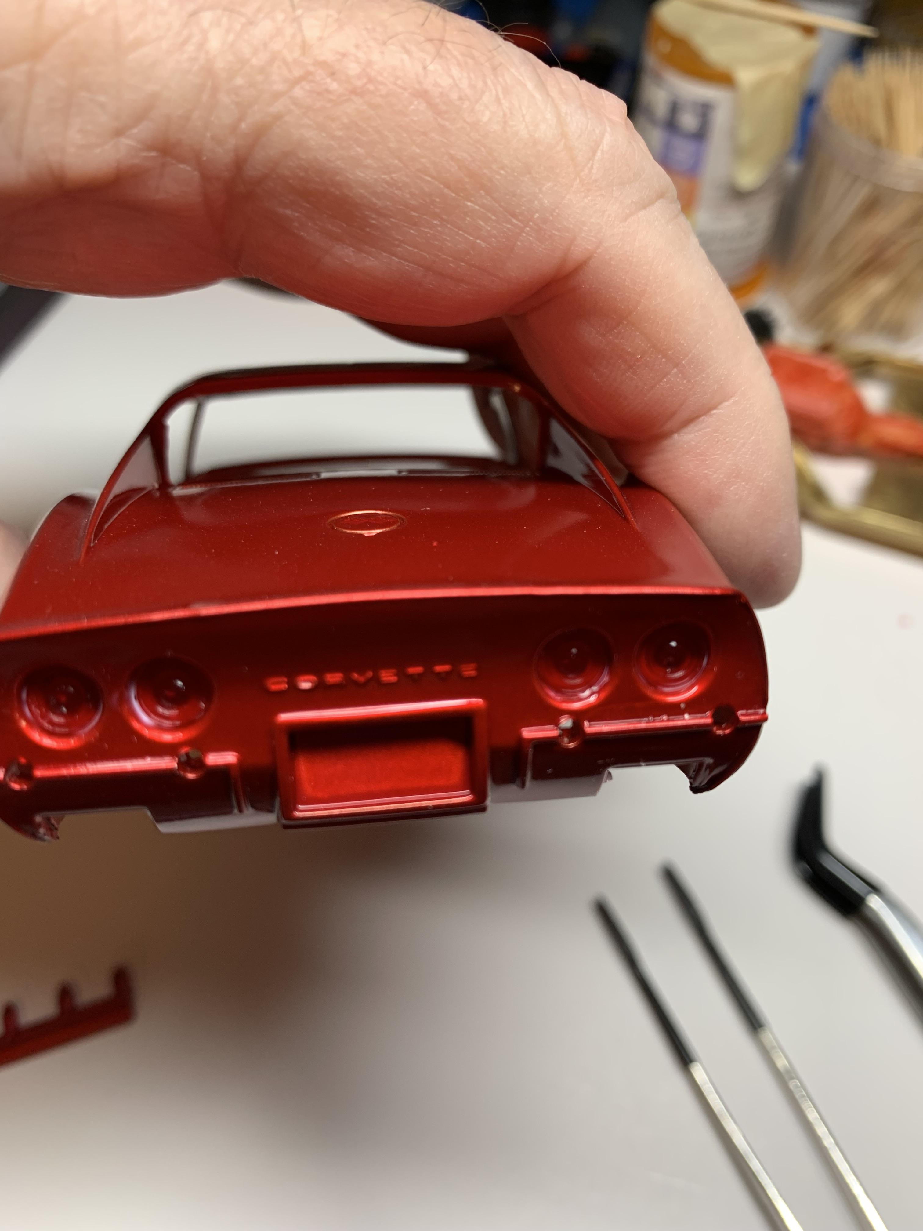

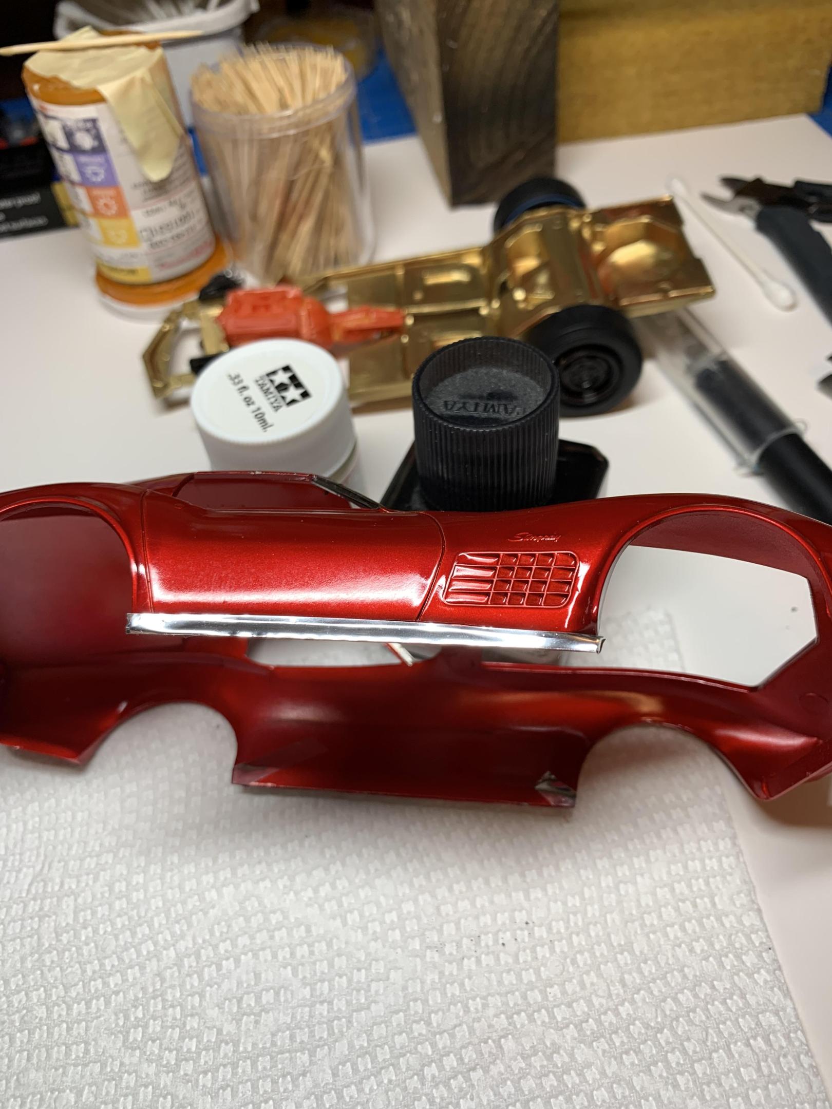

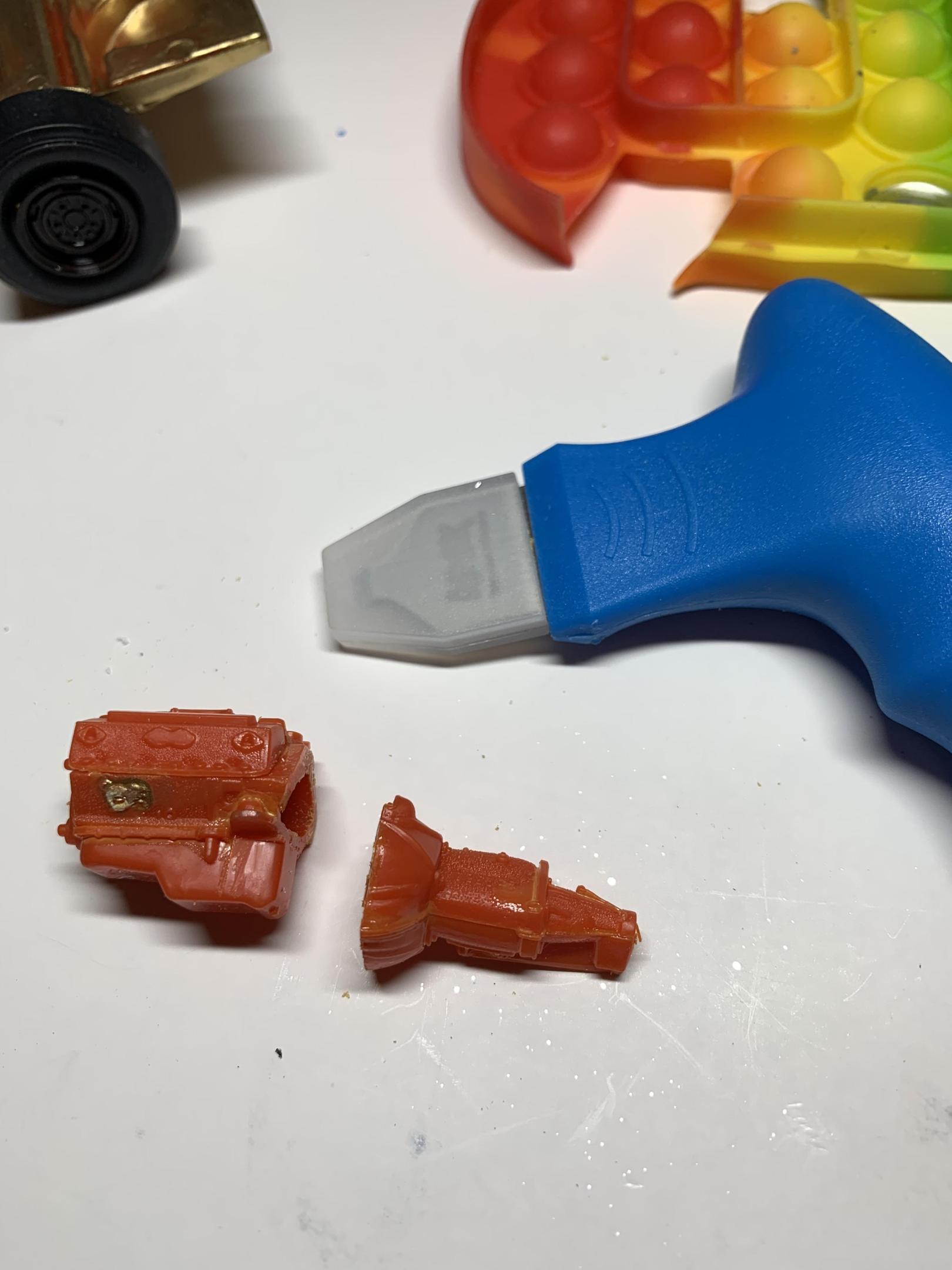

Returned to this build a few weeks ago, just didn’t update on here.  My mold and casting experience was interesting, but not very productive.  The first batch was worthless as the mold did not harden.  I was not totally surprised as this kit was 2 years old.   Ordered some smooth-on and had good results with it.  Anyway, moving on, couldn’t resist posting a couple more pics of this beautiful car.  I put the tailights in and painted the parking lights with some Tamiya white.  I really like these coated tweezers for handling small parts with a good grip.

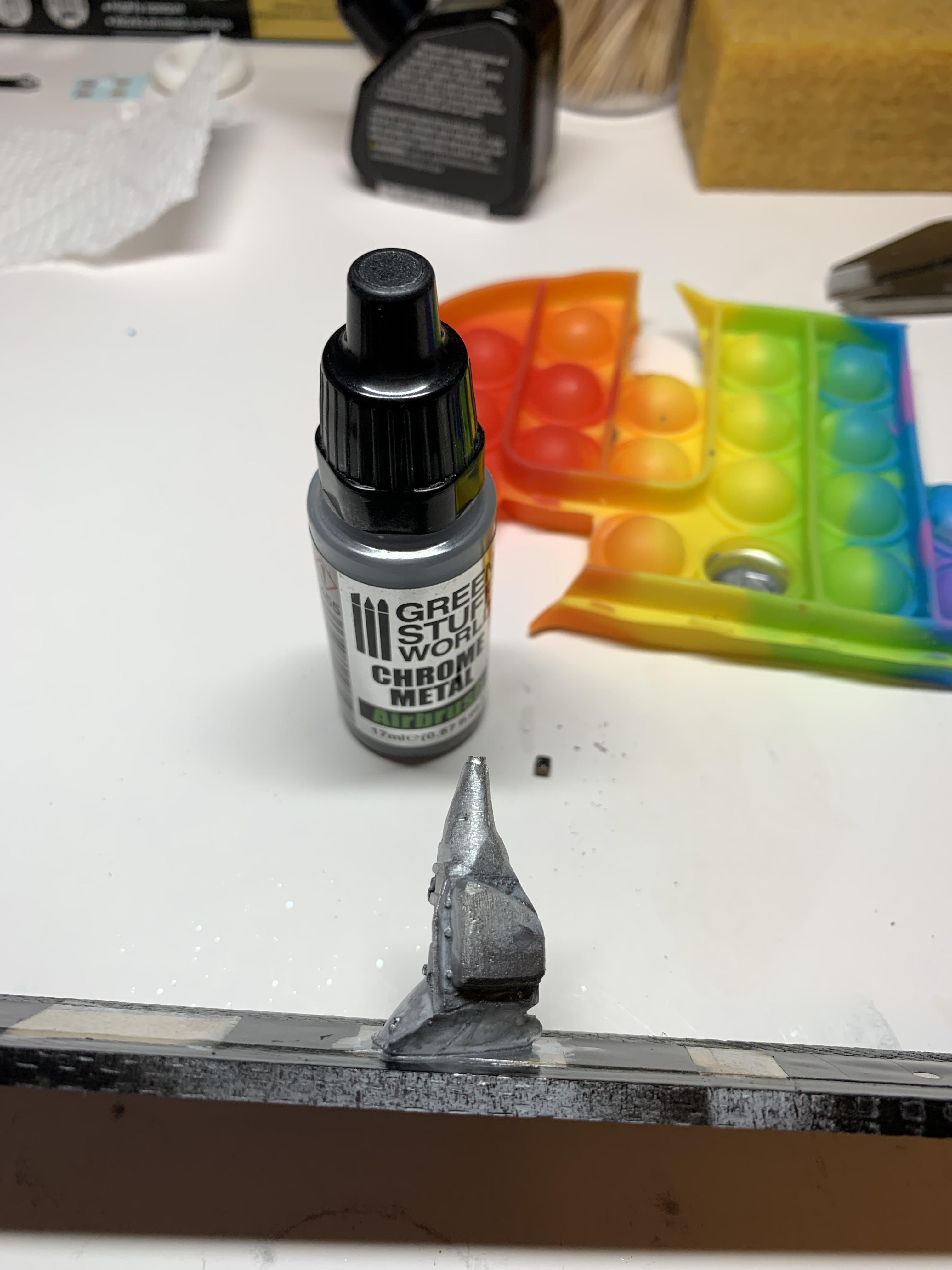

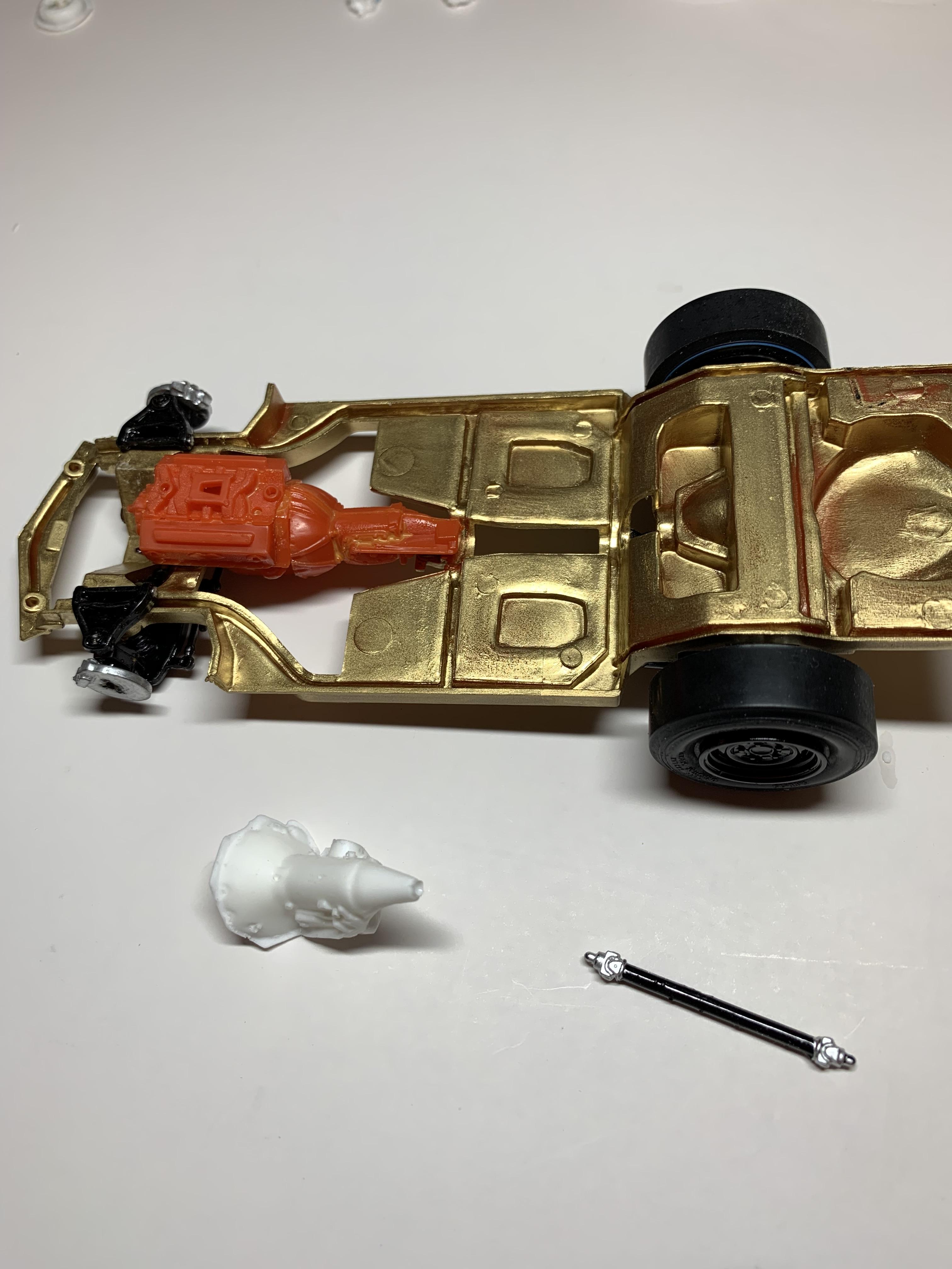

Some wash on the vents, some chrome on the lower molding, cleaned up the cast TH200, shortened the driveshaft, tried some airbrush type GSW on the trans, didn’t like it, tried something else later.

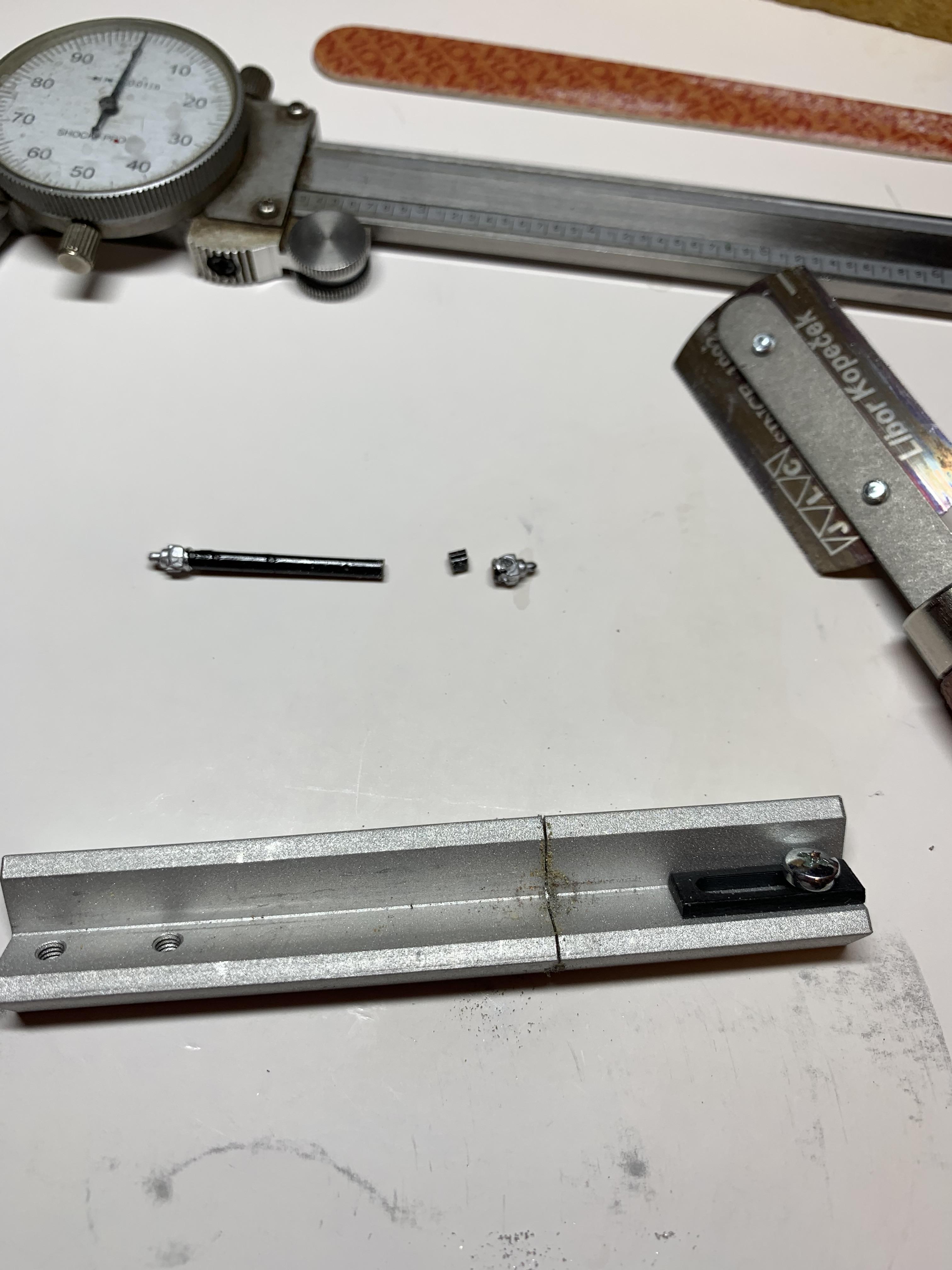

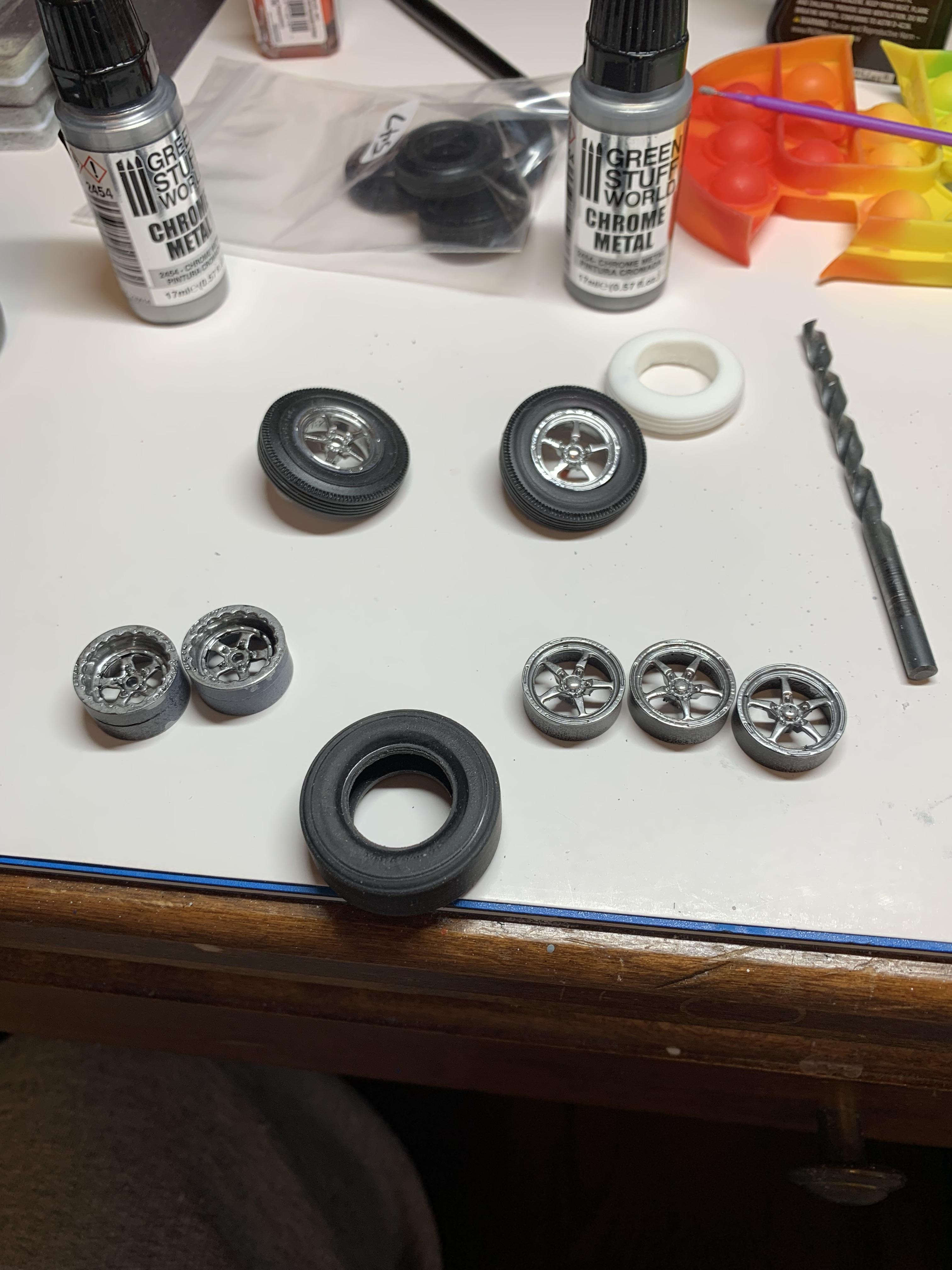

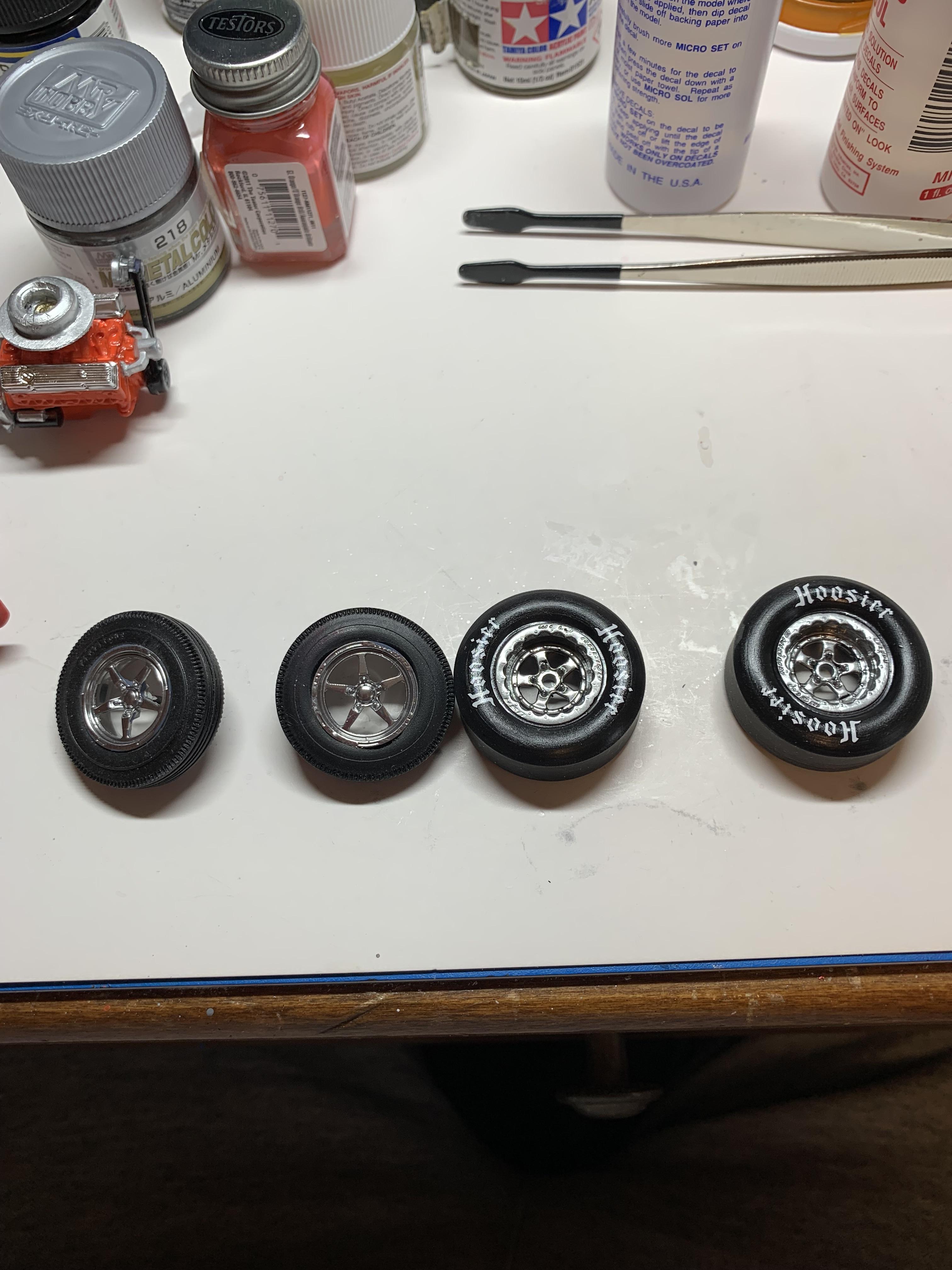

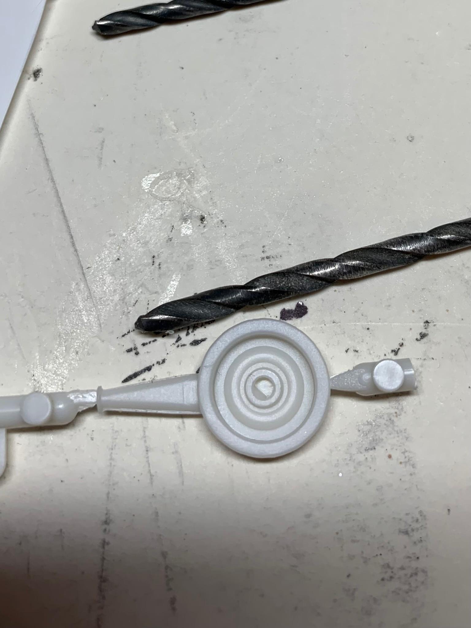

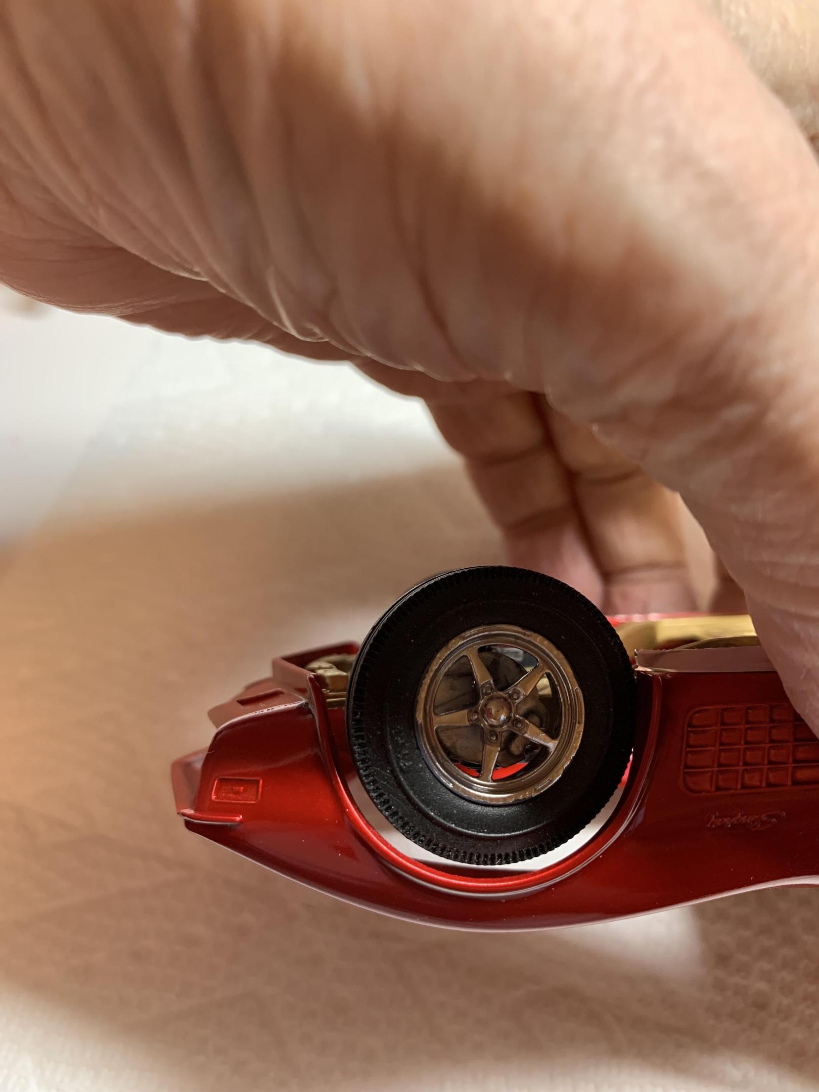

Thanks for your kind words of encouragement and of course I will post the finished build (I am getting close).   I cut the stick shift trans off daubed some GSW ( not the airbrush type) on the wheels with a microbrush.  Also, increased the i.d. of the front tires to fit the wheels.   I used an expandable rubber freeze plug wrapped with sandpaper.  Also, drilled out in a couple steps, the mounting holes to fit the axle stubs I made up.

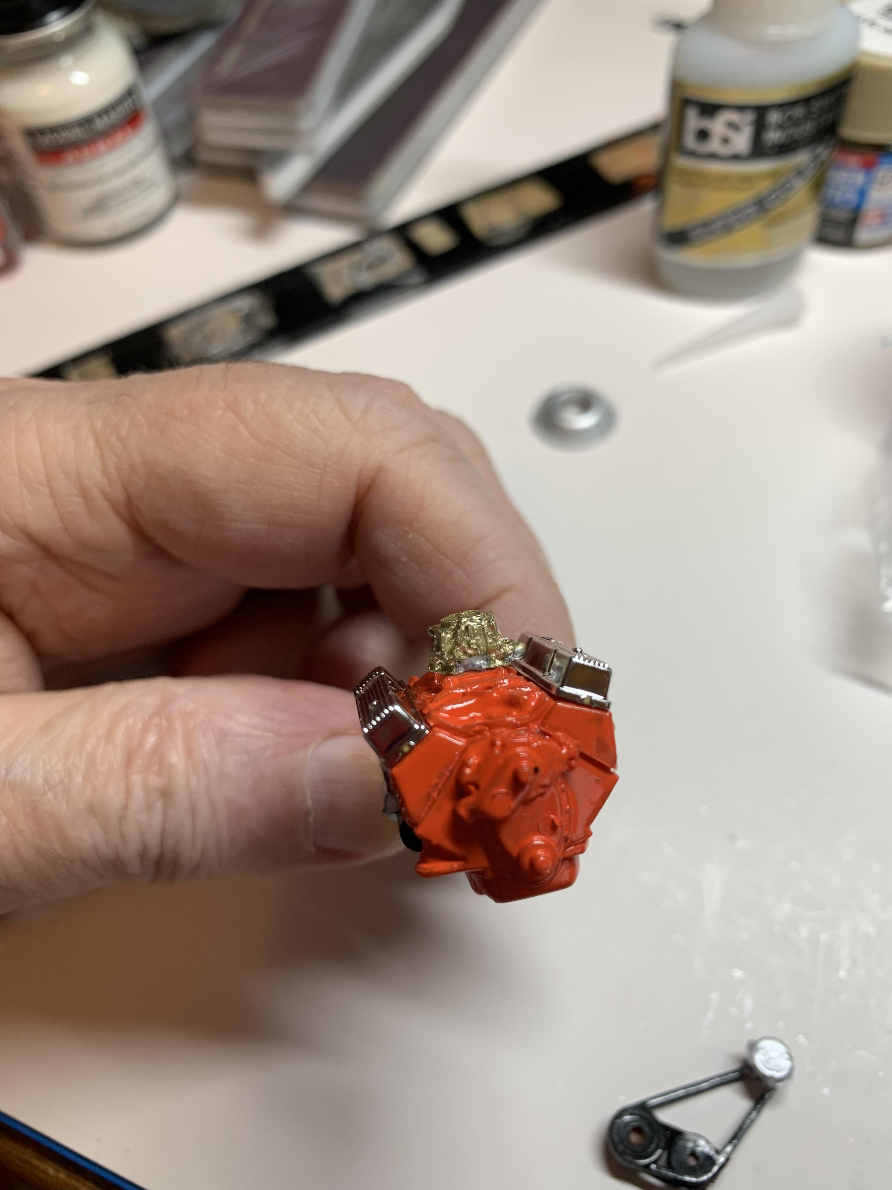

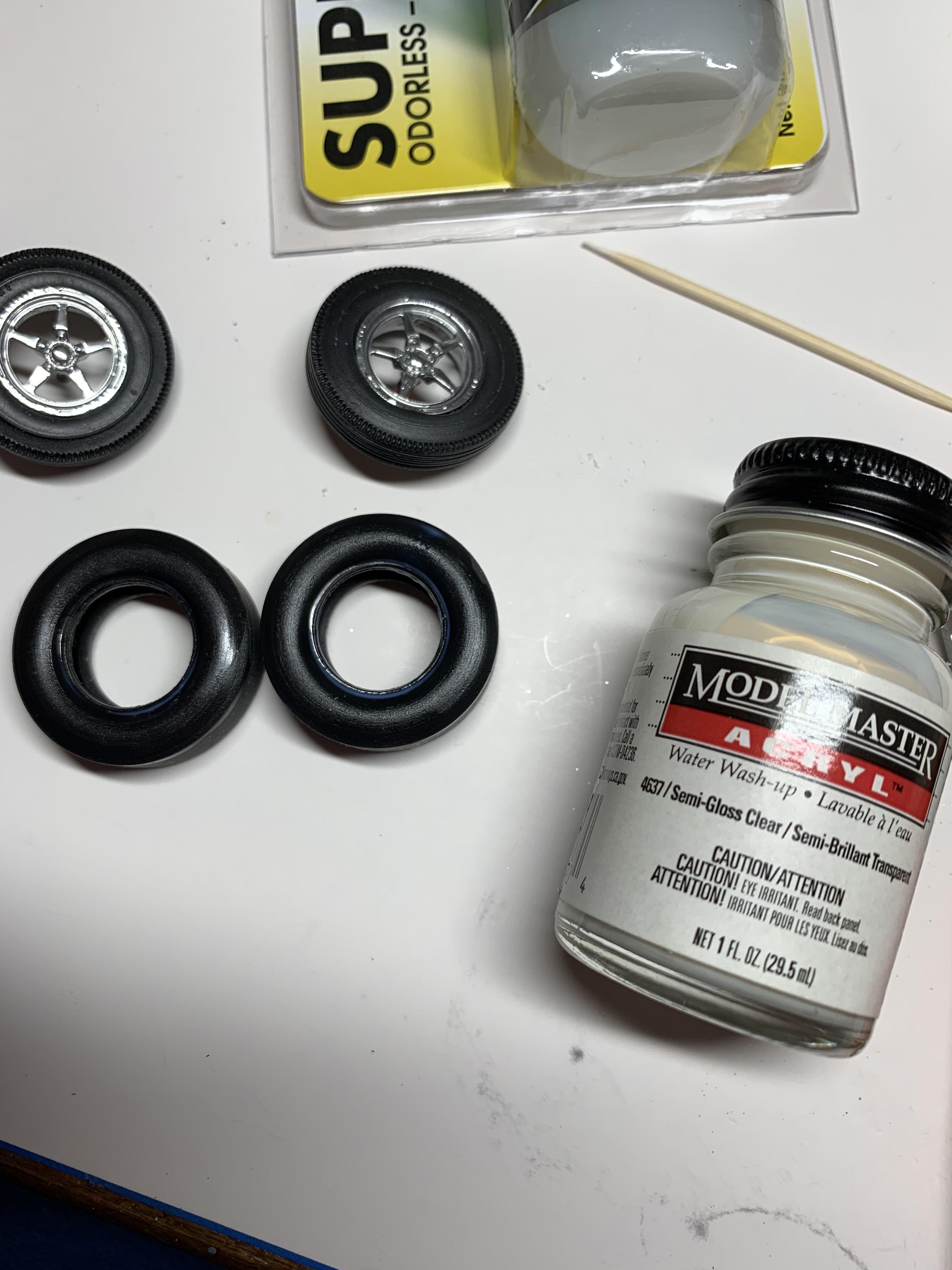

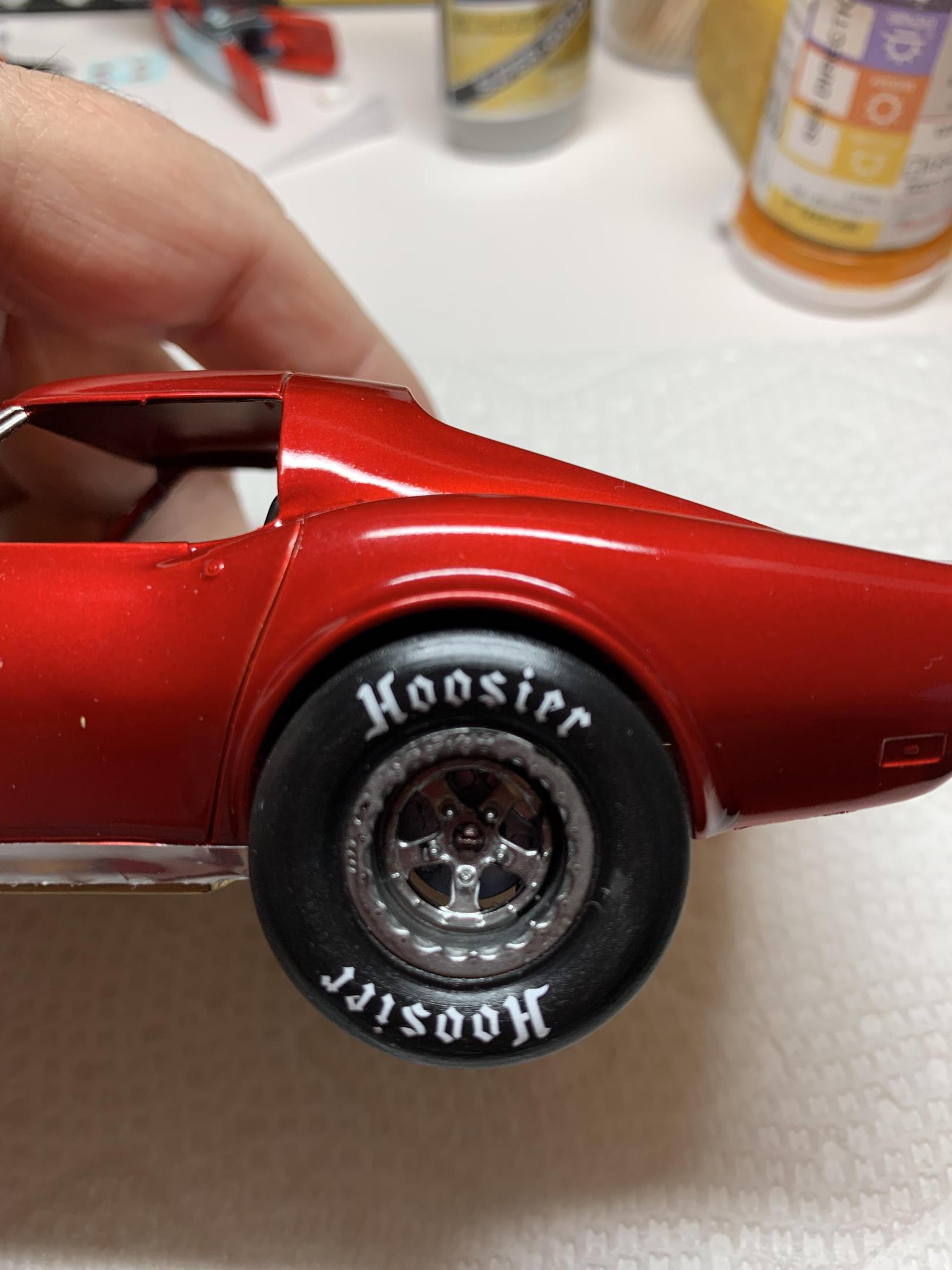

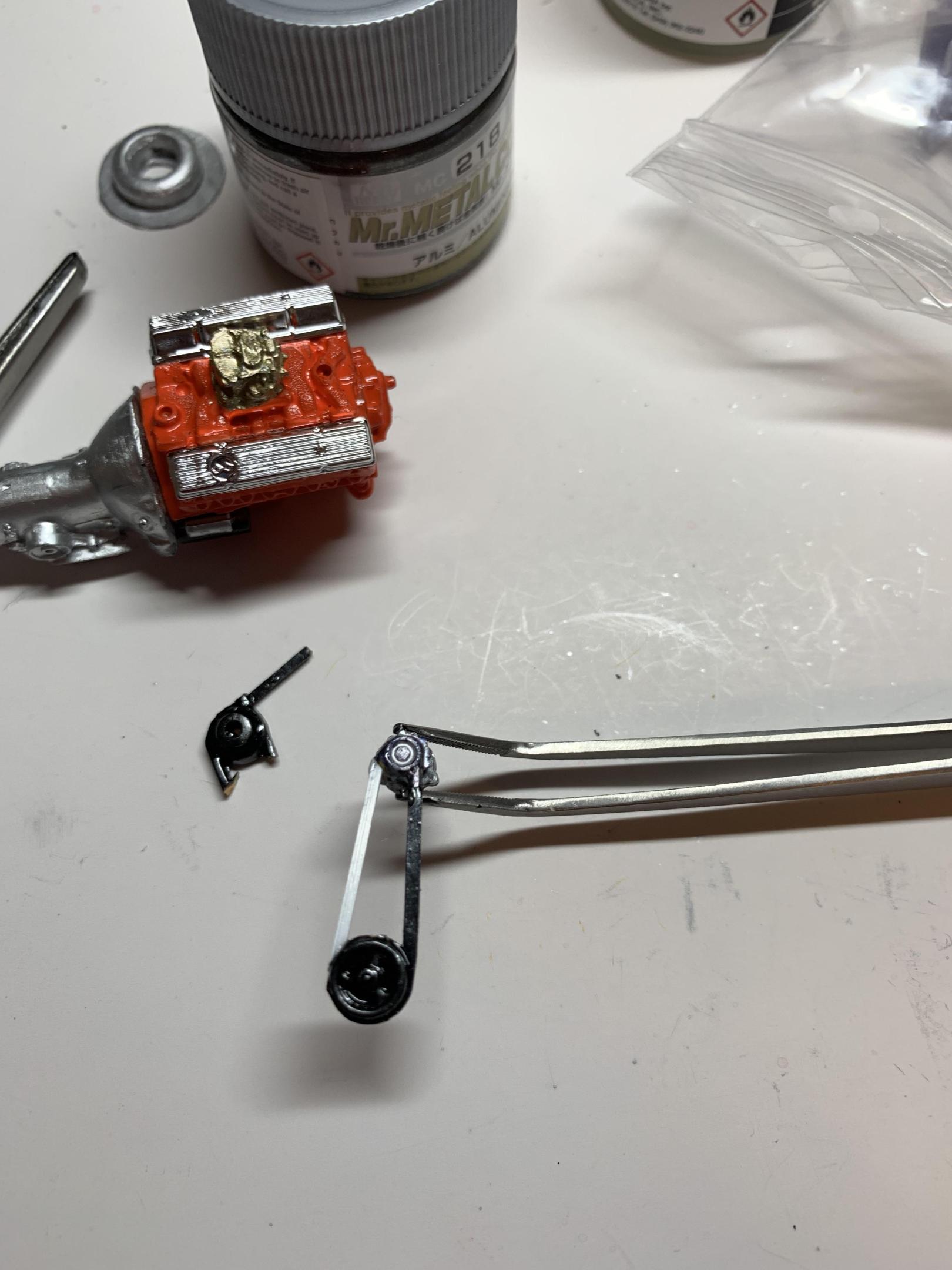

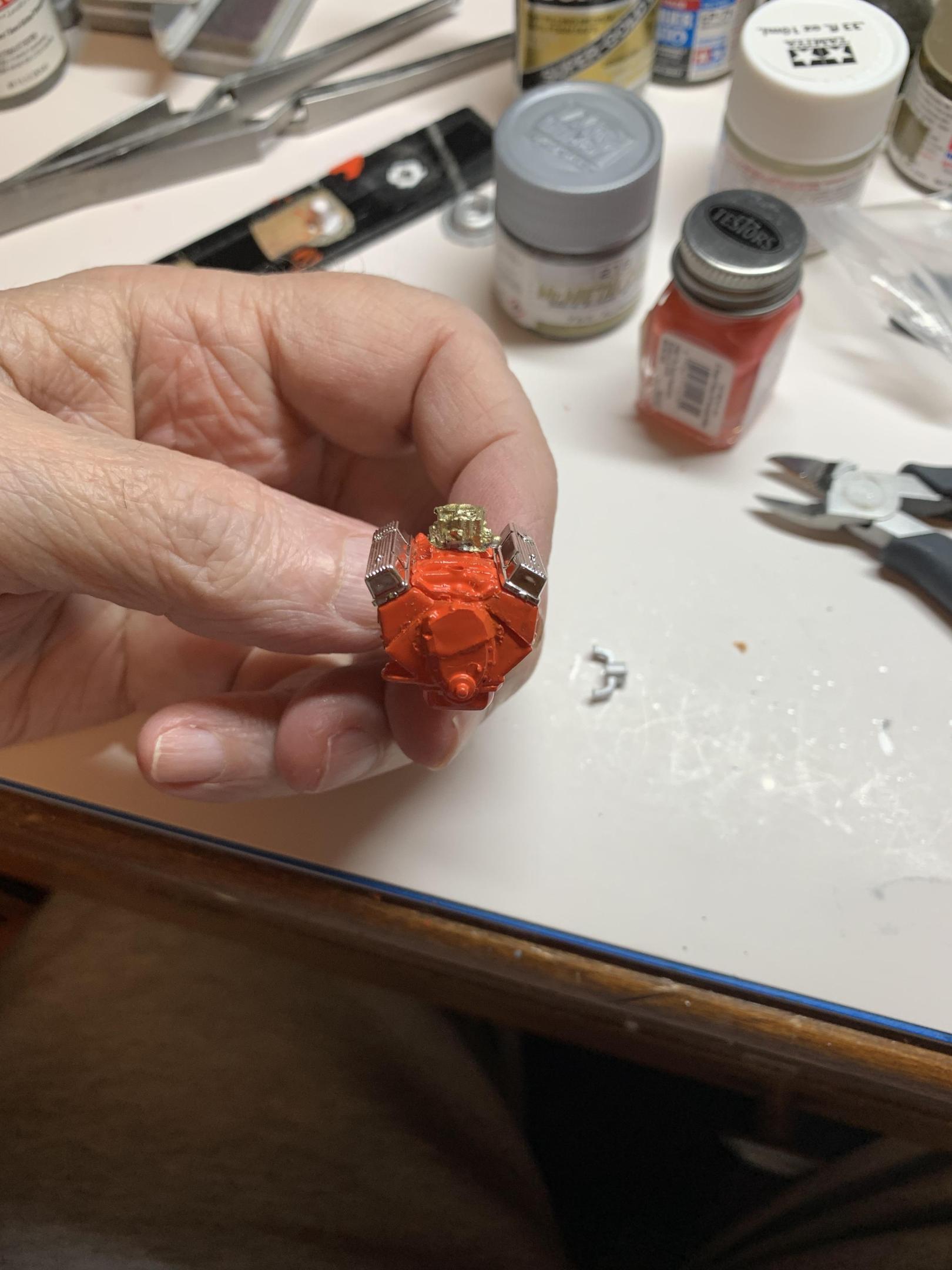

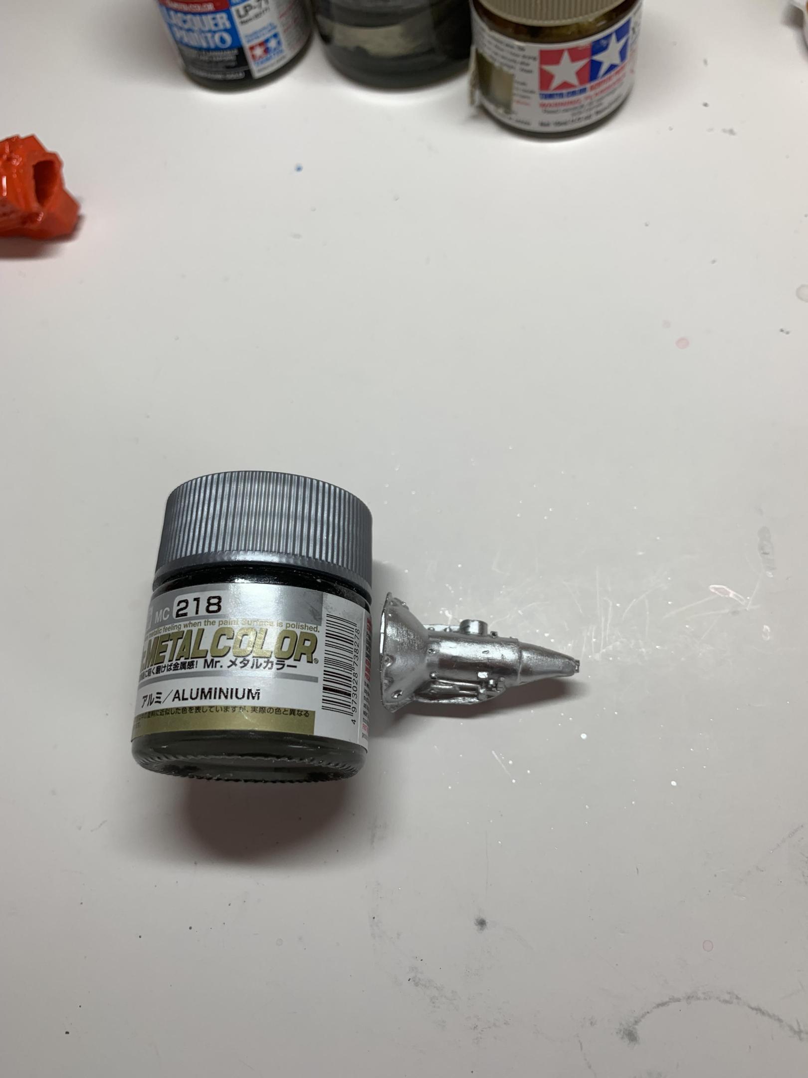

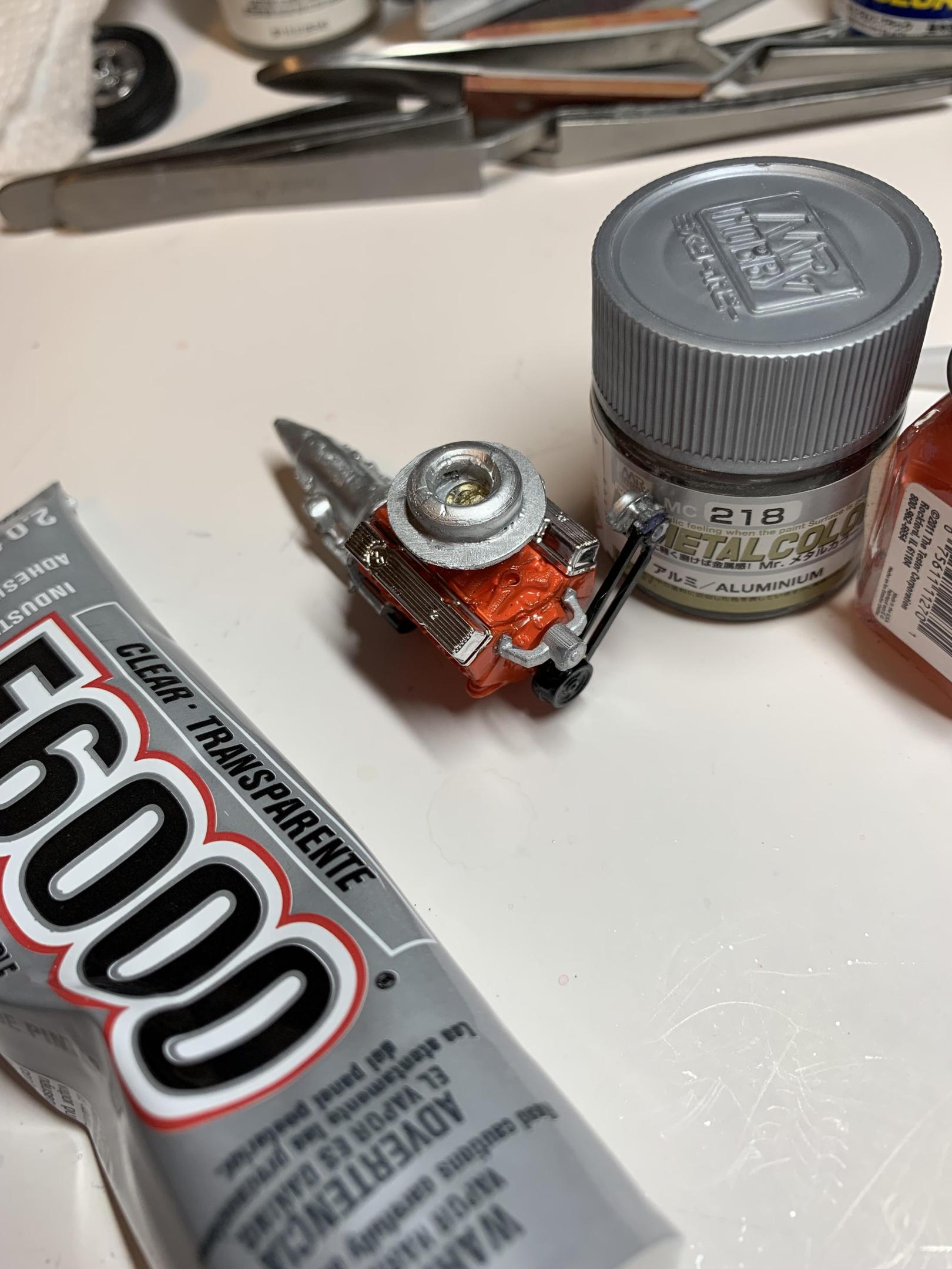

Trying to catch up on the updates.  Some semi gloss clear on the slicks, Mr. Metal aluminum on the trans, alternator, and air cleaner base.  Glued the trans and carb on after some Chevrolet type orange paint on the engine.

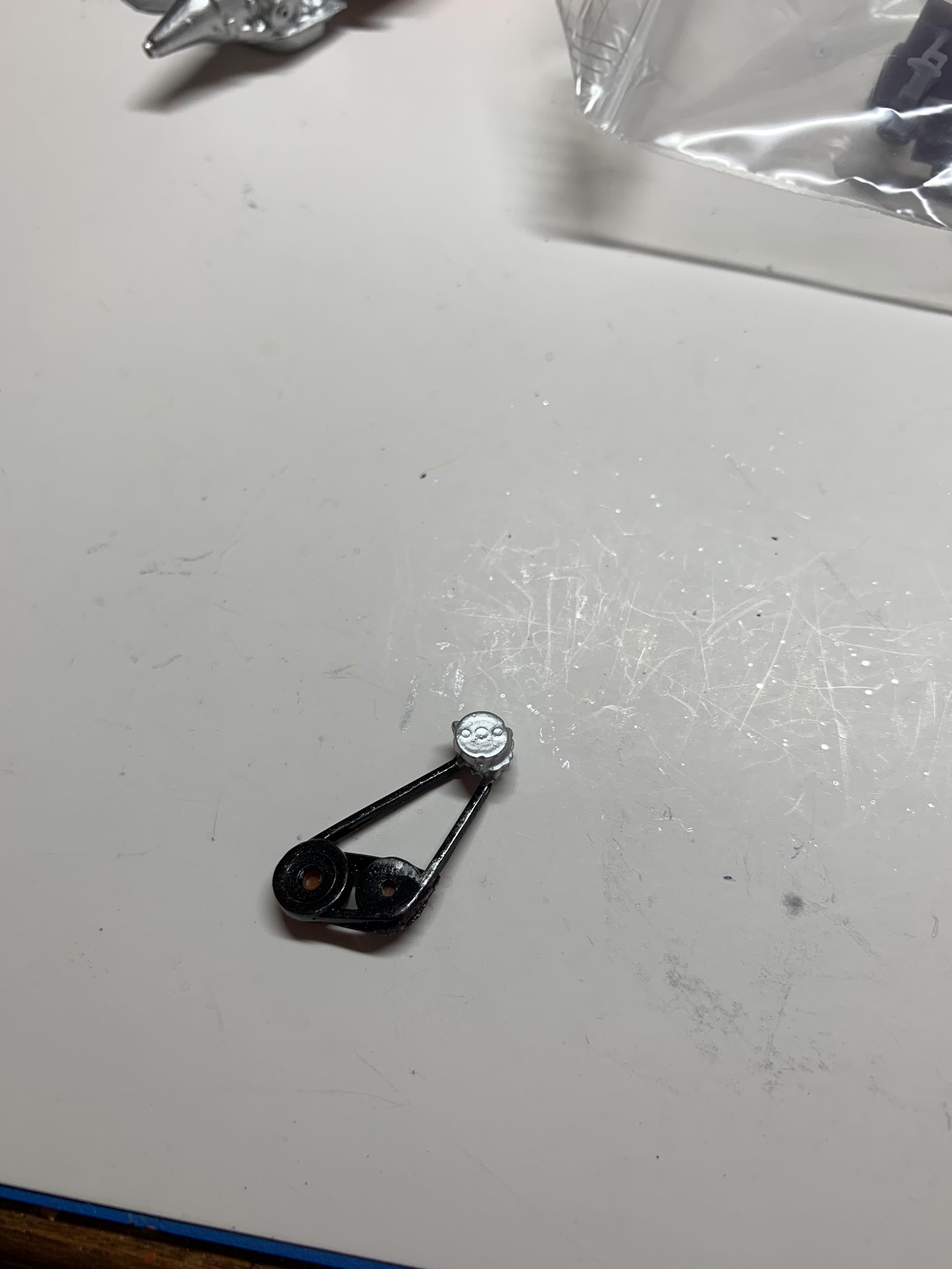

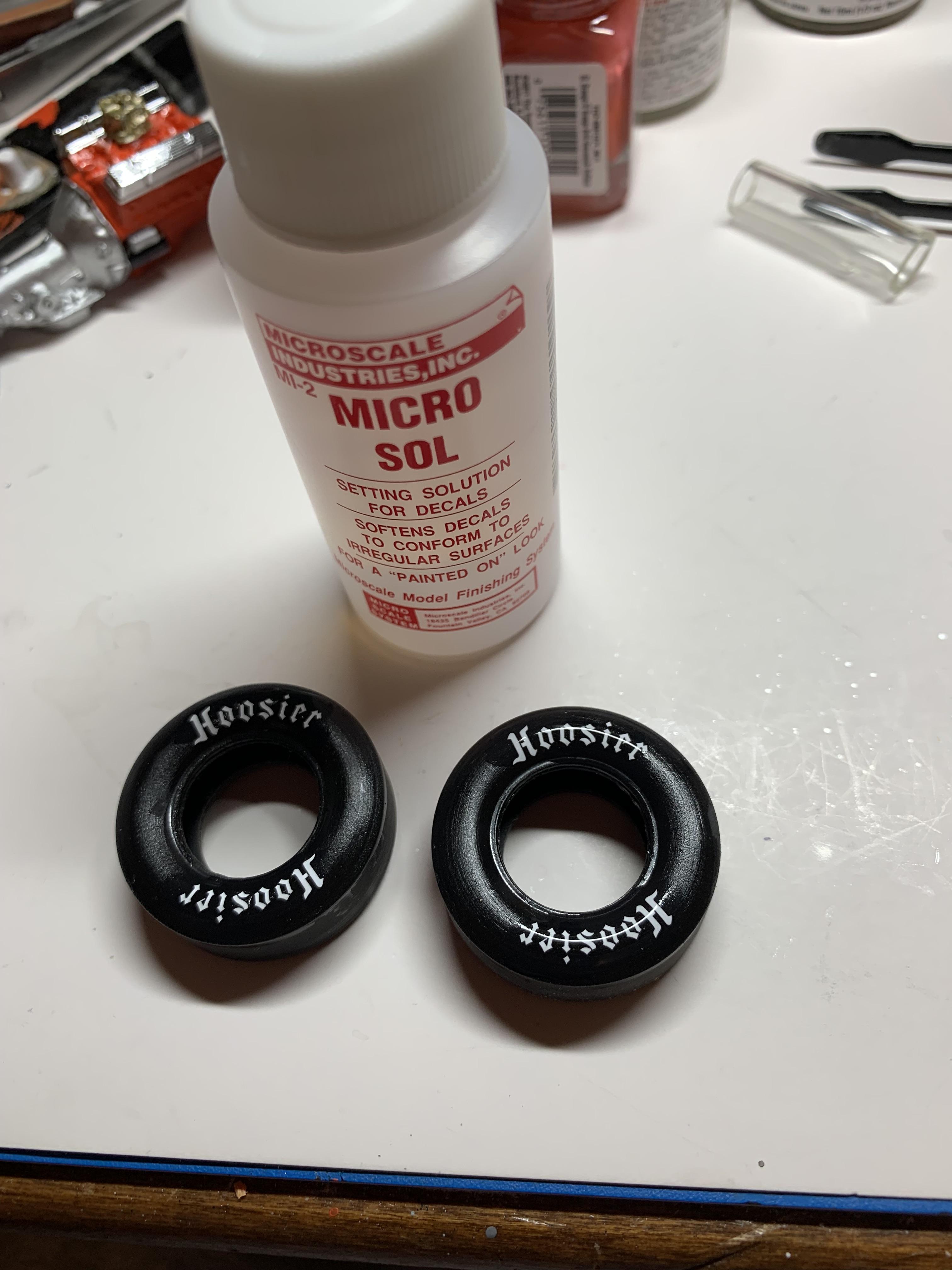

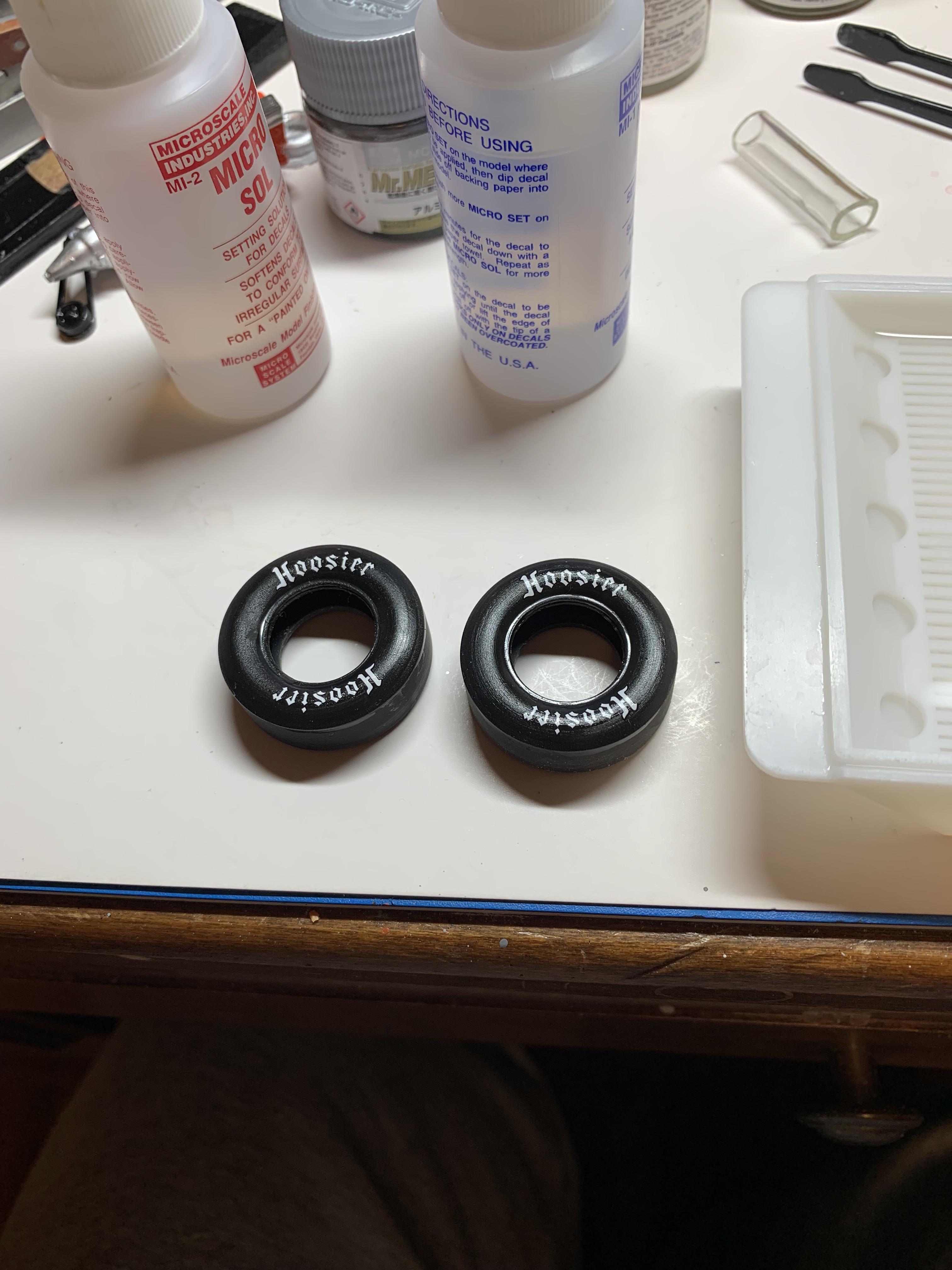

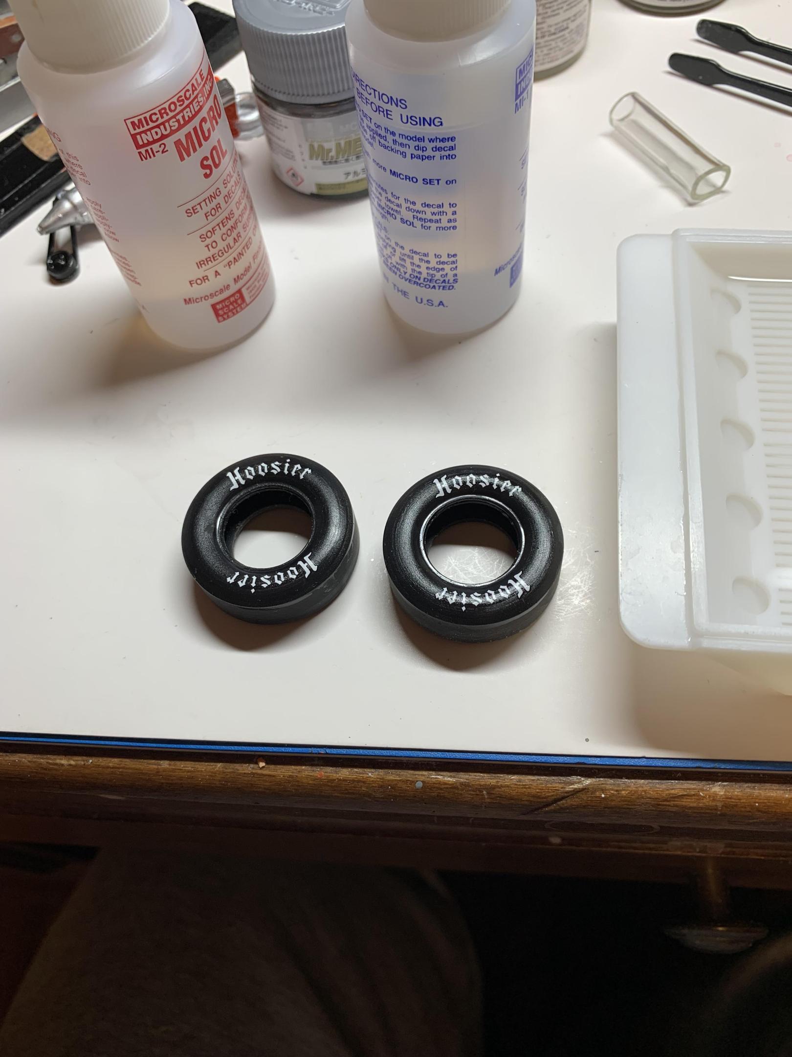

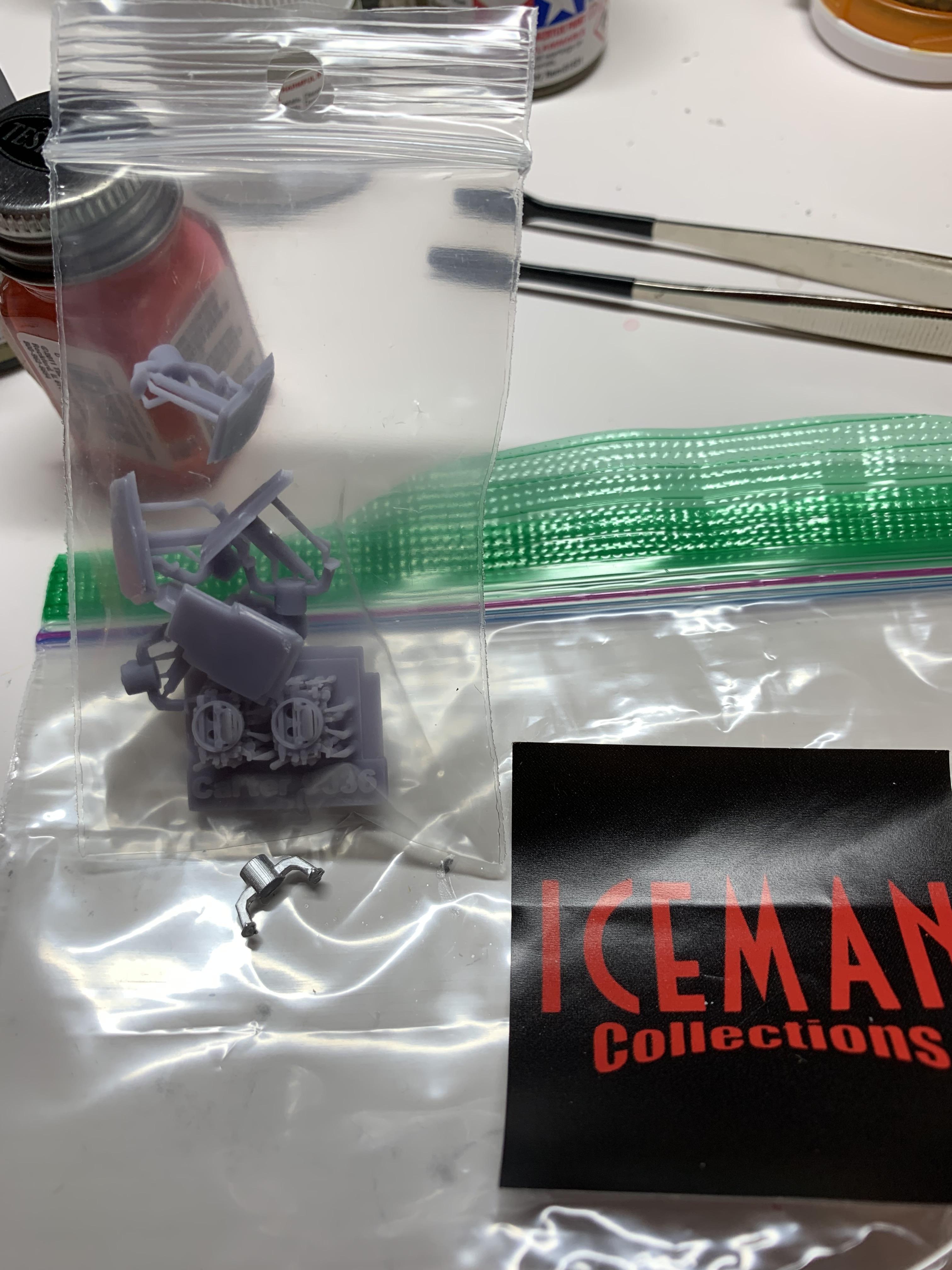

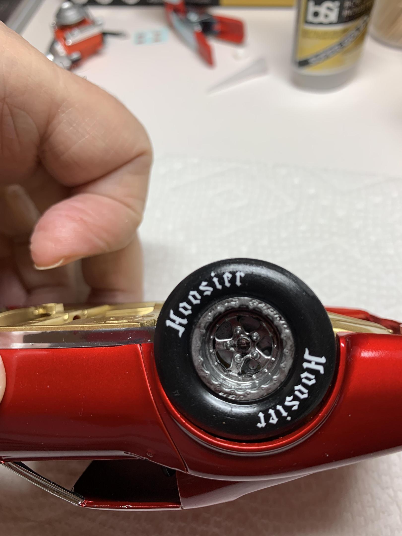

Still another update.  Modified the alternator bracketing as the only bracket is for the alternator.  Also trimmed off the stock water pump in preparation for installation of the electric water pump from Iceman Collections, then some Hoosier tire decals for the slicks only.  Tried out some E6000 glue on the air cleaner base (boy, that mold casting came out pretty rough), and the water pump.   Pictures don’t lie, do they?  Wheels and tires are ready to go on.

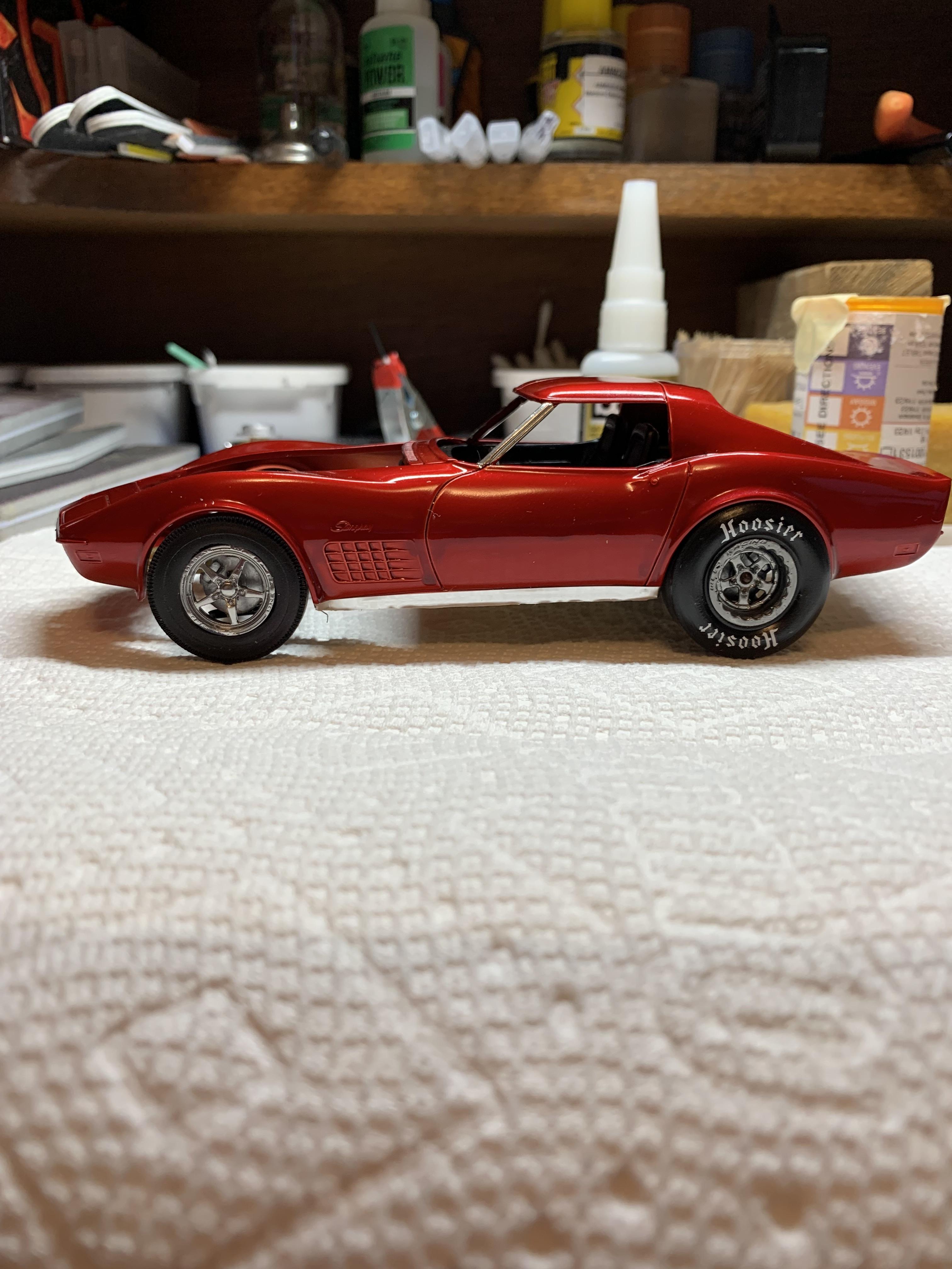

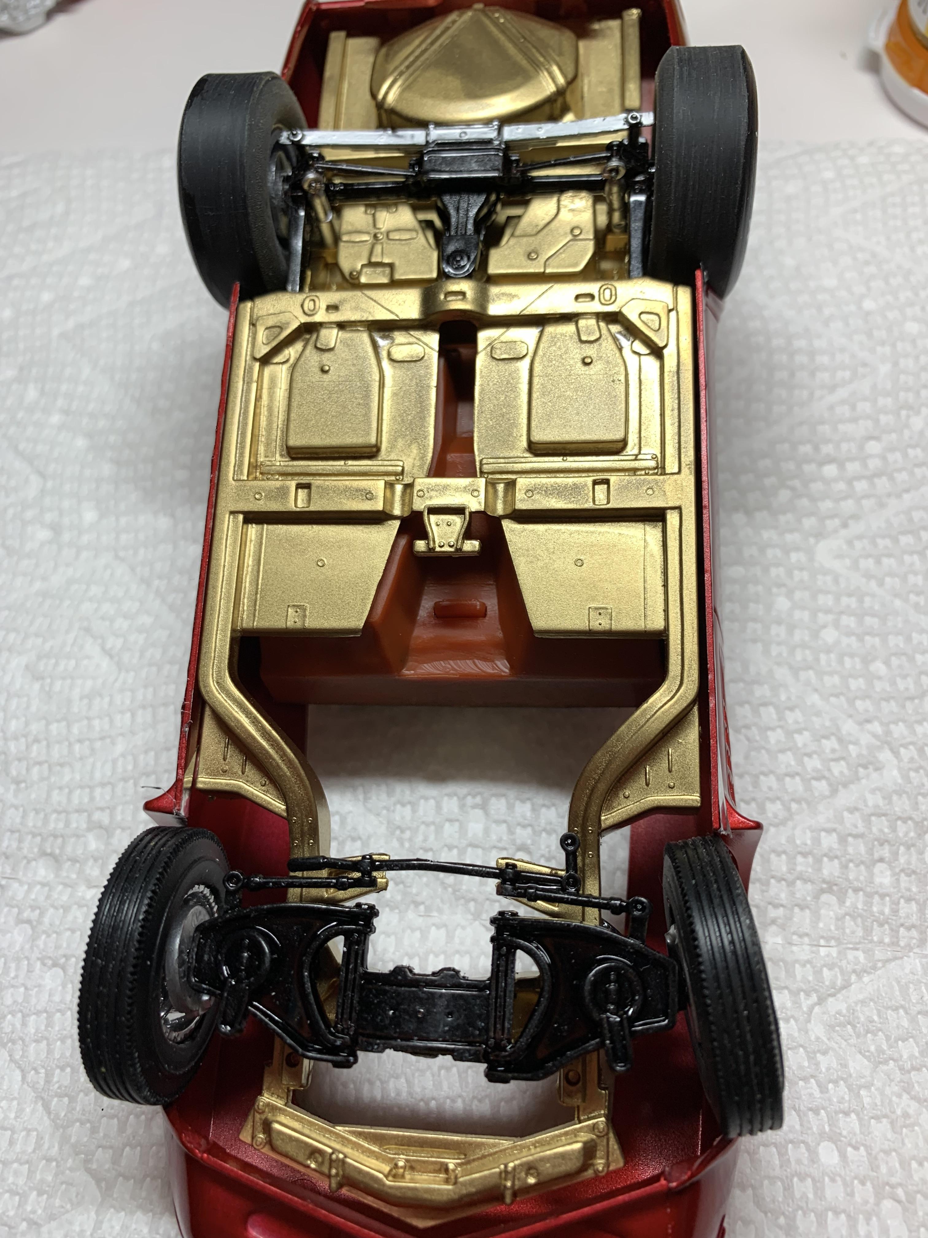

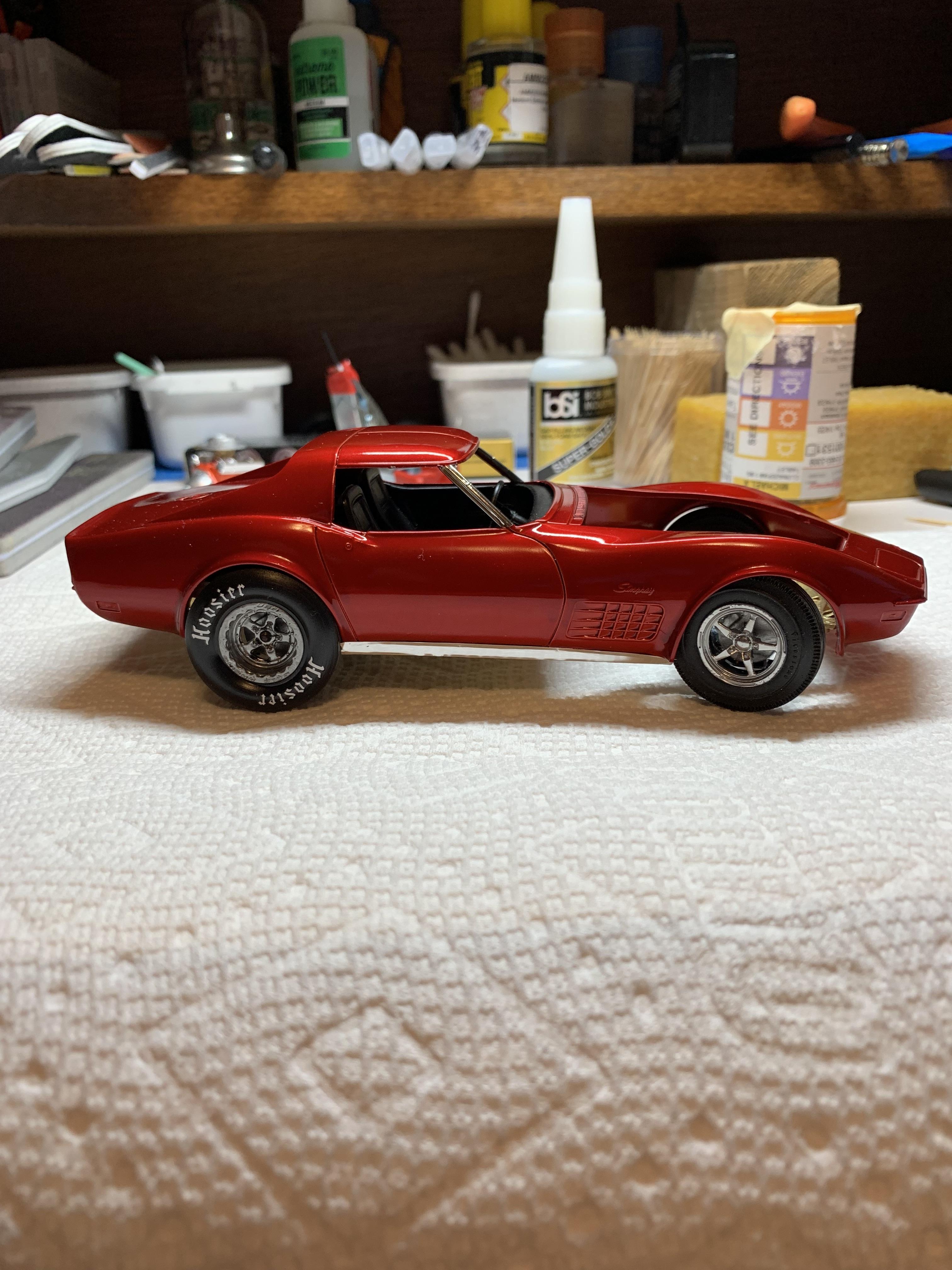

One more.  Installed wheels, first trial fit of chassis on body, has posable front wheels.

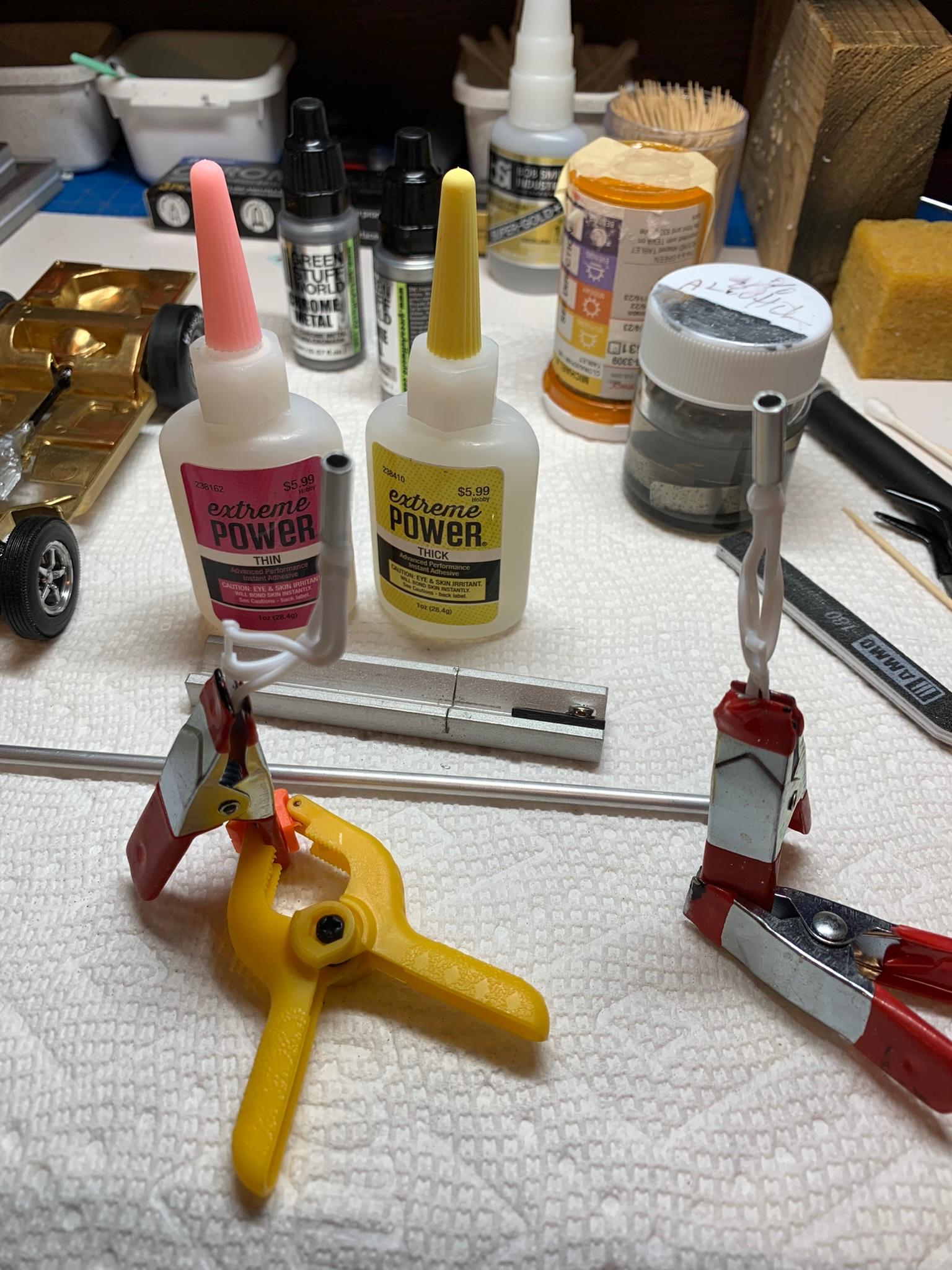

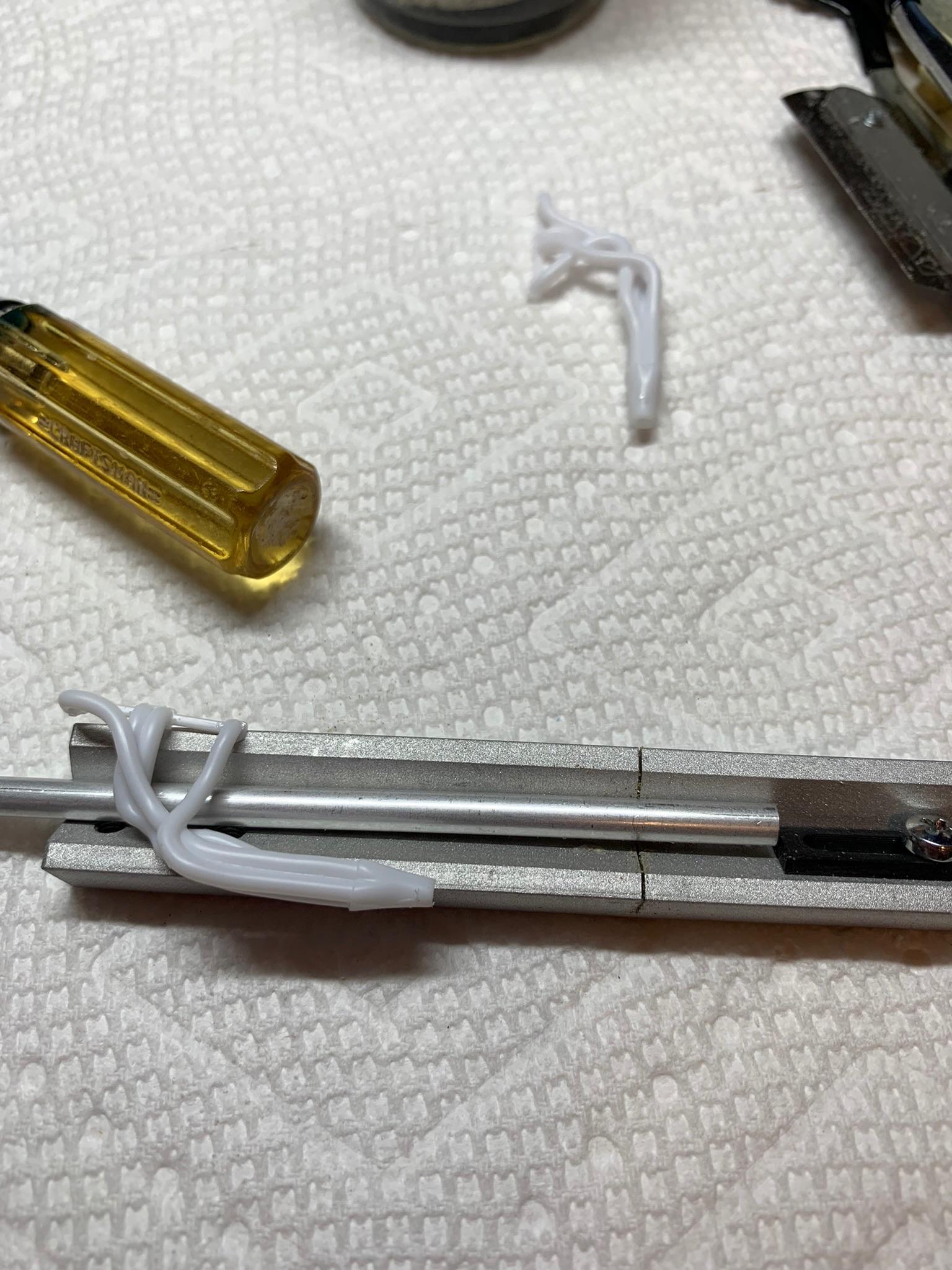

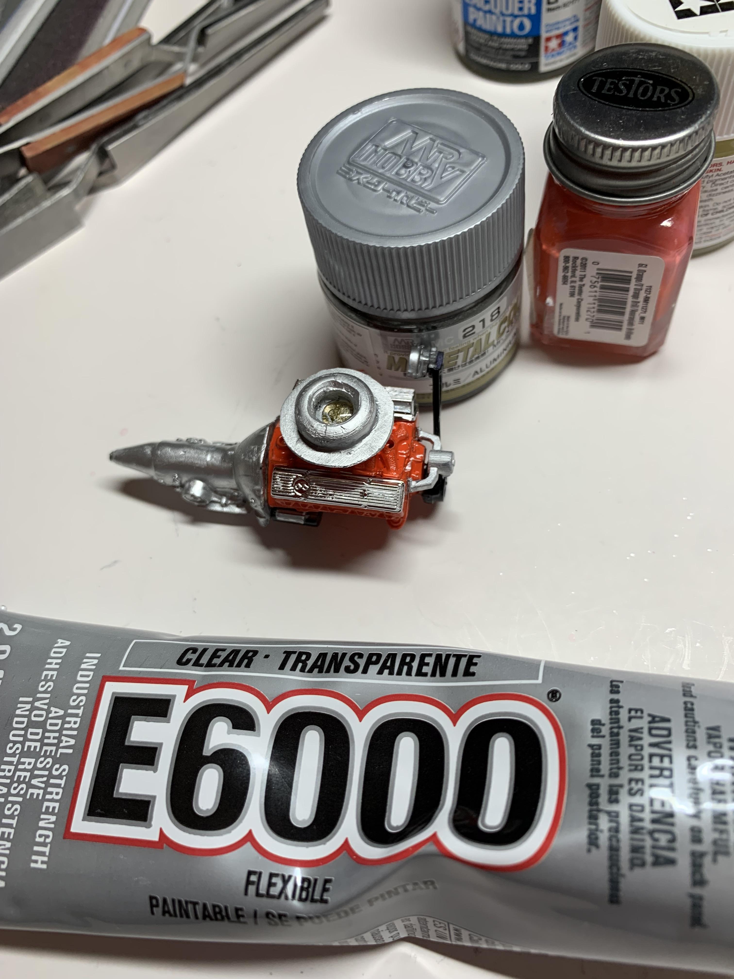

Thanks.  Your quality parts make it easier.  Made some side windows out of .005” clear styrene to put the class numbers on.  Seems like I have to do this on every drag race car I build.  The headers i’m using come in the Camaro and Nova kits.  I have tried making 2 part molds for them with very little success.  Real race car tuned equal length headers are difficult to find except in NASCAR kits which rarely fit standard chassis cars.  Temporarily installed the engine with some e6000 to check for header fit and made some header collectors from aluminum tubing.  Put some “welds” on with thick ca glue.
Edited by R. Thorne
Welds.
