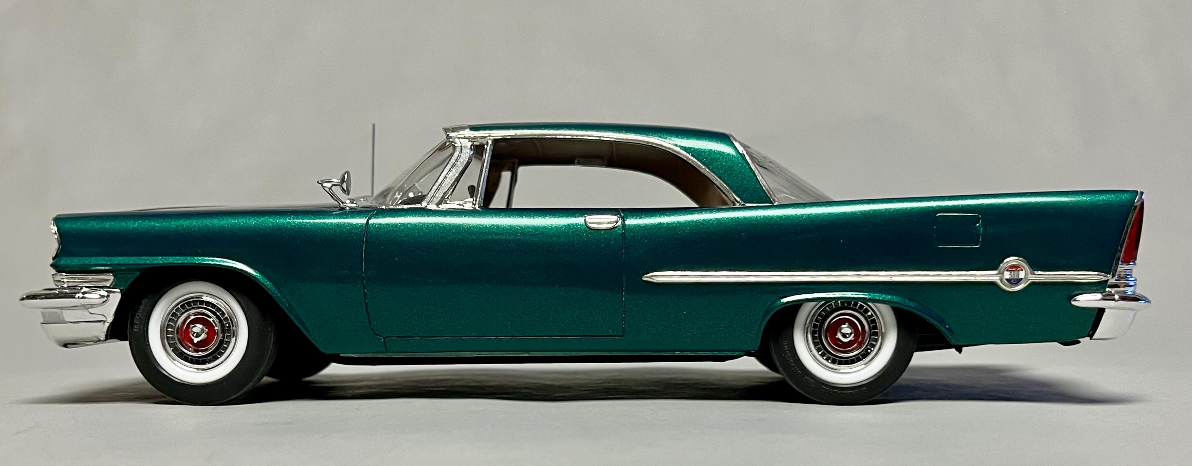

On 11/21/2023 at 3:38 PM, papajohn97 said:
This was a fun quick effort mostly built OOB of a kit I read good things about. The green I used is called “Parade Green”, a Chrysler factory color in ‘57, for which I used MCW base lacquer with Gunze Mr. Color GX100 lacquer clear coat, all other colors done with Tamiya acrylics. I tried wicking red paint into the circular recess in the kit chrome wheels but it was impossible for me to achieve a clean concentric result so I punched some rings out of masking tape and airbrushed them with gloss red Tamiya acrylic and then just stuck them on like stickers, much better result! The one problem I had with this kit was getting the front chassis + interior to fully seat within the body. Most likely due to error(s) on my part.  I ended up having to squeeze the front end assembly together (causing the chassis to bend upwards), bond it with liquid cement and CA and tape it tight overnight. Not the first AMT kit that I have had this issue with (looking at you ‘62 Bel Air!). Despite this issue, I’m happy with the finish and really like the look of this shade of green on this car. Cheers, John

Guys, also note that John applied the Parade Green to the areas around headlamps, which are plated in the kit but need to wear body color paint, as he hasd done here.  Given the configuration of the kit, that is very difficult to do.
Thanks Tim. Painting the inner areas of these chrome headlight inserts actually wasn’t that hard to do. I punch out round tape masks for each of the headlight bezels using hypo tube punches (made years ago, I use these a lot for rounds/ fillets in masking) and then just applied liquid masks around the parimeter of each insert. I then airbrushed the green base paint and then removed the masking and did a few Molotow touch-ups where the chrome plating was damaged.
