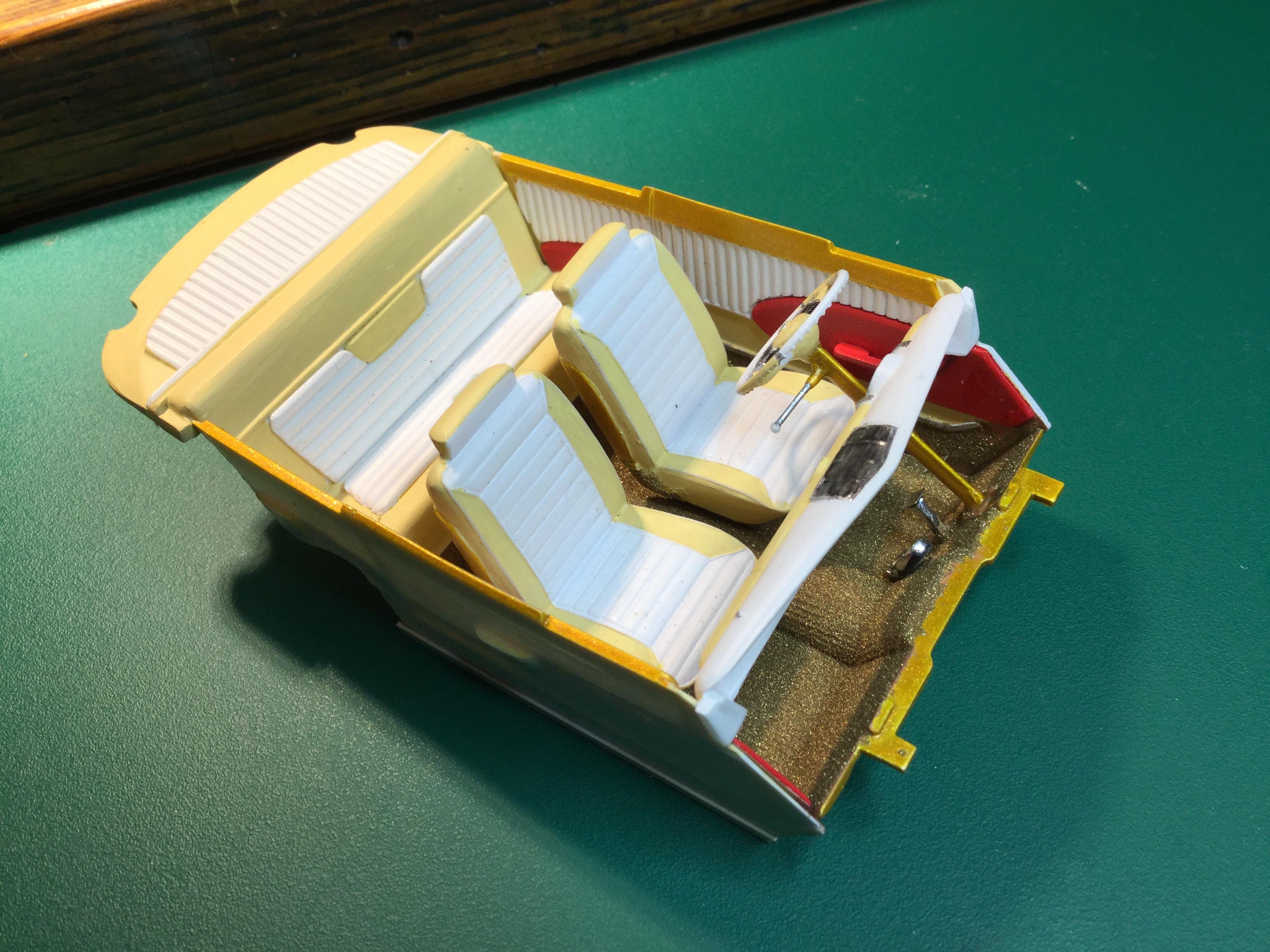

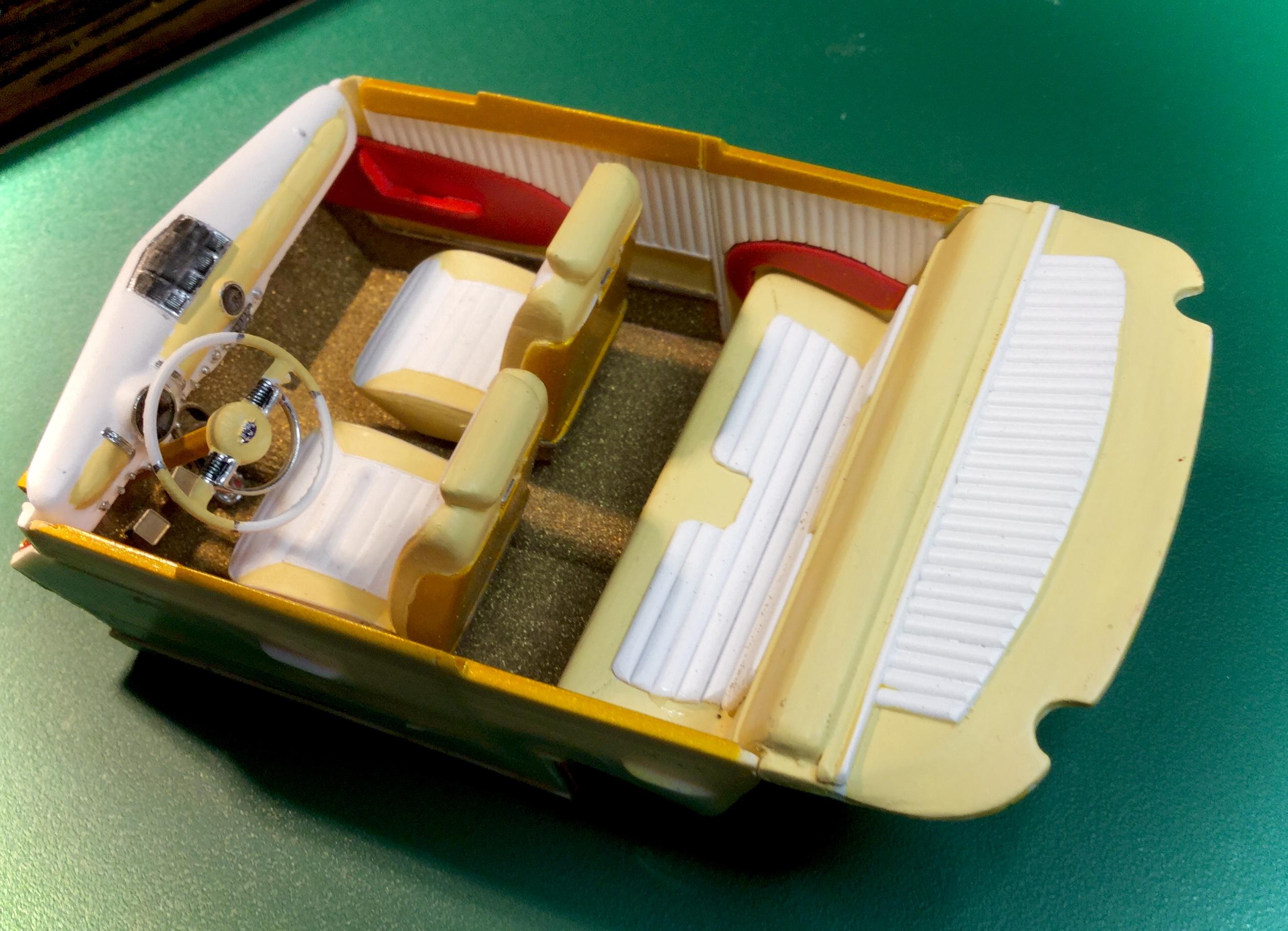

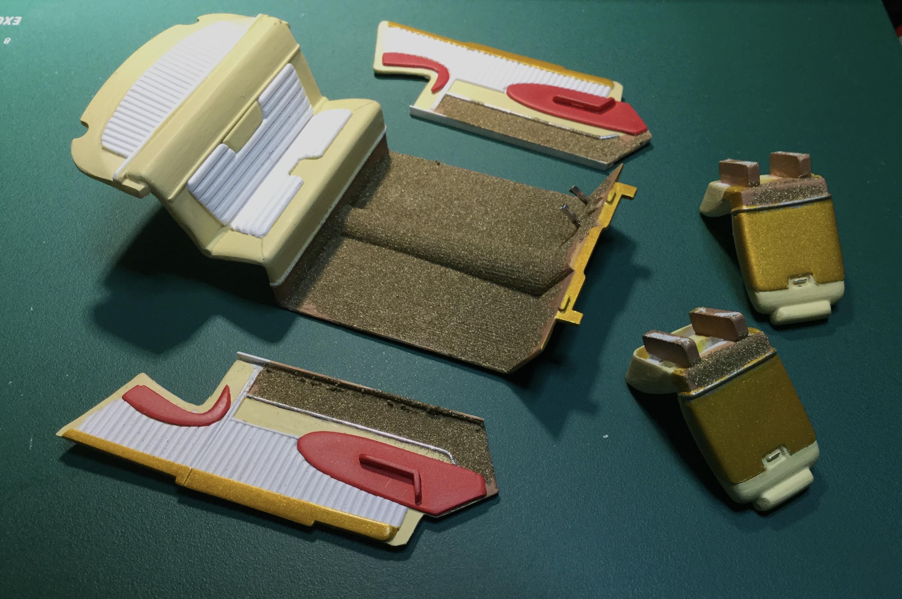

An example from my 49 Shoebox build using half round Evergreen products to create the new interior panels, rear deck and seat patterns. Embossing powder was employed to create the carpet and effect.
Hope this offers you some ideas Milo,
Cheers Misha
Cheers Misha
Nice work, everything has to be lined up perfectly or else it looks bad. One other I saw that came out well, the seats and interior panels were gutted. The pleated parts were installed in those "windows".
