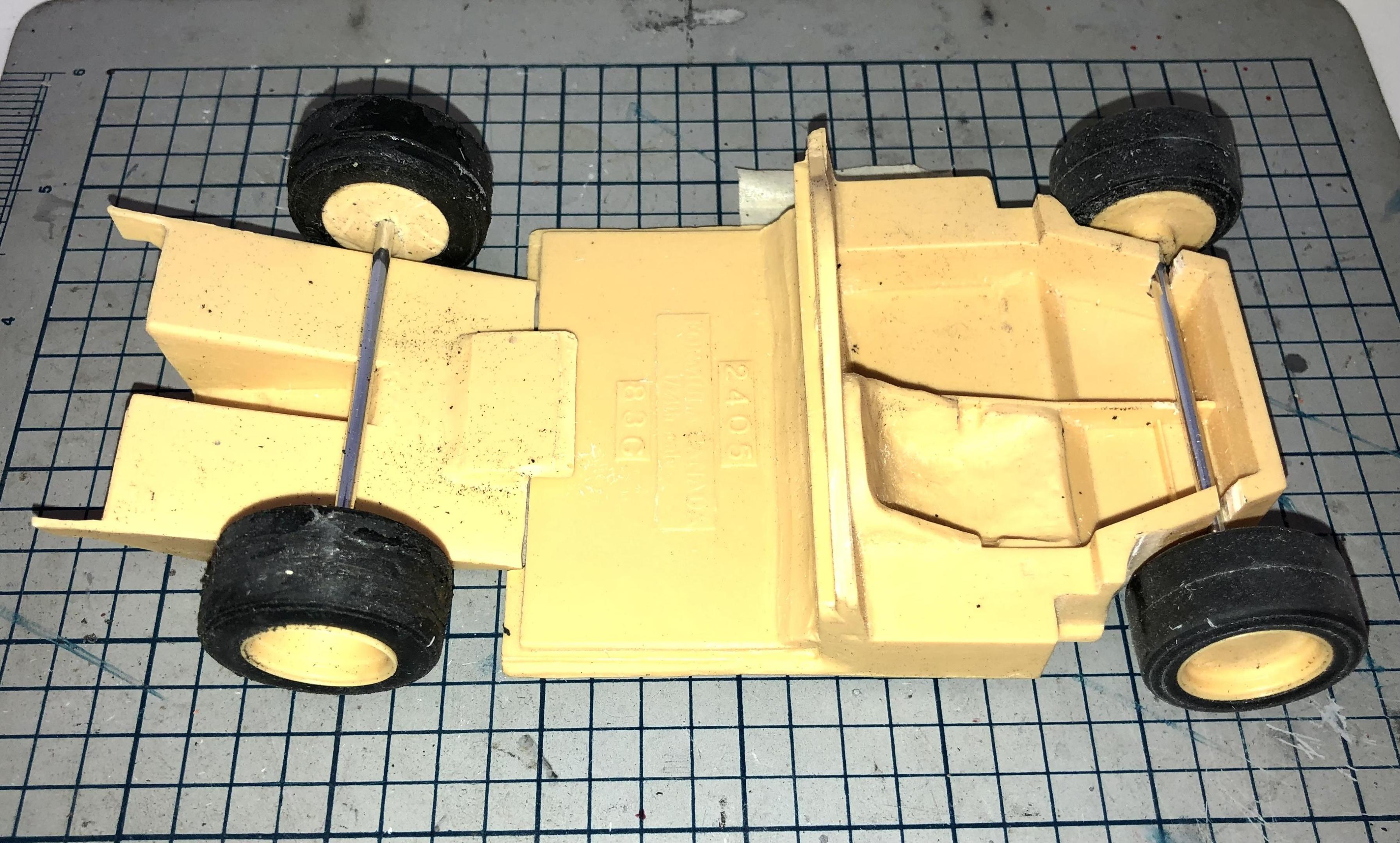

Although the kit came with rubber-like tires at this point I am going with parts box tires which are of the same dimensions and may even be the same tires on which the kit tires were based. The rear tires and wheels had to be narrowed by about ¼ inch each side so the tires would fit within the body between the outside surface and the diffuser. I plan to glue a tube onto of the diffuser through which the rear axle will pass and maintain the rear stance. To mount the front axle slots were cut in the foot box and a fair amount of material had to be removed from this assembly to give inner clearance for the wheels and tires. Once the exact stance is established, I will make up a holed mounting plate from sheet styrene to glue on the side of the foot box. Both the front and rear wheels wells required reshaping for the tire diameters. While I had the dust mask on I also recontoured the lower side of the body to give a nice flare to the bottom sill. I also re-scribed all the panel lines.

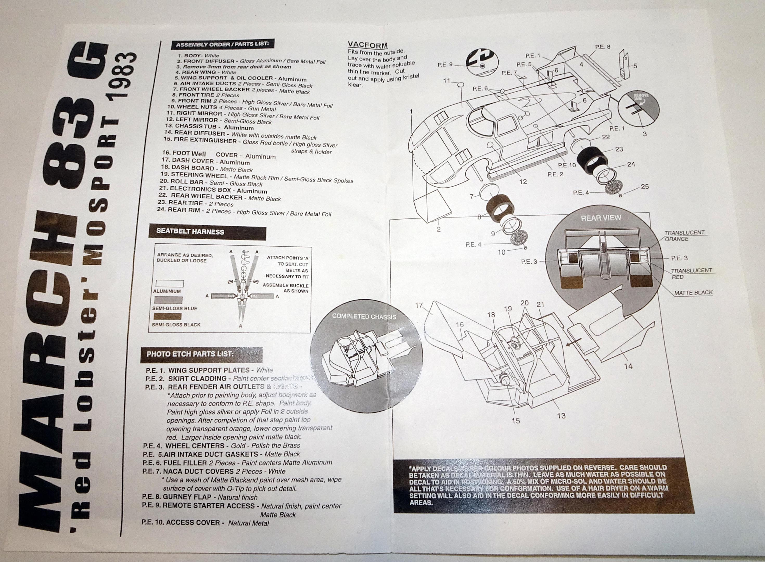

Howdy, would it be possible to get your axel measurements? I have a kit, but no instructions. Your build is very helpful to this builder.
Hello Patrick - Cool to see someone else working on the same kit. The more I work on it the more impressed I am with it. Chris Mann did a great job mastering the kit. I shortened both of the supplied metal axles. The front axle is now 61mm and the rear 59mm. As mentioned earlier I narrowed the back wheels and tires about 1/4 inch or 6mm per side. I have started work on the interior and plan to complete all of the under body before moving back to the top sides. Here is a larger version of the instructions.

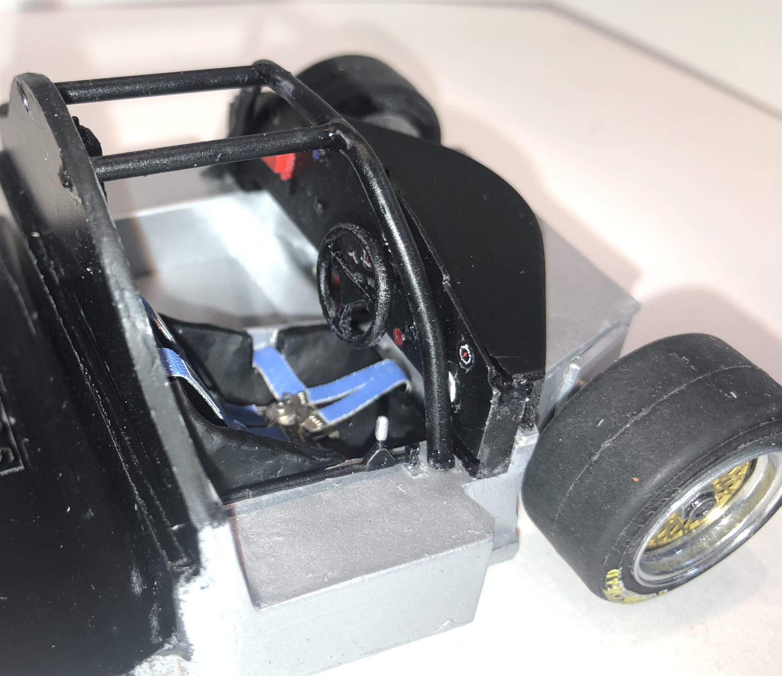

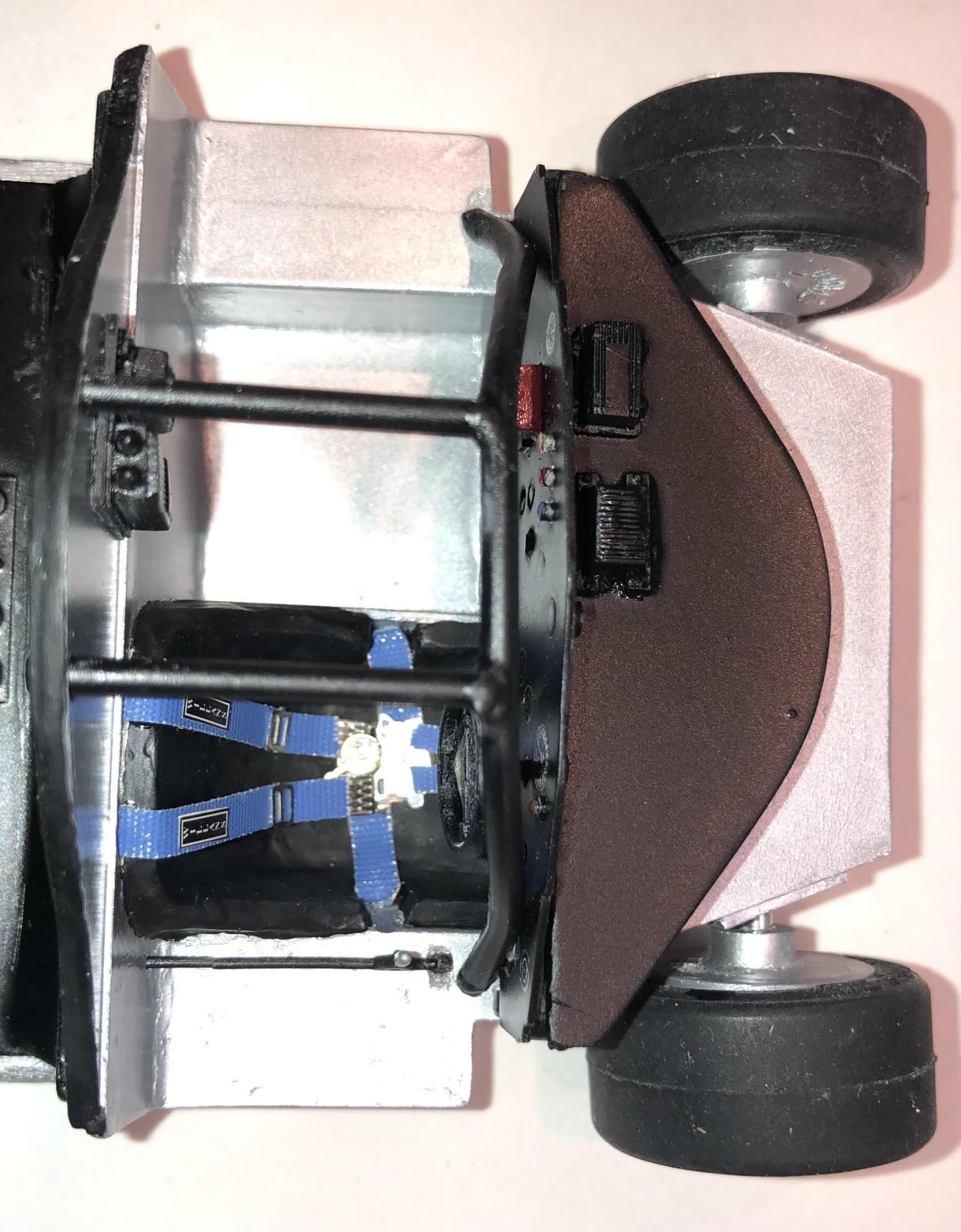

I have completed all the under-body construction. The kit comes with a nice set of photoetch seat belts to which I added self adhesive material. I really like the look of the wheels with the brass photoetched centres. I used Revell Spray chrome on the rims. I do not have a lot of experience with old resin kits. I did clean all the parts in a dish soap solution and primed all the parts before top coating but I am having problems with paint adhesion which is more obvious in the photos. Those areas have been touched up by brush. I just recently read someone on the forum saying "resin does not like paint". I definitely plan to use more aggressive cleaner on the body parts and do more sanding.

This should be a formidable build Phil. The livery is so beautiful. I only built one resin car and like you I soaked it and then I did a progressive wet sanding of the body (800-1000=2400=3200) to help give it a bit of mechanical adhesion for the Tamiya fine primer. Maybe I just got lucky but no paint peeling events.
Thanks Pierre - I have already touched up some of the cockpit bits and will rewash and re-sand all the body parts.
