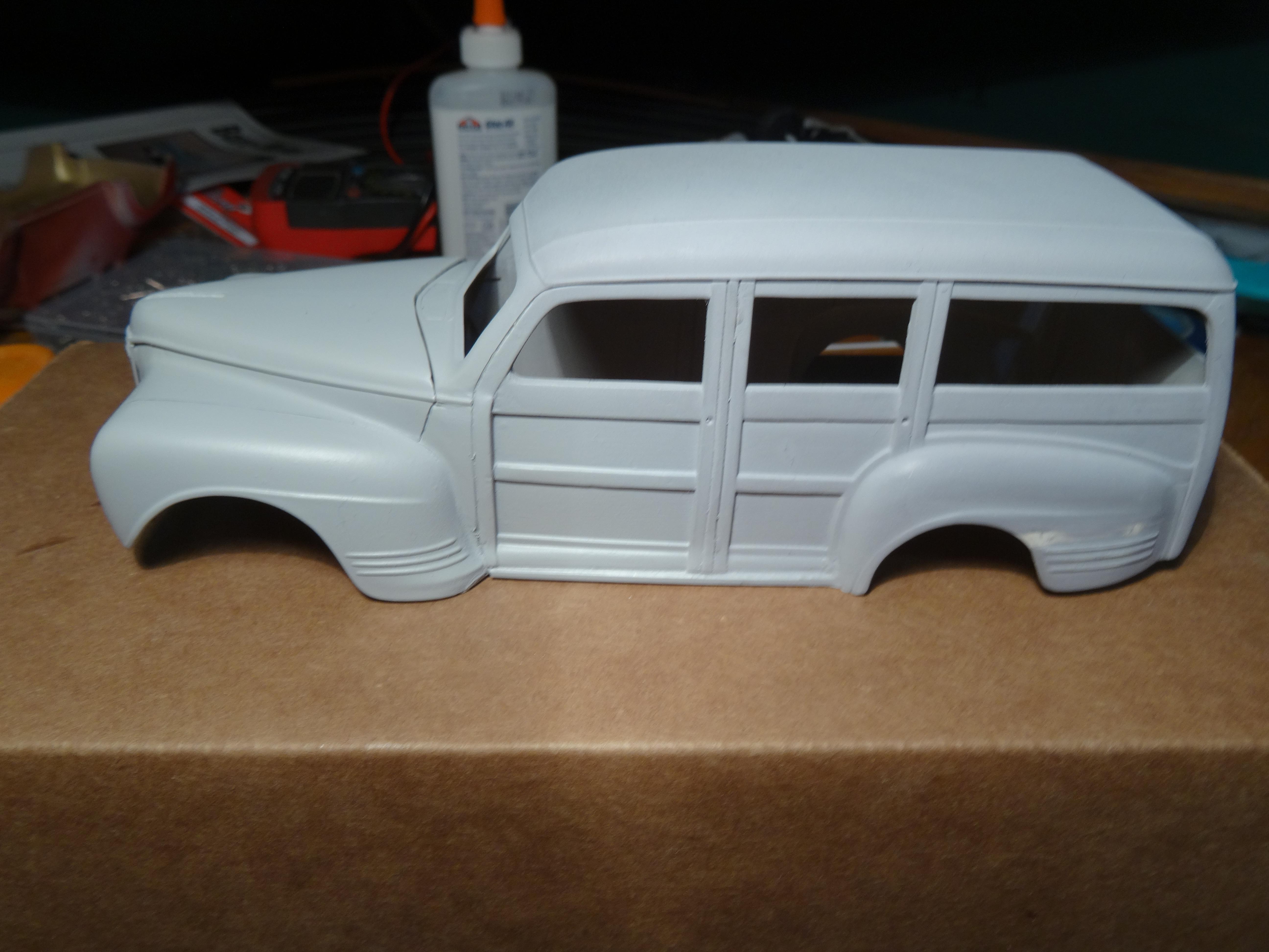

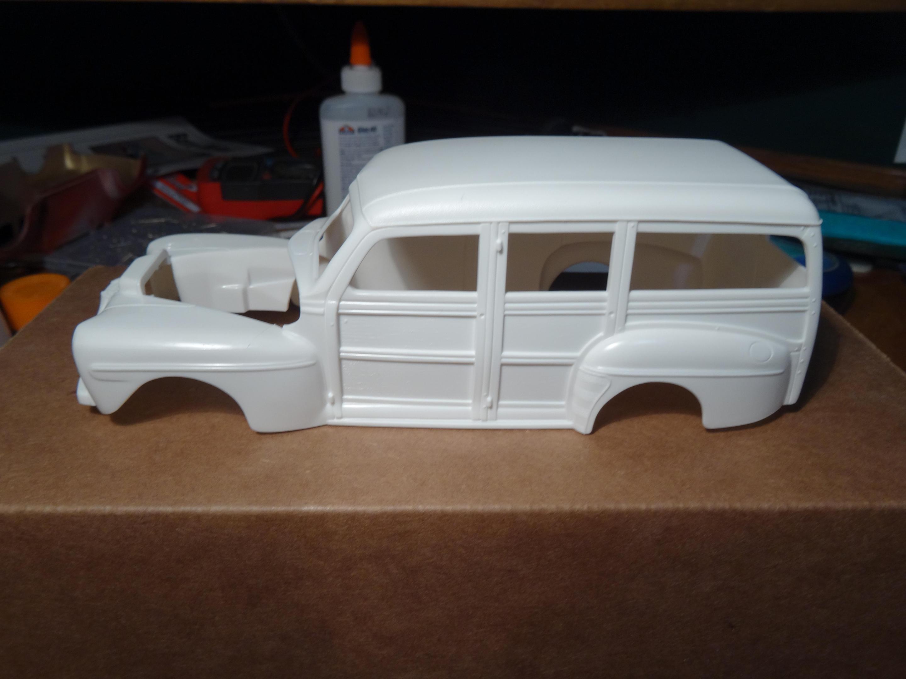

The Woody
I don't have any pics from when I started this build a few years ago but I thought I'd pull out another untouched body for comparison. I'm not going for a completely correct woody body, I think the effort spent on the nose is enough work in itself but I did want to try and make it feel the part a bit better. And besides at the time a lot of these old woodies had work done to them to repair damaged pieces and were not always 100% correct. My grandfather in fact had a 1938 Ford Woody and he completely rebuilt the tailgate because it was rotten but made it his own design, boy I wish I had that car now.

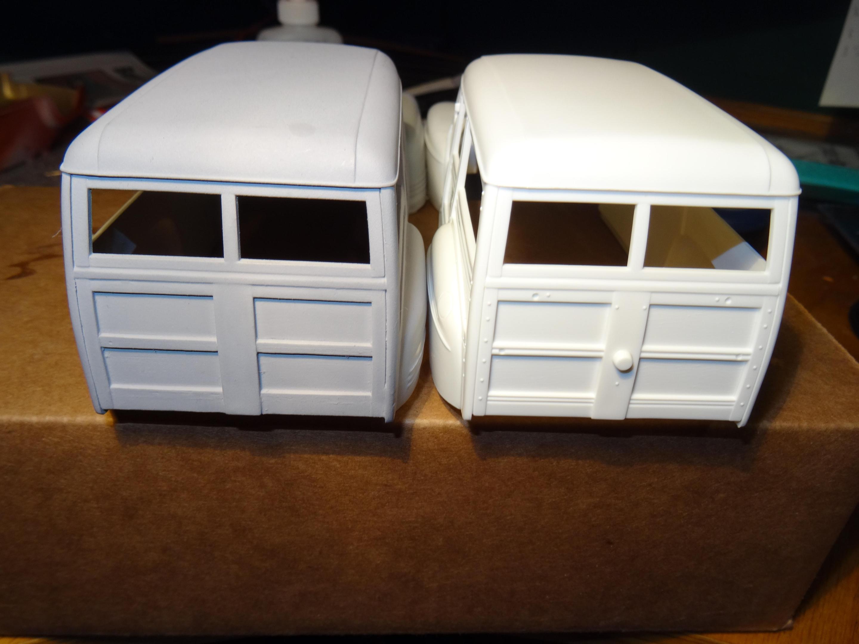

On the rear the Ford has exposed bolt heads and a bump in the dead center for a spare tire, these were removed as the Plymouth is much more plain in the backside.
The modified body is on the top with the original below it. Most of the work here was to the rear fender to make it in the style of the Plymouth. The fender is more rounded in general and doesn't come as far forward into the rear door but I choose to leave that alone as it would require modifying the wood as well as the fender and altering the wheel base.  The wood strips on the Plymouth are also simpler then the Ford's so they were filled in to remove the grooves. The Ford has visible hinges while the Plymouth does not. So not a perfect rendition but close enough for me.

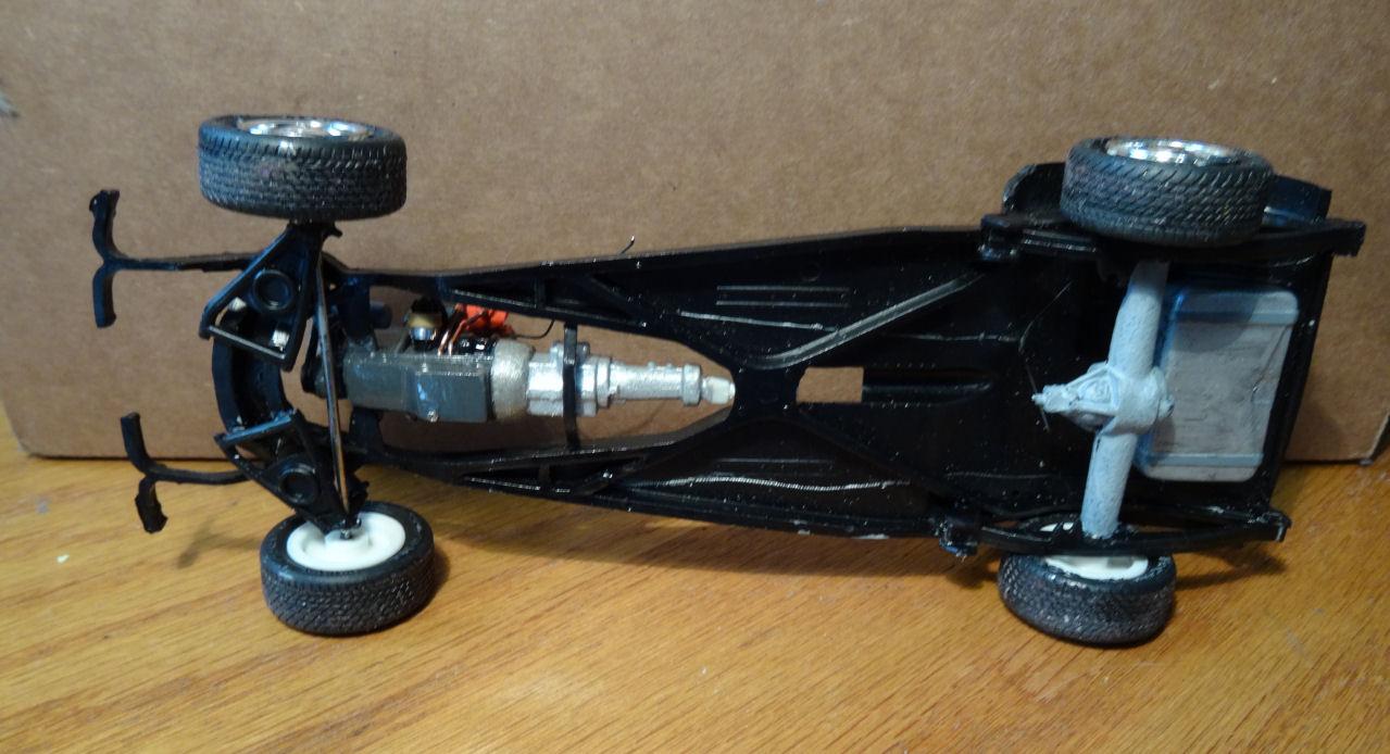

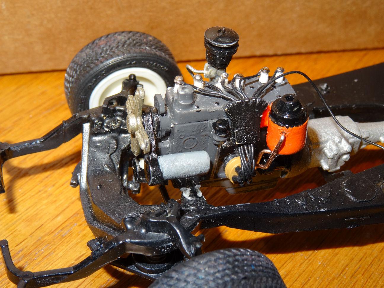

Anyhow, have the chassis and engine somewhat put together. The front axle is not staying, AMT and their metal axles.?

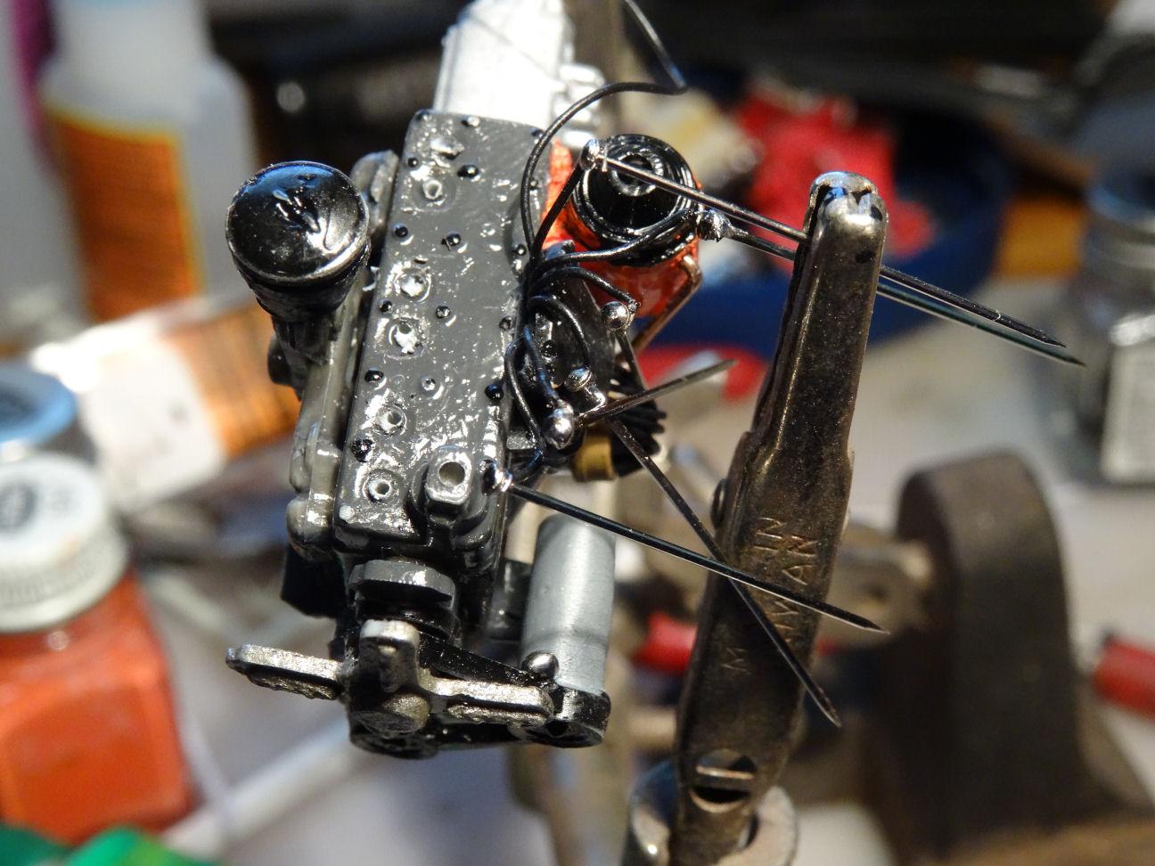

There is a lot about the engine that bothers me and while I tried to dress it up a bit I would take a different route next time. So much is not accurate, one thing being the oil filter. The kit replicates a skinny little filter which technically was correct back on day one, but those filters were sealed units and you threw the whole thing away and replaced it. They are long out of production and you might find one if you hunt long and hard at Hershey, but most people nowadays replace it with a canister with an removable element. I had some scrap bits on the bench and started piecing one together with a crankshaft and alternator pulley sandwiching a large piece of round stock and some .030" welding wire. It looked great in my hands but I feel it is too big for the engine. Anyway, I decided to leave it, still need to put a nut on the top to keep the oil in.?
But Jim, curse you for those spark plug wires. I had totally forgotten about the wire style they used back in the day. I have gotten away from that on the 1:1 '39 so it never occurred to me. I already had the distributor wired and the wire separator created all I had left to do was wait for the plug boots to dry and slip the wire into them. And then I saw your post with the wired engine. I thought, forget it, I'm not going back now, but it kept bugging me. Finally I gave in and switched the style. Being everything was already in place it made it just a bit more difficult to solder on those ends. I felt like Vincent Price creating Edward Scissorhands. ?
I used some straight pins to slip into the 'spark plugs' (drilled out round stock) which now replaced the boots. And on top of it I broke a drill bit off in the head drilling out the block. It will have to stay there as I don't have an extractor that small.??

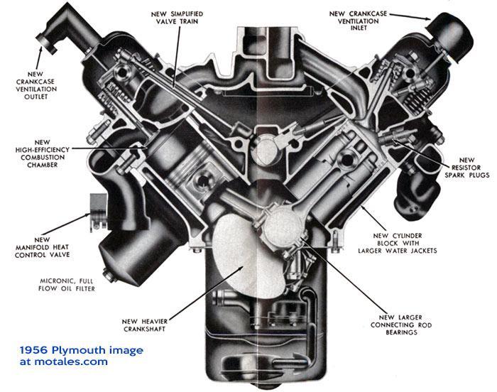

Are you trying to tell me that thing on the bottom is an oil filter? Gotta love where they put the exhaust ports. Or did the last builder put the heads on upside down.
Think I need to start a different project??

I guess that is supposed to be the “micronic full flow oil filter”. That is how the heads are mounted according to the instructions…and I’ve started a ‘49 Merc, and a ‘66 El Camino since starting this one…gotta keep my sanity.???

Thanks for confirming that Greg. I don't want to use those kit headers but I might also see about doing a head swap as these look ridiculous with the exhaust ports above the spark plugs.

Yeah, that’s why I stuck with the six-banger.?

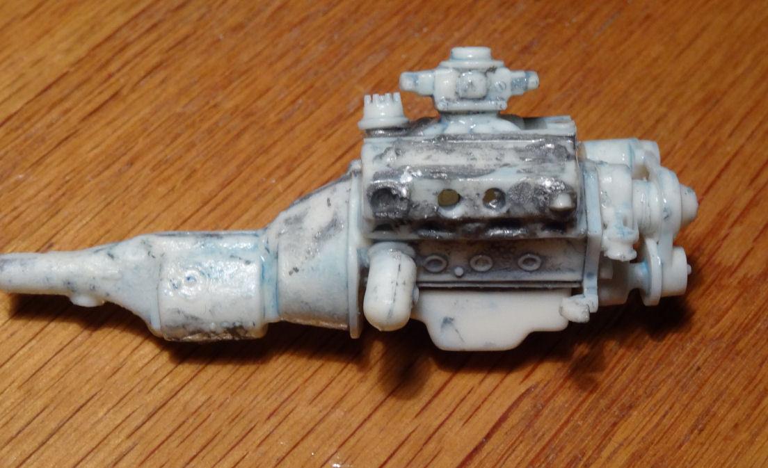

I'm sure I'm breaking some rules here but I just can't live with the boxed engine. Chrysler had some small Hemi's, the smallest being the Dodge 221 Red Ram,  so why not build one, or a semblance of one at least.
Went to remove the heads from this engine and discovered they were molded on so I hacked them off. Leaving a big gaping hole.
Transplanted the Hemi heads and between them the original intake and already it looks a whole lot better.
Had some nice valve covers in the parts bin. And lo and behold it might pass for a Hemi.
