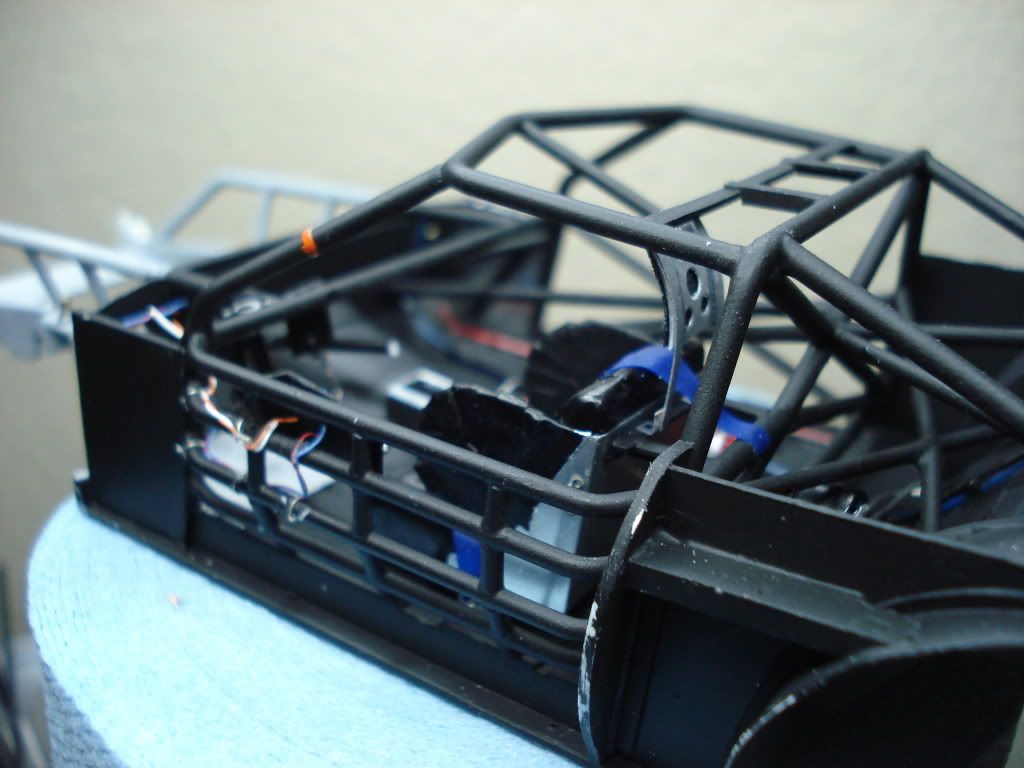

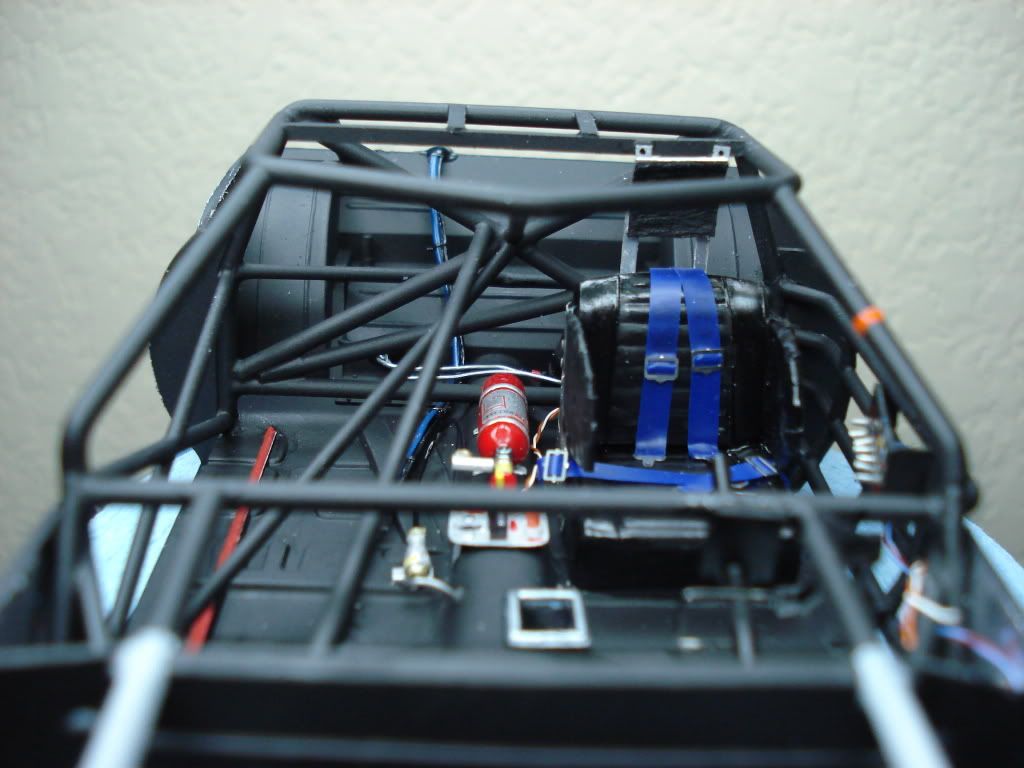

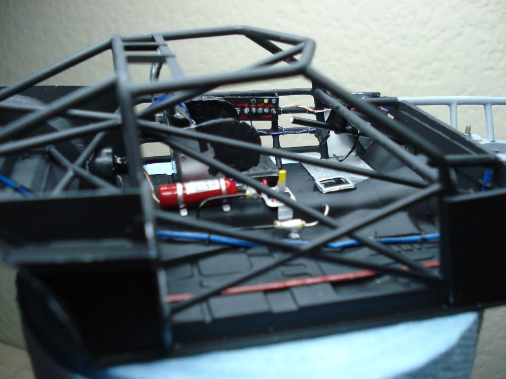

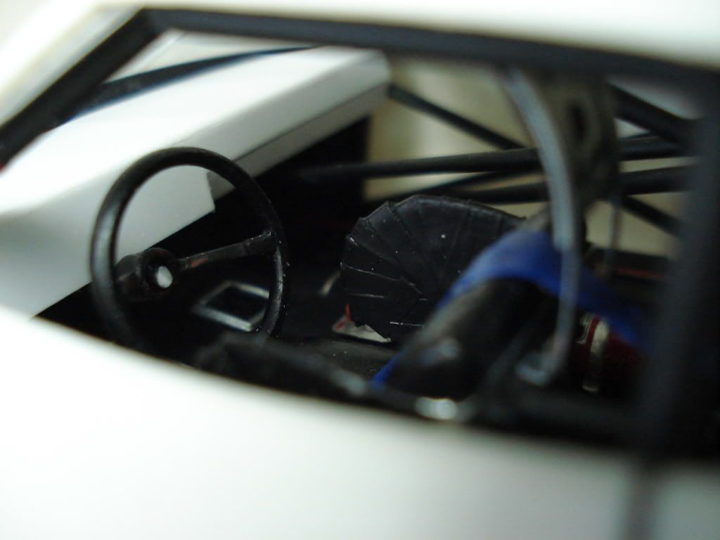

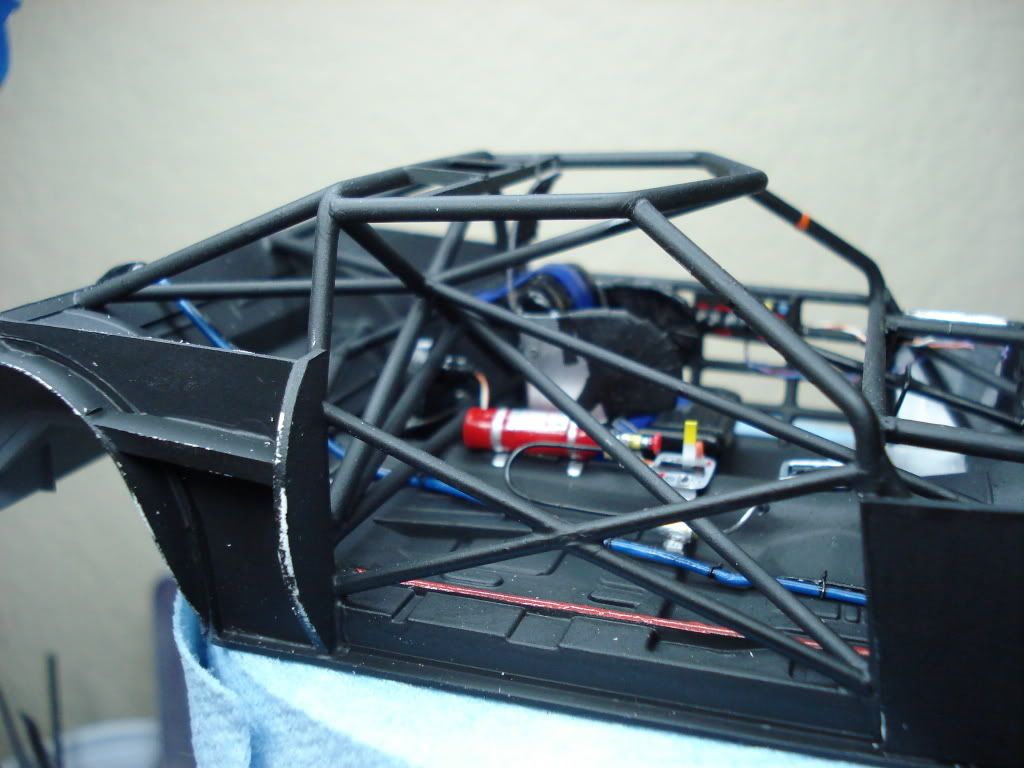

hey danny, your porsche is looking good. it is a great relief when you finally get the body painted, huh?
just to let you know, i am still in this. the fiat is on hold until i get the torino closer to the finish line. i need to start moving faster. :) one and half months, huh? sheesh. i did not get as much done as i wanted but, progress is being made.
the chassis is painted and the interior is almost done. still need the dash, shifter, steering wheel and a couple more wires.
the office is almost ready to move in.
please excuse the scraped off paint. the body fits so tight, it scrapes off paint going on and off.
i also hope to have some paint on the body by this weekend. ;)
post up boys.
later
BRO THE INTERIOR LOOKS VERY GOOD, VERY RACING LOOKING
YOU HAVE DONE AN EXELENT JOB ON THE DETAILS.
I DONT'T WORRY ABOUT THE CHIPED PAINT....ITS REALISTIC
THOSE DAYS WHERE MORE DOWN TO EARTH AND THEY USE TO
WORK ON THE CARS IN THE DIRT AND WITH OUT A COVER
OVER THEM....THE GOOD OLD DAYS.
I WOULD DO MORE WHETHERING...LIKE A RIP IN THE SEAT
SOME GREASE ON THE BELTS IF YOU CAN GET A OLD HELMET
WITHOUT THE FACE AND HANG IT FROM THE ROLL CAGE, IT WOULD BE COOL.

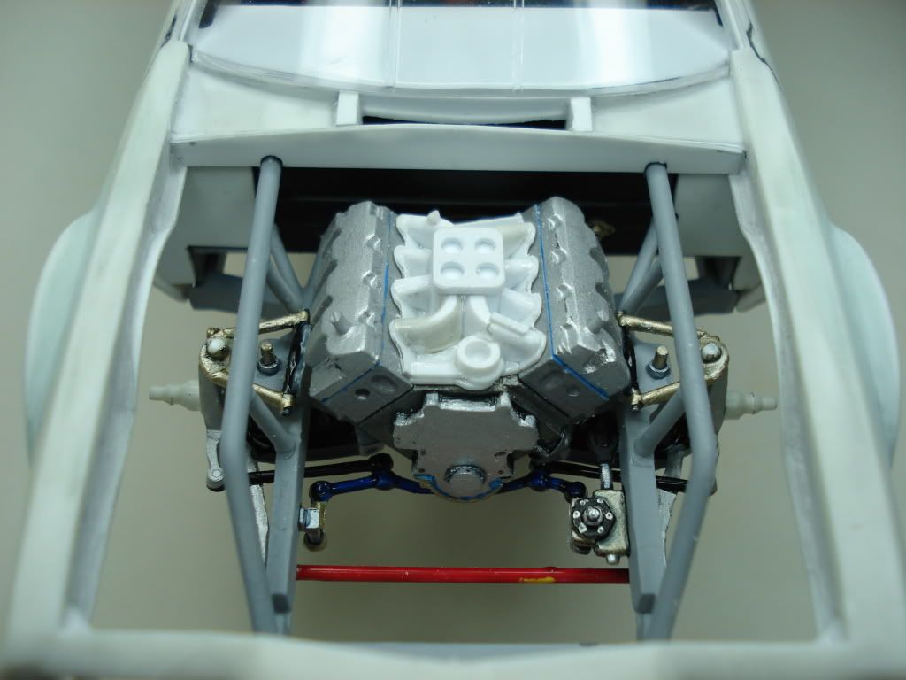

hello gentlemen,
i finally got the urge back to get this thing going again. i wish i could find that creative faucet. that way i could turn it on and leave it on. :o
i started getting the front end together. still need to make the shocks and a little touch up paint.

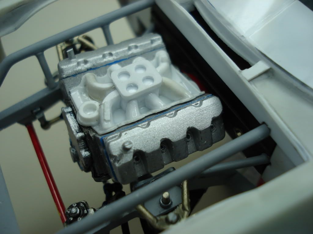

also started the motor, a BOSS 429! i started with the monogram small block chevy and converted it to a "385 series" big block ford. added deck height, lengthened the block, added an oil filter boss, timing chain cover and a bunch of other little things. built the heads and the intake manifold ( i think it turned out pretty cool ). the valve covers are 1/24 monogram's that have been corrected. removed the lip ( there is none on the 1:1s ) and the markings.
here are a couple of pics:
here you can see that the cowl, w/ intake opening, is complete.
hey look, a BOSS 429.

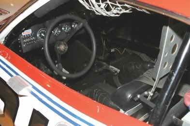

here is the shot of the 1:1. notice the light above the number to illuminate it.
too bad it did not get to run at le mans. :D
