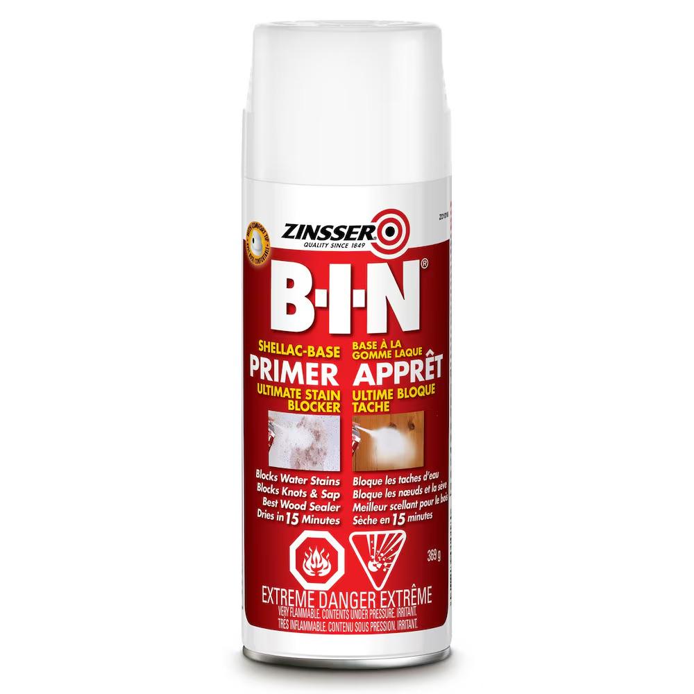

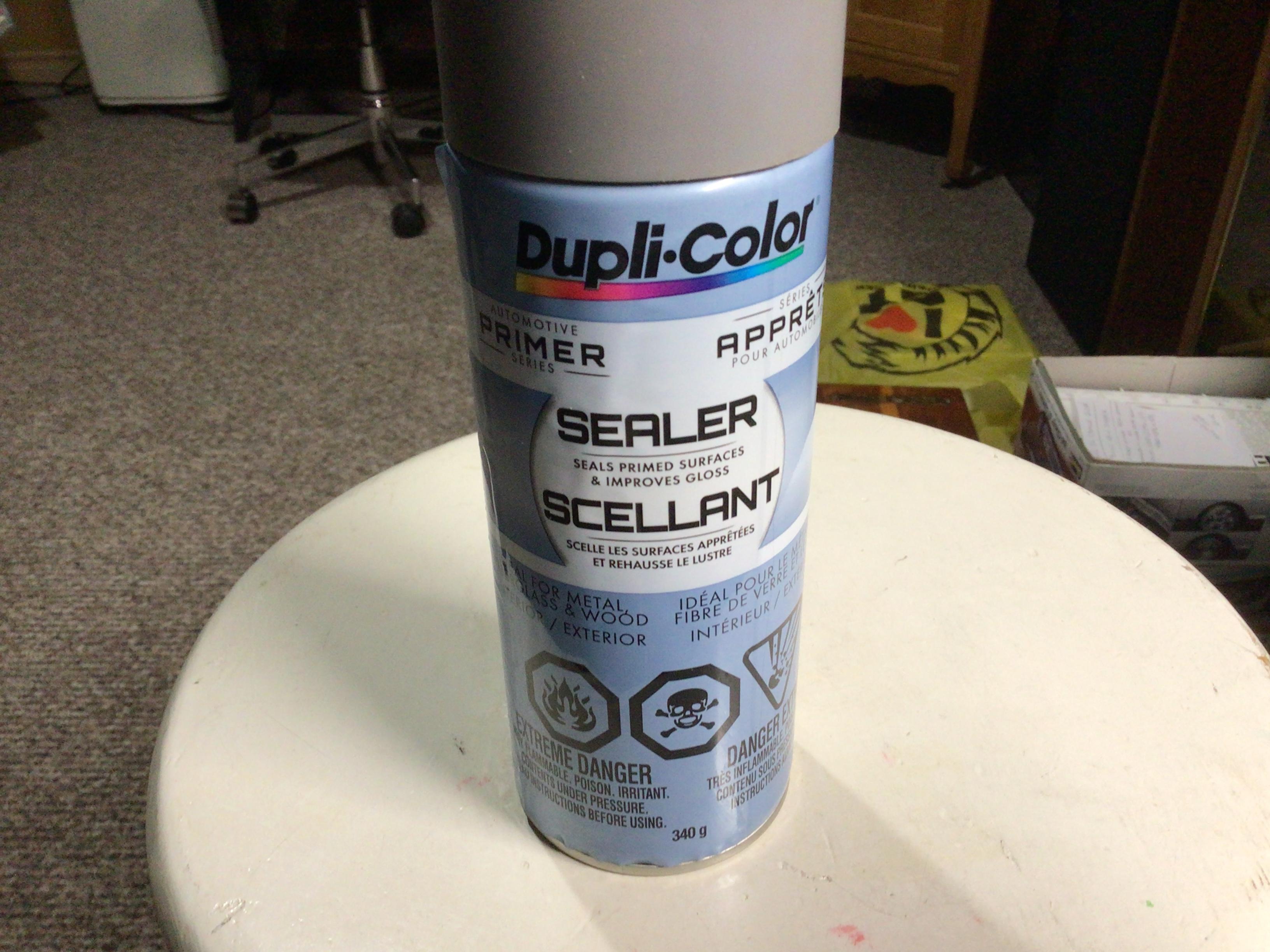

NOBLNG Posted March 24, 2024 Posted March 24, 2024 I have used the Zinnser shellac based primer for sealing bodywork. There is also a Duplicolor primer sealer that I have not yet tried. I imagine either of those should be a barrier against bleed through. Has anyone here tried them on a red molded kit? 2
