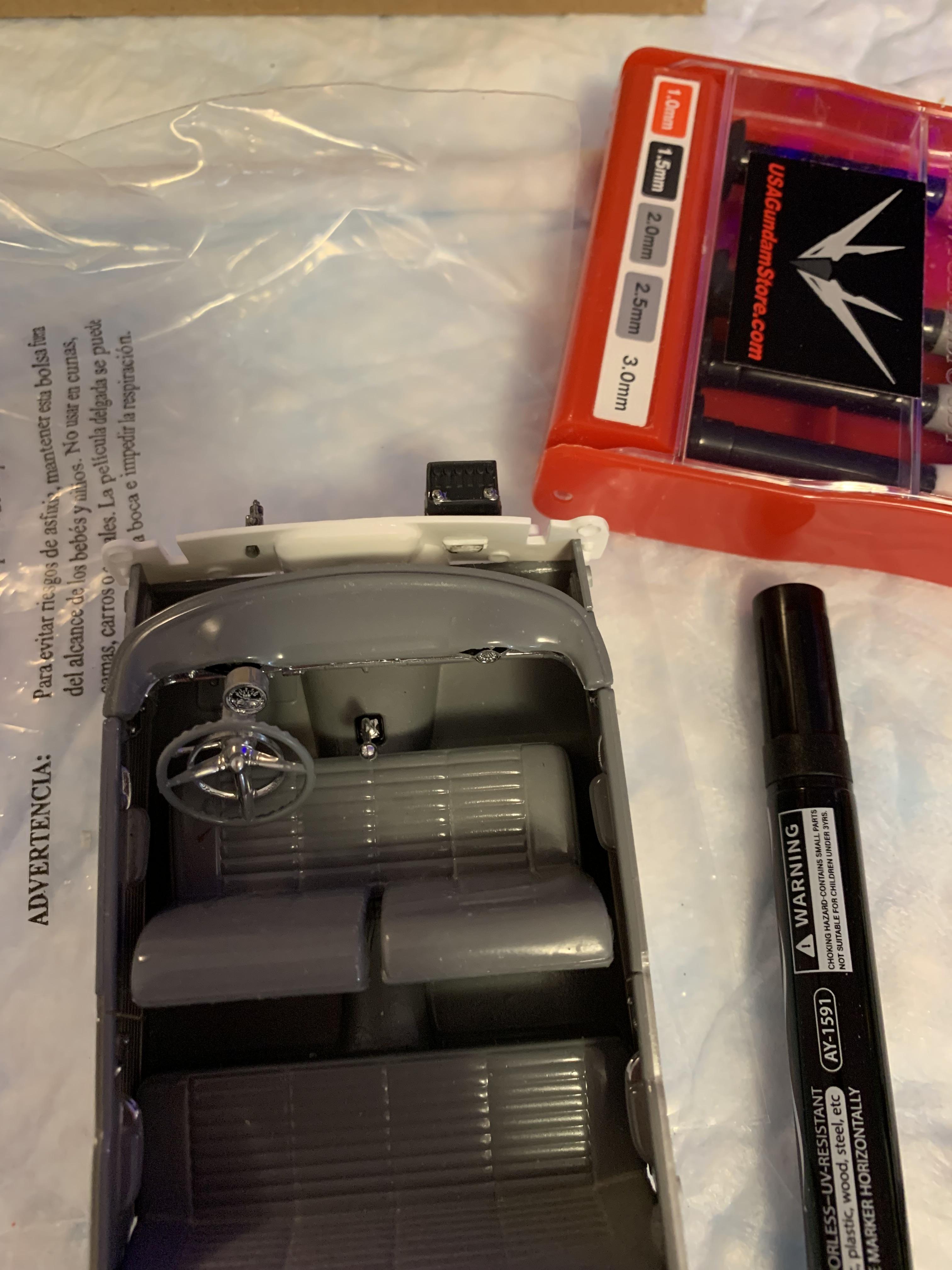

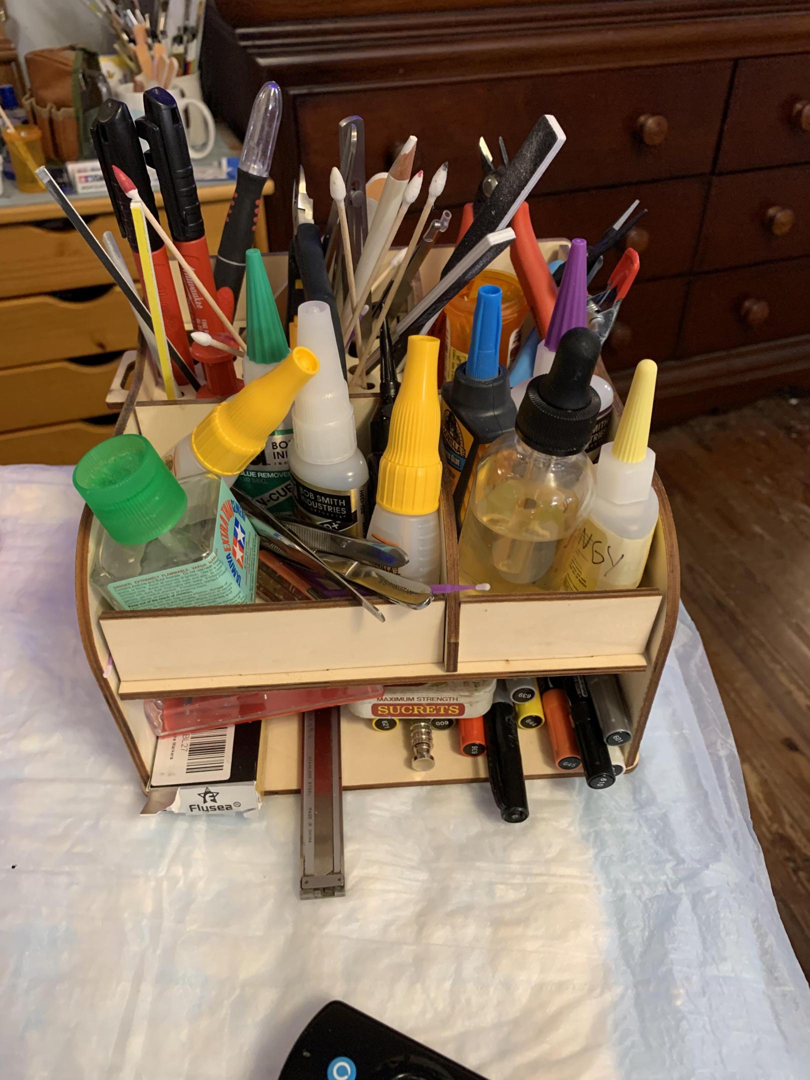

Back on this one.  I have to spend a fair amount of time in my son’s room.  He is bedridden with serious TBI, hemiplegic, tube fed, doesn’t talk, etc.  I have taken care of him for 20 years (since he was 17).  Any way, this is my portable work shop that I place on my rolling shelf so I can work in his room.  It is amazing how many tools I can cram on this apparatus.  Took the shifter from the 62 Pontiac kit I just finished, drilled a hole with my drill bit set, blackened the shifter boot with the brush type end on my new acrylic marker (how did I survive without those?).  Put one coat of Tamiya black wash on the grill.  Will let that dry, then give it another coat.

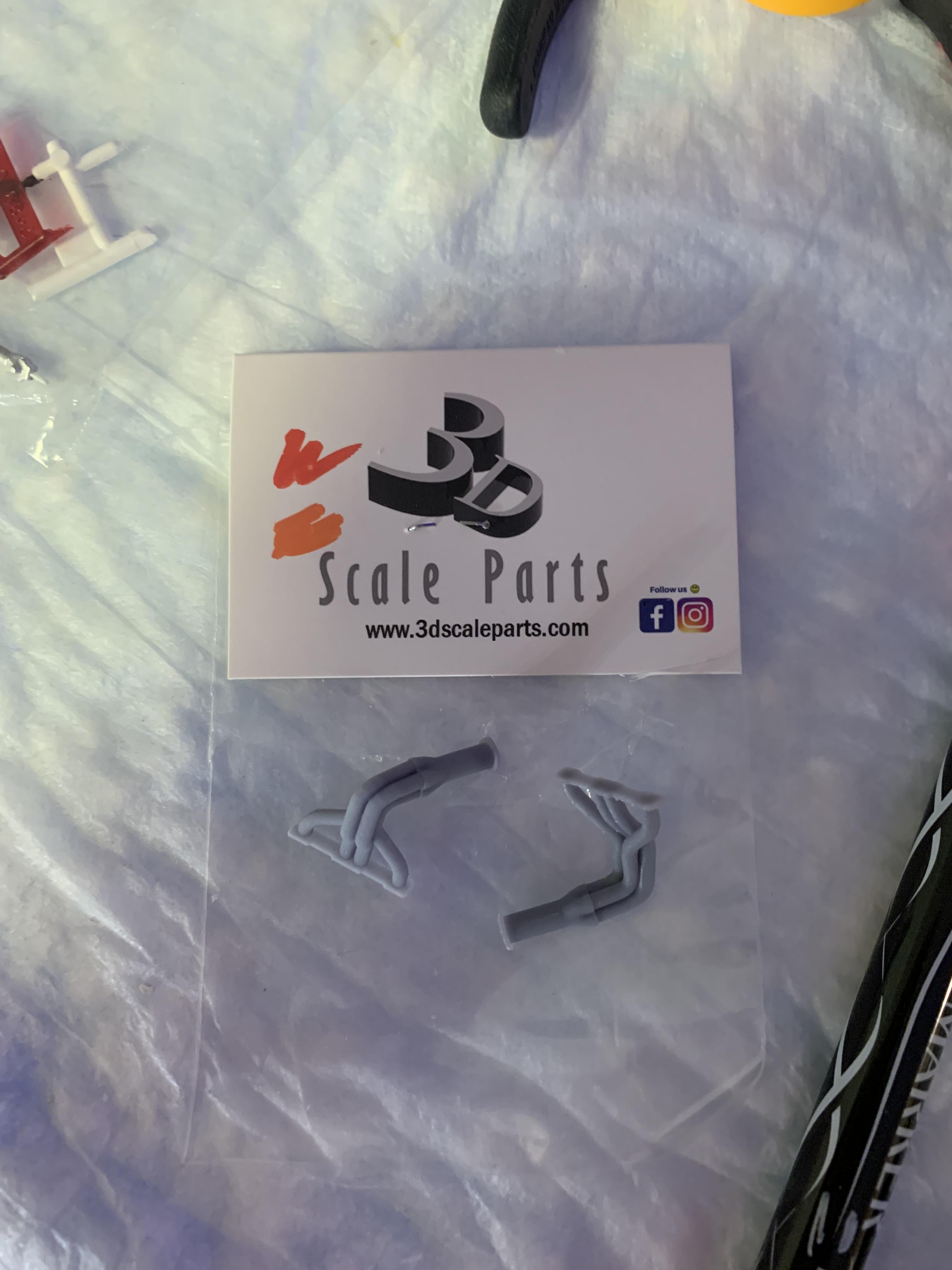

After a 6 month hiatus from this build, spent some time reorienting myself with what needs to be done.  Fender well headers should be here soon.  Got the 7” slicks out that I cast a while back.  They will require some cleanup and painting.

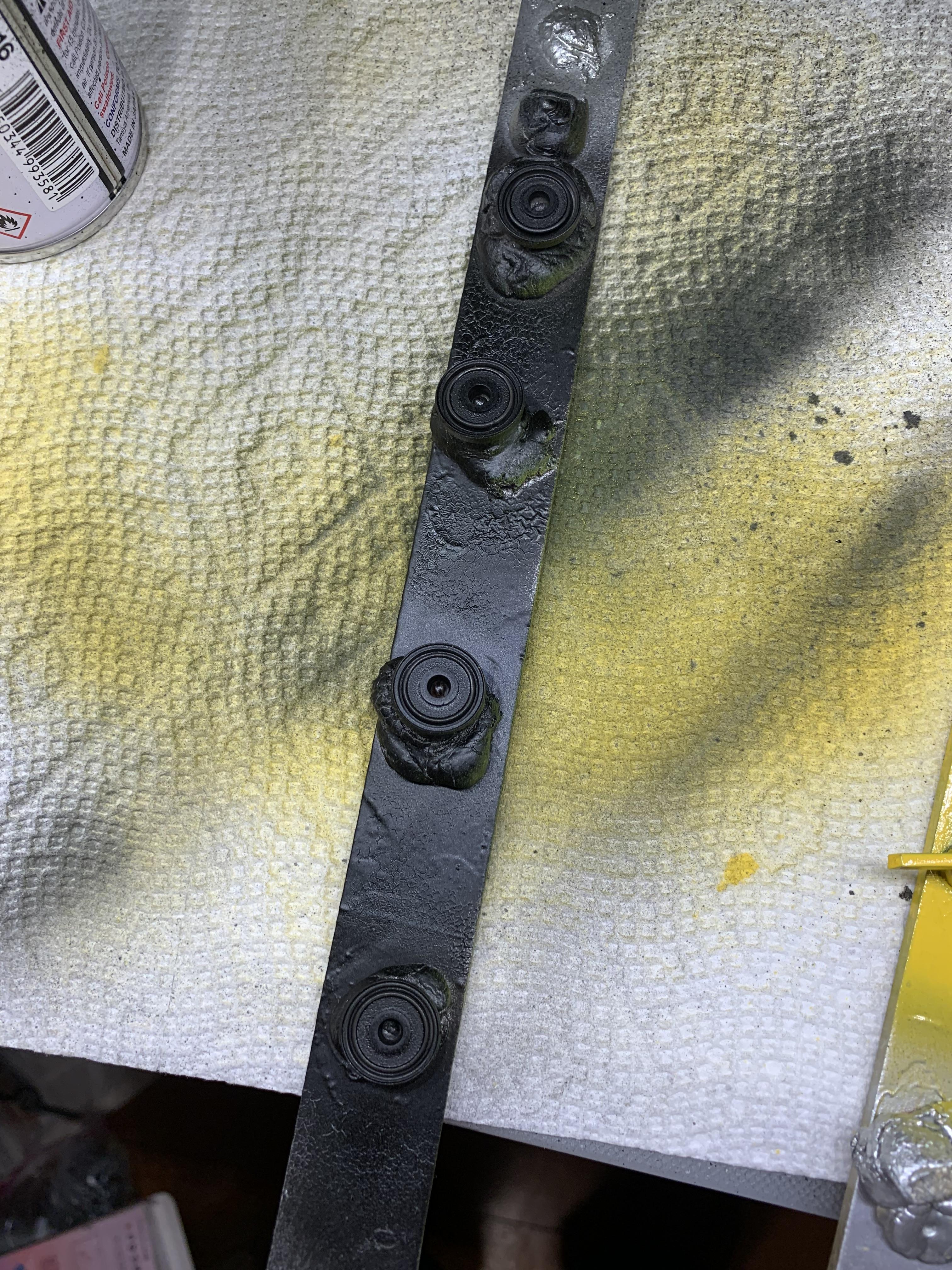

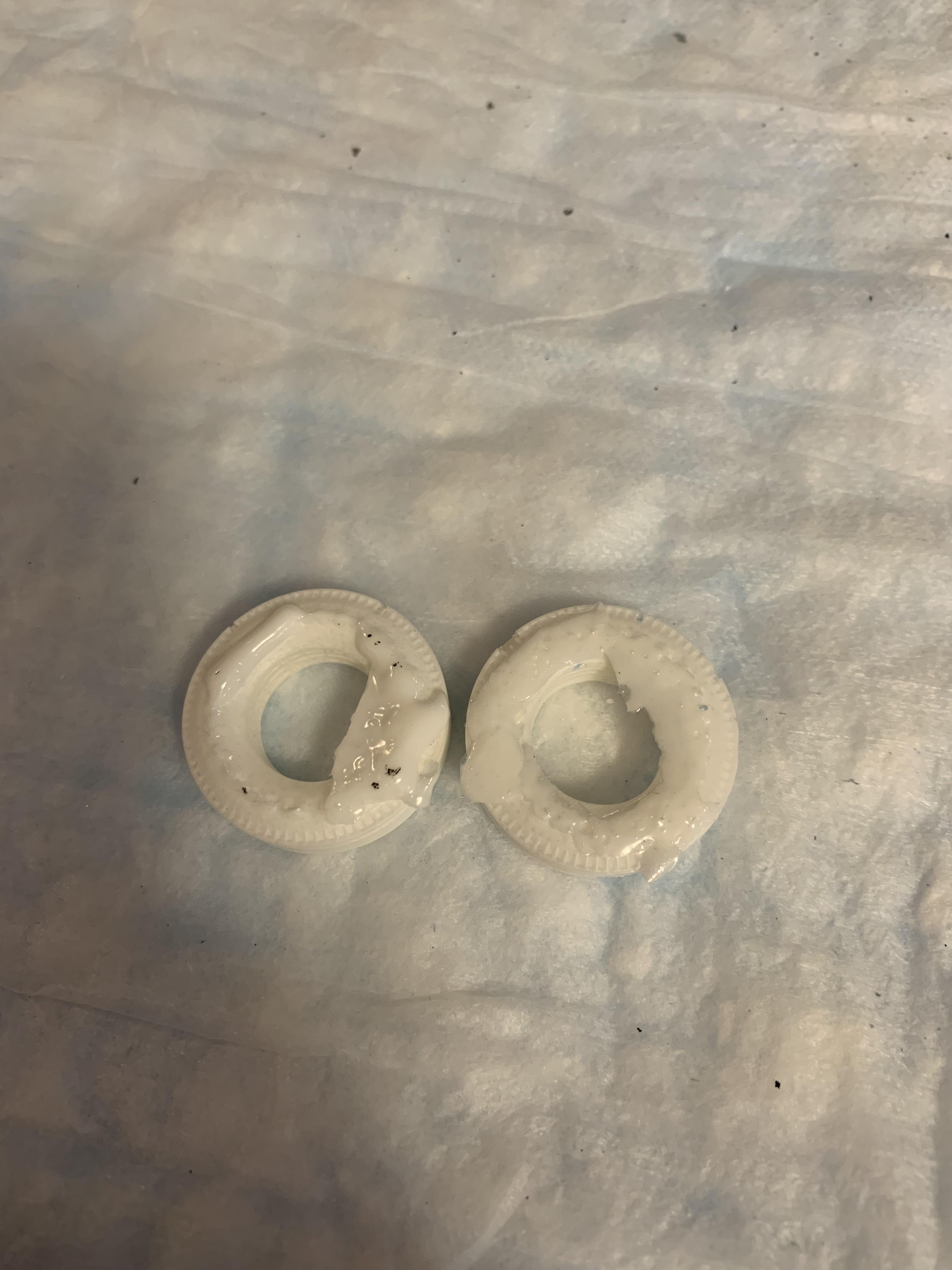

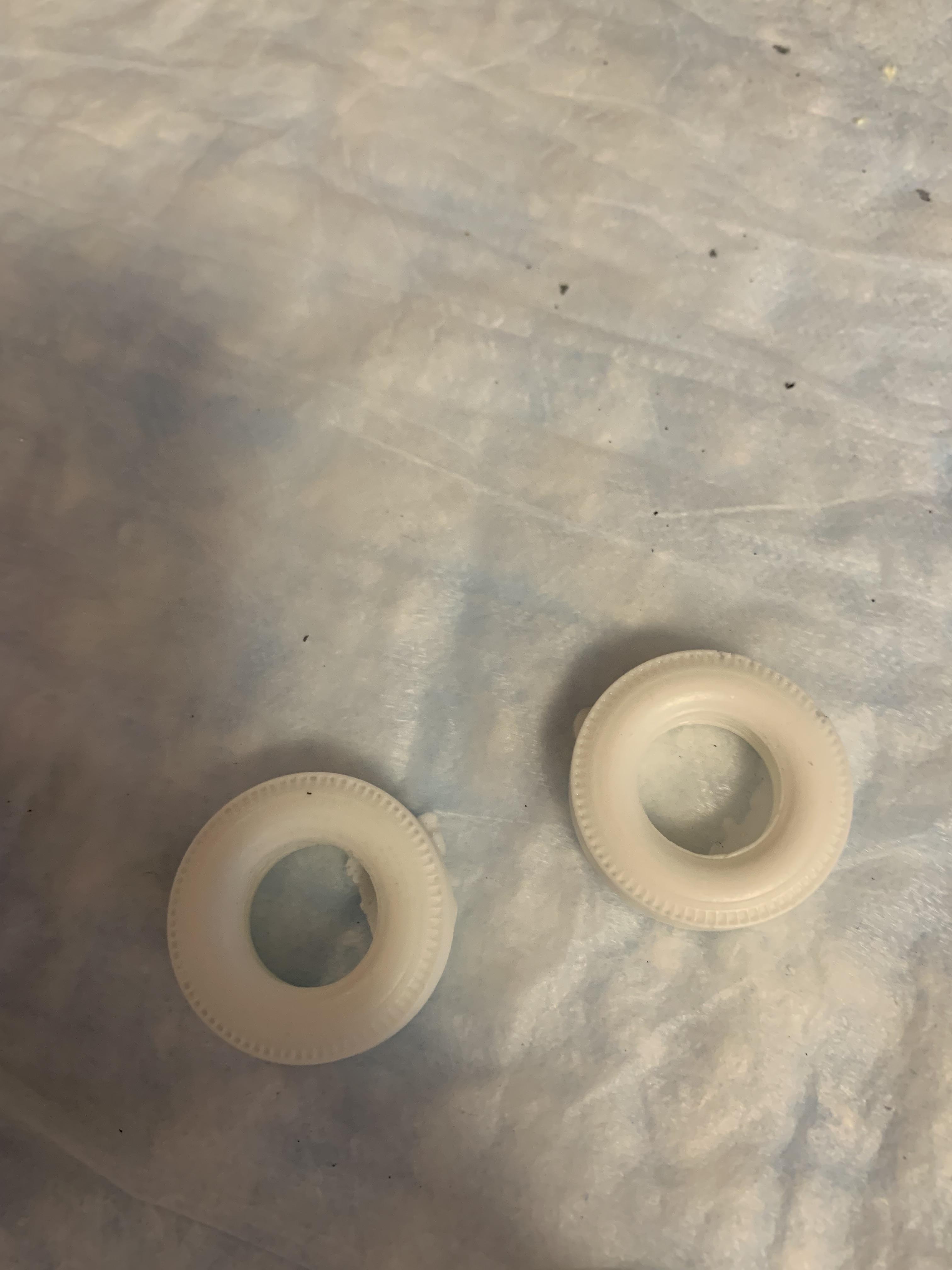

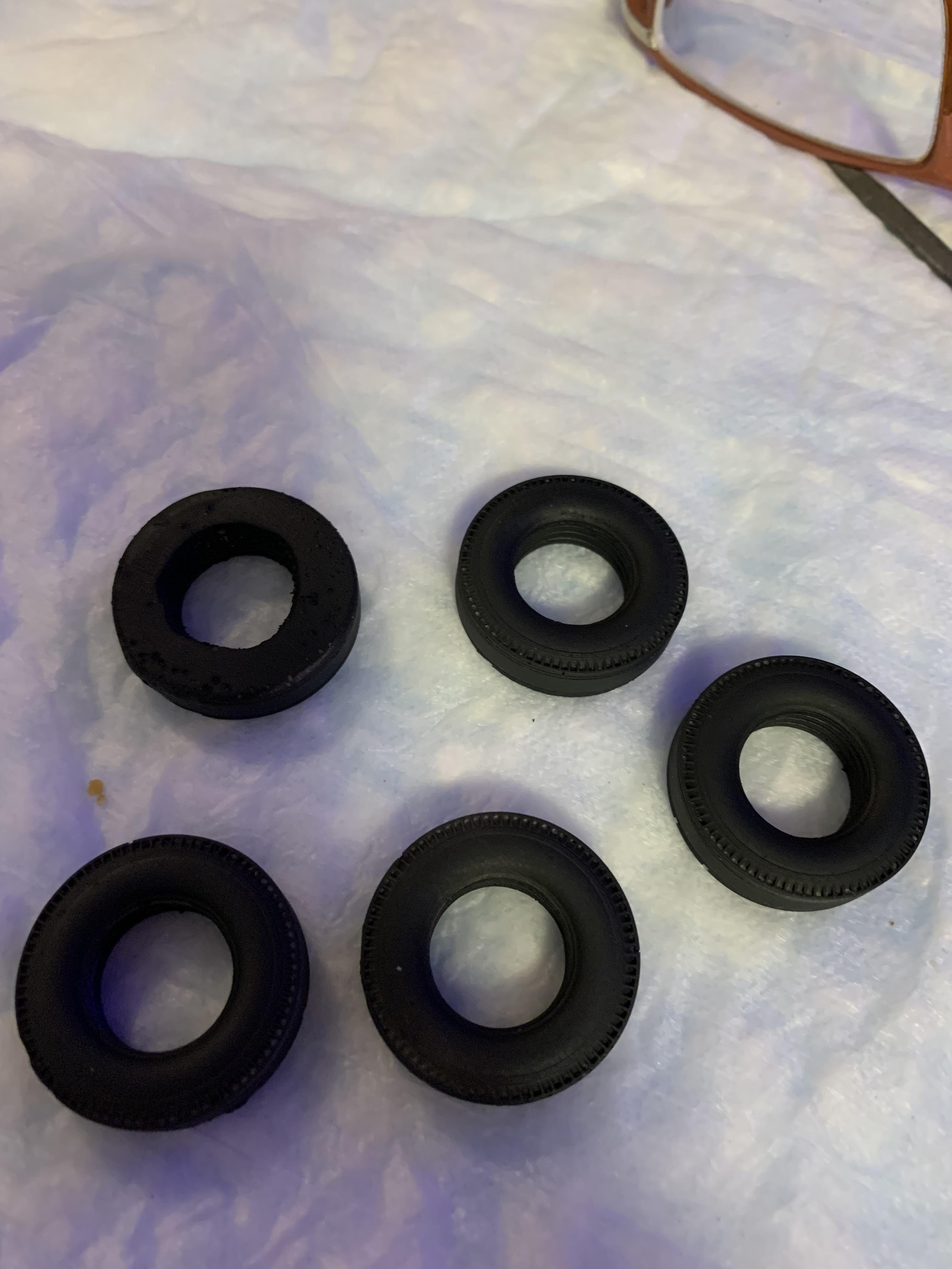

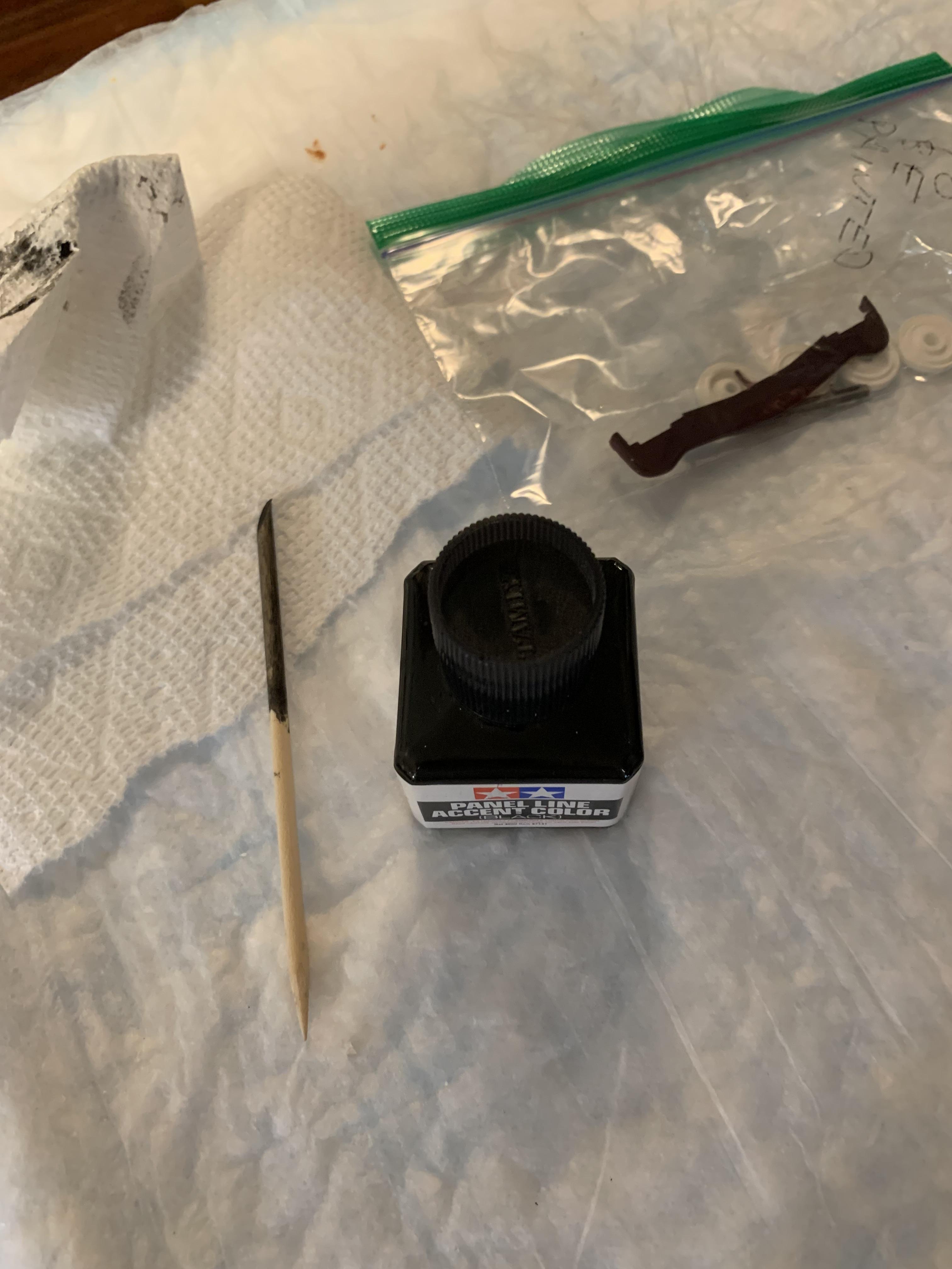

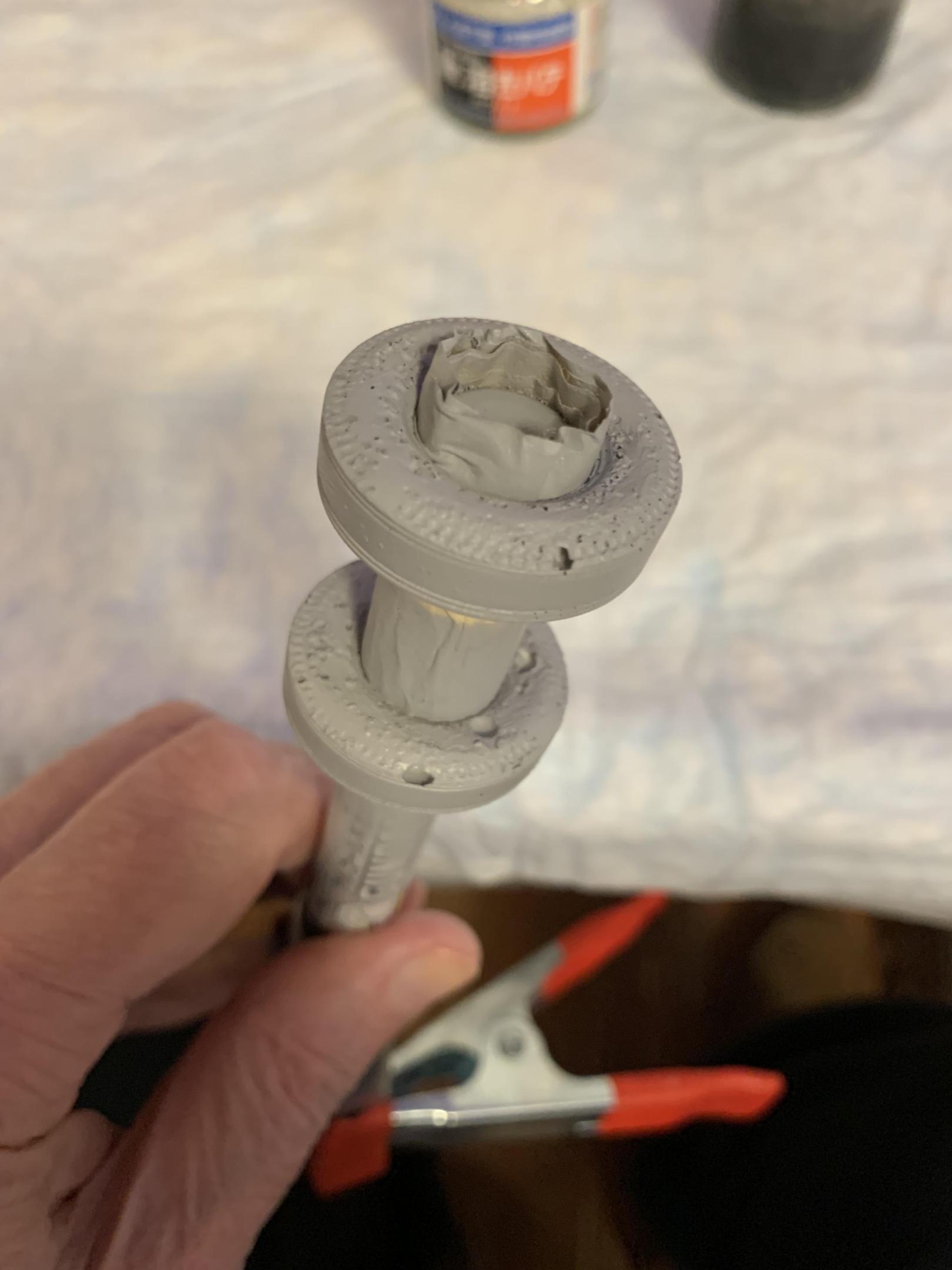

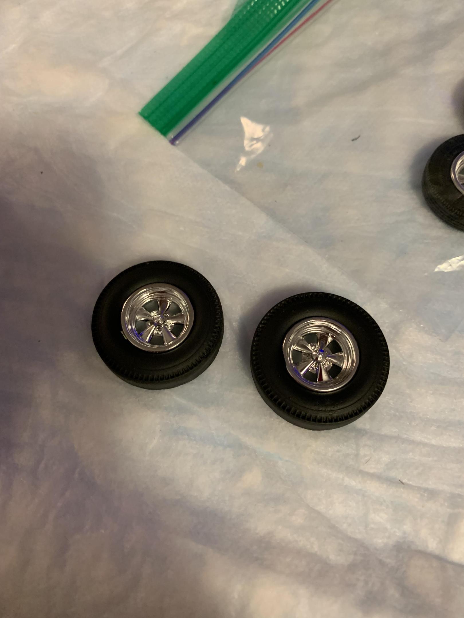

Due to my crummy casting job, considerable clean up required on one side of the tires.   I use this expandable rubber plug most of the time.  I noticed the Tamiya wash was extremely thin, so stirred it up with a piece of wood and gave it a turn on my paint shaker.  Much better.

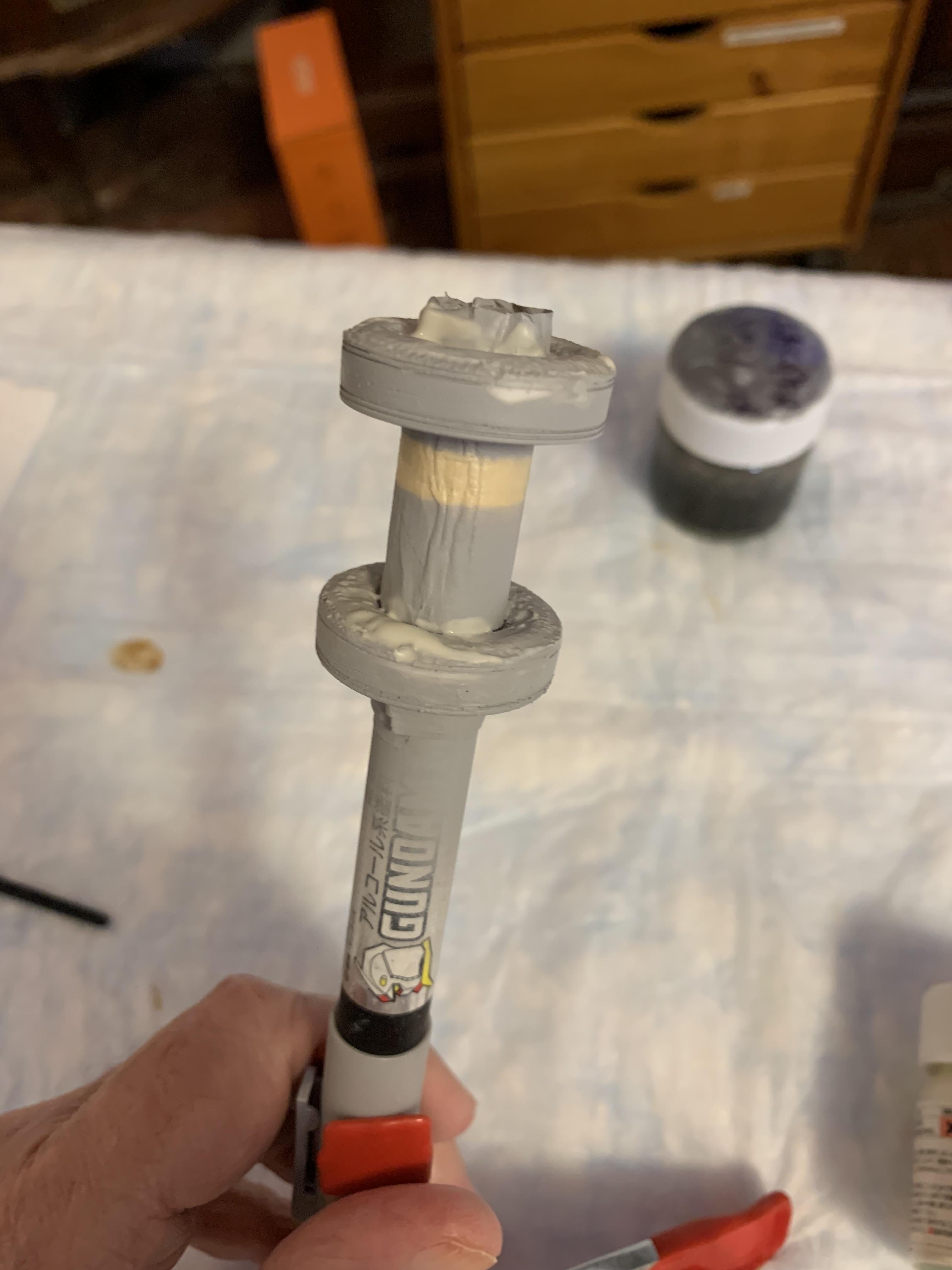

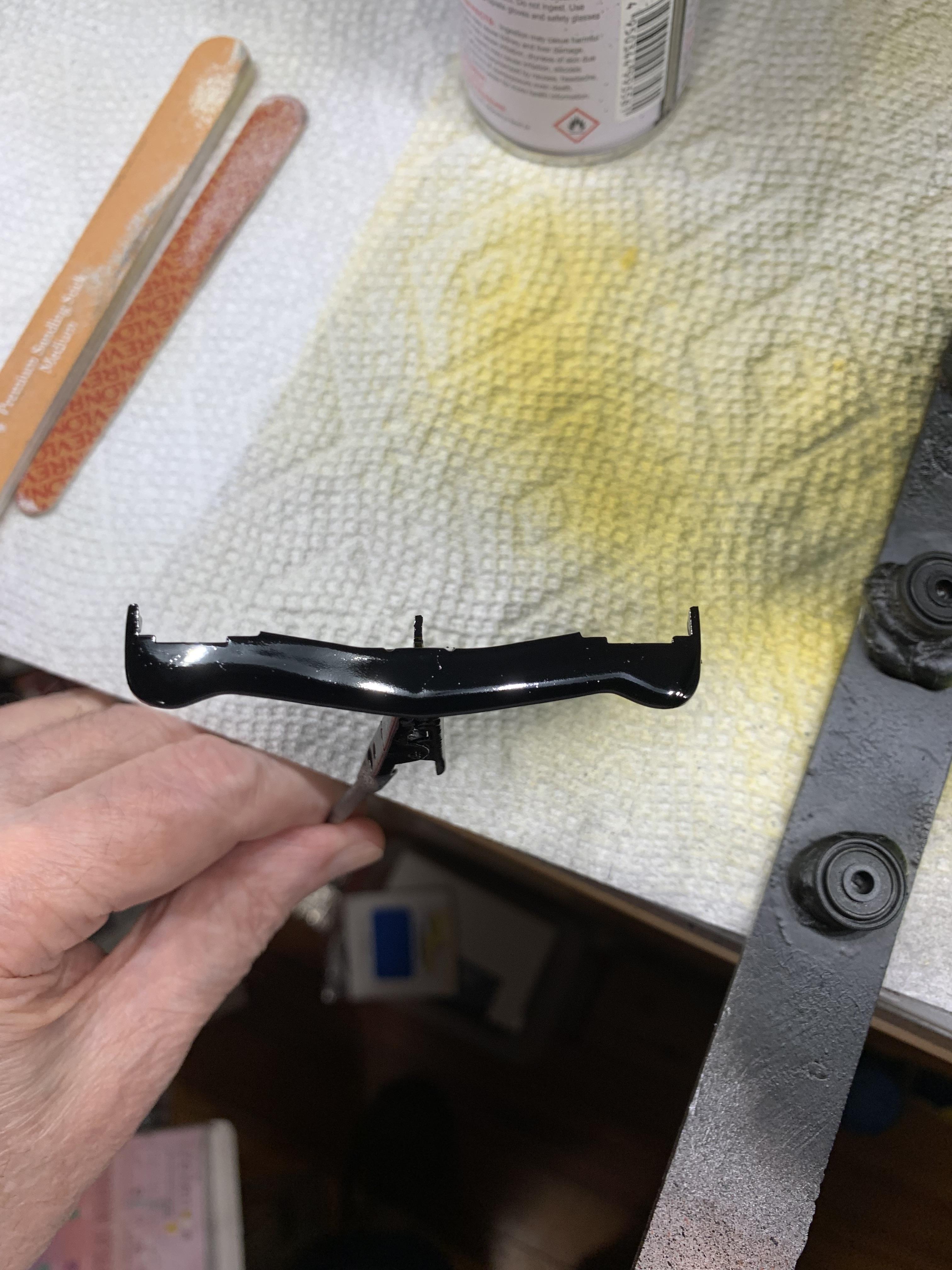

Made a tire holder out of a gundam marker and some masking tape, shot some primer to show how awful they look, then some Mr. Dissolved putty.  Painted the backing plates, traction bars, and bumper extension.

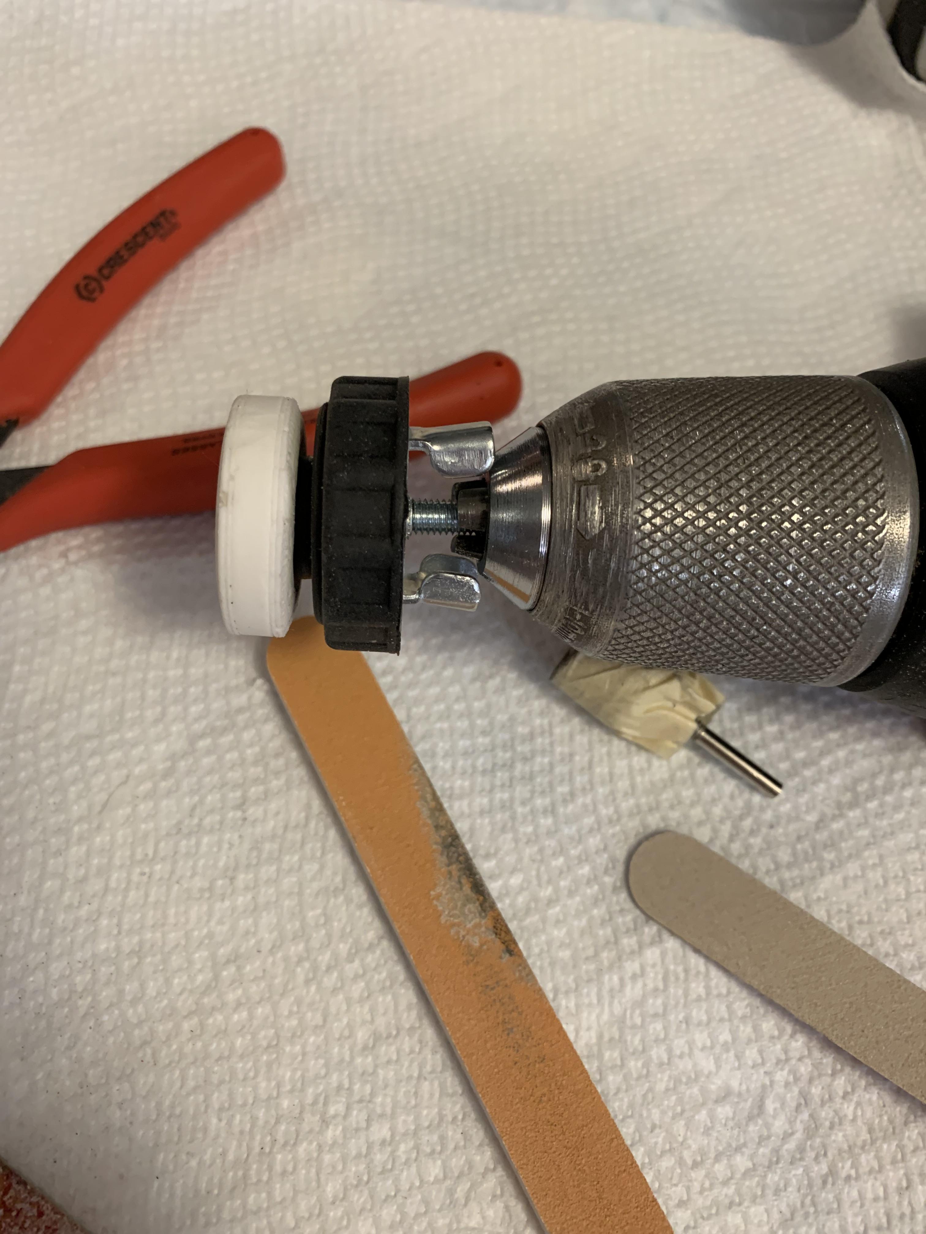

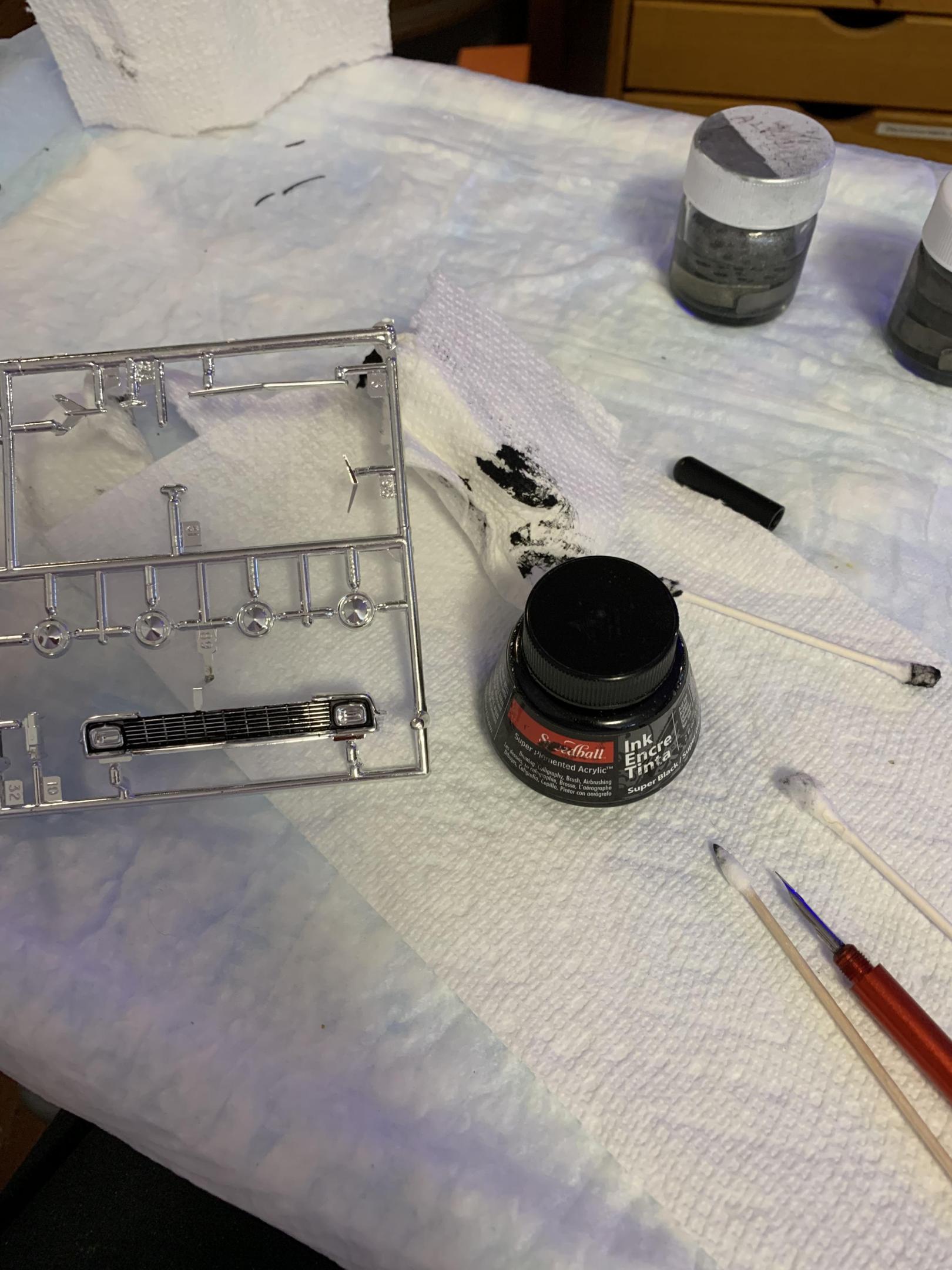

Sanded off the rear tires, then put some Tamiya putty on as there was some pretty deep gouges.  While that was drying, I put some ink over the Tamiya panel wash.  Looks better.

I love those headers - Thank you so much for showing the package. I need to check their products out !
Thanks.  Be advised, it took a while to get the headers (about a month, I think), as he doesn’t make them until he gets an order.

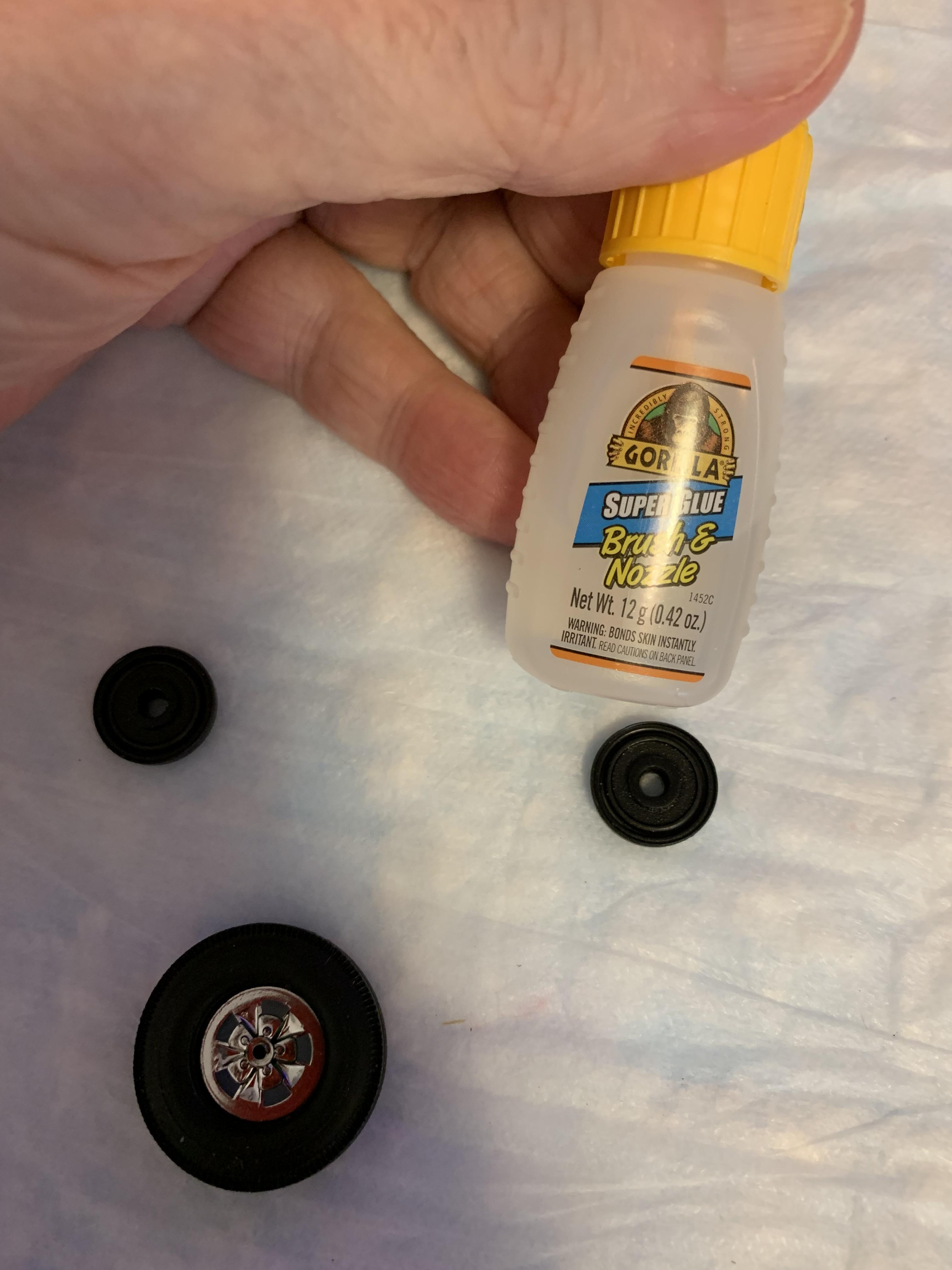

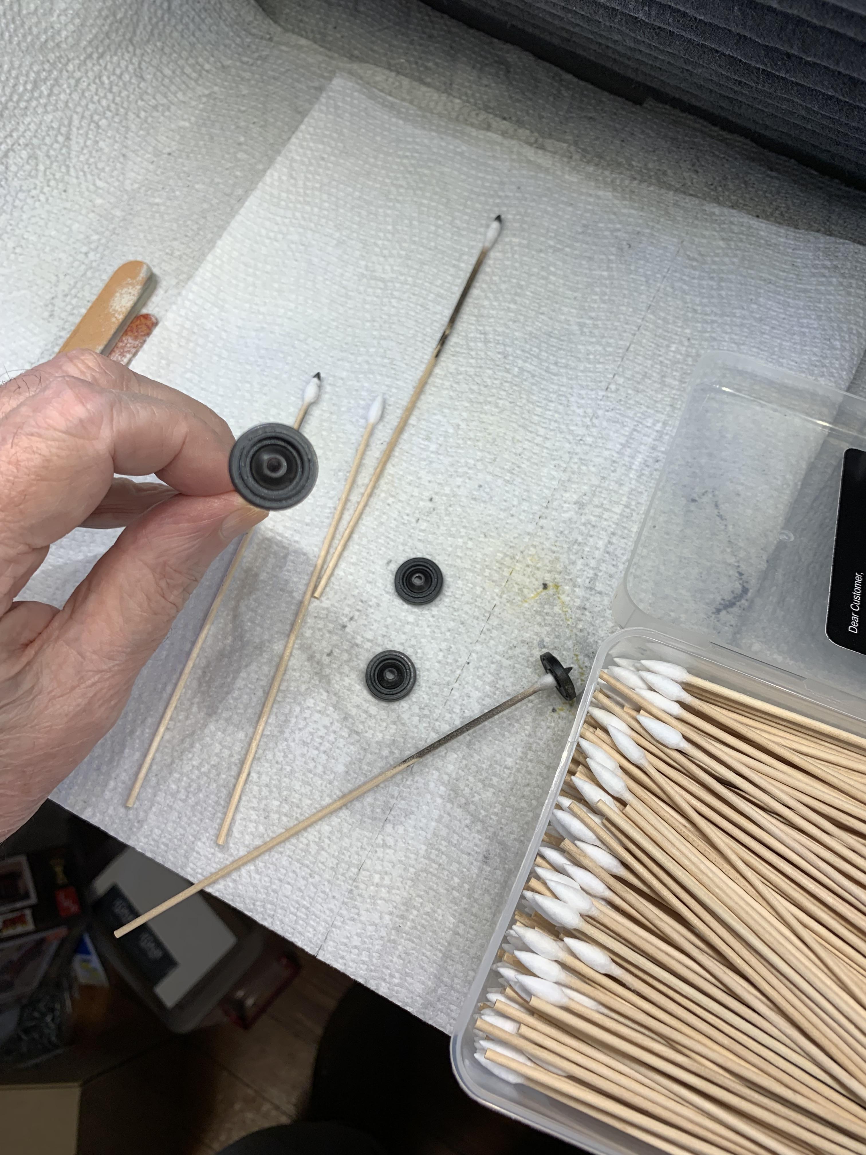

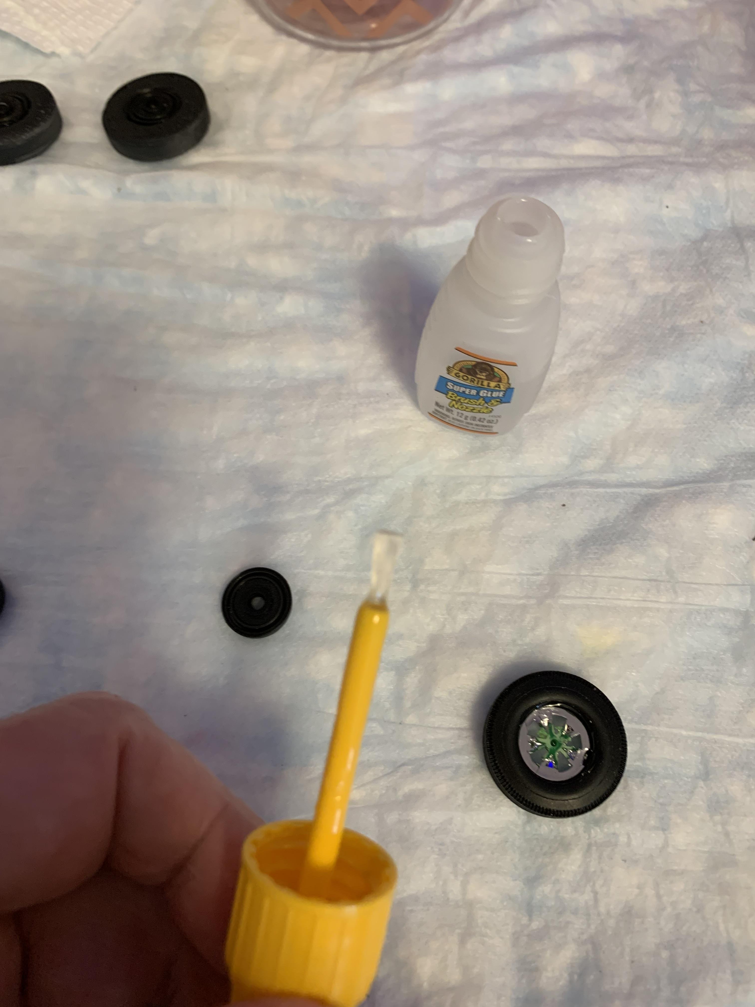

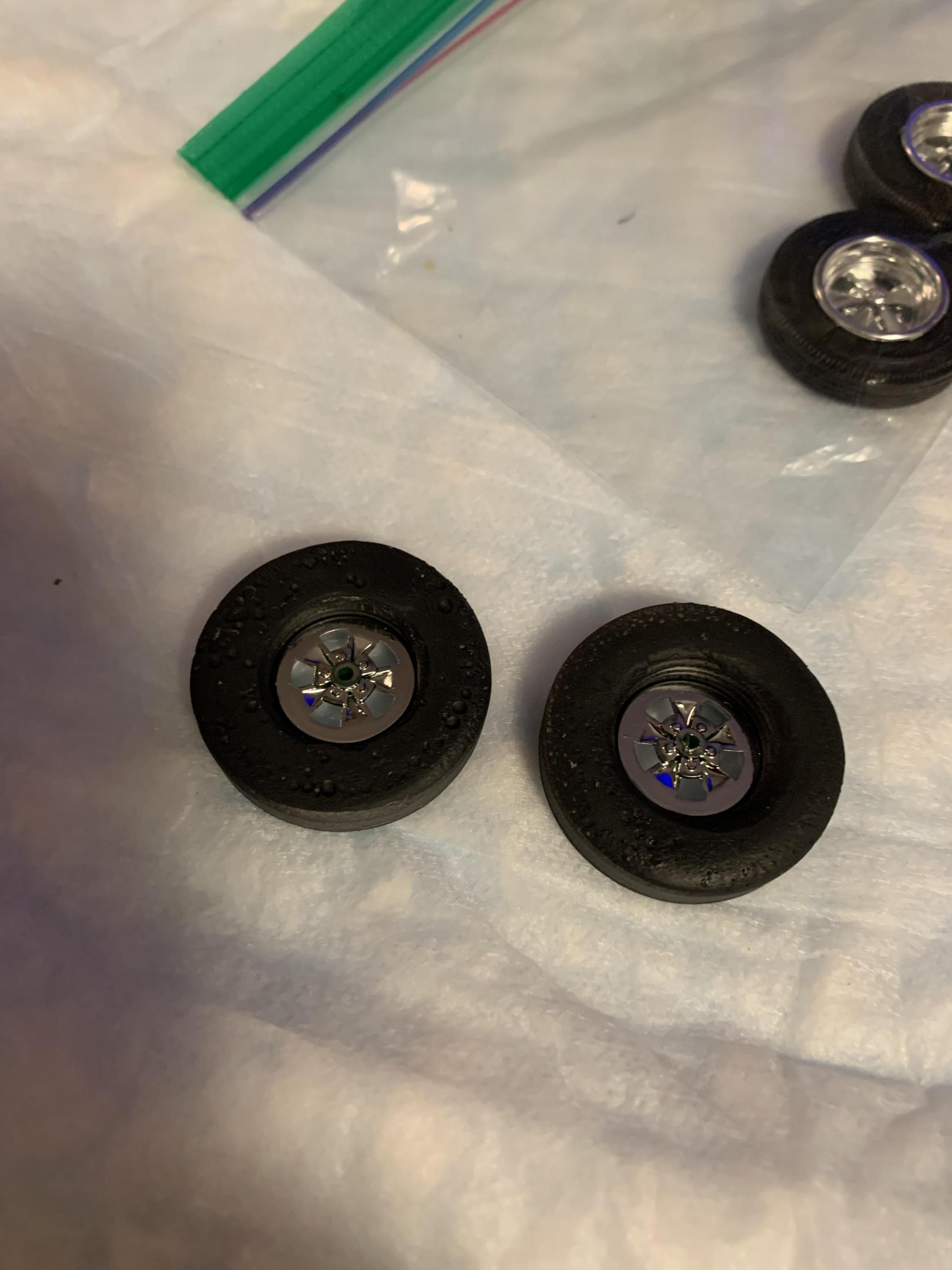

Shot the slicks (plus some extras) with TS82 Tamiya rubber black spray paint.  An interior pic.  Had to paint the other side of the backing plates, so decided to use these long wooden, tapered, cotton q-tips on the inside hub.  Worked pretty well.  Will try to remember that for next time.  Tried out the new Gorilla glue with the brush to glue the backing plates on.  I like it.
  • Like 1
I liked the brush on super glue so well I may try to scrounge up an empty Tamiya super thin cement bottle (and brush) and put some super glue in it.  Might work better than applying it with a toothpick or needle type apparatus.

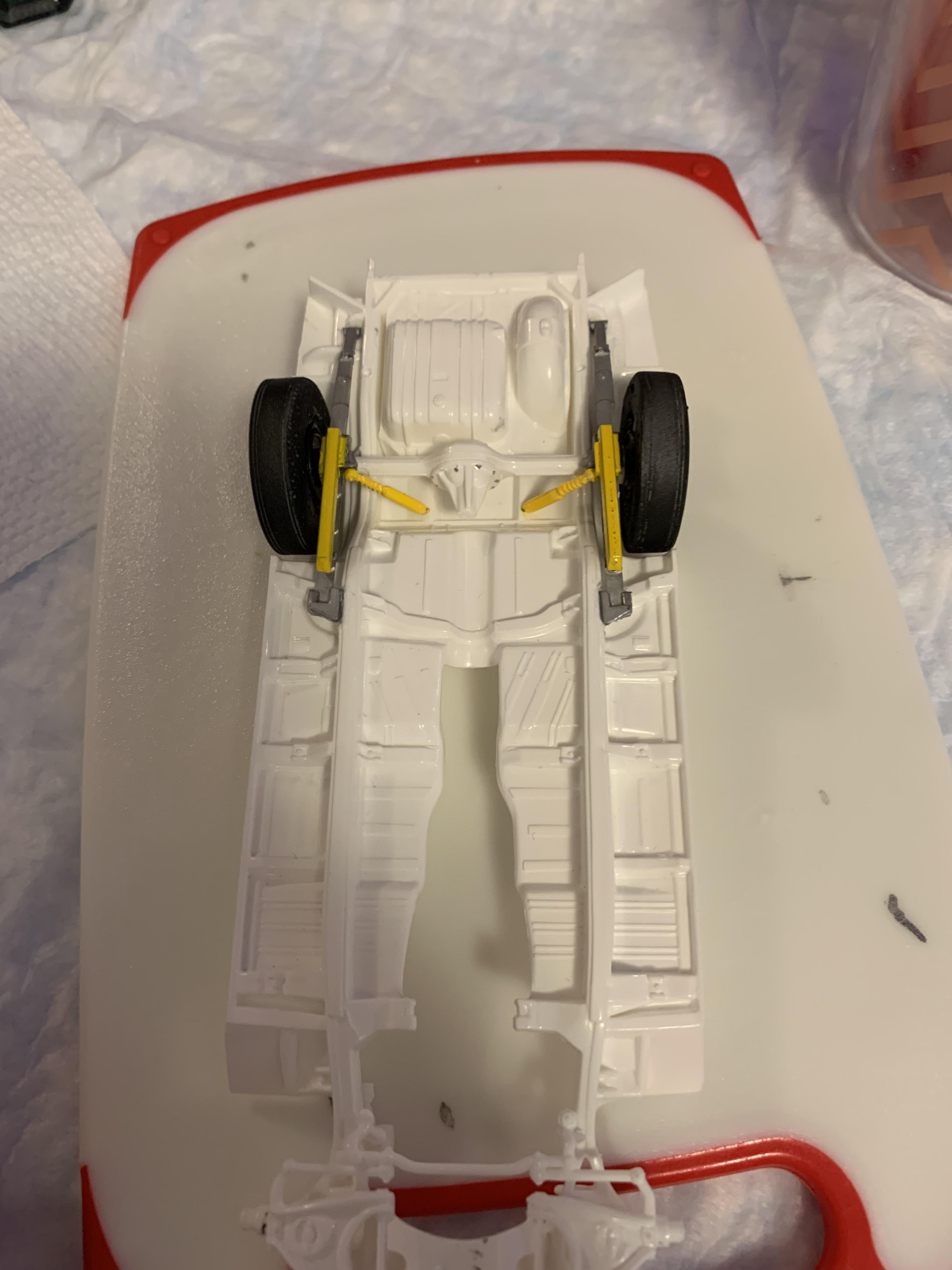

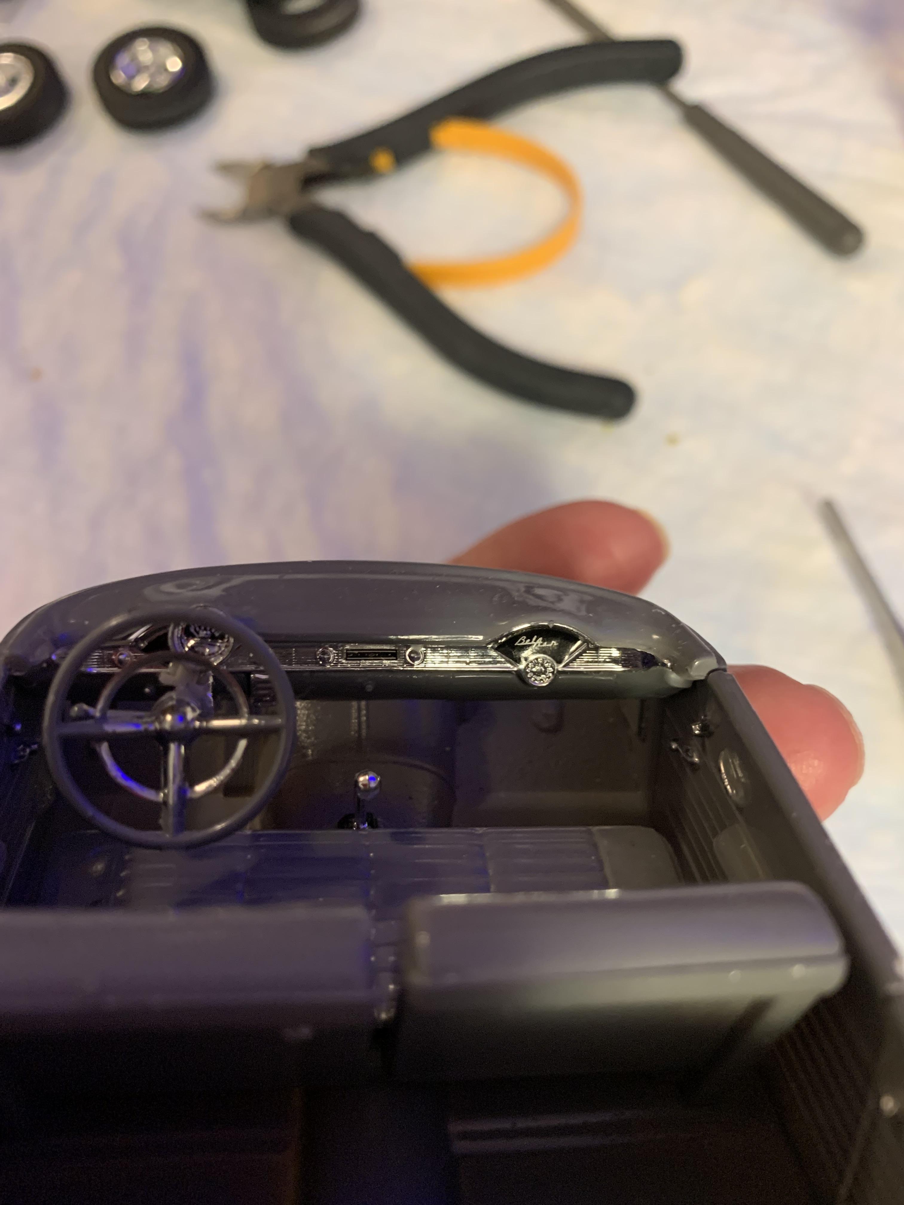

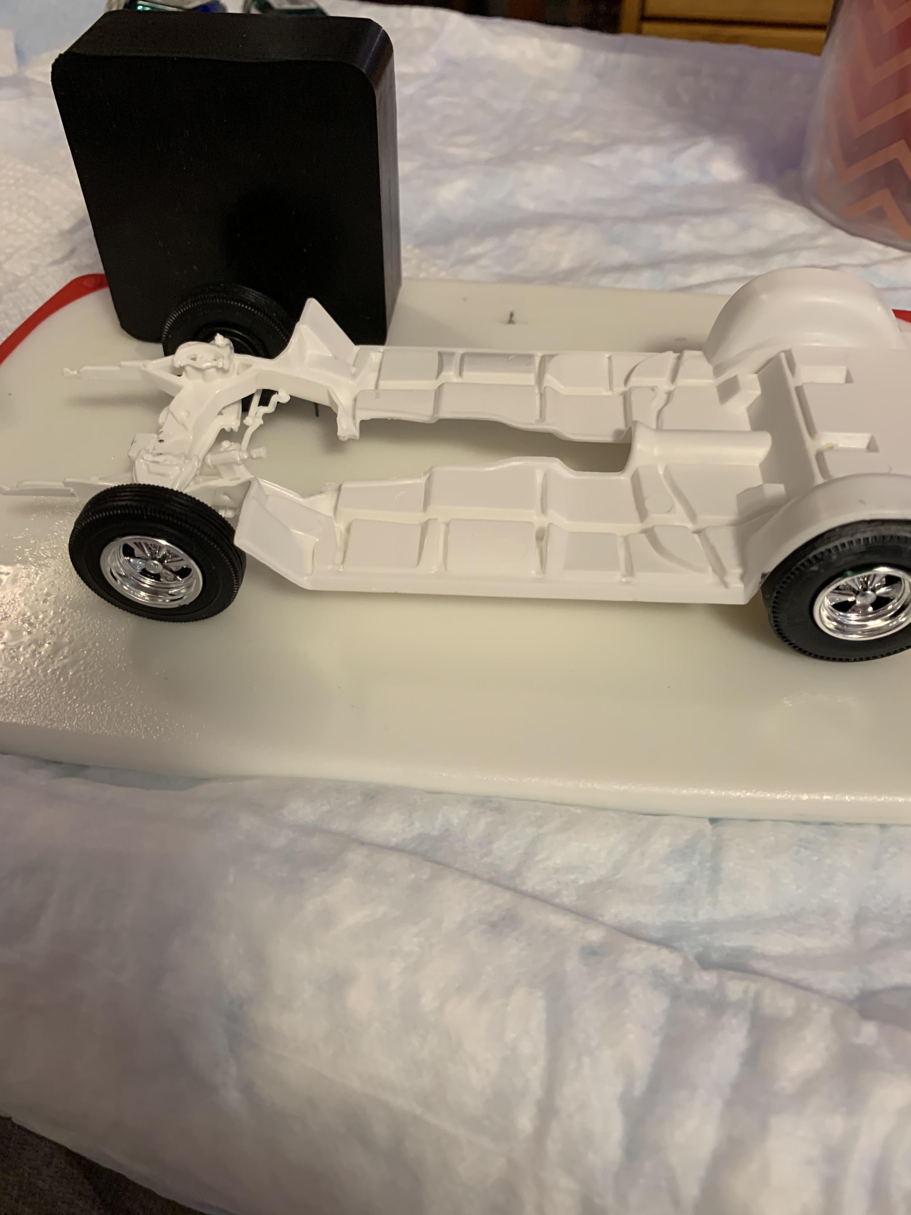

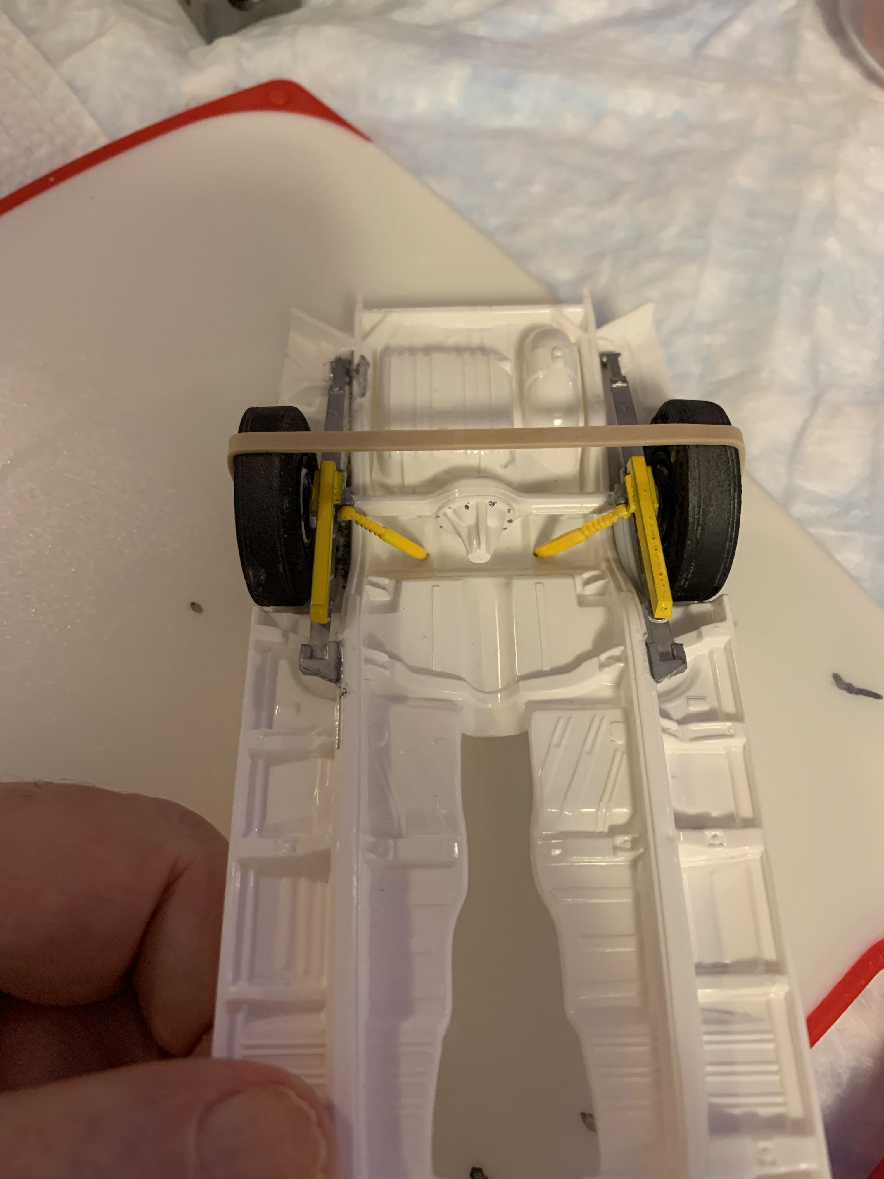

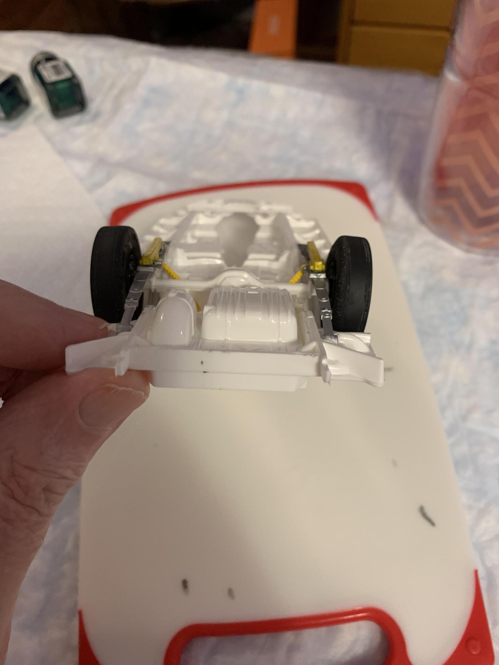

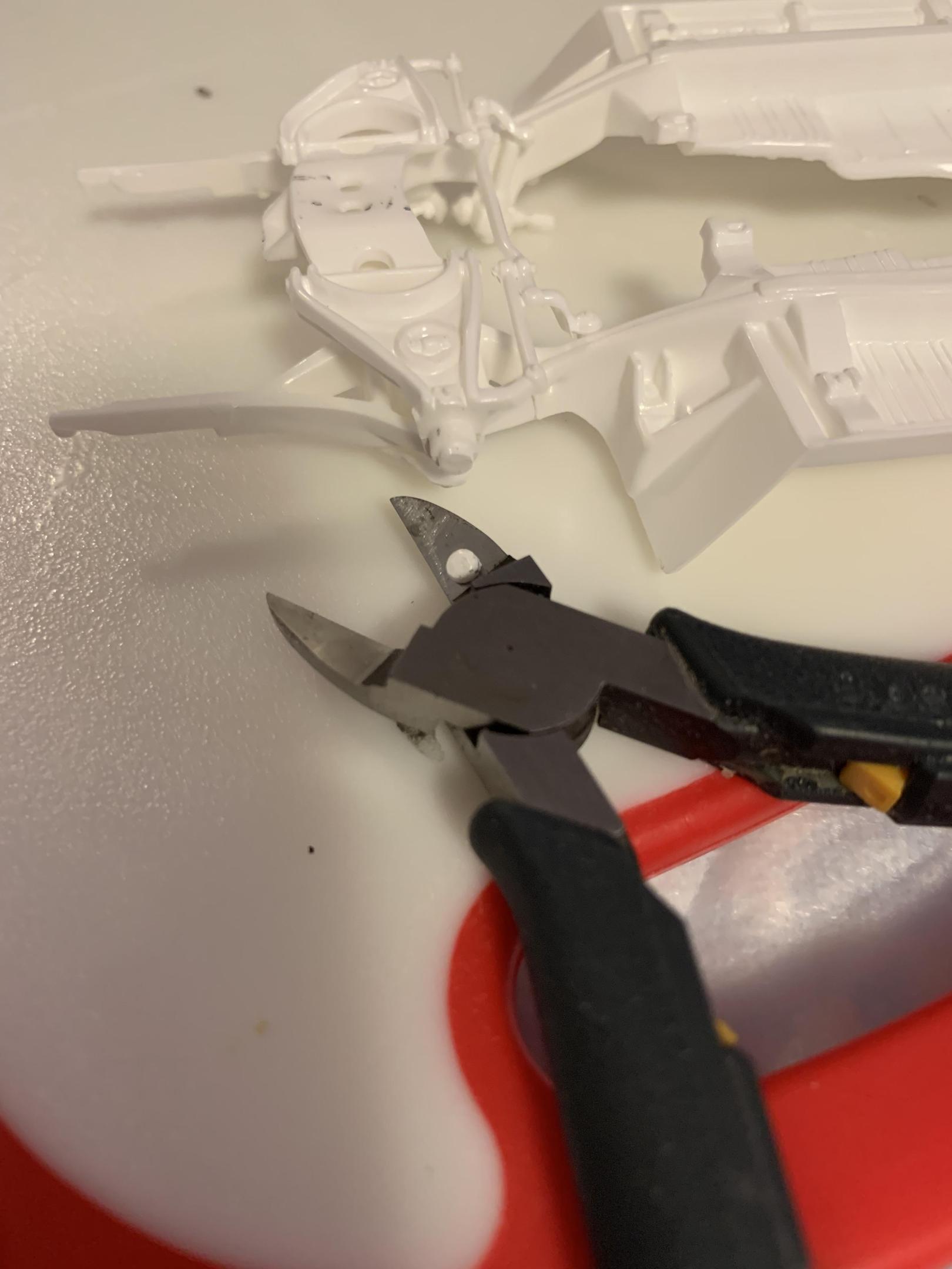

Well, I’m back at the 56 after getting stalled on the Firebird stocker.  Reoriented myself on this build (it’s been a couple of months), then installed the firewall after some cleanup along the mounting edges.  I installed the interior then and the chassis mocked up to see what needs to be removed in order to install the fenderwell headers.  Looks like the inner fender area behind the upper A arms will need trimming.

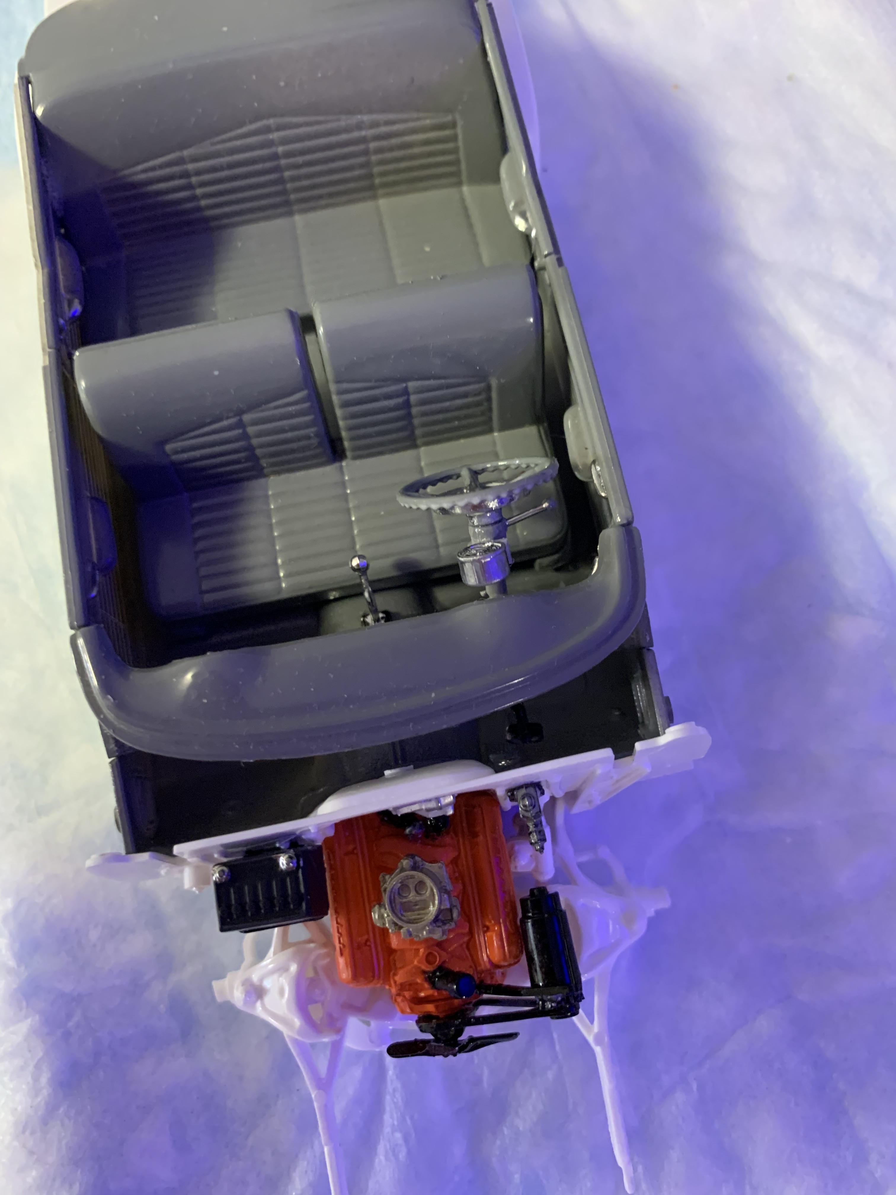

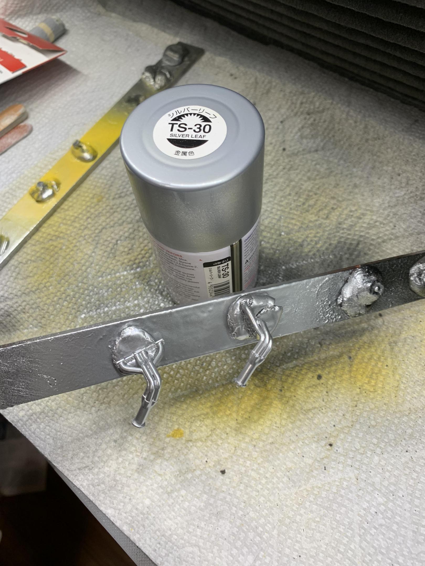

After another interlude, got a few things done.  Trimmed the rear inner fender wells for header clearance, made some rear engine mounts to raise the rear of trans to align with the rear axle, then super glued those and engine in place.  The activator in my new little jar helped, but I still managed to get some on the glue brush, making a large blob on the brush.  Oh well, I’m going to transfer the super glue to my empty Tamiya glue bottle tomorrow (another experiment).   Then snaked the headers in and glued them (tedious work).  Finally, used one of my new acrylic “brushes” to touch up some under hood spots.
