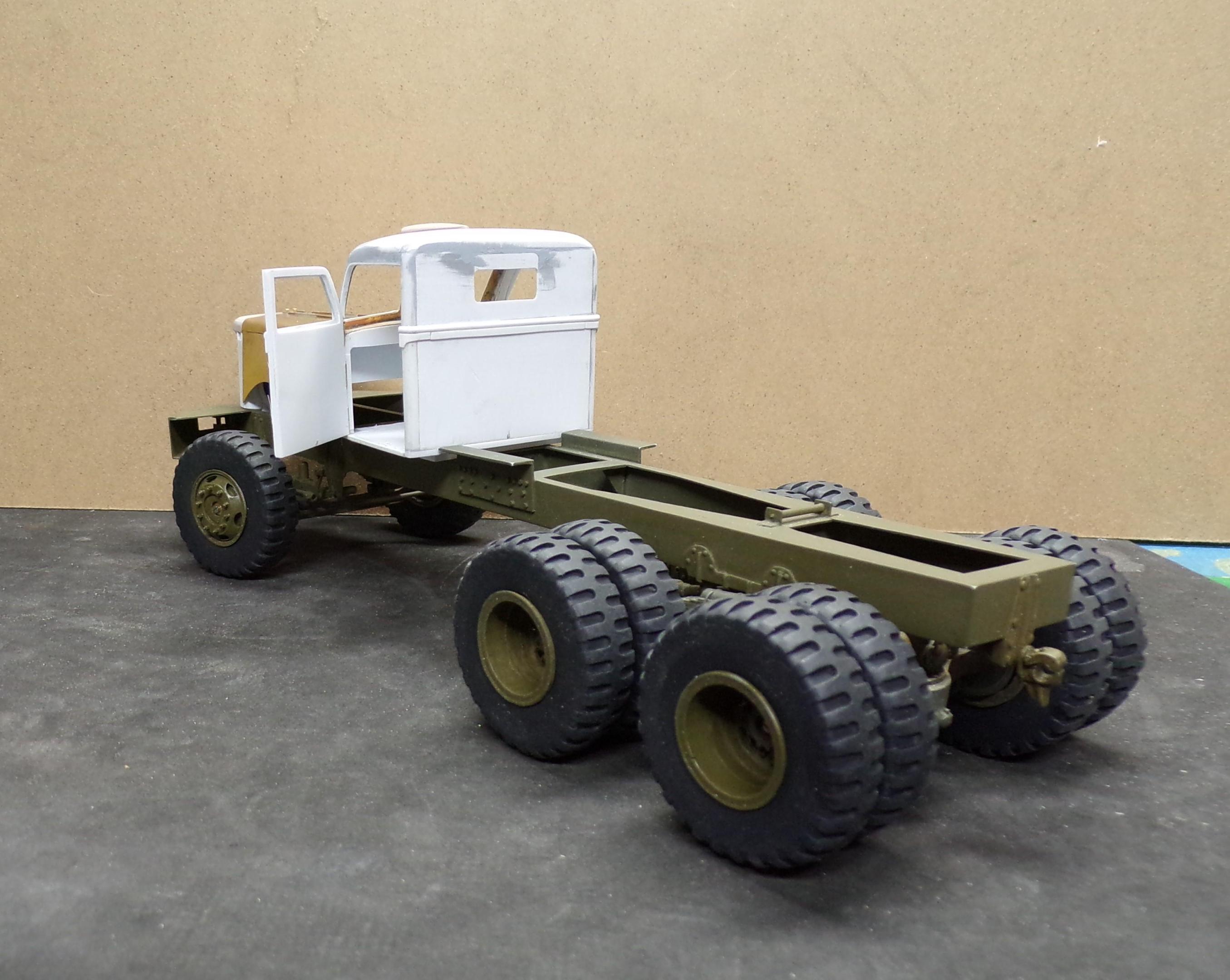

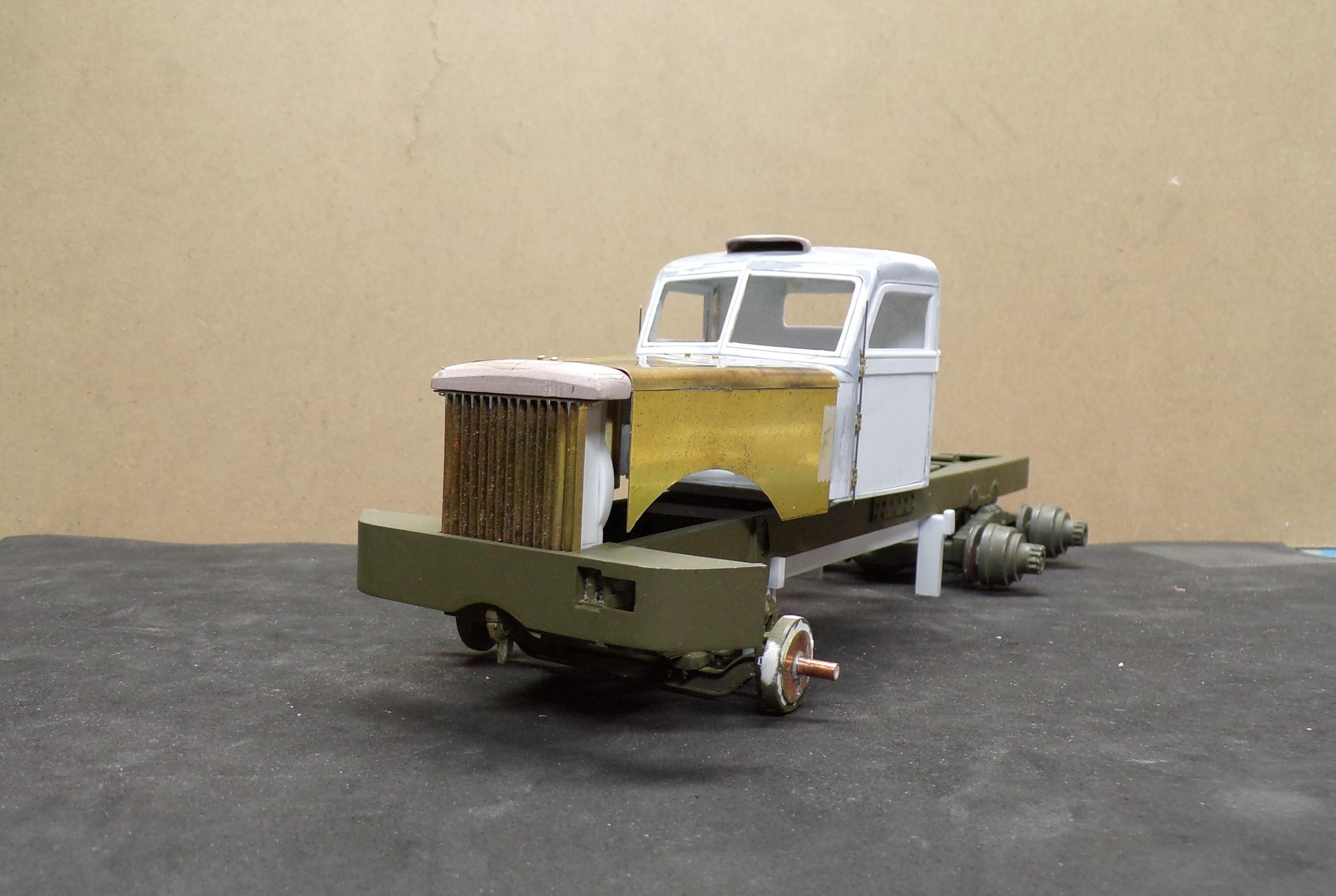

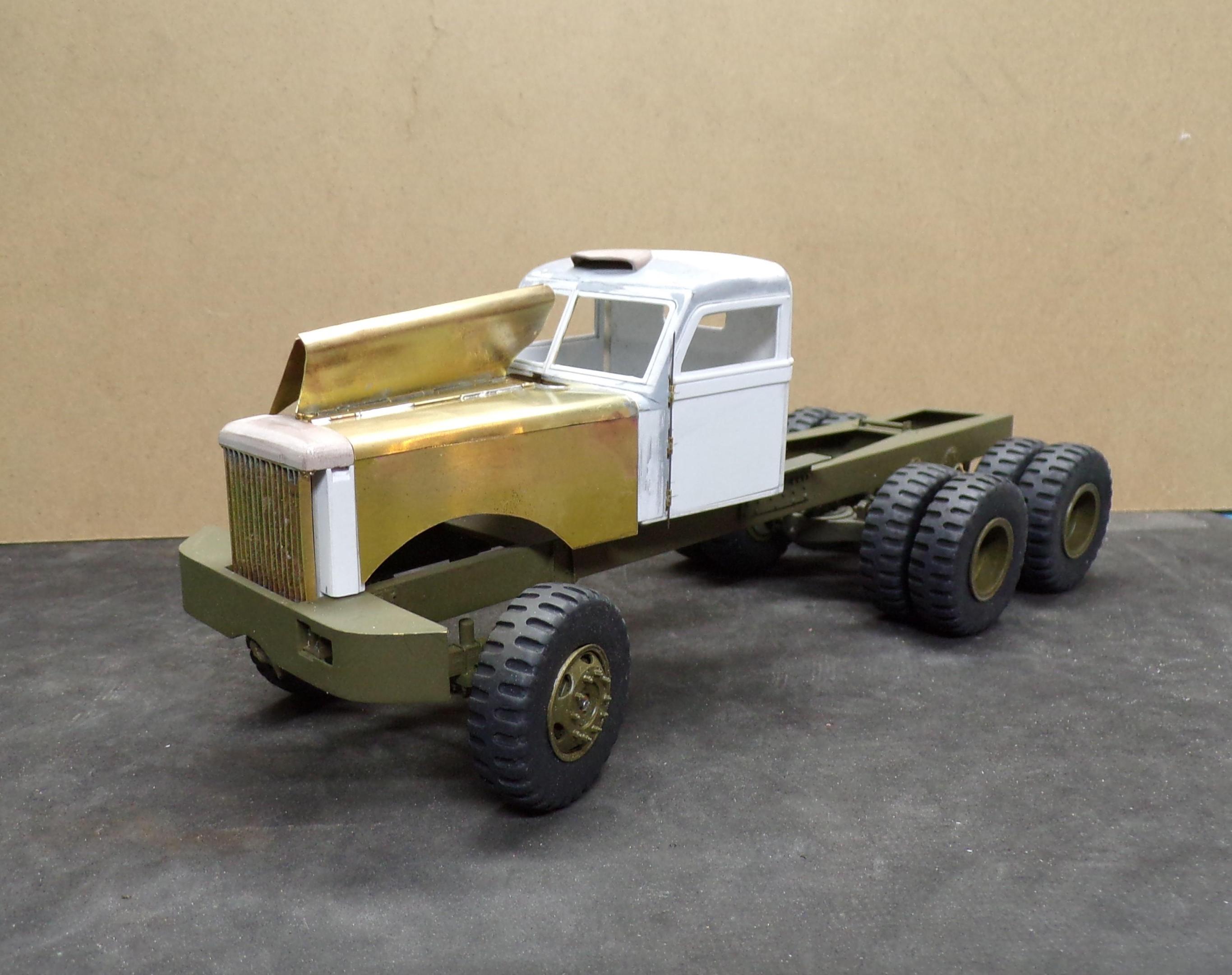

A quick update on the M-20.   Finally the radiator, hood and cab have come together.  I can now locate the cab precisely on the frame with the two screws that mate the frame and cab floor.  Still some tweaking to do on the hood sections and the hinges need to be added so it can be opened.  The doors are now fully hinged for opening and the cowl vent opens with a lever in the cab.  Radiator side pieces can now also be installed in line with the hood sides.027.JPG.6a0def532e04471ba4acf048cd36a94c.JPG028.thumb.JPG.ed0f87d1c15f678bf16c25f713f3e04f.JPG029.JPG.5a77a0c63f3014c9efaa406b06c78c51.JPG

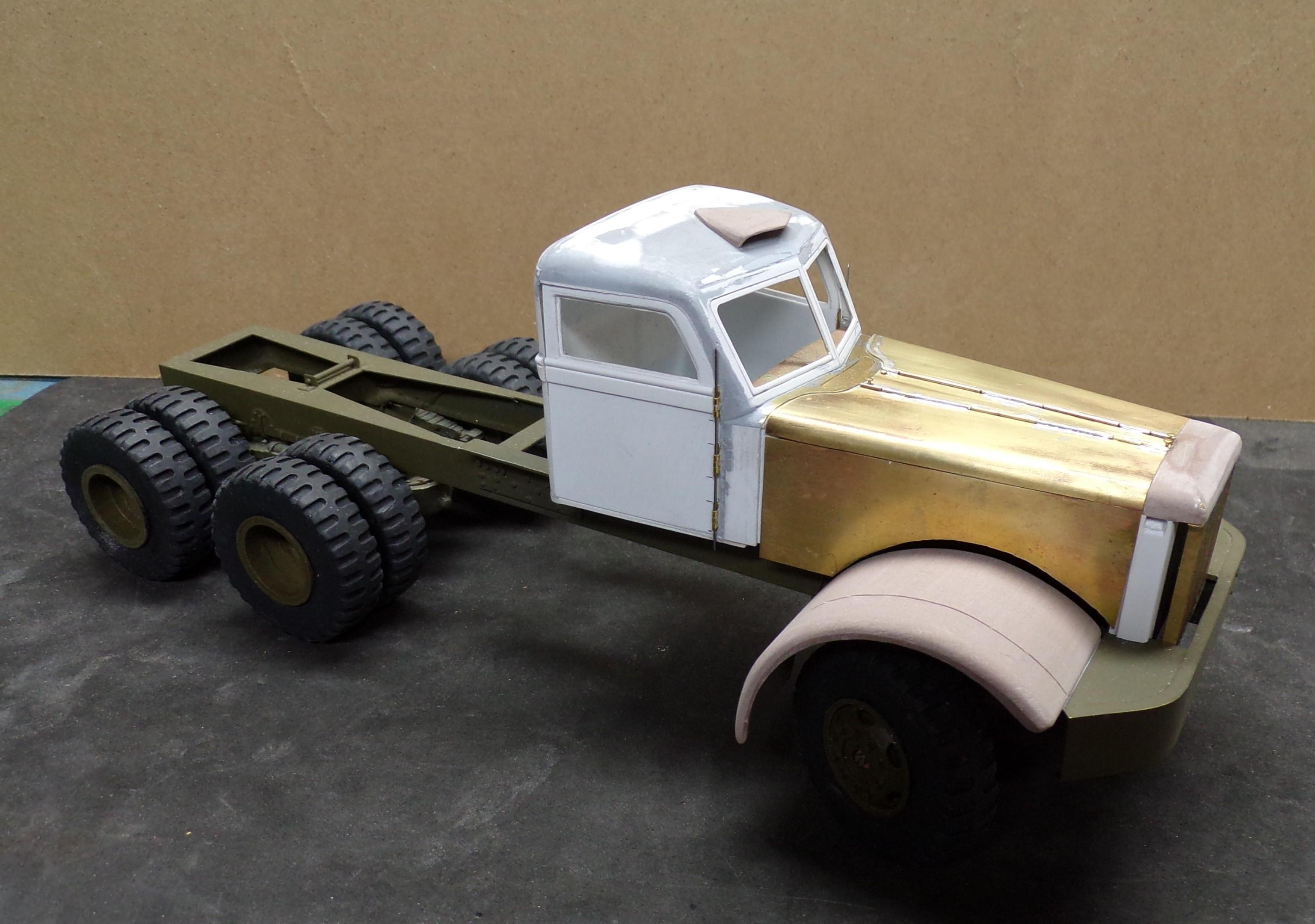

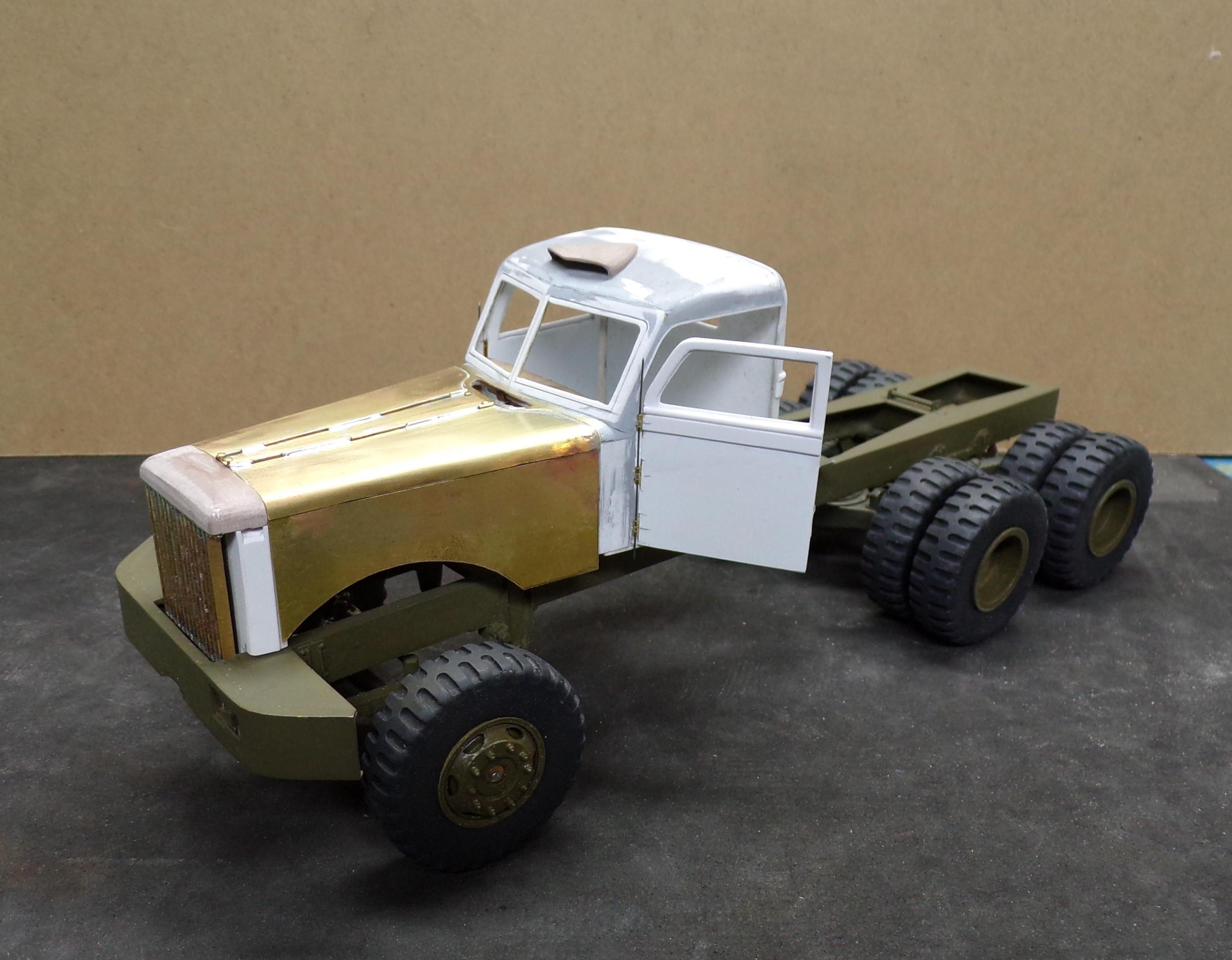

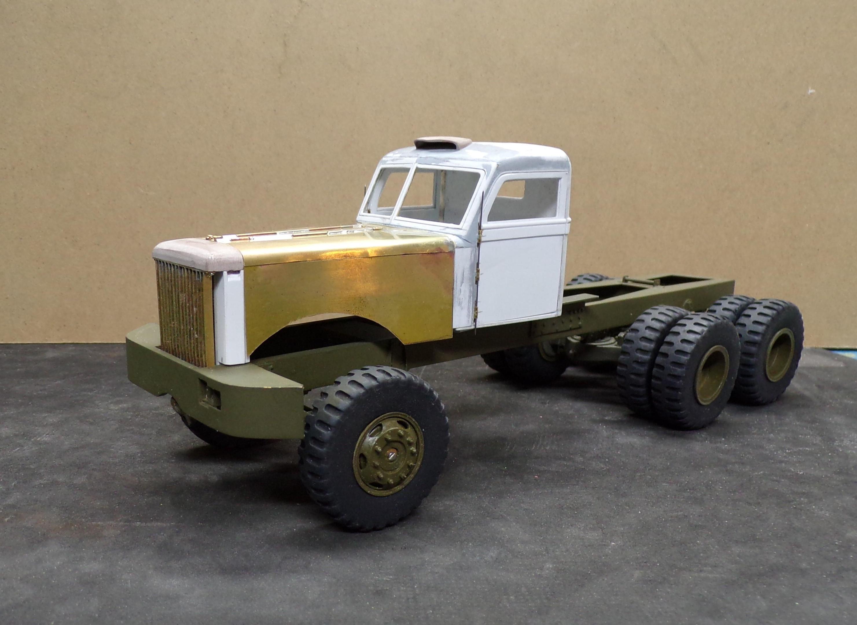

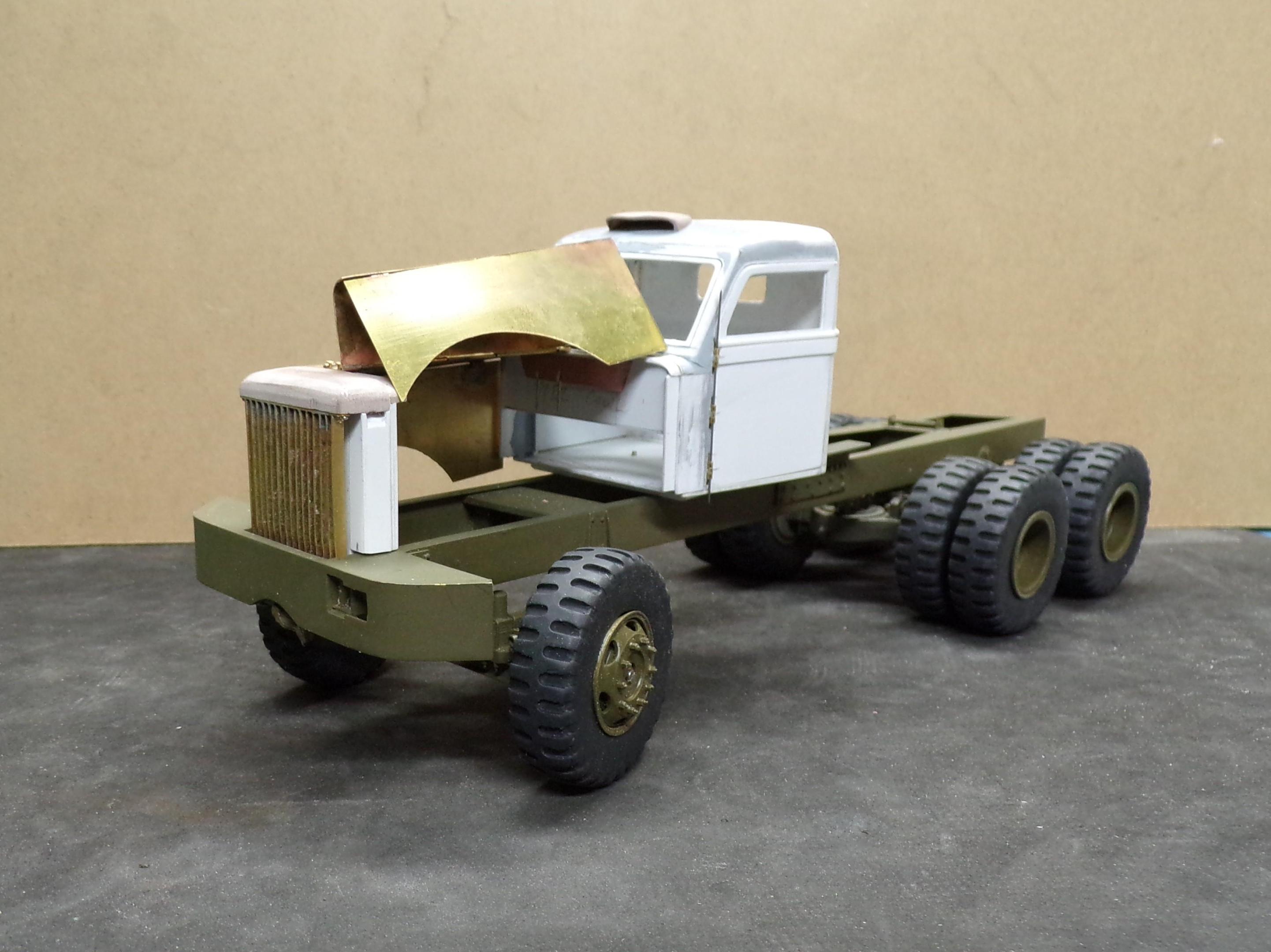

Got some real work done for a change.  The radiator, hood and cab are now where they need to be.  The 4 hood pieces and the center section are all hinged to open.  Pins at the front and rear of the center section connect the radiator and cab.  Tires and wheels are now painted and installed.  Beginning to look a bit like a heavy duty truck now.

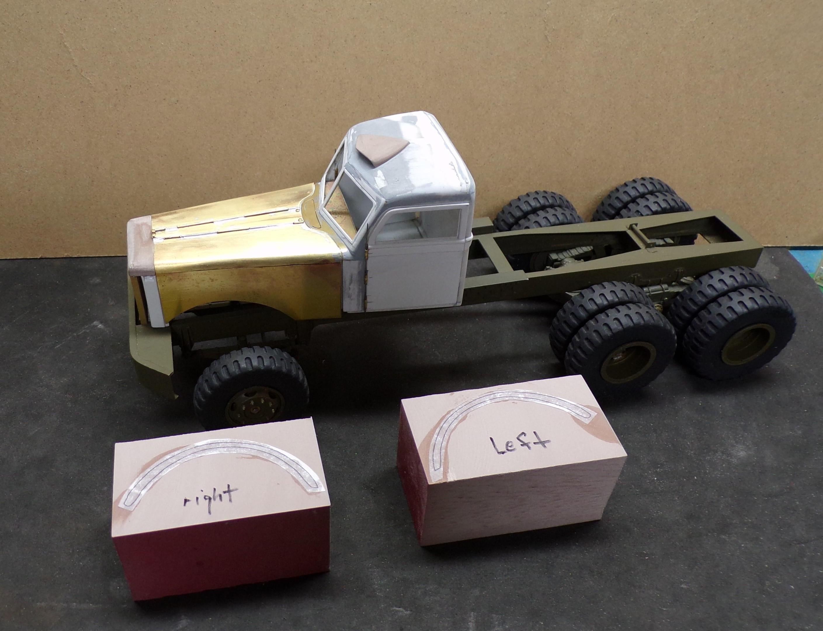

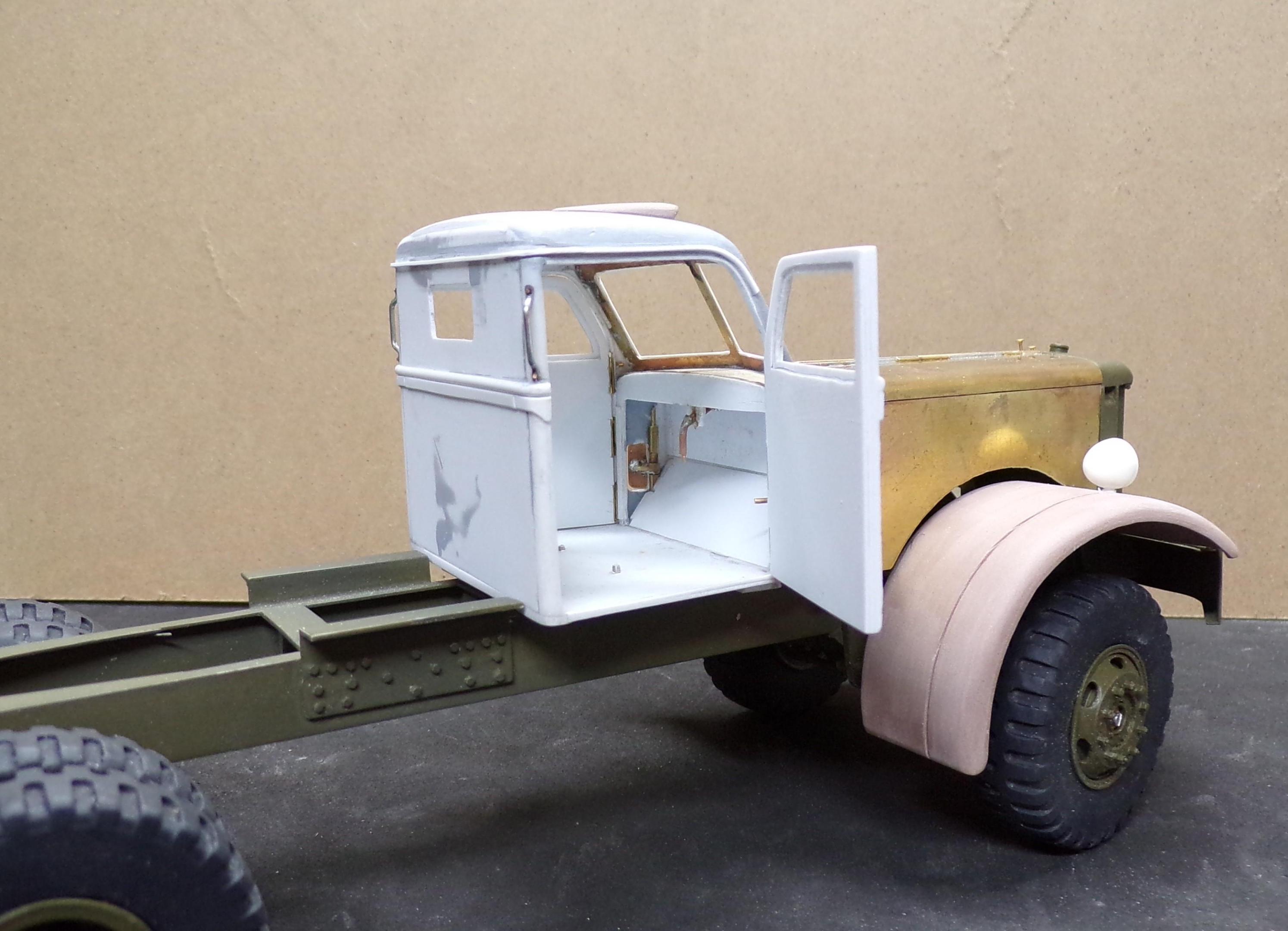

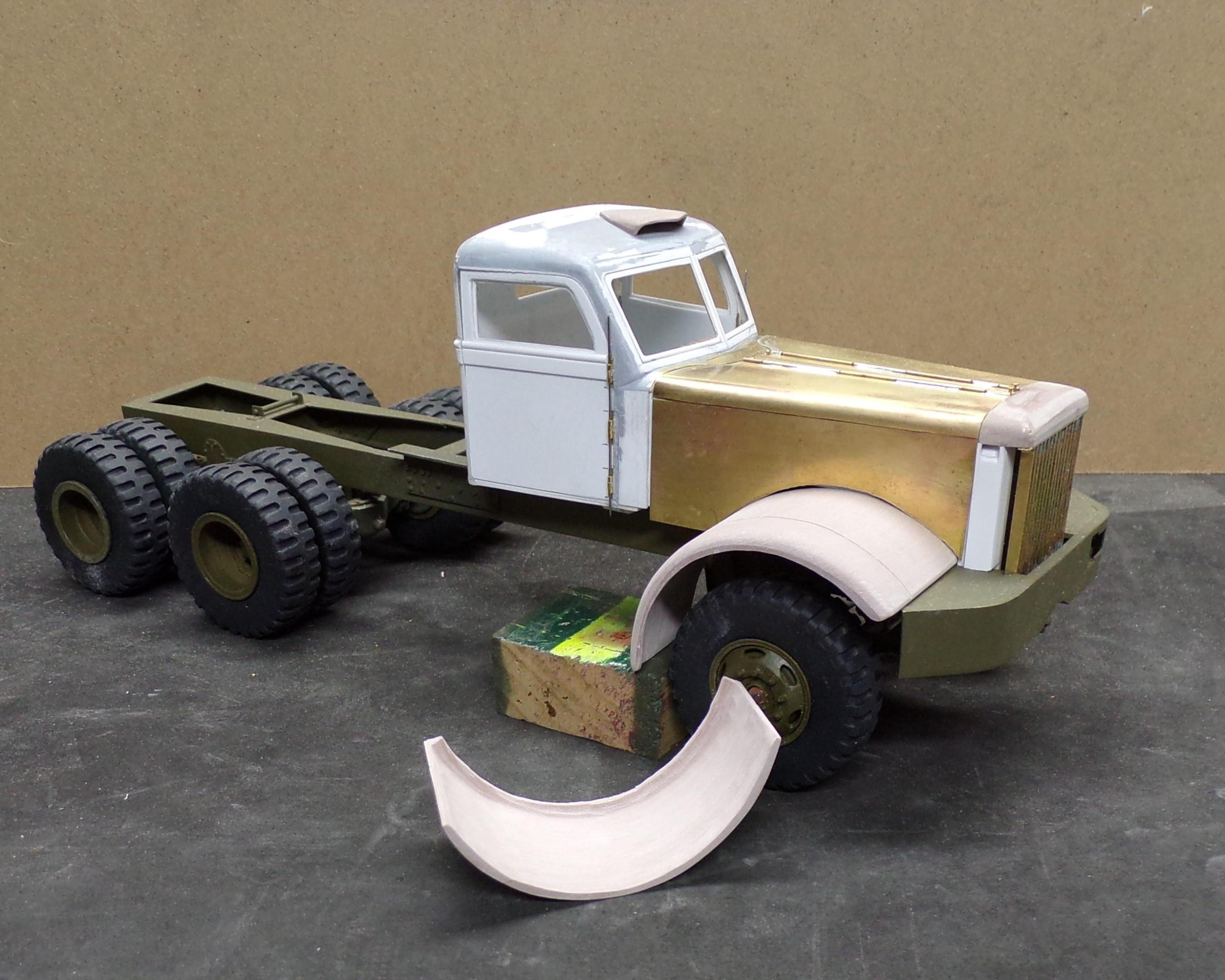

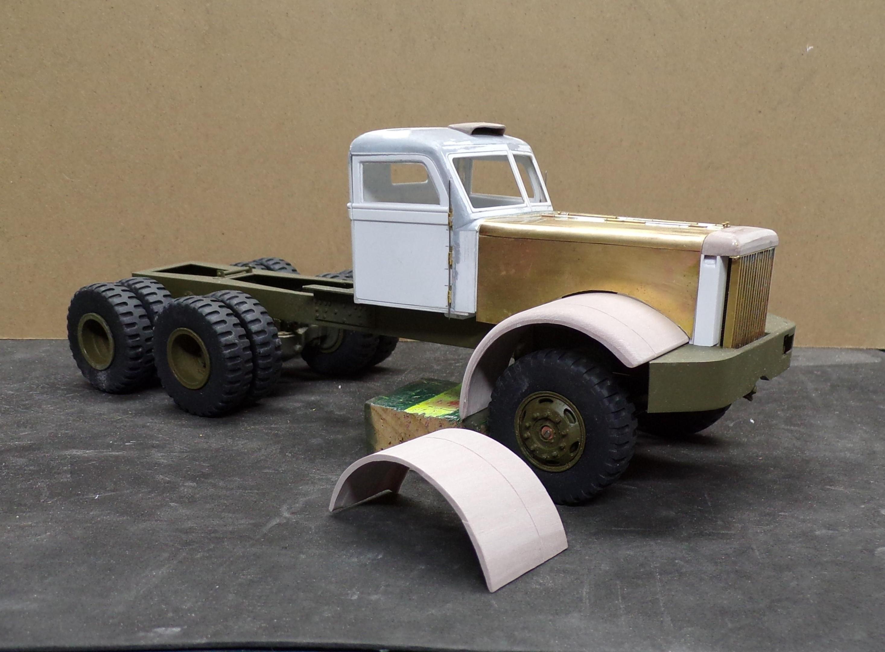

Work commenced on the fenders today.  To start a fender outline was prepared and glued to the face of a block of Renshape.  One for left and one for right.  A bandsaw was used to get close to the top line of each fender and to rough cut the material from the bottom.  Then a disk sander was used to smooth out the top surface.  Next was to scribe a line front to back for the two sections of the fender.  I used a sanding drum in my Dremel to sand away the rough underside and to create a lip at the edge.  With this done the edge was sanded round by hand.  The right fender is done.  The left one needs the edges rounded off.
 I had to trim the curve of the hood side some to better fit the fender contour. Little things like this are almost a given in scratch building.100_0685.thumb.JPG.6308fd770c689e040b26b9562980207a.JPG100_0686.thumb.JPG.81f166e8ea4e6b72914bdd9b19d9b1b6.JPG100_0687.thumb.JPG.cfb35846f6bd84241e32660e07135a7e.JPG

14 hours ago, Randy D said:
Hello Charles,  Your metal work is just amazing !!  Those fenders are coming out great.
Randy
Hi, Randy.  Thanks for the compliment.  Renshape is wonderful stuff to work with as well.  Easy to carve, easy to sand, it's strong, glues up well with CA and takes paint very well after primer.

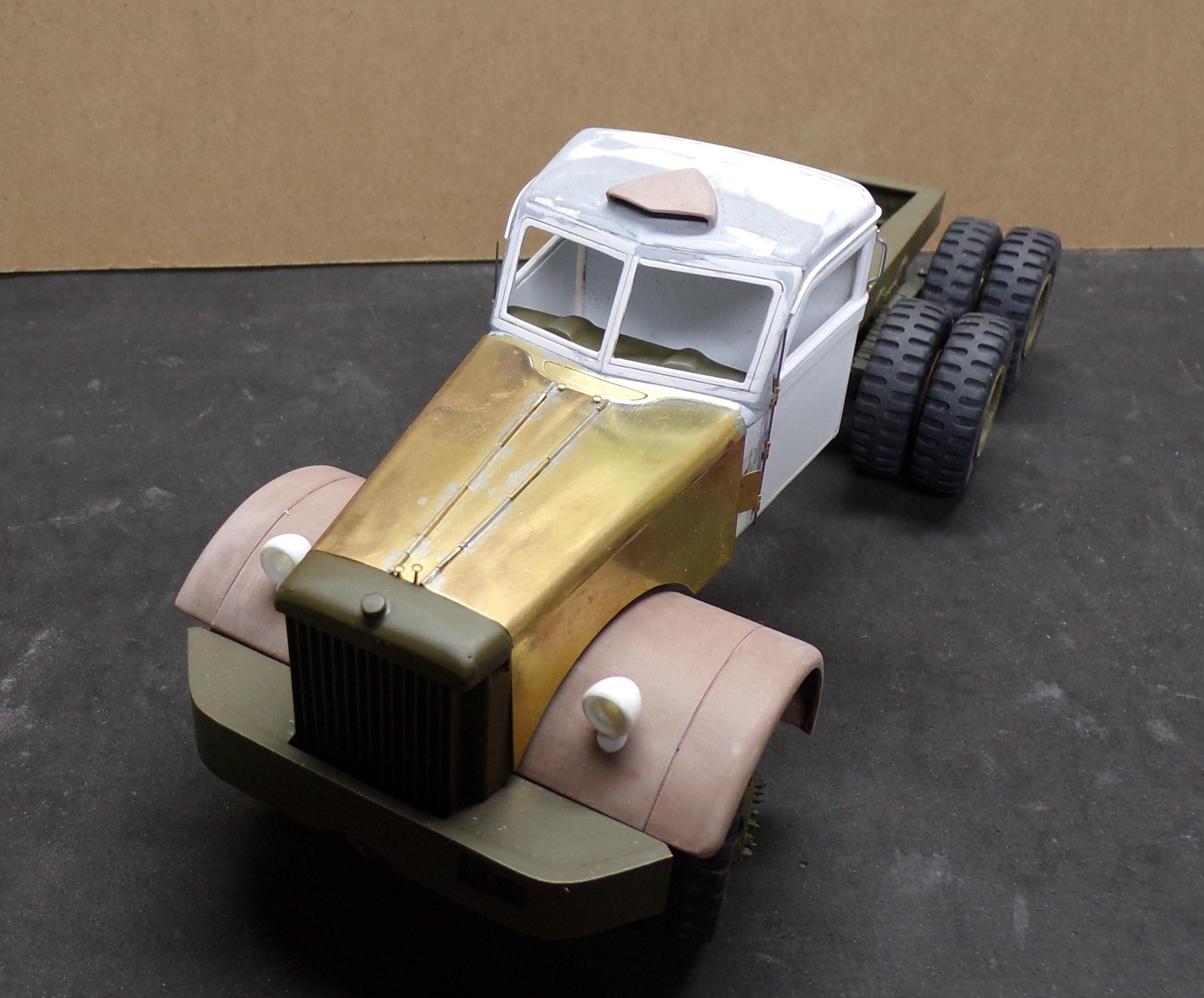

Fenders are mounted temporarily.  A piece of brass strip stock was used for a bracket that bolts to the frame to hold up the top rear of the fender.  The front sits on a thin shelf glued to the underside of the bumper.  I need to add a stiffener to the bracket to keep it nice and square.

Wow, such wide fenders, I thought metal was in short supply during the war. Guess they didn't fuss over aesthetics, either, LOL! Quite impressed with your quadruple-hinged hood, a whole lotta work in that one, a great detail faithfully replicated, kudos!
Same comment from someone on the other board about the wide fenders.  Specs say 100 inches overall width.  From all I can tell it was straight from front to rear and it's good to remember that this is a 45,000 lb vehicle without a load!  It's big!

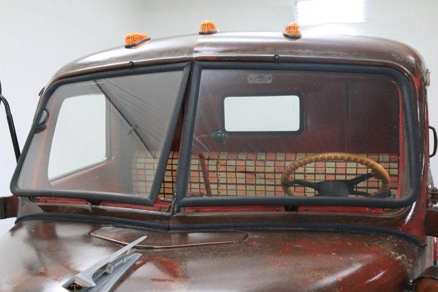

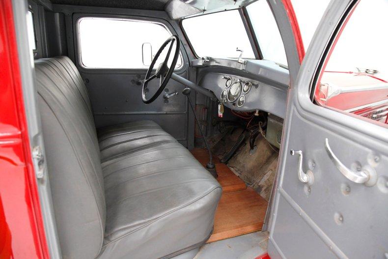

On that other board I saw you mentioned raised portions on the upper dash and I may have a reference photo or two for your consideration - to me they look like tunnels for the front windshield winders. Not used on military units to save costs, maybe

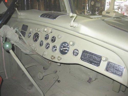

That last photo is quite like the dash that is in the military version except for the windshield cranks.  The way the military opened the windshield was by the use of knobs and slotted bars that were attached to the cab A posts and the center windshield post.  The other difference is in the gage layout and the number of switches used on the M-20.  Thanks for posting the pics.  They help clear up what is not mentioned in the publication.

I like how the military version has gauges spread out all over the dash! then there's a map light at the top, looks like yet another knob

I found out that the hood only is hinged at the top and not at the sides, even though every photo shows a clear line of separation.  So I have to put in some interior braces to keep the sides from folding.  (wasted some small hinges making them fold!).  Every time there is a new learing curve!!?
