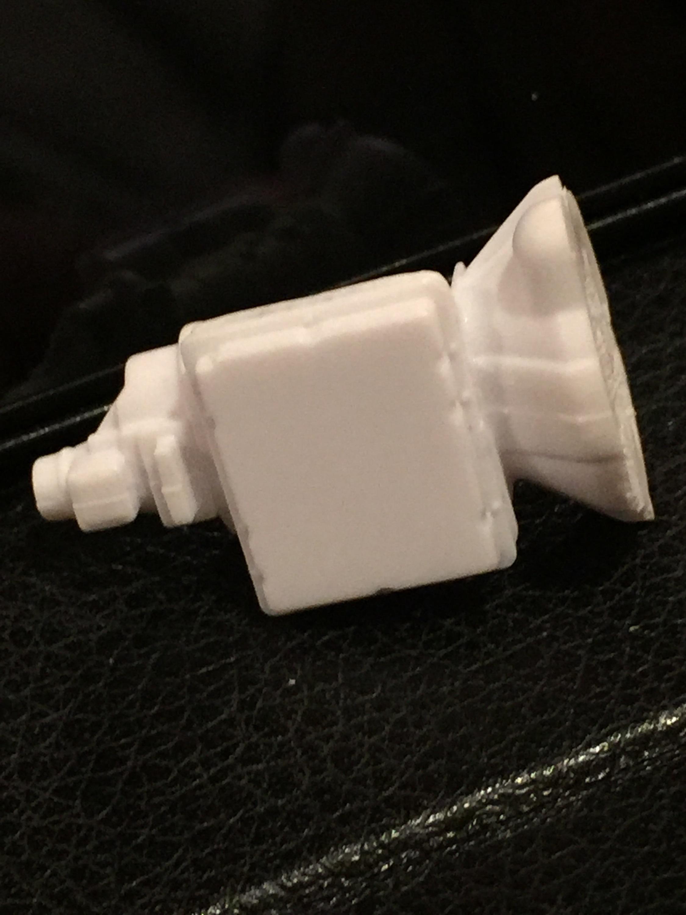

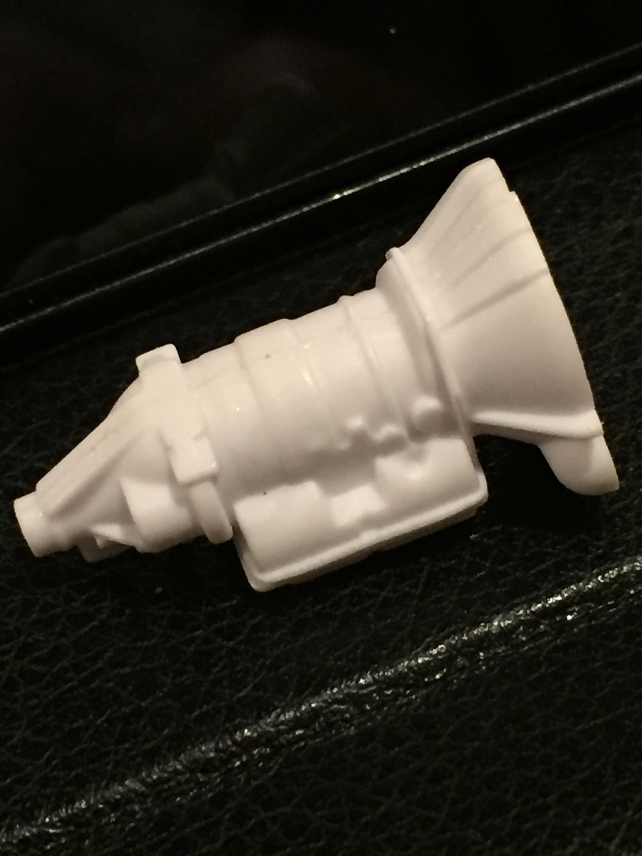

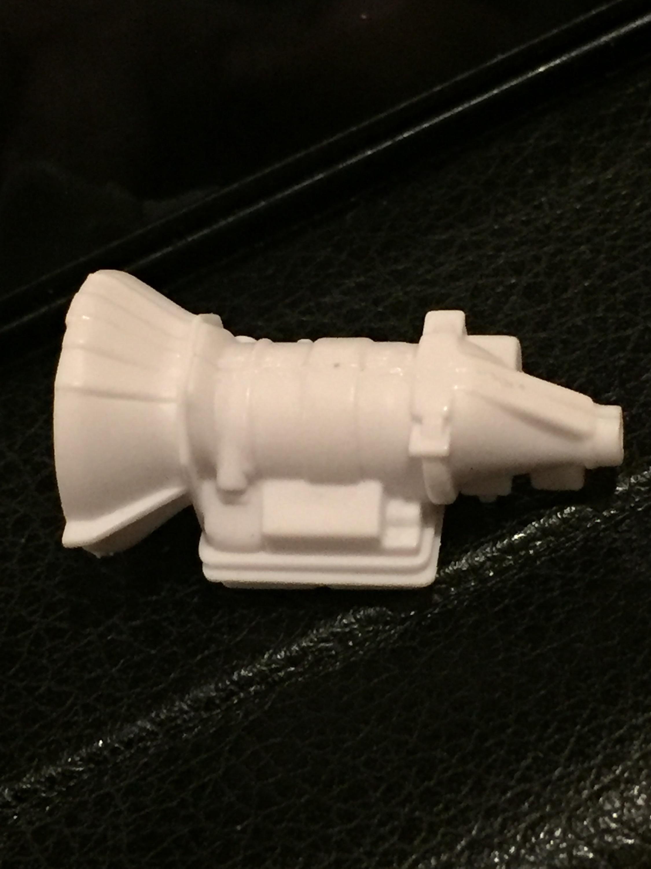

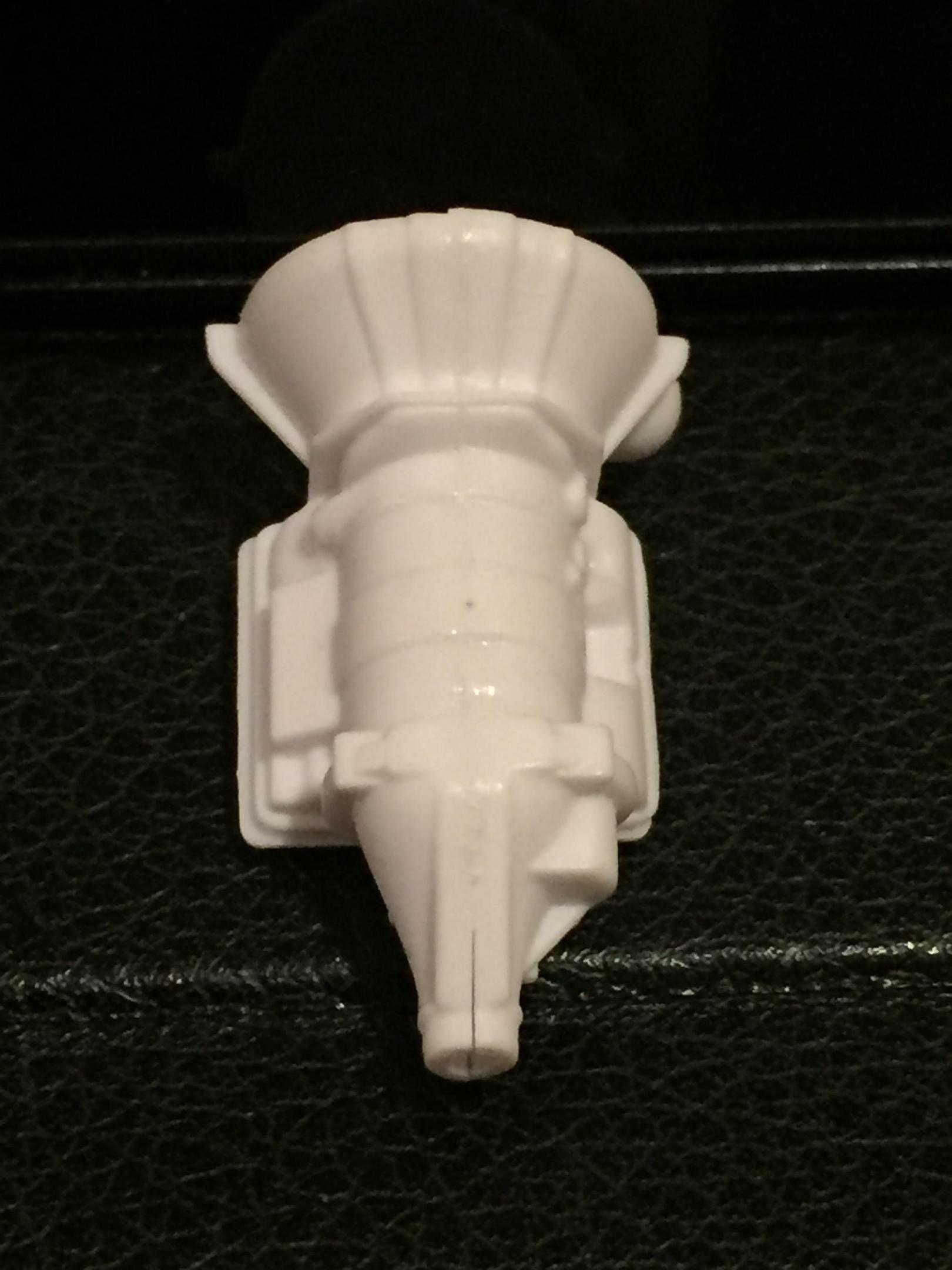

I cut this automatic off of some engine that I wanted to be equipped with a manual transmission. It was many, many moons ago ?.  Can any of youz guys identify the below transmission for me? I just know one of youz does ! ?IMG_6037.thumb.jpg.9548cd7ef3873bc353e4ff1a029bd14f.jpgIMG_6036.thumb.jpg.d0eb31bd896b7c073341c50b314611d4.jpgIMG_6038.thumb.jpg.ecc02590c06432f02ed2dfb45bfdd981.jpgIMG_6041.thumb.jpg.f16a47a61e3321b68fef36cb5b2275d5.jpg
  • Like 1
The square pan limits the options of what it could be. It isn't the greatest of replicas but it it intended to be pretty much hidden under the car.
Its hard to tell because the bolt pattern isn't there, but the starter looks like its in the GM location.
Based on the square pan and the short tail shaft housing I think its a GM 700R4.

Thanks, Dennis, I suspected it might be GM (but not Olds.) I tried looking at photos of them but no luck. I want to put it behind a 440. I hate it when the kit's optional engine has to share a transmission ?

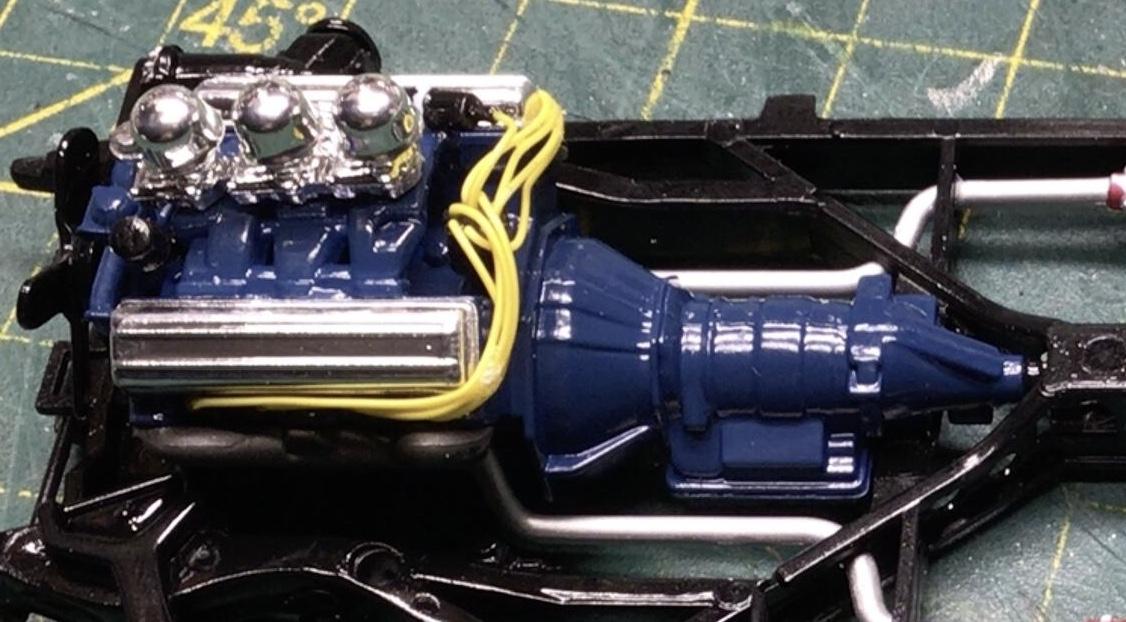

It looks like the one behind the Caddy engine in the Revell ‘49 Merc.
You got it, Greg! Now I remember. I didn't think it proper for a lead sled to have a slush-o-matic.

The cast in support bands on the case and the square pan identify it as a '59-'64 "Jetaway 315", used in some Pontiac, Olds, Cadillac, Buick, Hudson, and American Motors products.
It's a 4-speed automatic, kinda like the Hydramatic B&M used for their "Hydro Stick" racing autoboxes, but different.
https://www.charlietranny.com/315Jet.htm
Edited by Ace-Garageguy
