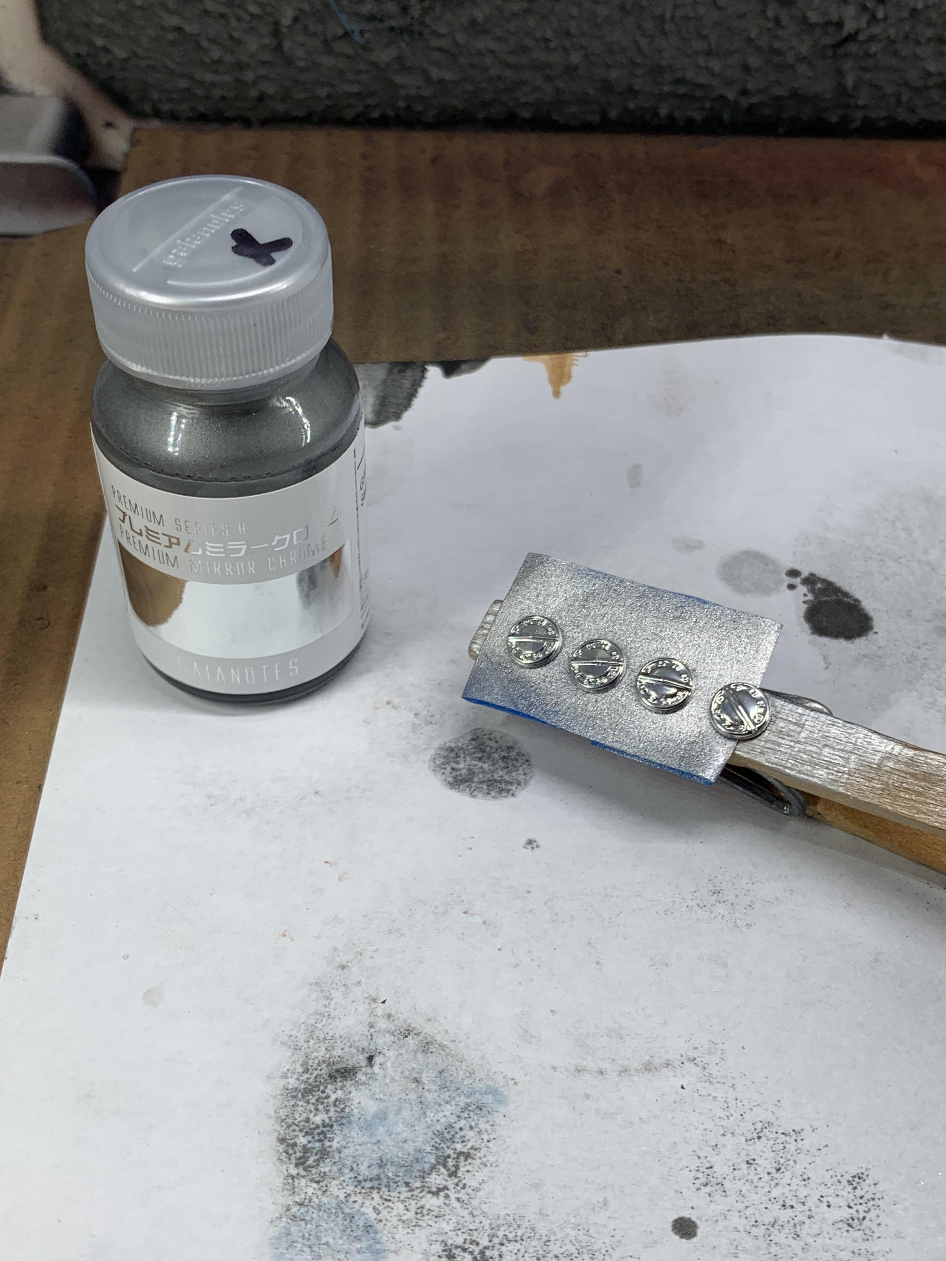

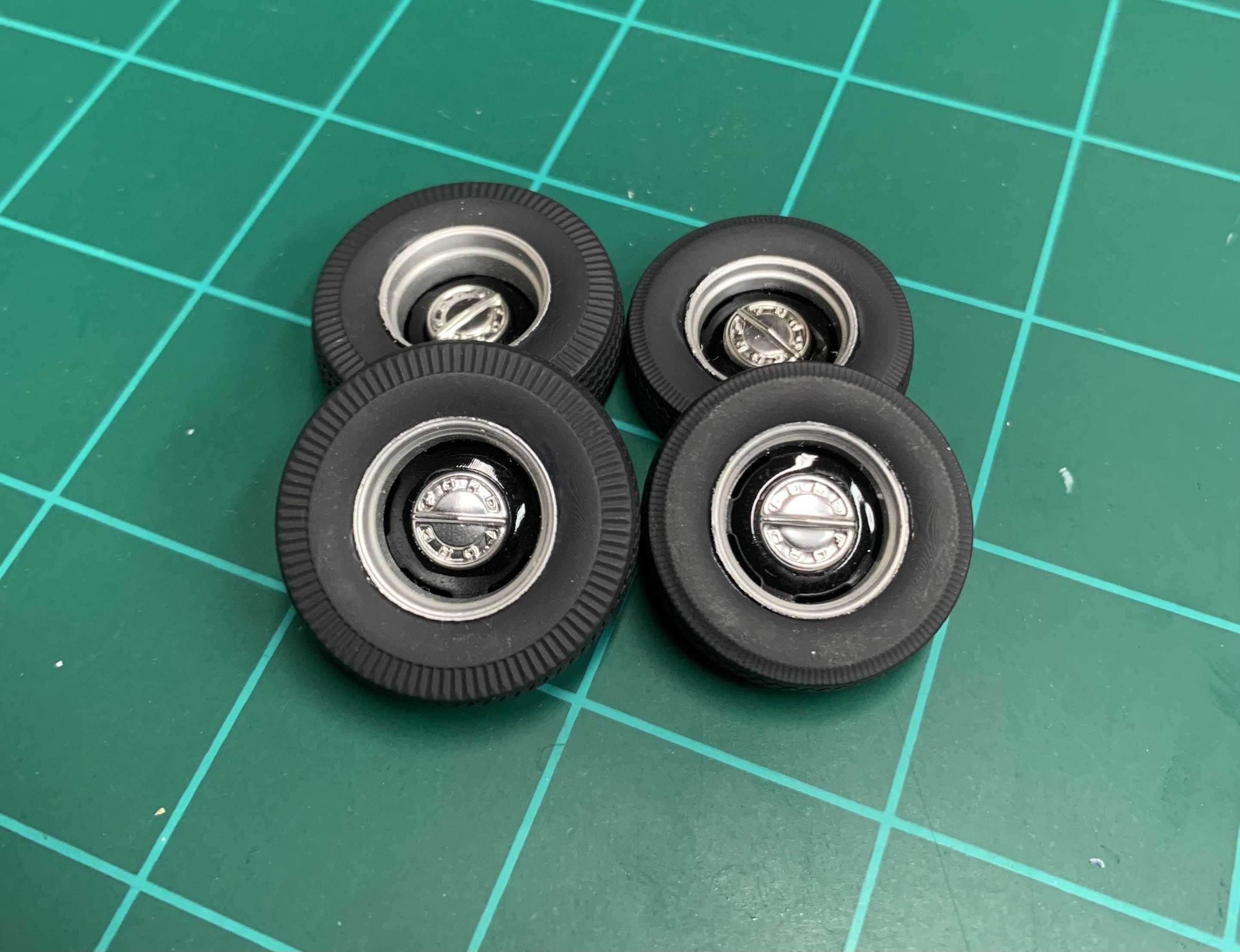

The hubcaps are chrome at last.  I used Gaianotes premium mirror chrome over gloss black.  I think I should have stopped after the first coat.  They were a bit more reflective than after the second one.

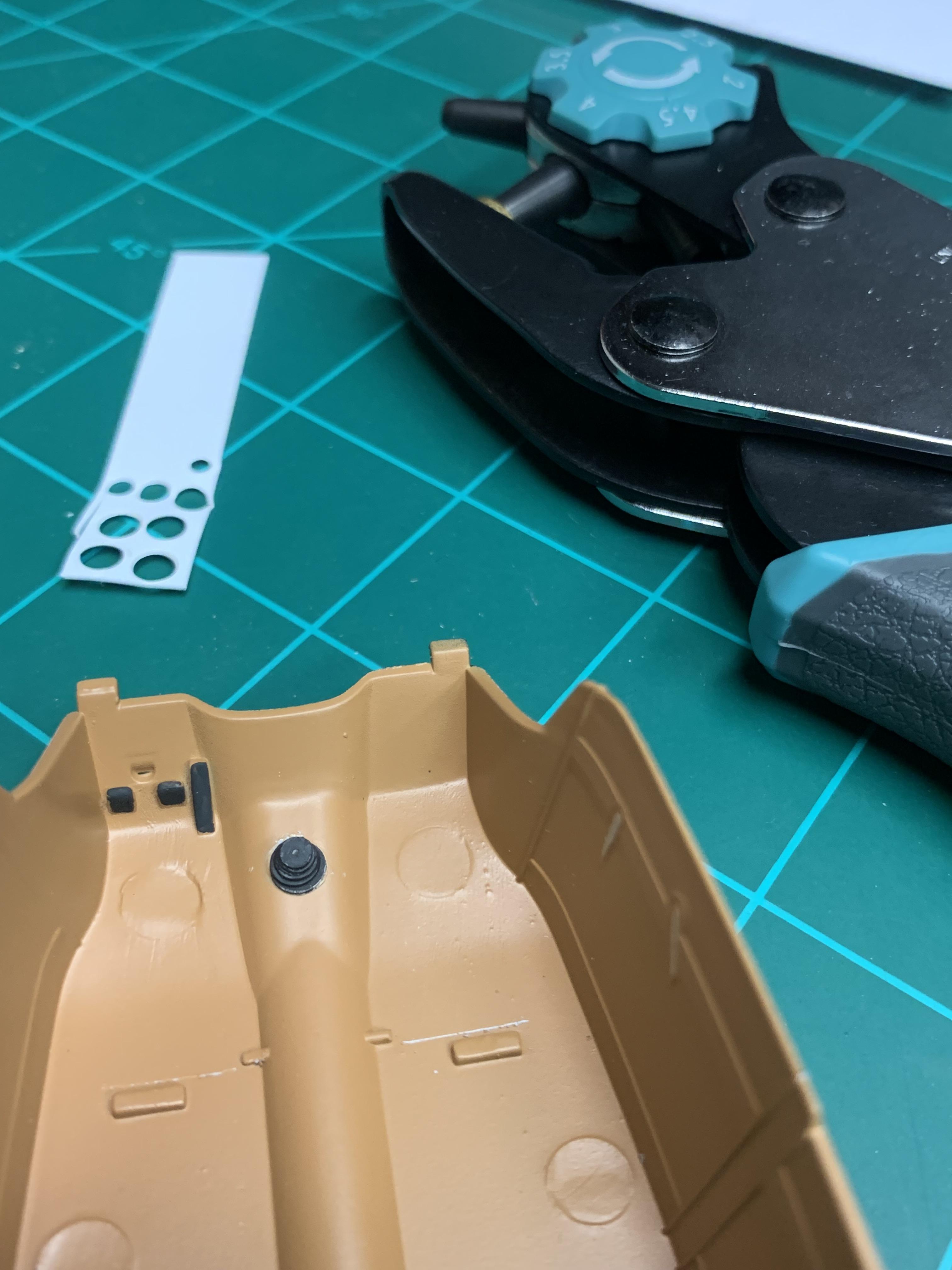

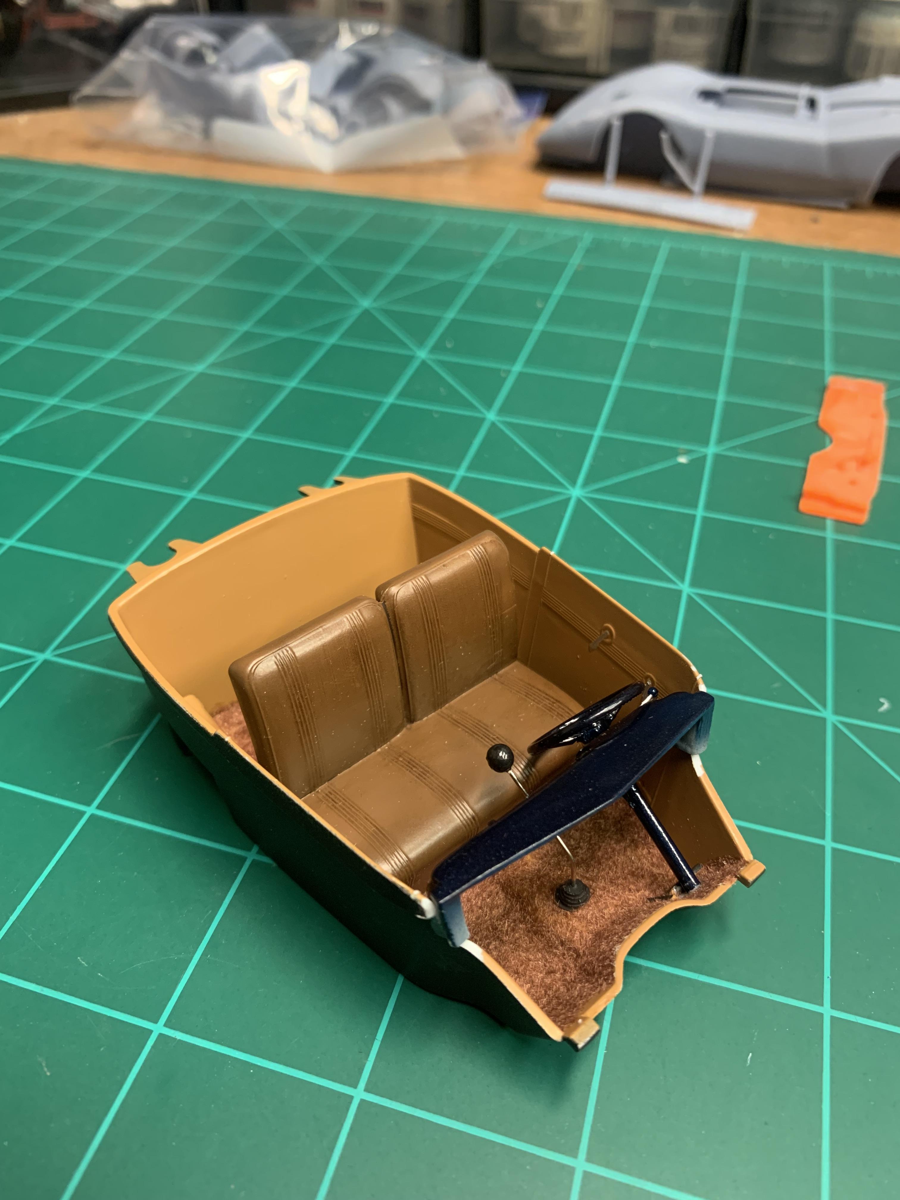

Over the weekend I decided to make my own shifter.  Here’s the boot, made from layers of sheet styrene cut with a leather hole punch.

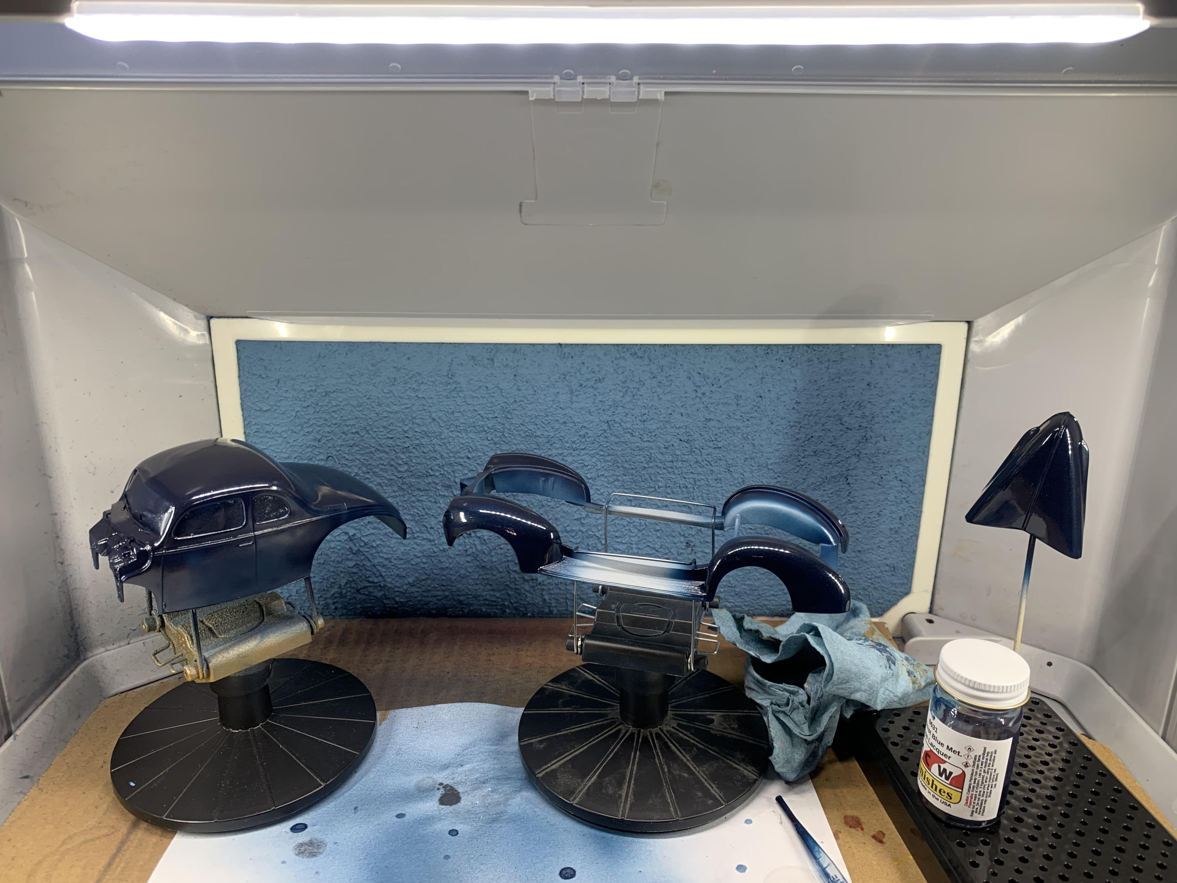

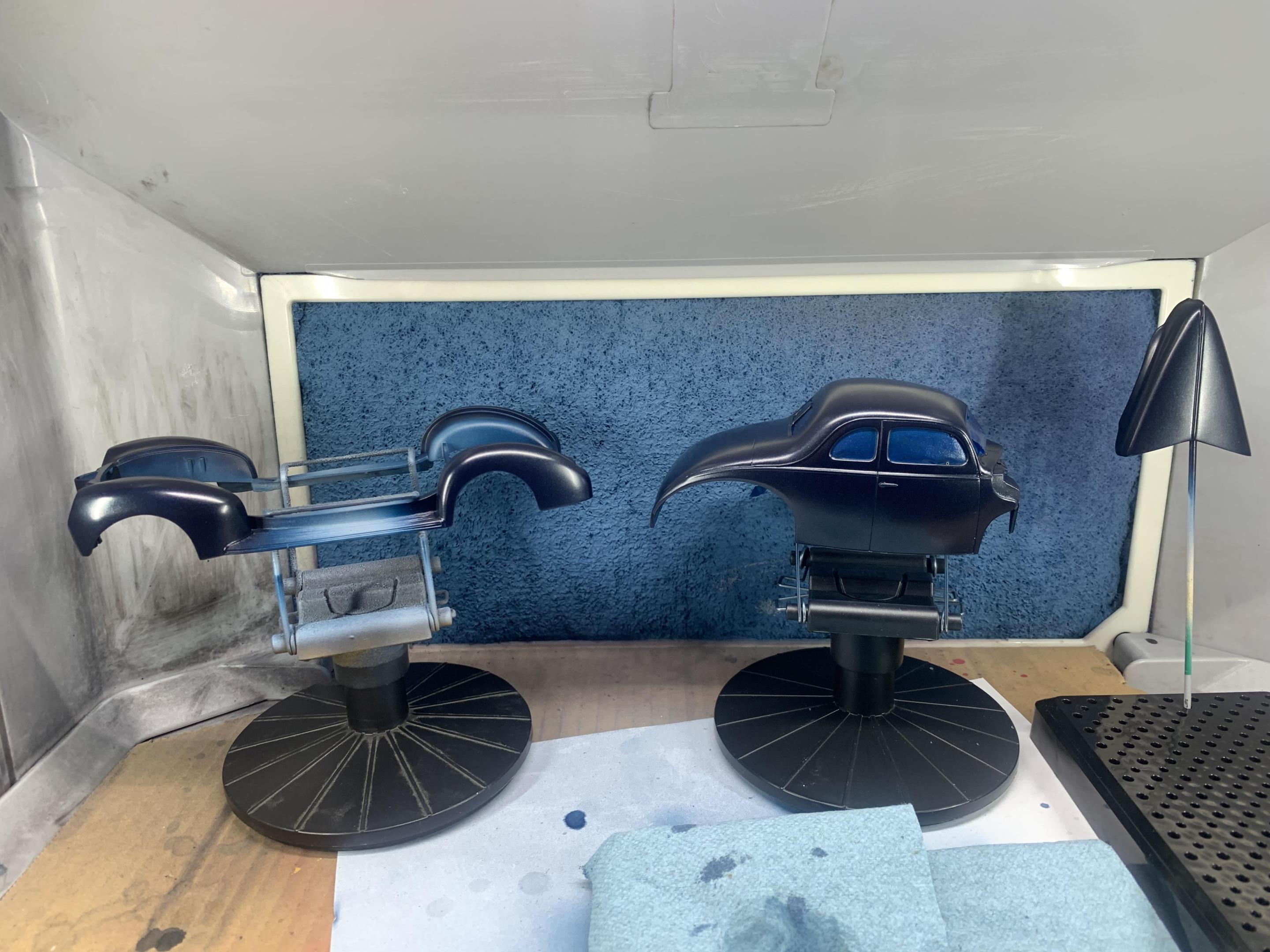

Today the body got its first few coats of paint.  I had to stop after the third coat because I found a bad spot on the body shell.  I’ll let it cure, lightly wet sand, and reshoot it as time allows.  I am LOVING this paint.

11 hours ago, slusher said:
Real nice work and paint looks awesome!
Thanks Carl!  The hood and fenders came out pretty nice, but the body needs a little attention.  I’m hoping to have it resprayed before the weekend.

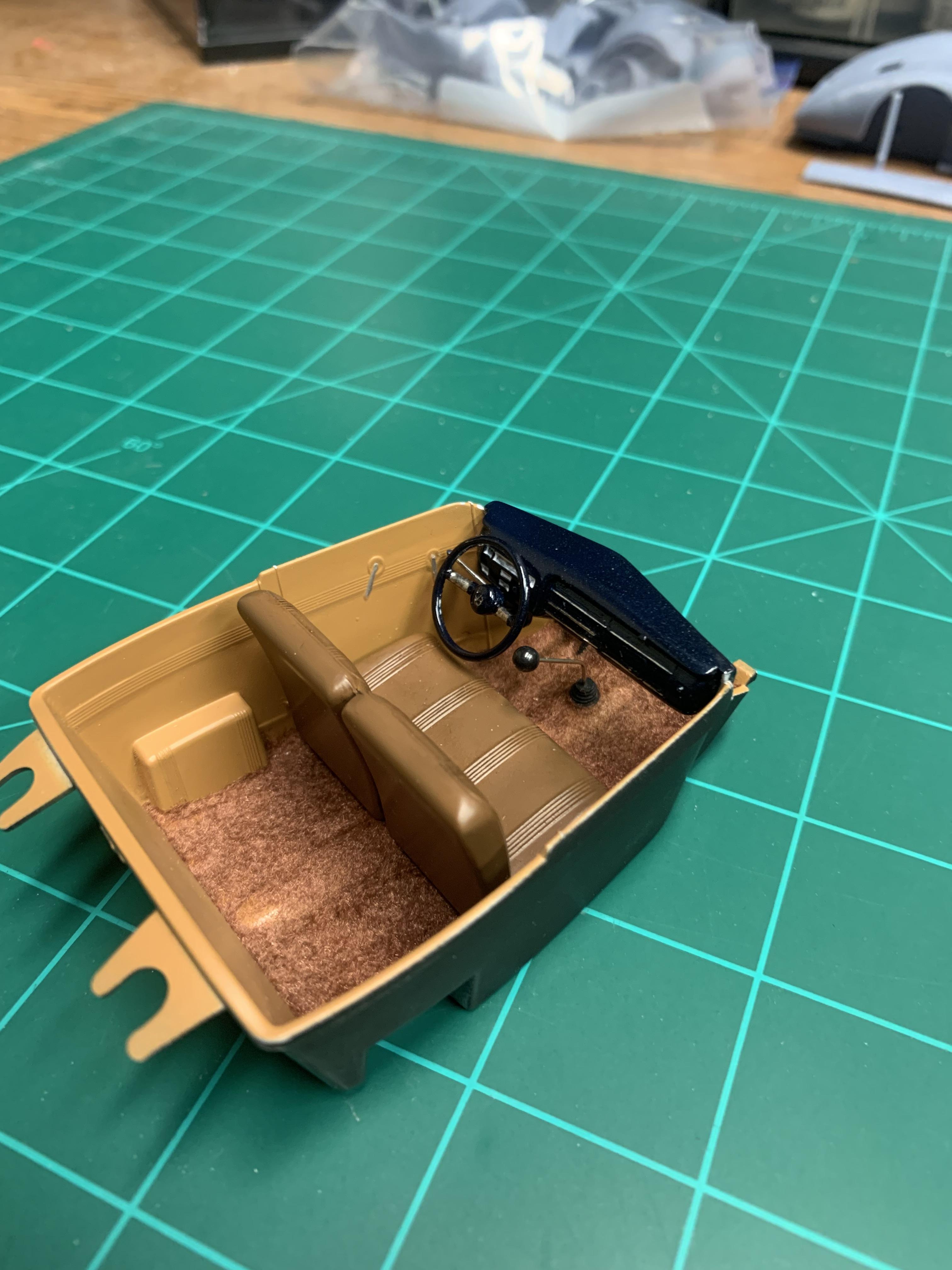

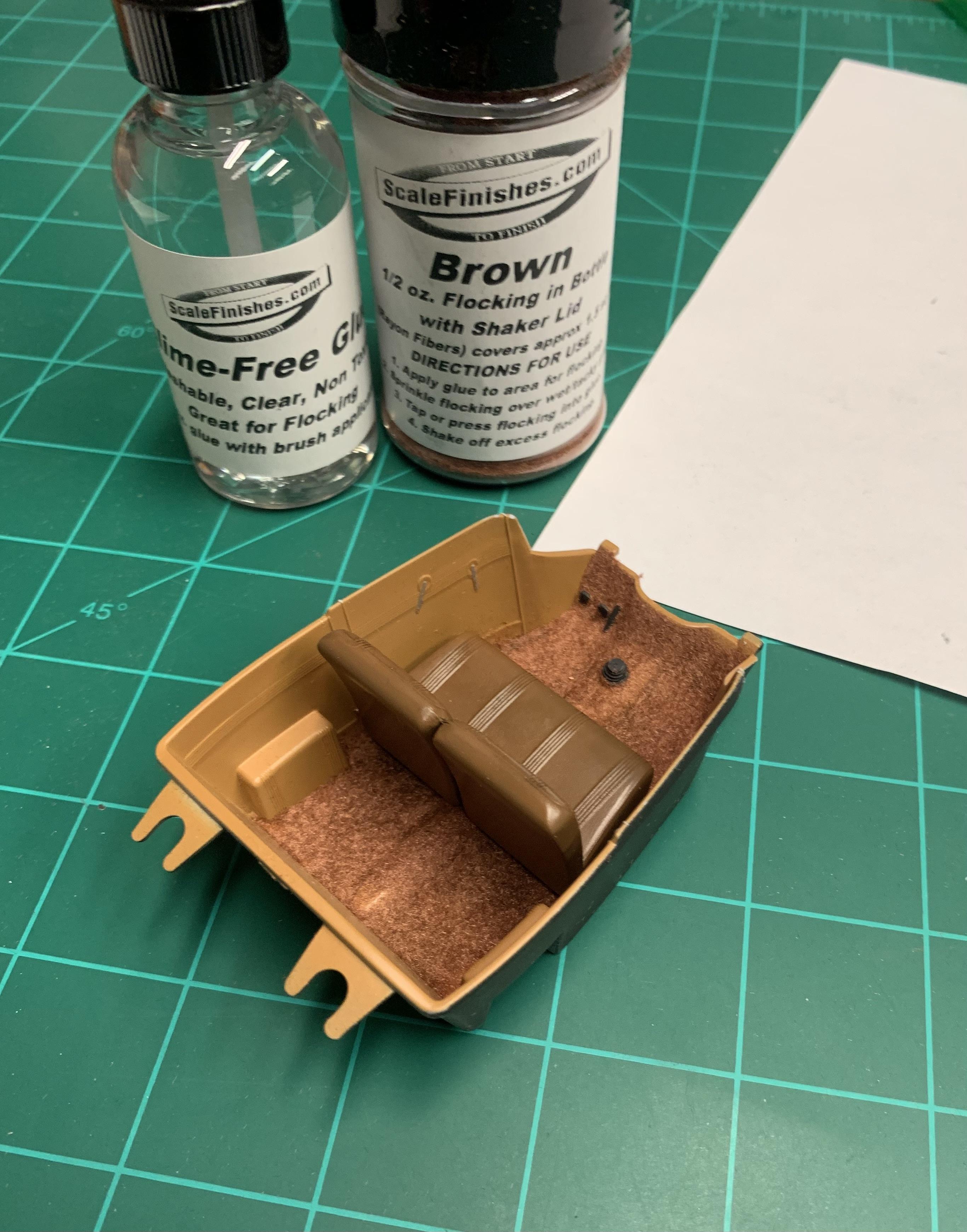

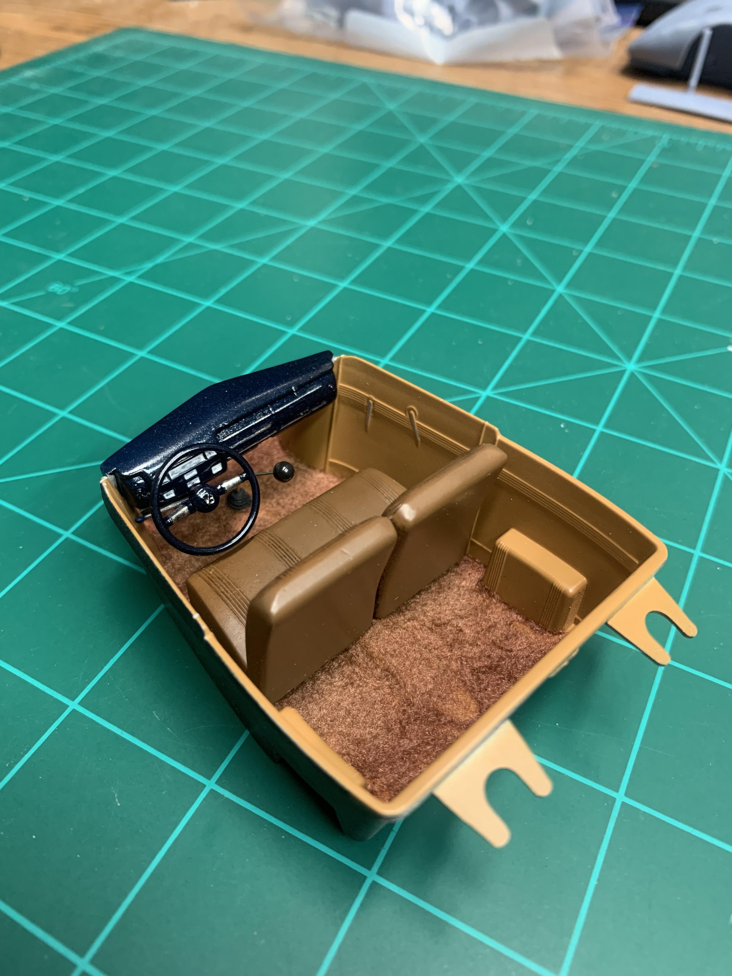

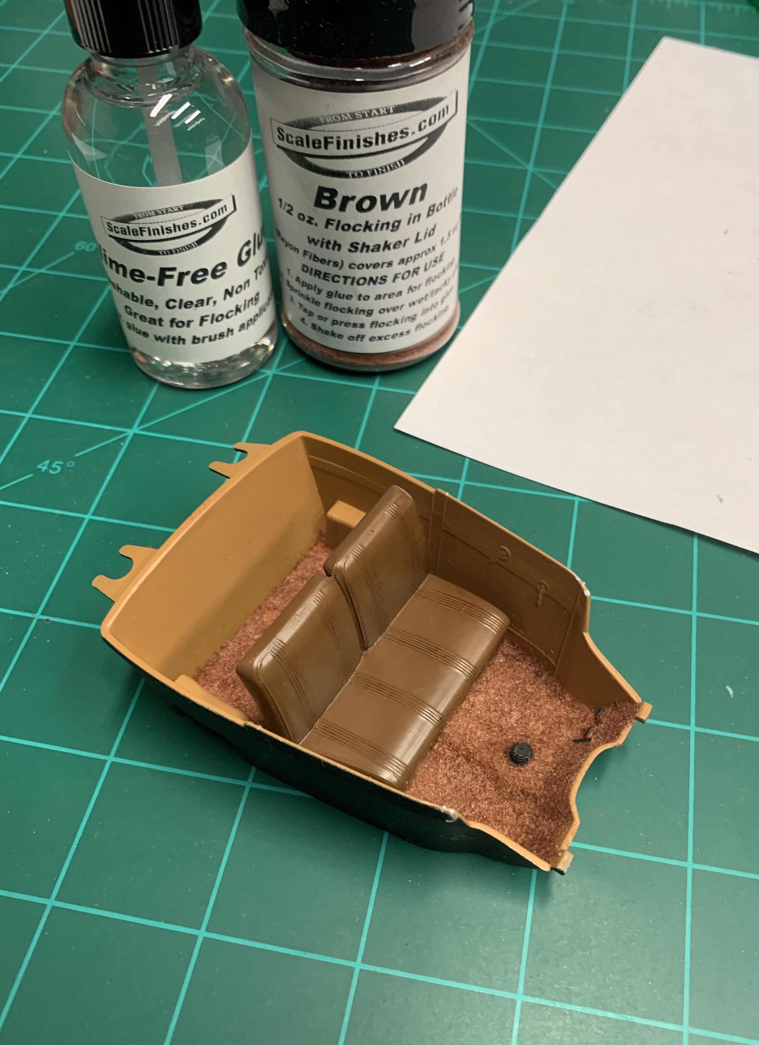

Ok guys, this is my first attempt at flocking.  How’d I do? Honest critique and feedback please.  I'd like to improve on this.
To my eyes it looks a little thin in spots and thick in others.

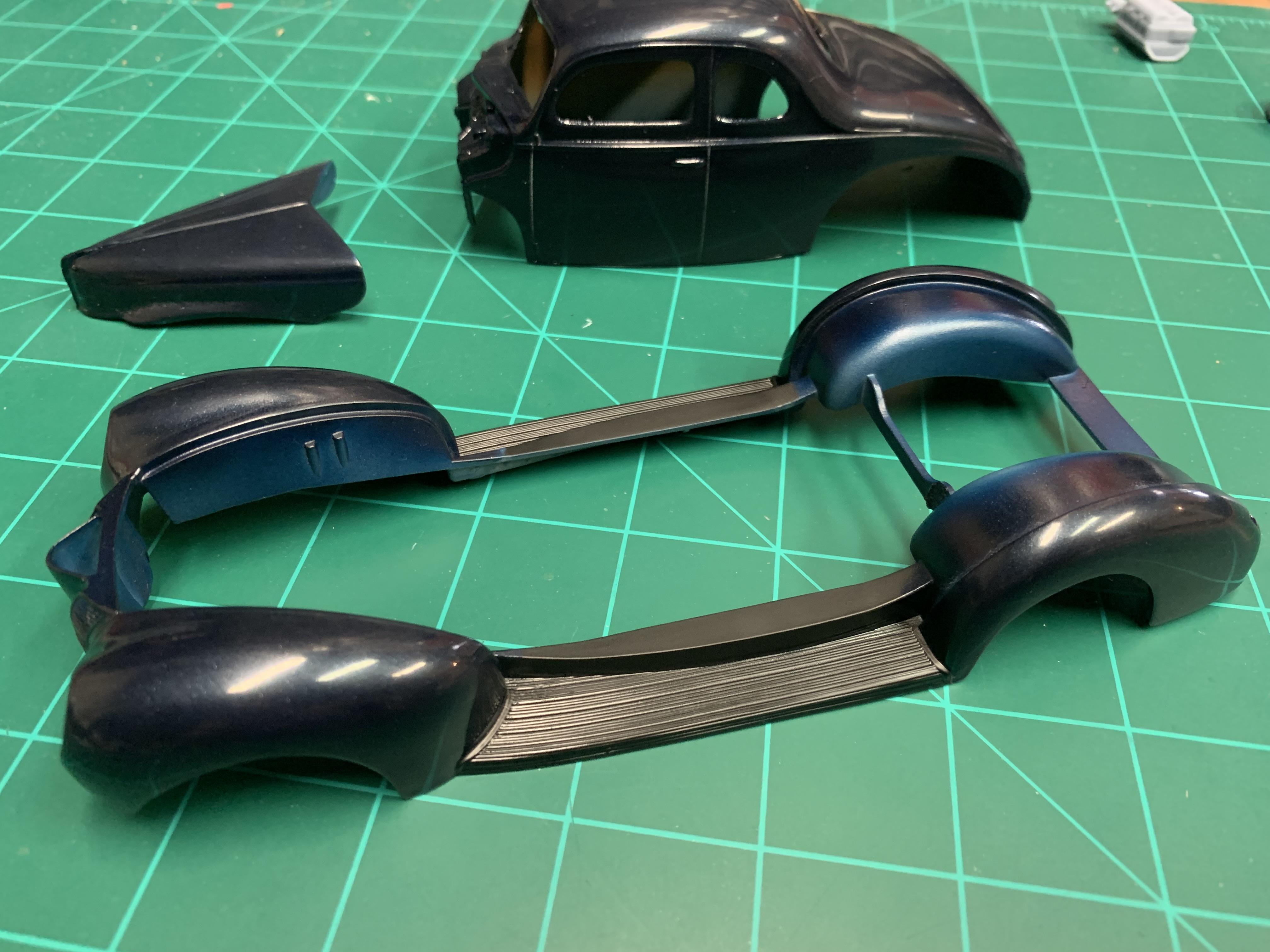

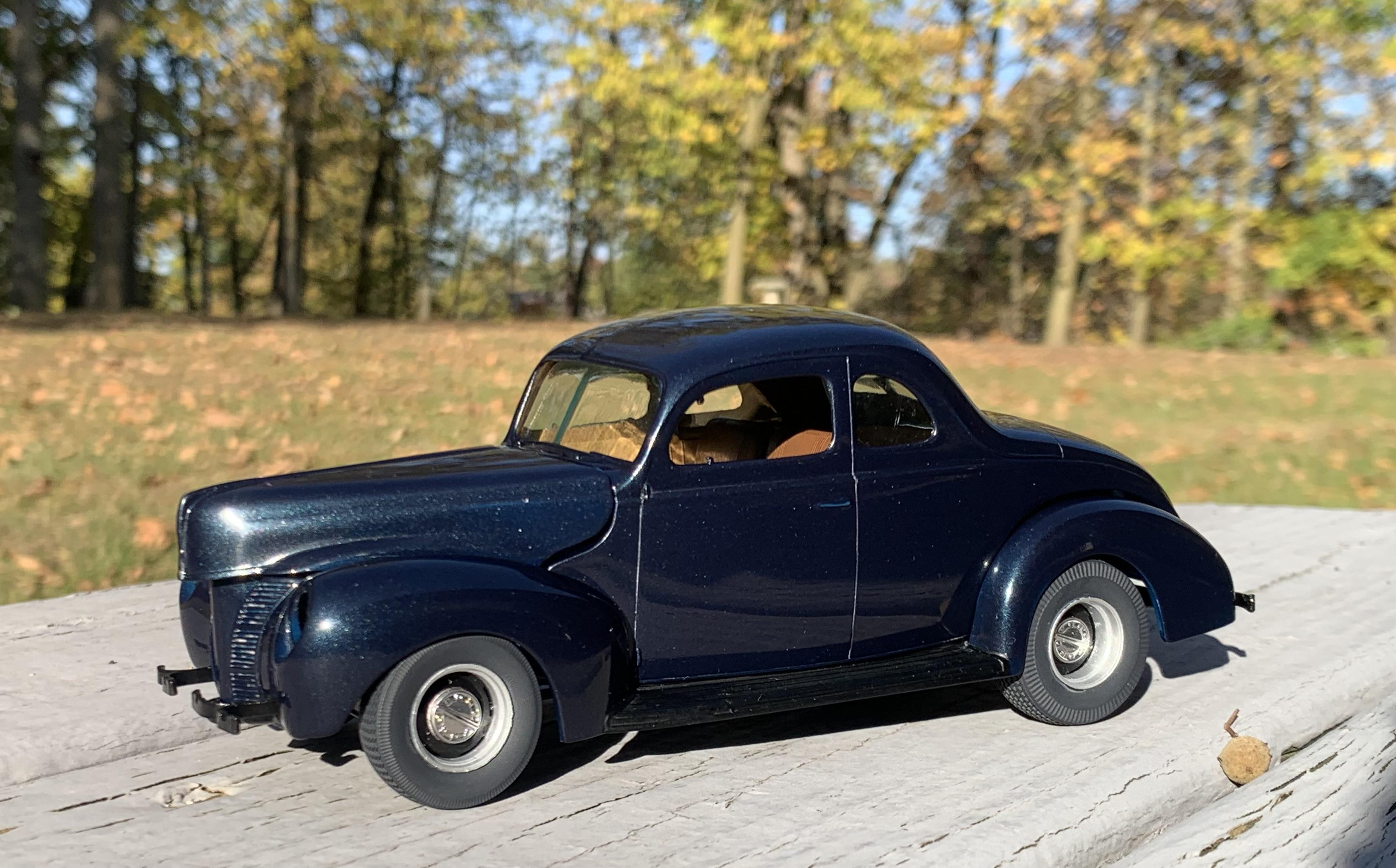

Finished spraying color on the body today.  Now I’ll let it gas out and then shoot clear when I get a chance.
It went on very smooth and glossy.  But I tried a technique I heard about for spraying metallics.  On the final coat, I pulled the brush a little further back and just dusted the model.  With luck, after clearing it, it should create a nice even flake in the paint.

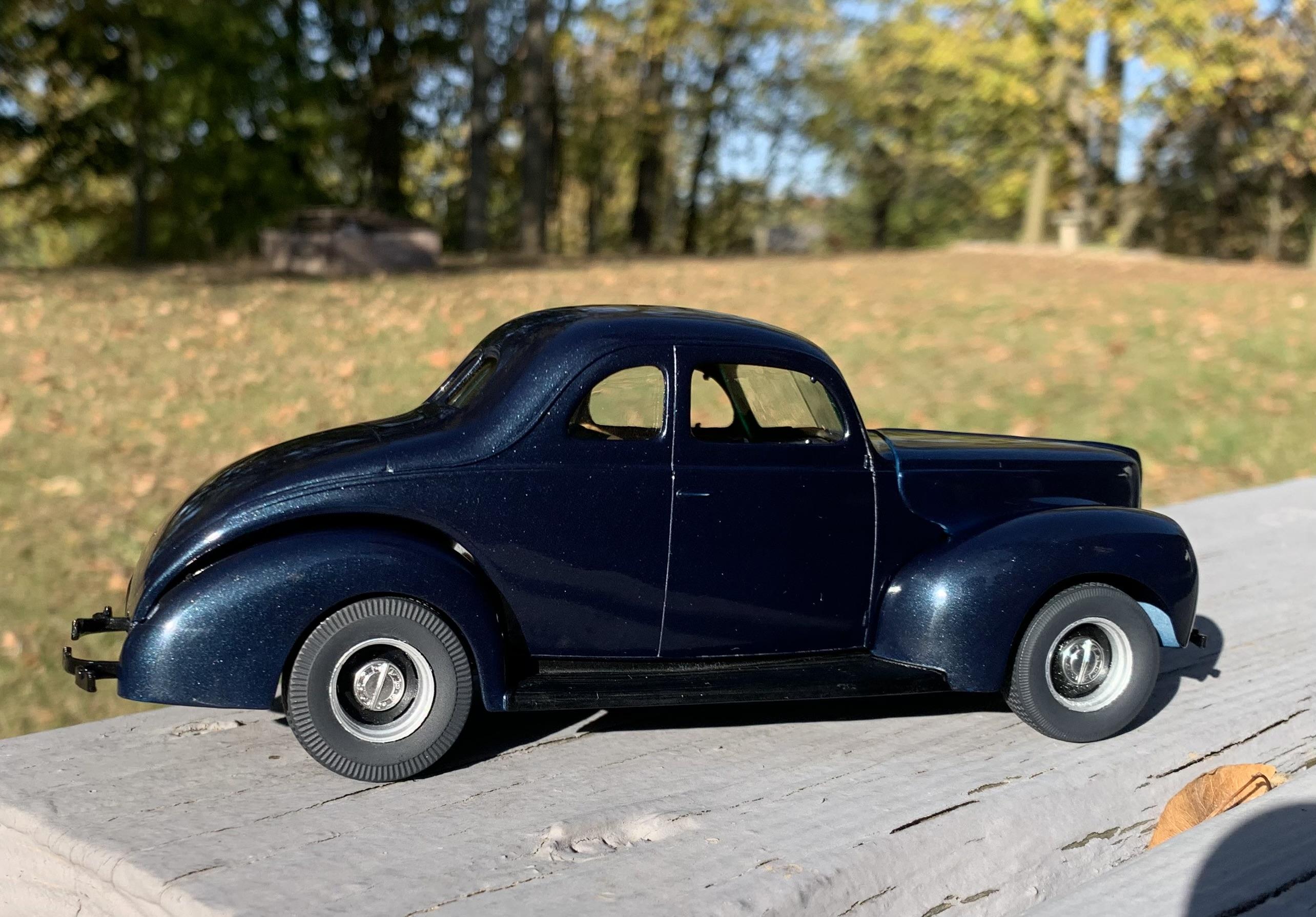

Yesterday I started the polishing process.  I took it up to 6000 grit and stopped.  I decided it would be best to paint the running boards before I went any further.
So today the running boards were taped off and shot with Tamiya semi gloss black.  It always makes me nervous putting tape on a nice paint job.  To avoid complications I removed it 20 minutes after applying the paint.  No problems!?
Hopefully I can finish polishing out the body this weekend.

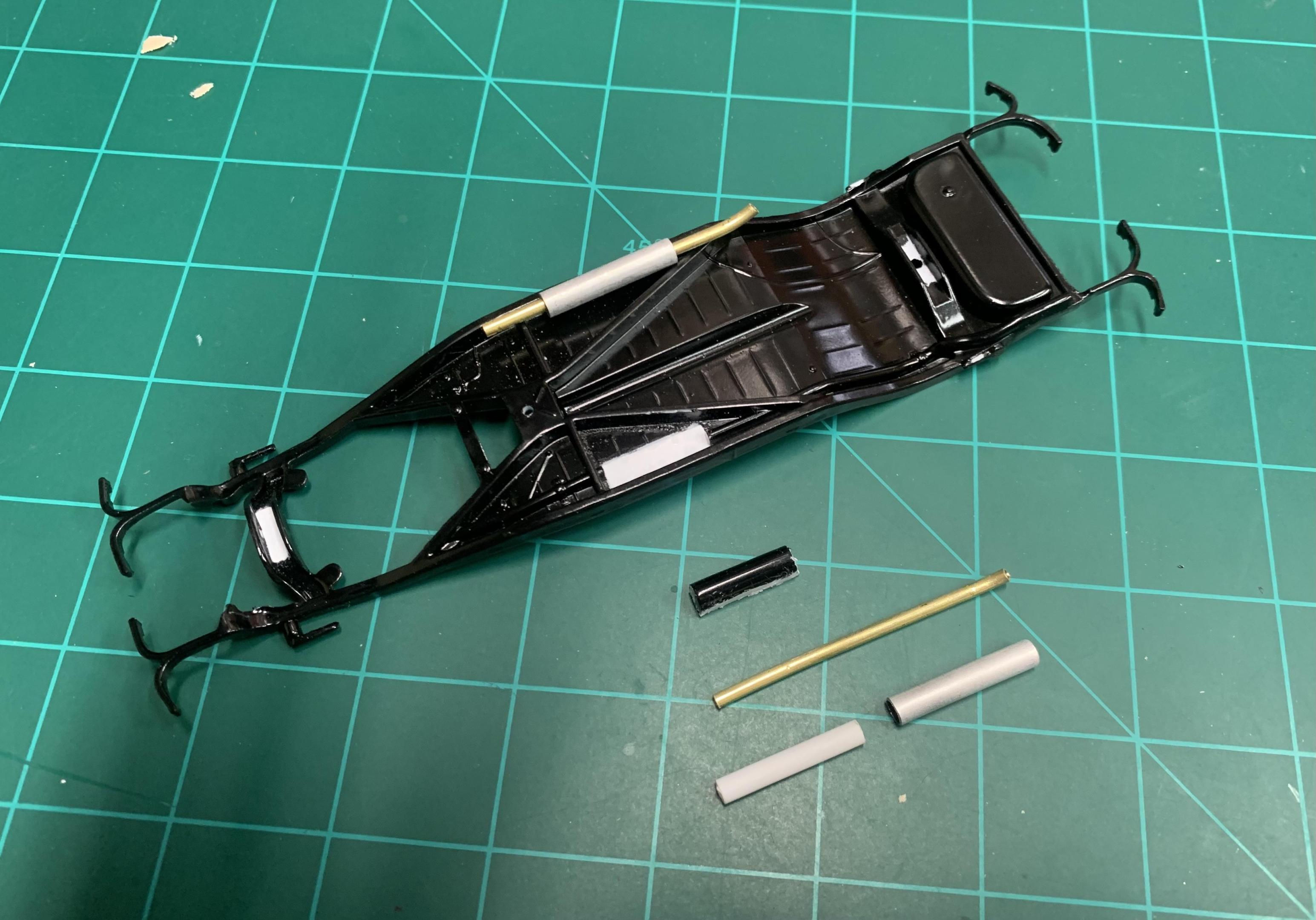

Working on the exhaust system today.  I finally have a plan thanks to some tips I got on Facebook.
The tubing is the bendable stuff you can get at hobby lobby in the model kit isle.  First time I’ve used it.  I have to cut the kit muffler from the chassis plate to clear the new part.  The hole was then filled with a piece of evergreen styrene.  Once everything is figured out and fitting the way I want, I’ll repaint the chassis.
Mounting brackets are the next step.
  • Like 3
4 hours ago, slusher said:
What did you cut the muffler out with?
I used the backside of a #11 blade.  I scored around it until it came free.  Then the hole was cleaned up with a file, and styrene sheet was used to fill the opening.
It's no where near perfect,  but the new muffler will cover  most of it.
