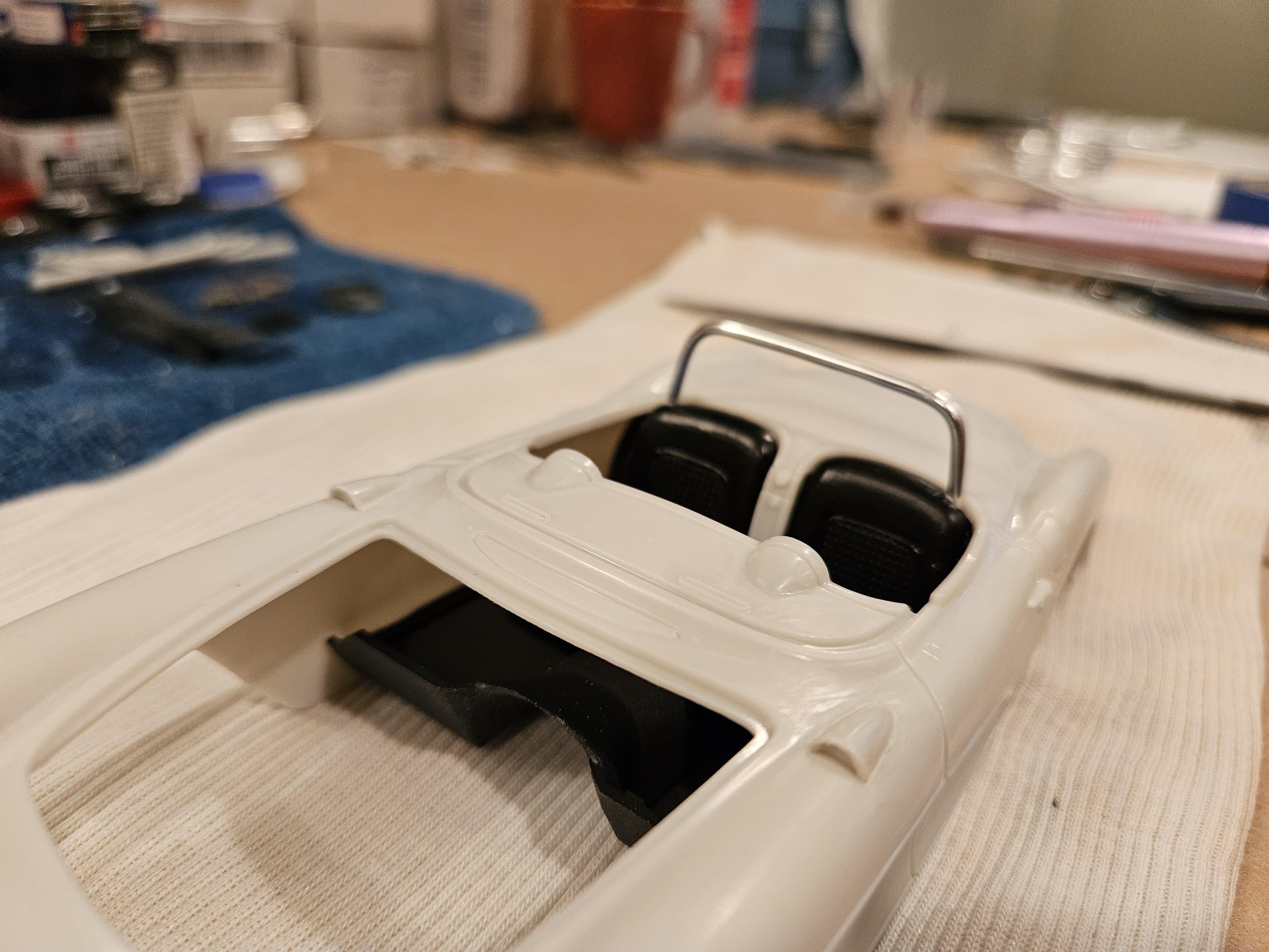

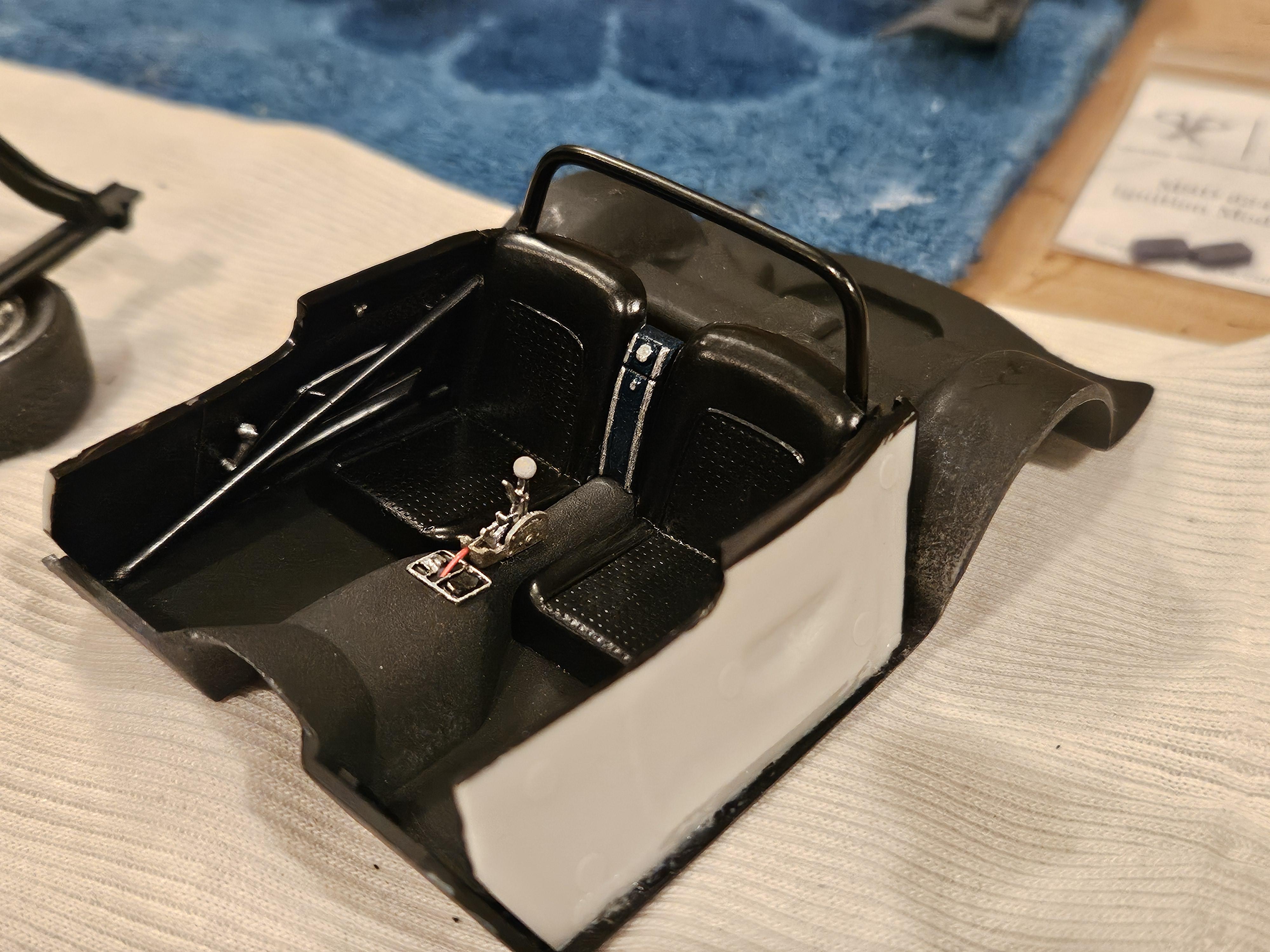

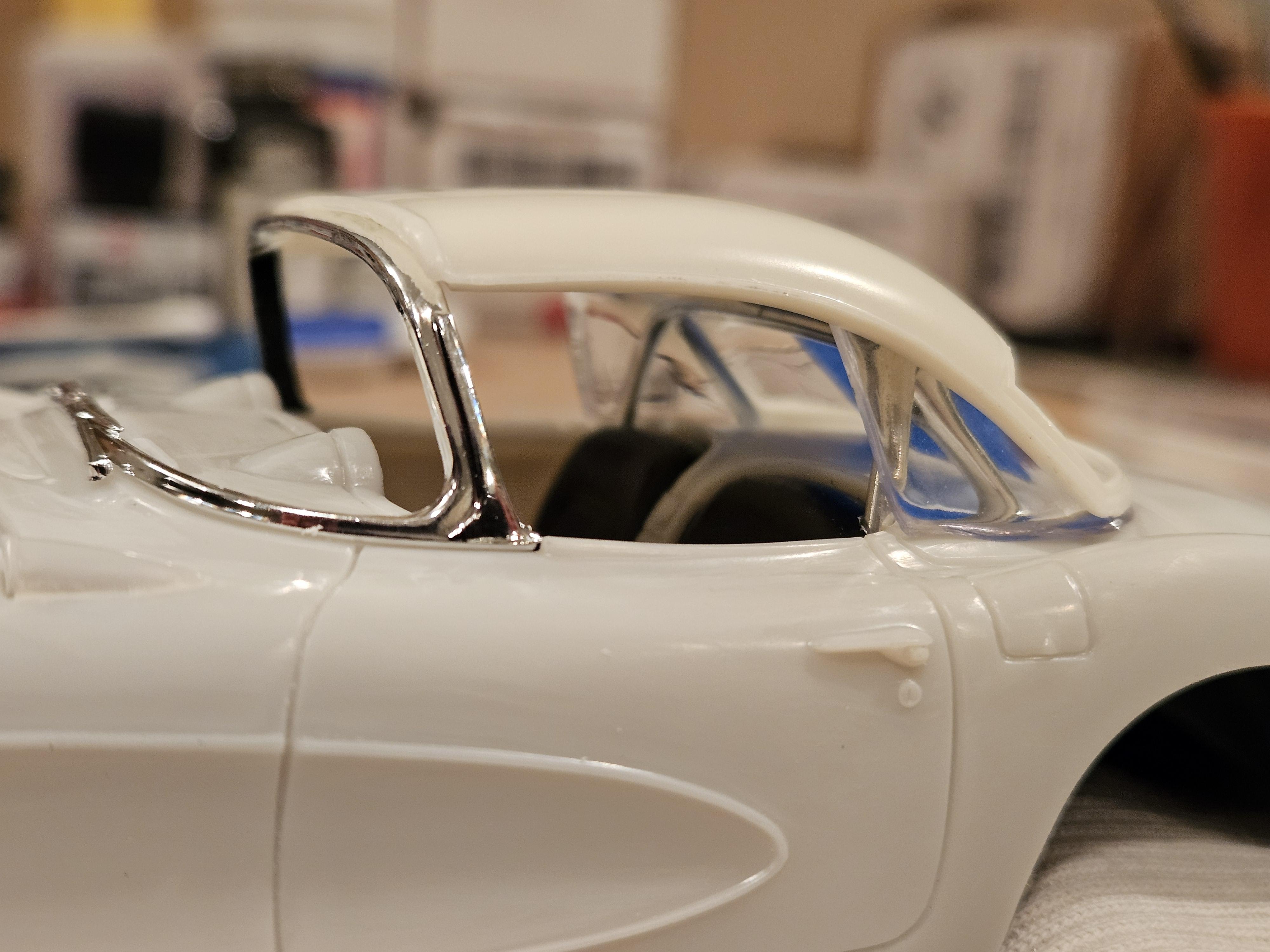

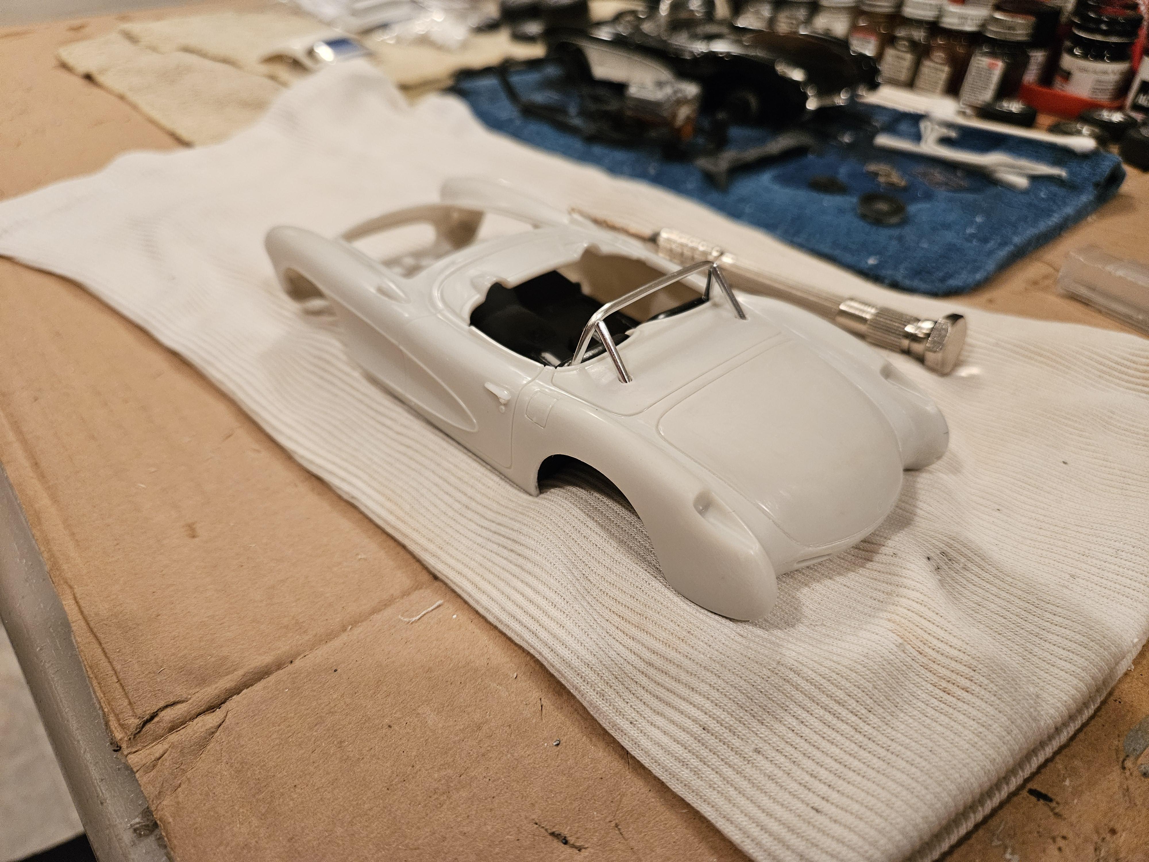

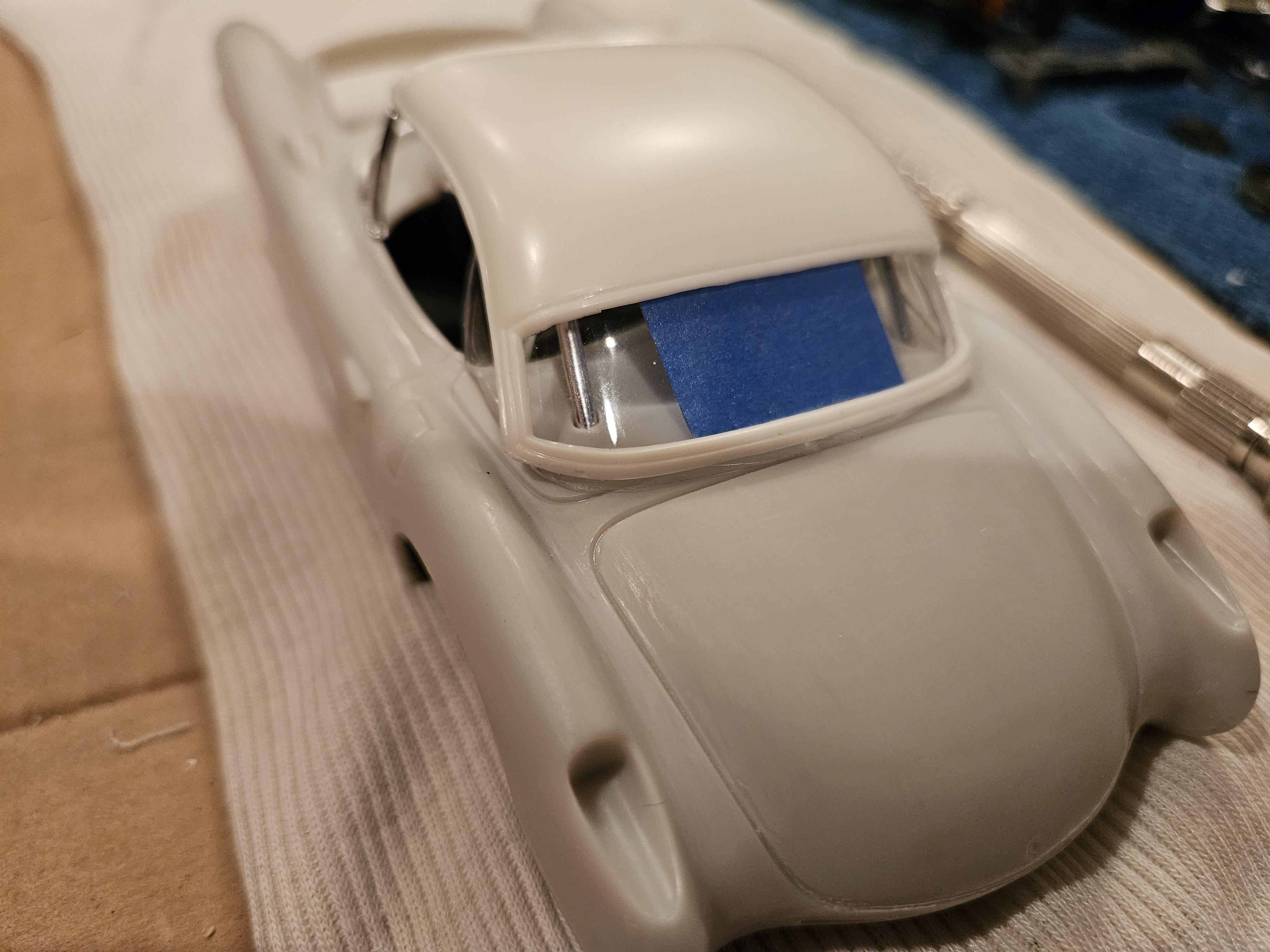

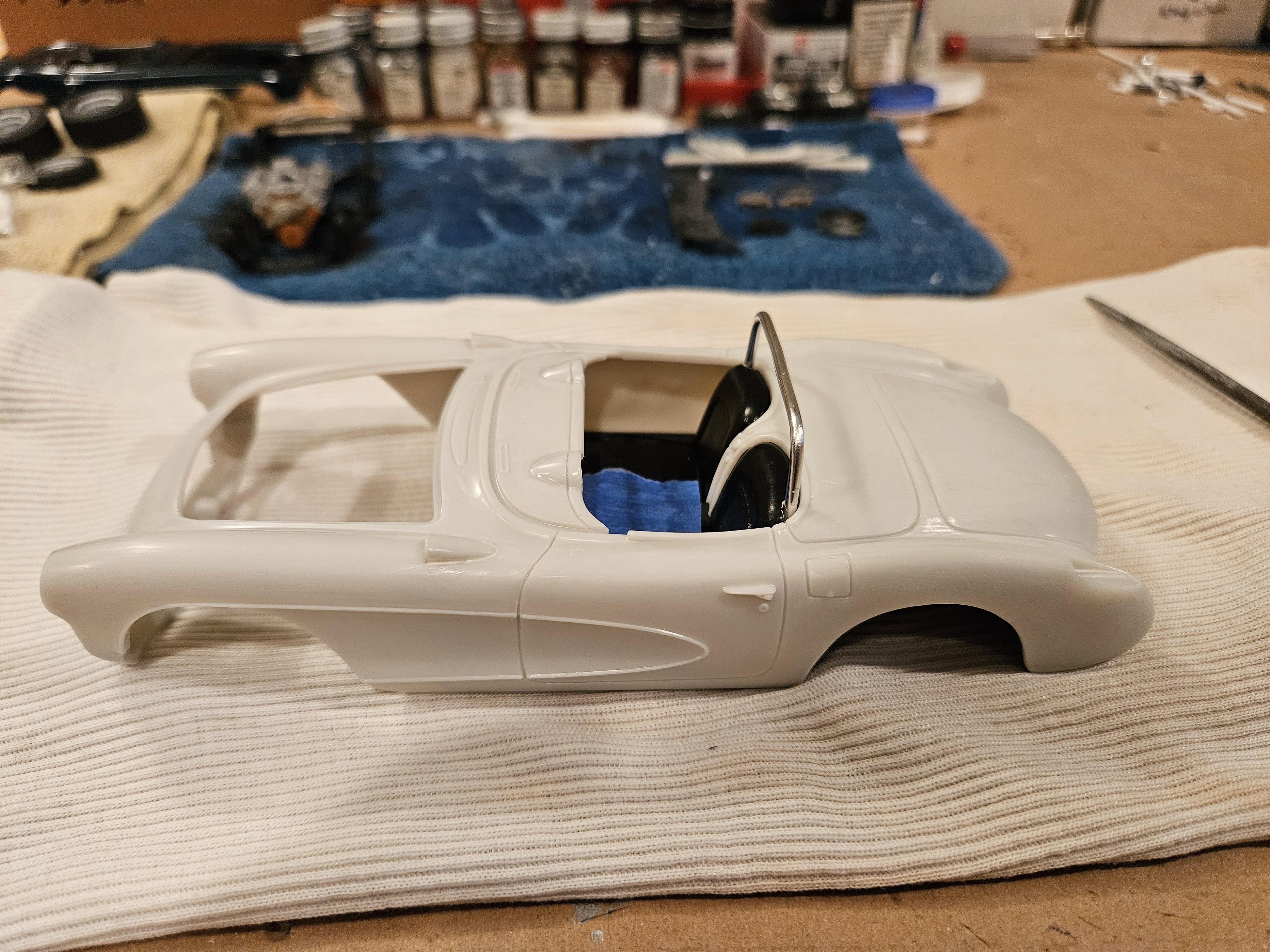

Got the roll bar in place where I want it with the rear down bars, drilled through the convertible top deck lid for them to pass through and made sure the hard top will still fit.  It will be a challenge to attach the rear bars and paint them once the rest is in paint though as it'll have to go together in a certain sequence.

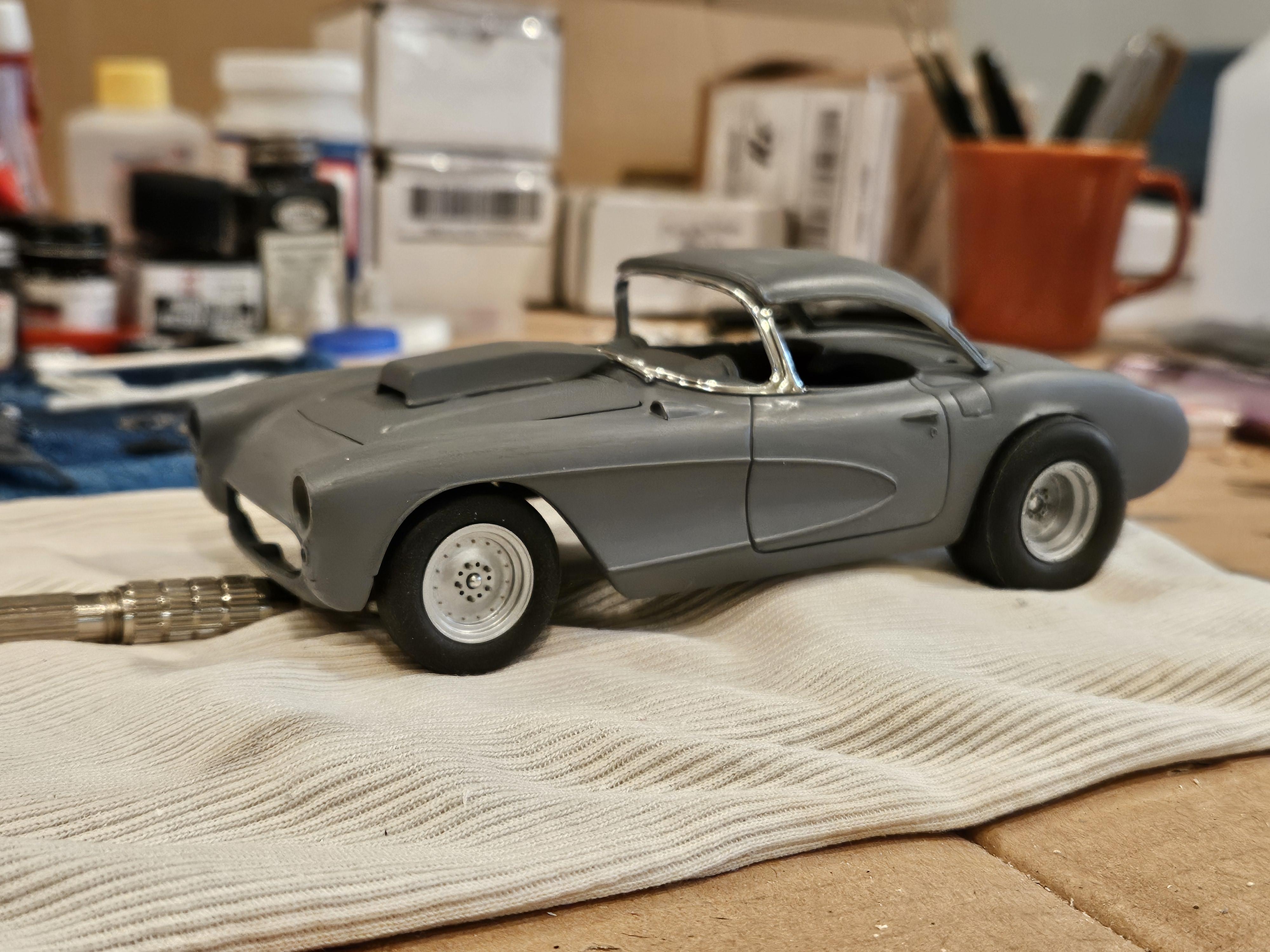

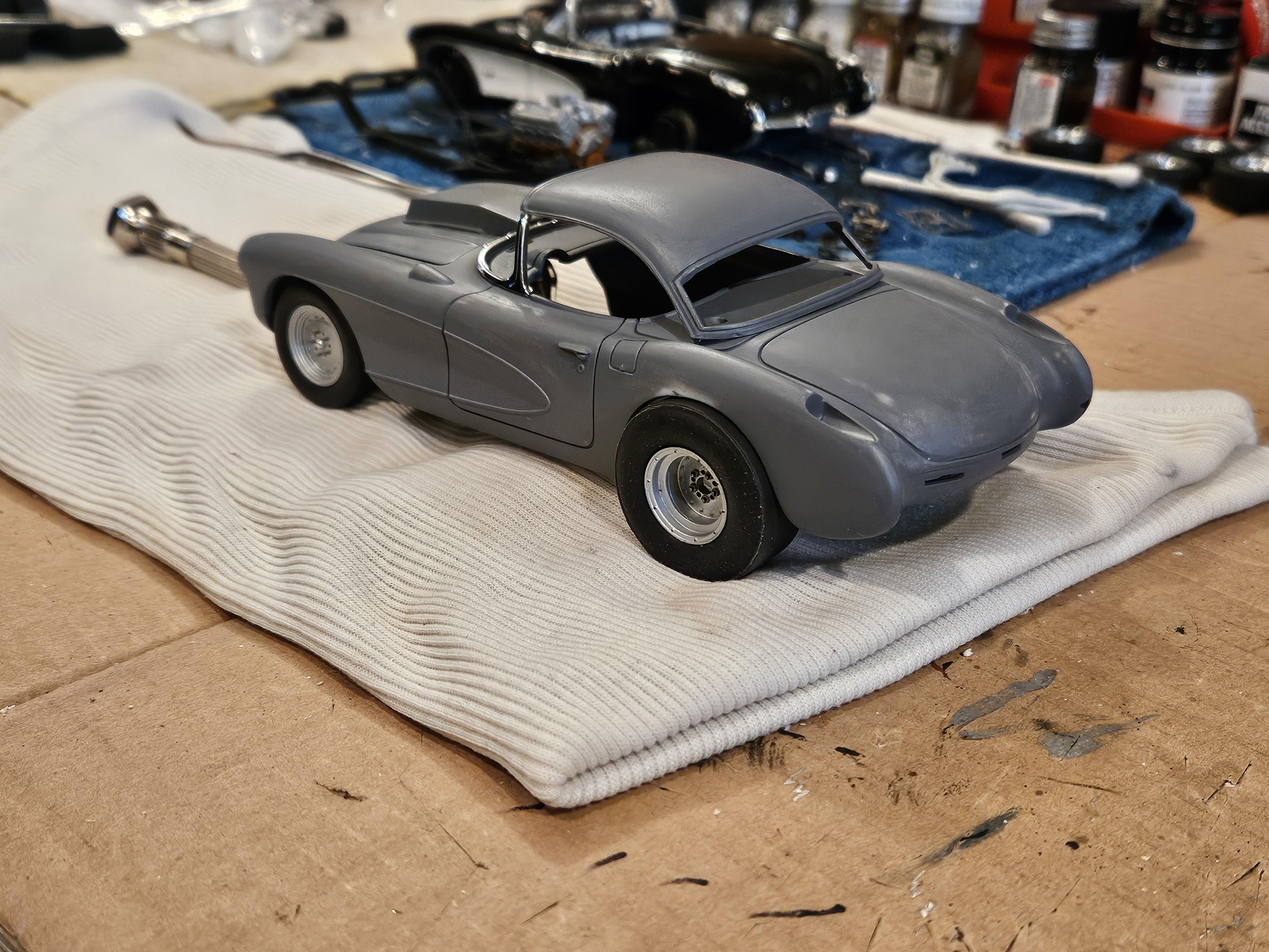

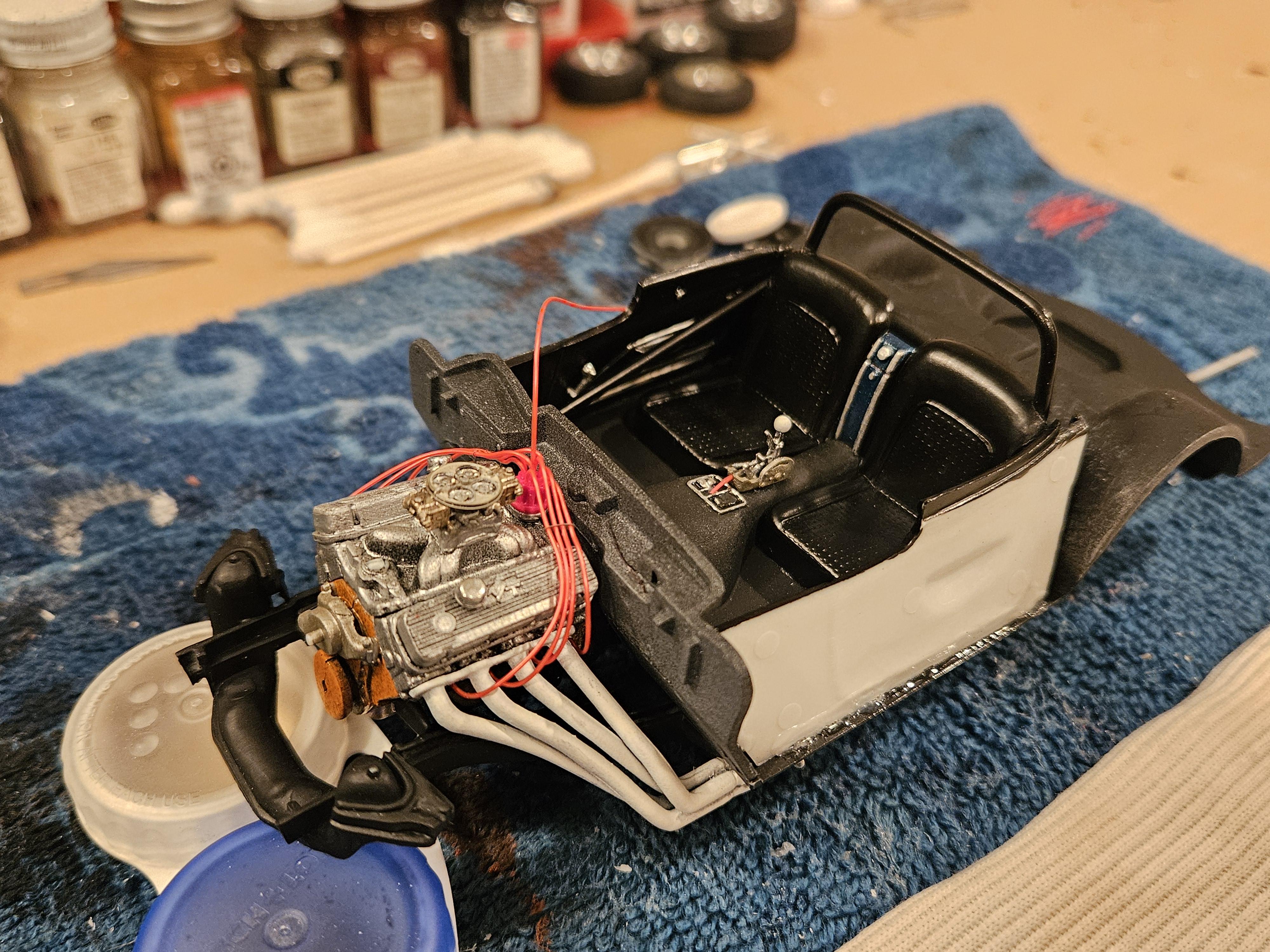

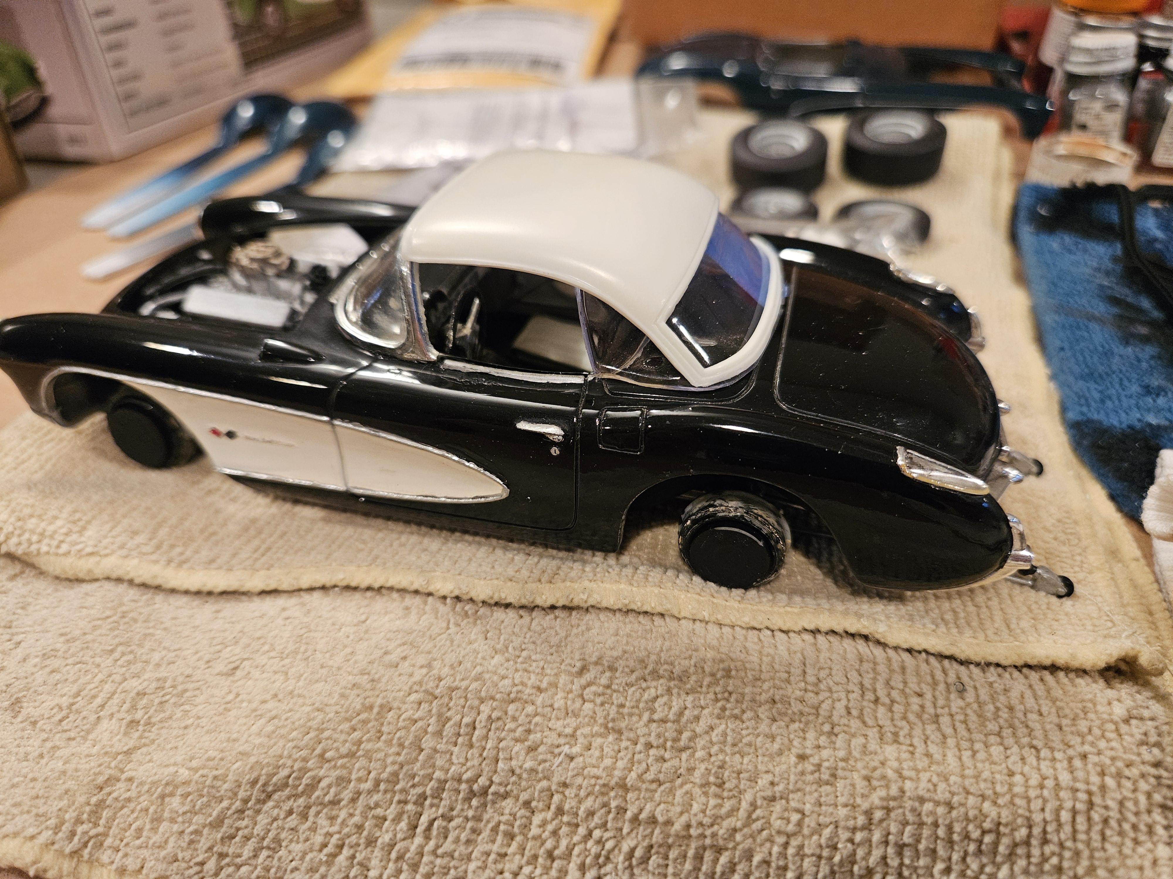

Thanks! It's coming together..got the body in primer and had to do another mock up for motivation, cause why not lol.

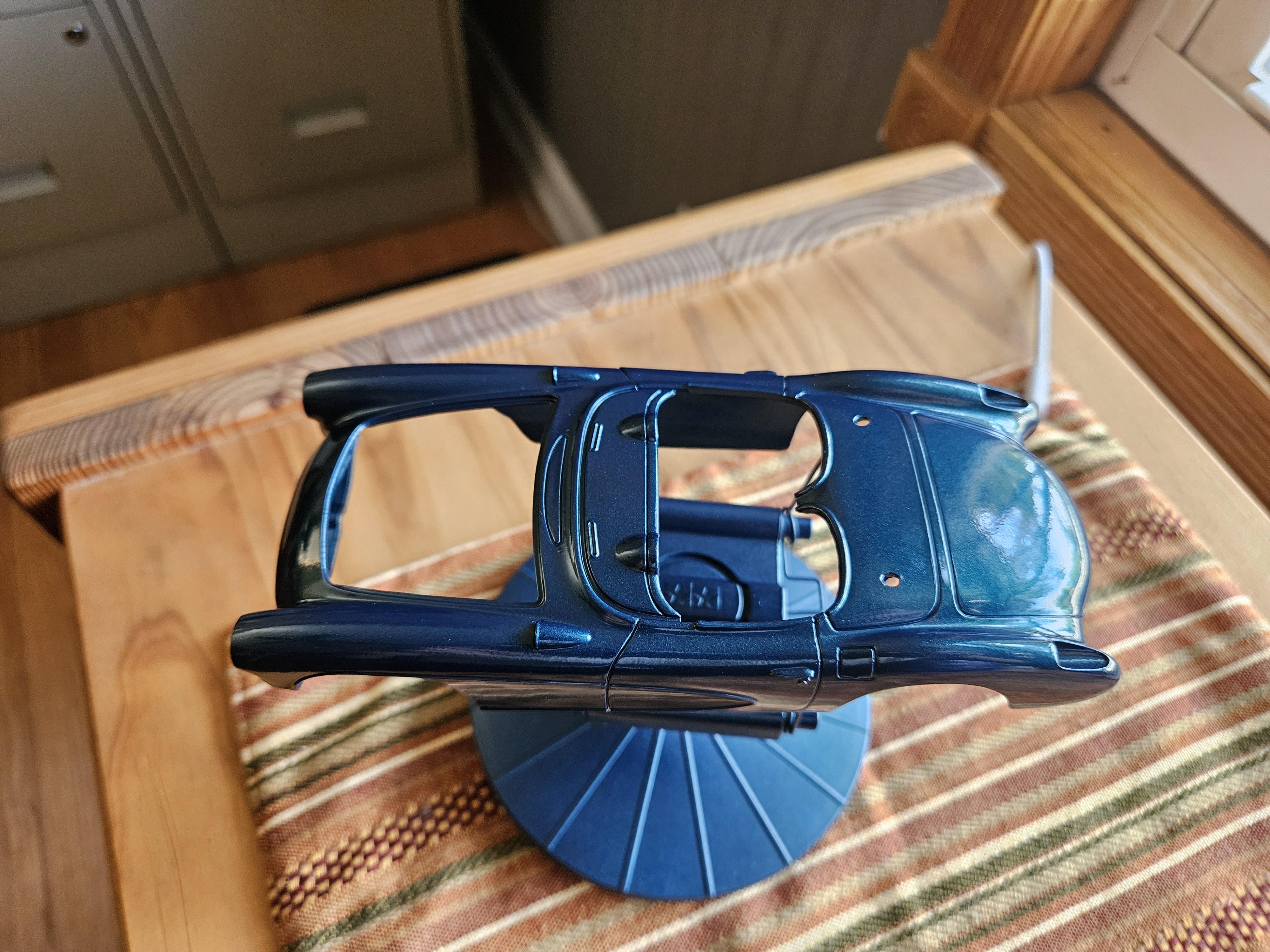

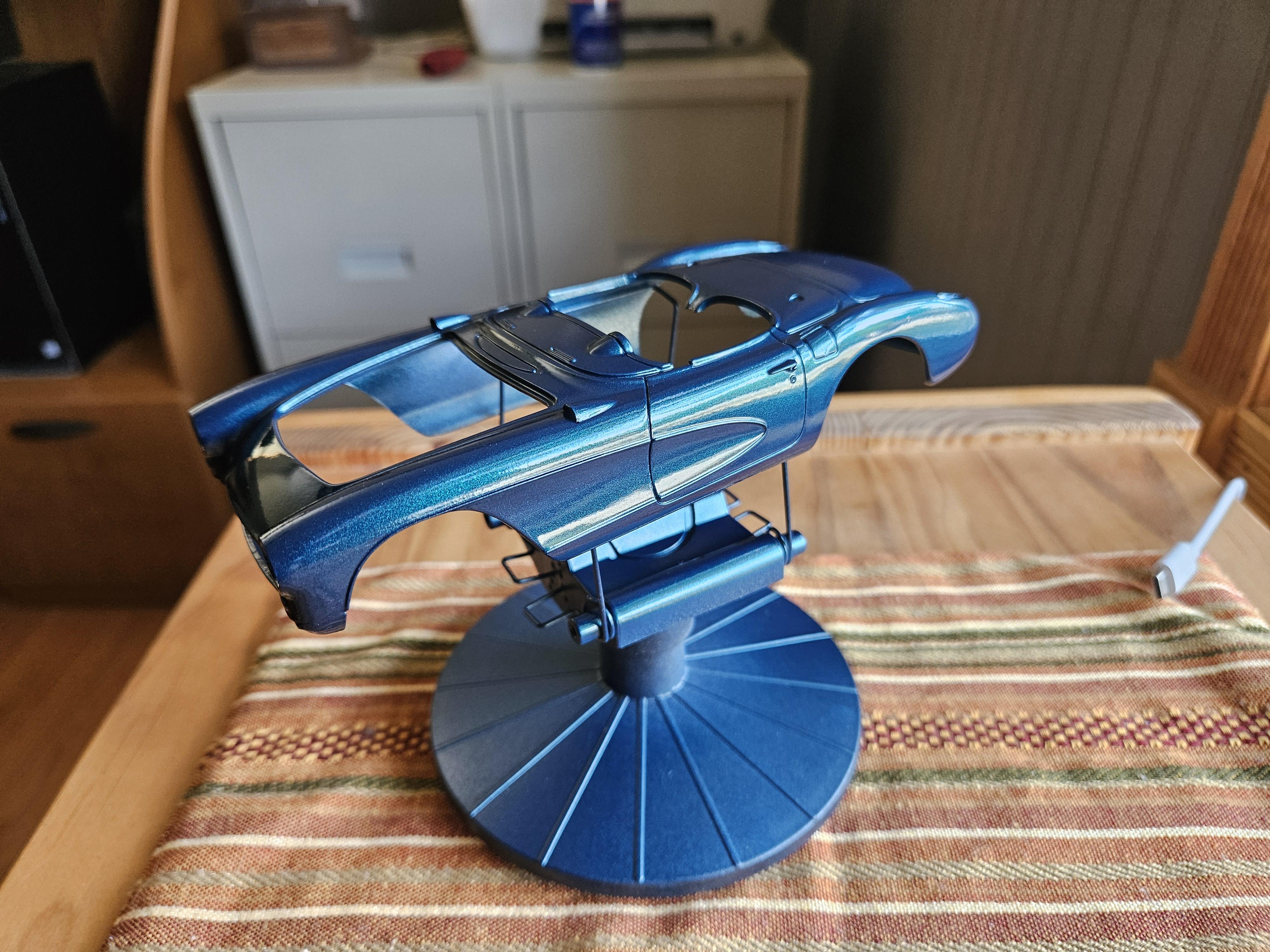

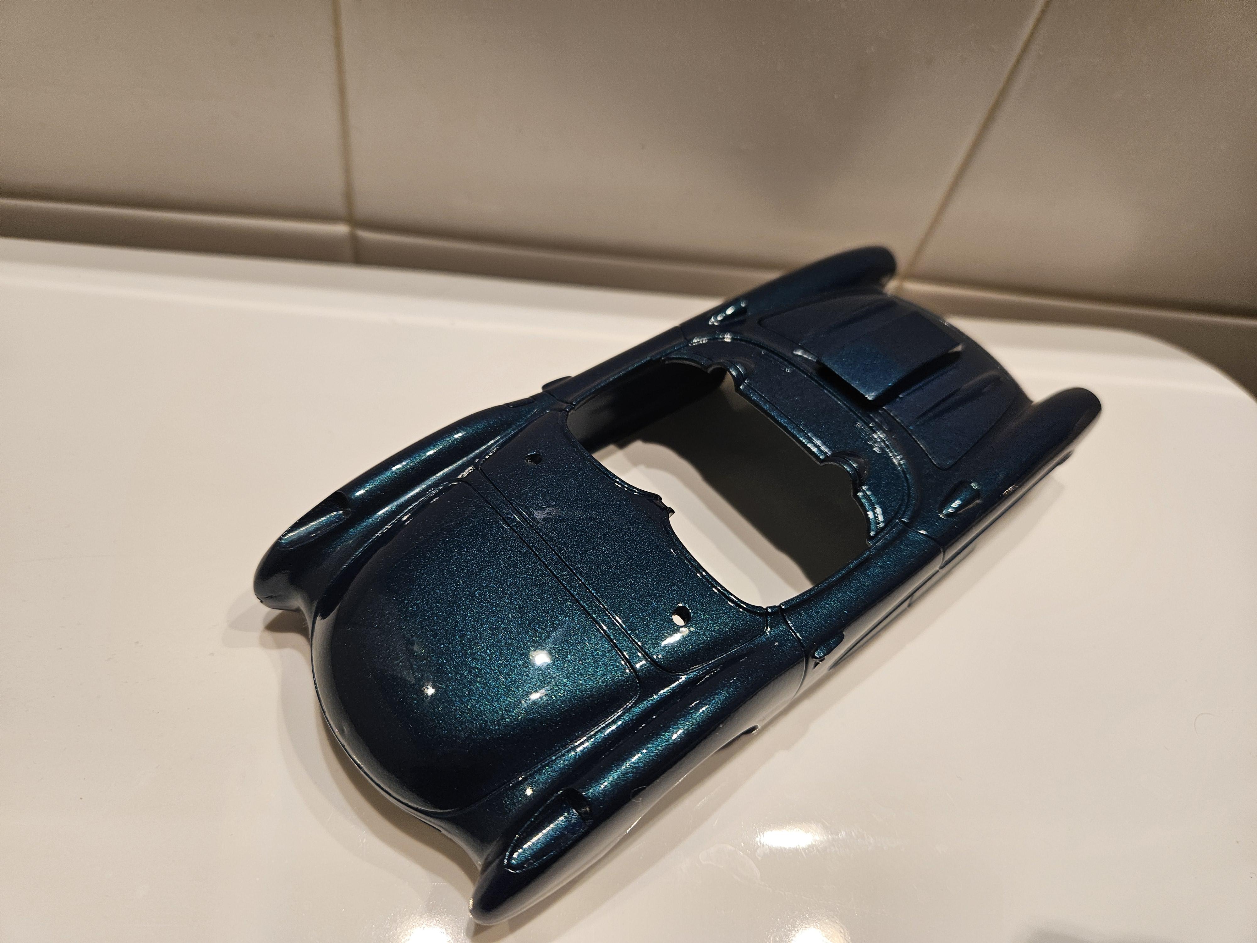

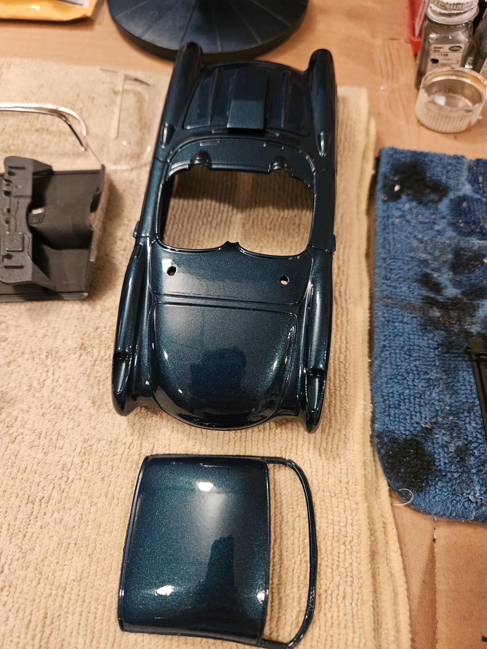

Got some paint on it last night, came out fairly smooth, got a couple small pieces of lint/dirt in the paint that ill have to knock down with some fine grit paper then shoot some clear on it.  Not bad though for a rattle can job.  Paint is GM mystic teal automotive touch up that I had mixed up in a spray can.
  • Like 1

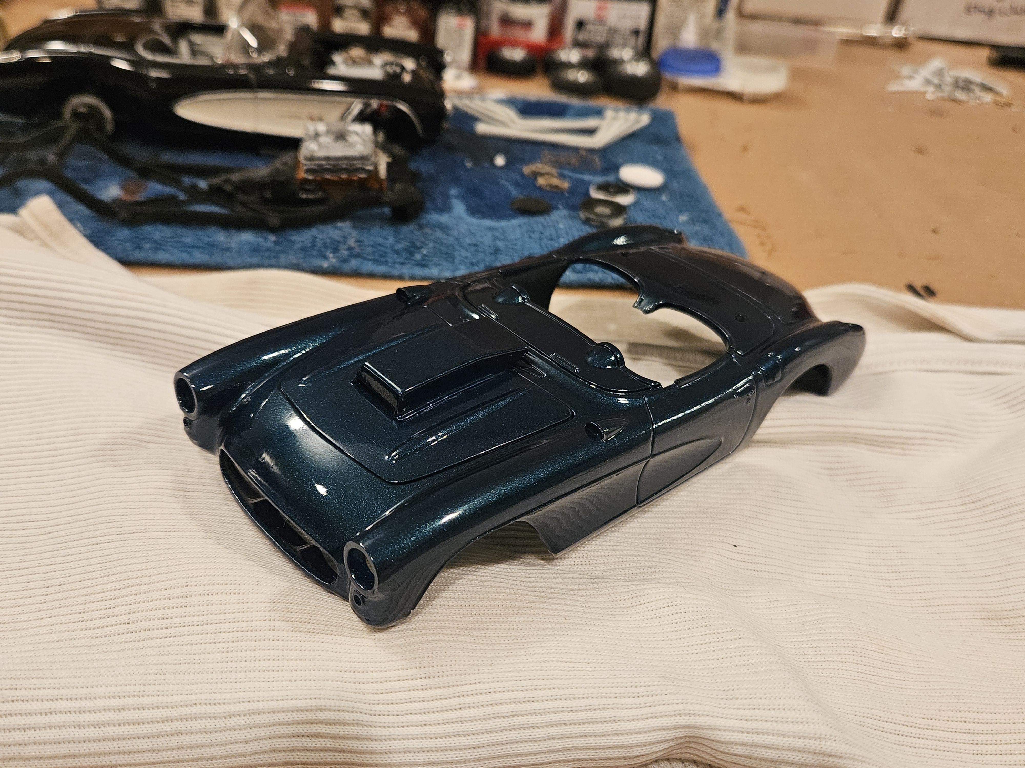

Paint is finished to my liking.  Had to strip and repaint and clear the hood after having some reaction with the metallic in the paint and clear coat.  Used rustoleum clear and lightly sanded and buffed a few spots.
  • Like 2

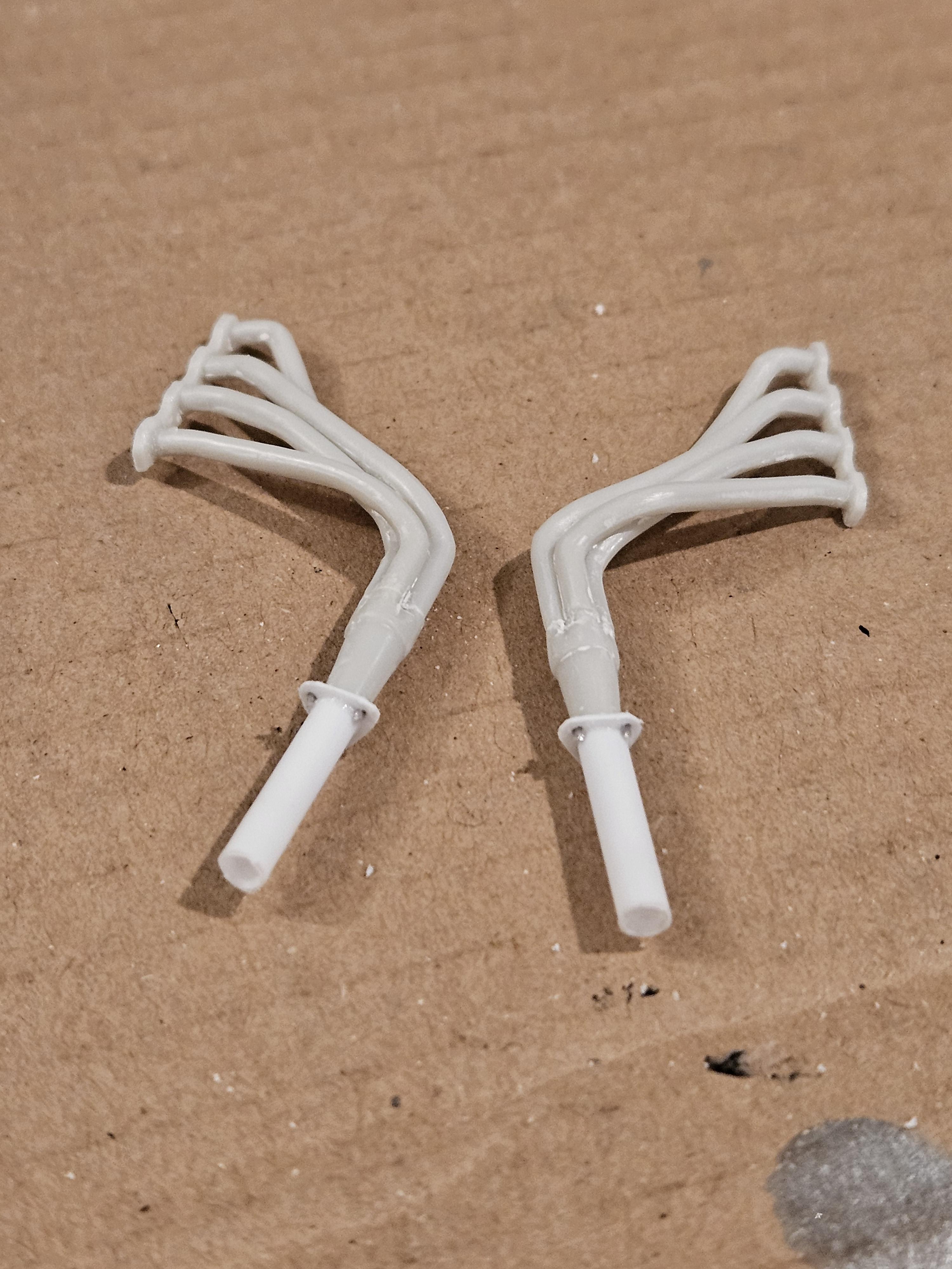

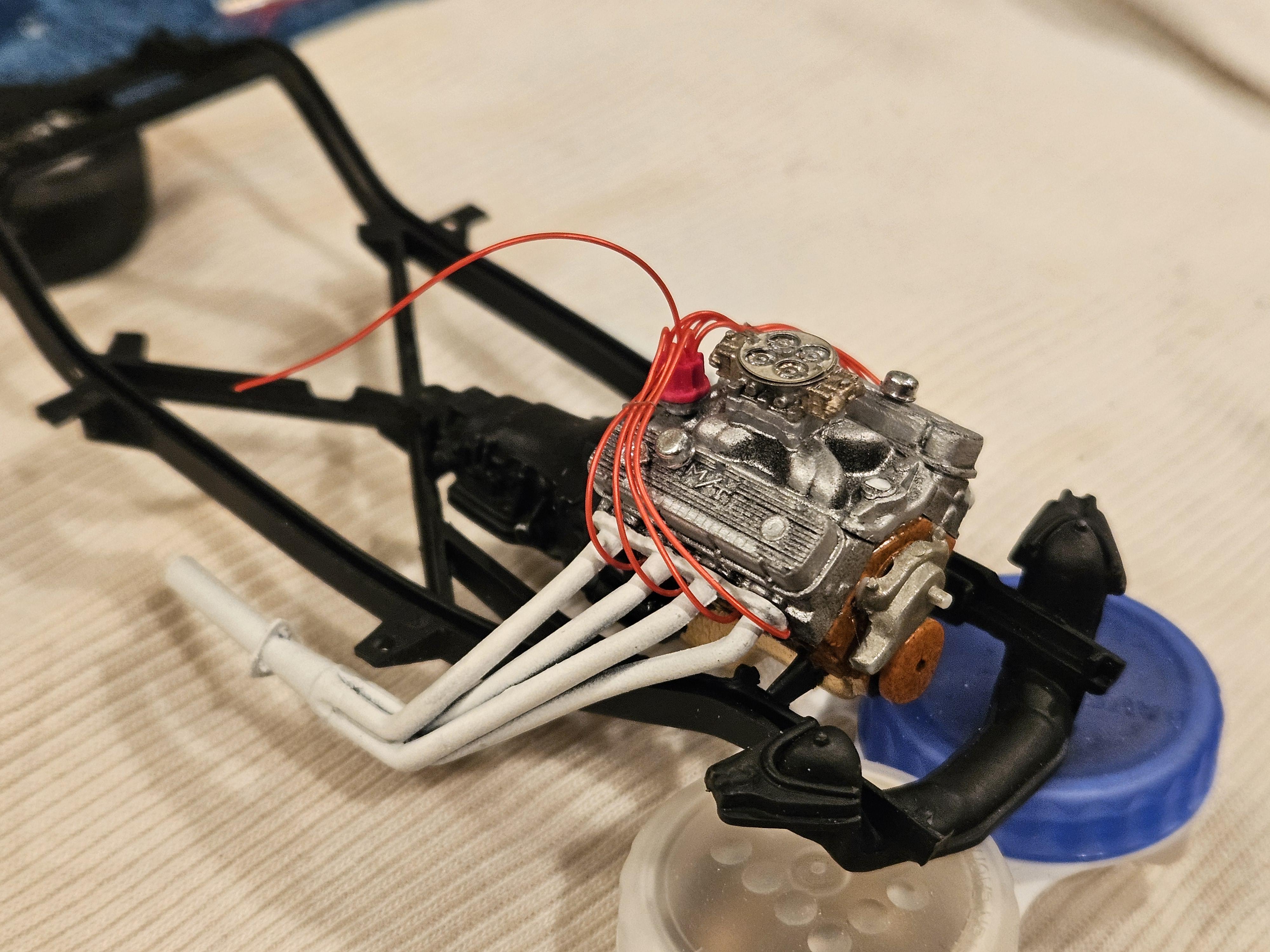

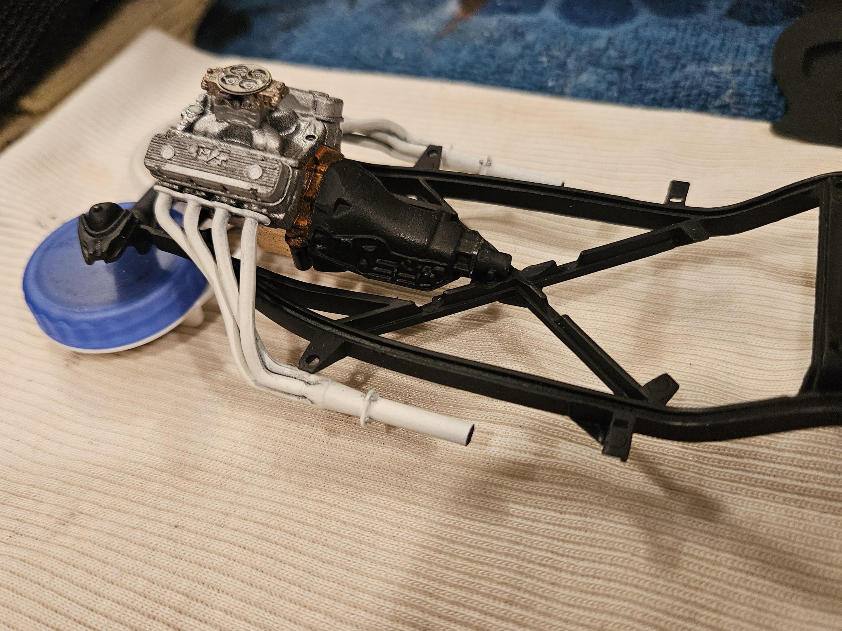

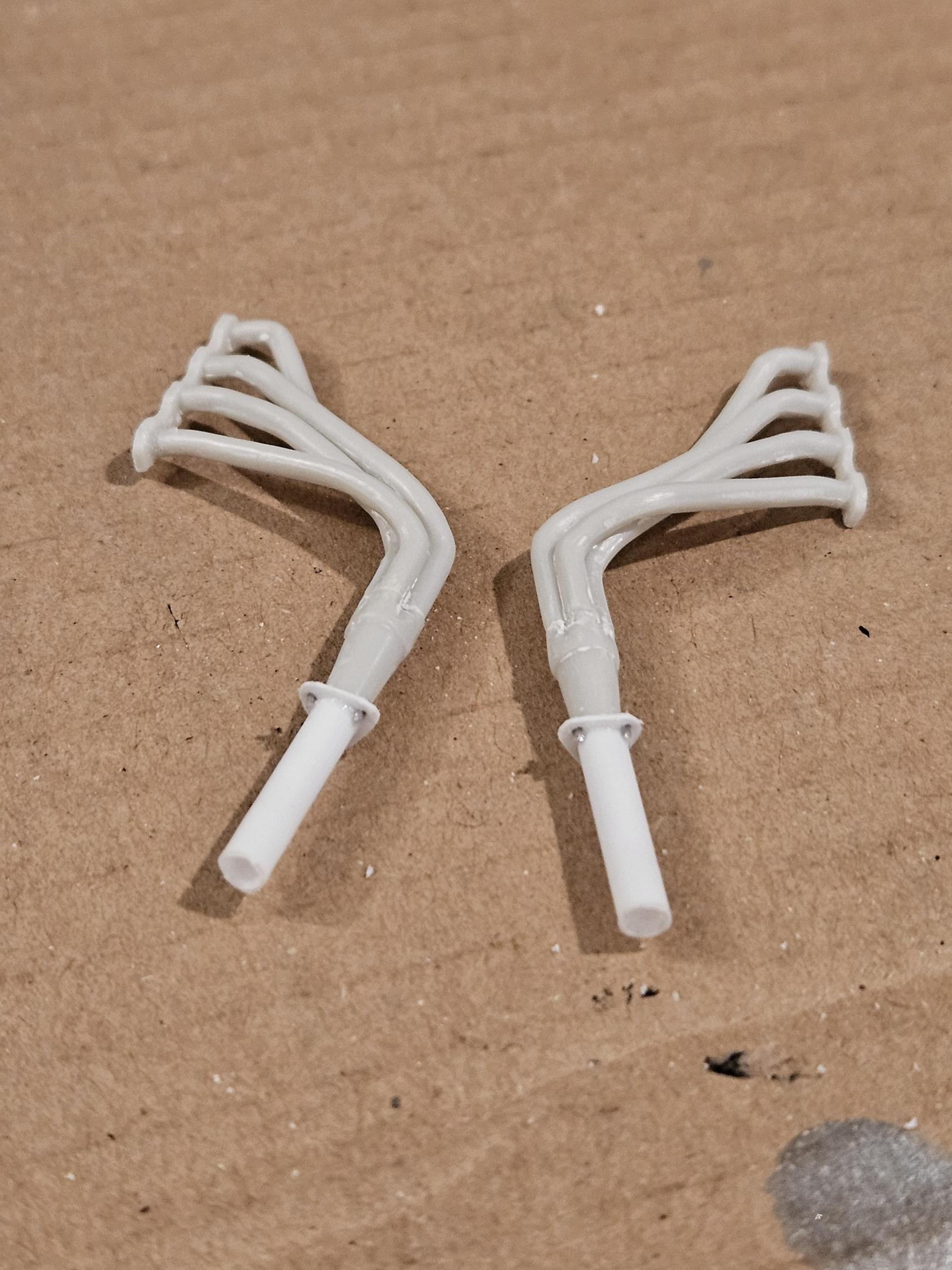

Modified the kit headers a bit, shortened the primary tubes a little and chopped off the super trap mufflers, added flanges and collector extensions.  Plan on painting them white and dirtying them up a little to give it a used look. Then I can mount them to the engine and put in a wired distributor.
