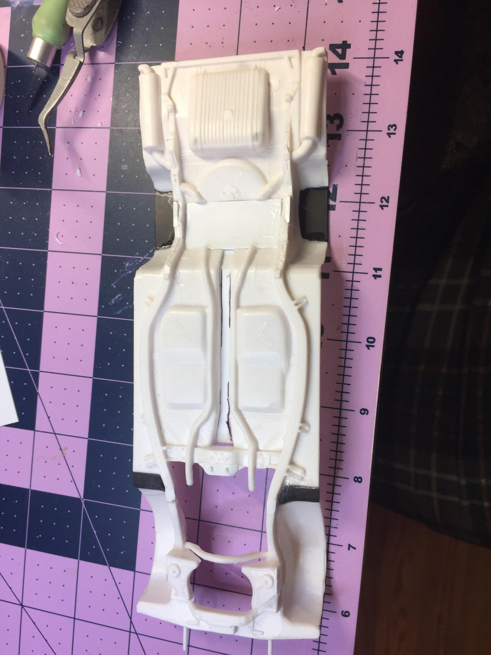

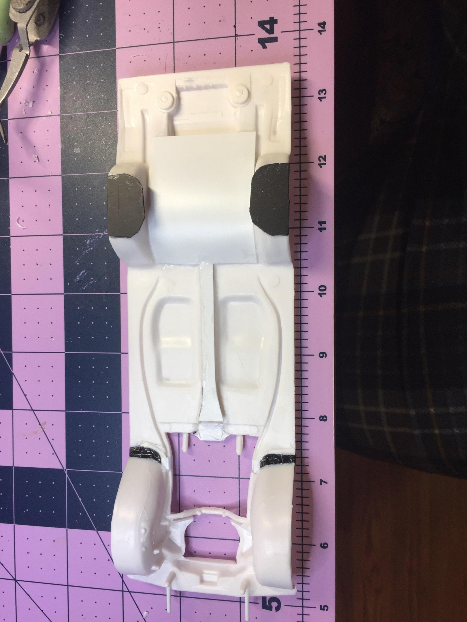

After having bought a nice '60 Starliner kit only to steal the chassis and firewall, etc. in order to build a decent model of a '63 Galaxie lightweight, I fell in love with the awesome body style of the '60. Being a cheapskate and somewhat thick-headed, I decided to use the discarded '63 chassis/floor pan under the gorgeous '60 fastback Starliner. This necessarily includes the '63 firewall which ain't too bad, really, but the chassis is pure dog poop.
I started hacking away on the chassis and you could describe my actions as "going off half-cocked". I lengthened the chassis at the firewall.? - not sure why but I decided to leave it that way. It seems to work except the rear axle thingie was too far back. I suppose I could have just drilled holes a bit forward (I did ?) but I knew I wouldn't be happy with that (I wasn't ?).  It was time to get serious and force my will upon this turd so I spent several hours today beating that P.O.S. into a real....um.....well, you decide.
IMG_6368.thumb.jpg.260fc2c598c876d258d0fd32bbf7182b.jpgIMG_6369.thumb.jpg.e70070afe8903dd6f8444be95ce1f98e.jpgIMG_6371.thumb.jpg.196bbf19b9dd5900c75d3d8b7a87eef3.jpgIMG_6370.thumb.jpg.76663c66e6287490ca4af92443f4fc4d.jpg
I attacked the blobular rear end with my sprue cutter. When the violence subsided, I closed the holes with some .015.  I made quite a mess so I cleaned it up a little with my trusty Micro and patched in the somewhat vague frame over the axle area. I could not come up with a proper 9" Ford axle but was able to locate this nice Dana unit from the Revell '68 Dart GT.
I replaced the cross member that I hacked out earlier and patched in the tail pipes (it ain't pretty but it's way better than what was there ?.
The length of the springs is perfect but the axle locating pins are a bit off. On the axle housing, the spring pads are too far in-board also. Some minor evergreen work and it should fit nicely.
I won't go into the wheel selection process but I will say that I'm grateful for the '41 Plymouth kits lying around here.  I think I have the rear end located to my satisfaction now. Thanks for reading all this, you must be very sorry that you didn't just look at the pictures ?

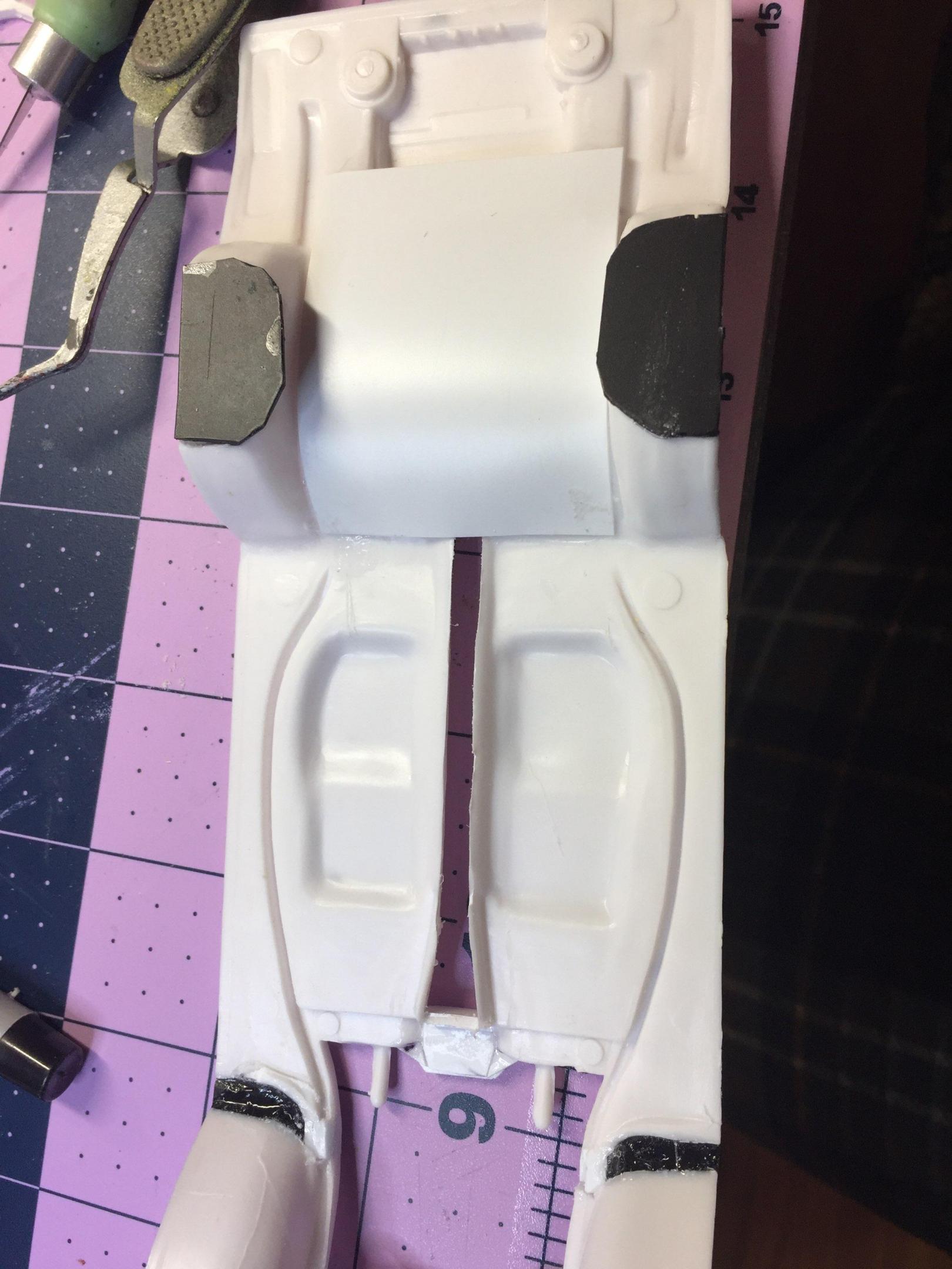

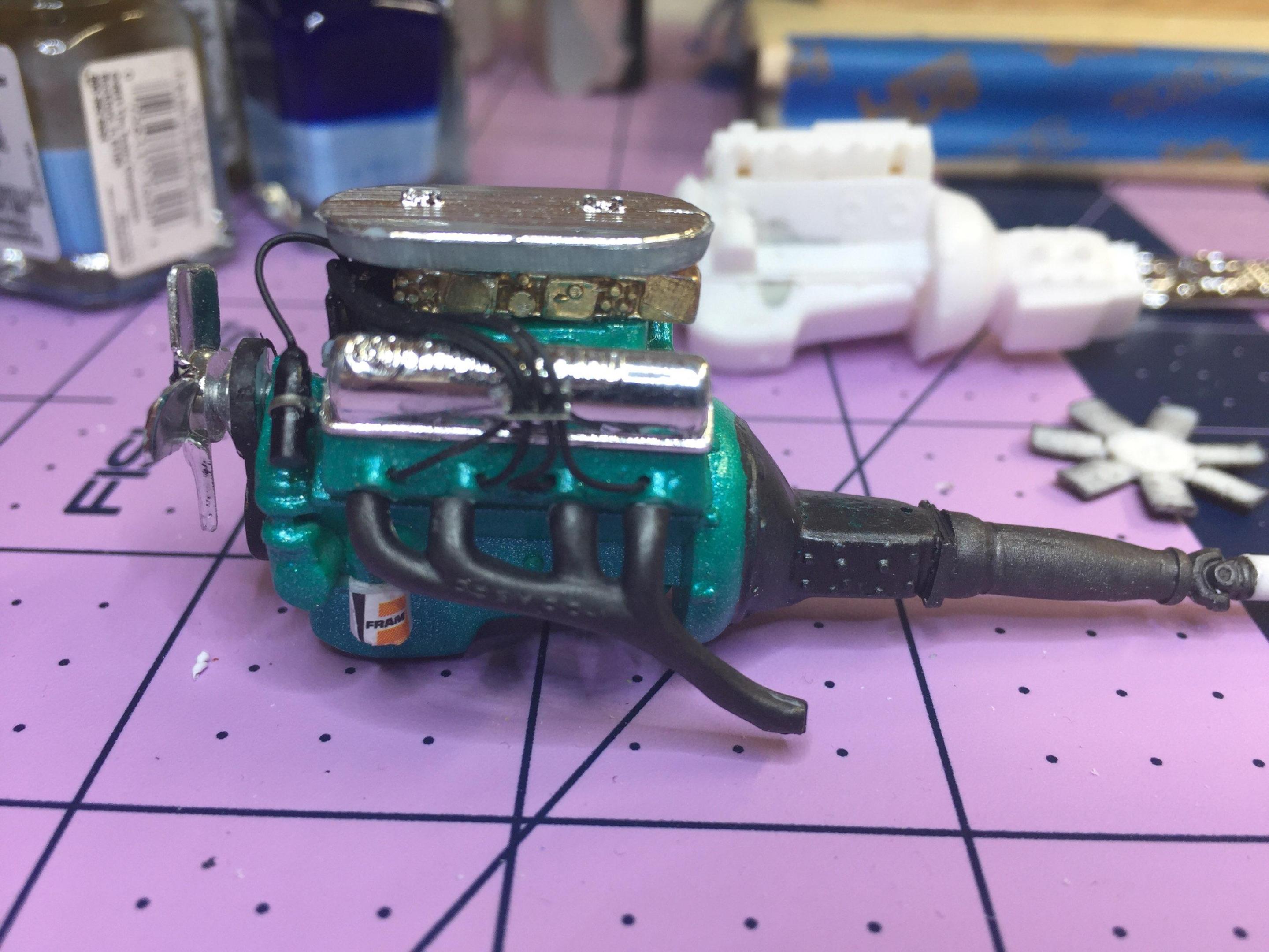

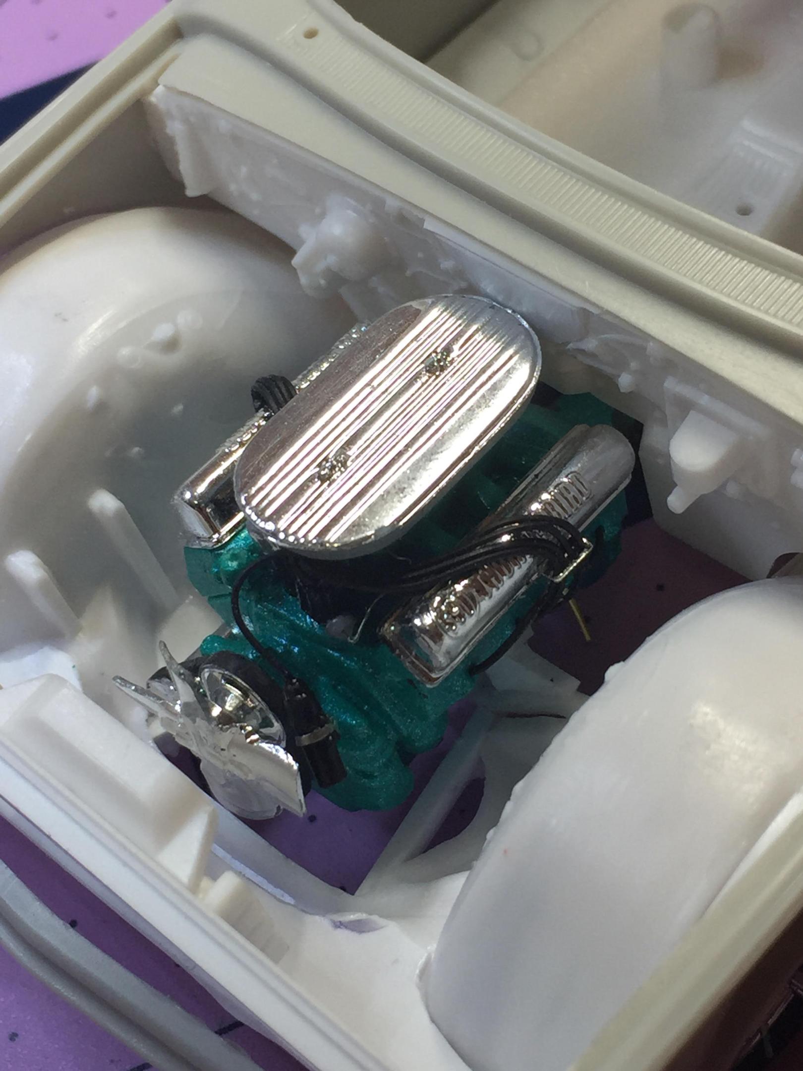

A fairly productive day for me. I was able to secure the rear axle housing to the suspension and I fabricated a pair of shock absorbers to give the dog-poop chassis some detail.  Satisfied with that, I moved on to the radiator support wall using some .020 sheet and .060 strips.  I improved on the non-existent side motor mounts (by creating them) and fiddled with various dysfunctional items that are not worth mentioning. So far everything seems to be working.  I'm not happy with the wheel/tire combo but it will do until I can find better. Thanks for following ??

Wow, those are some funky looking headers.?

 Greg, that's the kit engine from the '63, as is.  It'll be fine ?...the distributor? that's funky! The way the heads fit, the compression ratio is 00:1 ?

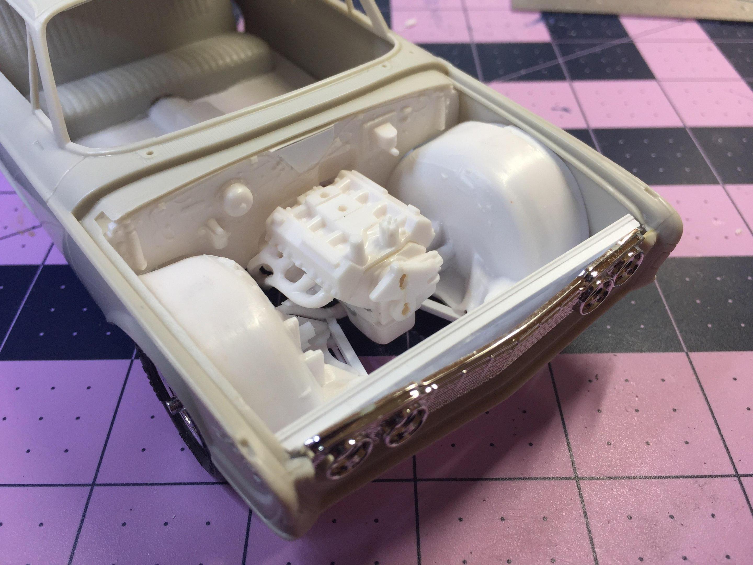

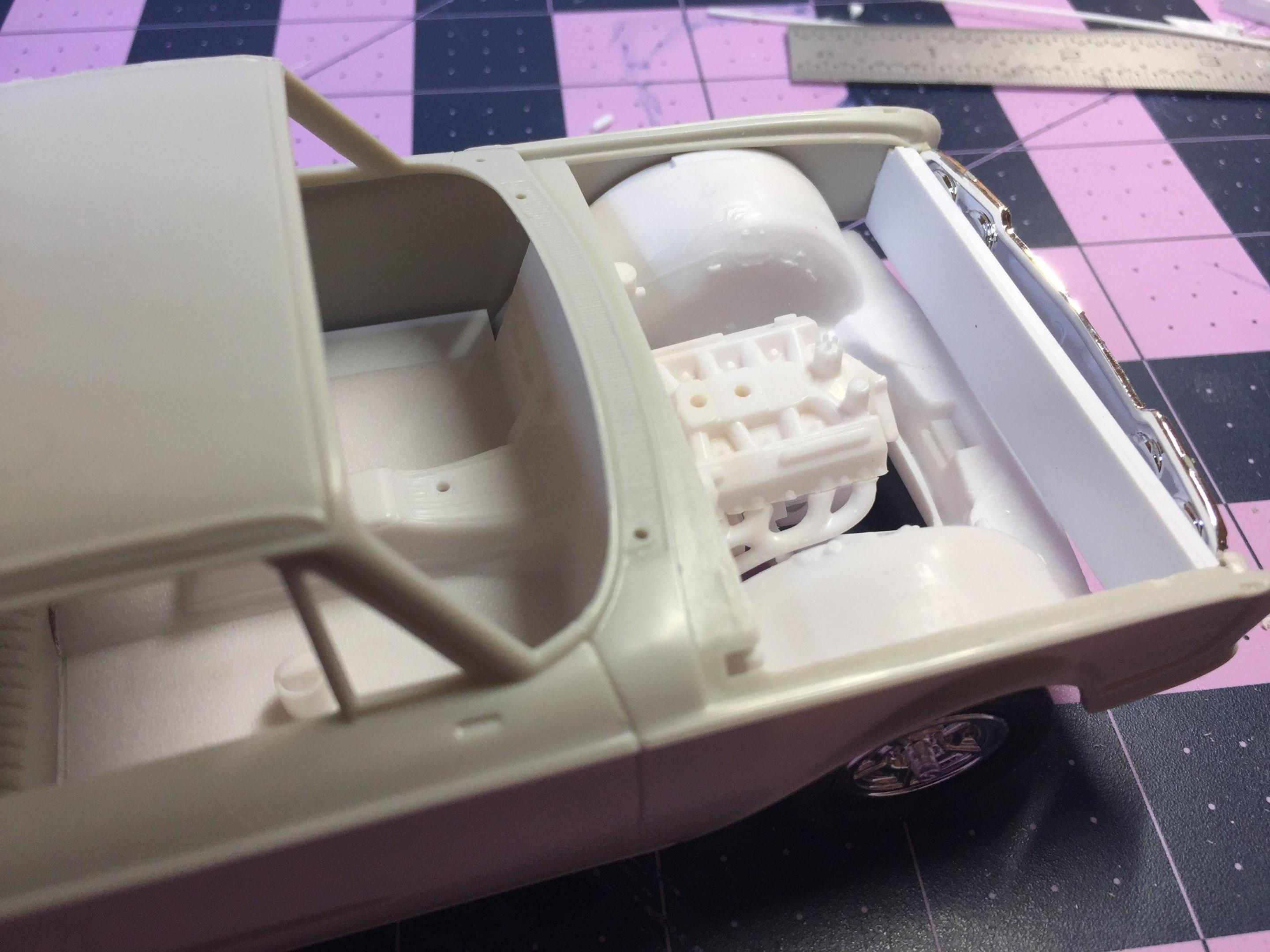

A very a quick update for you night owls ? ....there's been a change.  The '63 mill is now out. I found, while rummaging through some boxes, a completed FE that appears to be a 390 and its ready to go. I wish I could recall what it was for and why I didn't use it but it's perfect for a street custom like this. Chrome generator and fan, three deuces, and I had to use the "funky headers" from the '63.  it has a genuine Fram oil filter!  I had to turn the oil pan around and add a long tail shaft that resembles a leg off a table from my granddaughter's doll furniture. I got the wheel backs and the ?? chassis painted. If it's not still sticky (the paint) tomorrow, I will paint the exhaust system, gas tank and shocks. The lower A-Frames, I think, are from some Revell kit, maybe the '59 Impala? I dunno, but the power steering looks pretty much like Ford of the era. I suppose I've gotta hang a pump now. ?

good fit ?
