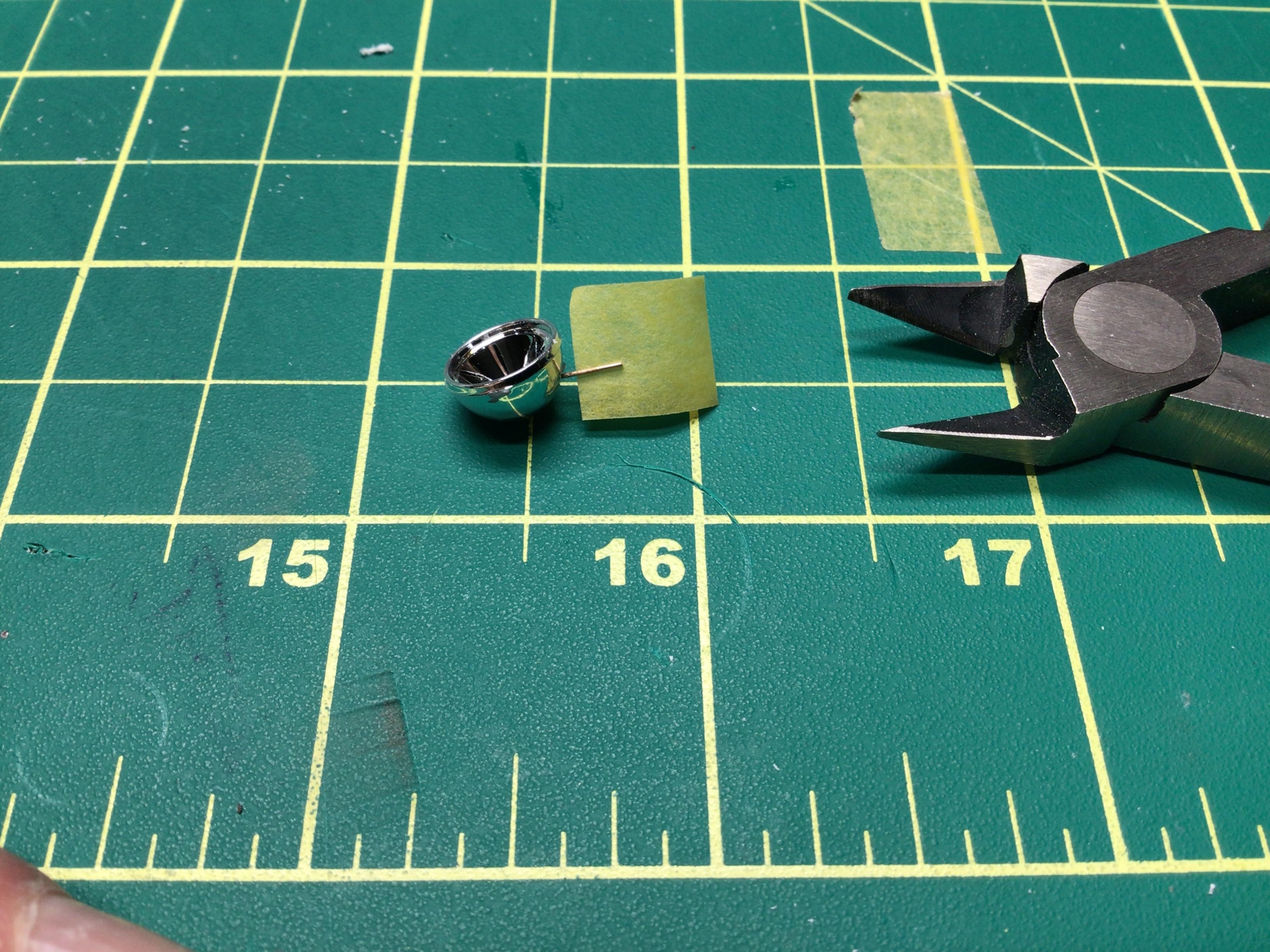

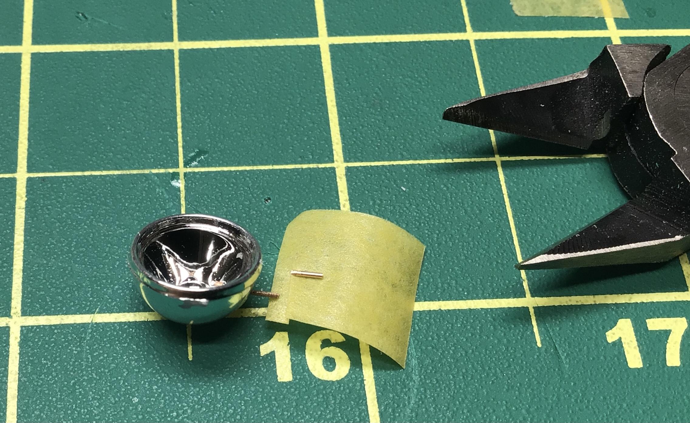

NOBLNG Posted July 6, 2024 Posted July 6, 2024 (edited) Simple tip to keep the cutoff from winding up in the carpet. Attach a piece of tape before cutting. Then fold up the tape with the scrap piece inside and toss it in the trash. Edited July 6, 2024 by NOBLNG 4
Straightliner59 Posted July 6, 2024 Posted July 6, 2024 Yes. A better idea than finding it with your foot! 2
stavanzer Posted July 8, 2024 Posted July 8, 2024 What a simple, yet powerful idea! Thanks for sharing it. 2
bobss396 Posted July 8, 2024 Posted July 8, 2024 I try to avoid anything sharp at all. I have plenty of .020" brass and some odd pieces of stainless wire. I have used the tape trick and it works. 1
