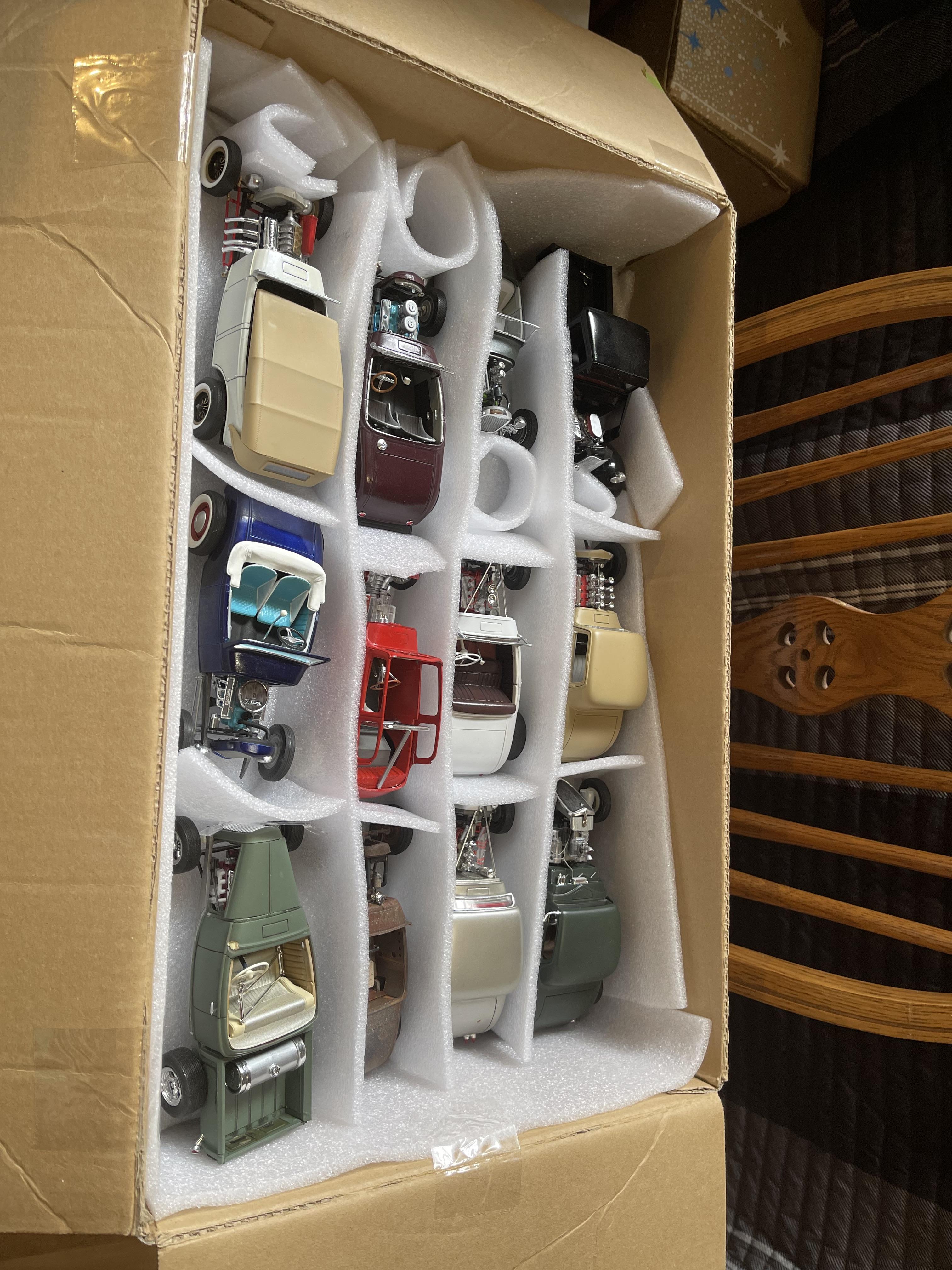

Bullybeef Posted July 16, 2024 Posted July 16, 2024 I was the shipper of this lot of built ups, I used semi flexible foam and made a partition between model, this lot made it across country with only a few loose parts. The box was four layers deep. 1 1
