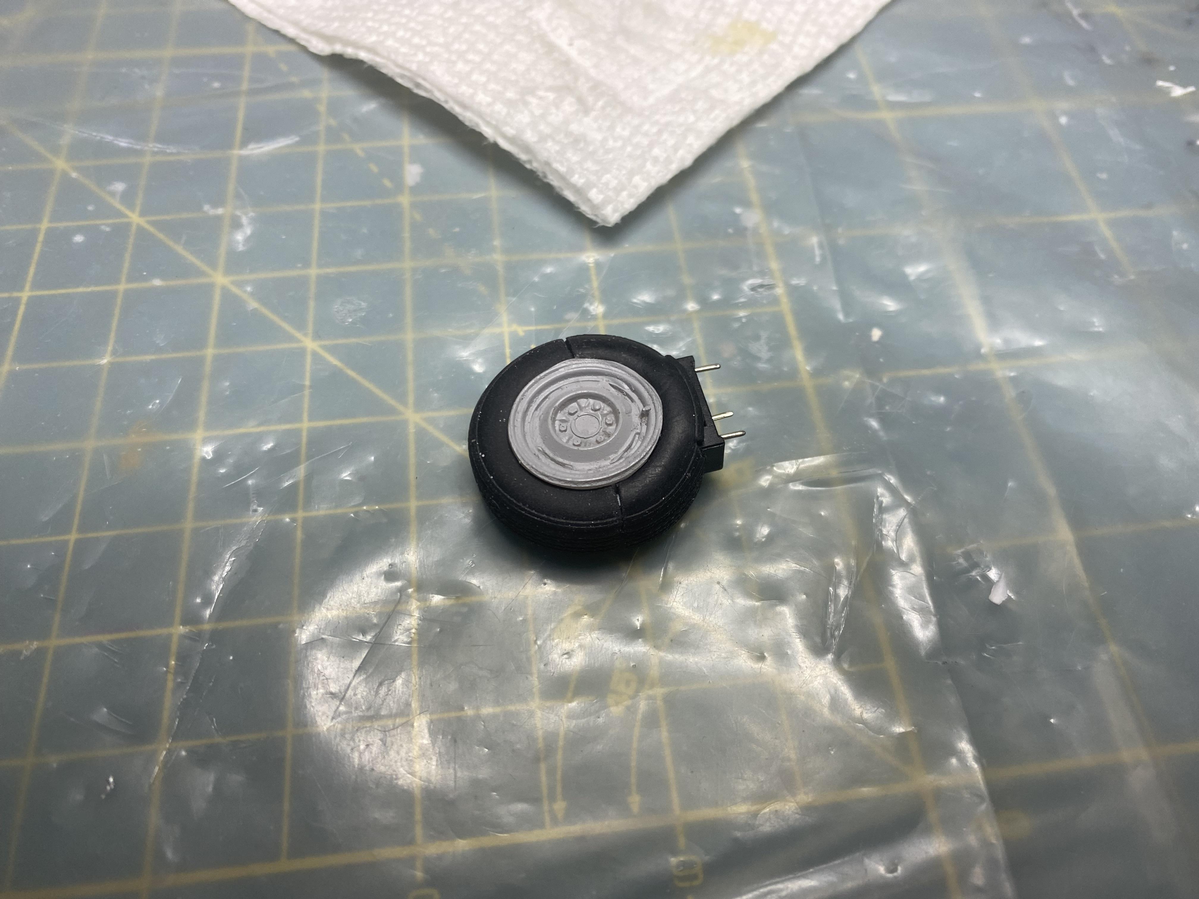

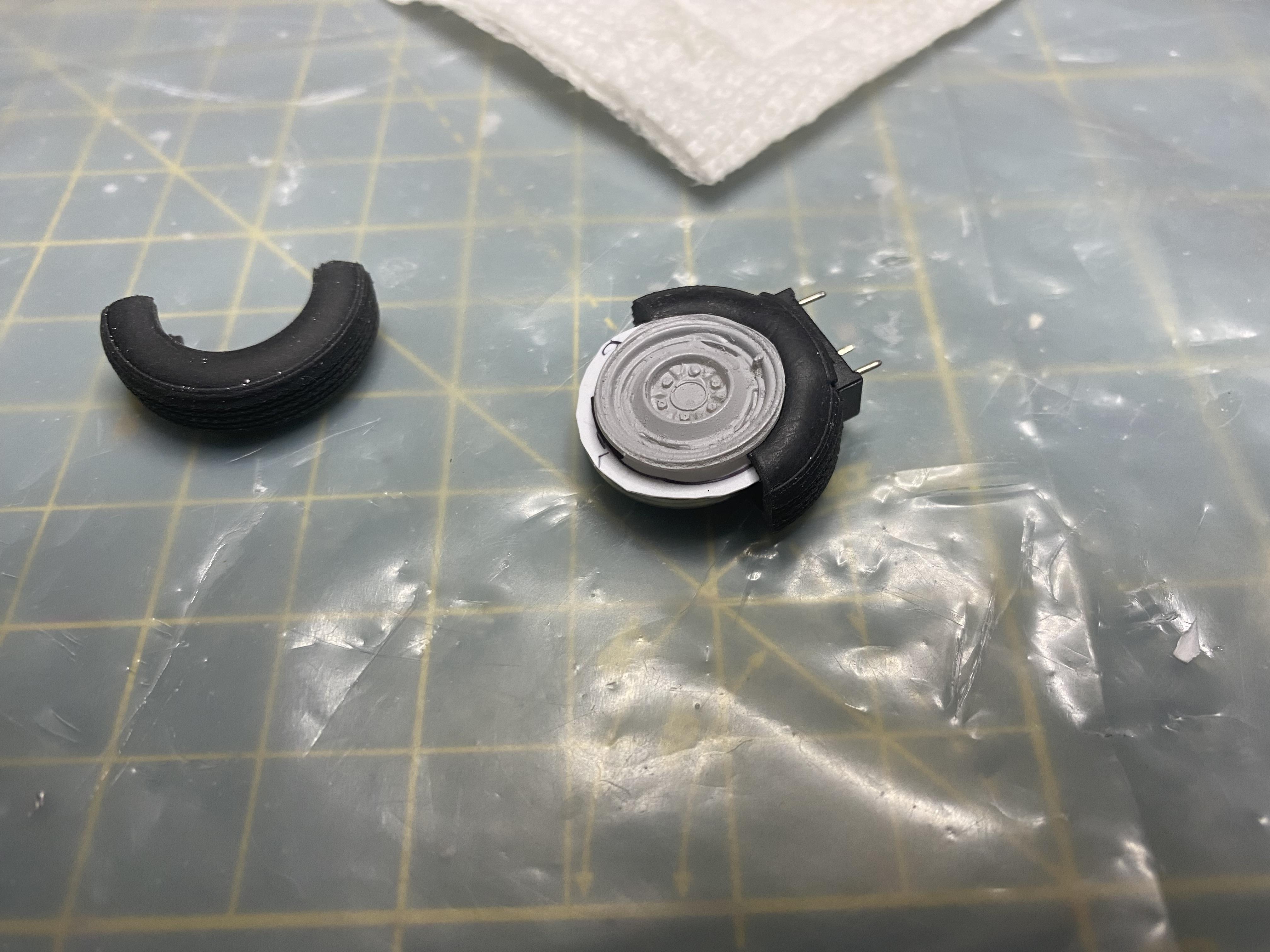

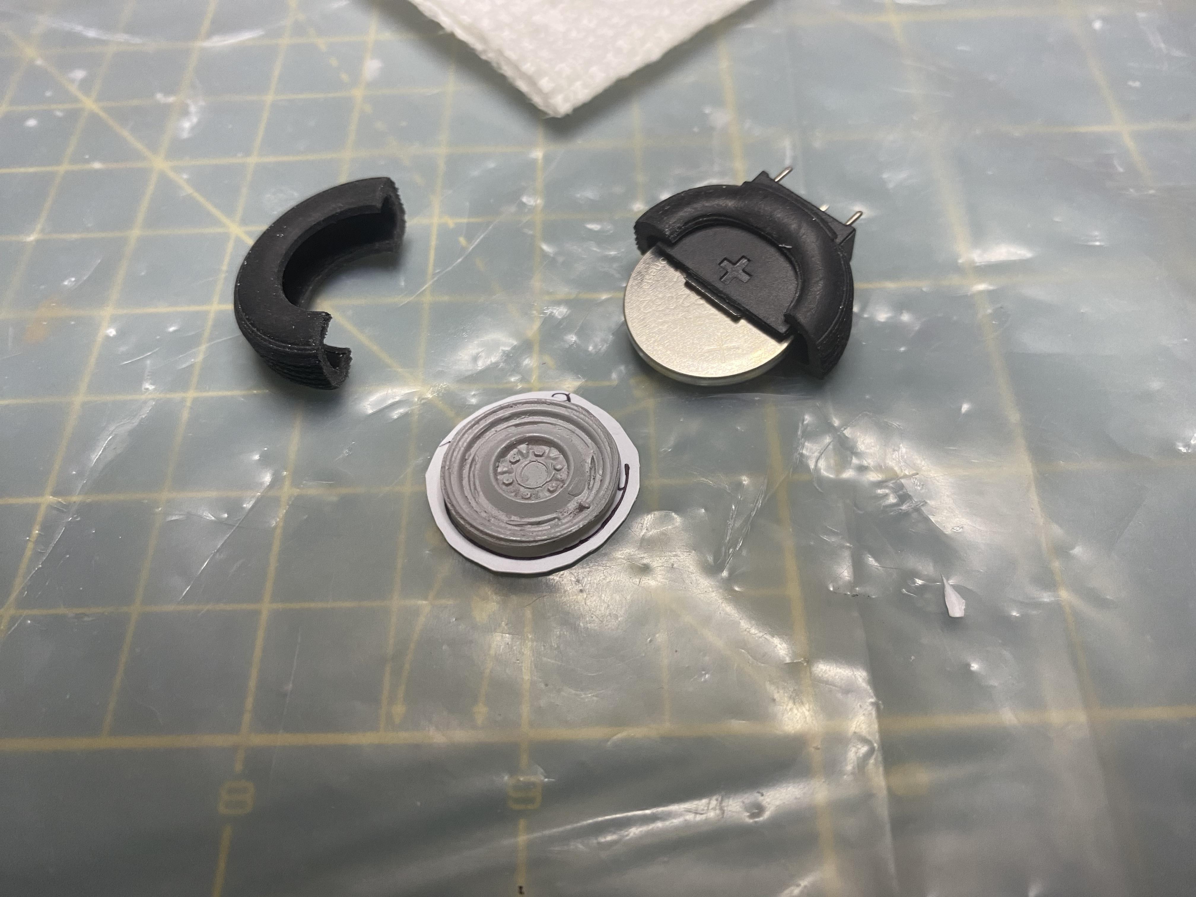

I resin cast a thin version of the steelie wheels that came with the kit. I think this will fit the bill for the spare tire : LED battery holder. :)

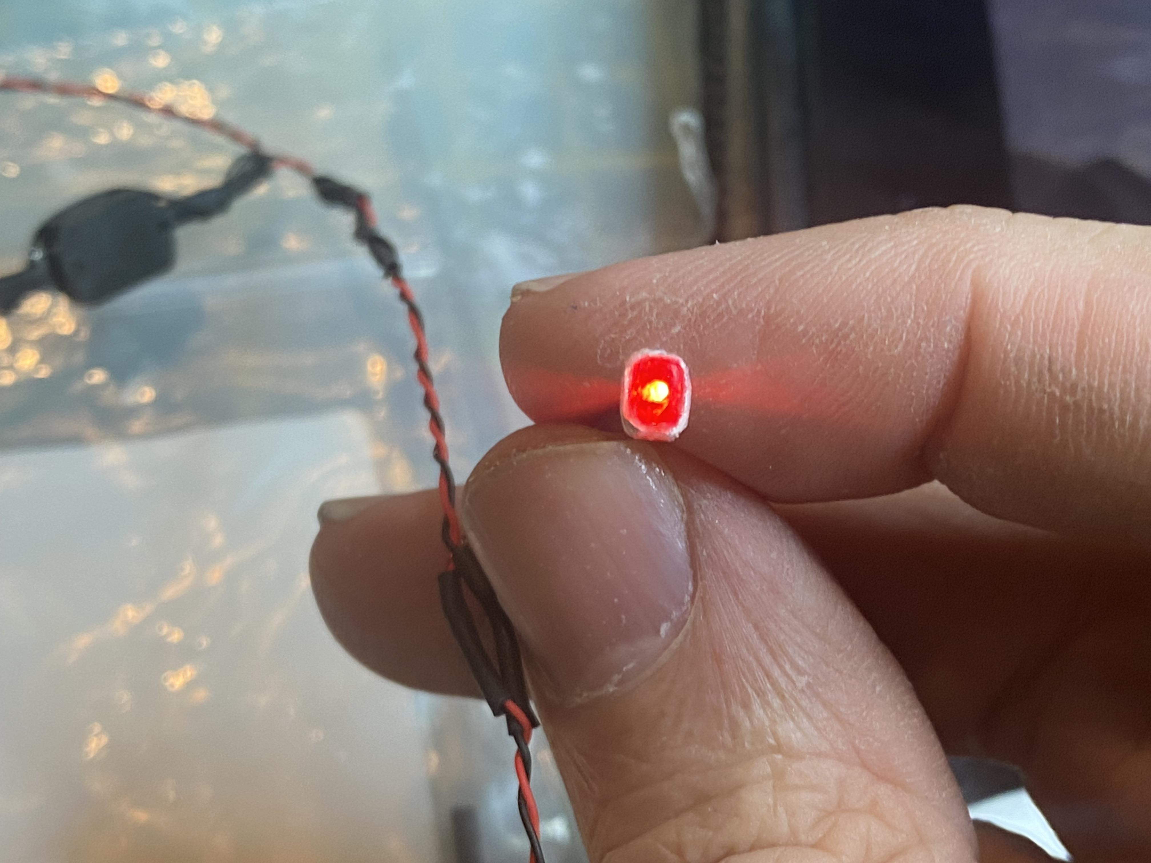

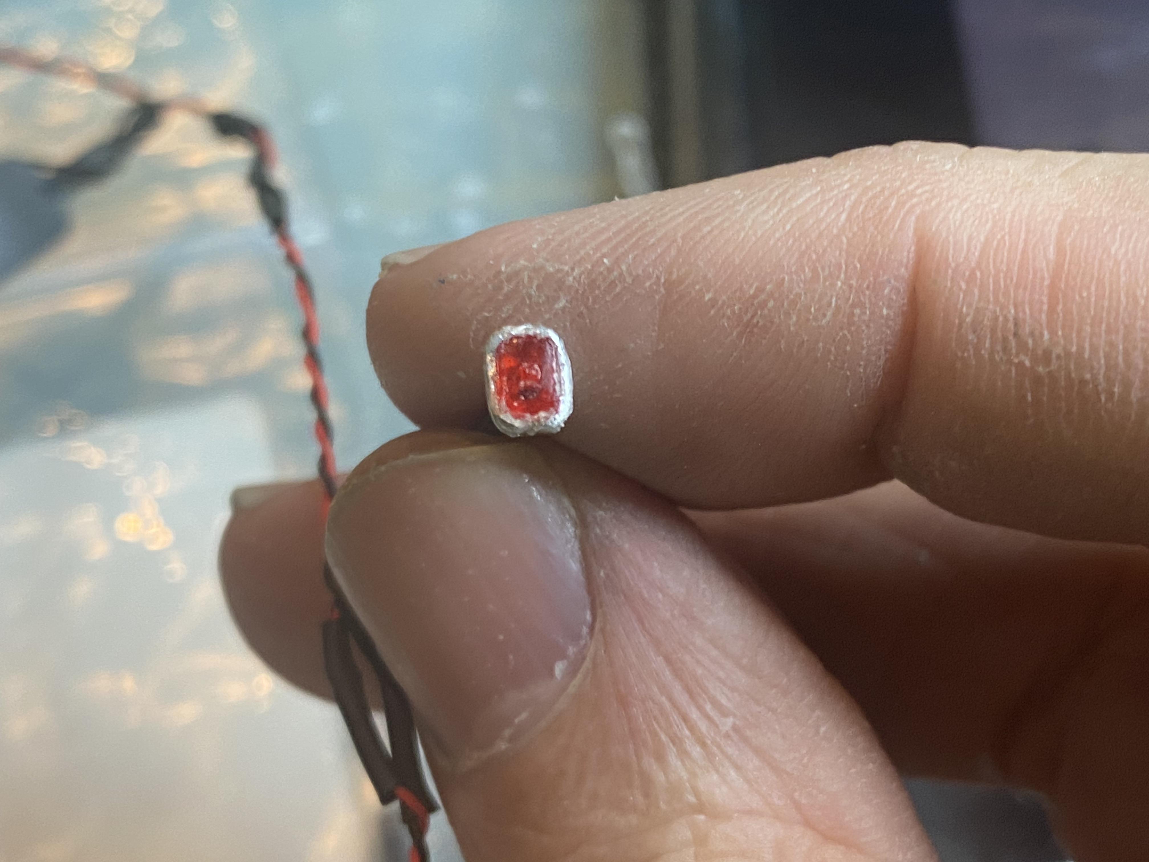

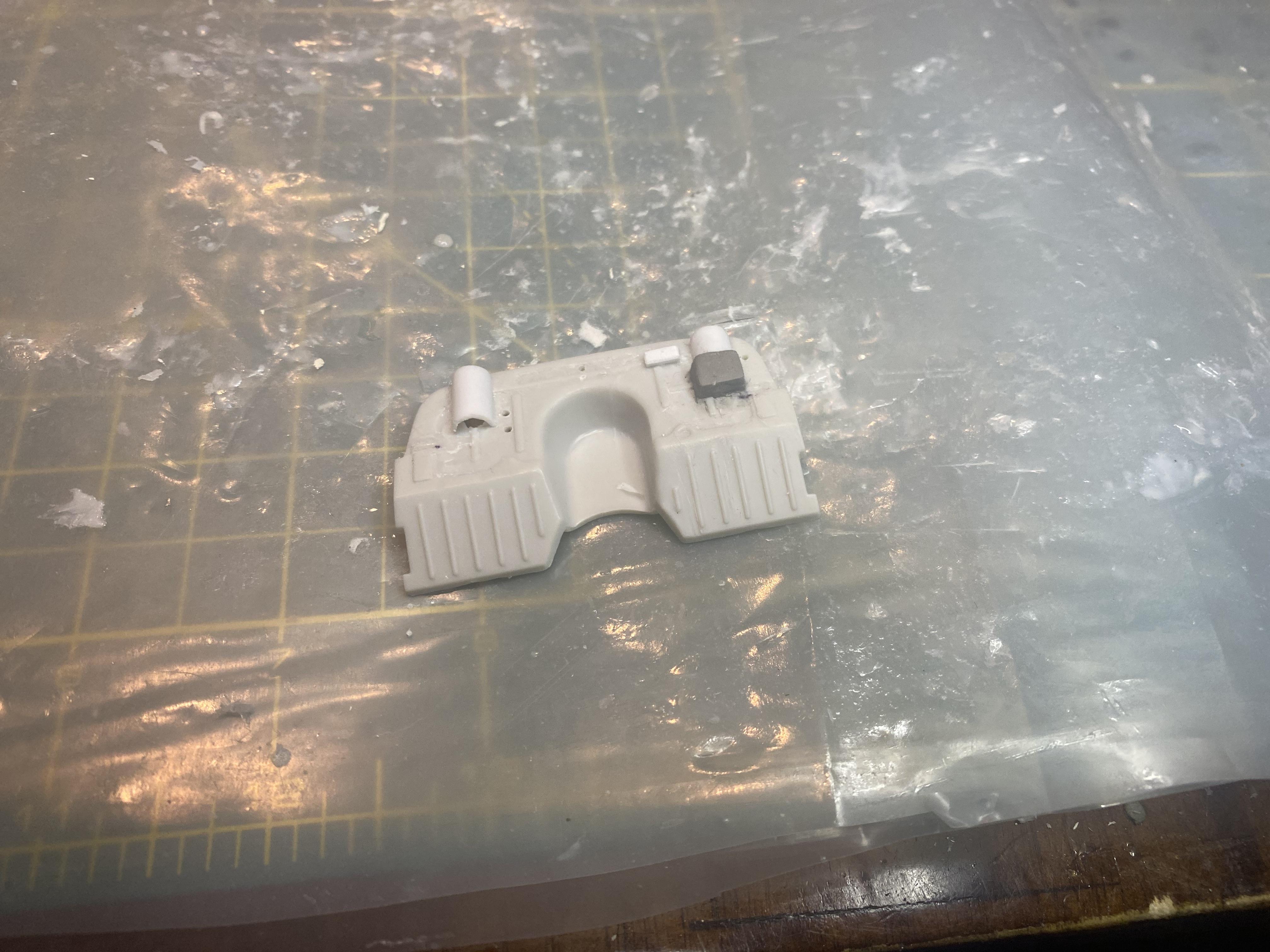

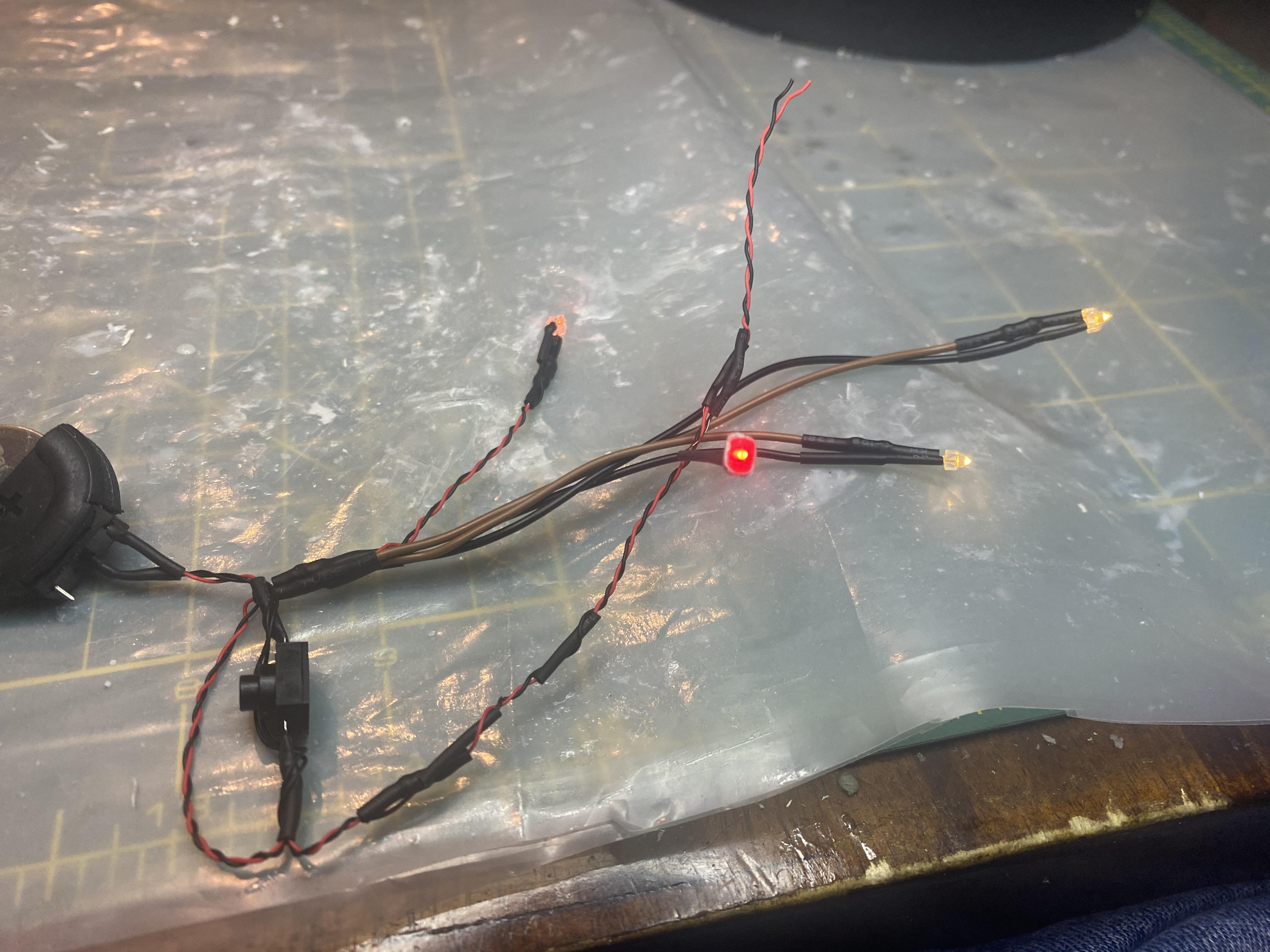

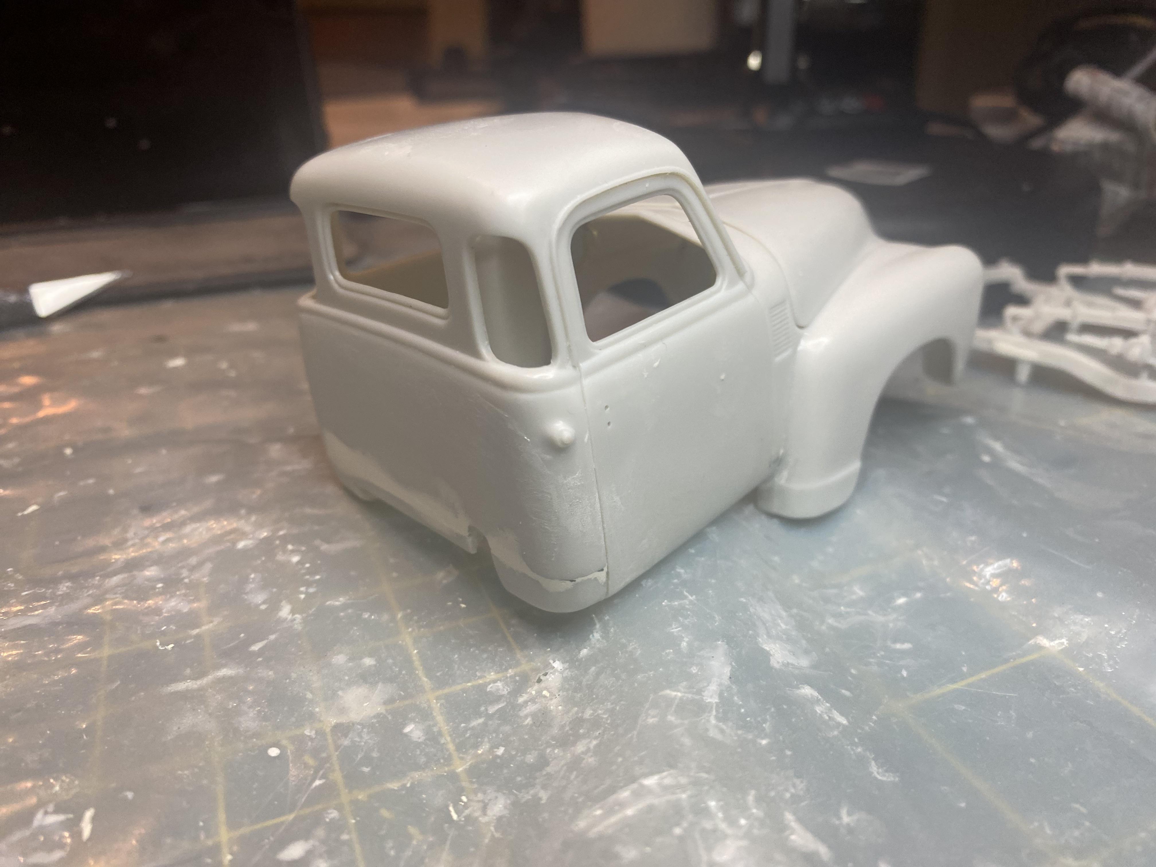

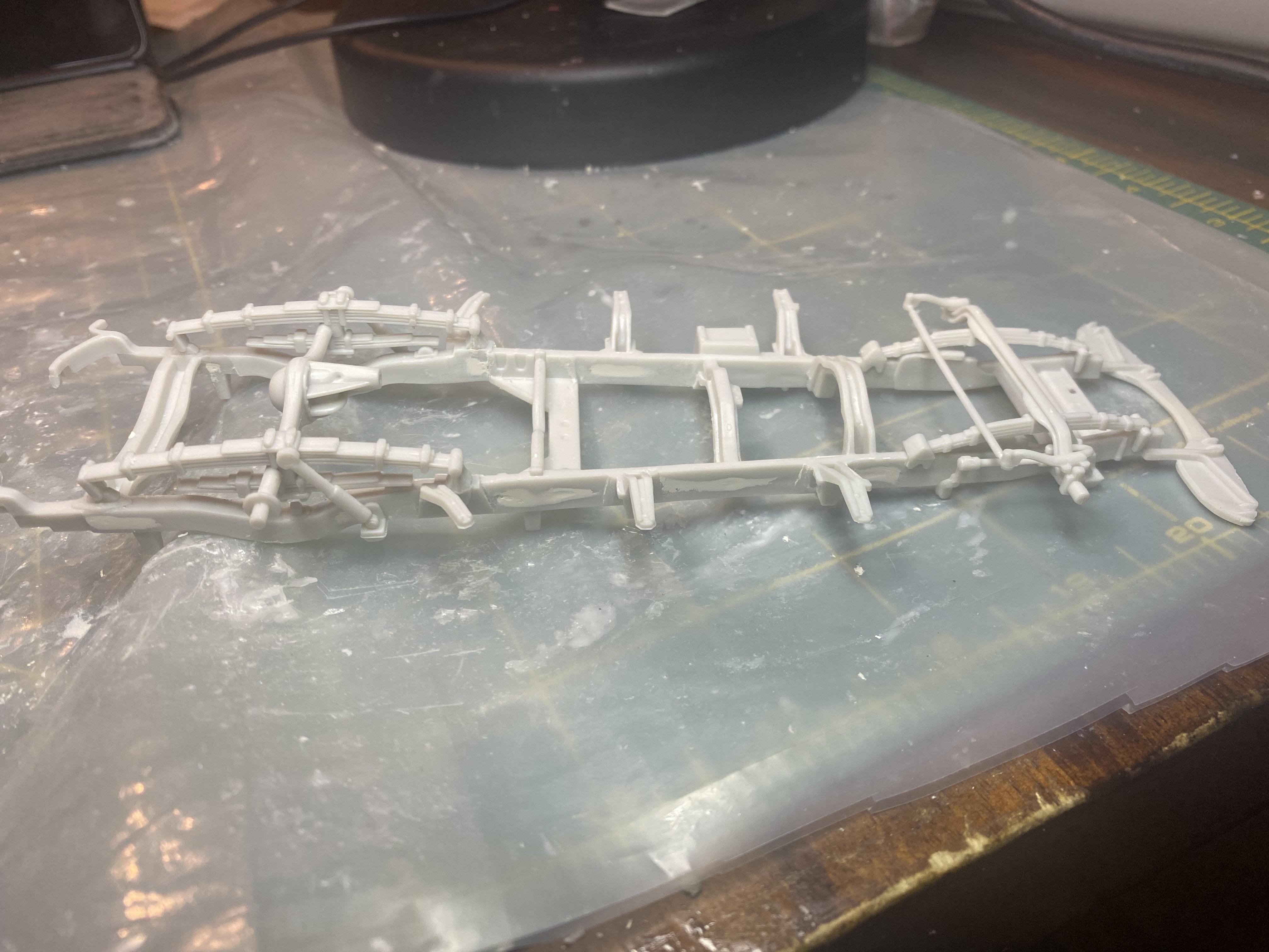

A bit of bad luck. Started creating the LED wiring harness and broke one of the tiny LED bulbs for a taillight. Had to order a new one. Did fill some issues with the body. I am almost ready to prime, fill and start to paint.

I have gotten a lot from Evan’s as well as Amazon. The LEDs seem to be brighter from Evan’s on average. The dash has always been a 1.8mm bulb the necessary color. 60s fords are usually green, older warm white. The truck taillights I am having to use pico bulbs to fit in the taillights, but they are fragile and I just ordered new ones and extras because I broke one. They make a kit for cars I have used if I can use 1.8 bulbs for headlights and taillights. Warm white for classics, cool White for newer cars like my 2018 mustang build.

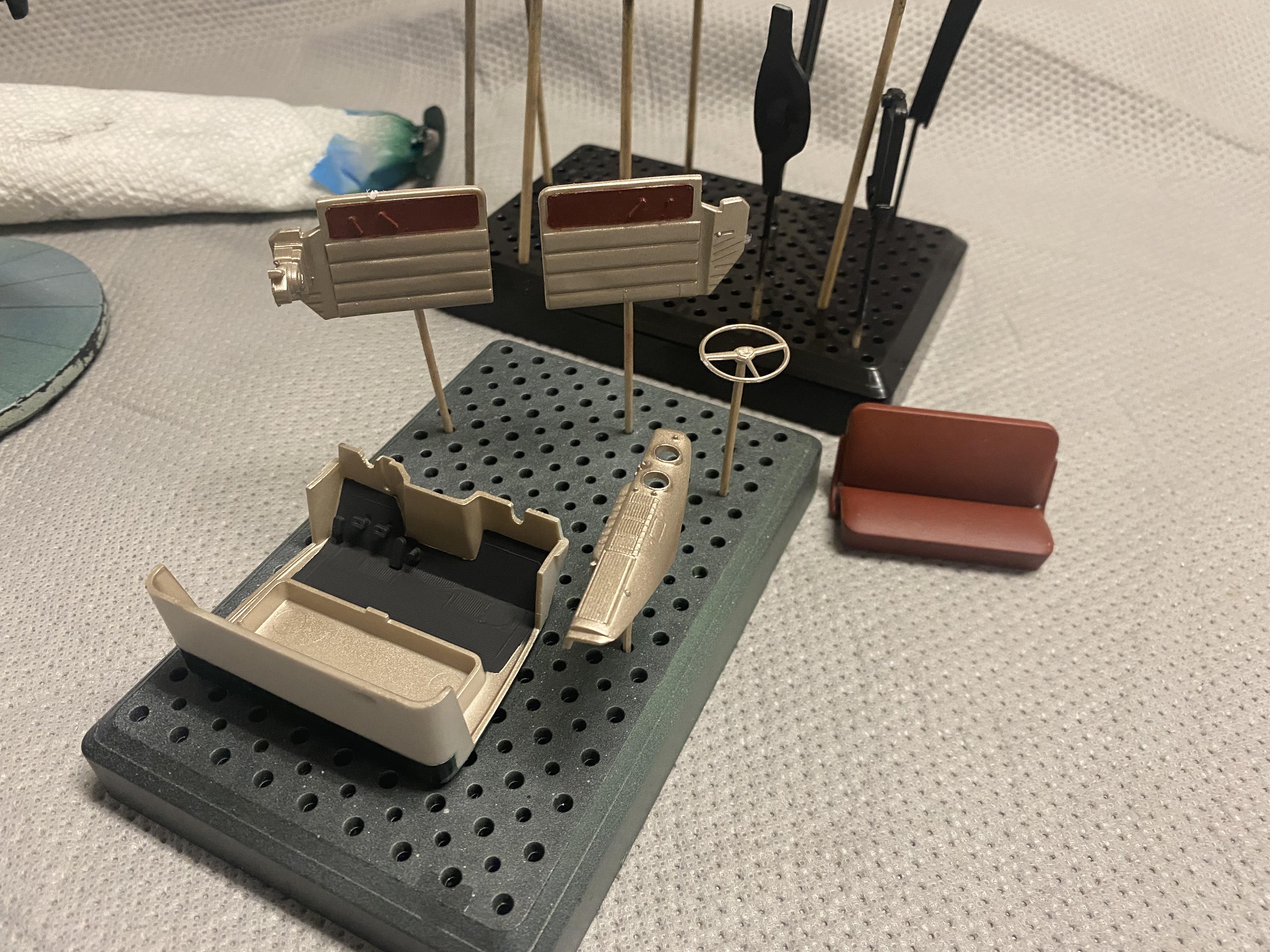

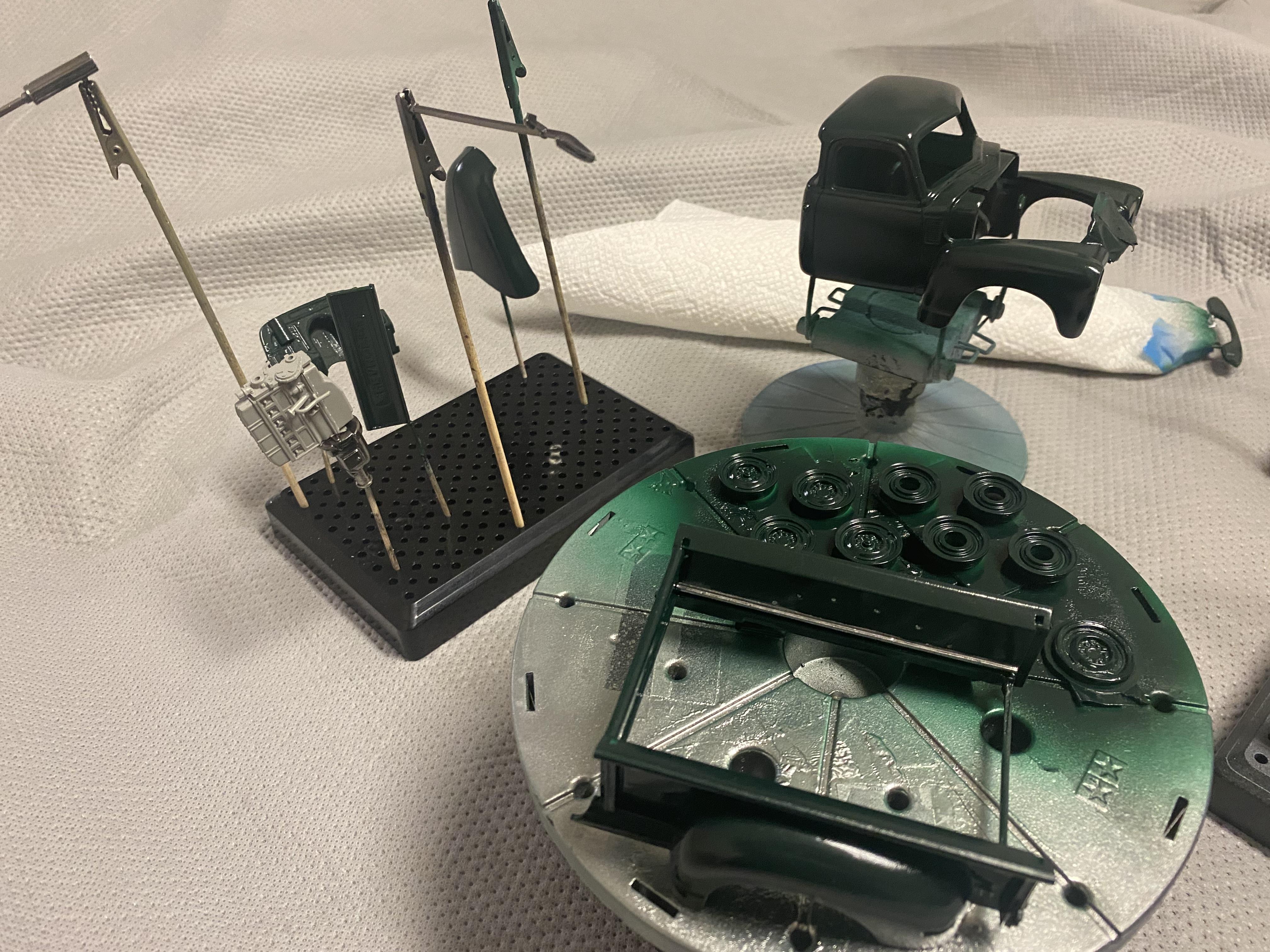

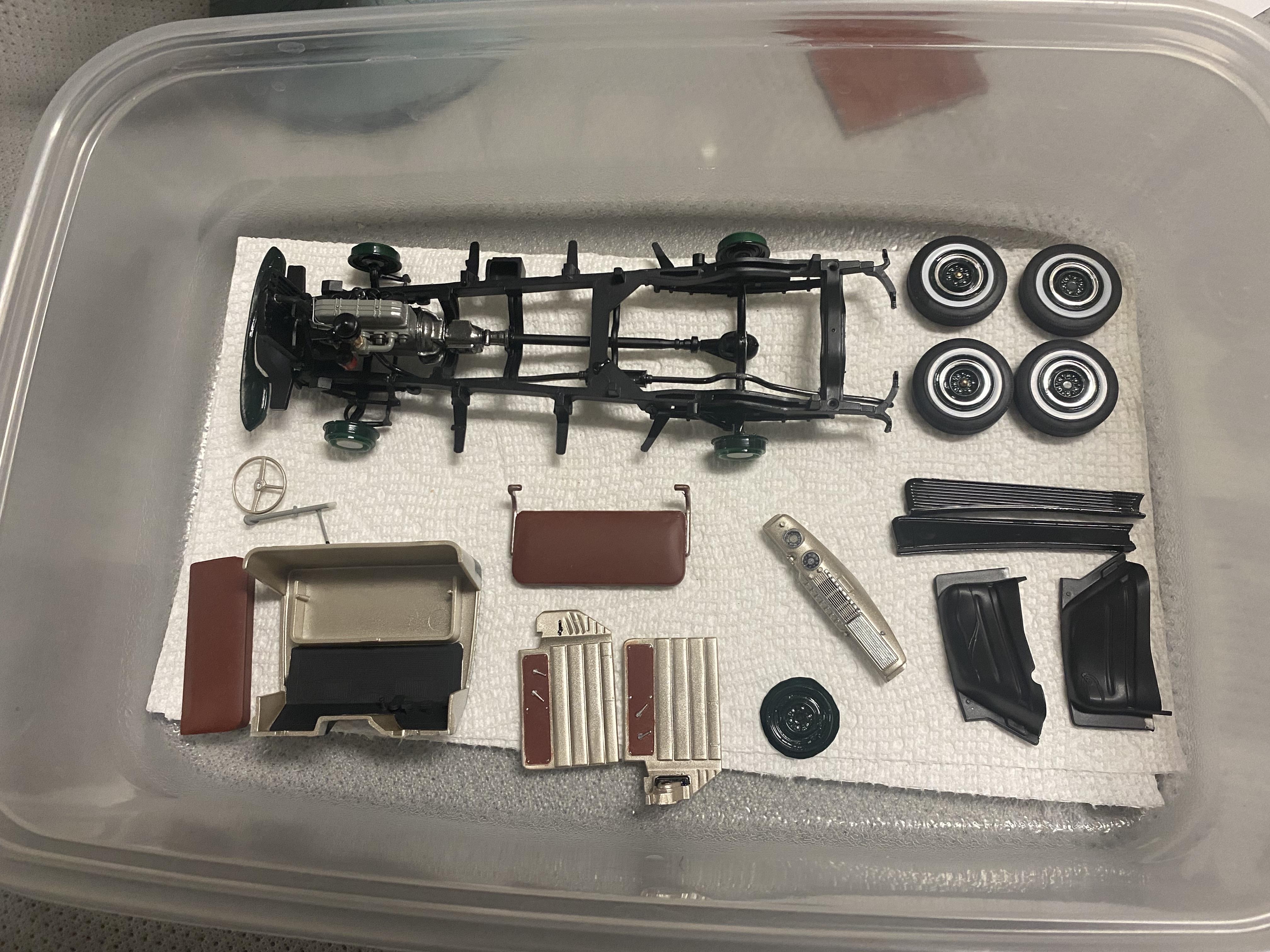

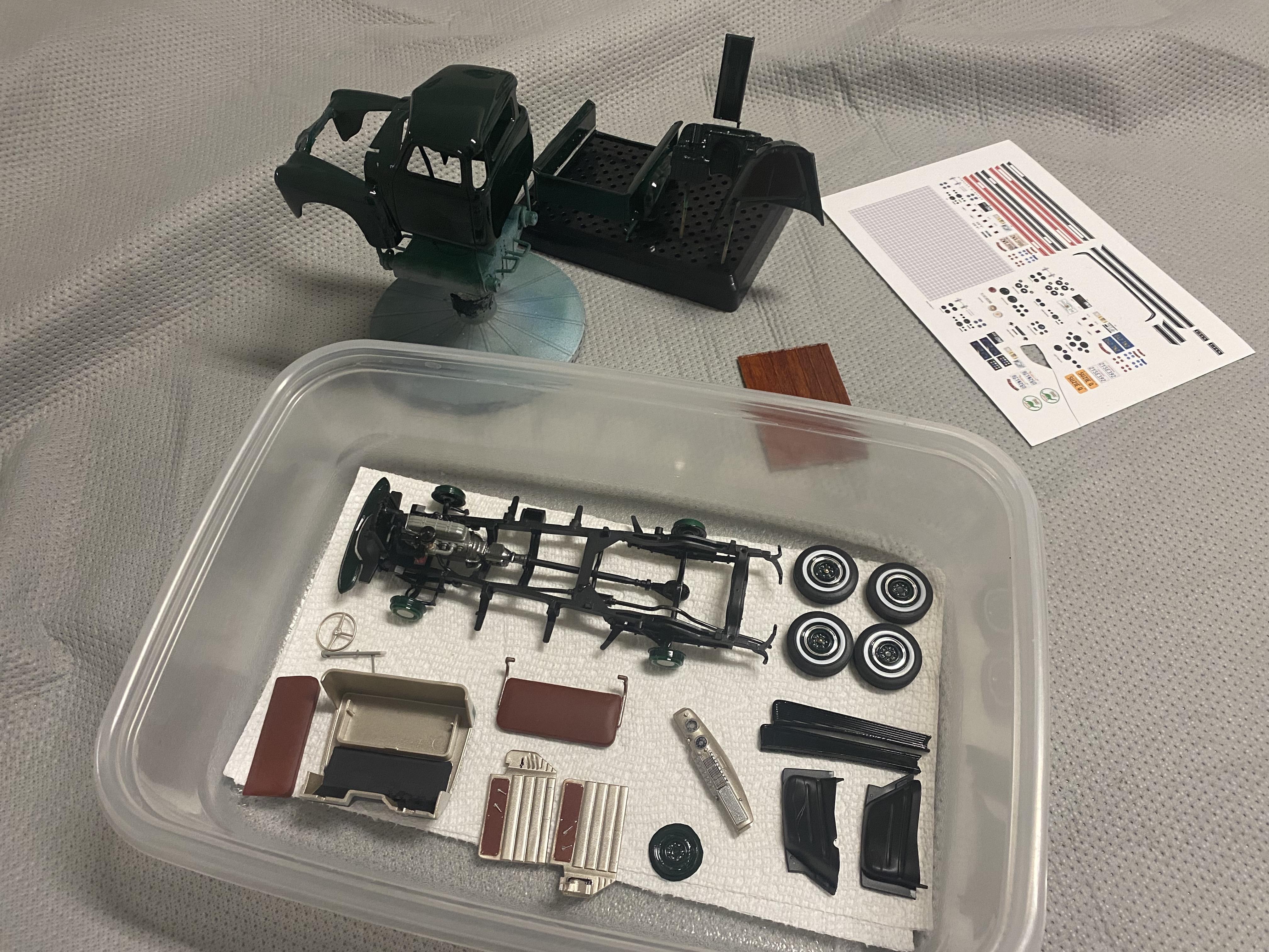

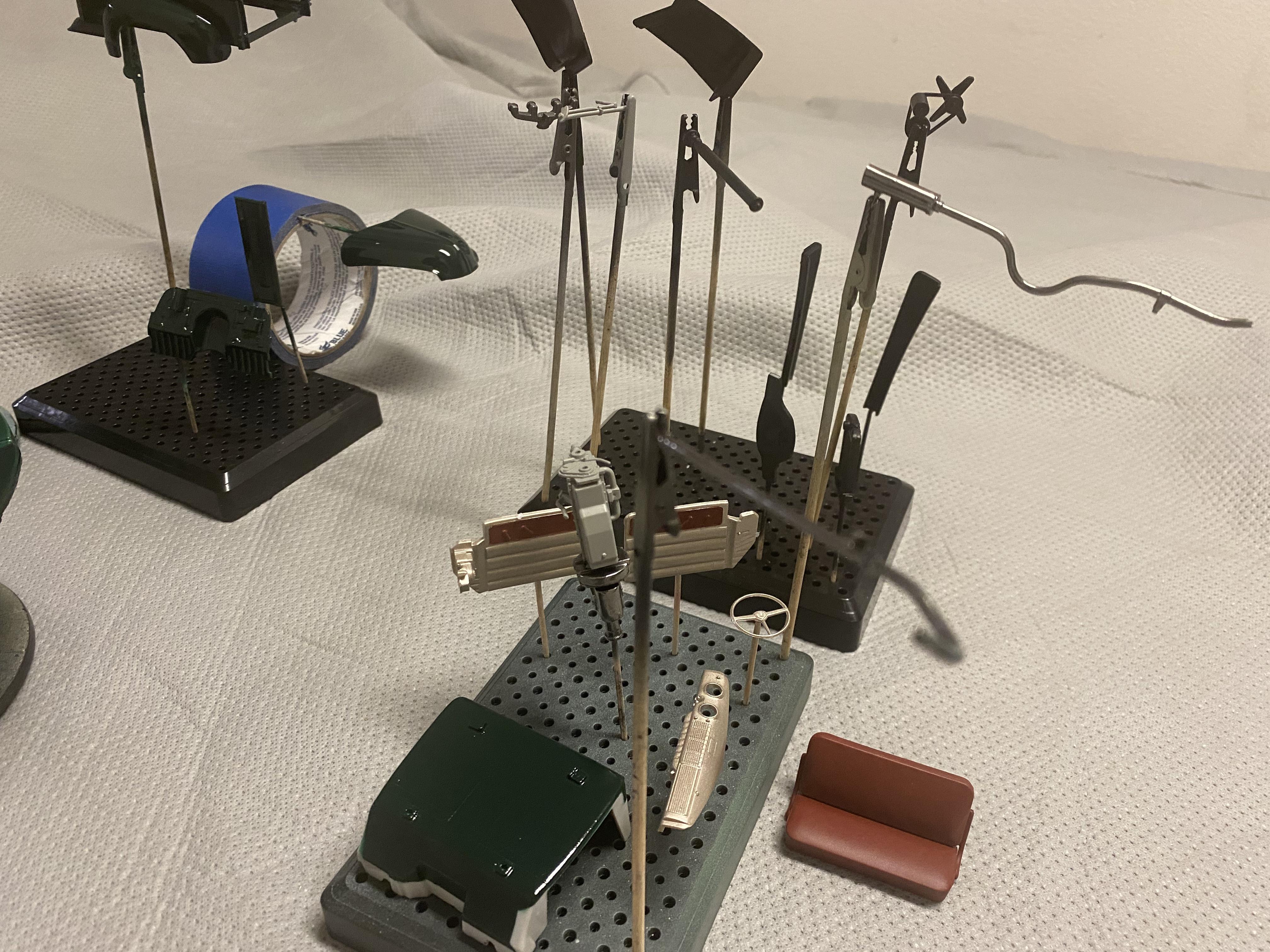

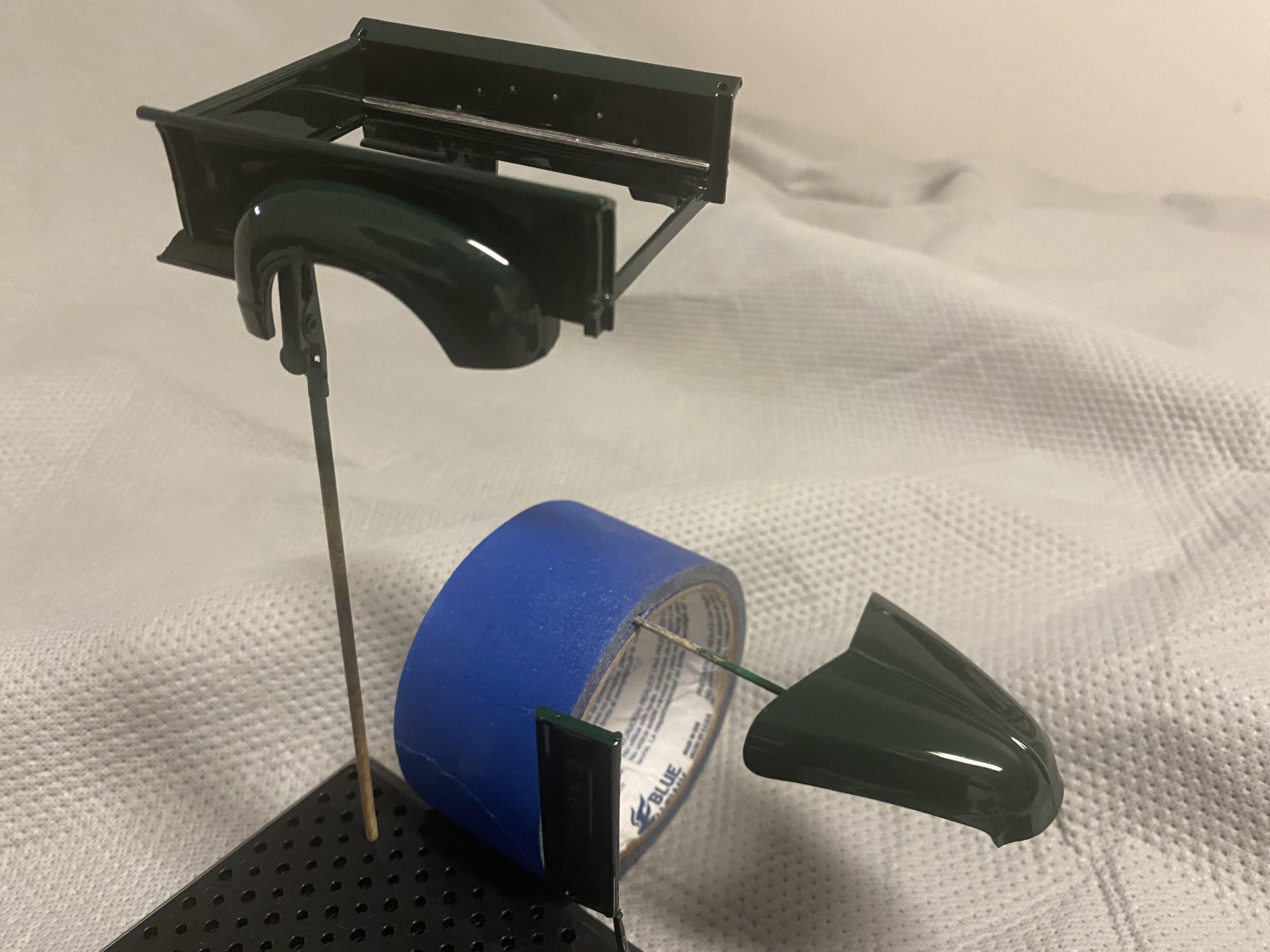

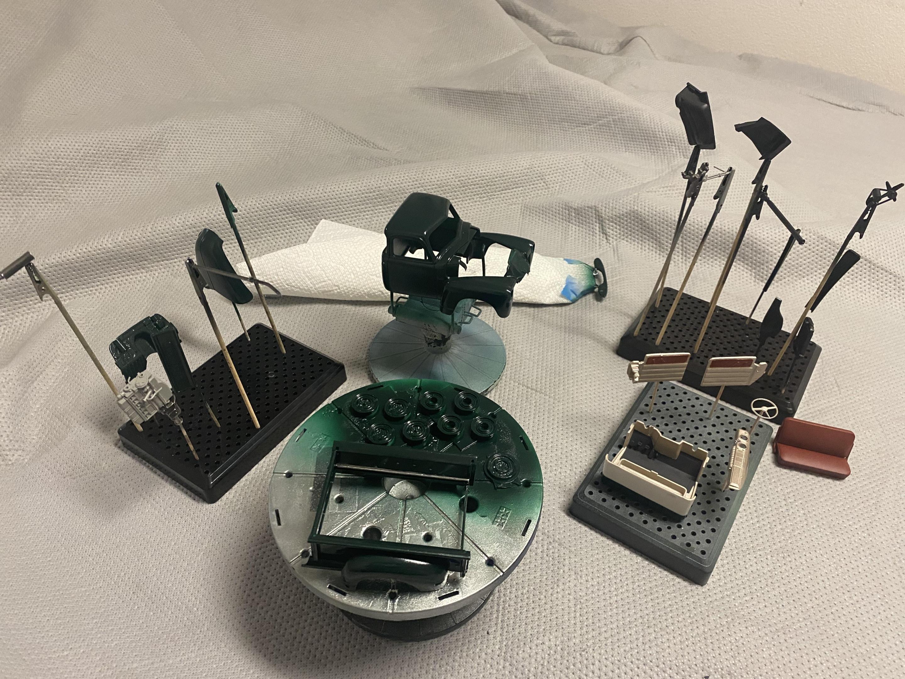

Starting to get base paint on many of the components.

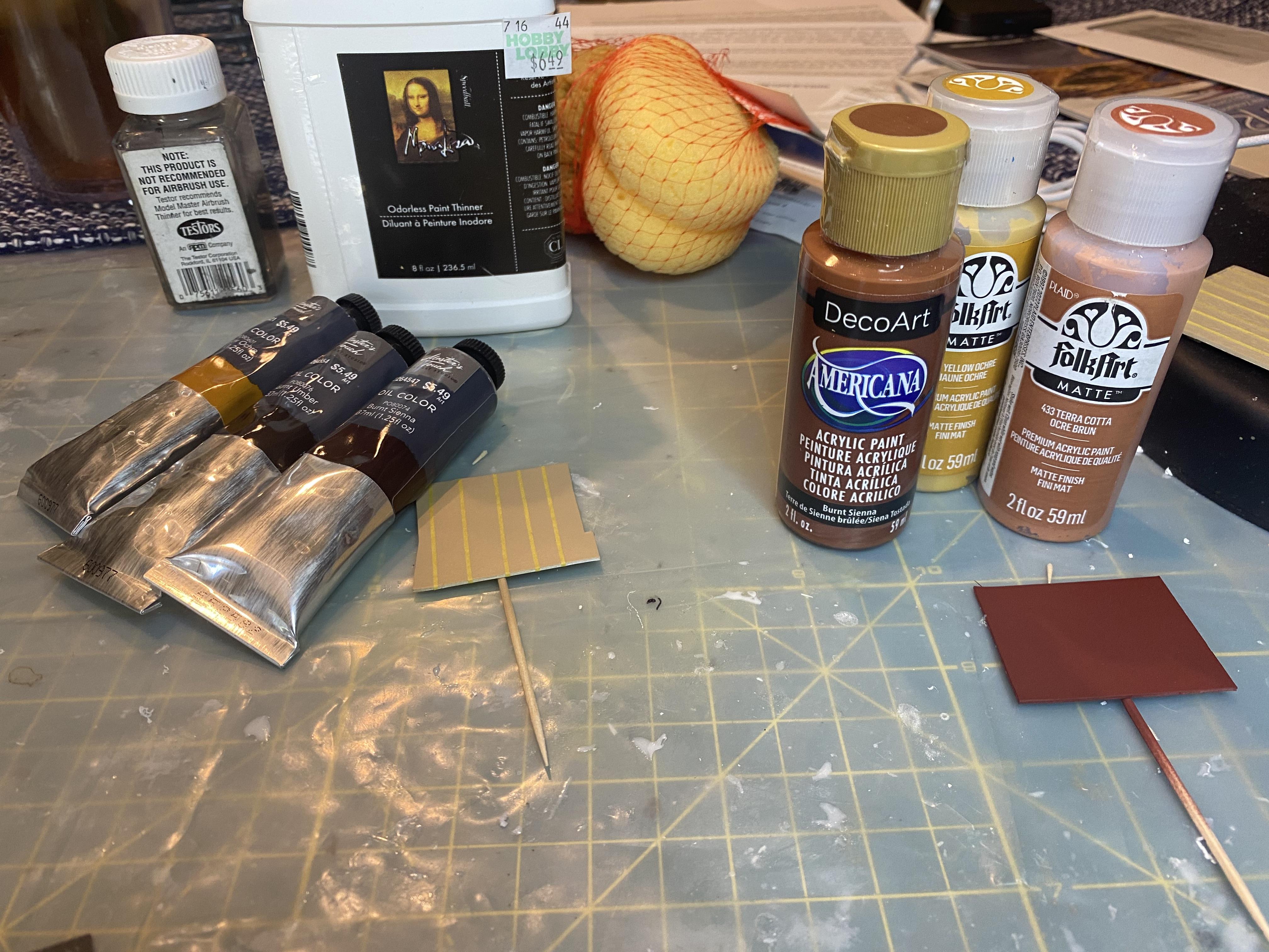

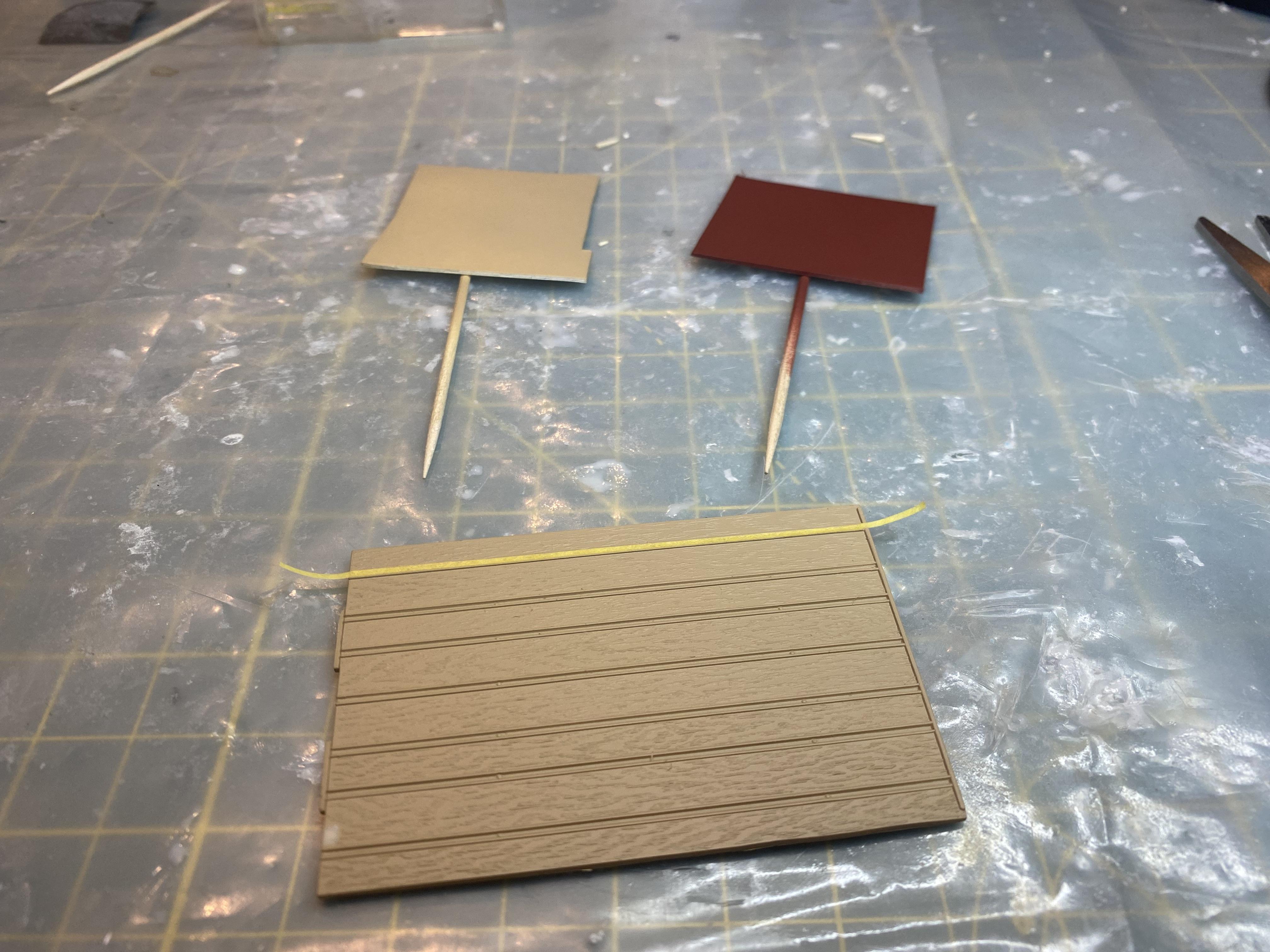

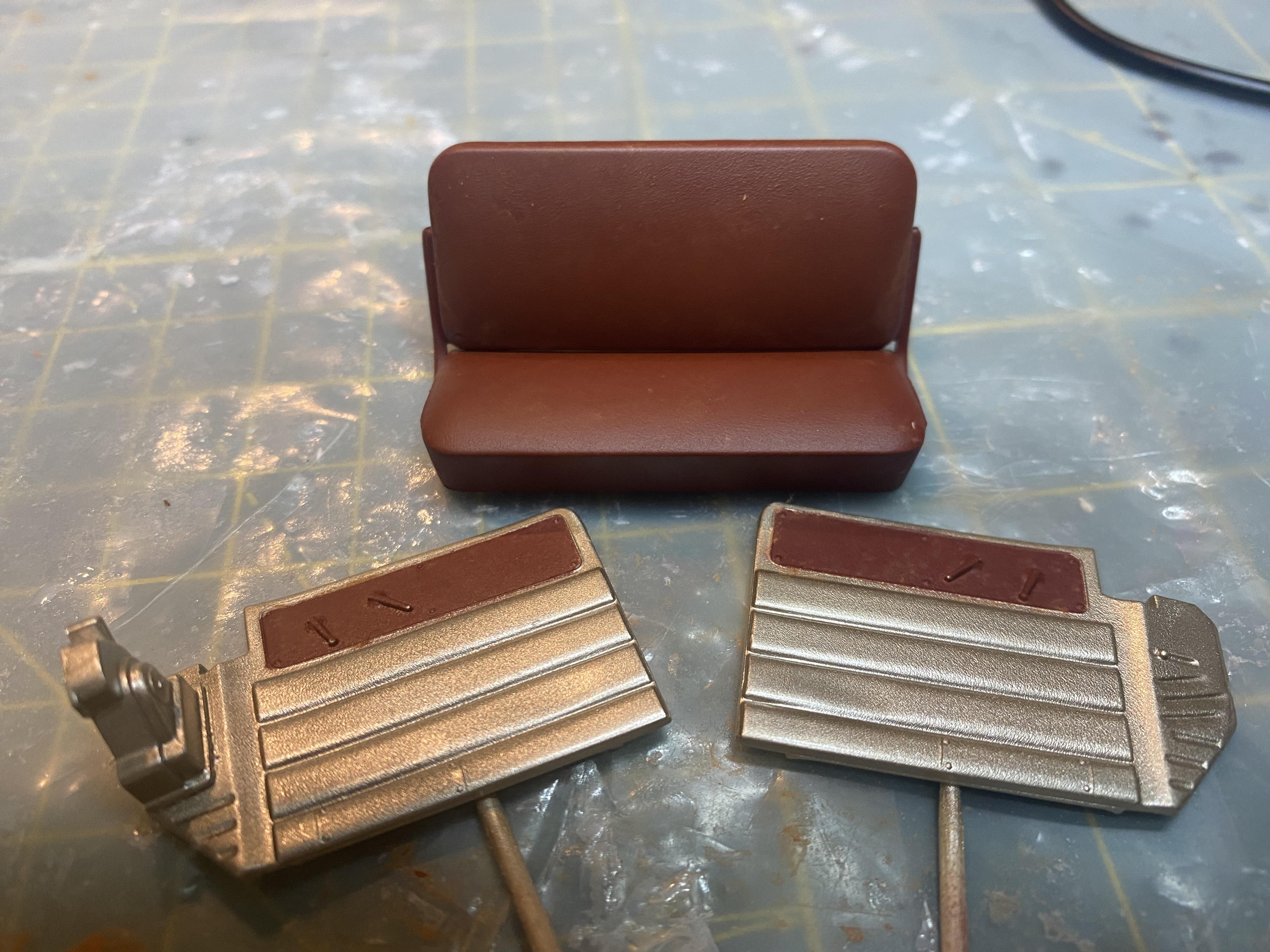

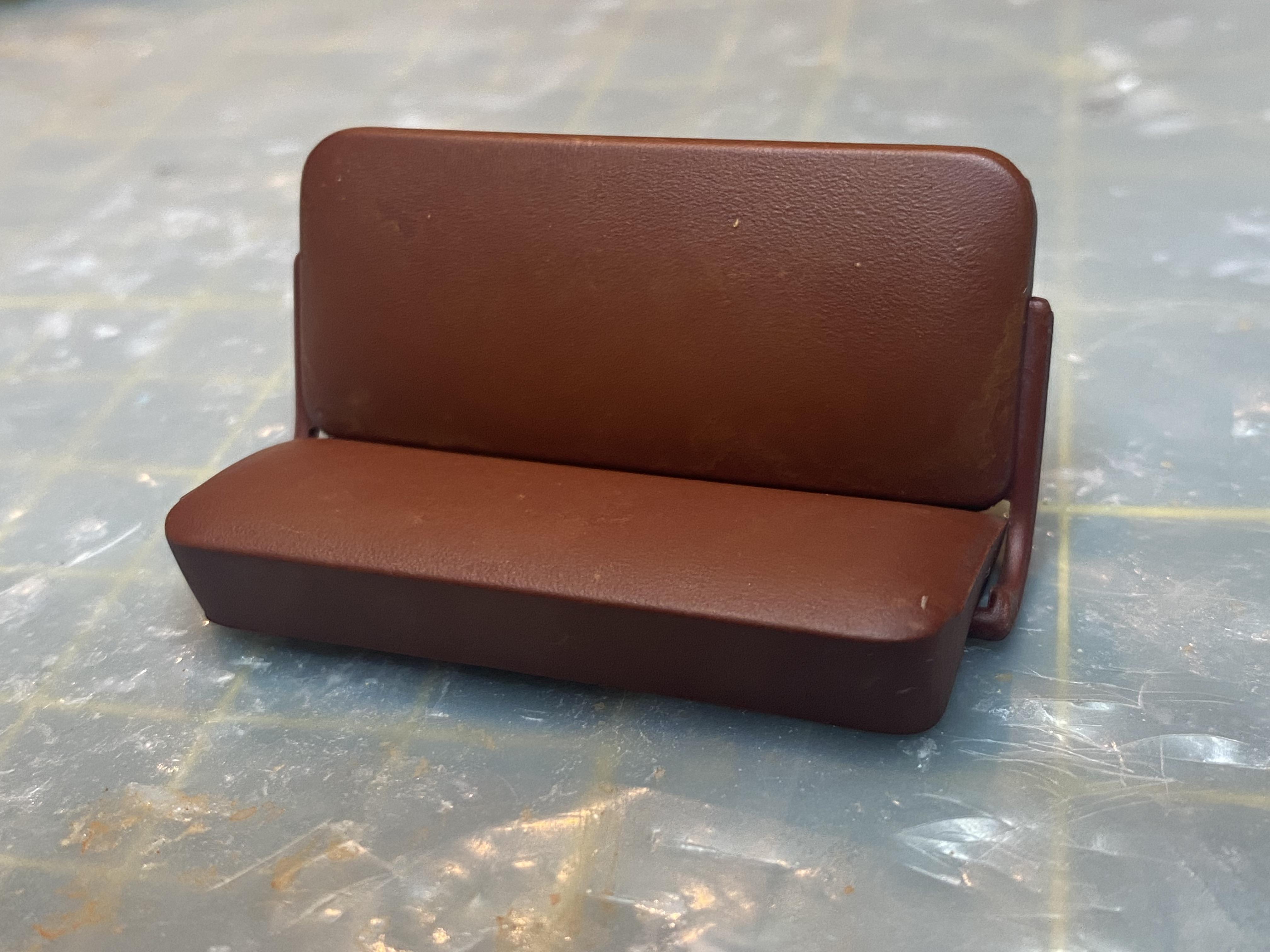

created test panels for leather and wood. First attempt for leather came out poorly but I think I settled on a fresh leather look for the seat.

Looking good! Can't go wrong with Juniper Green.
What is the base interior color? It almost looks light gold on my monitor.
  • Like 1
It’s called Fawn Beige metallic. Closest I could find to this
  • Like 1

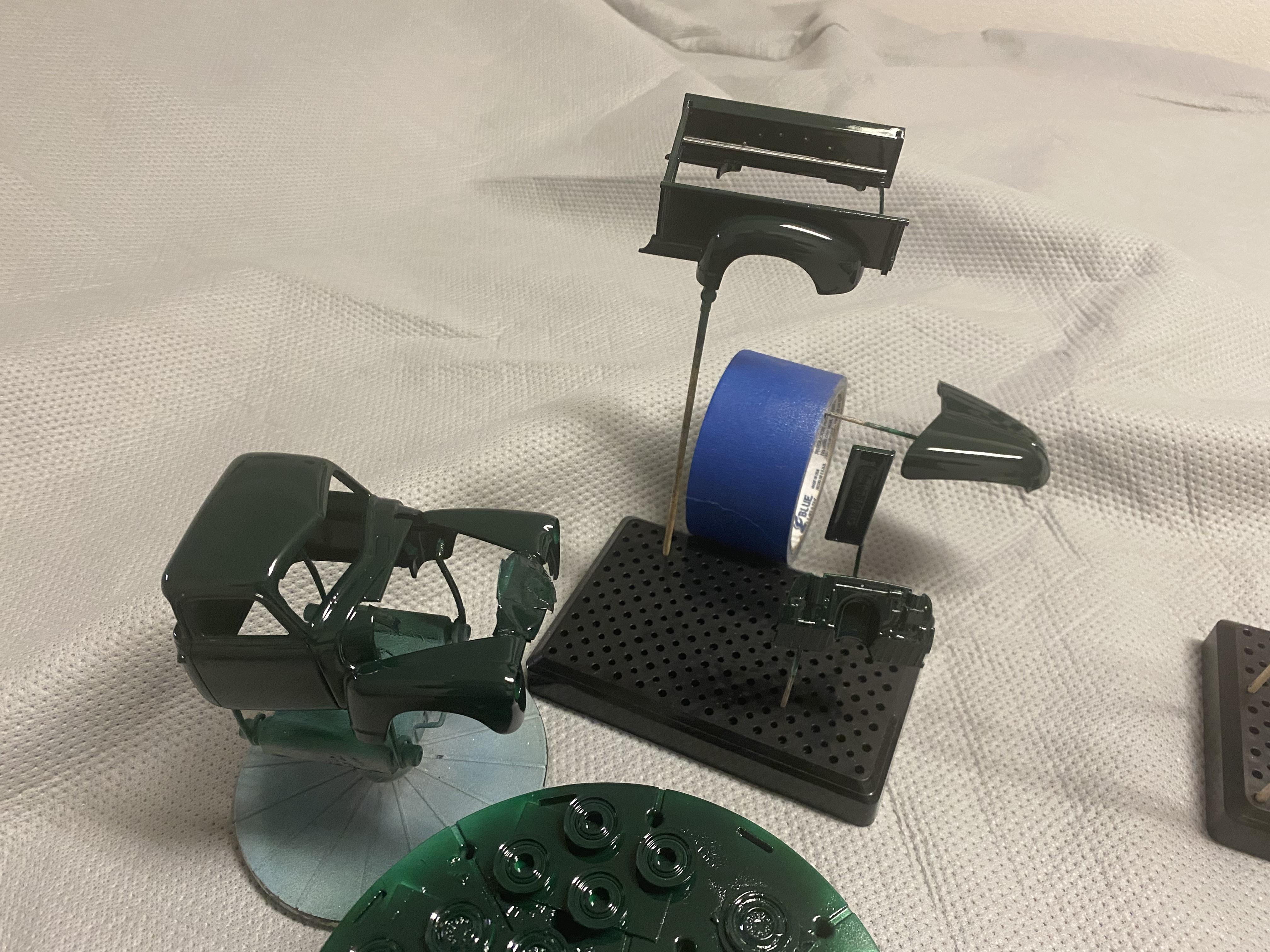

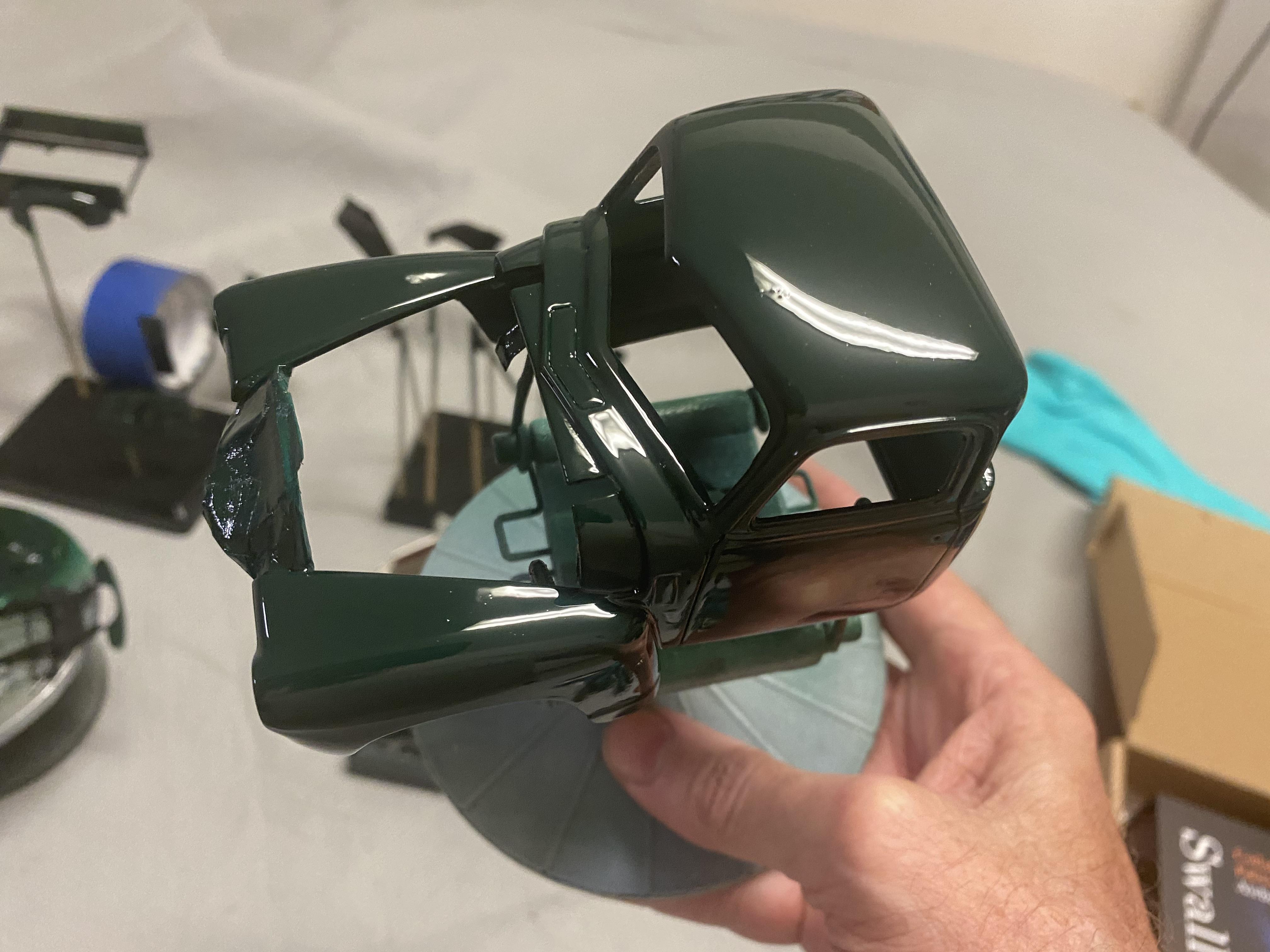

I did go ahead and spray the 2K clear. I did go ahead and spray the cab underside floor body color. I did get a nasty piece of trash in the roof, but I think it will come out when I wet sand and polish in a few days.
IMG_5056.thumb.jpeg.d5805bace66dad82a38e0c9436fe1be1.jpegIMG_5054.thumb.jpeg.5e5f09fb560b2175956caef53a7a888b.jpegIMG_5055.thumb.jpeg.2521f1c9f59b51fdebcad910efab1909.jpeg
  • Like 3
3 hours ago, Zippi said:
That 2K clear layed down nice Donald.  What paint and 2K clear did you use?
Thanks. The paint is Chevy juniper Green from MCW finishes, the clear is splash paints 2K.
Oh yeah, Splash Paints is the products that I use.

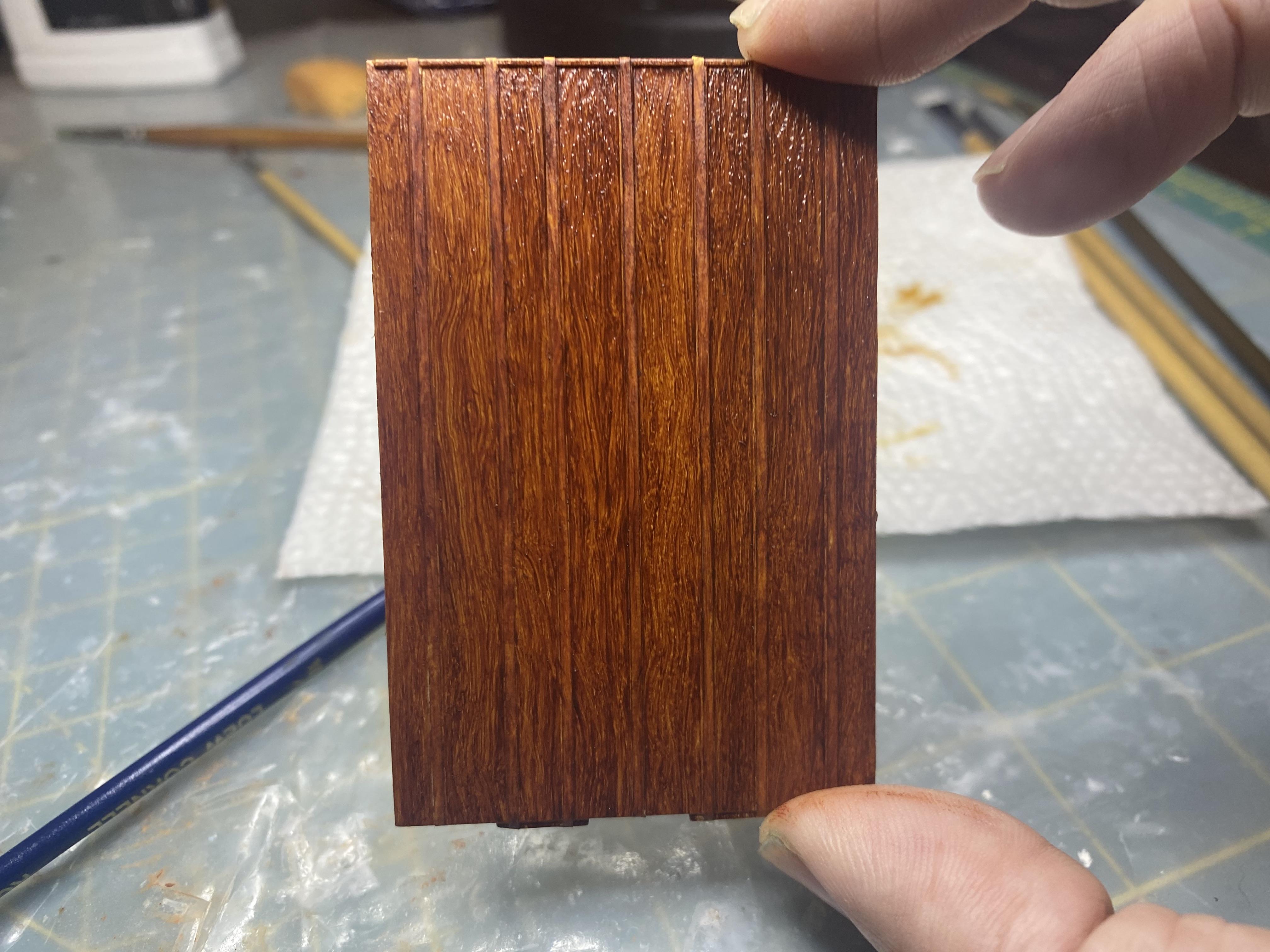

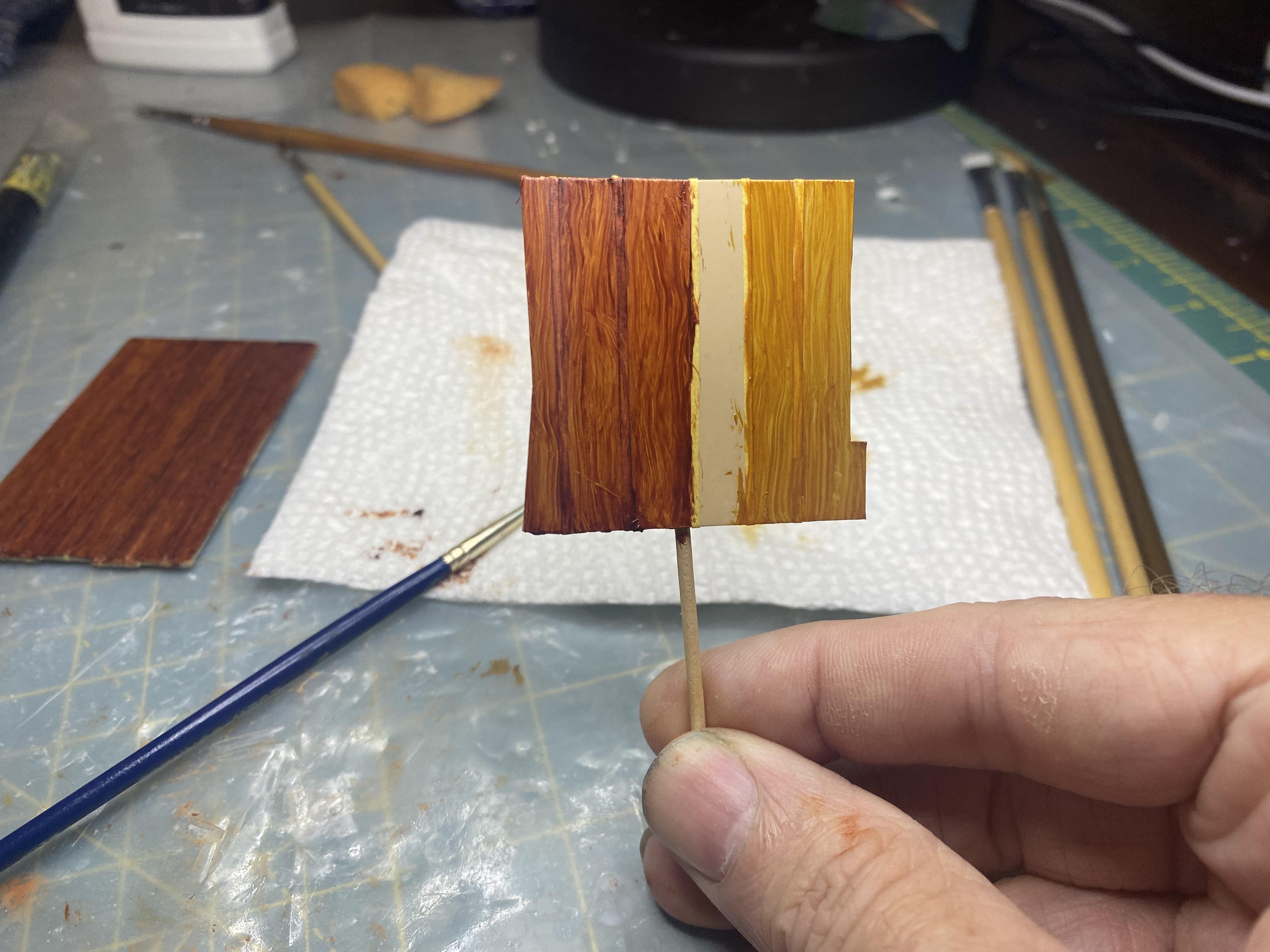

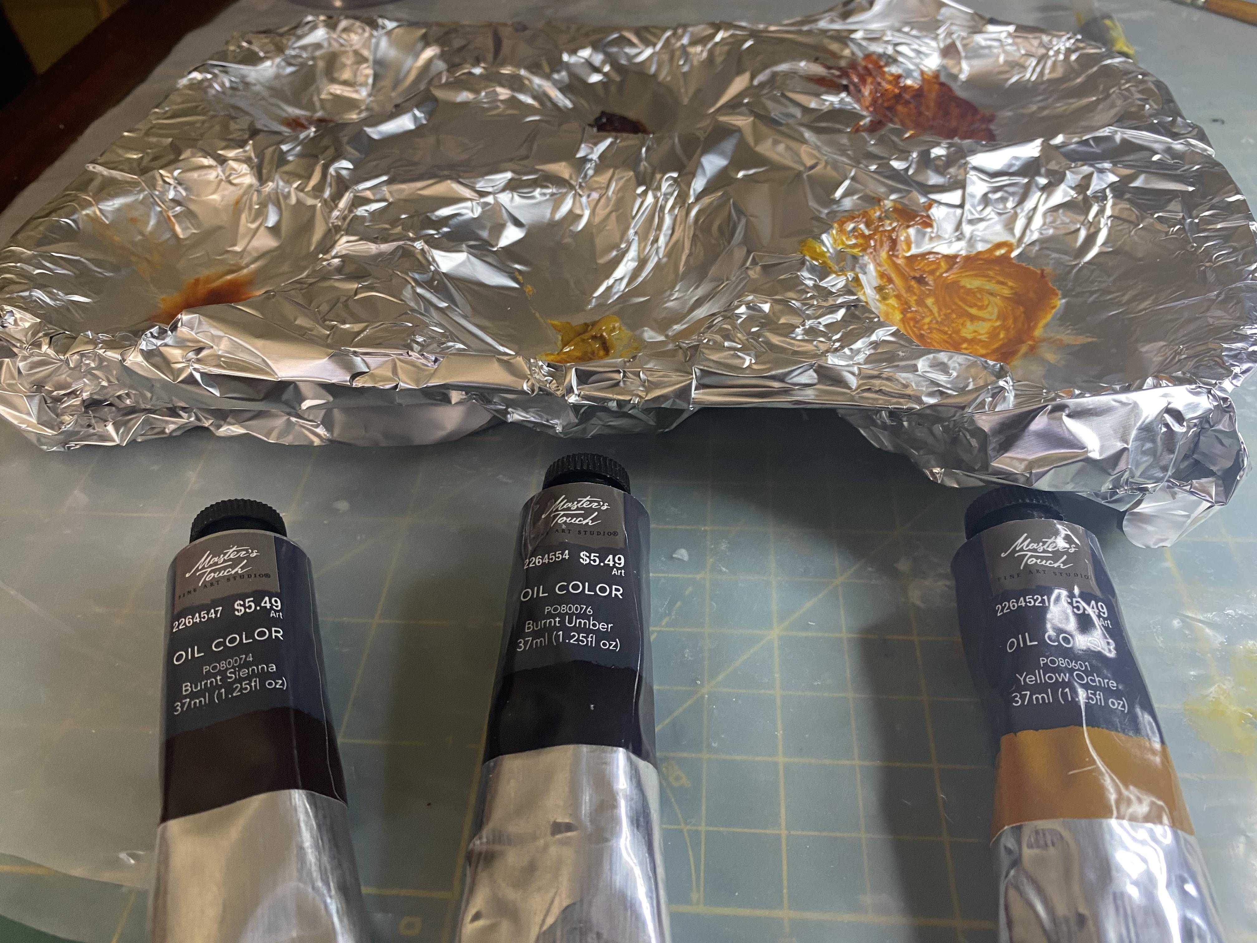

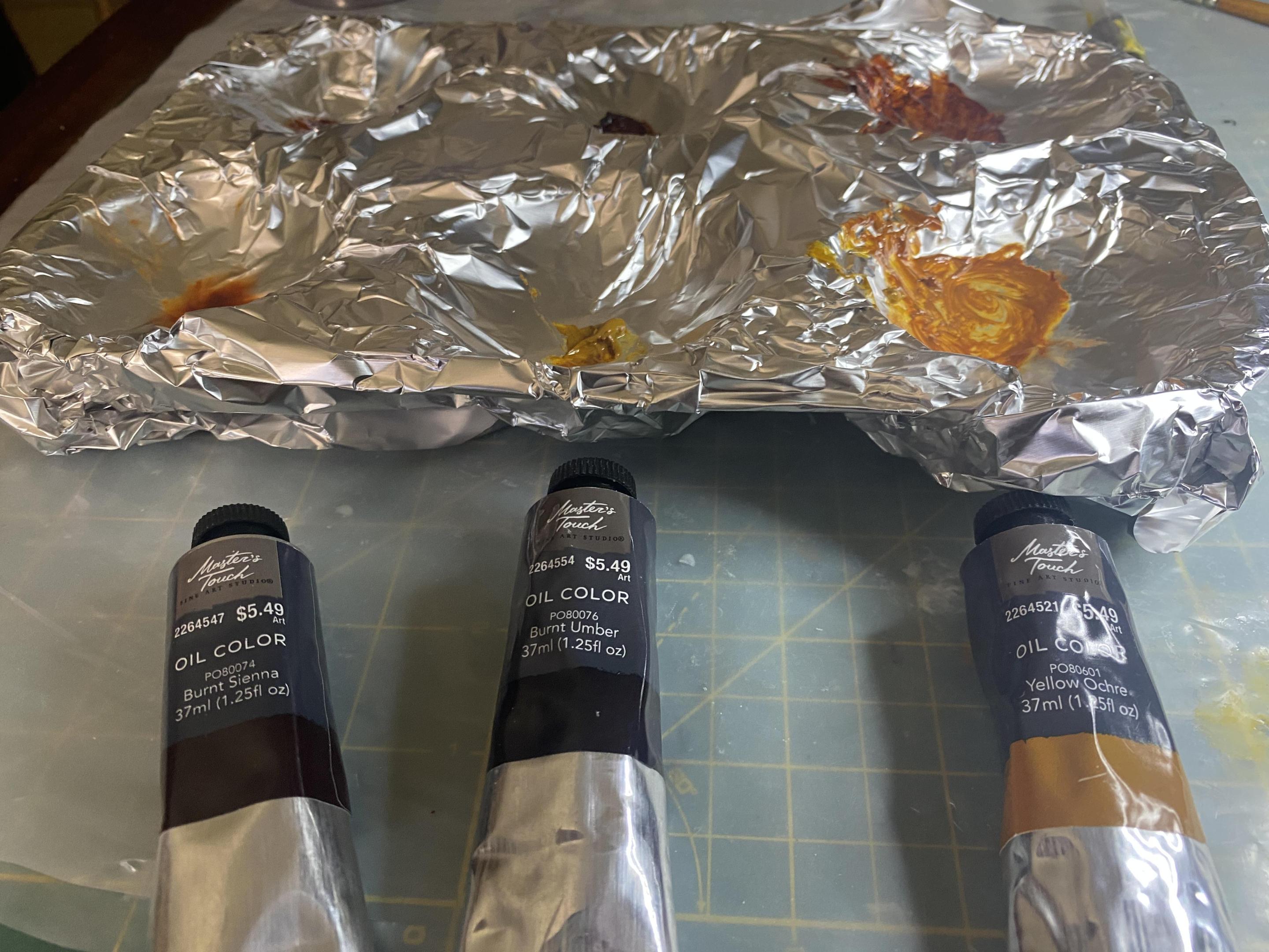

I got quite a bit done today. did a test panel before woodgraining the bed panel using oil paints. Going to take awhile to dry before I can do the underside.

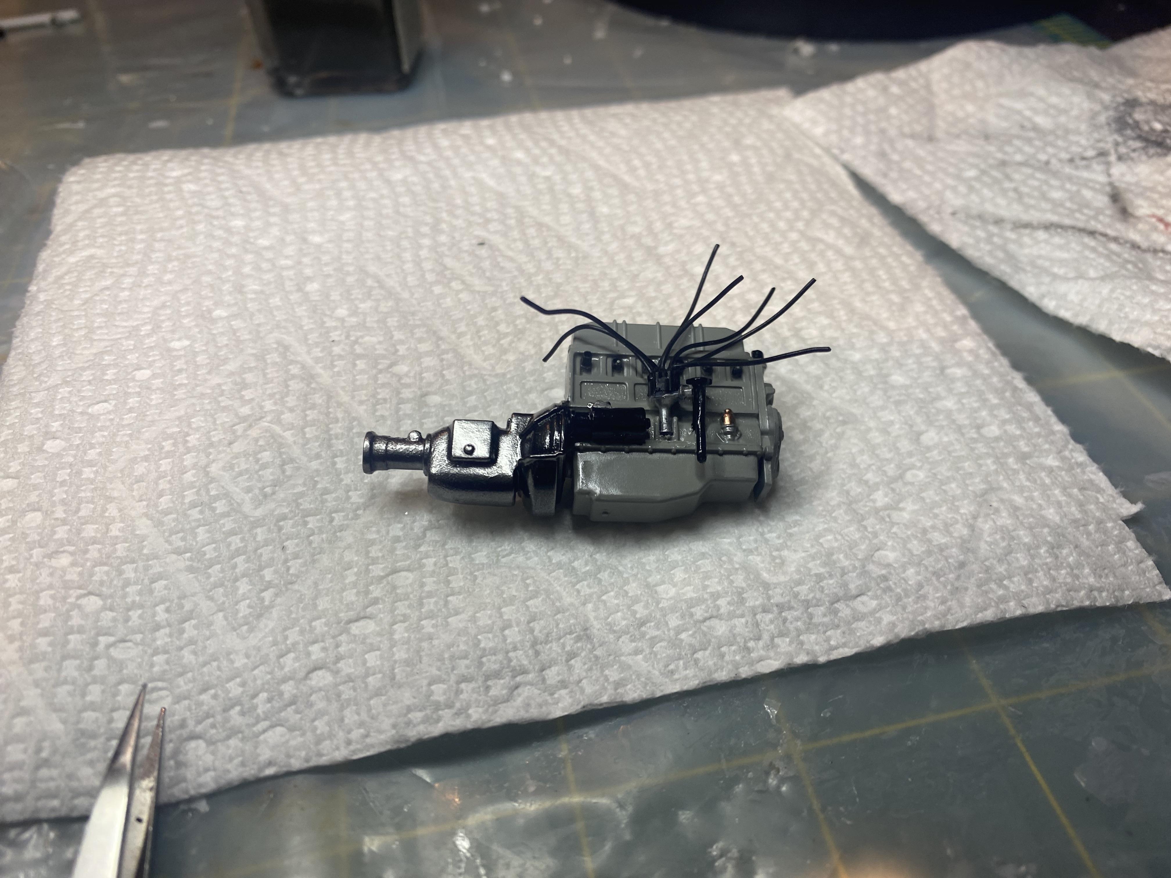

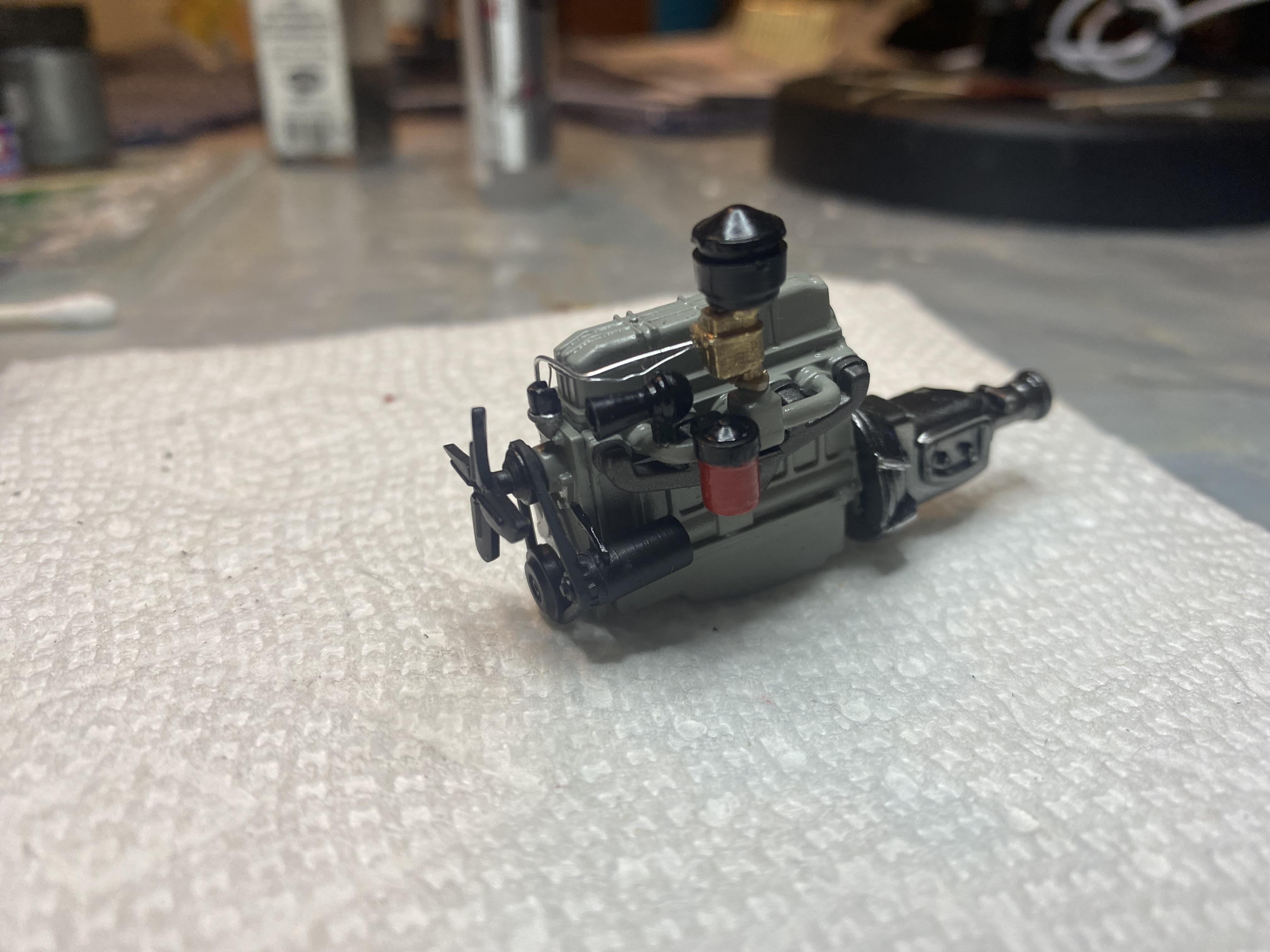

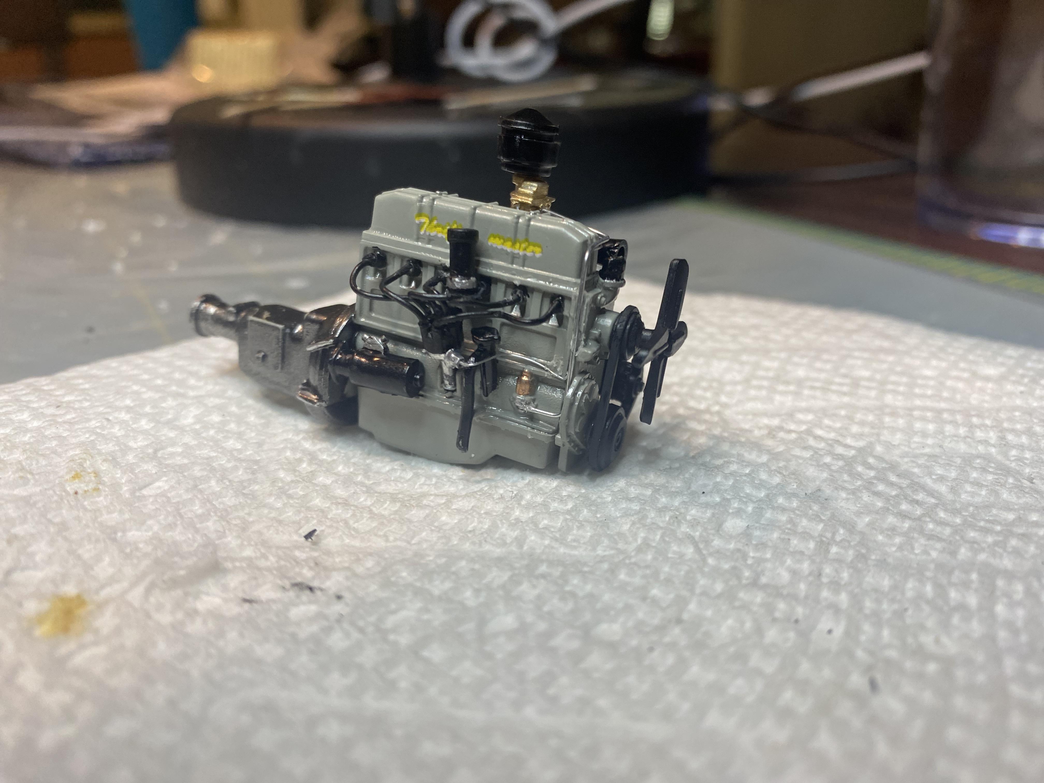

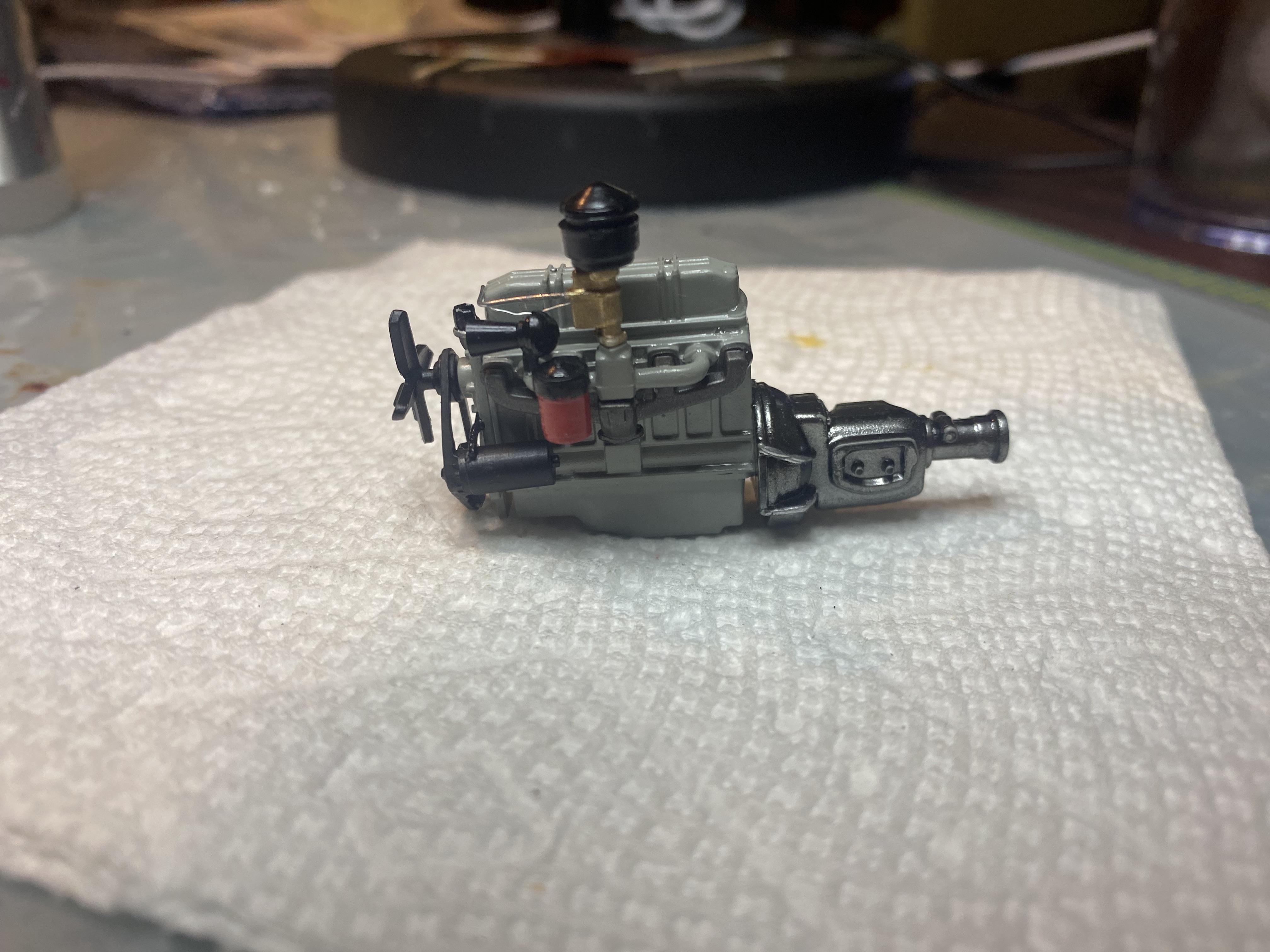

Put together the engine, even got the plug wires in the proper firing order and added vacuum and fuel lines.

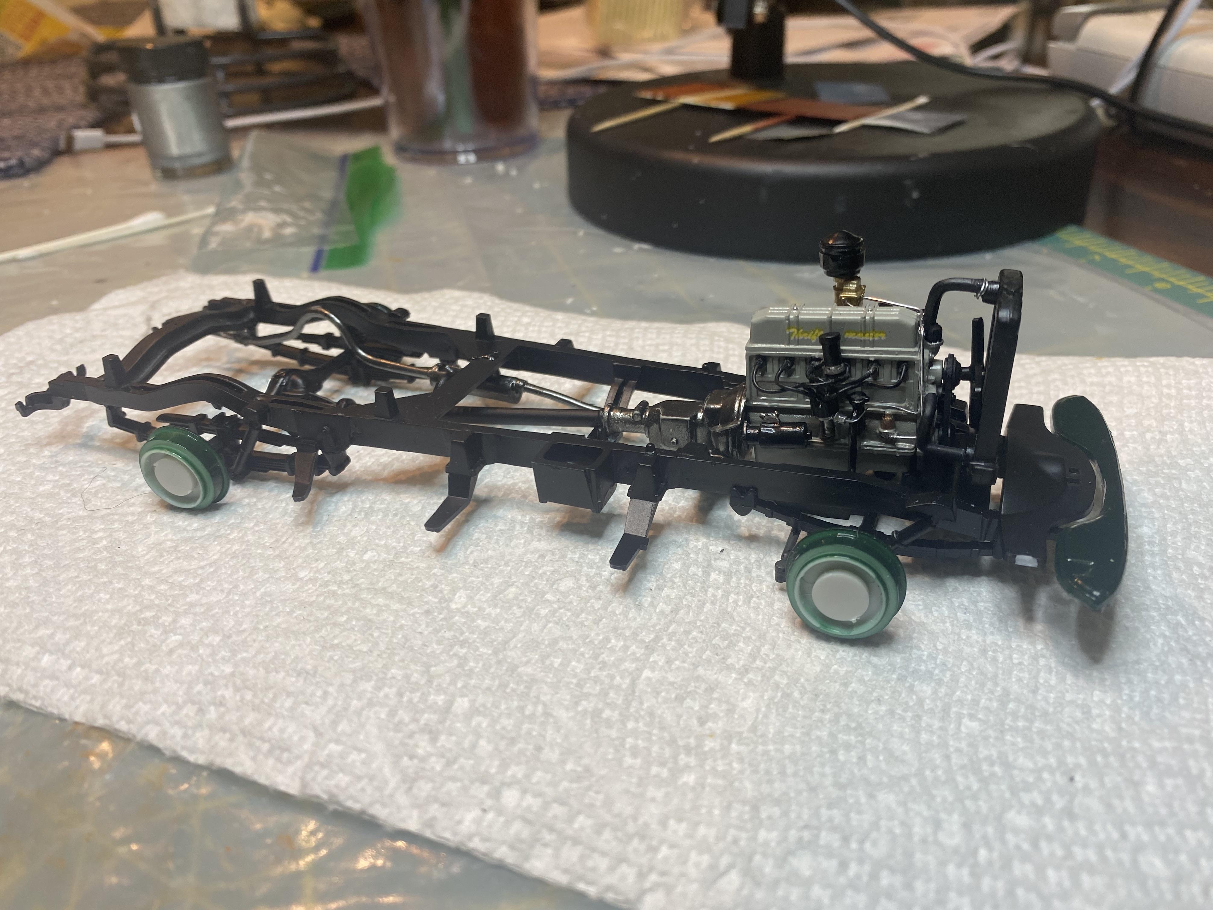

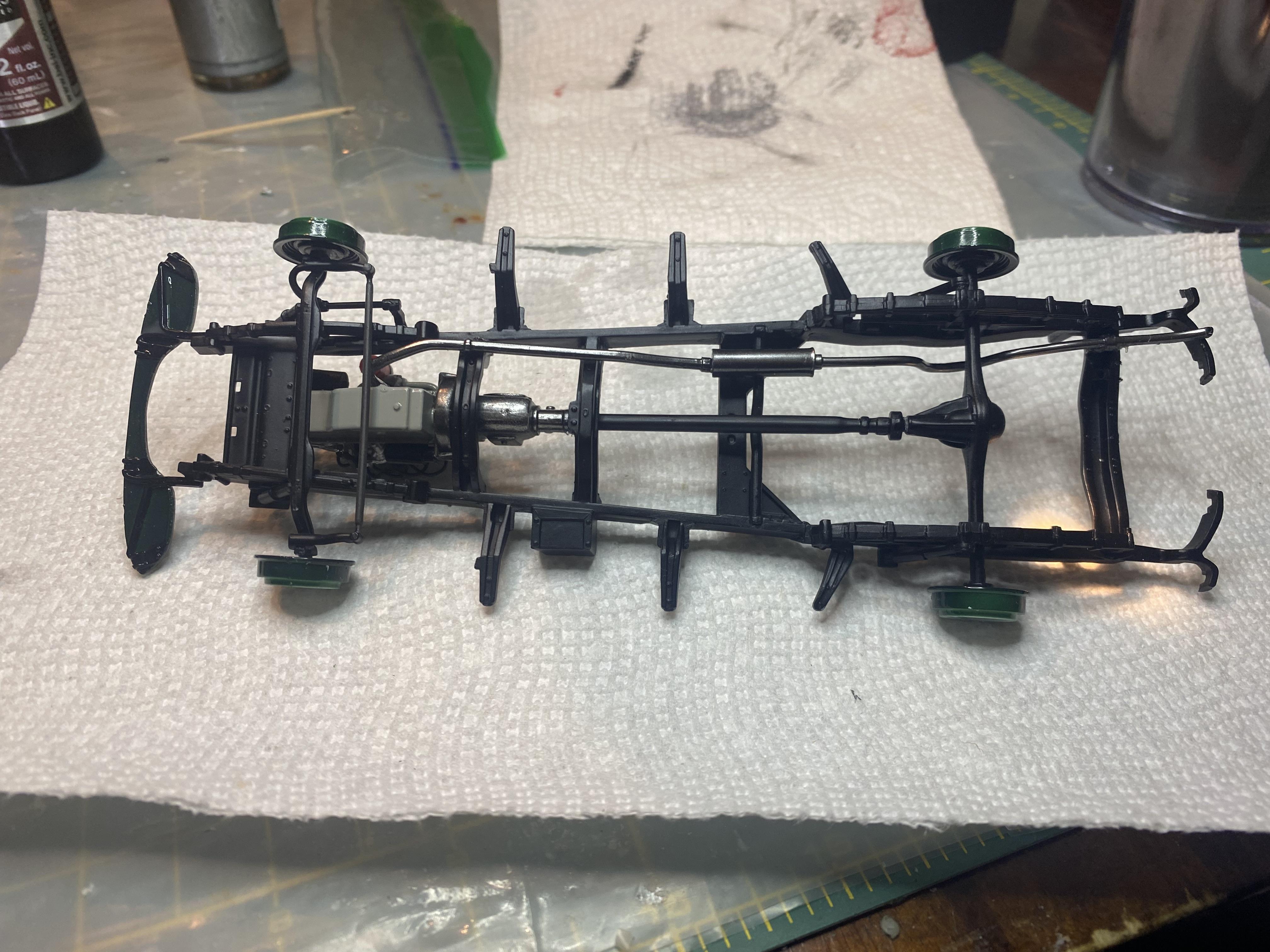

worked on the chassis and added the engine.

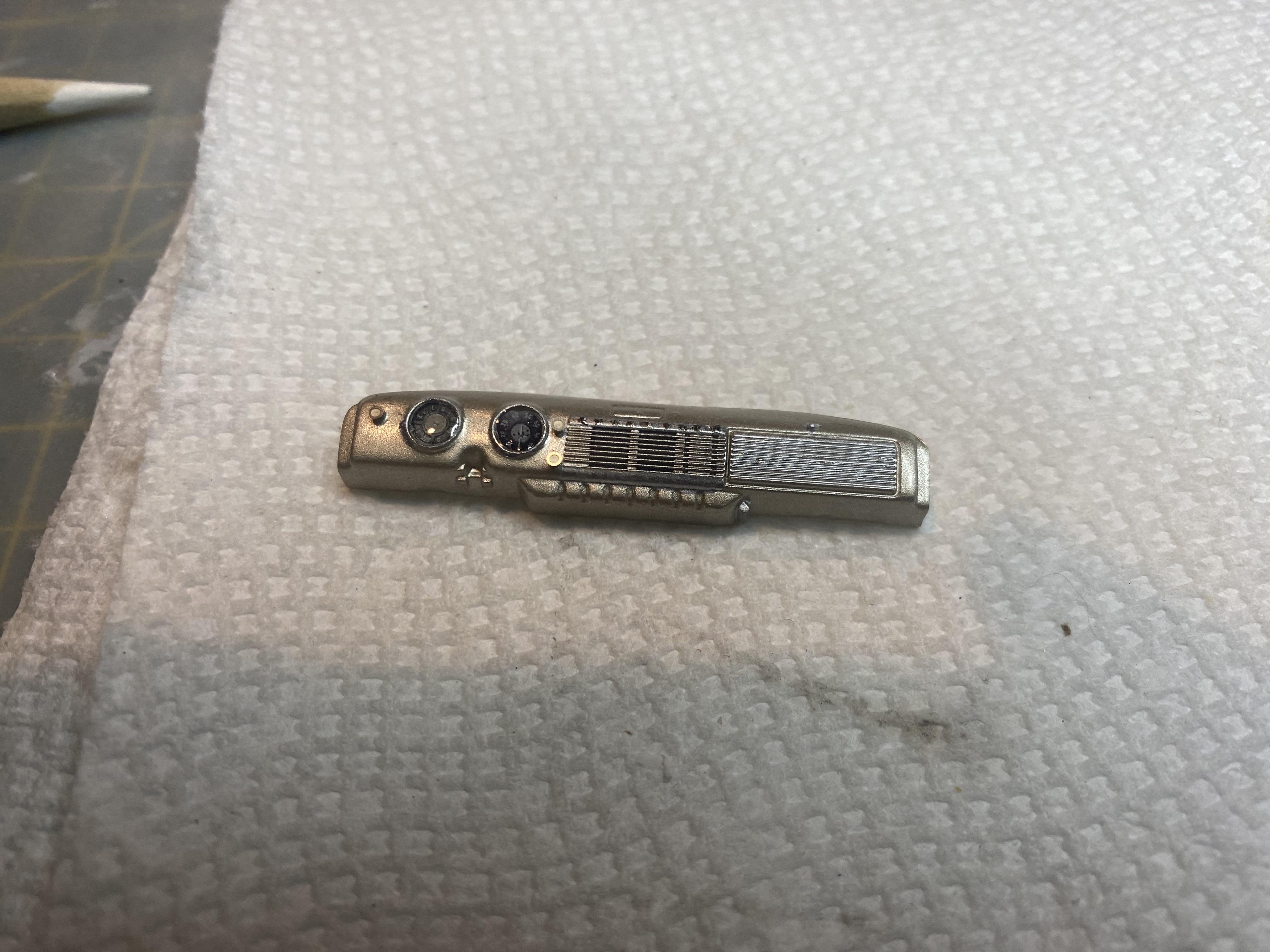

added clear resin and gauge decals. I tested the gauge LED but I didn’t take a picture.
