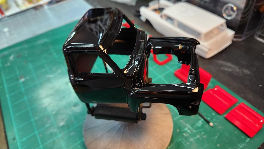

Cool Hand Posted August 24, 2024 Posted August 24, 2024 (edited) On 8/23/2024 at 2:28 AM, Zippi said: Well fellows, I dug deep in that top hat and found another rabbit Miracles do happen I guess. It paid off this time to give it one more shot. I'm not even sure why I bought that can of Tamiya black paint at the hobby shop last week. I guess it was meant for this paint job. I've never had black come out this good before. Nailed that black paint job, well done Bob. Great recovery on this build, going to be a looker with that colour combo. Edited August 24, 2024 by Cool Hand

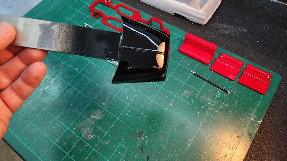

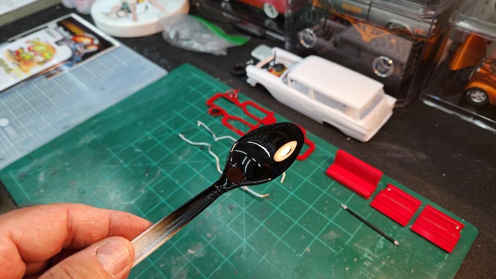

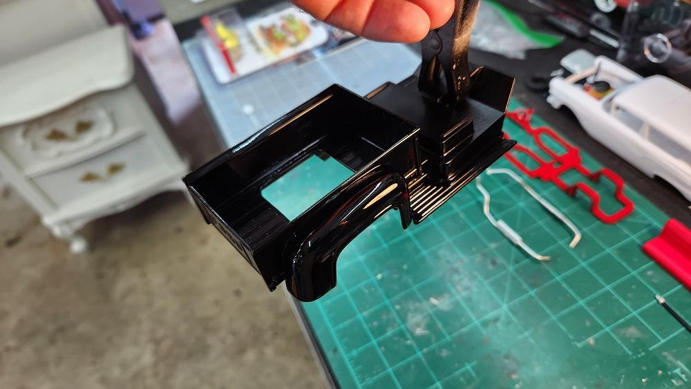

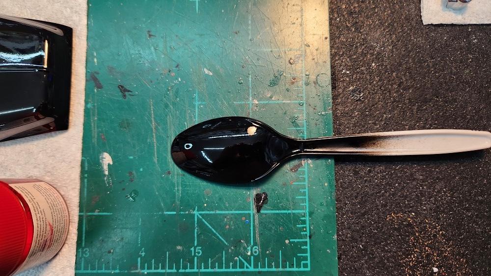

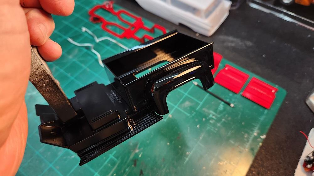

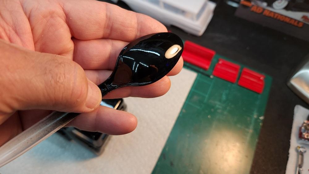

Zippi Posted August 25, 2024 Author Posted August 25, 2024 The temp this morning was 84° with 55% humidity so I shot the Splash Paints 2K Urethane Clear on this morning. I shot my test spoon first just to make sure there was no issues with the Tamiya TS-14 Black and the Splash Paints 2K clear. I really like this clear as it helps to hide minor issues. I'll let this set for 3 days then wet sand and polish it. The worst part is over so I think I'm out of the woods. Boy oh boy this has been a rough one to paint. 6

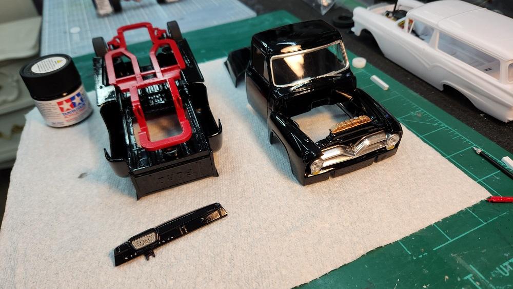

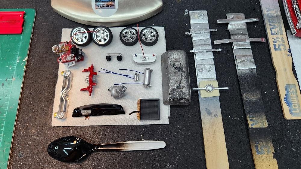

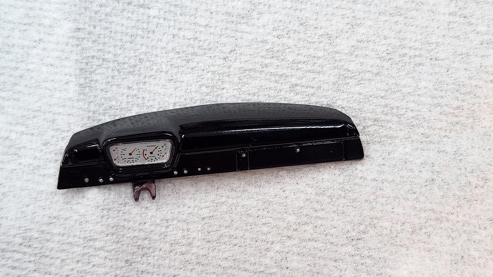

Zippi Posted August 27, 2024 Author Posted August 27, 2024 The paint has been air drying for 48 hrs now and I just stuck it in the Dehydrator at 122° for 1 1/2 hrs. It should be plenty dry after that. I got some of the detail work finished such as headlights and turn signals, dash, radiator hose, etc. I'm trying to decide if a I want to wet sand the body or just give it a good waxing. 9

Zippi Posted August 29, 2024 Author Posted August 29, 2024 I got the bright work on the front all painted and re-chrome and installed. I thought I would get out in the garage early this morning and get the bmf on the windshield trim before I start cutting the grass. it's going to be a hot one today with the heat index well over 100°. 4
ksnow Posted August 29, 2024 Posted August 29, 2024 That black and red looks sweet. And that chrome really pops. Stay cool out there.
DJMar Posted August 29, 2024 Posted August 29, 2024 That color combo is just kicking it. Just curious, is the instrument panel a decal? To my eyes it looks like the gauges are...upside down?

Zippi Posted August 29, 2024 Author Posted August 29, 2024 1 hour ago, DJMar said: That color combo is just kicking it. Just curious, is the instrument panel a decal? To my eyes it looks like the gauges are...upside down? Thanks DJ. With the shape of the the instrument cluster area the decal can only go on one way.
