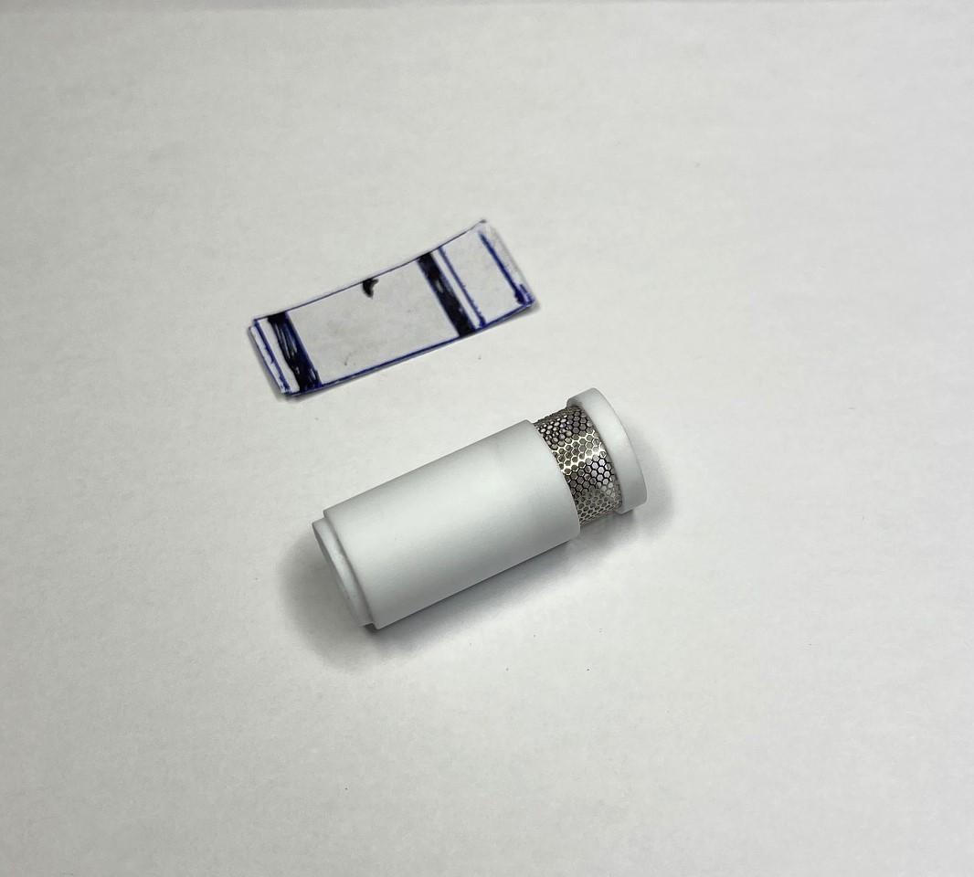

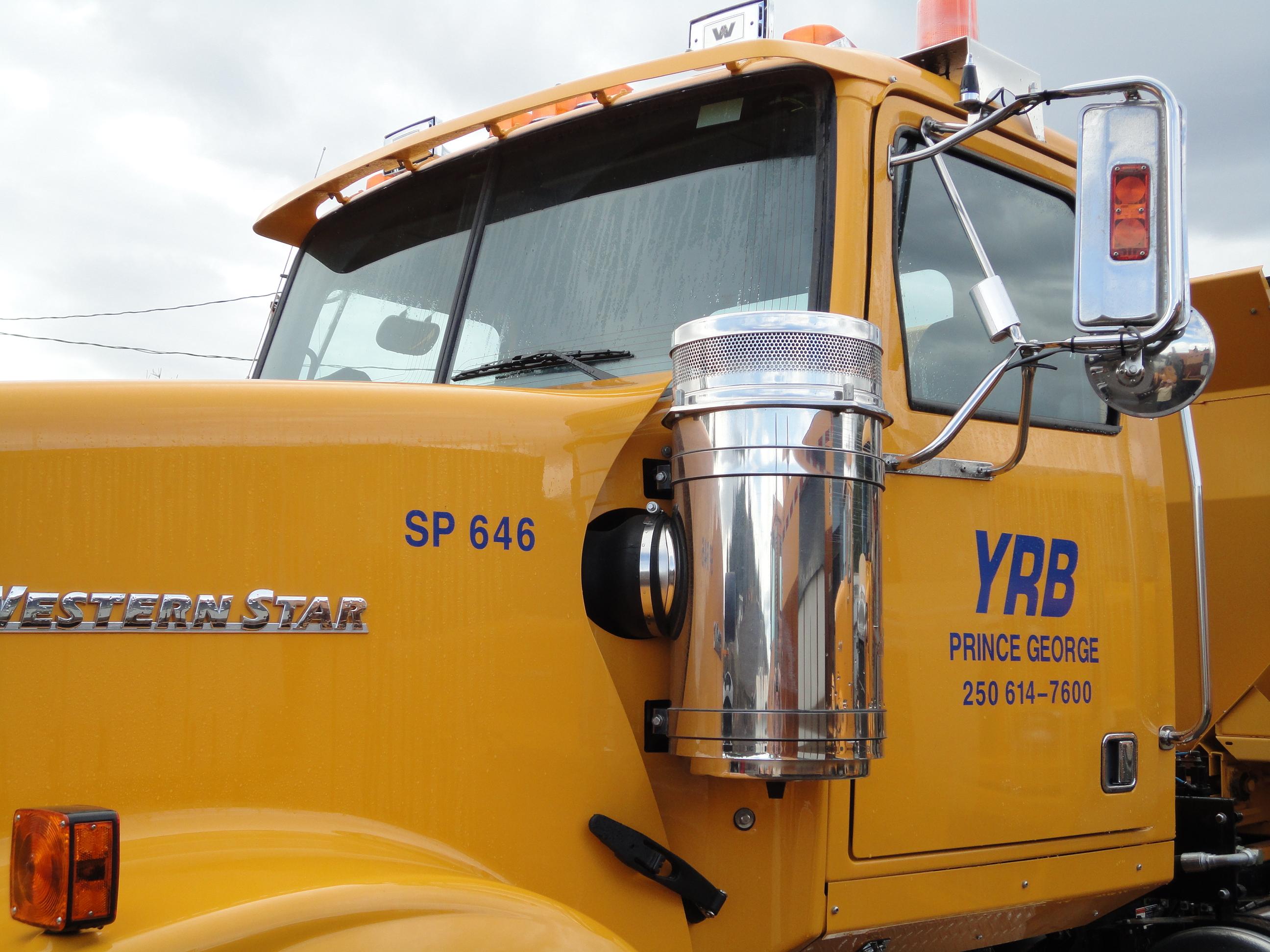

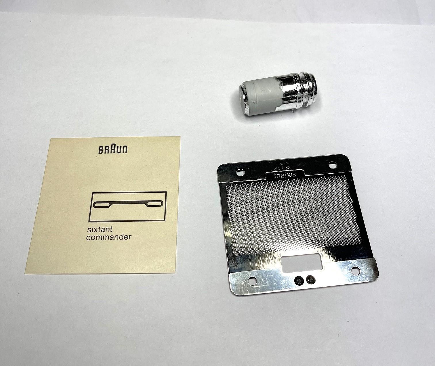

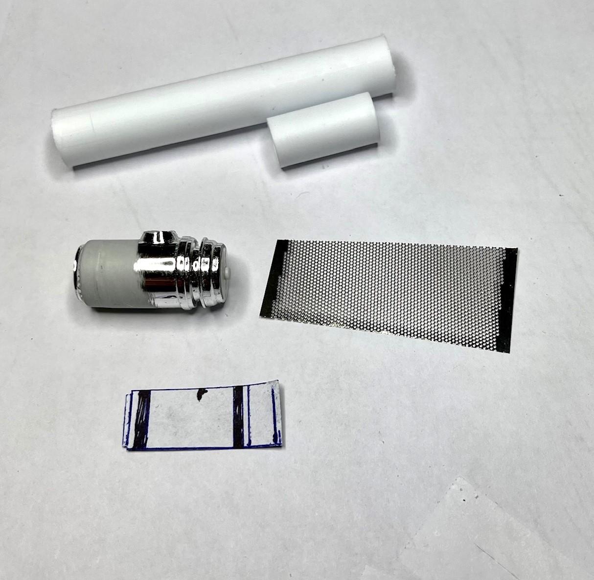

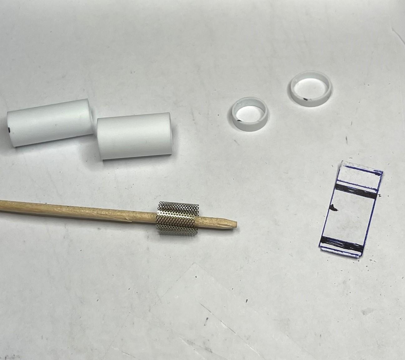

BK9300 Posted November 15 Author Posted November 15 (edited) Been raining for several days now, and a bit too humid to paint - even in the heated shed. One of my issues, from way back, was the kit air cleaner cannister being too big - in a mock up, the bottom edge of the driver's side fender was hitting the cannister. A long overdue problem to solve, so I finally made myself tackle it. Gathered a few items to work with and made some progress! The air cleaner in the pic below is from an old kit - thought I could clean it up. But it wasn't close enough to resemble the Donaldson cannister on the real truck and too much work needed to be done for it to look smooth under chrome paint. I had a replacement screen from an old Braun, electric shave I thought I could use, to better look like the Donaldson - This is what I wanted to get closer to - The outer cannister scaled to 1/2" in diameter and I wanted to use the next smaller size, to attach the mesh to and slide that assembly up into a piece of the 1/2" tube - had a small sketch to keep me aware of proportions needed - Pieces cut out and squared up. I cut out a piece of paper to determine the size of the mesh section I needed to cut out of the shaver's screen. Once cut out, I needed to wrap the mesh section around a small dowel, so the mesh would retain a curved bend smaller than the inside tube, allowing it to stay in place until CA glued - I had glued the mesh section to a lower inner portion of tubing and to an upper, 2 mm section. Once glue had set, I was able to slip the 1/2", upper and lower tube sections over the inner tube/mesh, sealing the mesh in - I still need to close off the ends of the cannister and make those end pieces smooth. Plus, will need to make two, simple mounting brackets with straps and add the outlet pipe. I tried to be careful not to scratch the cannister body, so it would still look smooth under the chrome paint. Should be able to get most of this work done tomorrow. I appreciate the continuing patience as I get closer to getting this done - take care! Edited November 15 by BK9300 Typo 5
ShakyCraftsman Posted November 15 Posted November 15 10 minutes ago, BK9300 said: Been raining for several days now, and a bit too humid to paint - even in the heated shed. One of my issues, from way back, was the kit air cleaner cannister being too big - in a mock up, the bottom edge of the driver's side fender was hitting the cannister. A long overdue problem to solve, so I finally made myself tackle it. Gathered a few items to work with and made some progress! The air cleaner in the pic below is from an old kit - thought I could clean it up. But it wasn't close enough to resemble the Donaldson cannister on the real truck and too much work needed to be done for it to look smooth under chrome paint. I had a replacement screen from an old Braun, electric shave I thought I could use, to better look like the Donaldson - This is what I wanted to get closer to - The outer cannister scaled to 1/2" in diameter and I wanted to use the next smaller size, to attach the mesh to and slide that assembly up into a piece of the 1/2" tube - had a small sketch to keep me aware of proportions needed - Pieces cut out and squared up. I cut out a piece of paper to determine the size of the mesh section I needed to cut out of the shaver's screen. Once cut out, I needed to wrap the mesh section around a small dowel, so the mesh would retain a curved bend smaller than the inside tube, allowing it to stay in place until CA glued - I had glued the mesh section a lower inner portion of tubing and to an upper, 2 mm section. Once glue had set, I was able to slip the 1/2", upper and lower tube sections over the inner tube/mesh, sealing the mesh in - I still need to close off the ends of the cannister and make those end pieces smooth. Plus, will need to make two, simple mounting brackets with straps and add the outlet pipe. I tried to be careful not to scratch the cannister body, so it would still look smooth under the chrome paint. Should be able to get most of this work done tomorrow. I appreciate the continuing patience as I get closer to getting this done - take care! Neat idea Brian. Polish the tube with some 4,000 or higher sand paper before painting. Ron G 1

RoninUtah Posted November 15 Posted November 15 Great idea for the air cleaner! Might have to buy a Braun shaver- and I wear a beard! 1 1
BK9300 Posted November 15 Author Posted November 15 14 hours ago, ShakyCraftsman said: Neat idea Brian. Polish the tube with some 4,000 or higher sand paper before painting. Ron G Thanks, Ron - I’m liking how it’s turning out. I have a set of finishing sanding pads, up to 10,000 - I’m just leery of leaving any streaks at all in the smooth plastic. Maybe I’ll have to do some fixing if primer shows any flaws - just trying minimize the handling at this point! 9 hours ago, Straightliner59 said: Nice work, my friend! There are so many times that it's just easier to scratchbuild something, rather than modify a kit part--they always look better, too! Yes, I wasn’t getting anywhere fast on the old kit cleaner! Just took awhile to decide to scratch it. I’m my own worst enemy, though - if I don’t know how to do something, I tend to think, then overthink, too much before just doing it. Thanks, Daniel. 3 hours ago, Gary Chastain said: Air cleaner is looking spot on Thanks, Gary! Bit more to go on it, but most difficult part of it behind me now. 1 hour ago, Biggu said: Your scratch skills are off the clock. Just fabulous. The air cleaner looks perfect. Thanks a lot, Jeff! Like I said above, too much time spent thinking about how to do it - this should have been made several pages ago. 35 minutes ago, RoninUtah said: Great idea for the air cleaner! Might have to buy a Braun shaver- and I wear a beard! Thanks, Ron - appreciate you having a look! By accident, I found a few of those screens for sale, tucked away in a box in a second hand store. Maybe you won’t need to buy a whole saver! 2

AmericanMuscleFan Posted November 15 Posted November 15 Your air cleaner canister looks fantastic Brian, I remember trying to use an old Braun screen for a front grille but the glue won't stick on it. In your context, being encased inside the Styrene tubes, the result is perfect once again! Who is surprised? 😉 1
