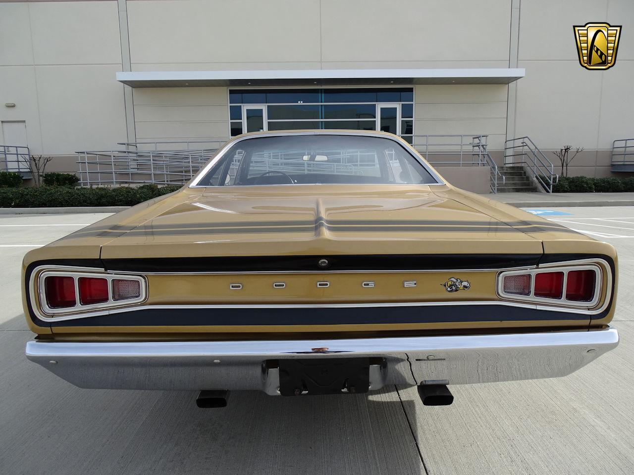

GMP440 Posted August 21, 2024 Posted August 21, 2024 Since we have the re-released MPC 68 Coronet kit is there anyone casting/3D printing a correct plain front grill and taillight panel to turn the 68 Coronet R/T into a 68 Superbee? 3

Mark C. Posted August 22, 2024 Posted August 22, 2024 The Plymouth part is an entirely different animal. It would be nice to be able to do a ‘68 Super Bee. We would also need decals and preferably a low-line interior, with bench seat.

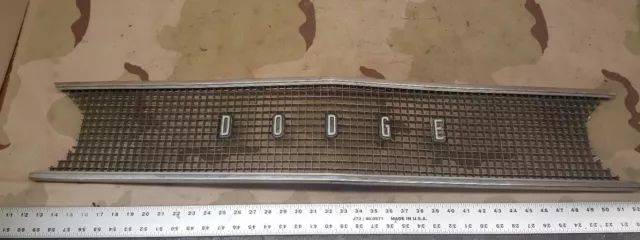

Force Posted August 24, 2024 Posted August 24, 2024 The 1969 Charger 500 uses this grille don't they? But the only Charger 500 kit is the old MPC kit.
Mark C. Posted August 24, 2024 Posted August 24, 2024 6 hours ago, Force said: The 1969 Charger 500 uses this grille don't they? But the only Charger 500 kit is the old MPC kit. IIRC, the Charger 500 grille does not have the DODGE lettering. More importantly to me is the tail panel, which is quite different in that the R/T tail lights are separate vs being contained within a single trapezoid shape.
Can-Con Posted August 24, 2024 Posted August 24, 2024 (edited) Looks to me like a simple conversion to me. Scrape the trim from the kit tail and add some PE DODGE lettering and a bee decal. Modify the tail light trim with a simple addition of a thin piece of wire around the light section and foil it so it looks like all one piece. For the front, cut out the grille and replace it with the PE grille mesh from the MCG '67 Camaro and add PE "DODGE" letters. Edited August 24, 2024 by Can-Con 1
Force Posted August 24, 2024 Posted August 24, 2024 3 hours ago, Mark C. said: IIRC, the Charger 500 grille does not have the DODGE lettering. More importantly to me is the tail panel, which is quite different in that the R/T tail lights are separate vs being contained within a single trapezoid shape. You are right.
Mark C. Posted August 25, 2024 Posted August 25, 2024 (edited) 19 hours ago, Can-Con said: Looks to me like a simple conversion to me. Scrape the trim from the kit tail and add some PE DODGE lettering and a bee decal. Modify the tail light trim with a simple addition of a thin piece of wire around the light section and foil it so it looks like all one piece. For the front, cut out the grille and replace it with the PE grille mesh from the MCG '67 Camaro and add PE "DODGE" letters. Might work if the dimensions of the Camaro grille fit the Coronet opening. Not sure how I would make it work, though I’m sure someone of your skill level could pull it off. The taillights would still not look right unless you dremelled out the dividers and scratch built new lenses/housings. You could grind the ribs off the panels for sure. Or, for people with less motivation and lower skill levels such as myself, hope that somebody with the skills and equipment sees an opportunity to digitally print them and offer them as a kit. In the end it would look better than any scratch built conglomeration that I could come up with, plus there would be less photoetch sacrificed to the modeling gods… Thanks for the suggestions, though. For me it wouldn't be high enough on the priority list to attempt a conversion without a readily available kit... hence my involvement in this thread. Edited August 25, 2024 by Mark C. 2
CapSat 6 Posted August 26, 2024 Posted August 26, 2024 It’s a reasonable question. I’m sure a new grille could be sketched up in 3D pretty easily. The tail panel is another matter, not because it would be hard to sketch up, but because all of that detail is cast into the body on the ‘68 kit. It would almost be easier to just grind the vertical bars out from the center area, and cobble up any missing trim, otherwise, any new piece would have to be installed only after carving or cutting out the tail panel in the body. I’m not an insider, so I have no real idea, but I would be willing to bet that Round 2 has sketched up Super Bee parts for this kit, and that they will eventually follow up with one.

Mark C. Posted November 4, 2024 Posted November 4, 2024 Another thought for the grille is the one from the old ‘69 Charger 500 kit. The 1:1 Charger 500 used a ‘68 Coronet grille, but I don’t know how the fit would work out from the model kit side of things. You would still have to add the D O D G E lettering as well, I think.

CapSat 6 Posted July 3 Posted July 3 (edited) On 11/24/2024 at 7:29 AM, Abnormal said: Hello, I'm also interested in a '68 Coronet grill (with lights) to fit in a '68 Revell Charger. Would it be possible ? You could do it the way Dodge did it- use a grille from the new ‘68 Coronet kit. Scrape the “R/T” emblem off as best you can, and fit it to the ‘68/ ‘69 Charger grille opening. I have a 1:1 ‘68 Coronet grille somewhere in the basement. I got it super cheap at a swap meet about 25 years ago. I figured if I ever lucked into a ‘69 Charger, it would go on it, or at worst, it would make good wall art. Round 2’s new grille has been rendered more accurately than the old MPC piece, but I haven’t checked it for fit. The MPC Charger 500 grille (tooled around 1987, for the old General Lee kit) seems to have been created to fit that kit specifically. It looks just a little off to me as a result. My understanding is that the 1:1 ‘68 Coronet grille is a direct fit for the Charger 500. Lastly, Harts Parts does a resin repop of the old MPC ‘68 Coronet kit grille. I think it’s $5 on their website. It is different from the new Round 2 piece. When you compare them, the new one does look nicer, but if you like this one better, it might be the way to go. MPC 68 Coronet Grill – Harts Parts Resin You might need to compare them and test fit them. I’ll get some pics up comparing them tonight if I can. I’m using a Harts’ piece for a Charger street machine build I’m doing to recreate a model I built in the early 80’s. I took a General Lee, which at the time had a 500 body, and added a John Heyer resin cast ‘68 Coronet grille to make it into a 500. This was before MPC’s 500 kit was available. It was easier than modifying the back window, and back then, it wasn’t unheard of for rare muscle cars to get the street machine treatment. Rare muscle cars such as these were still cars to those who had them (although valued and revered), not insanely priced, and absolutely mythical to teens like me in the 80's! My build was Testors yellow, with a black painted Daytona stripe, jacked up in the back, with fat rear tires, and ‘70 Challenger bucket seats, Centerline wheels, a 440 Six Pack, and side exhausts, in other words: 80’s I stupidly ripped it down for parts several years later. Edited July 3 by CapSat 6 added link 1
