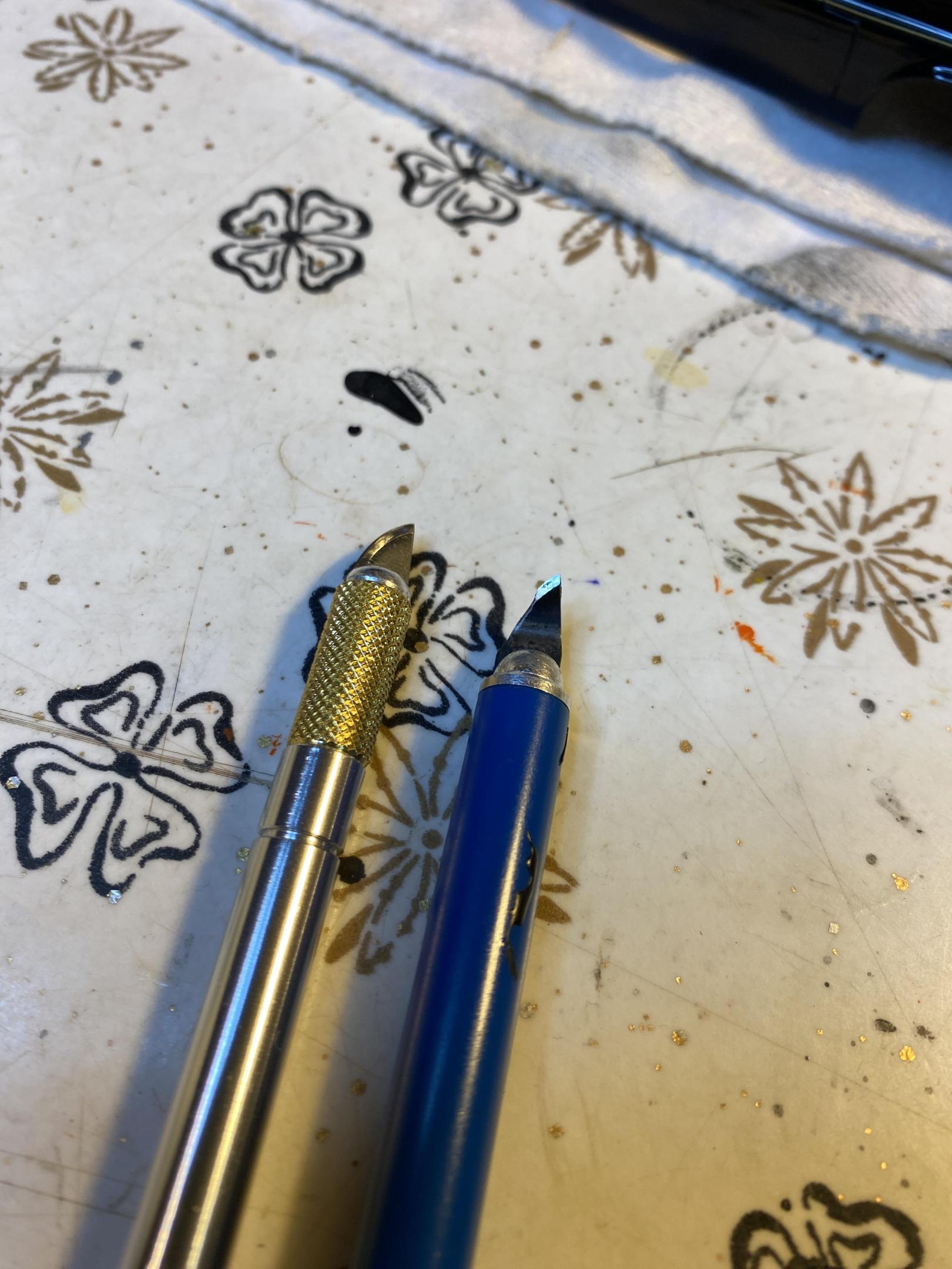

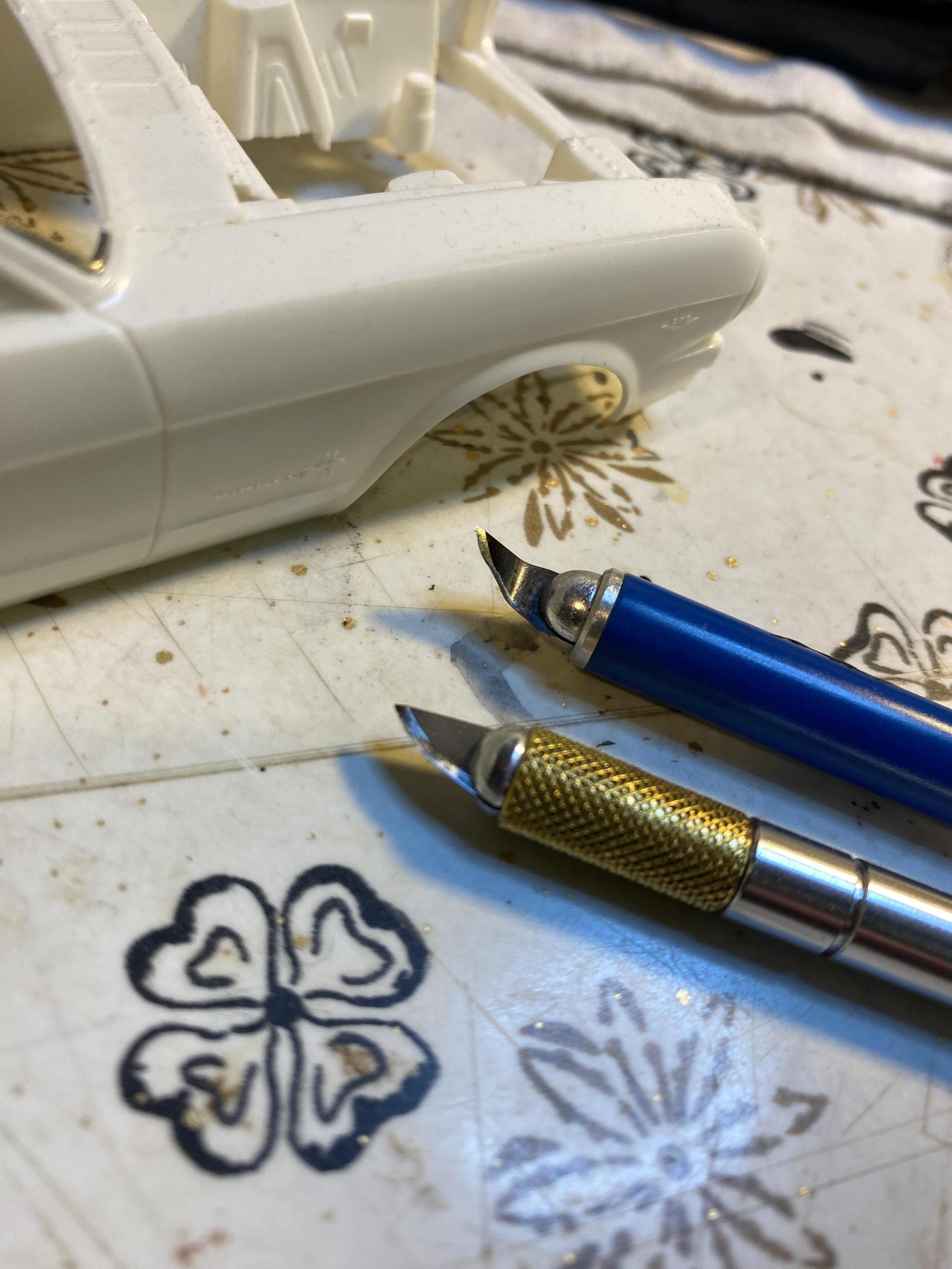

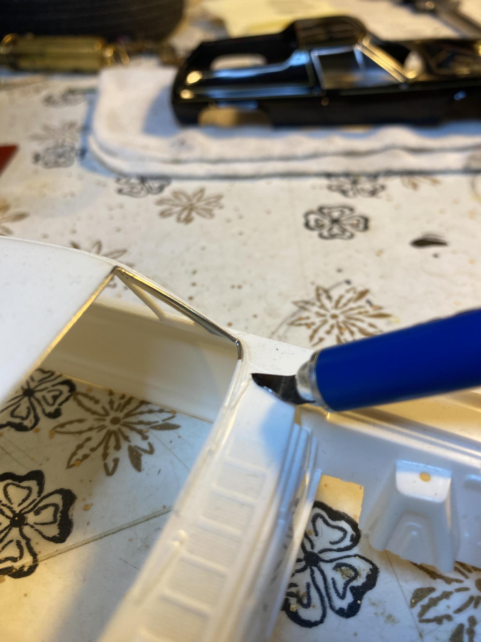

with a very sharp knife, I take very thin slices, baby steps.  It's more of a shave than a cut - thin cuts to avoid putting too much force on the knife.  Pushing too hard can cause the knifer to slip, gouging into the cowl vent or creating a big cut in my finger... so far, no blood.

A tool I find particularly useful for jobs like this is a curved blade heated and bent to about 30 degrees, and the cutting edge ground off save for 3 mm (.120") at the end.  To bend the blade I clamp the cutting end in a vise, use a pencil torch to heat the bend-area red and bend with a pair of pliers. It's important to clamp at the cutting end to sink the heat away from the cutting edge to preserve its temper.

I use a very sharp chisel blade to do most of the removal. I sharpen them up on a hard stone.
I really rarely change blades out. I keep sharpening them instead.
I tape around the wipers to protect the area surrounding them from scratches. I use a Tamiya chisel to slowly scrape off the wipers.
