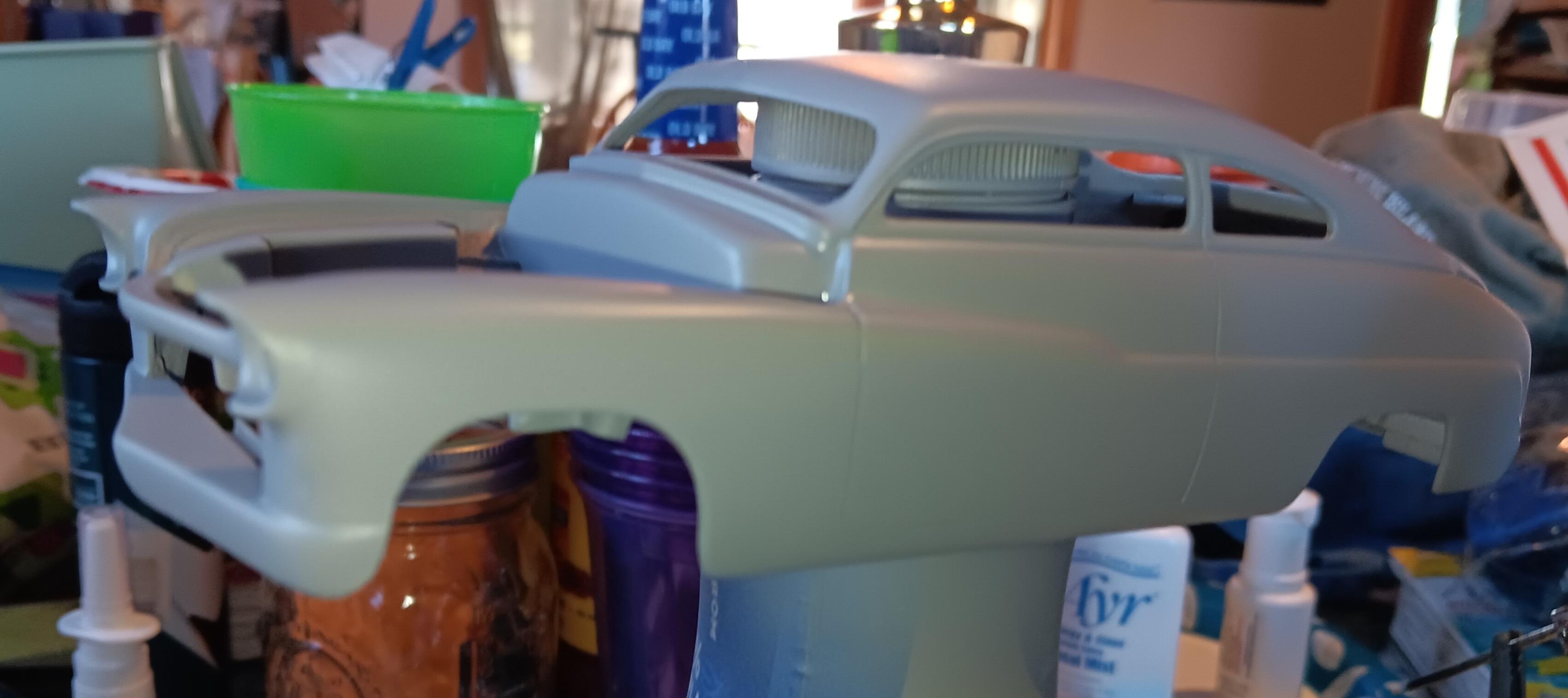

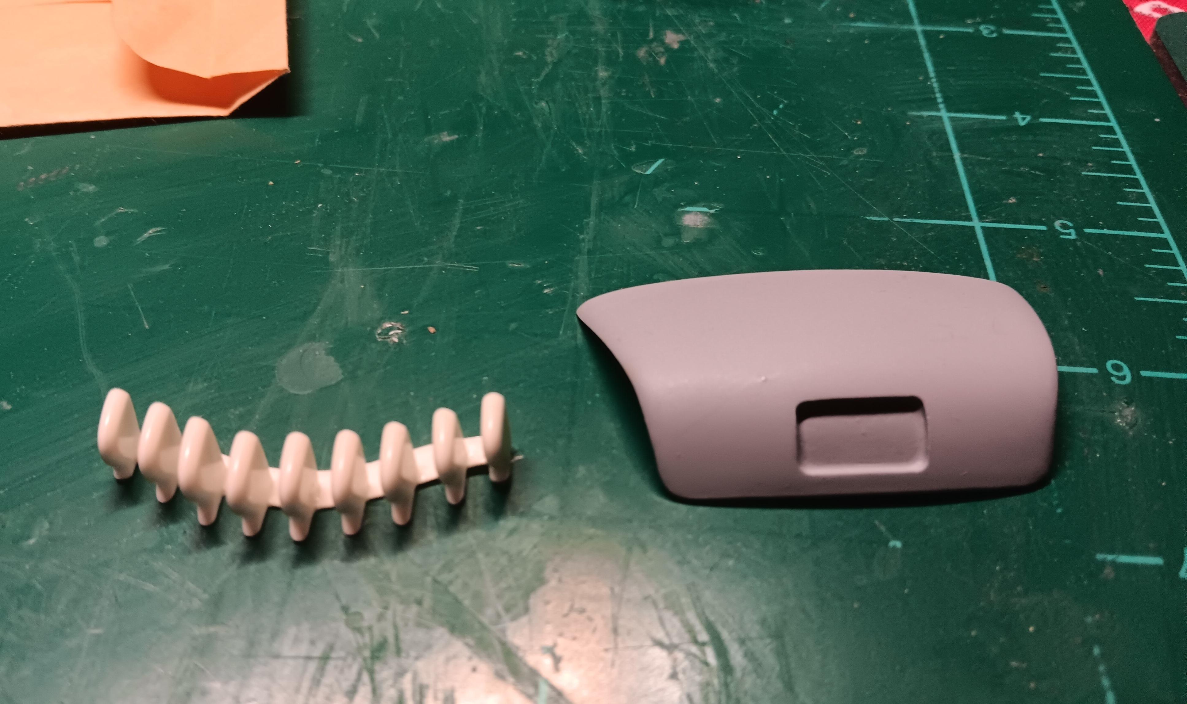

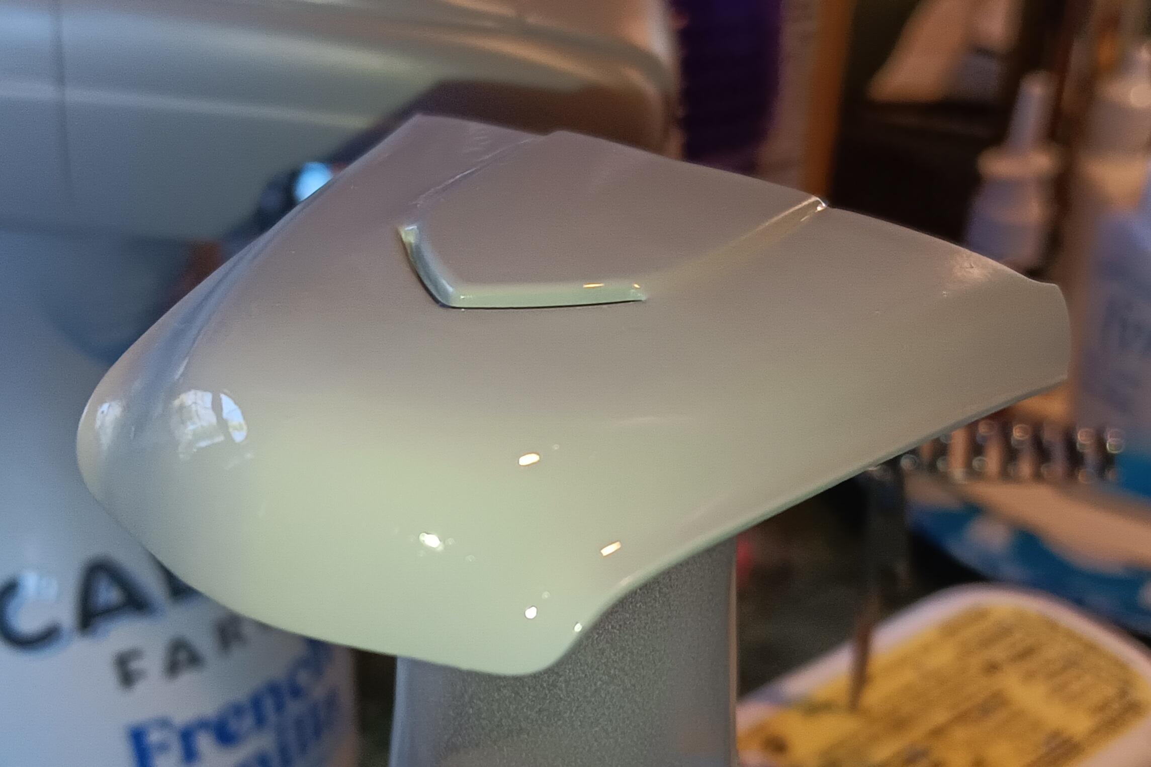

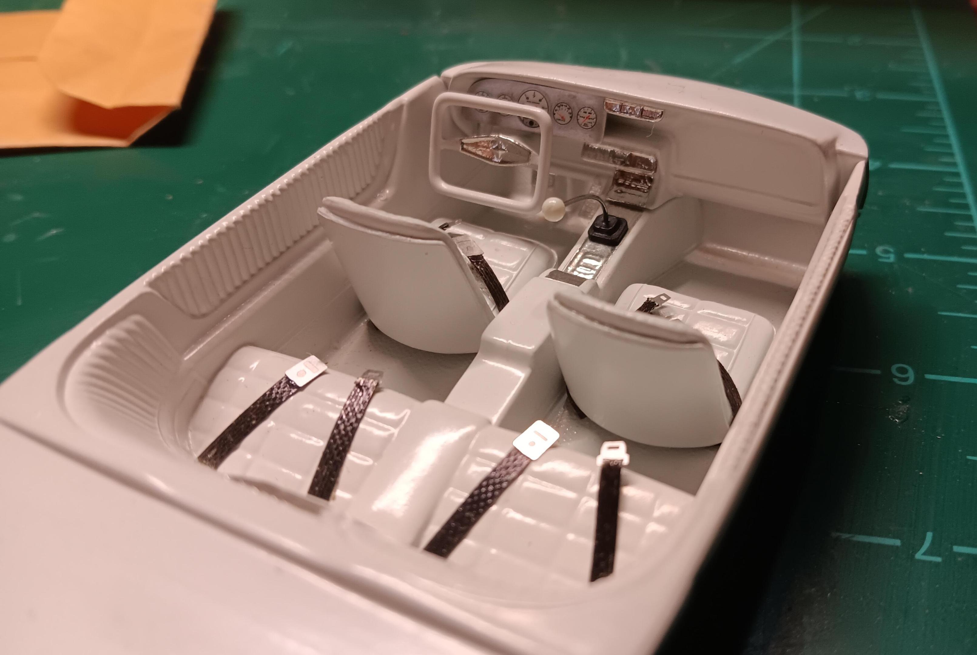

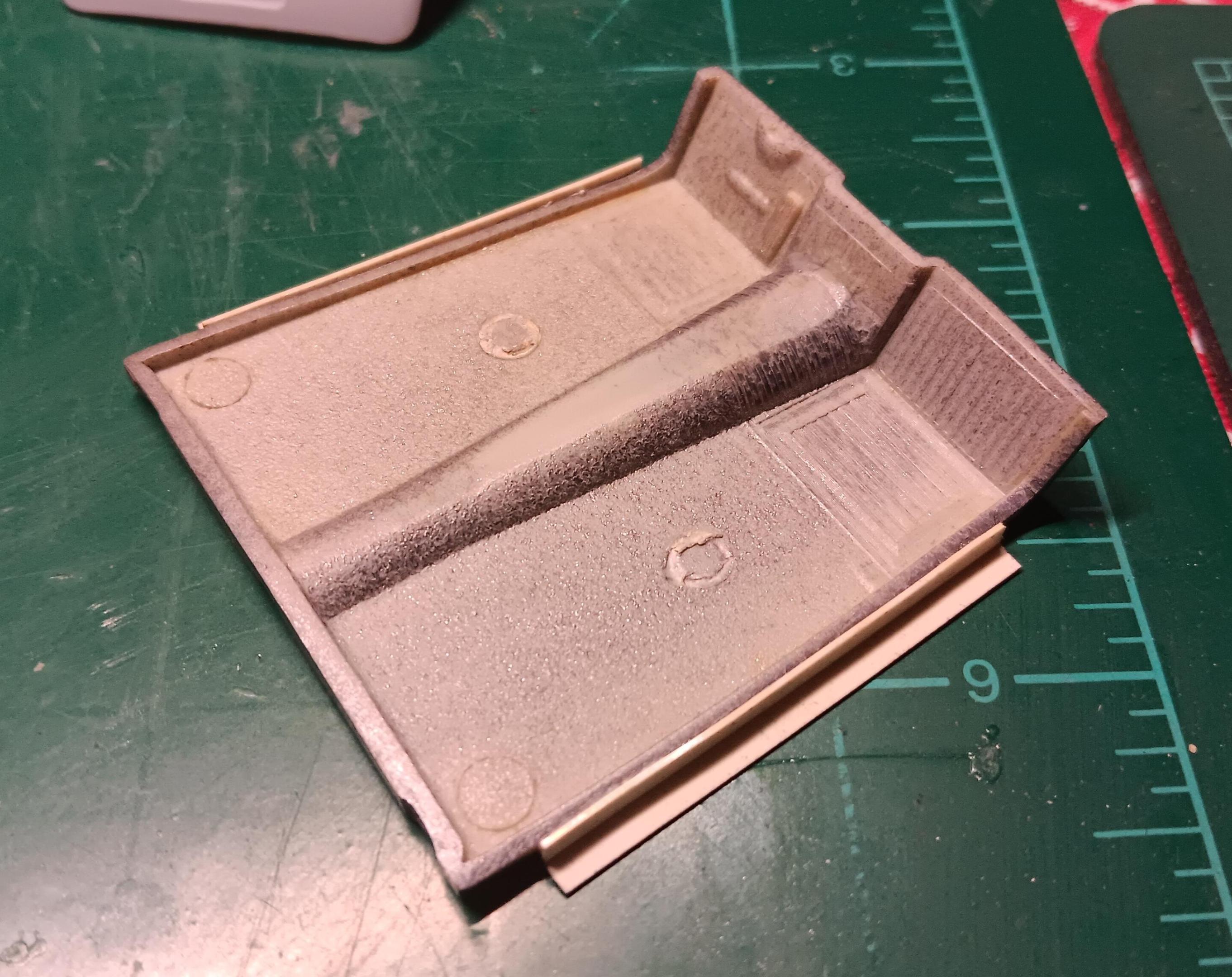

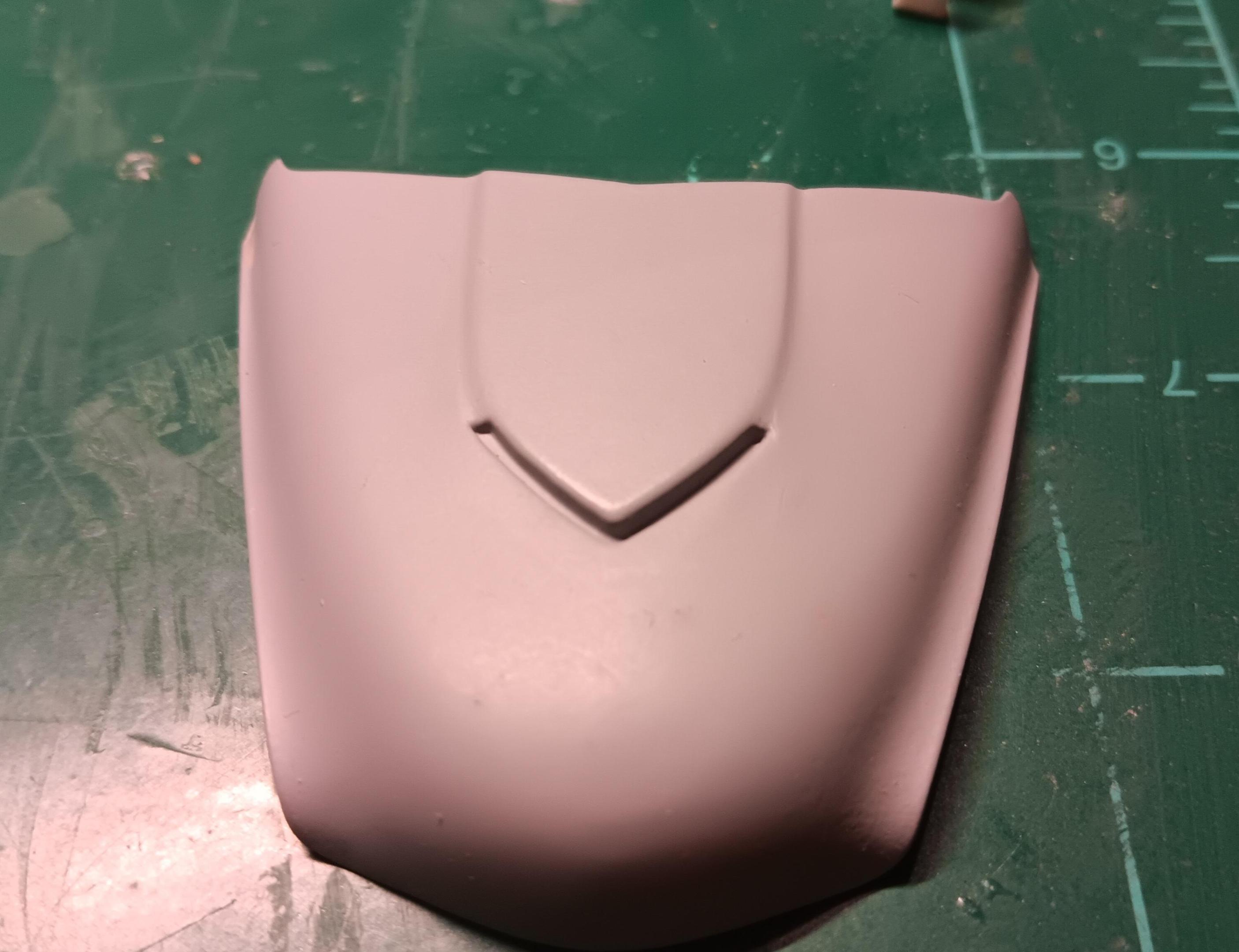

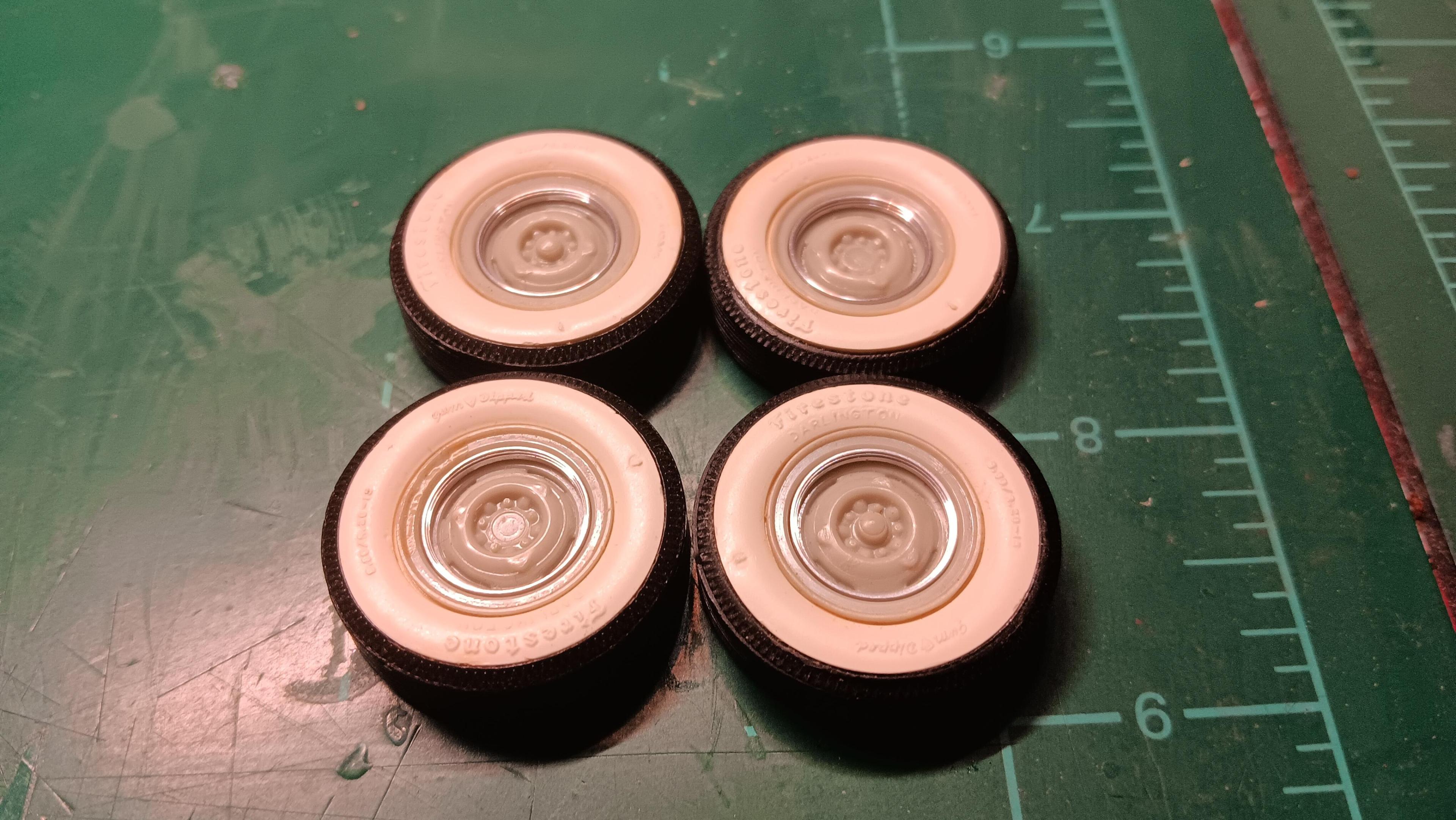

bobss396 Posted November 22, 2024 Posted November 22, 2024 I dug this out, determined to finish up some stalled projects. This is from around 2009. Resin body. I forget who made it. Most of kit is the AMT '49 Mercury. Interior tub and hood scoop are from a '66 T-Bird. I'm not 100% sure where the engine is from. I made up a dummy floor pan from the Mercury kit since the T-Bird tub is so shallow. Wheels are from the kit, tires from Modelhaus. Trim rings I machined from aluminum rod. Firewall is aluminum sheet, actually chimney flashing. Taillights were made from a piece of red plastic from the '37 Chevy. Grille is from Norm Veber. Trunk lid is sunken for the license plate. I have a load of small parts bagged up, I'll add more from my 3D printed stash. 5
espo Posted November 22, 2024 Posted November 22, 2024 The shape of the headlights on this body reminds me of the custom options in the original AMT '57 Chevy. The exhaust manifolds resemble what would be on a big block MoPar engine, think 383 or 440. Looks like the caster did a nice job on the chopped roof proportions. Like your firewall solution.
bobss396 Posted November 23, 2024 Author Posted November 23, 2024 14 hours ago, espo said: The shape of the headlights on this body reminds me of the custom options in the original AMT '57 Chevy. The exhaust manifolds resemble what would be on a big block MoPar engine, think 383 or 440. Looks like the caster did a nice job on the chopped roof proportions. Like your firewall solution. Yes, I really remember that '57 kit. Now I think this is a 440 from a Charger. I've had this so long, I forgot where the body is from. The chop is nice. I have notes with it about the windshield fit. I will be gluing the trunk lid on this one. In total, I have 3 Mercs in the works. 1
LennyB Posted November 23, 2024 Posted November 23, 2024 (edited) On 11/23/2024 at 6:19 AM, bobss396 said: Yes, I really remember that '57 kit. Now I think this is a 440 from a Charger. I've had this so long, I forgot where the body is from. The chop is nice. I have notes with it about the windshield fit. I will be gluing the trunk lid on this one. In total, I have 3 Mercs in the works. Only three in the works? You can never have enough Mercury’s. Coming along nicely. Edited November 24, 2024 by LennyB 1
bobss396 Posted November 24, 2024 Author Posted November 24, 2024 On 11/23/2024 at 6:54 AM, LennyB said: Only three in the works? You can never have Mercury’s. Coming along nicely. I likely have 3 of other things in yhe queue too. Planning on spending 2025 catching up on stalled projects.

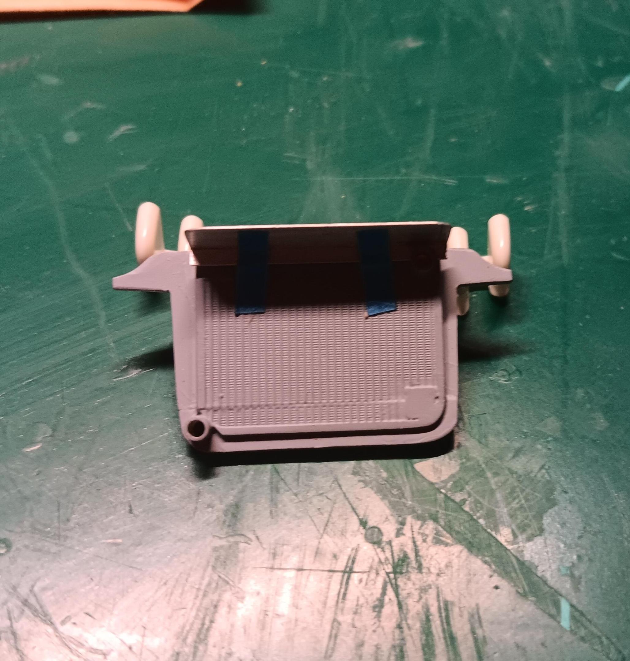

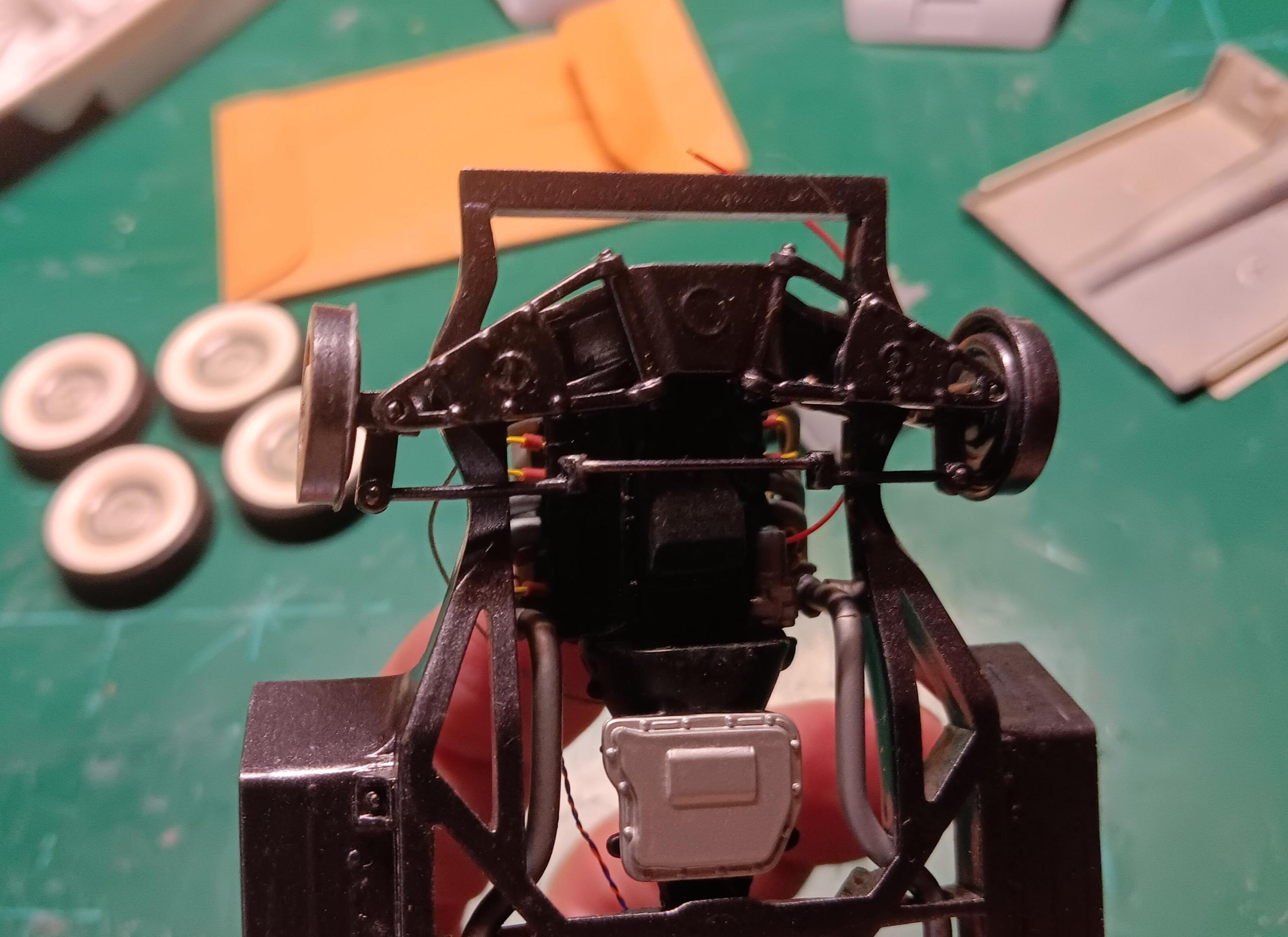

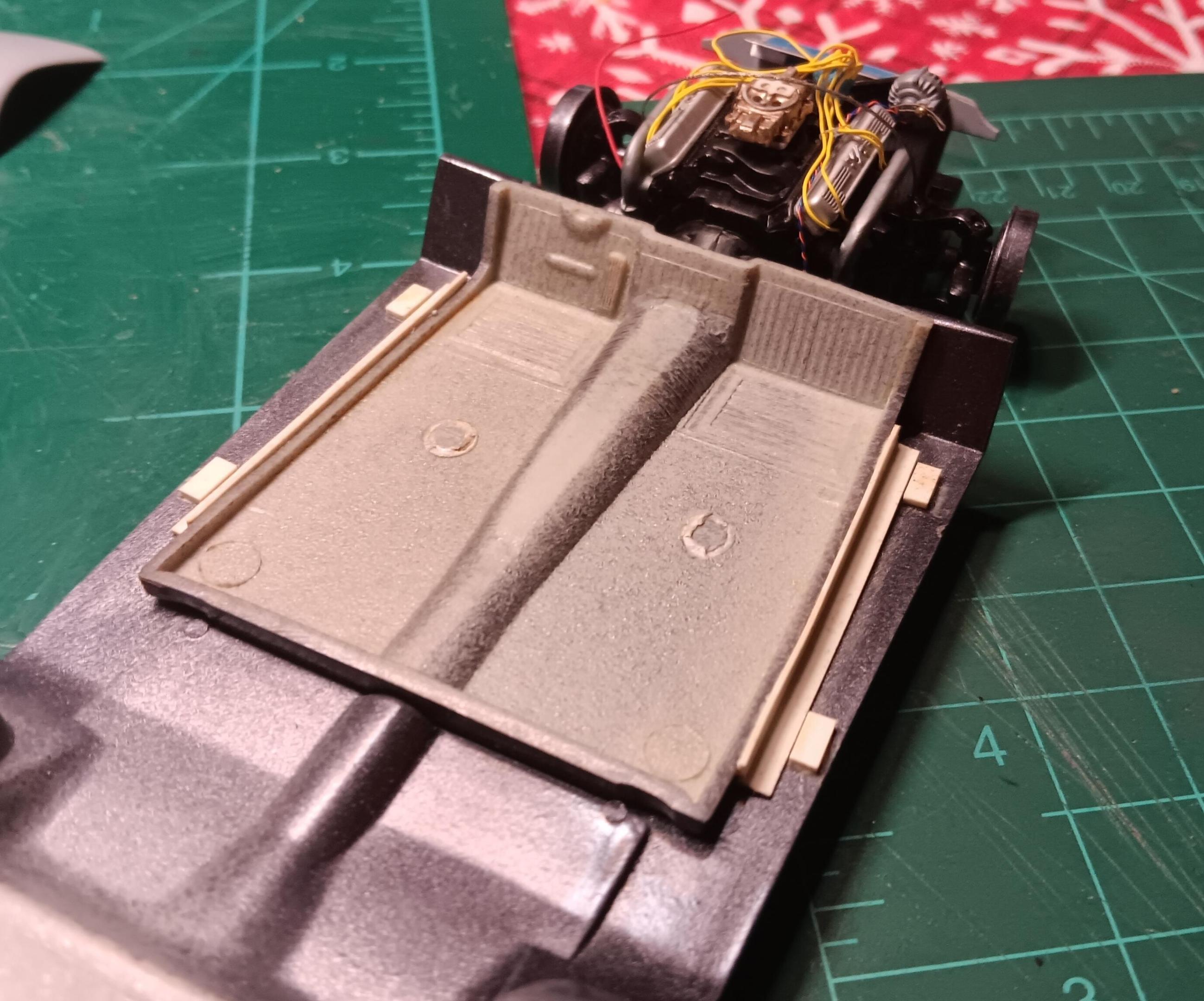

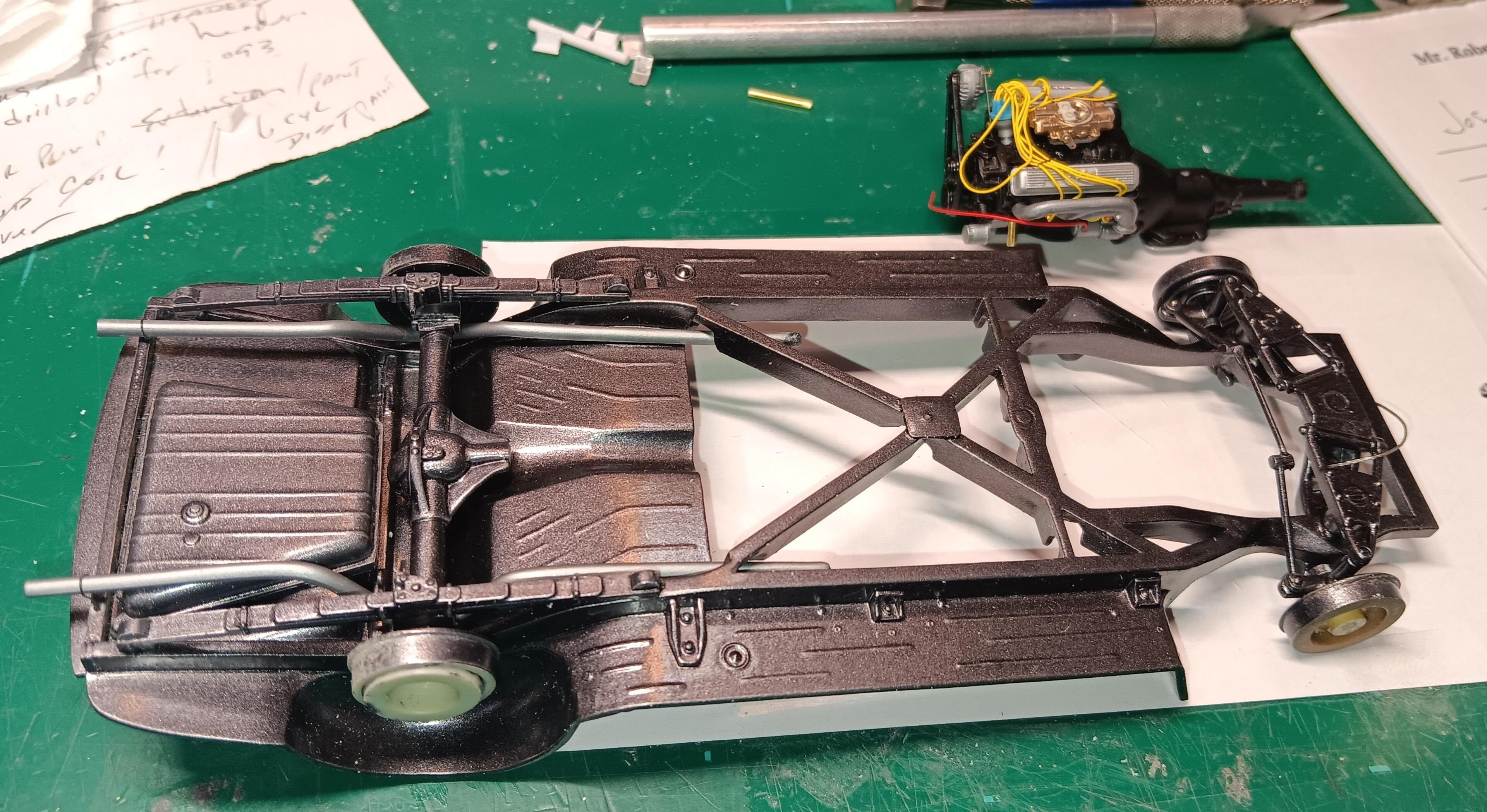

bobss396 Posted January 13 Author Posted January 13 Ok, back to work on this gem. The engine just about fell out of it, so I'm making new mounts up. The exhaust was loose too. I had forgotten I prepped it for sneaker pipes, I have some 3D printed side pipes on order. I may omit the under car exhaust entirely. The trunk lid had a license plate recess, I moved that down to the rear valance. I blocked up the exhaust notches too. The body work is close to complete, I need to squirt more primer on it. I just washed the body. Paint is a Mopar touch up spray. Wheels will match the body color, I machined up some trim rings a while ago. 1
