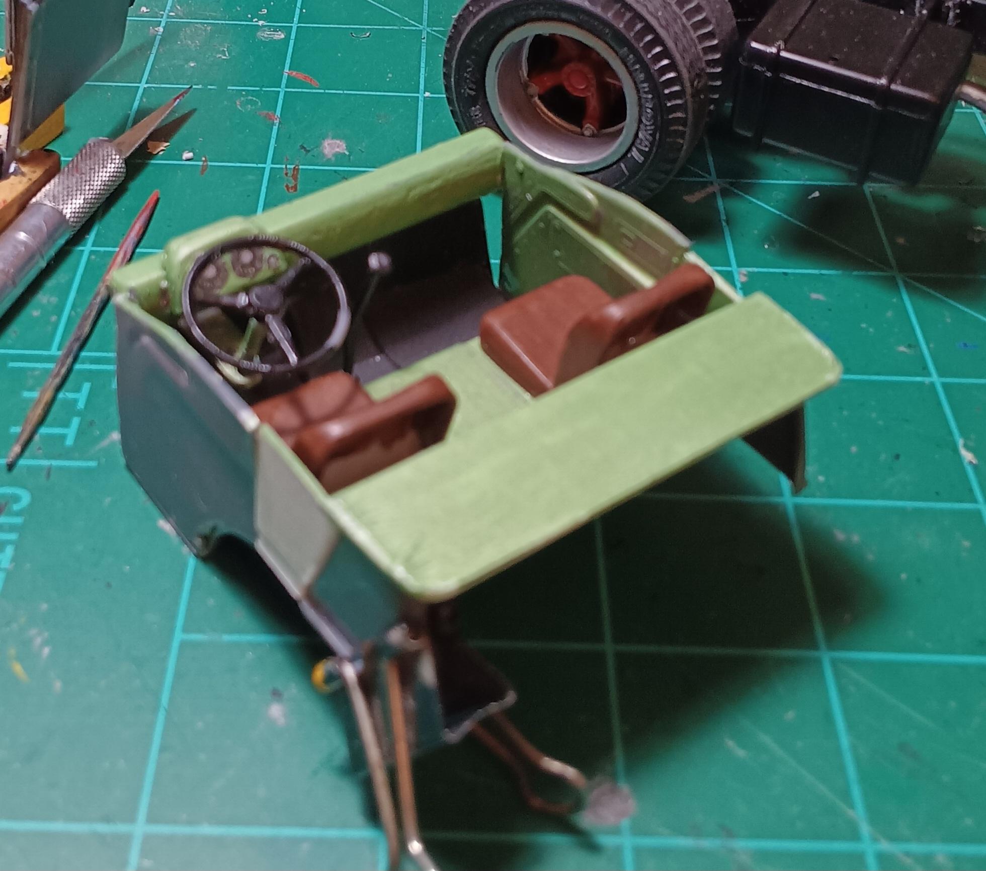

Interior is coming together with more period seats. Also inner door panels from altered L700 kit which is the donor.

Chassis and wheels and tires done.
Working on interior and trying to figure out an engine for it.
