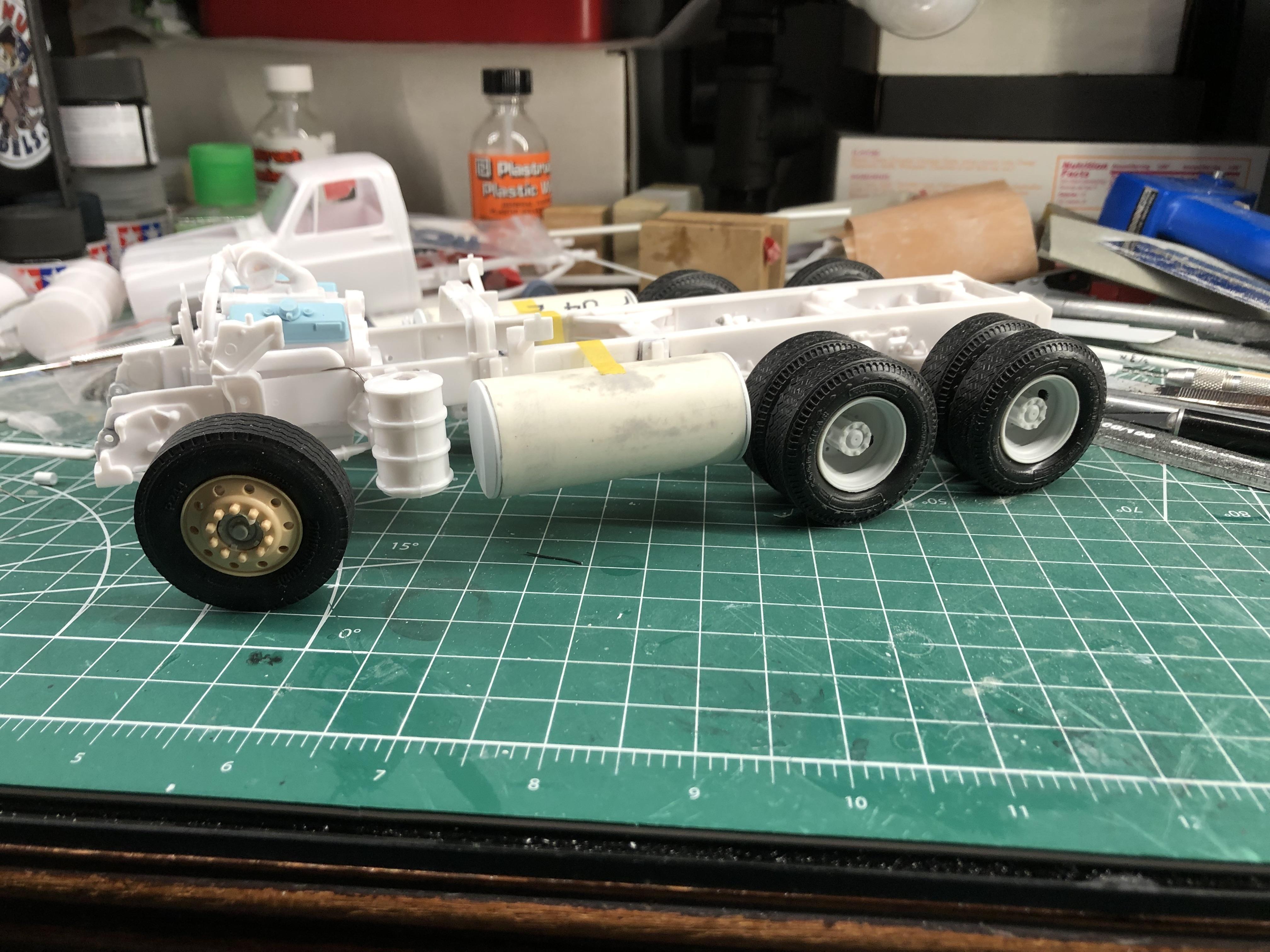

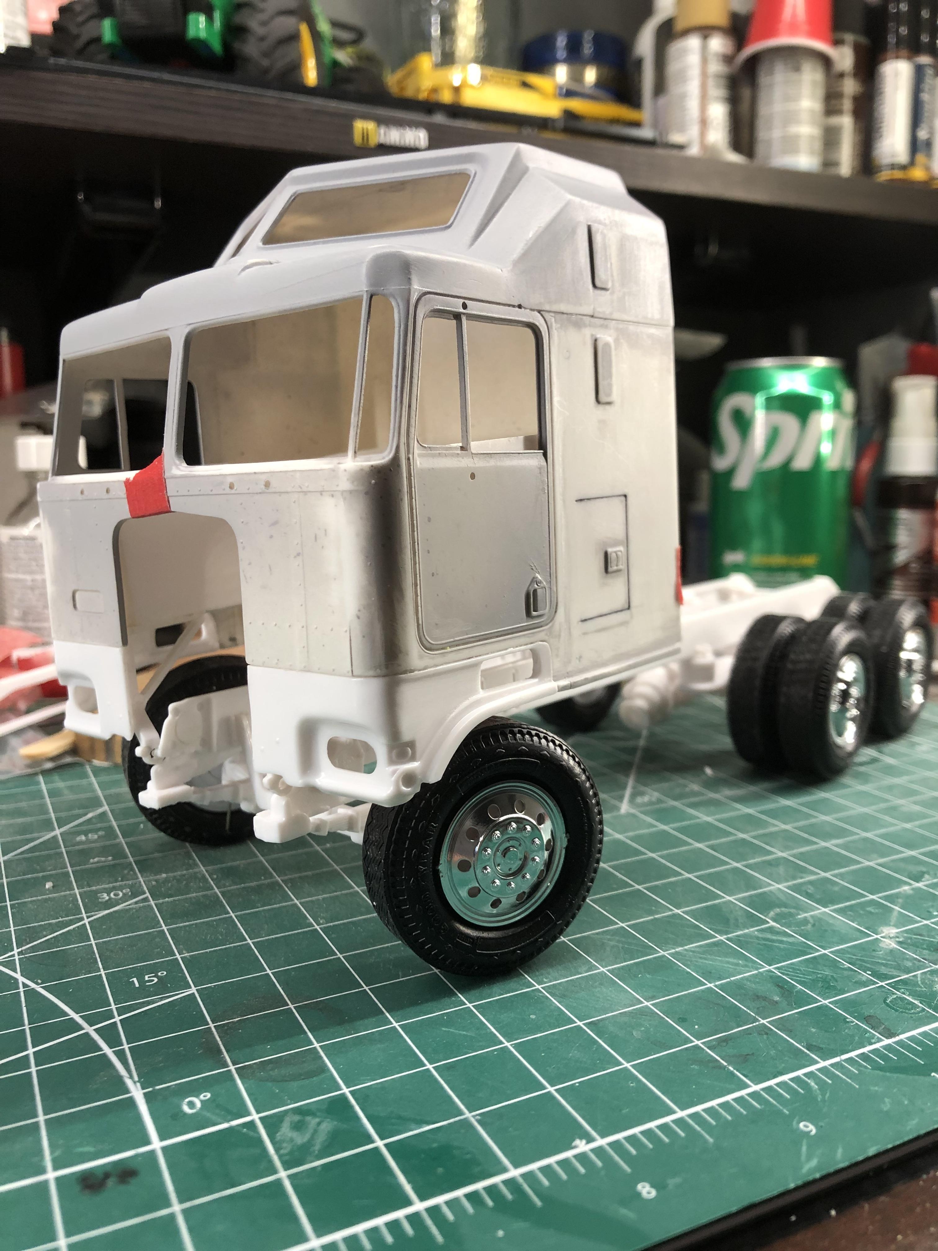

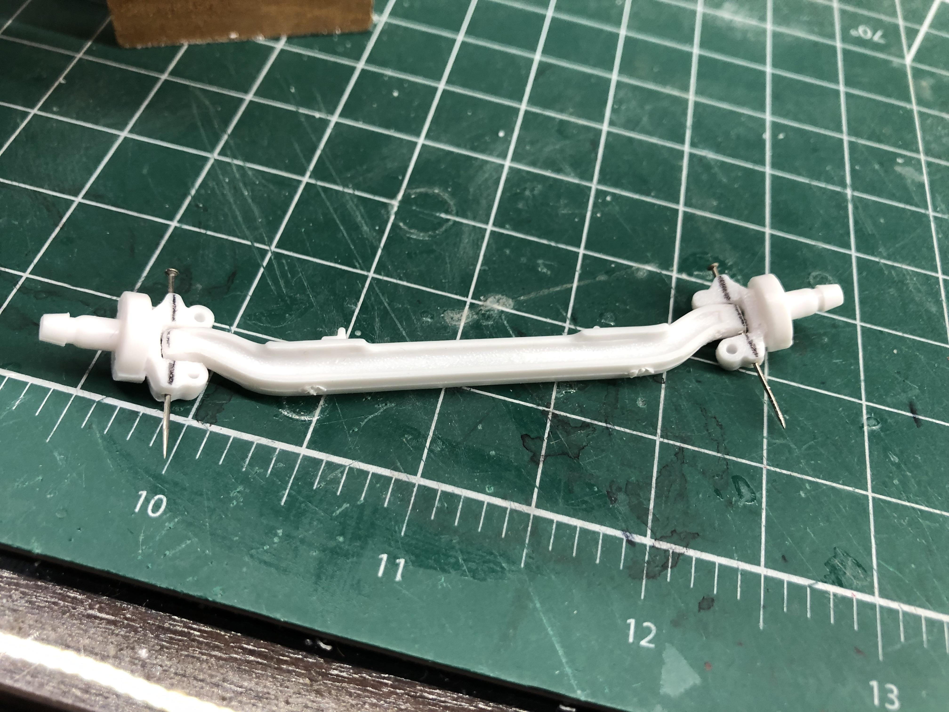

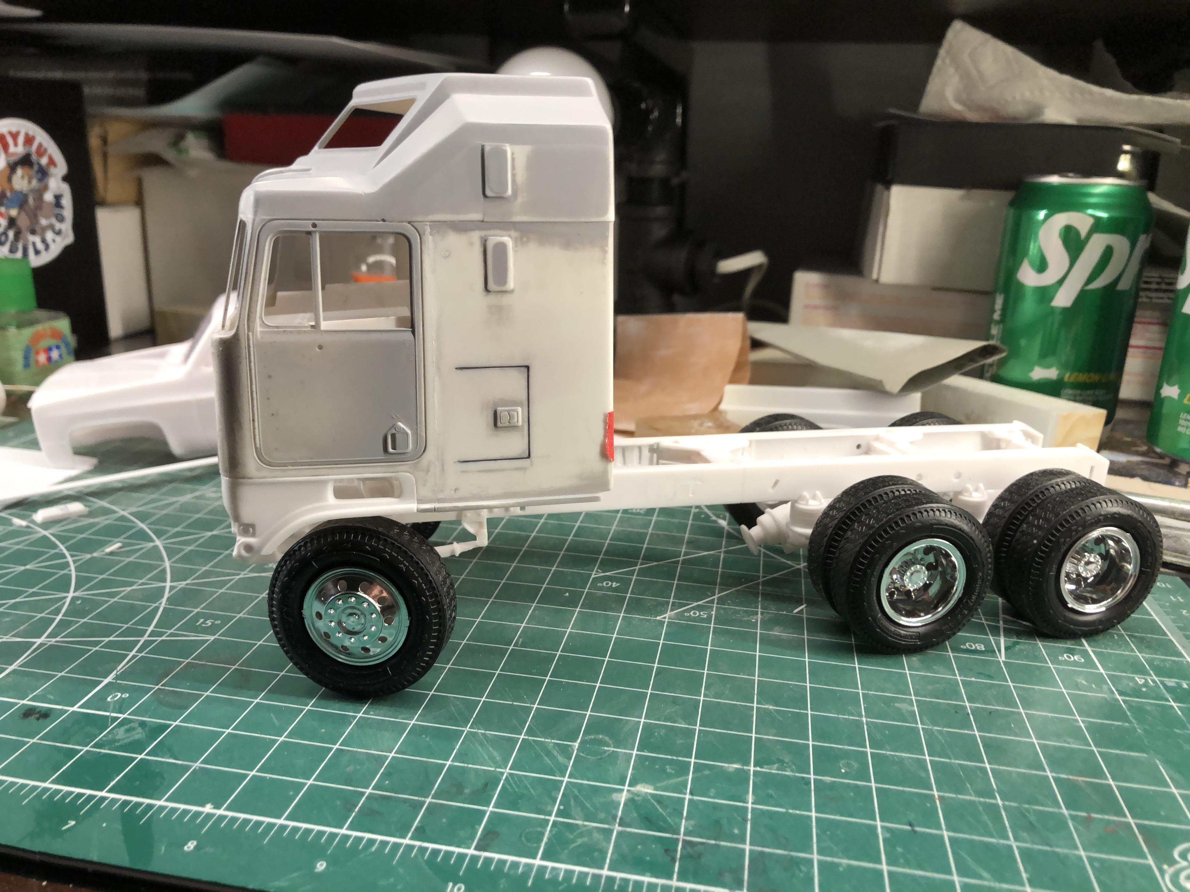

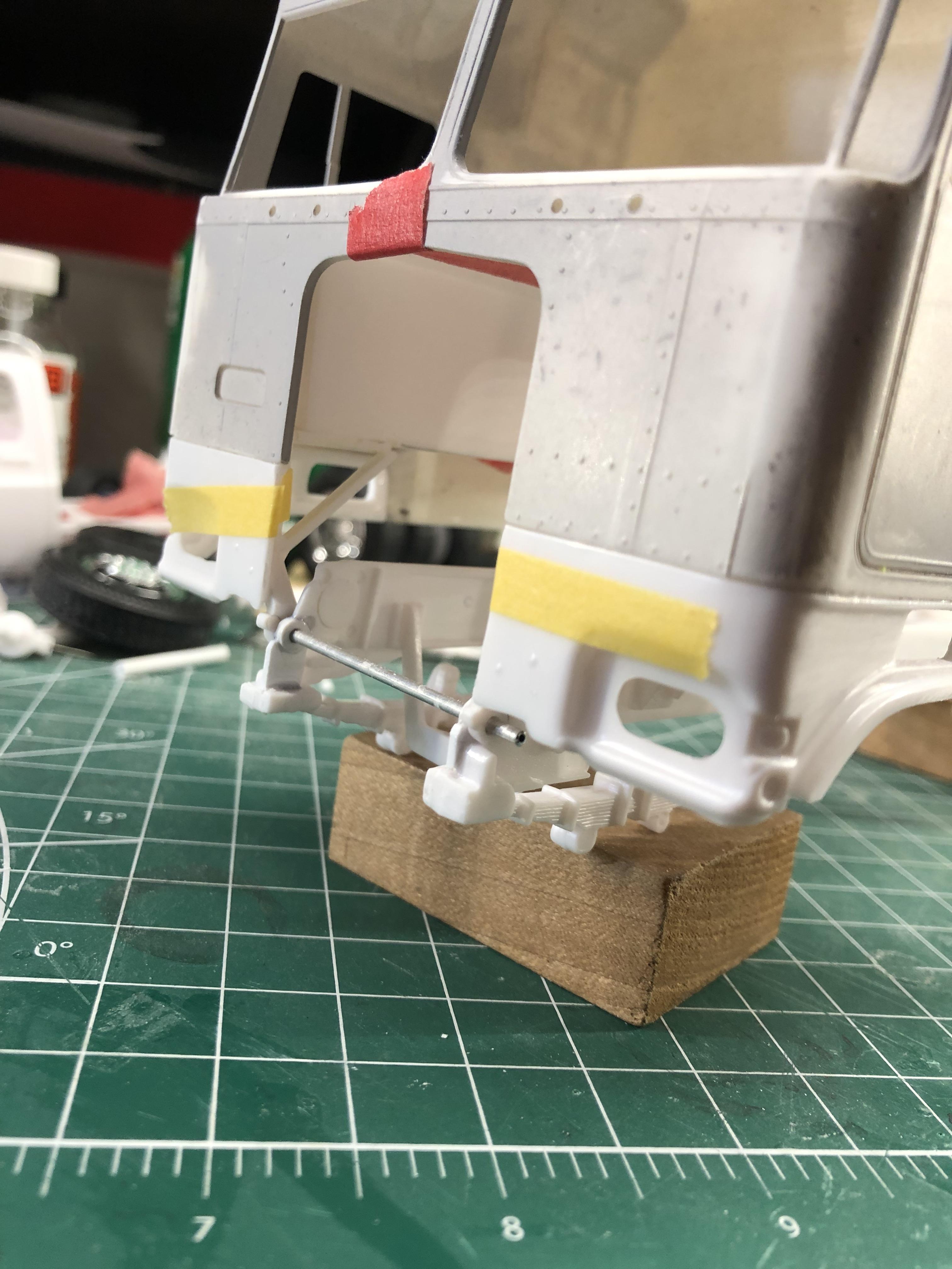

After being frustrated with International build I set it aside for now , I thought I would build another 86” Aerodyne got the cab cut apart and put back together , shorted the frame , made a steerable front axle , cut the step pockets off and removed the molded on KENWORTH letters. Here is a quick mock up .
Thanks for looking

Nice - it seems forever since anyone has done the poseable front axle.  I like the 86" truck length, something different and out of the box. Good to see your still here posting Mark.
  • Like 2
This is cool…… I see there is a square quad headlight up grade for the KW cabover too.  I really like the shorty version. This has great possibilities , looking forward to seeing this one come together ….
  • Like 1
That's really good work there, you'd never know how it started out. Great job on the front axle too, just hope it's strong enough. That would take me months!
  • Like 2
Nice job again on this conversion. There’s something I like better on the 86’ bunk than the standard one. Great job on the Posable steering I’ll be falling along.
  • Like 1

Thank you every one for the comments.
     Sean glad to see your  back on the forum as well , this axle is one of the easier one to modify.

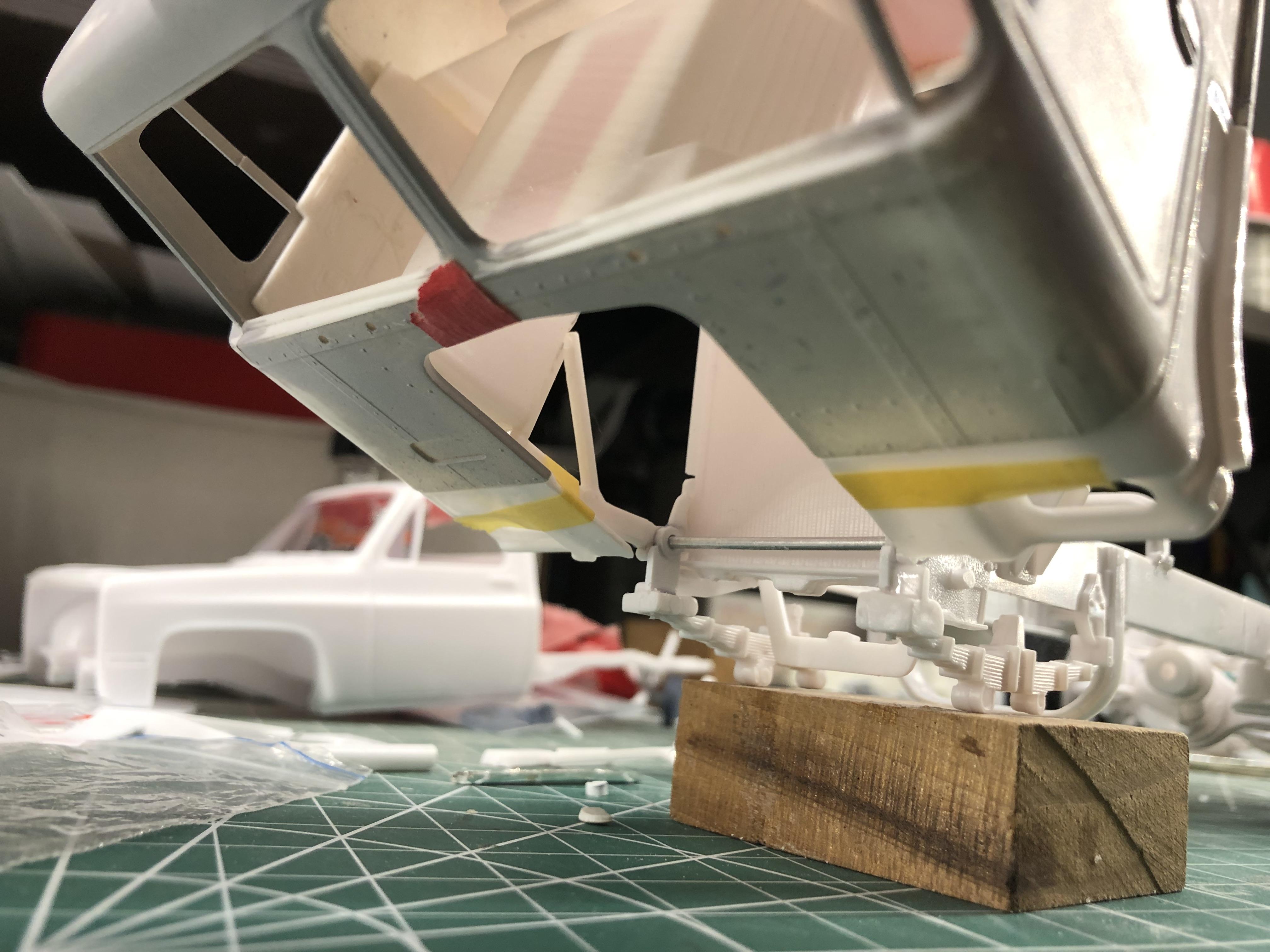

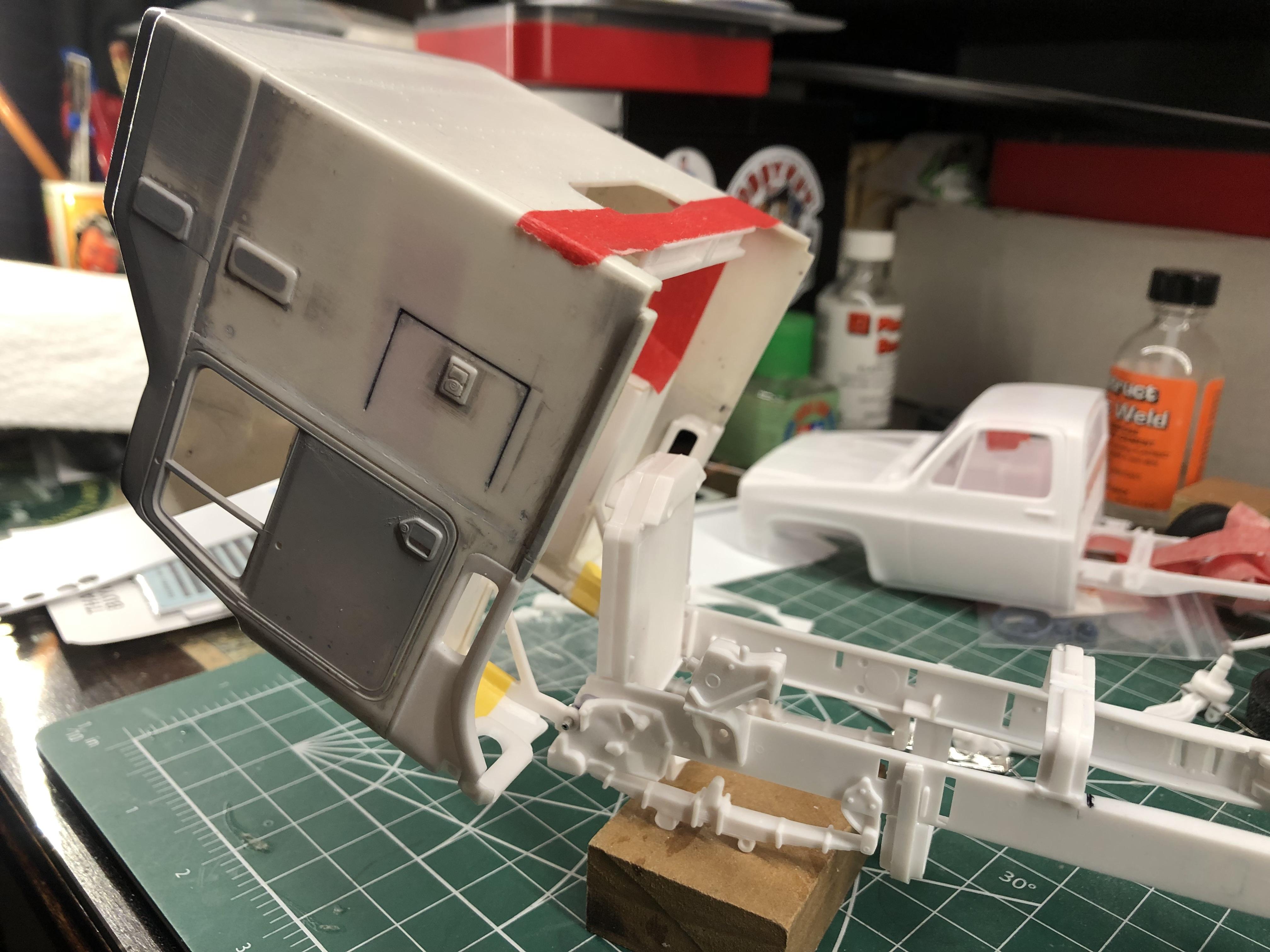

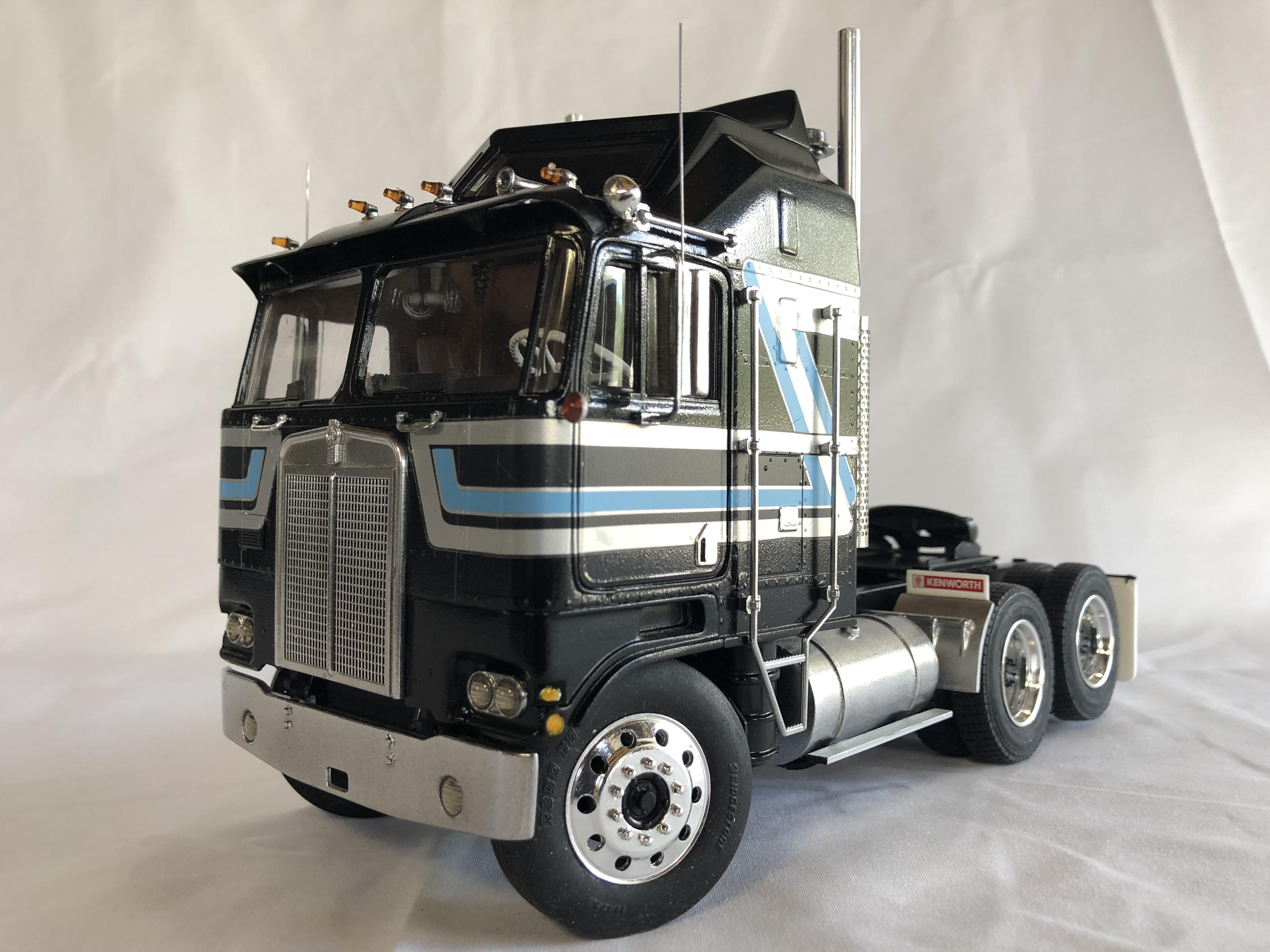

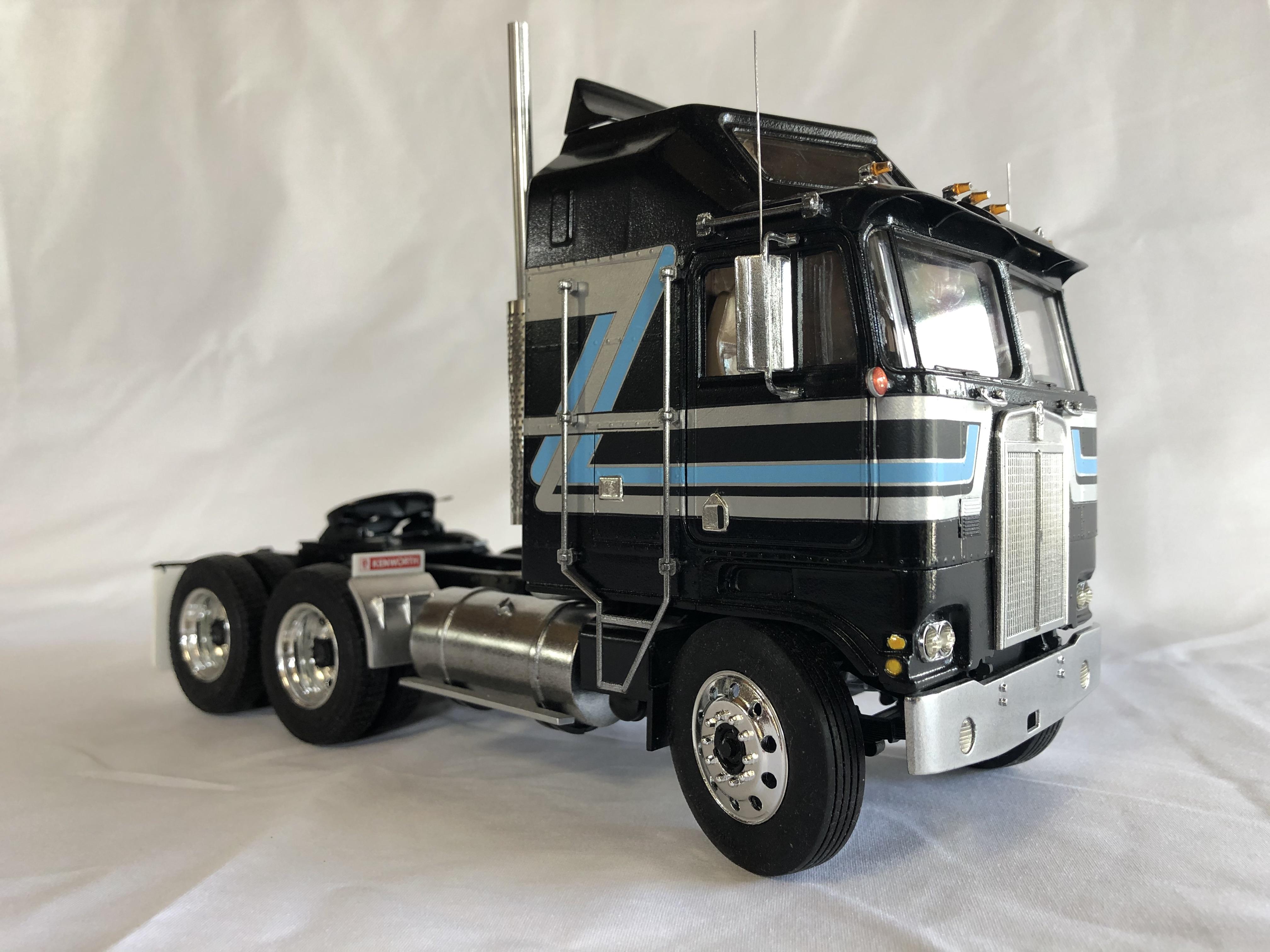

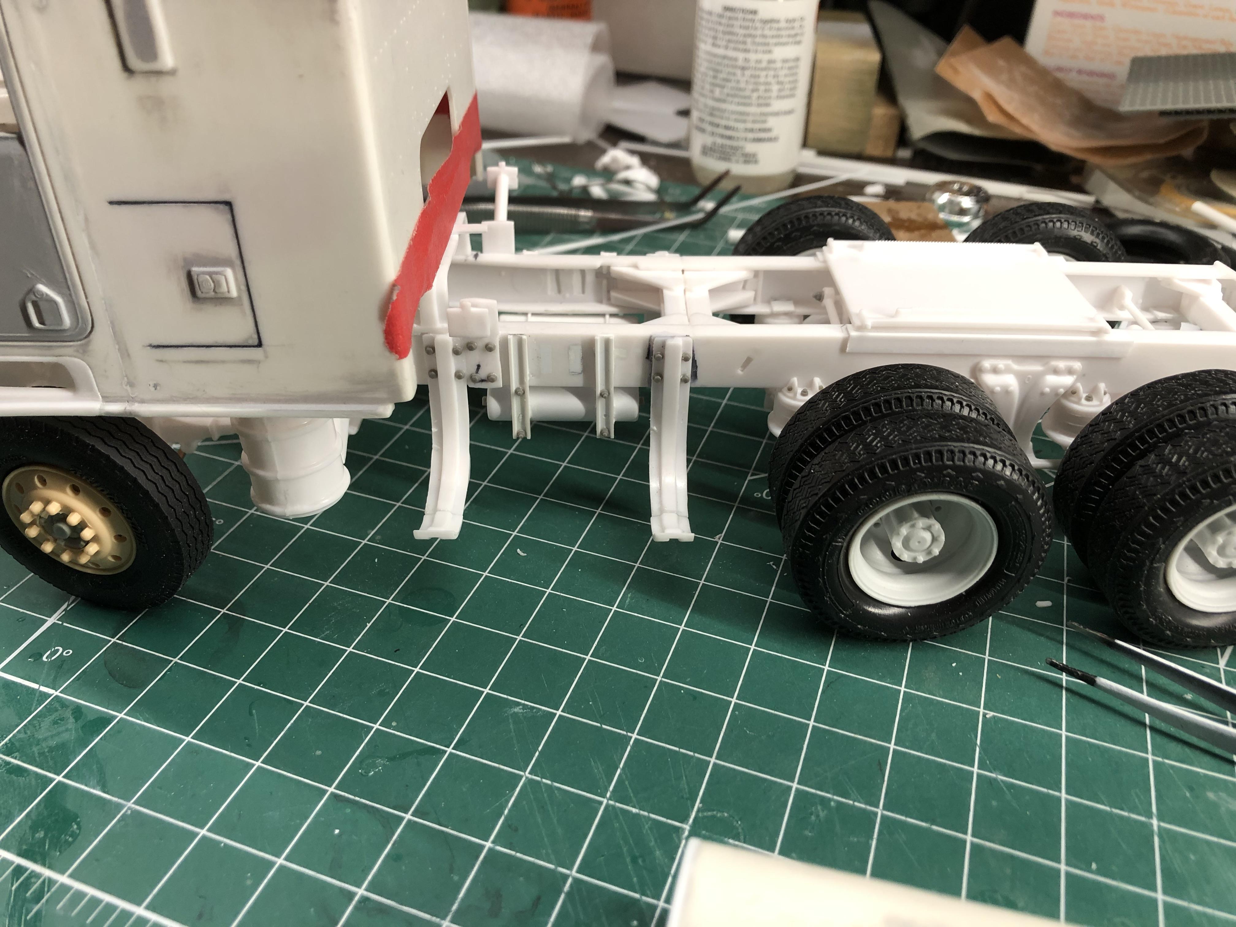

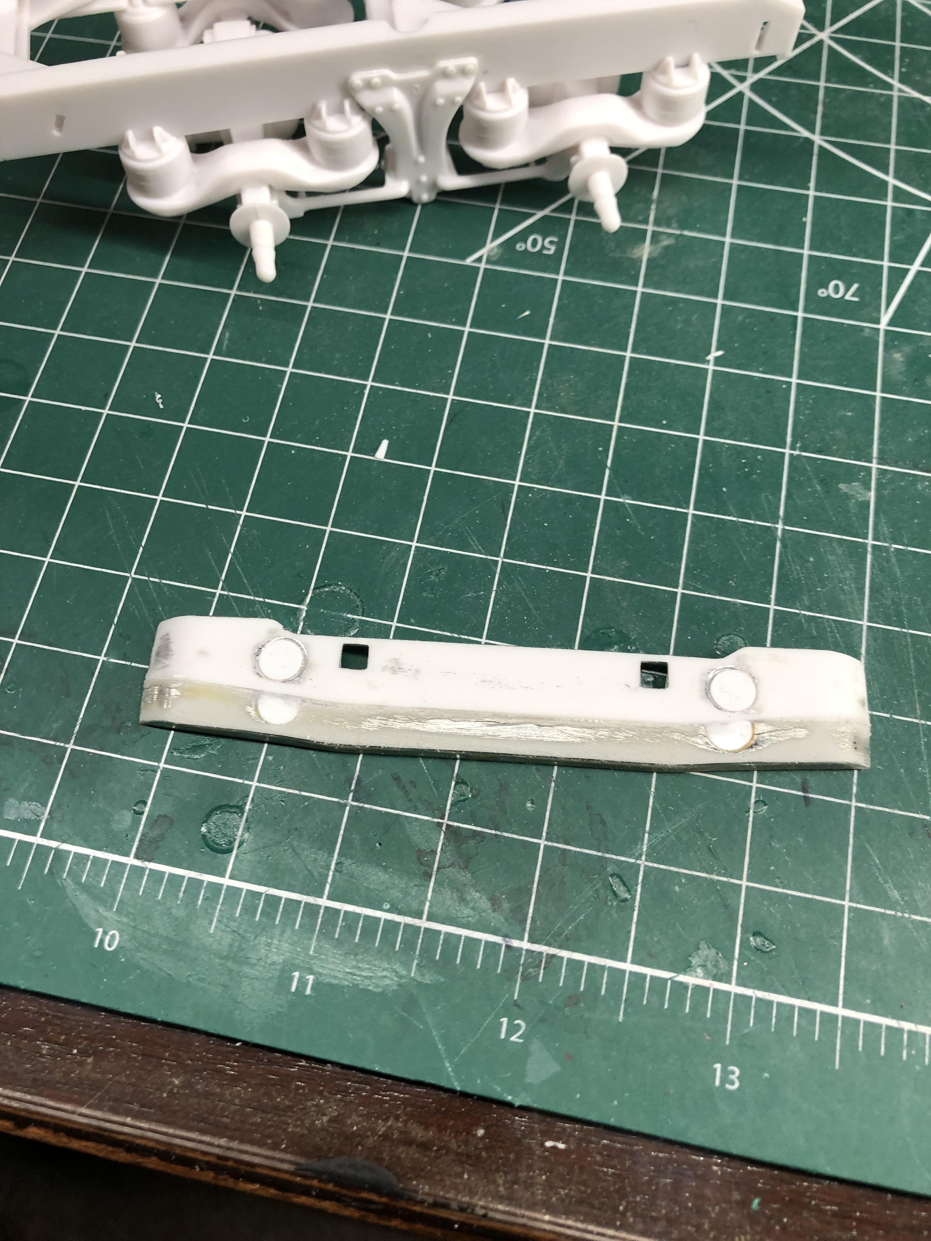

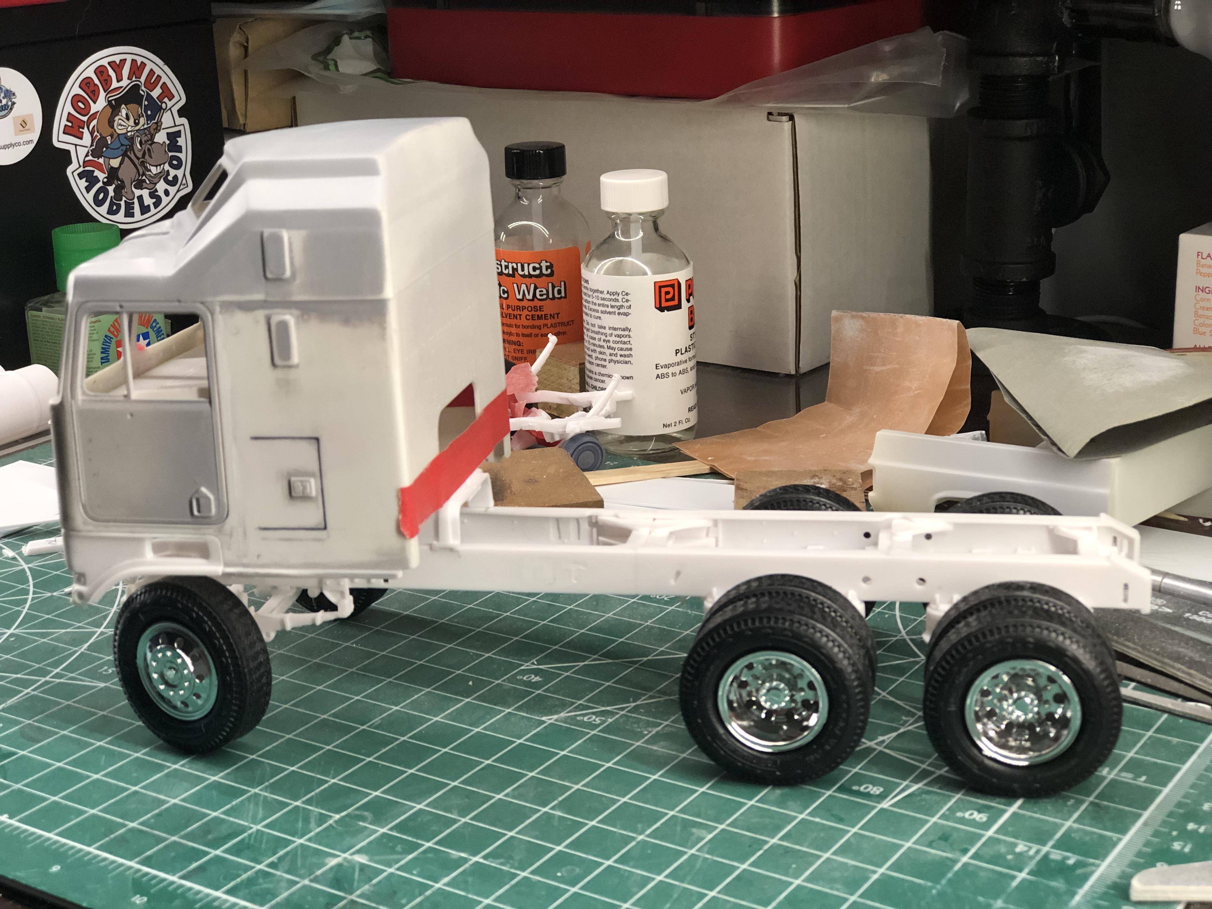

The mounting pins for the cab hinges are horrible I used some 1/8 styrene tubing glued to the frame and I used 1/16 aluminum tube for the pins (it will be shorten) . Got some of the rear suspension built. The front bumper is to narrow so I’m trying to make a wider one , we’ll see out it turns out . The last 2 pictures are of the first conversation I did a few years ago .

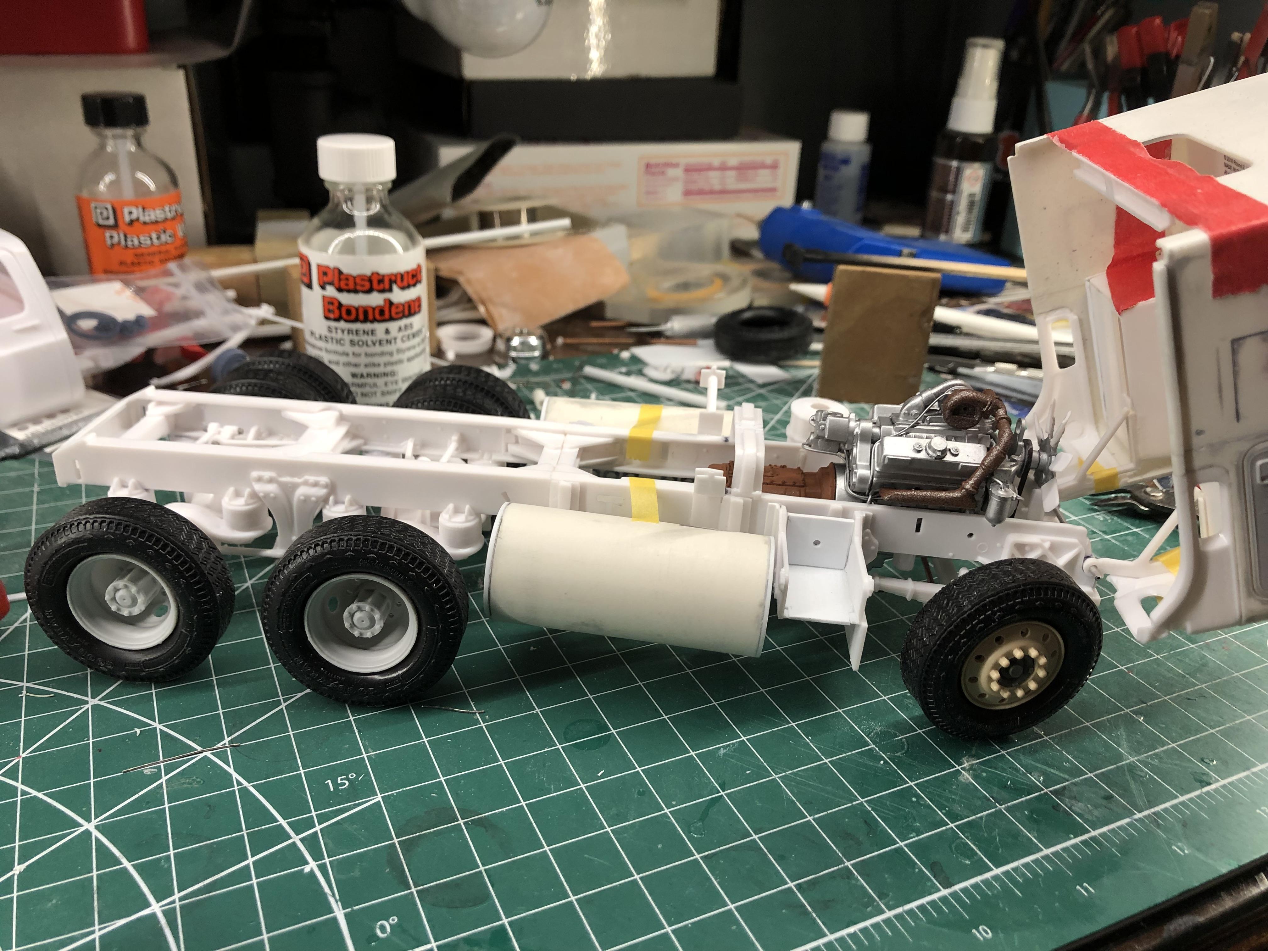

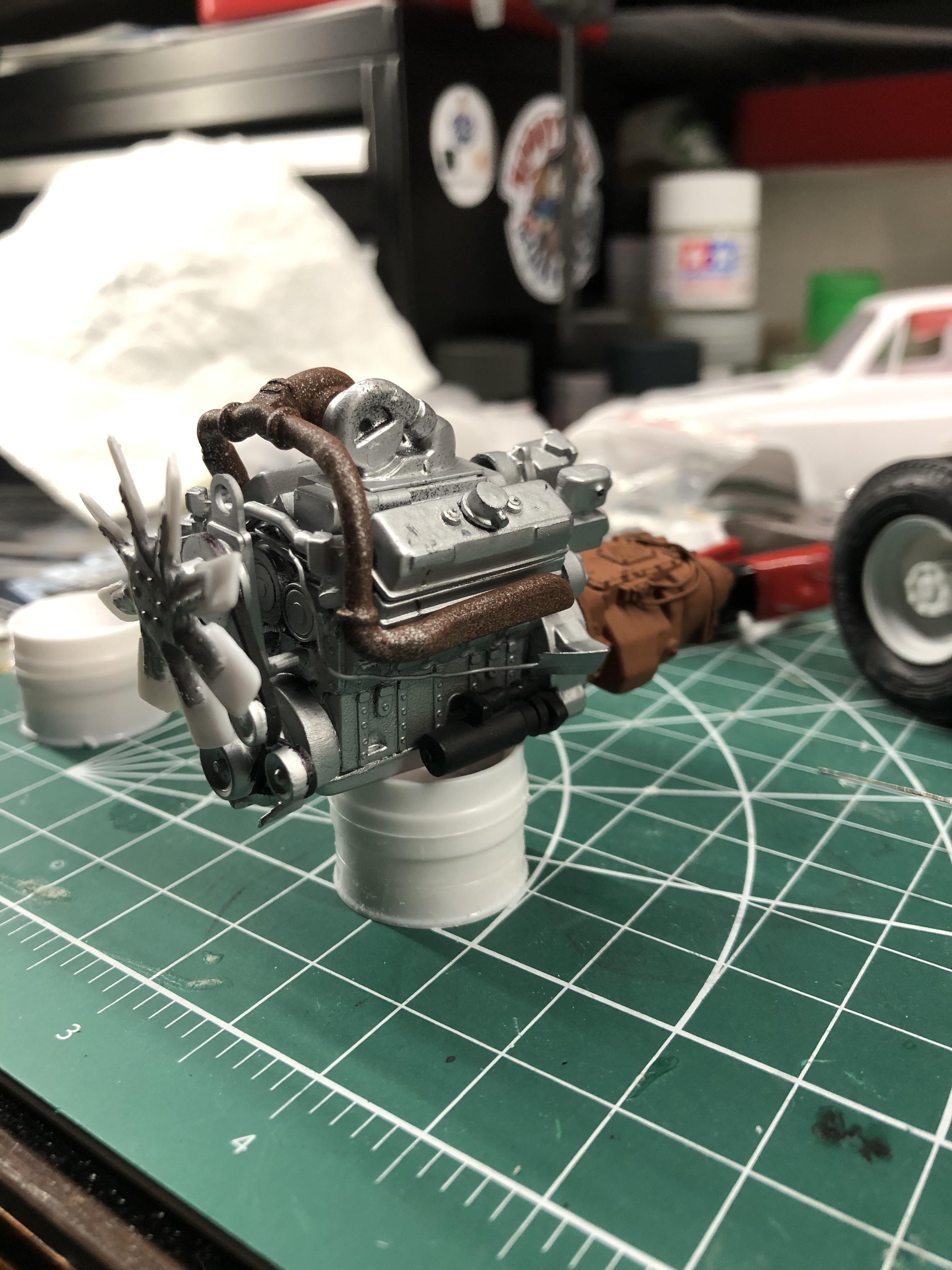

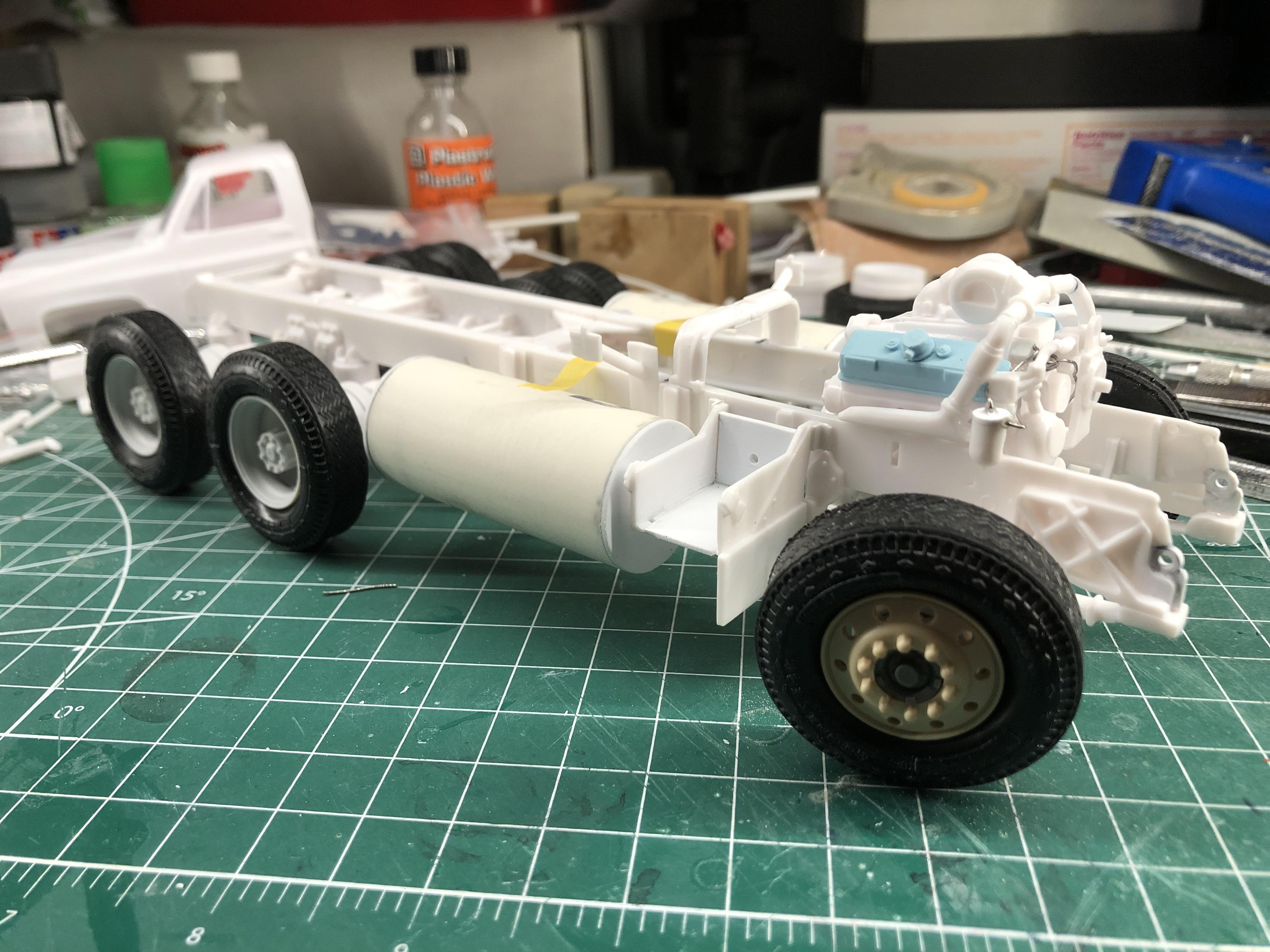

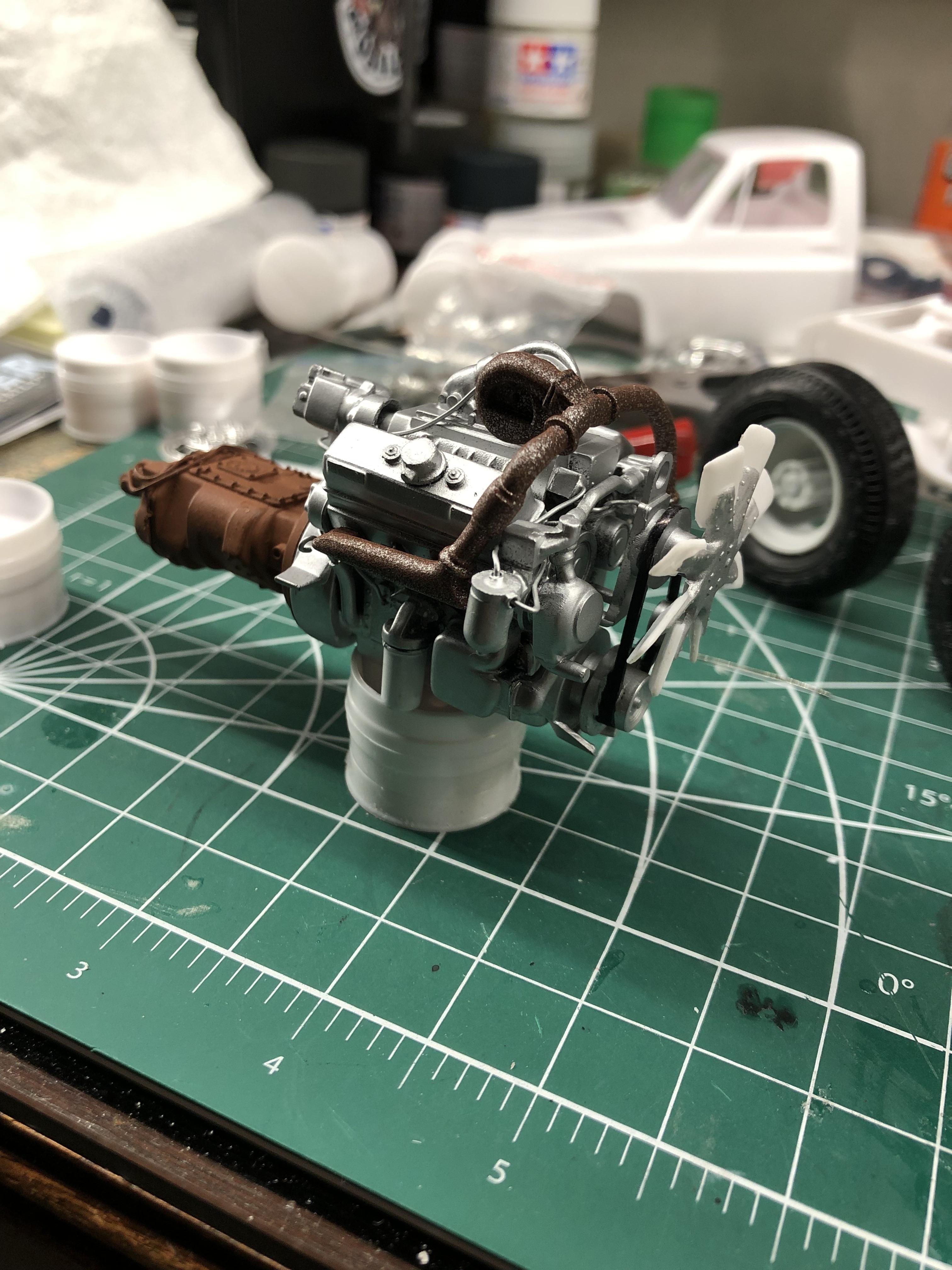

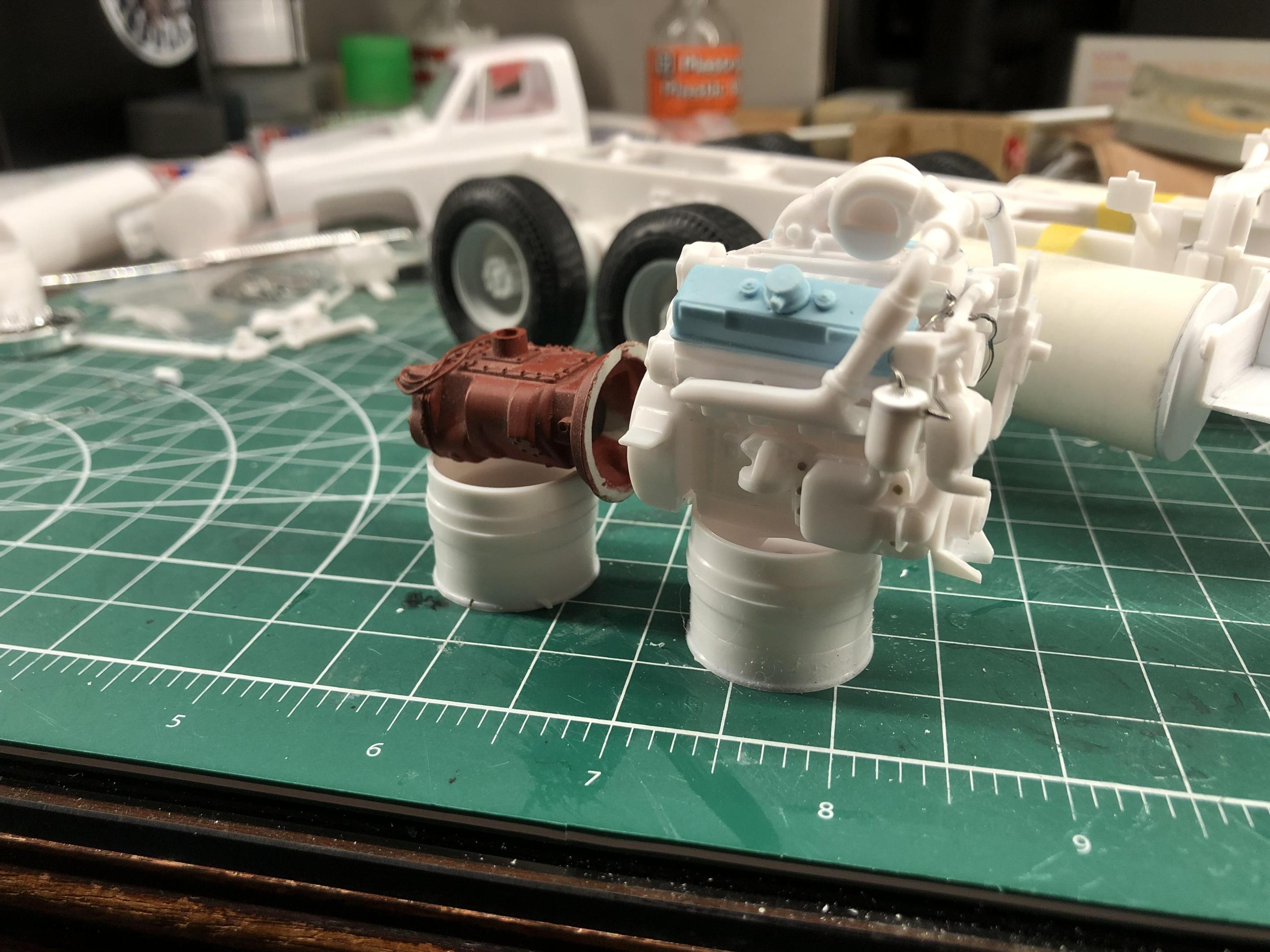

Thank you all for the comments. After the crazy busy holidays I was able to get a little model time today , I decided to go with the Detroit with Manuel transmission did alittle pluming on the engine , made new fuel tanks out of PVC, modified the battery box by cutting the molding in battery out and added plastic sheets to the bottom and back . I’m going with 2 hole Buds in the back from ST supply and 10 hole in the front from Jamie .

Thanks guys , I worked on getting the engine finished up just some basic pluming still have to do some weathering on it .
  • Like 7

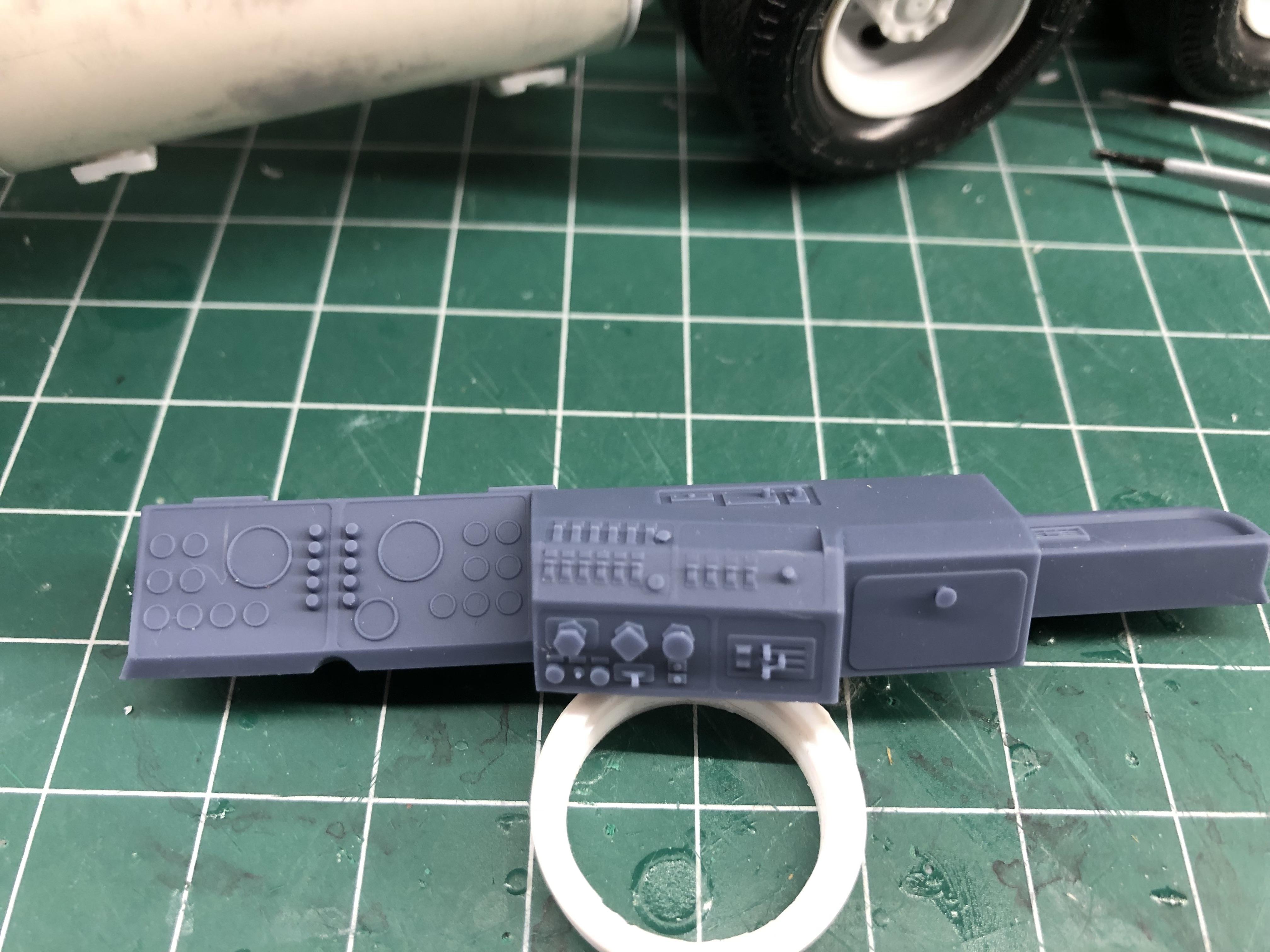

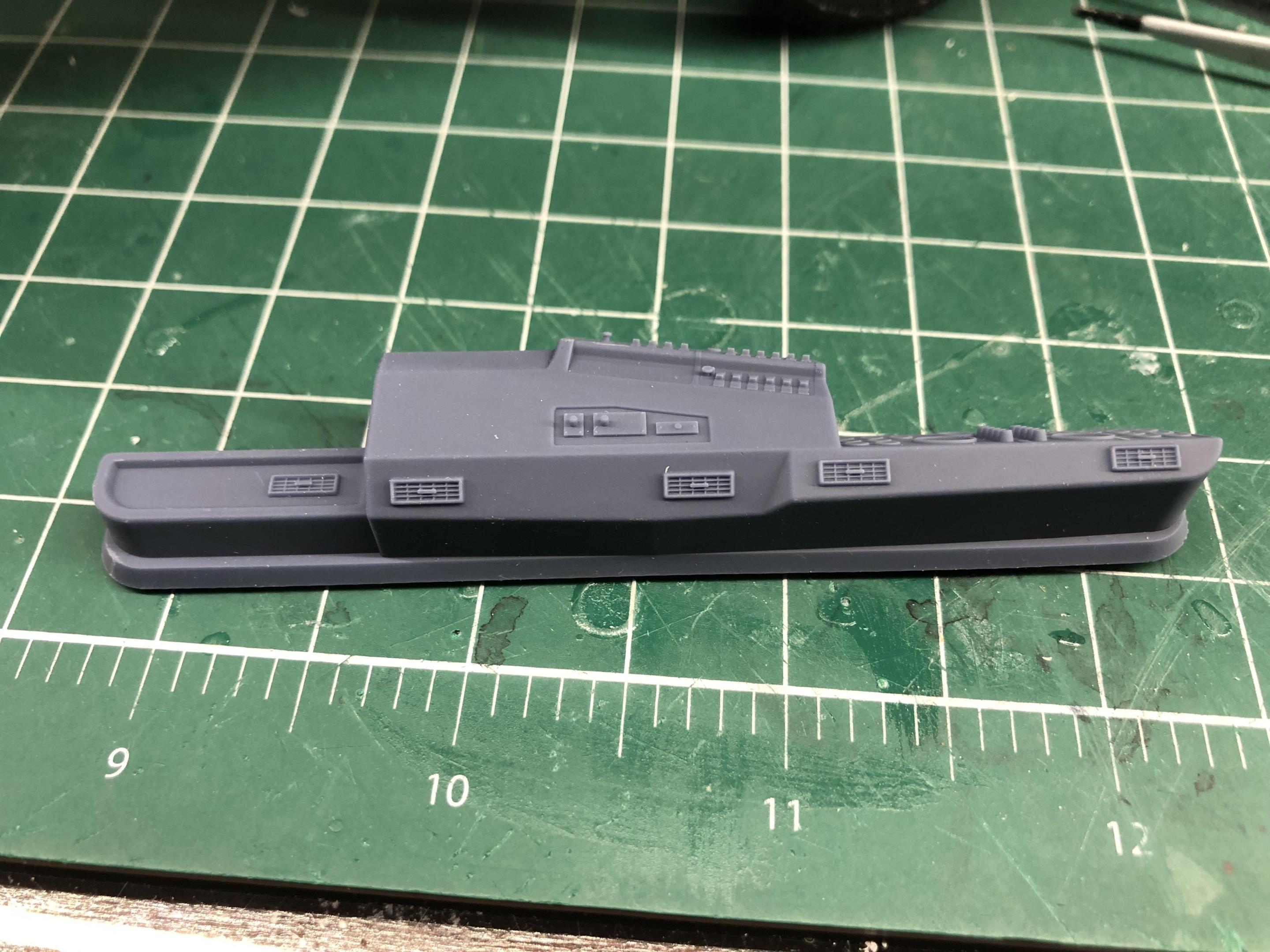

I order the K100 dash from Texas 3d Customs, it a Beauty . I made 2 air tanks and added some bolt detail that’s about it for now .
thanks for looking .
  • Like 7
Looking good so far ! Like those pvc tanks, so much cleaner than fighting w seams
The printed dash is really well done, didn't realize they offered one

Your welcome and that dash looks good thanks for sharing.  I was doing some research on my Mack R the other day and found this and thought about you so I saved it in case you haven’t seen it. This was the debut picture AMT/Matchbox used when they came out with the Kenworth Areodyne in 1980 they used a 86” sleeper pic.

The lip at the bottom is so it can be used on both the AMT and Revell kits, so it has to be trimmed to fit.
