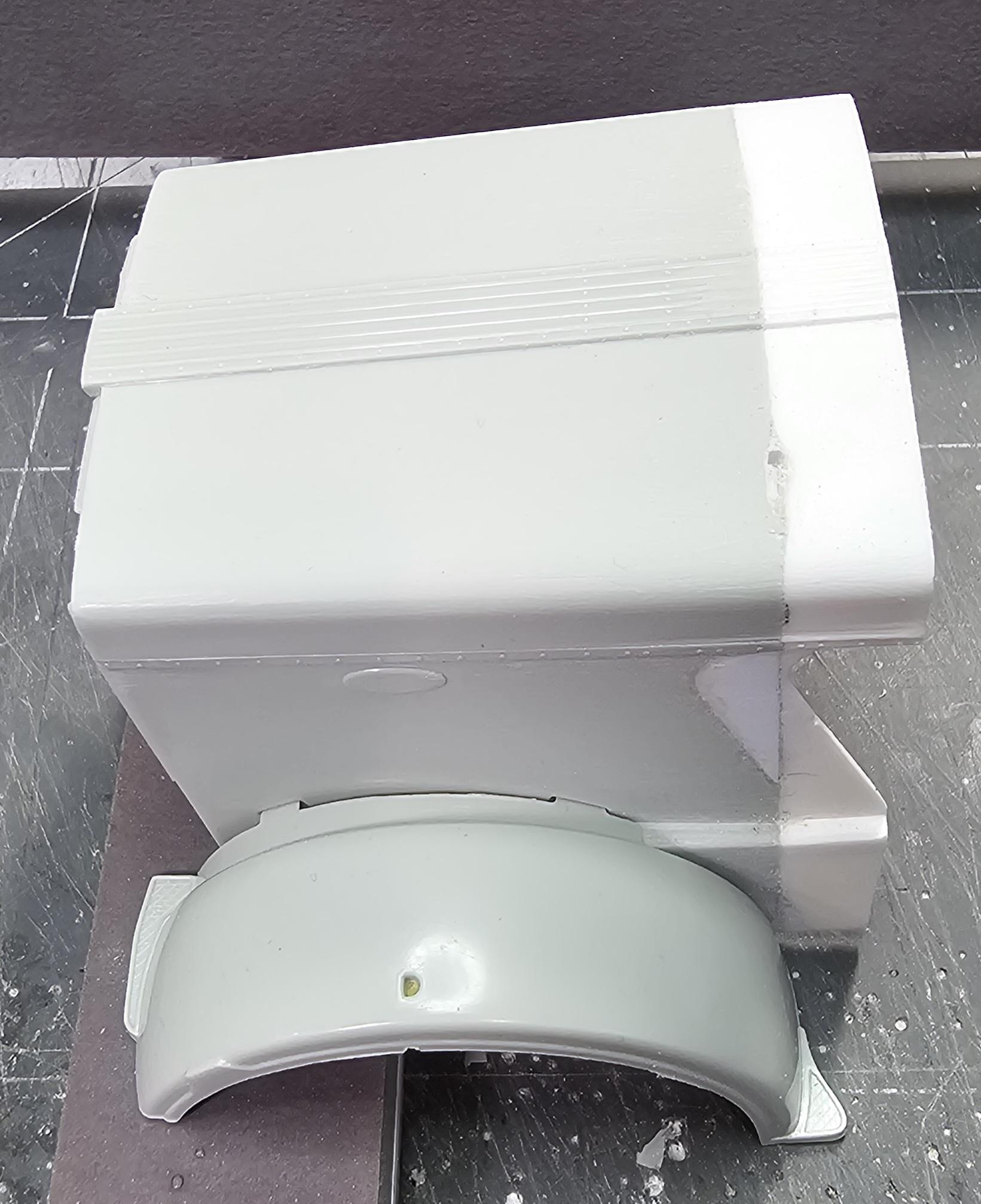

  Well, I  got a little more done on this build. I now have the hood just about ready for primer, I cut the front of the rails off of the "BS" frame. I'm using them to lengthen my frame rails 8" to work with the extended hood. Don't get in a panic I fixed the "BS" rails so I can use them on another build.

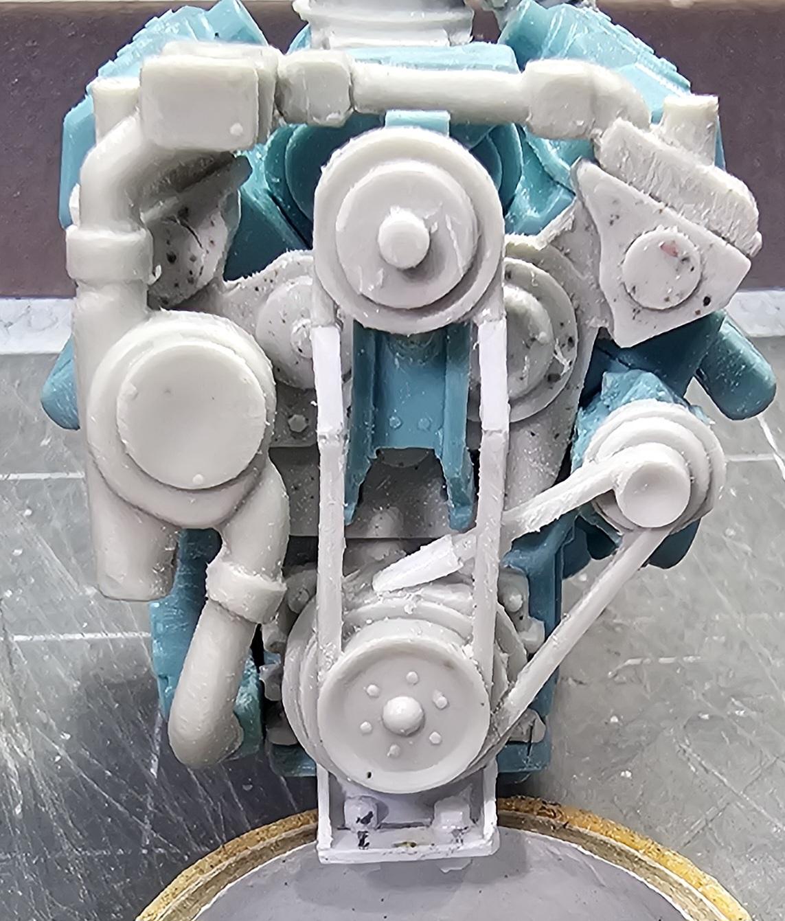

 I had to modify the DD 12V71N. I had to remove and refit the alternator and belt. I had to remove the fan pully and move it up about 2.5" and add peices to it. It now matches up to the fan in the radiator. So here are some pictures for yous all to look at.
20241227_162845.jpgThis view shows the holes in the hood filled in and sanded.

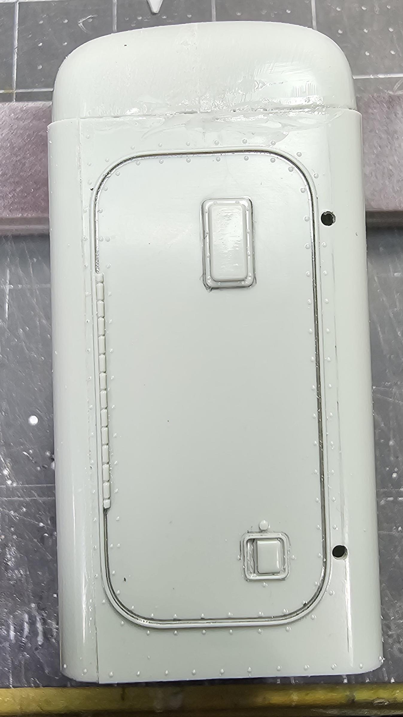

20241227_162759.jpgThe other side of the hood.

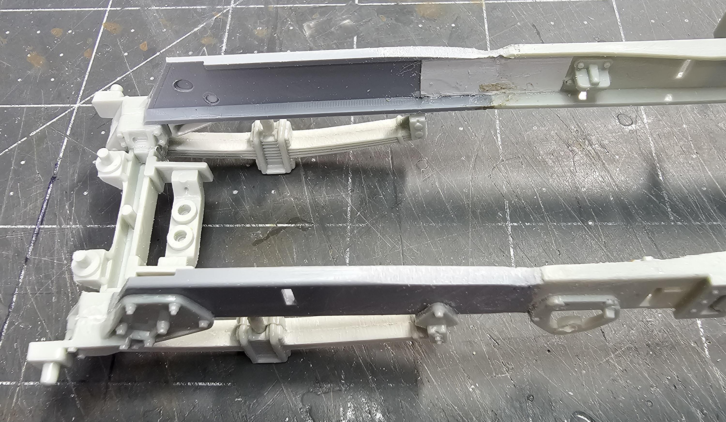

20241227_162414.jpgThis view shows the peices from the "BS" frame rails that I used to lengthen my frame by 8". I added a strengthening strip to the inside of the rails.

20241227_162520.jpgThis view shows the front engine mount and the peices I added to the fans belt.

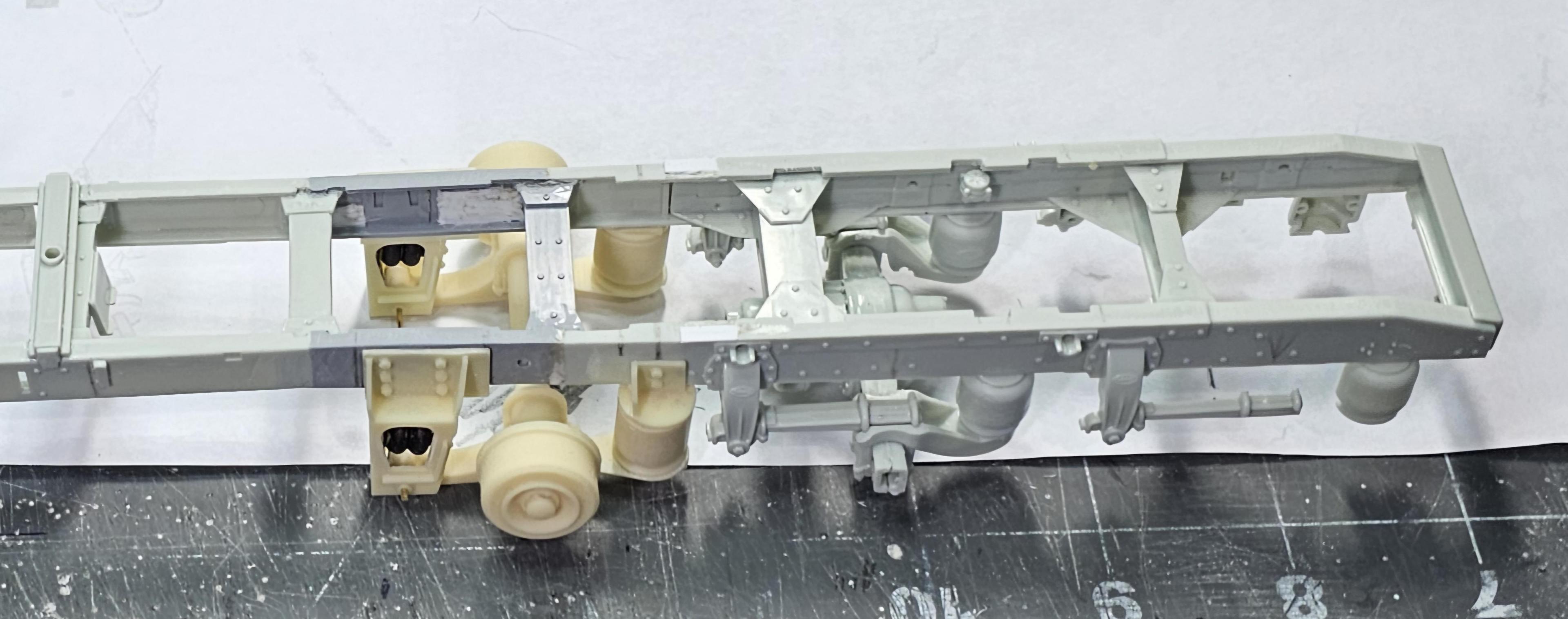

Okay, you guys are probably going to be mad at me. Yupp, I had to cut a section out of the spread axle frame. It was for a good cause, plus I did salvage the rear spread axle section. I needed it for my Heavy Haul frame for the "BS" Peterbilt frame.
20241229_152535.jpgThis view shows the rolling chassis temporarily together for pictures. You can see that there is now room for the Hendrickson lift axle and the steps.
20241229_152653.jpgAnother view of the chassis. I added a 3' (36") section to this frame from the spread axle frame.
20241229_153119.jpgThis view shows what the final layout will look like. That's a 3D Concepts headache rack. It's not the one I'm actually going to be using, but the good one isn't here yet.
20241229_153140(0).jpgAnother view of the set-up. You can see were I made a pull handle for the fifth wheel release out of some 0.016" wire.
20241229_154036.jpgThis view shows the 3' section and were I added it.
20241229_154046.jpgA better view of the 3' section. And the extra cross member from the kit.
20241229_154124.jpgThis view shows the two front air tanks fixed in place on the frame. I modified the kit parts by cutting off the end peices and gluing them to a peice of 5/16" x 1 1/16" long tube. This was the easiest fix to the void in the kit tanks. I rapped them with some 0.016" wire for the clamps. Well that's it for now I'll be back when I get a chance.

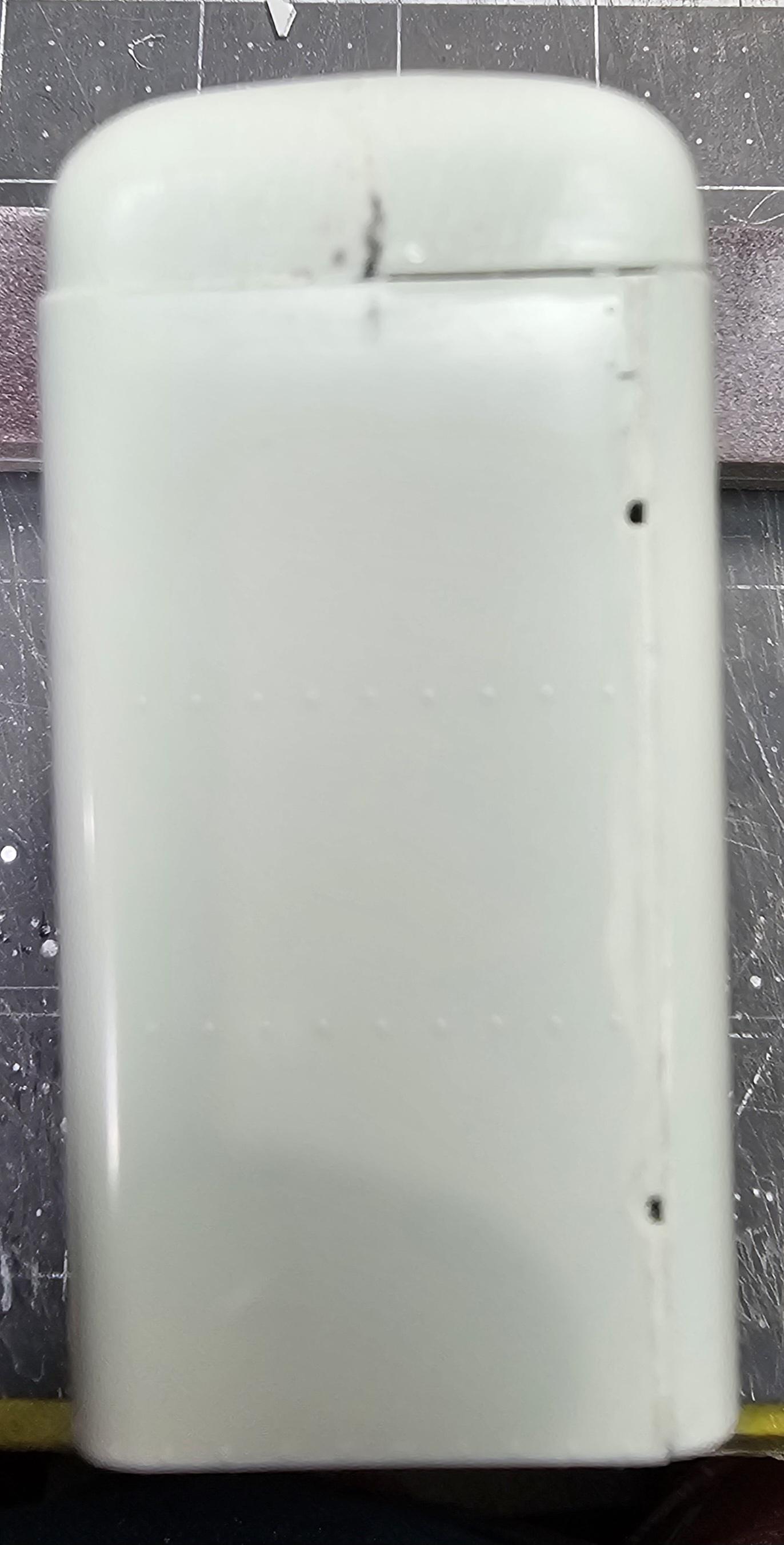

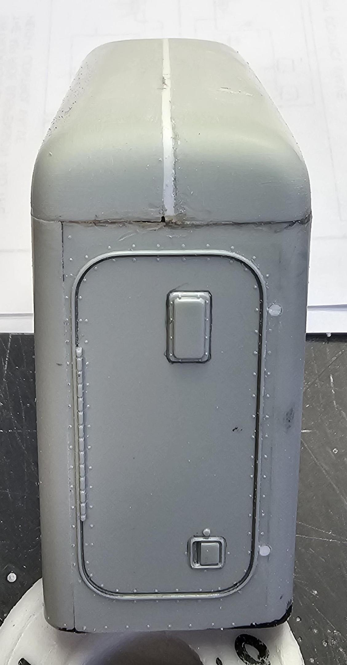

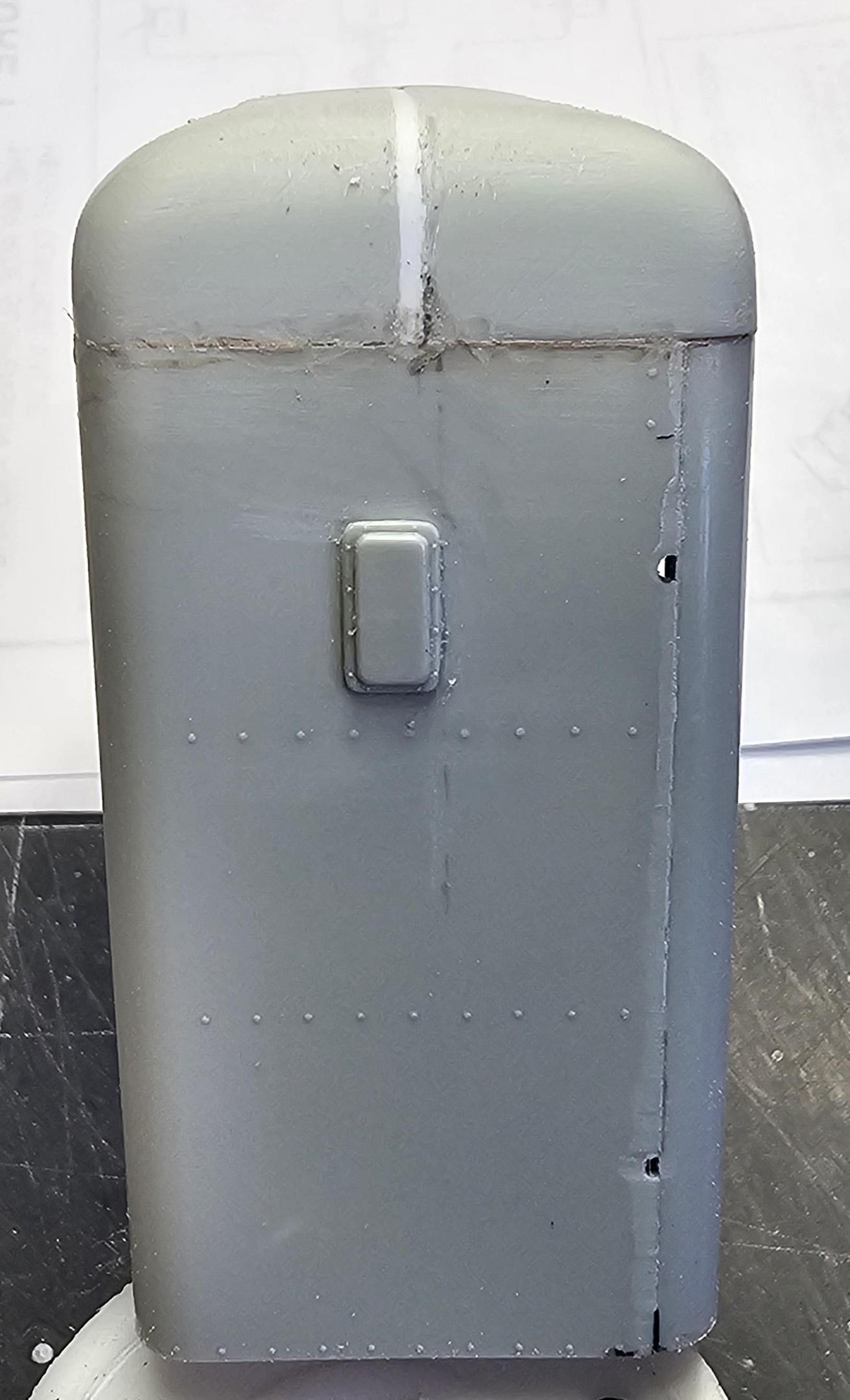

Okay, I have the sleeper cut down from a 60" to a 36" one.
20241229_182003.jpgThis view shows the 36" sleeper sitting in place on the frame.
20241229_182217.jpgFront of sleeper.
20241229_182322.jpgRear of sleeper.
20241229_182328.jpgDrivers side of sleeper.
20241229_182333.jpgPassenger side of sleeper.
20241229_182350.jpgBottom of the sleeper. That's it for now be back soon with more.

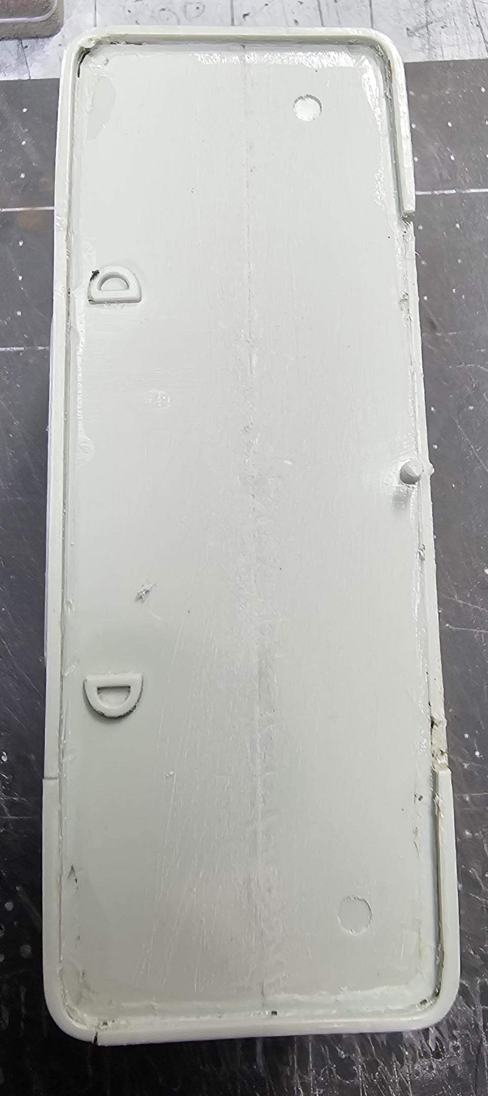

Hey all

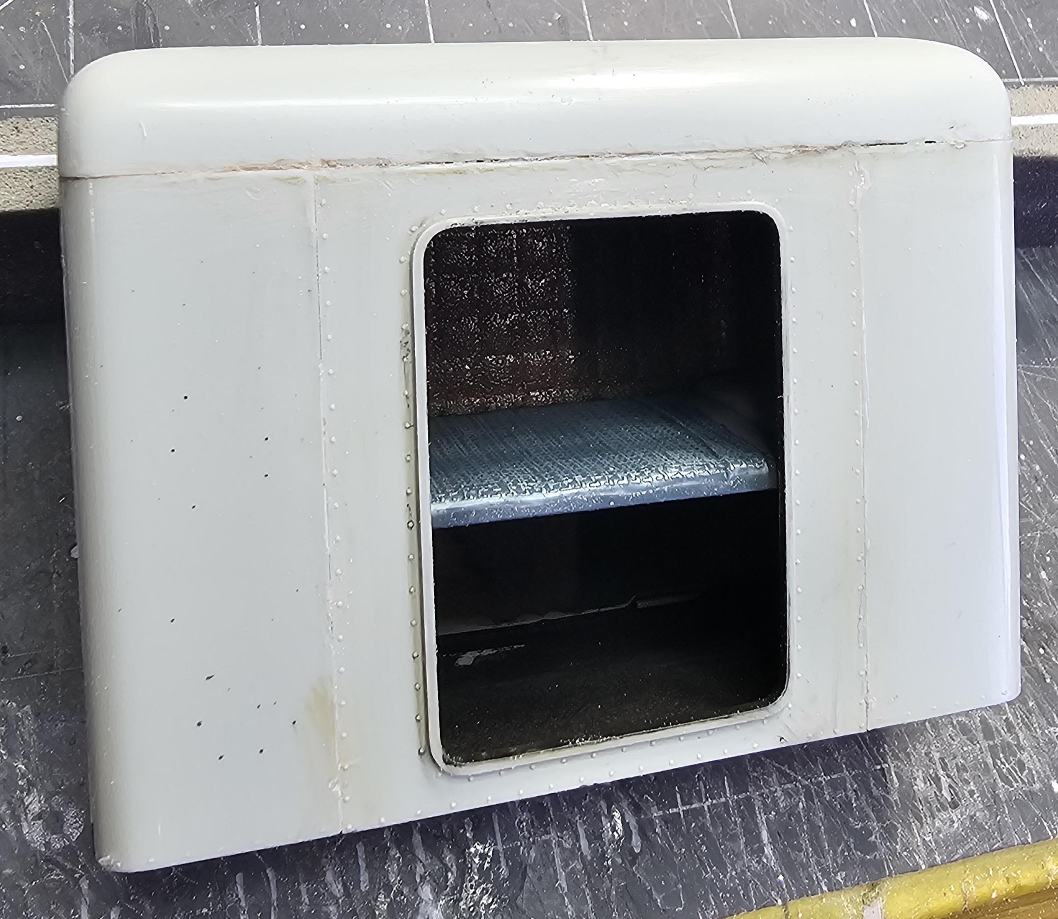

 I removed the roof of the sleeper to fix the fit. I also got the lift axle mounted. And I fixed the air intakes on the 12V71N and add a fuel pump to the front blower cover.
20241230_134735.jpgThis view shows that I added some paint to the inside of the sleeper. I also added the bed.
20241230_140721.jpgI didn't go crazy with the paint because you won't be able to see much when it's done.
20241230_141139.jpgThis view shows that the roof fits much better now that I added a peice of 0.04" plastic strip to the gap.
20241230_141209.jpgI also added another vent to the passenger side of the sleeper. I think I'm going to have to get some Archer rivets so I can finish this.
20241230_170520.jpgThis view shows the Hendrickson lift axle mounted. I can still disassemble it for painting.
20241230_170822.jpgThis view shows the the new modified air intake. Also the fuel pump just in front on the front blower. Well that's it for now be back soon.
