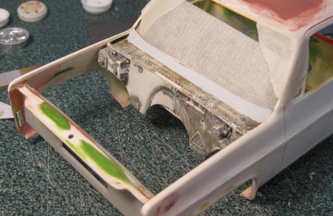

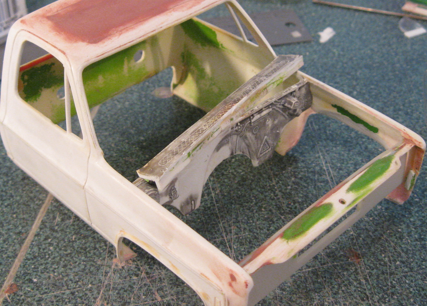

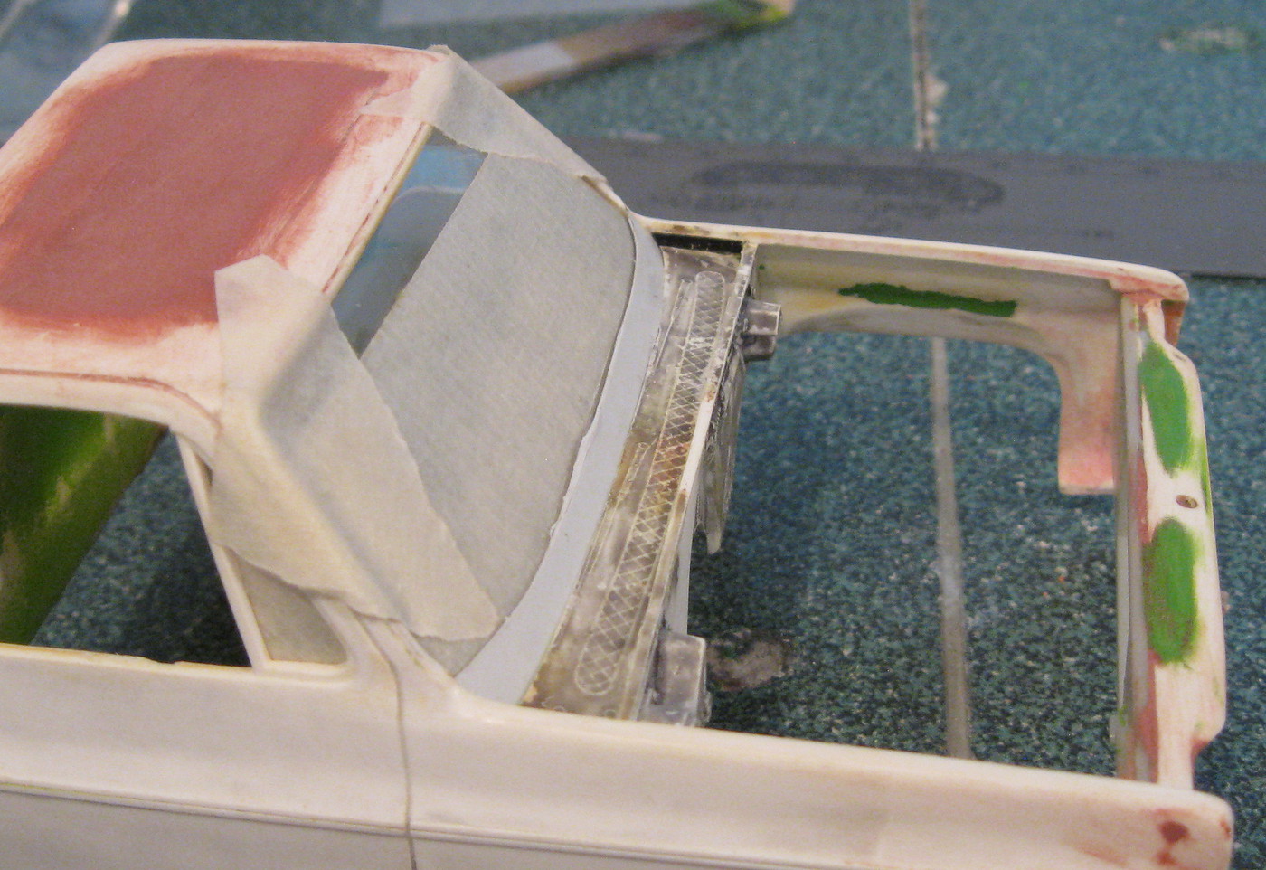

I'll be wanting to add photoetch wipers but there's not enough room between the hood and cowl as molded, so I'm dropping the cowl a little for room.
First glued the firewall onto the cowl solidly just at the top edge. and cut the section out behind it flush with the back of the firewall.
Then simply glued it back in slightly lower to make room for the wipers and added a thin strip across the bottom for the sheetmetal at the bottom of the glass on the real trucks.
Not 100% correct to the 1/1 trucks but this truck isn't exactly "factory stock" anyway.
I'm gonna let it sit for a while and trim the sheet off following the back edge of the hood before priming.

Well Carl, lets see , , ,
Dropping the cowl itself wouldn't affect the hood fit. The issue will be when I add the photoetch wipers. If I don't do this the wipers may hold the hood up when it's done.

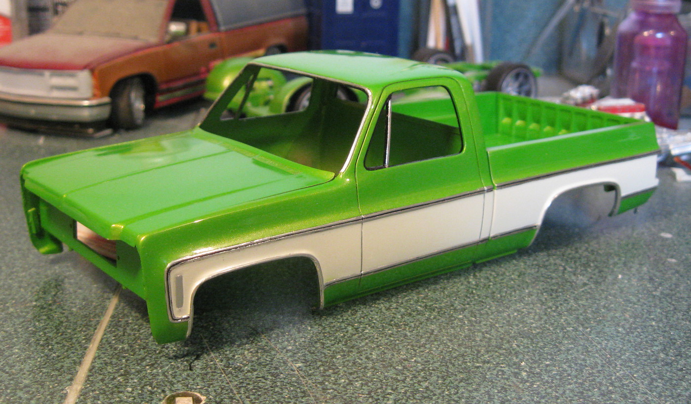

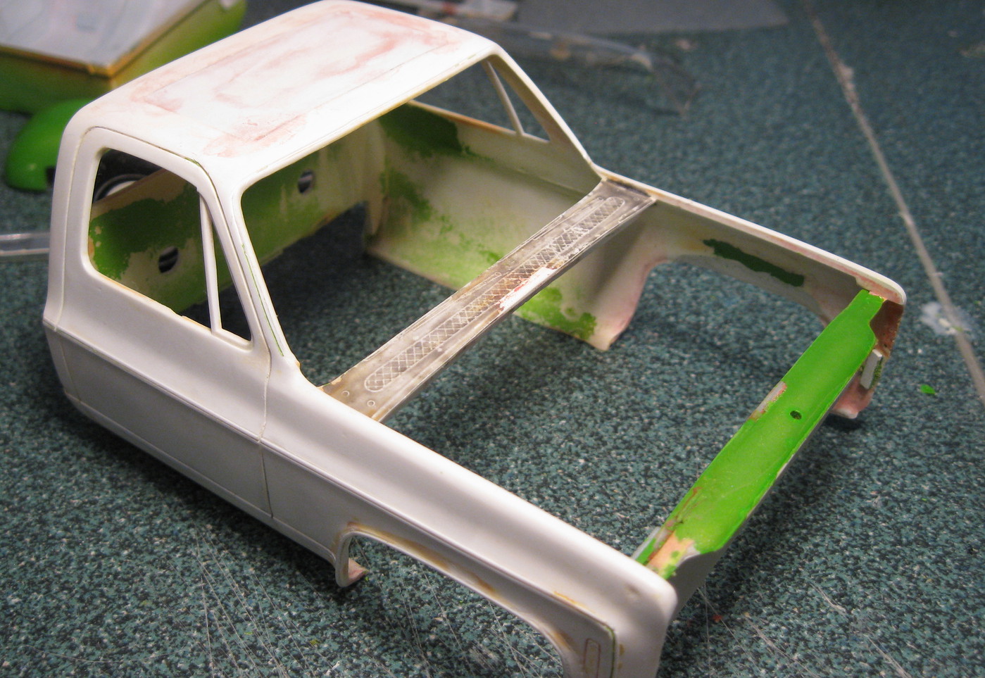

I didn't have enough paint from my original batch to do the repaint so I had to mix up some more.
The inner fenders are the original paint, the rest is the new batch. I think it's a pretty good match.
I paid more attention to my prep work this time and added a couple details I didn't do the first time.

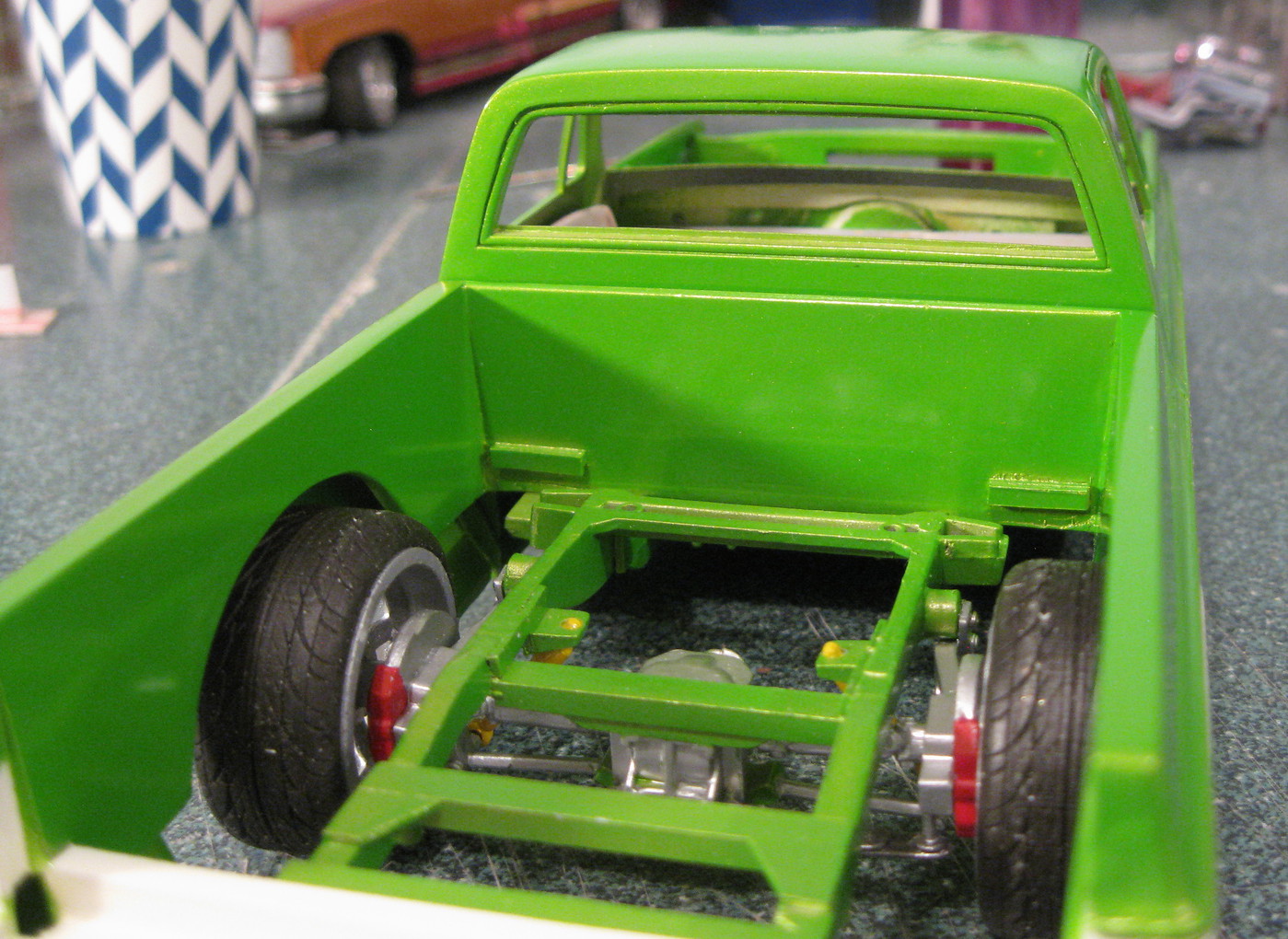

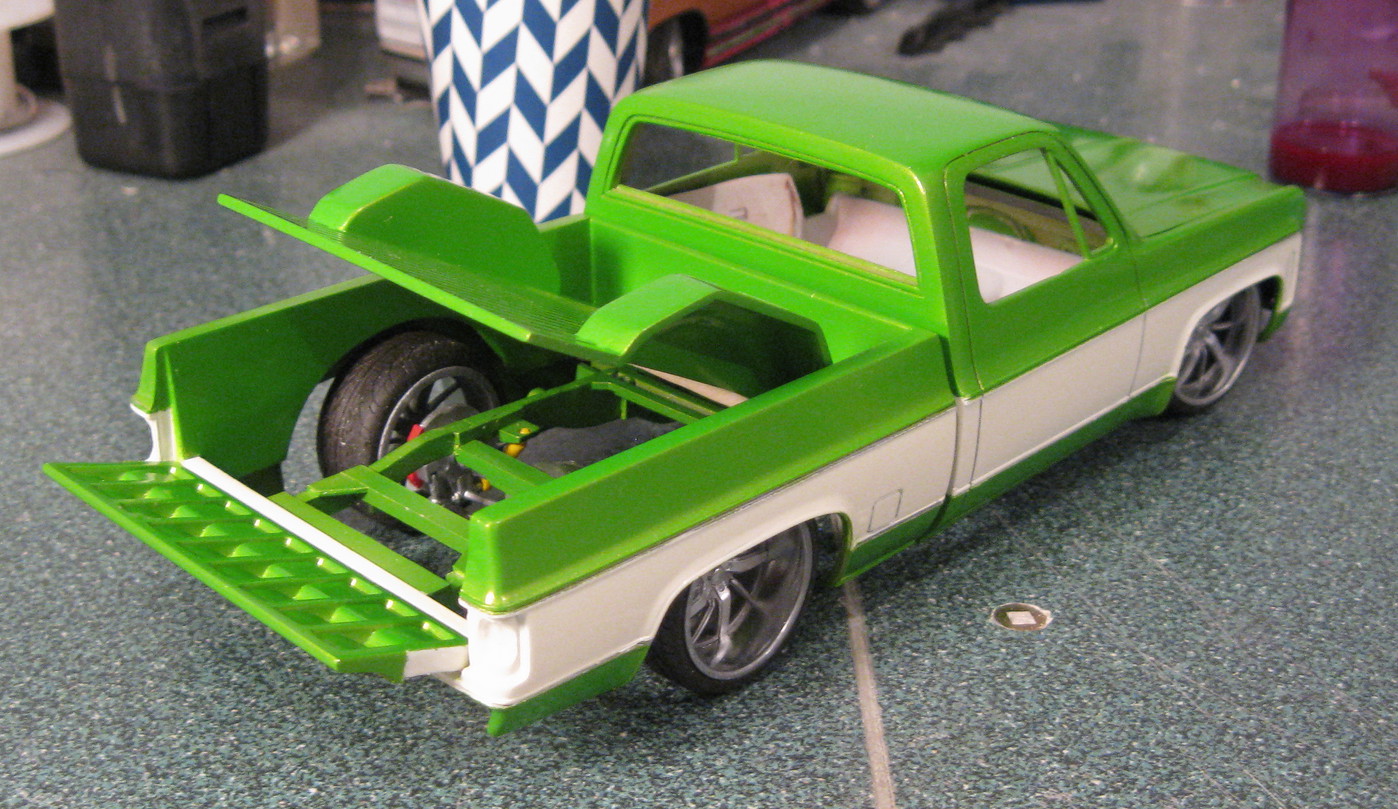

In addition to the sunken cowl for the windshield wipers I added a lip inside the rear window opening so I can cut the glass down and mount it from the outside and will have the floor of the box separate so I can display it open to show the rear suspension etc. Going to make a couple struts from aluminum tubing to hold it up when open.

Great work Steve, the separate floor for the box is a great idea to show off the suspension details, it's the kind of thing you see at modified car shows like the SEMA show!

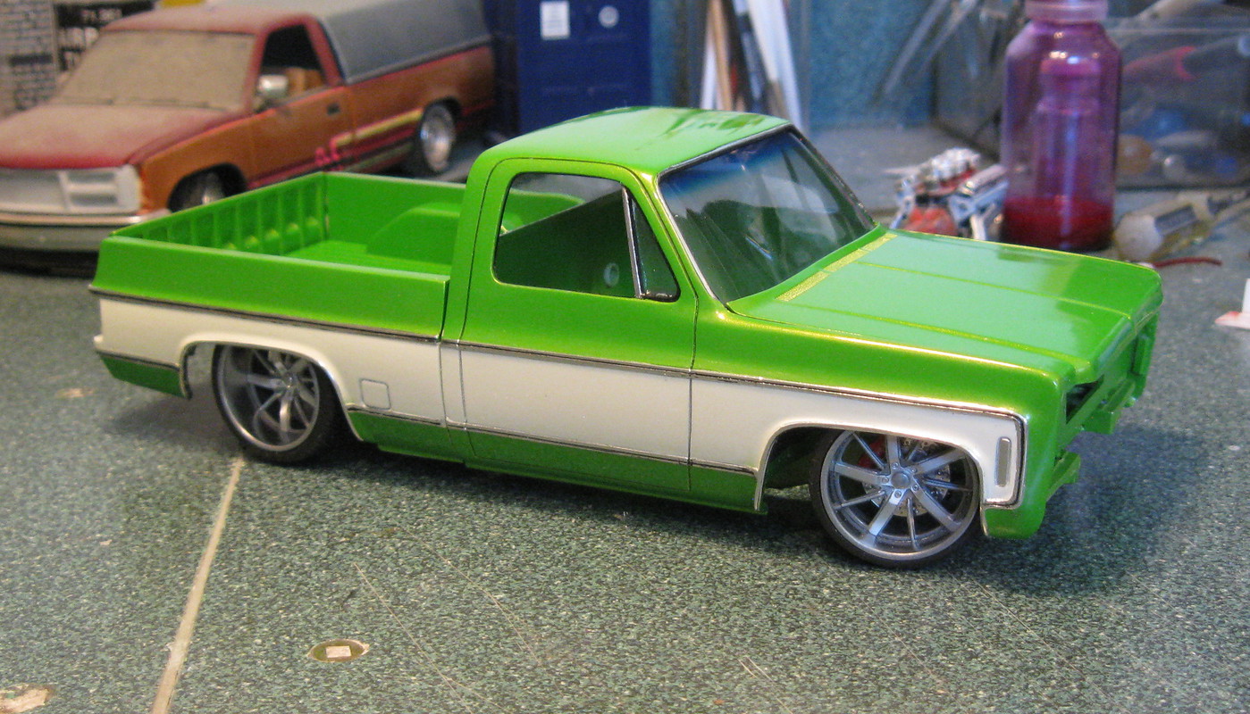

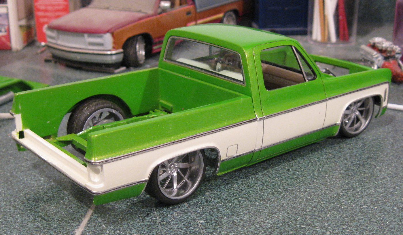

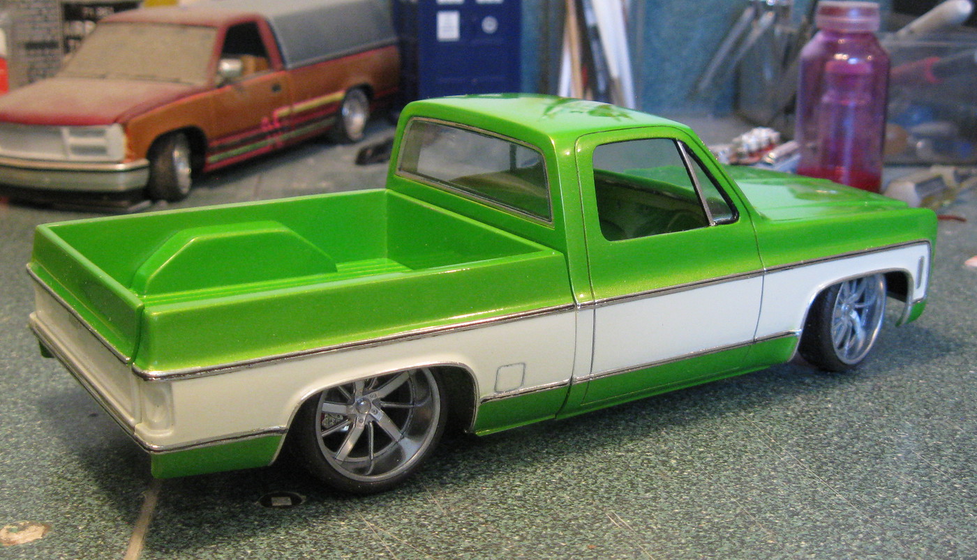

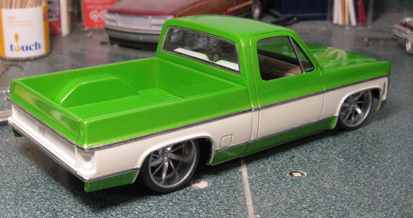

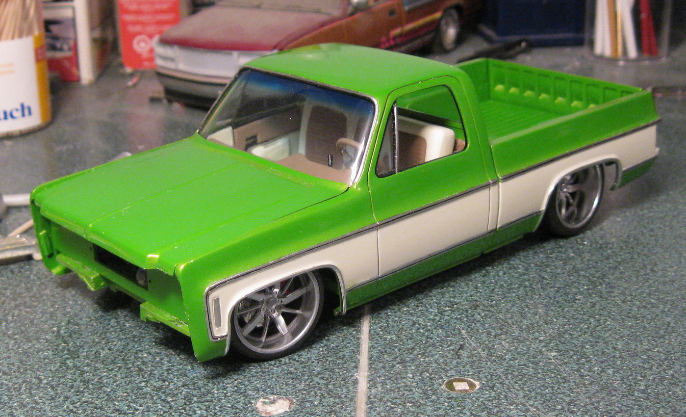

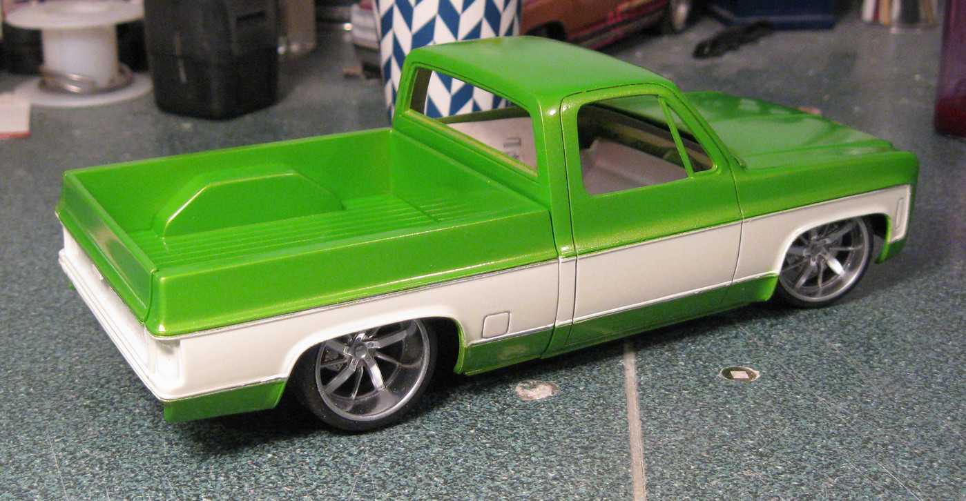

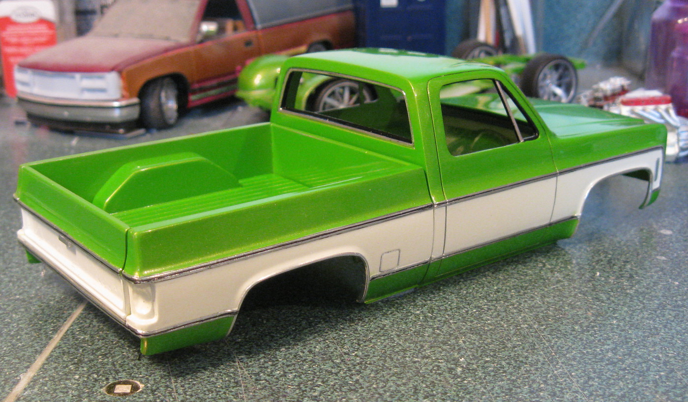

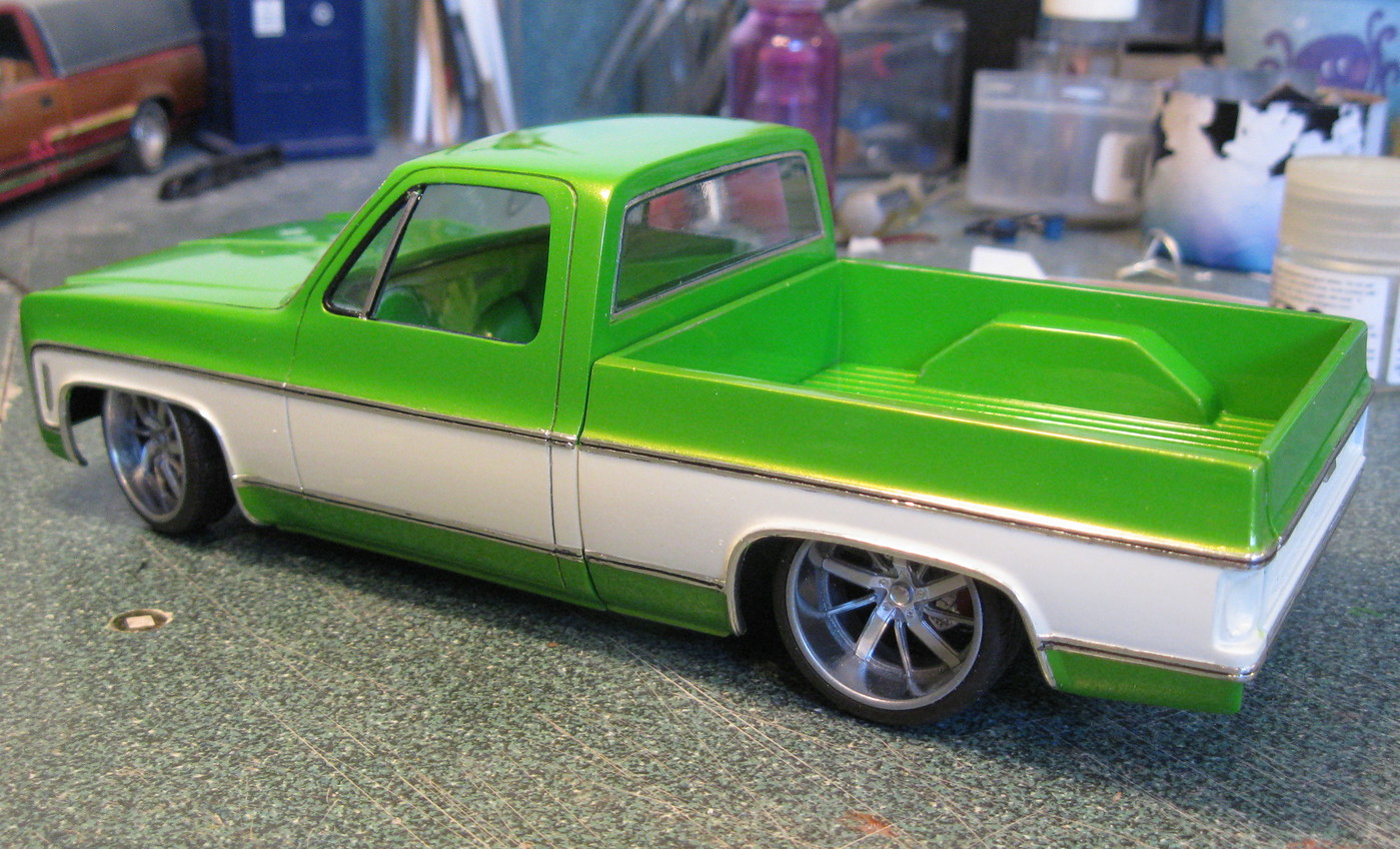

The paint and trim is now finished. Looks like the black on the side trim will need a bit more cleanup but you can't really see it in person.
Tomorrow I plan to install the glass and the engine in the chassis, maybe start on the interior if I get really ambitious.😉

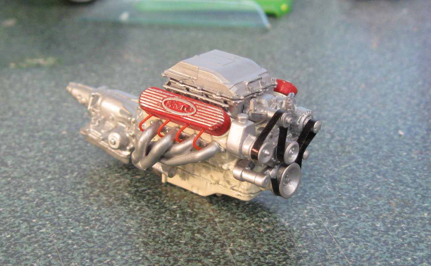

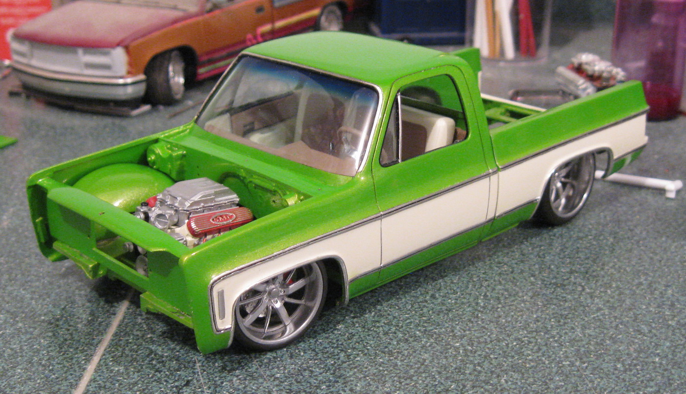

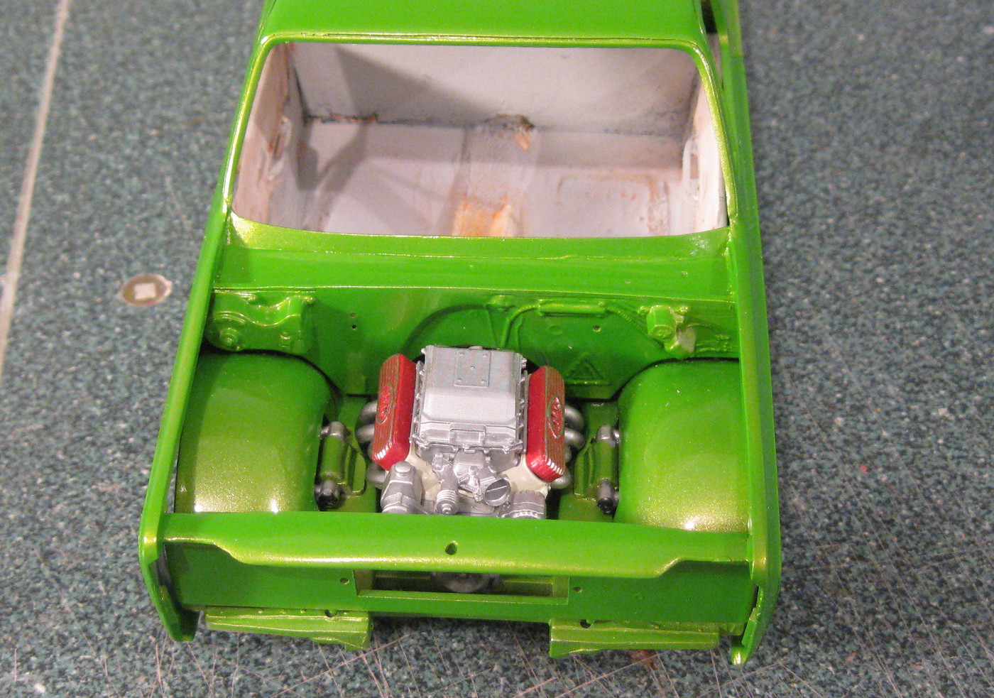

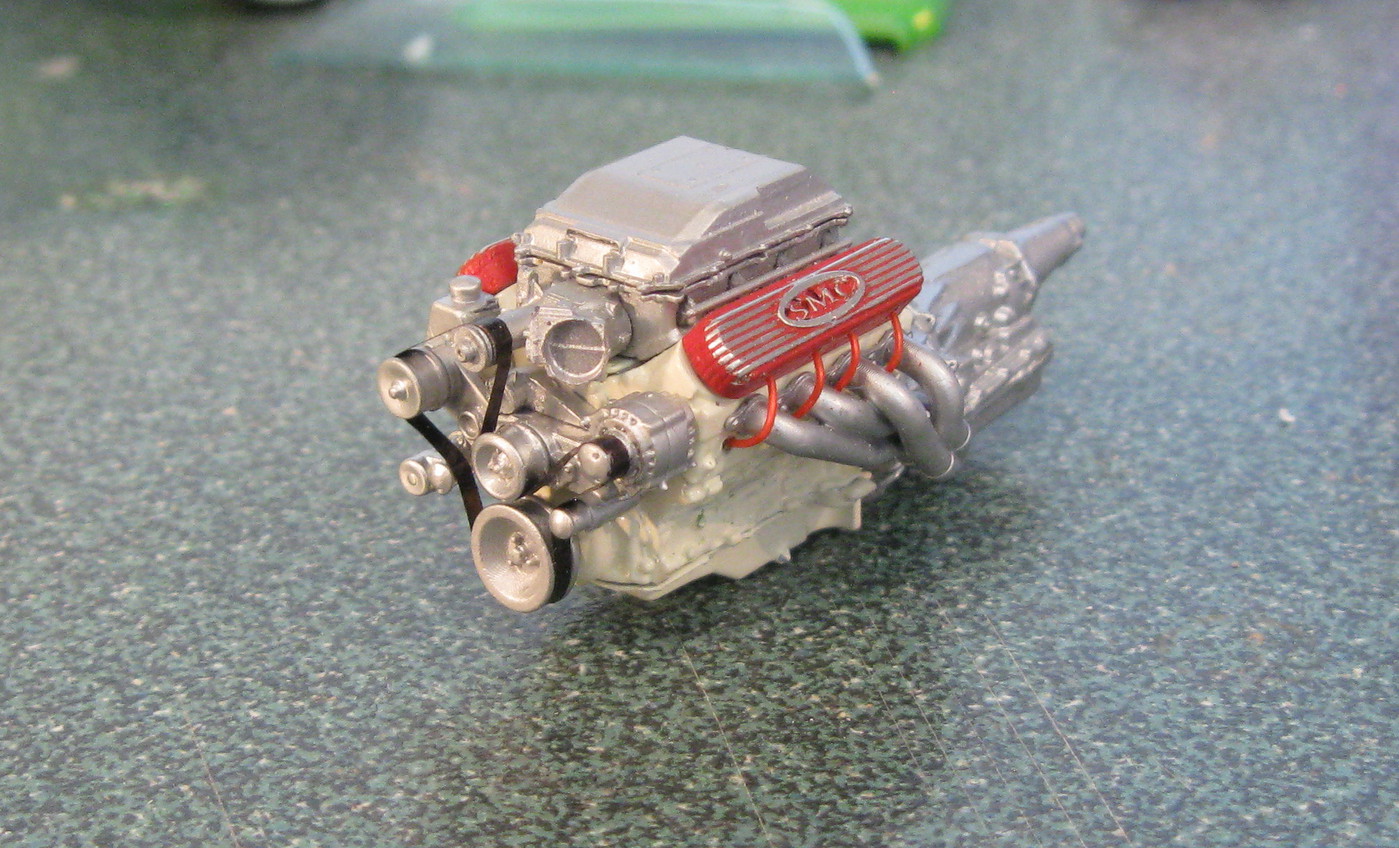

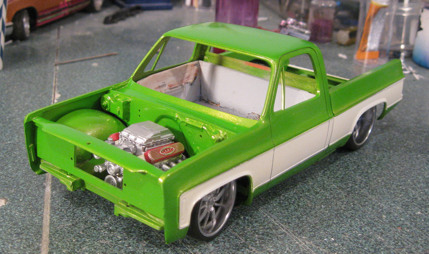

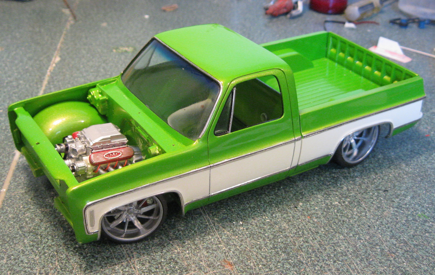

Have to do a little detail paint on it but the LSA engine is finished. Easiest engine to do the plug wires I've ever done.
IMG 4386
IMG 4385

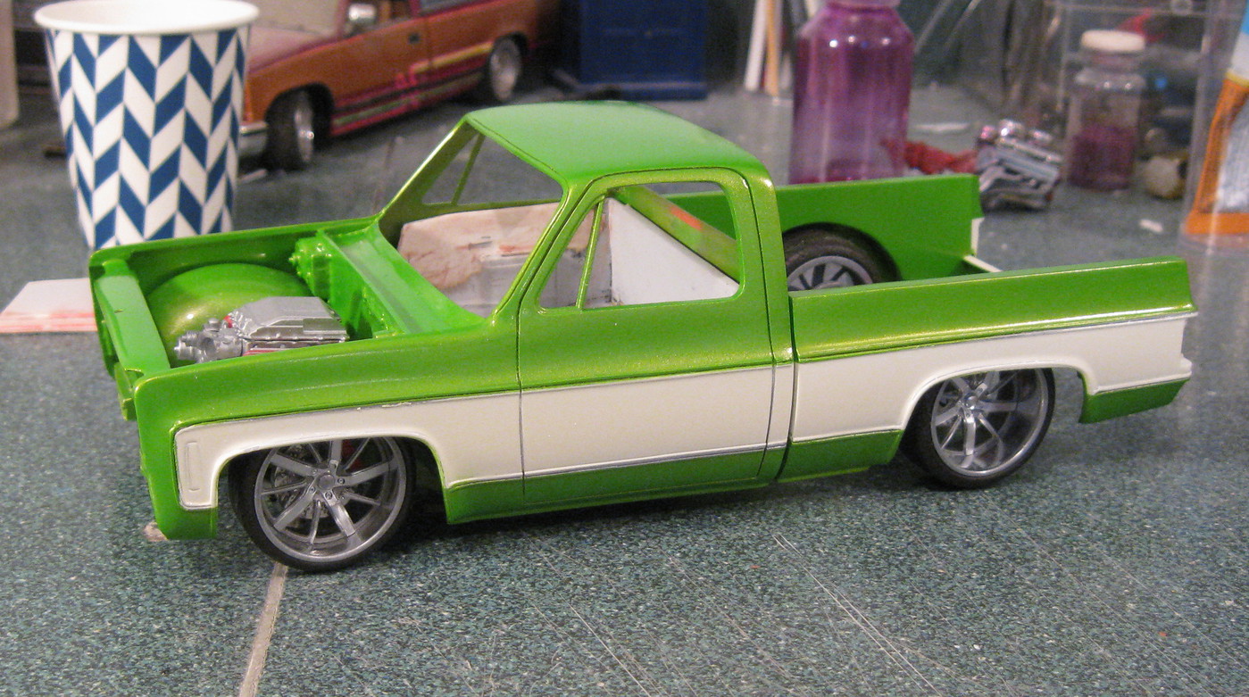

Looks pretty good down in it's new home.
IMG 4387

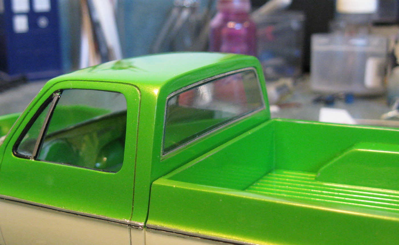

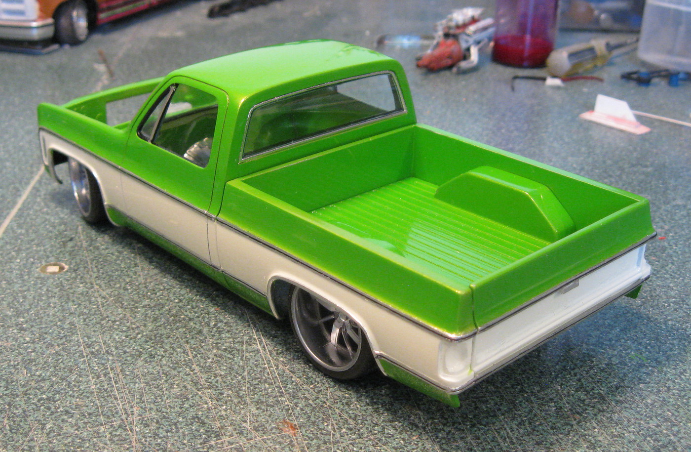

I carefully ground down the rear window with Dremel and a file and mounted it flush in the opening.
IMG 4389
 , , and a couple mockup pics.

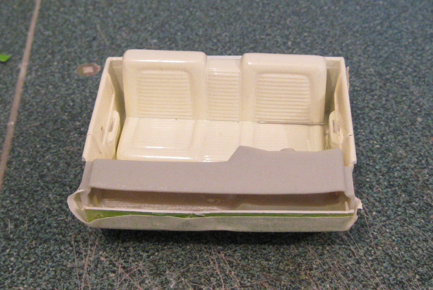

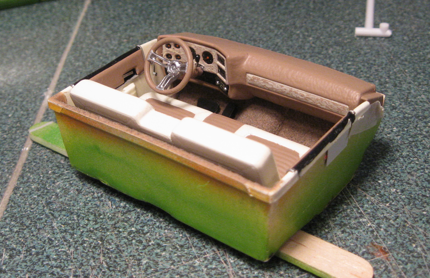

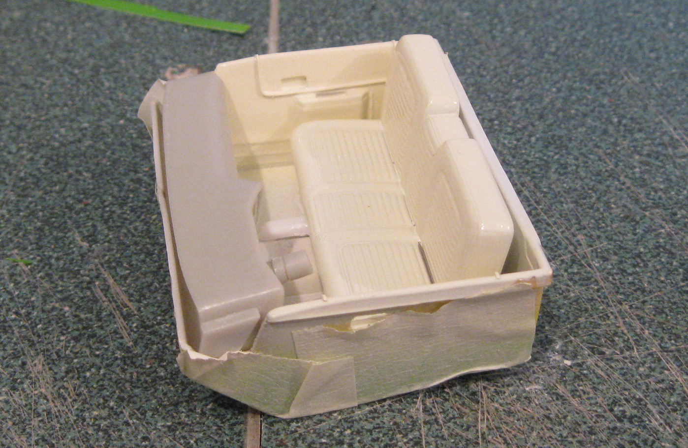

Been working on the interior.
Re-shaped the upper door panels. Some inserts going in the spaces at the top.
Seat's from the AMT '57 Chrysler. I thought it makes a pretty good looking custom seat for this truck.
Some green patterned decals I made up will go on the seat and door panel inserts.
Made a tilt steering column from scratch and will be adding factory style tilt and signal light stalks and a shift lever.
Paint is the same Tamiya racing white I used for the side panels on the body and it'll all be dull coated when done.

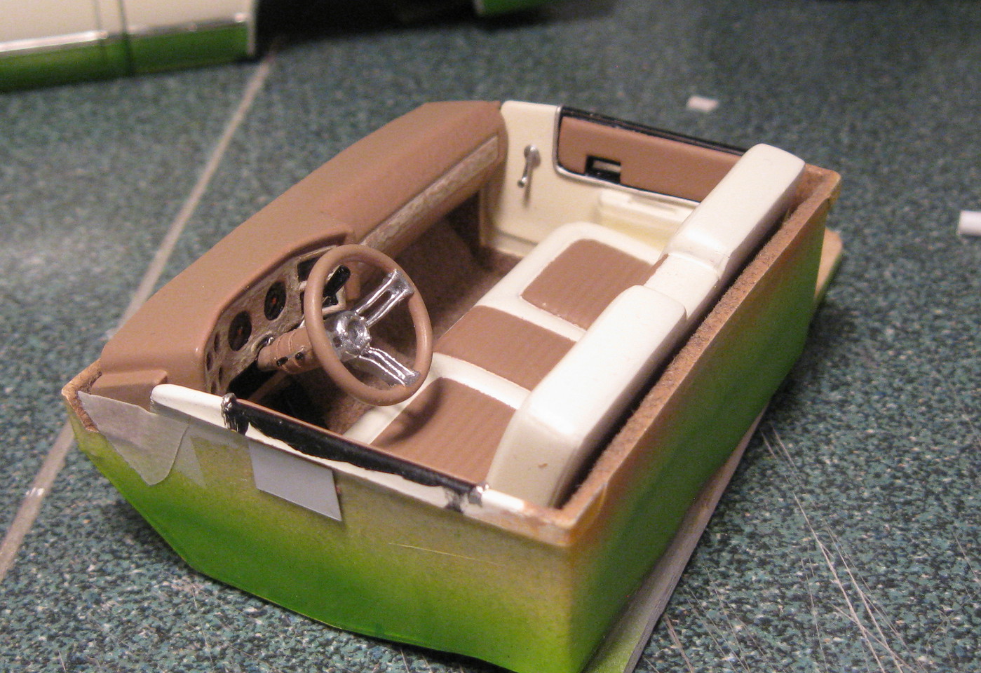

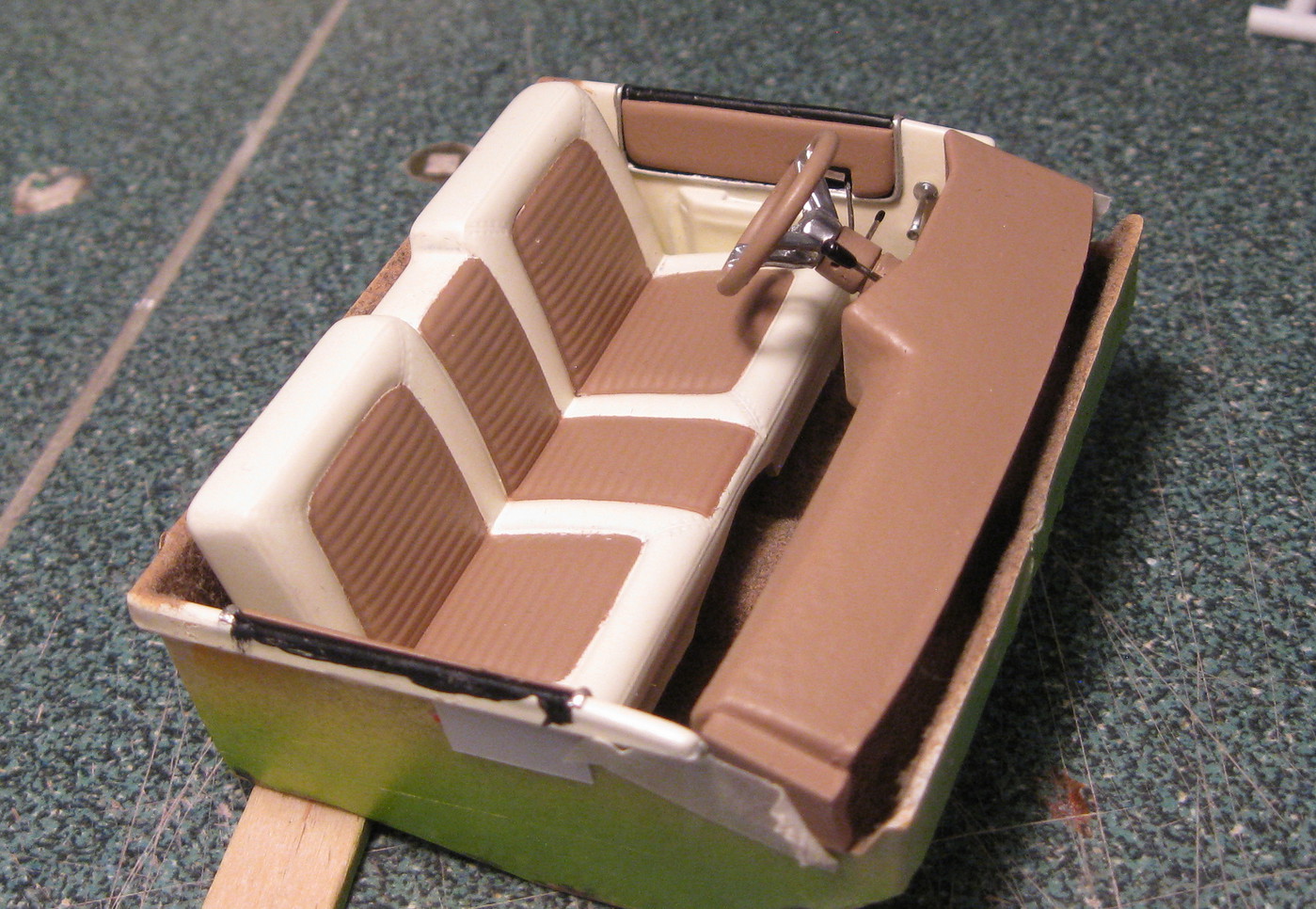

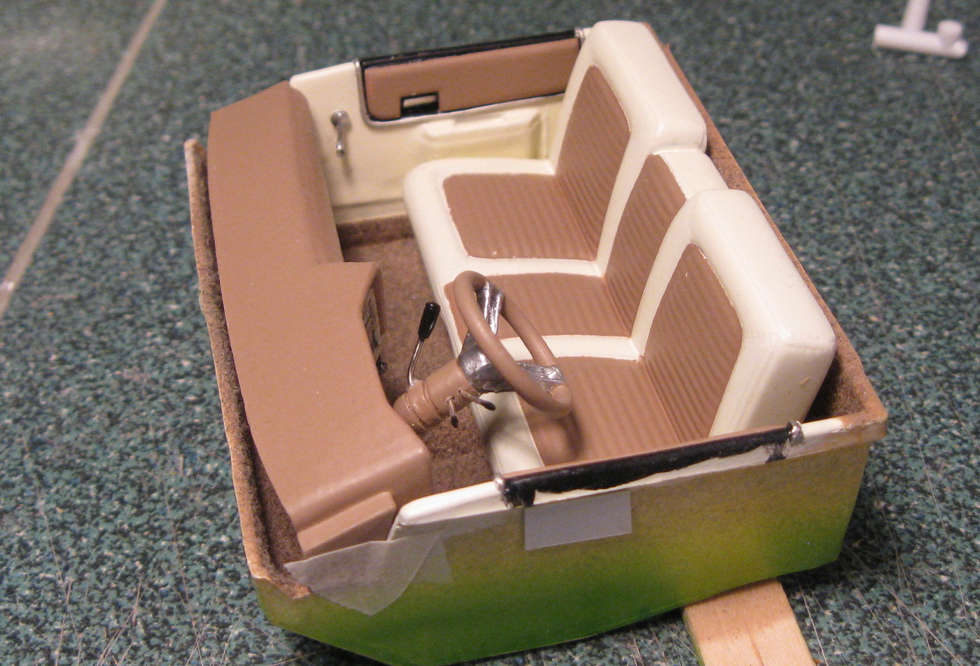

Got the interior finished
Modified the door panels and added printed window cranks. Probably should have picked a smaller set but I may pick them off and replace them with power window switches before it's done.
Seat is from the AMT '57 Chrysler. It's the right size and looks like a common style custom seat for pickups. Made brake and gas pedals from sheet stock and made a steering column with shifter, tilt and signal stalks from scratch and added a printed steering wheel.
I had originally planned to go with a green pattern decals for the seat and door panel inserts but I guess my decal paper is too old and broke apart when I tried to apply them so I went with the light brown. Again common with current pickup builds from the show coverage I've been watching on YouTube
  • Like 4
Beautiful work. Kinda makes me hungry - apple, cream and chocolate! I like your carpet. Is it a blend of different coloured flock/embossing powders?
  • Like 1
Yes, I mixed some tan and chocolate brown flock to about the shade of the brown accents.
