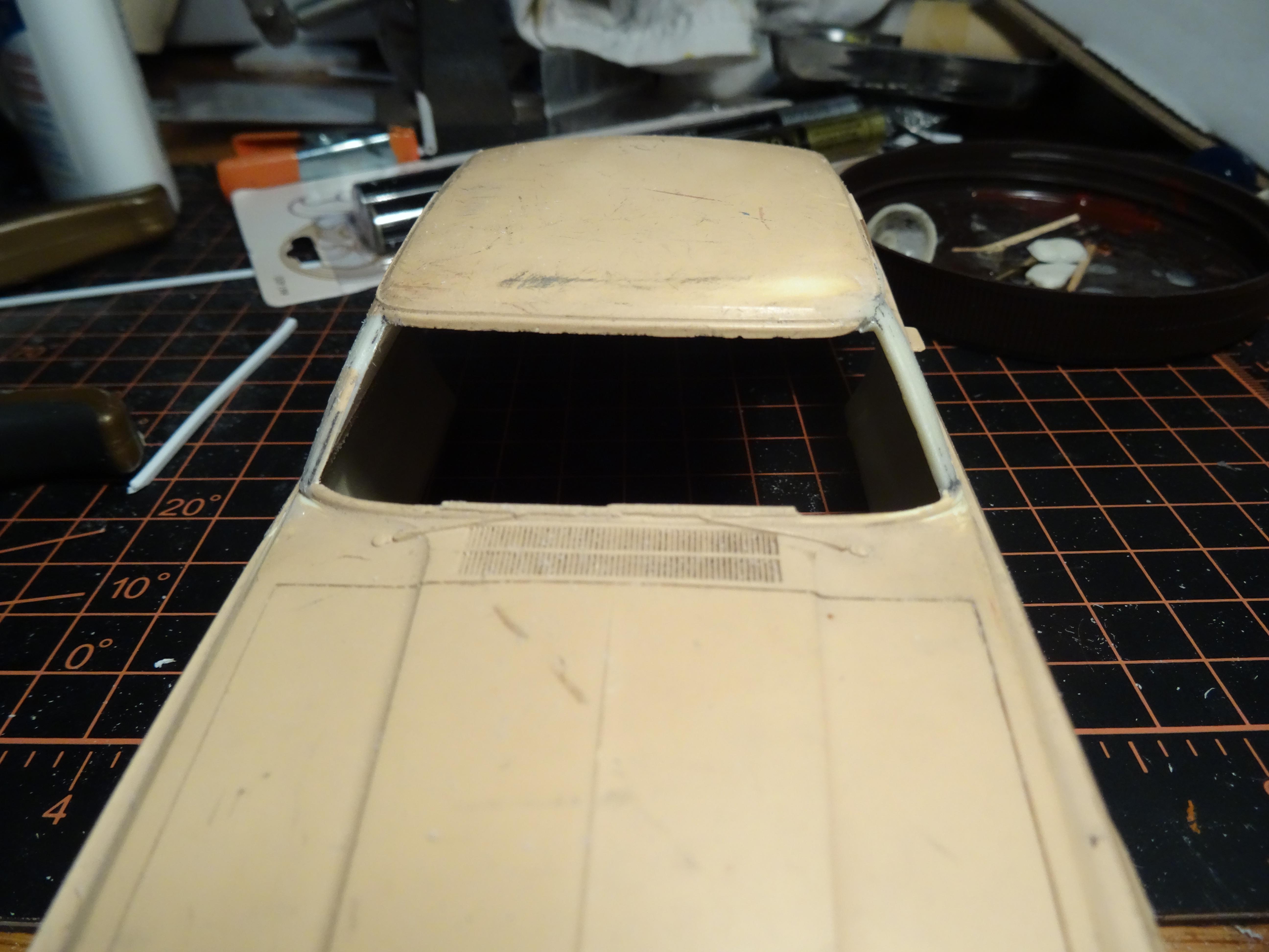

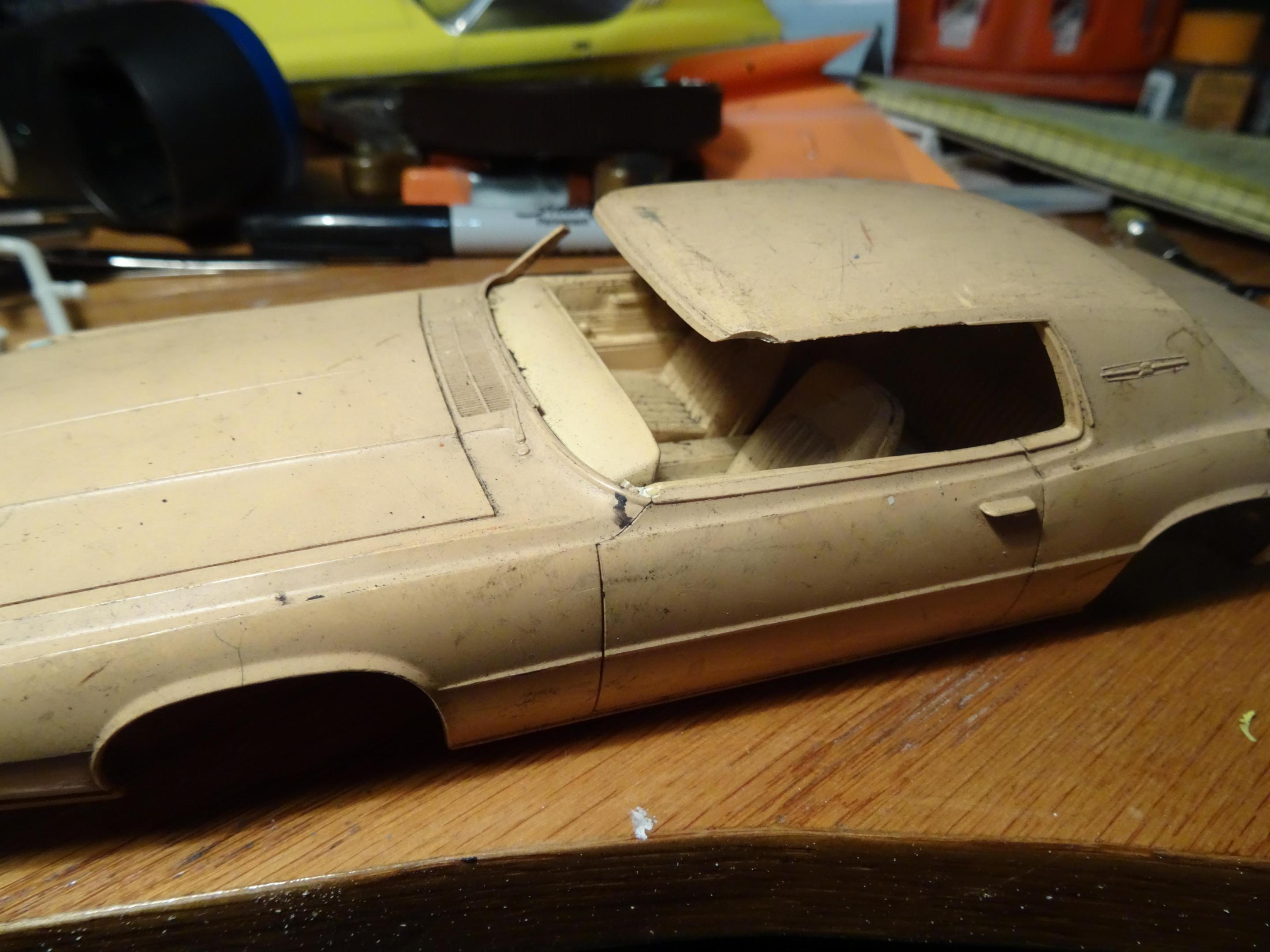

Anyone have any tricks for repairing A pillars. Have this old T-Bird I want to bring back to life. Have some ideas of my own but wondering if anyone has a good "solid' way of repairing this.DSC01362.thumb.JPG.49a3685928eb4416ea668d3761eadf00.JPG
Len,
I recently repaired a 67 T-Bird with a broken A-Pillar. I did what I think most people do - which is to use various sizes and thicknesses of plastic strips to rebuild the pillar and roofline. I used a wider strip for the back of the pillars, and then used thin narrow strips to build out the exposed portion of them. Some body putty and some very gentle sanding were also used to fill in any small gaps that still existed
Hopefully these photos will give you some idea of how I did it.
I think it was a pretty "solid" repair. The window glass behind the pillars also helps to provide support.
Good luck with your T-Bird. It has more damage than I started with, but you should be able to rescue it!
Bart

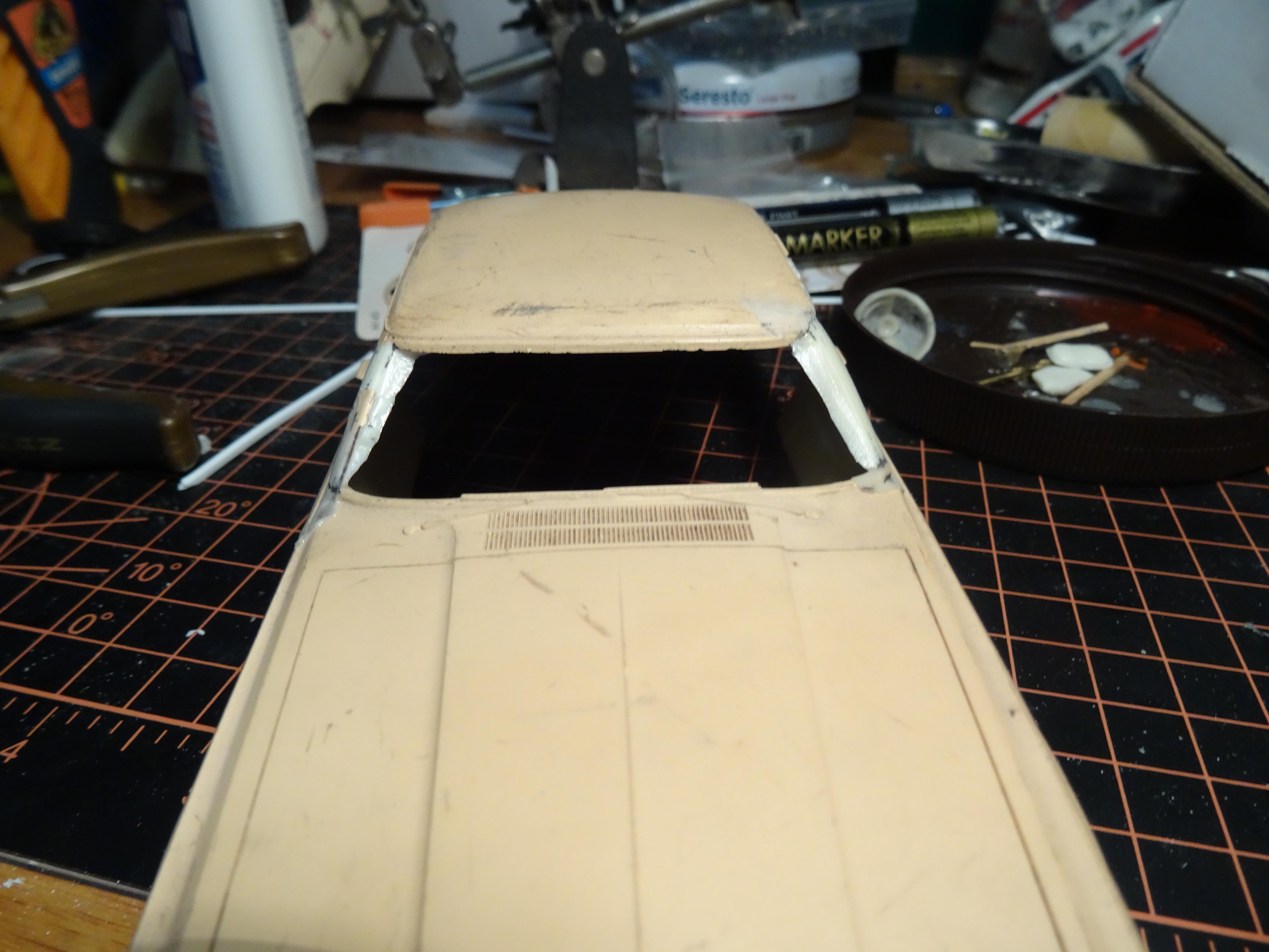

Almost there - still had a little bit of sanding and body putty to be done.
The finished restoration

Thanks guys, this is kinda what I've been thinking. Thought about reinforcing it with a wire embedded from behind like you mentioned also.

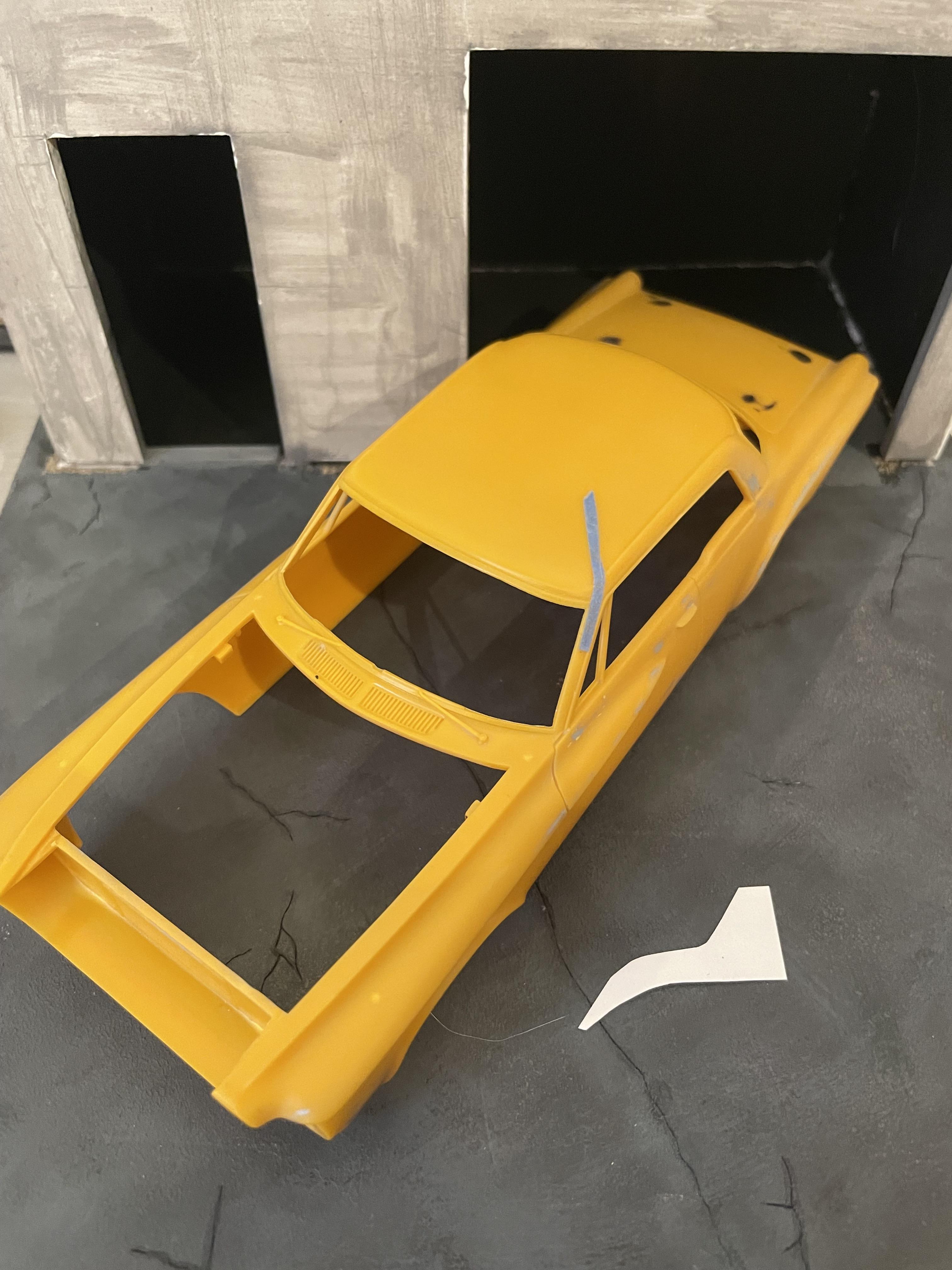

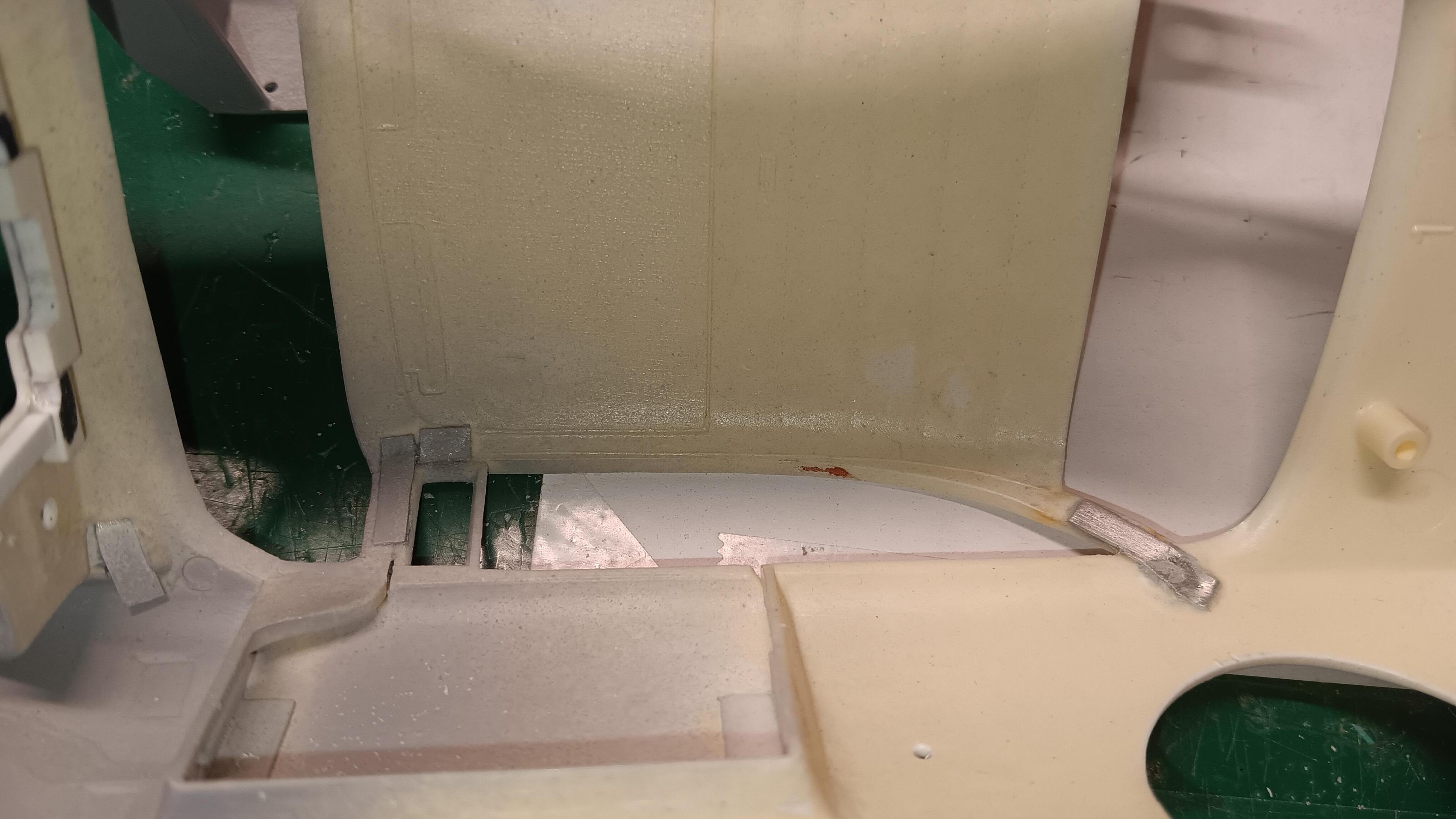

I have repaired a broken A-pillar in the upper corner once, if it wasn't a Jo-han Oldsmobile kit I wouldn't have done it, phew what a lot of work !
I sawed a 1/16 groove into the roof actually and glued a piece of flat styrene that was quite hard(plasticard was too soft).
When the glue dried I filed to the shape including the edge of the windshield because the roof post was a little thicker.
I took a picture just now to show the angle of how I sawed (blue tape), the styrene piece was very well machined at the end that was glued to the post while the other end stuck up so I could hold it with a piang, the paper piece has about the same shape. I then glued with Tenax (much like Tamiya's glue) and filled (sculpted) with Milliput. Was it good or perfect ?
It was ok but a vinylroof Mary have hidden some…
Give the glue long time to set.IMG_0264.thumb.jpeg.58a4e2efaf5e2af3833c81a712bca5ee.jpeg

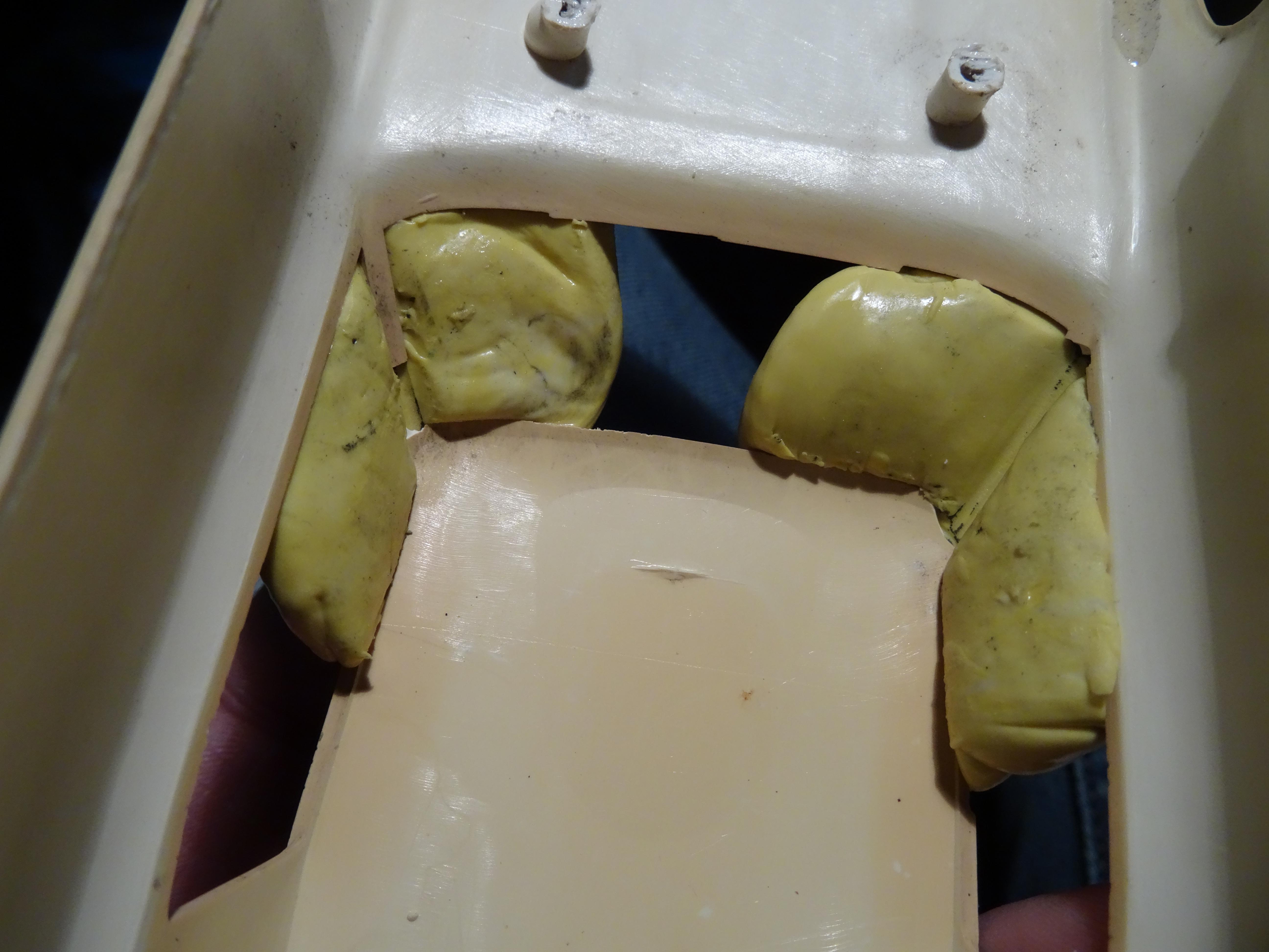

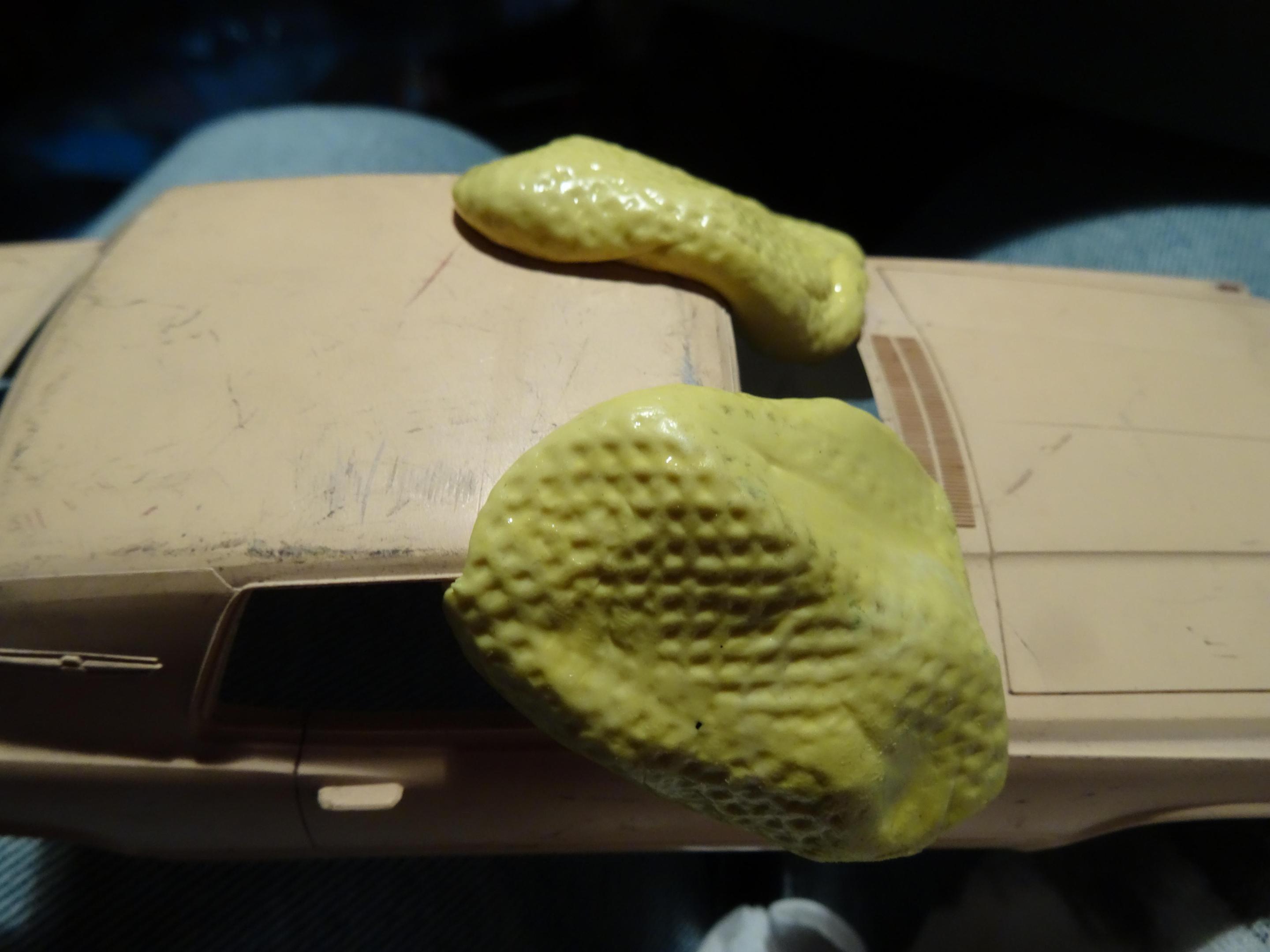

I want to thank everyone for their input. Essentially I followed the thread by  59 Impala with some slight deviation. I used the Amazing Mold Putty but instead of fingernail resin I used Alumilite Tan Casting Resin.
Molds on the body
You can see here how much is missing from the pillar on the right.
Removed from the mold.
After cleanup, will just need a little more work.DSC01384.thumb.JPG.e473cb0788c319f21d98c673423e5cae.JPG
