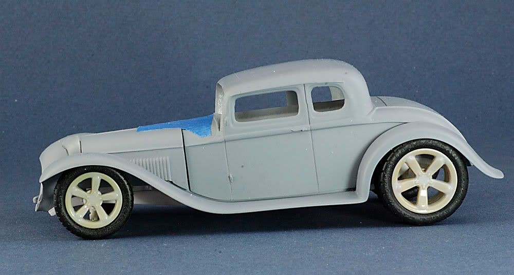

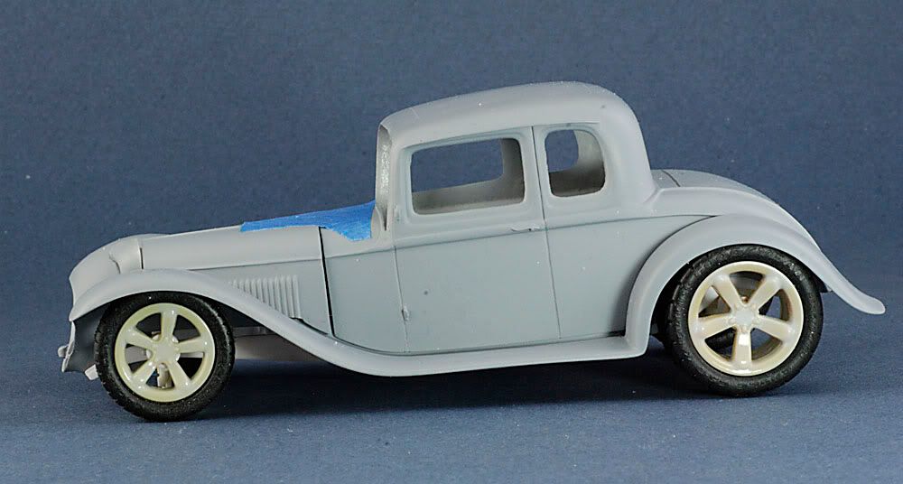

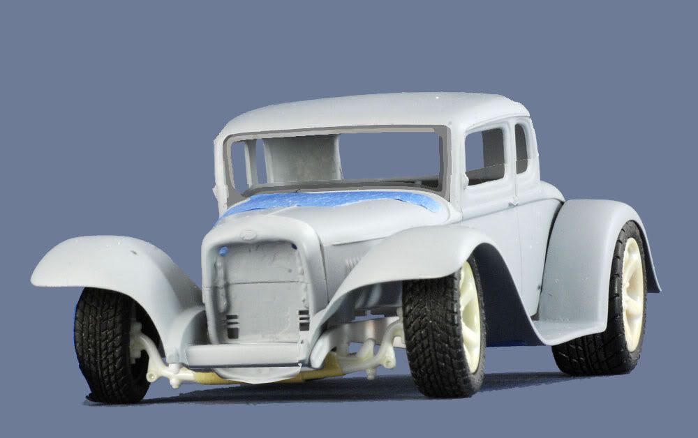

Foxer Posted April 25, 2009 Posted April 25, 2009 I hadn't meant to put this bench hack up yet, but I'd like to solicit some opinions on the top chop. I originally meant to only section and channel and widen each fender but 3.5 inches. No top chop. Now I'm wondering if I should. I do still like the look of the tall roof, but it's just at the point that I've been staring at this too long and could use some feed back. So, here's a couple pics with no chop and a chop done in the Photoshop Body Shop. Also another at a better view with the fender width showing to balance the view. No chop in the 3/4 view. Photo 1 - no Chop Photo 2 - Chopped 3/4 view.. guess I could have PS chopped this one without too much work, but for now it's not chopped.
Fletch Posted April 25, 2009 Posted April 25, 2009 This was a tough one. Normally, I all for chopping a '32 3 or 5 window coupe but, with all the additional body work you've done the stock height has a better look. The photo shopped version seems to take it out of reasonable scale. Without the section I'd say chop it. But, the additional body work would be lost if you were to chop it. Move forward from where you are. IMHO
george 53 Posted April 25, 2009 Posted April 25, 2009 Go with the chop Mike, it won't look so topheavy that way,just a more sleeker(if you can use that word with a 32 Ford)look to it. Looks good so far, I like it!
fordsixty Posted April 25, 2009 Posted April 25, 2009 the original top looks way too formal. the chop looks great, only thing missing is a big, hairy forearm hanging out the window. great idea and excellent execution.
Bernard Kron Posted April 25, 2009 Posted April 25, 2009 (edited) Yet another variation! Keep almost everything you've got, but don't chop the grill quite so much so the valence of the shell shows below the axle line. It looks KILLER in 3/4 view. See?: (My chop may be slightly milder than yours, which may argue for the in between approach) Edited April 25, 2009 by gbk1
diymirage Posted April 25, 2009 Posted April 25, 2009 i would go even more agressive, and drop the front of the roof to the level in the chop and then decrease the slope of it towrds the back, so that the roofline will be horiziontal (cant photosoup it but i can invision it) i think that would look awesome
Dennis Lacy Posted April 25, 2009 Posted April 25, 2009 I would definately chop the top. Also, Bernard made a very good point about not sectioning the radiator shell so much. His version gives the front end a much more aggressive look that flows with the rest of the bodywork way better. Otherwise, awesome bodywork you've done so far!
RyanSilva Posted April 25, 2009 Posted April 25, 2009 Chop the top...just don't chop it so much..maybe a scale 2 inches or so.
Jantrix Posted April 26, 2009 Posted April 26, 2009 IMO there IS a point where chopping, channeling, and sectioning stops being about improving the look of the automobile and becomes about the builder flexing his bodywork muscles. I'm speaking in terms of 1:1 mind you. At some point the car stops looking cool and becomes a caricature of a car. That seems to have become a bit of a trend in some circles but it's not for me.
Foxer Posted April 26, 2009 Author Posted April 26, 2009 (edited) I really appreciate EVERYONE'S input on this. I was at that infamous wall and needed a nudge. I pretty much agree on the prevailing opinion that a chop somewhere between the versions I showed is the way to go. The grill chop which gbk1 showed a restoration of really opened my eyes. That does look so much better than what I did. I had thought cutting the grill down that much would reflect the cuts on the body, but not so. This body is the ancient reissued AMT one I had as a kid, so looks like the Revell kit I'm using for the chassis will now be donating a grill also. IMO there IS a point where chopping, channeling, and sectioning stops being about improving the look of the automobile and becomes about the builder flexing his bodywork muscles. I'm speaking in terms of 1:1 mind you. At some point the car stops looking cool and becomes a caricature of a car. That seems to have become a bit of a trend in some circles but it's not for me. Most of the time I do agree with you, Rob, though sometimes you just have to step outside the box and do something you normally wouldn't to break out the rut you're modeling down to the sparse grass and pebble grains. I've been mostly doing cars I've owned and, while I love doing this, I needed something different to play with. I did a scale 48" high 40 Ford Sedan in 1962 at age 16 and have nothing to prove, but I'm still learning and I model just what makes me happy. Contests aren't my thing.. VERY few people have actually seen anything I've built, but I am REALLY enjoying going on display HERE and not being worried about what I show. I always loved getting those oldies down low and this one was inspired by a car not far from me that was driven on the road since it's inception in the early 50's, now owned by Skip Rapp This car has an interesting history, all the more being a New England car .. NOT SoCal .. ehhe Edited April 26, 2009 by Foxer

Bernard Kron Posted April 26, 2009 Posted April 26, 2009 ...looks like the Revell kit I'm using for the chassis will now be donating a grill also. ... ... being a New England car .. NOT SoCal.. ehhe East Coast baby, yeah!!! Re: the grill shell - Replicas & Miniatures makes a lovely 2" chop shell with p/e grill that would work. Also ditto Model Car Garage in a 6" version. It would save massive amounts of work & look great. One thing to worry about, though, and that's the actual shape of the grille shell and the mating to the hood. But with your bodywork chops maybe that's not such a big deal... Can;t wait to see more!
