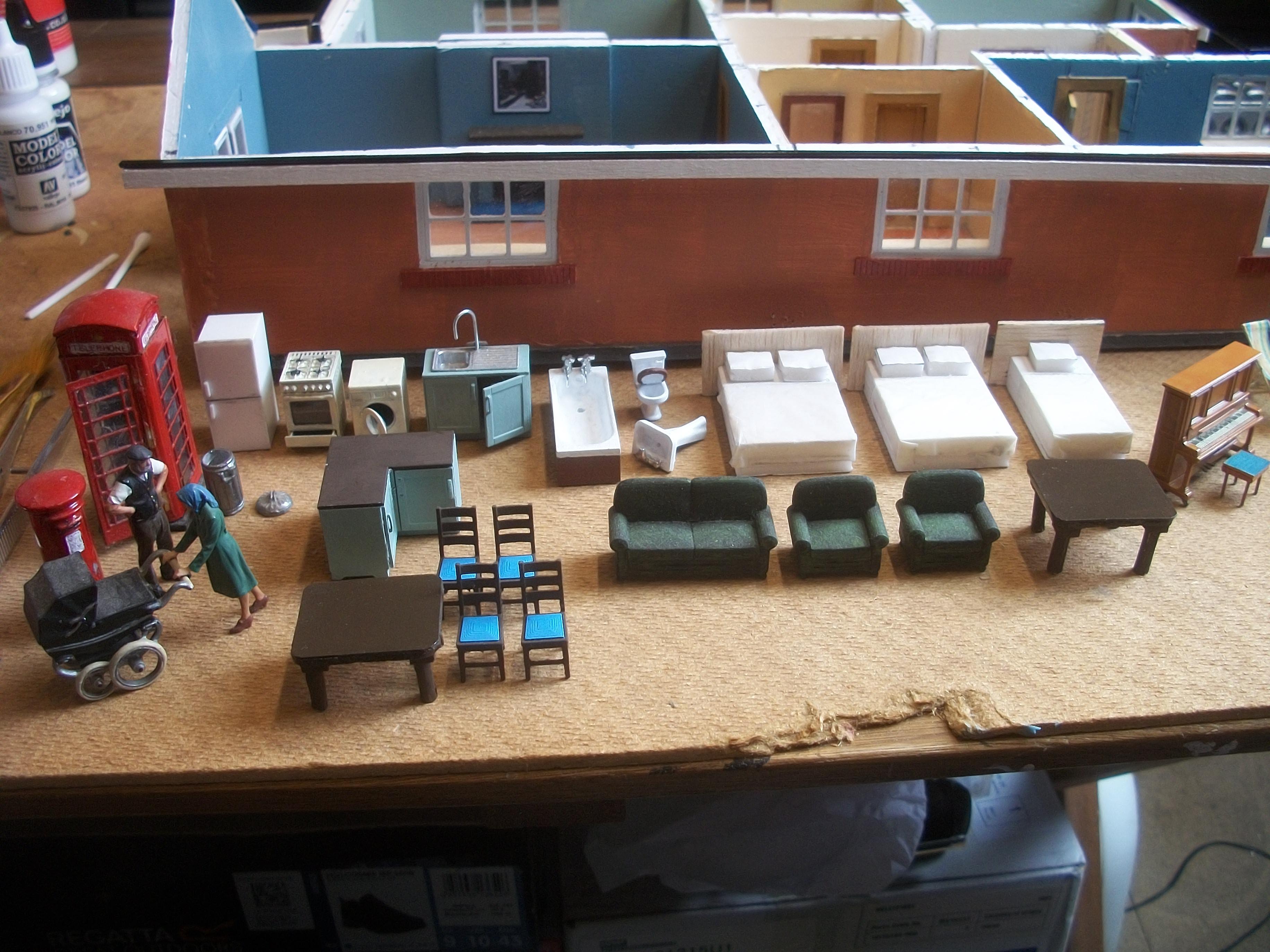

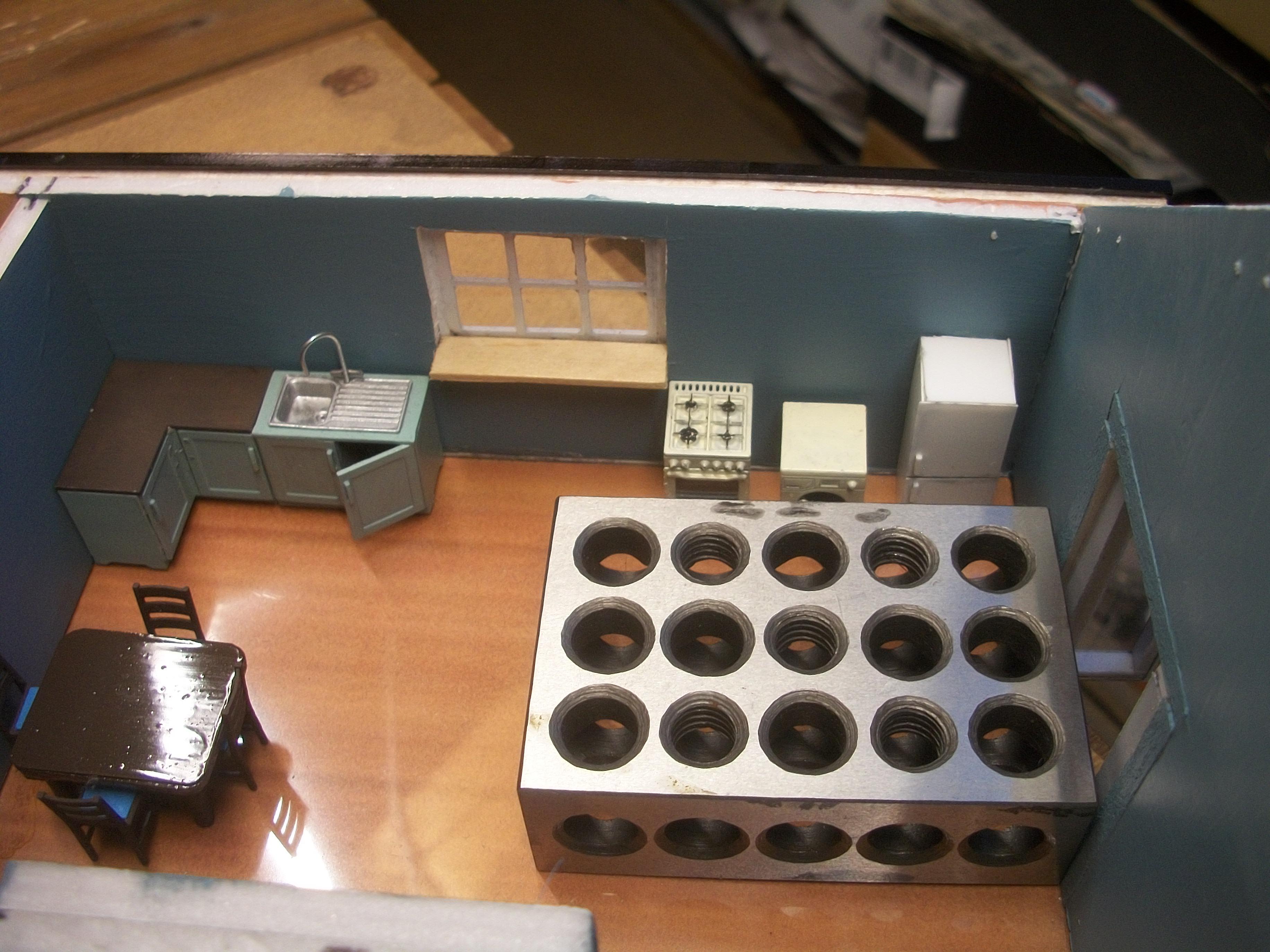

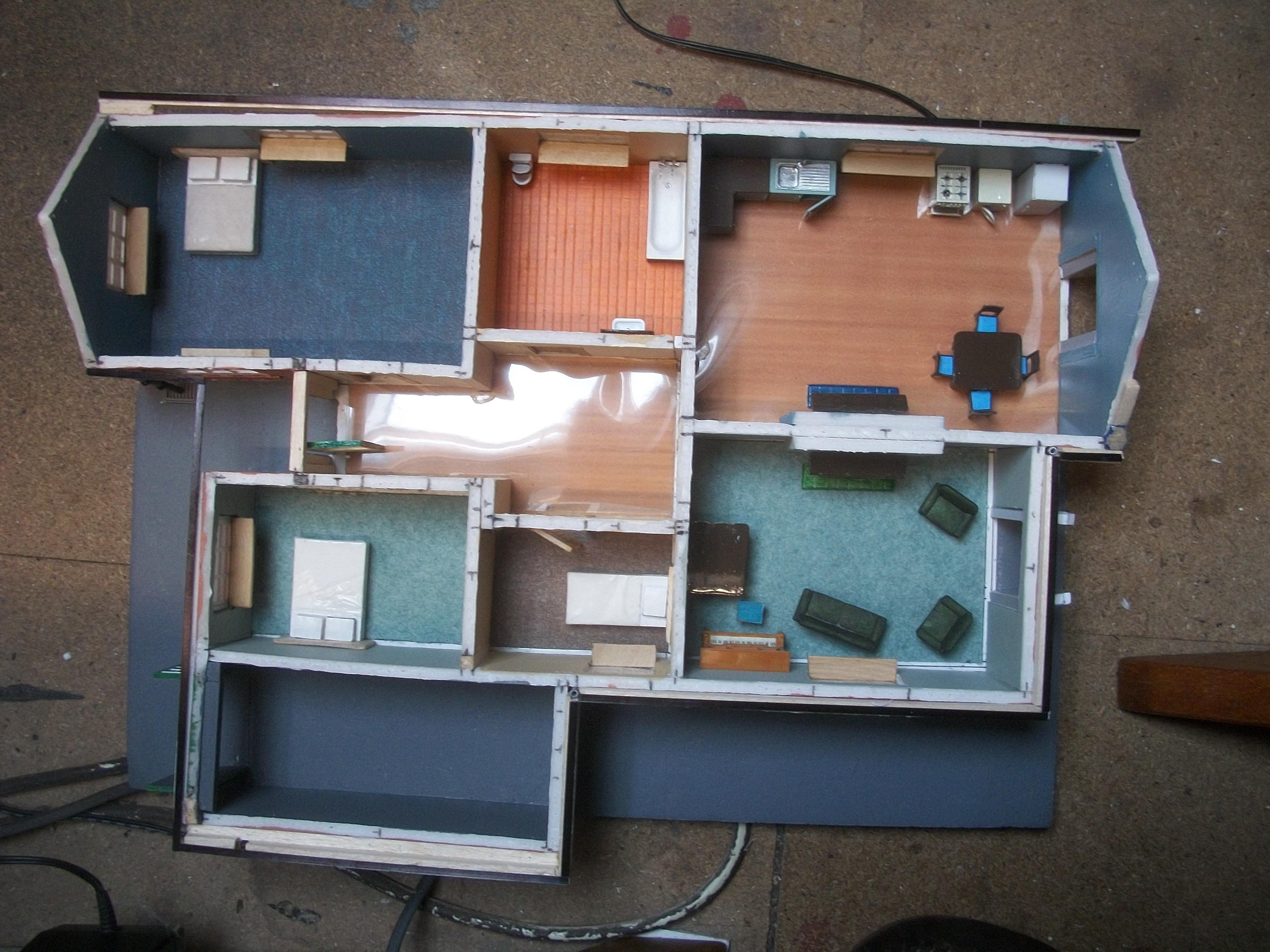

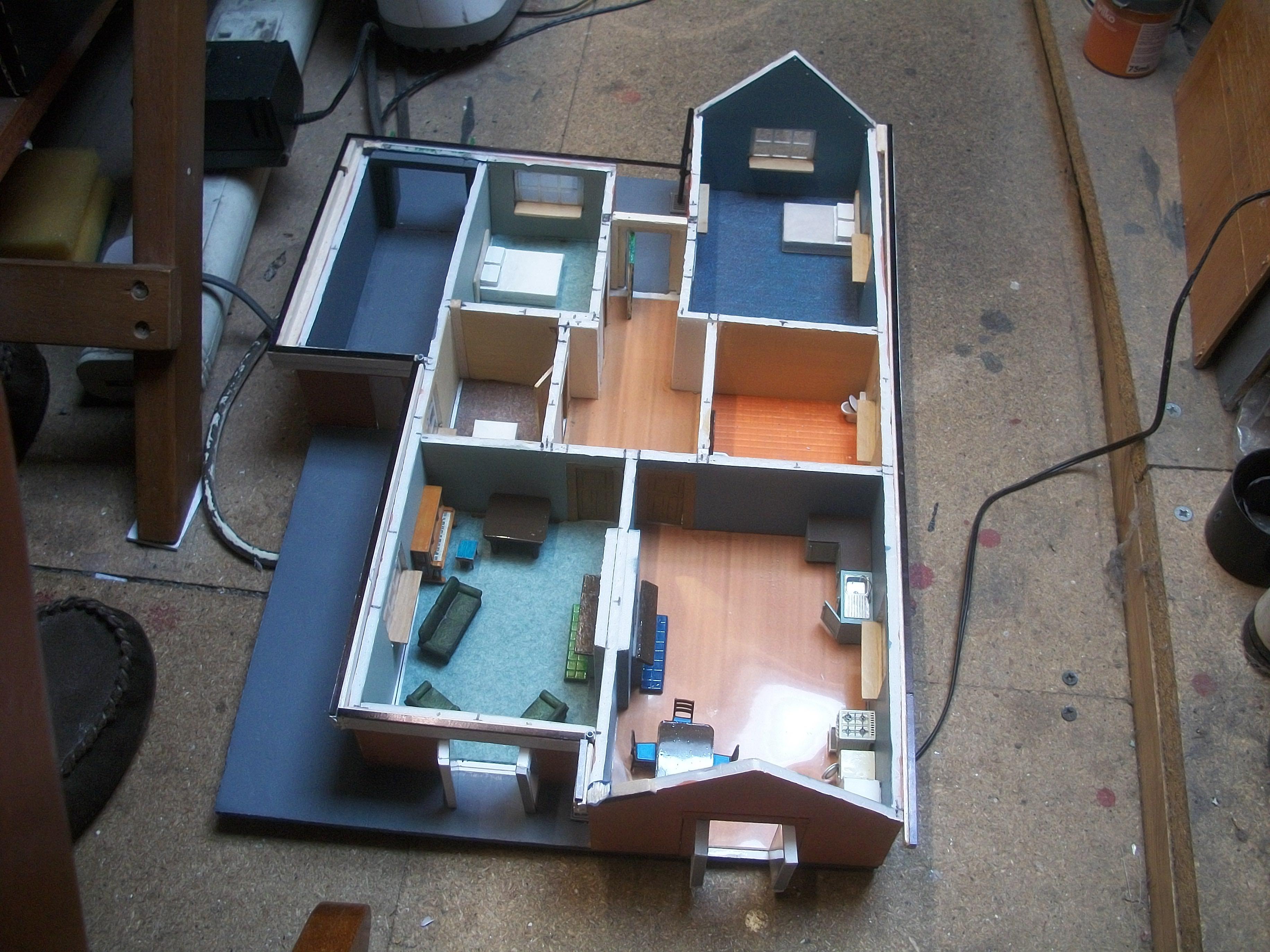

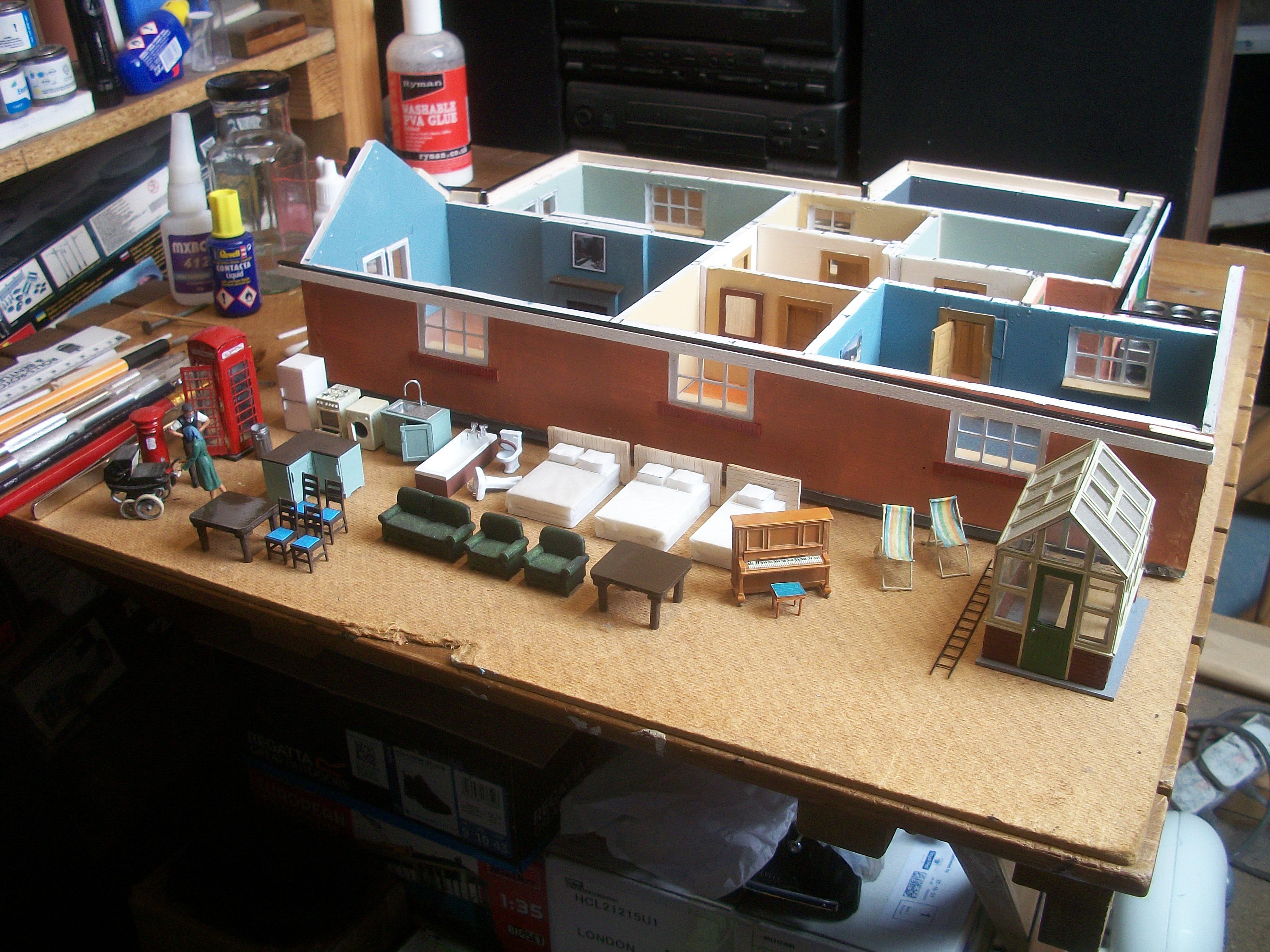

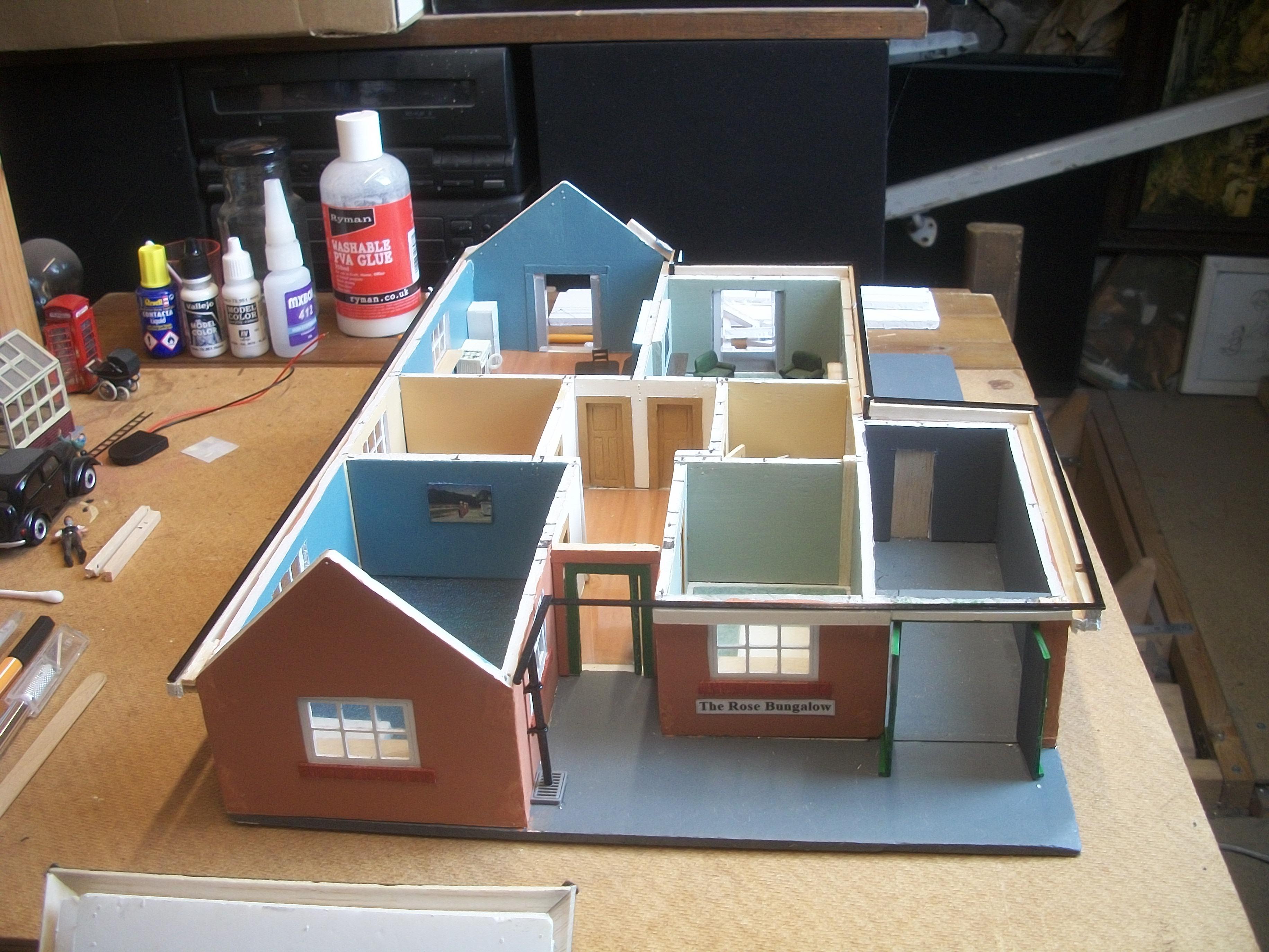

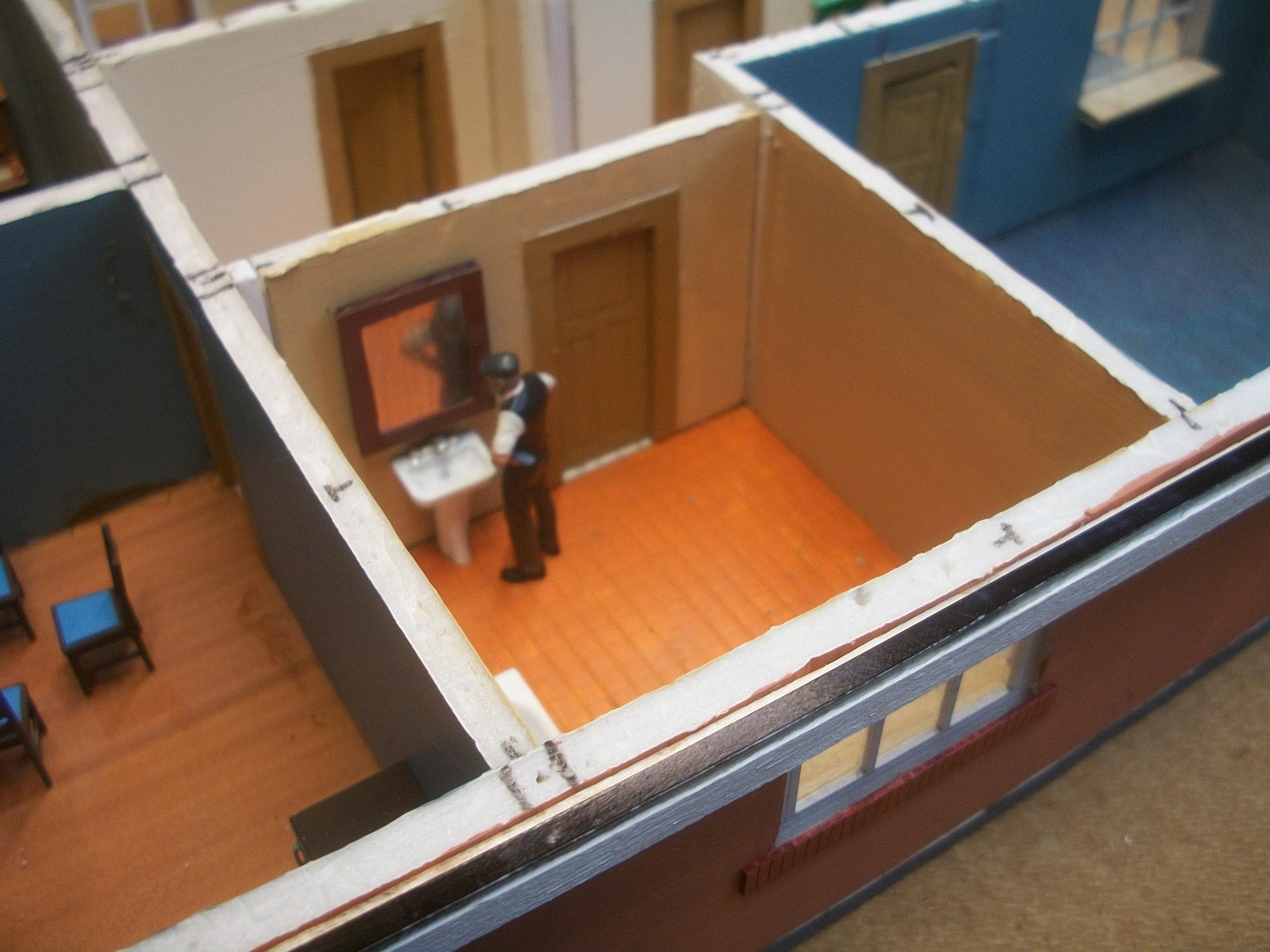

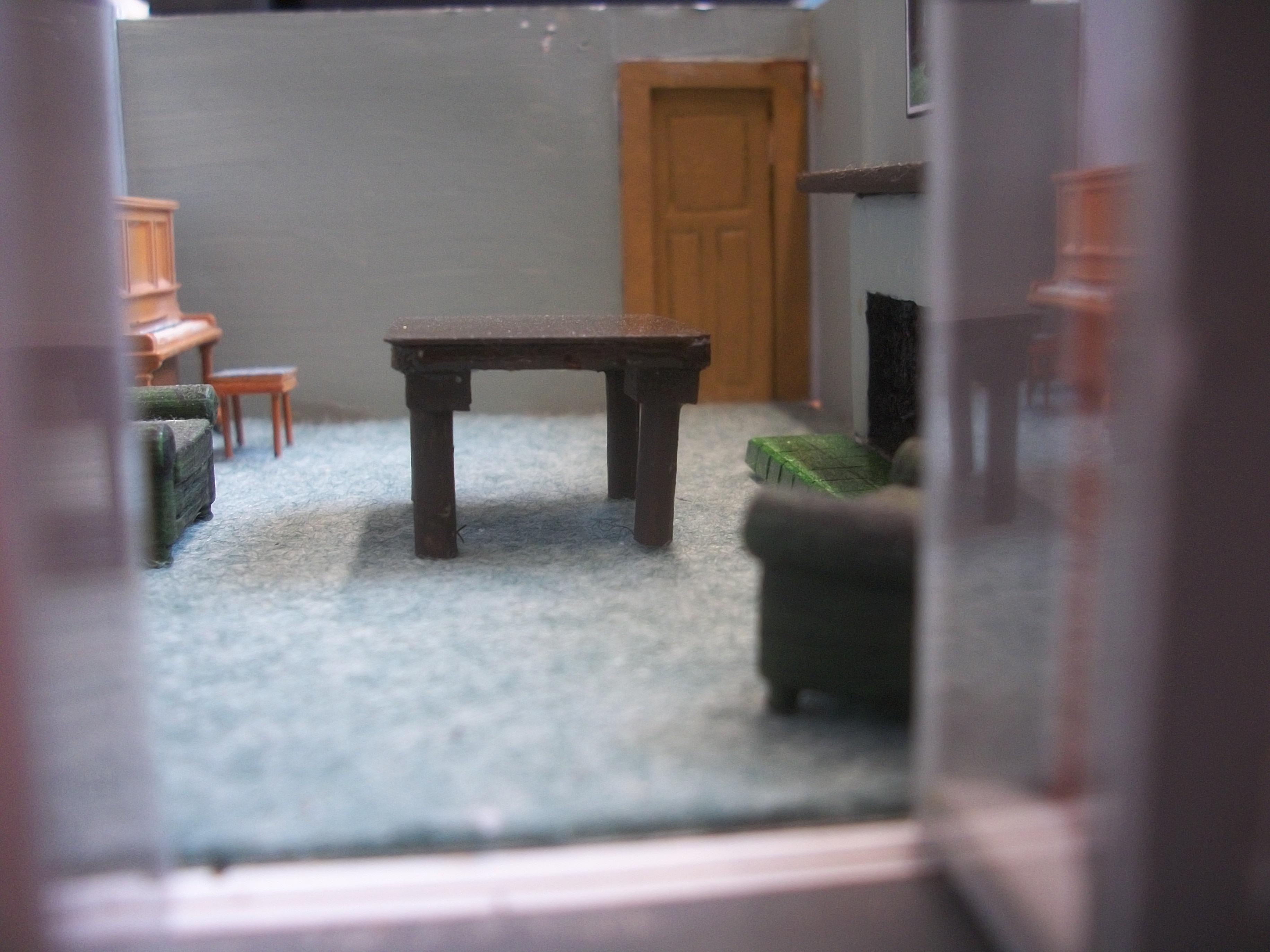

During today the furniture and fittings for the bungalow model were moved from the downstairs workbench, and upstairs to the workbench in the loft . . .
These parts have all been assembled or scratch built and painted, ready to be placed in their respective rooms. Some parts are intended for outside locations, such as the greenhouse, deck chairs, post box (mail box), telephone box, dustbin (refuse bin) and ladder . . .
The furniture and fittings have been loosely arranged inside each room, and so far I have super glued the fridge freezer to the floor and wall in the corner of the kitchen, as well as the wash basin in the bathroom . . .

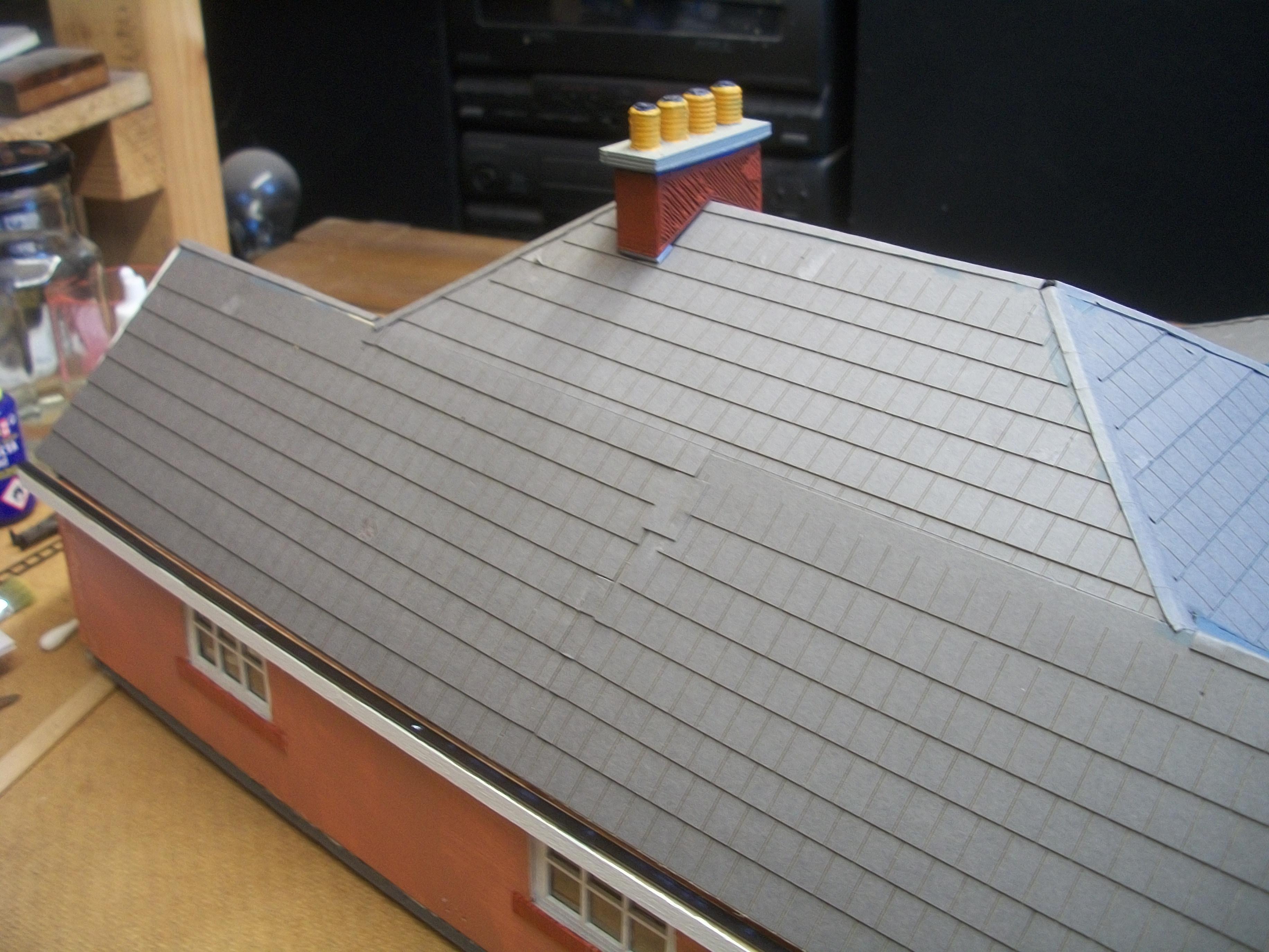

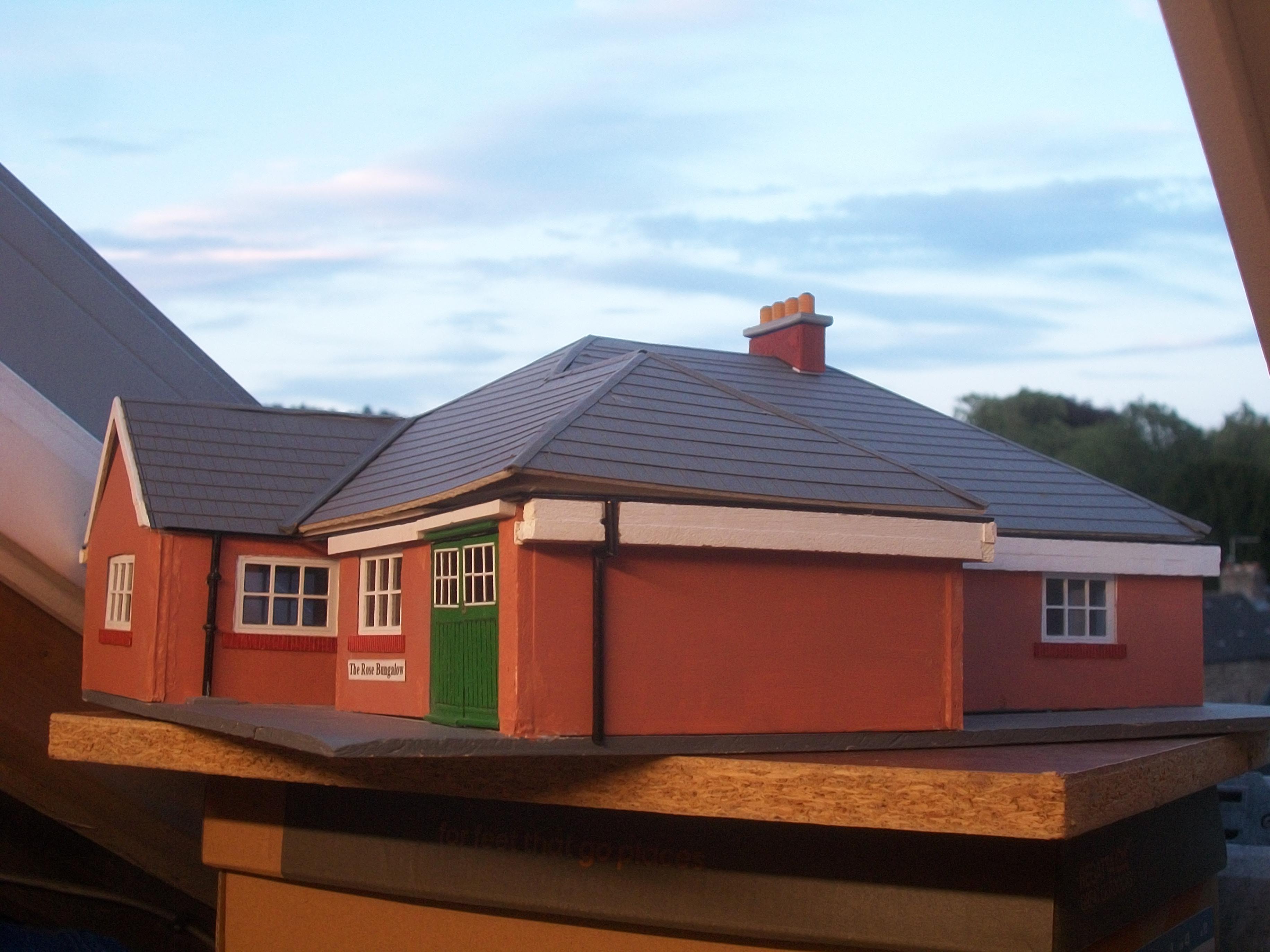

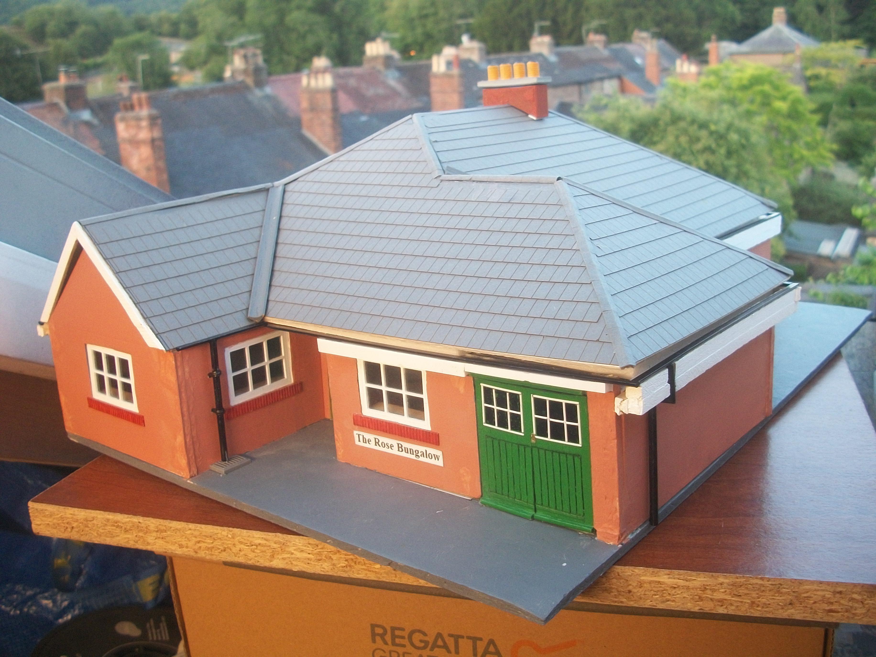

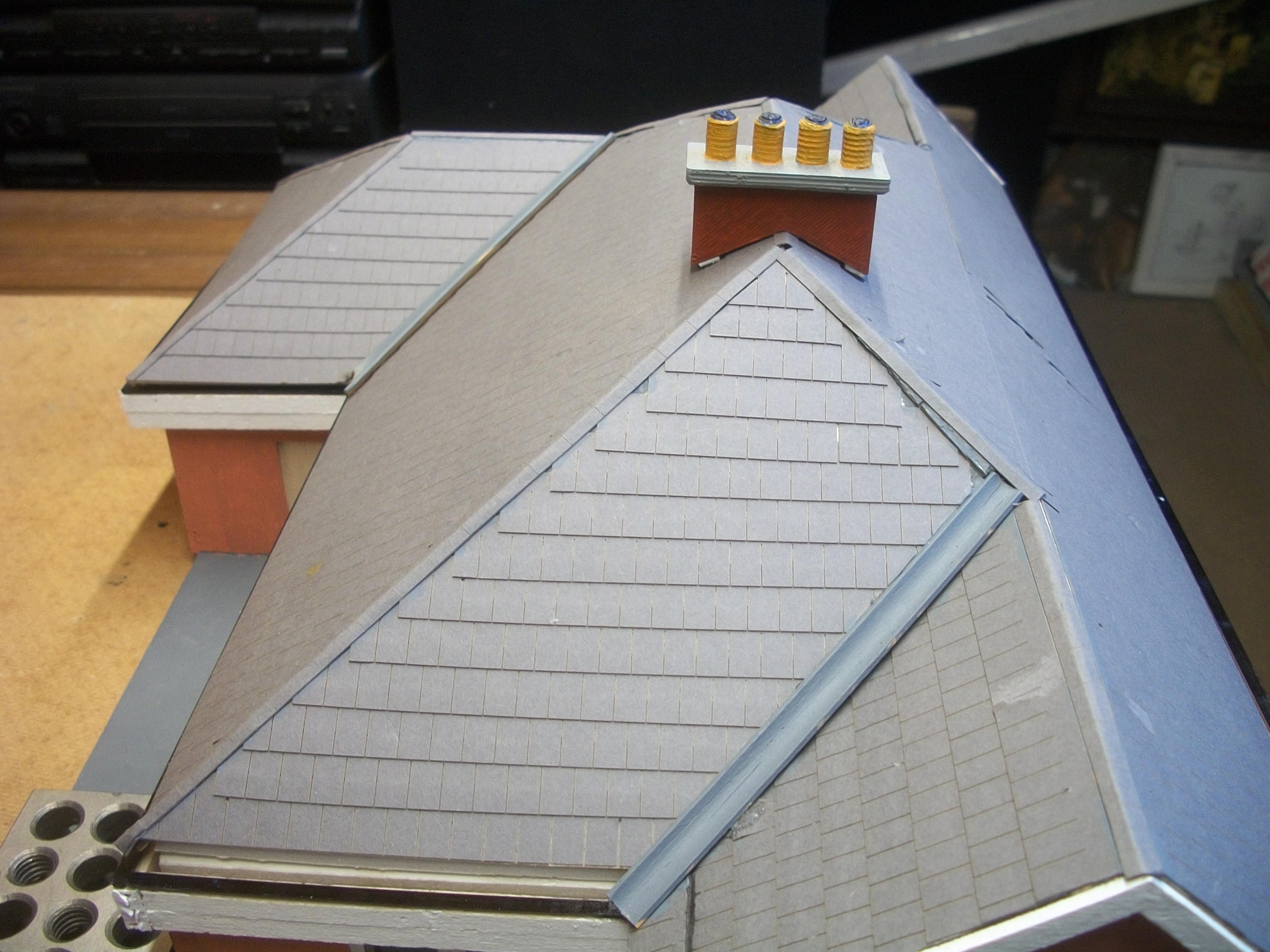

Having added some styrene support pads to the base of the chimney stack, this is now firmly glued in place on top of the roof, and it looks pretty good . . .
David

Thanks David G., and those low angle photos were taken just inside the Velux window that looks out over neighbouring properties from my loft . . . They show the chimney stacks of other cottages, as a sort of comparison with my 3D printed chimney stack.

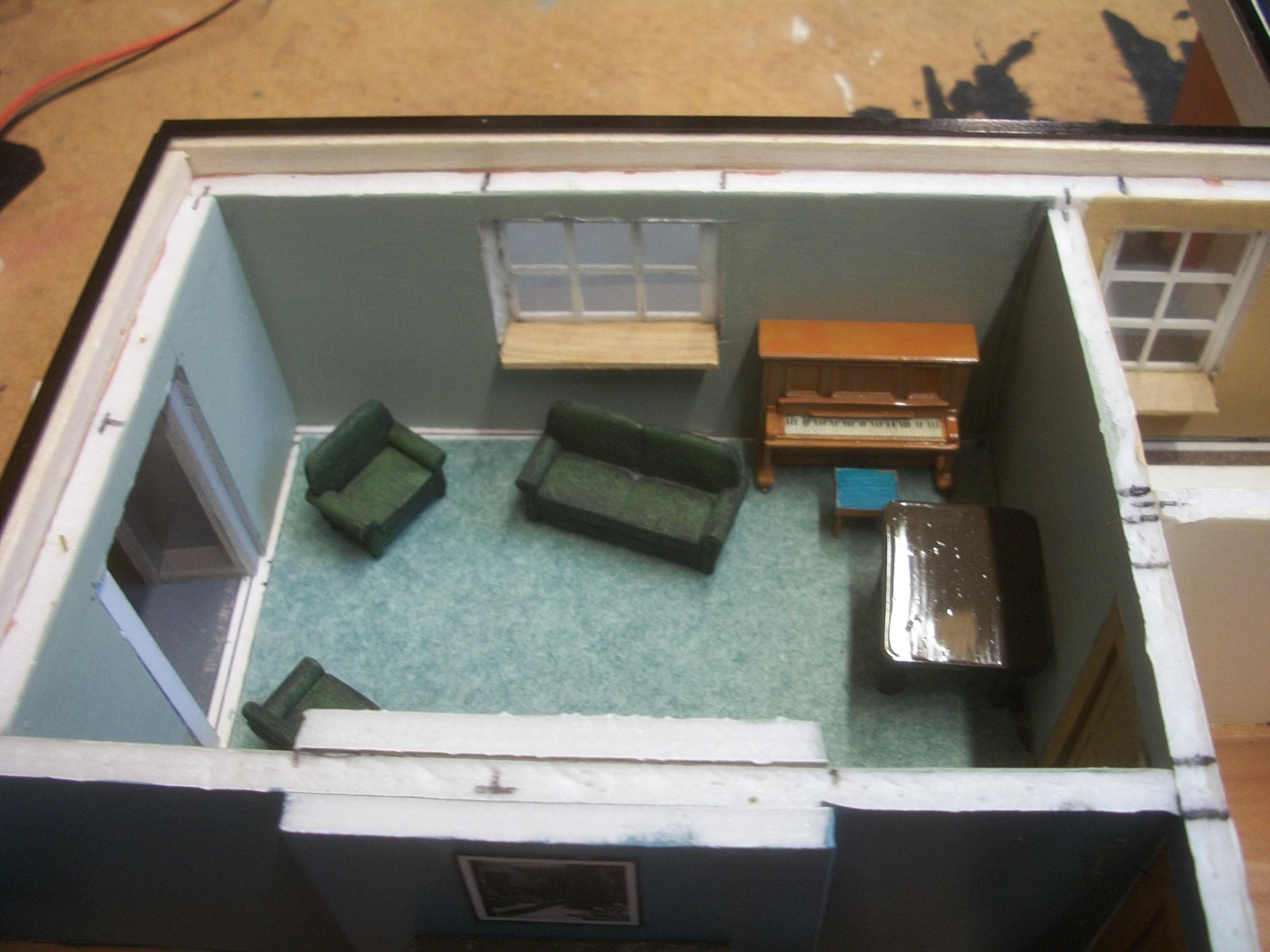

The first of the following photos shows the living room with one of my existing lighting kits set up. I think the ones that are on order should be more effective.
David

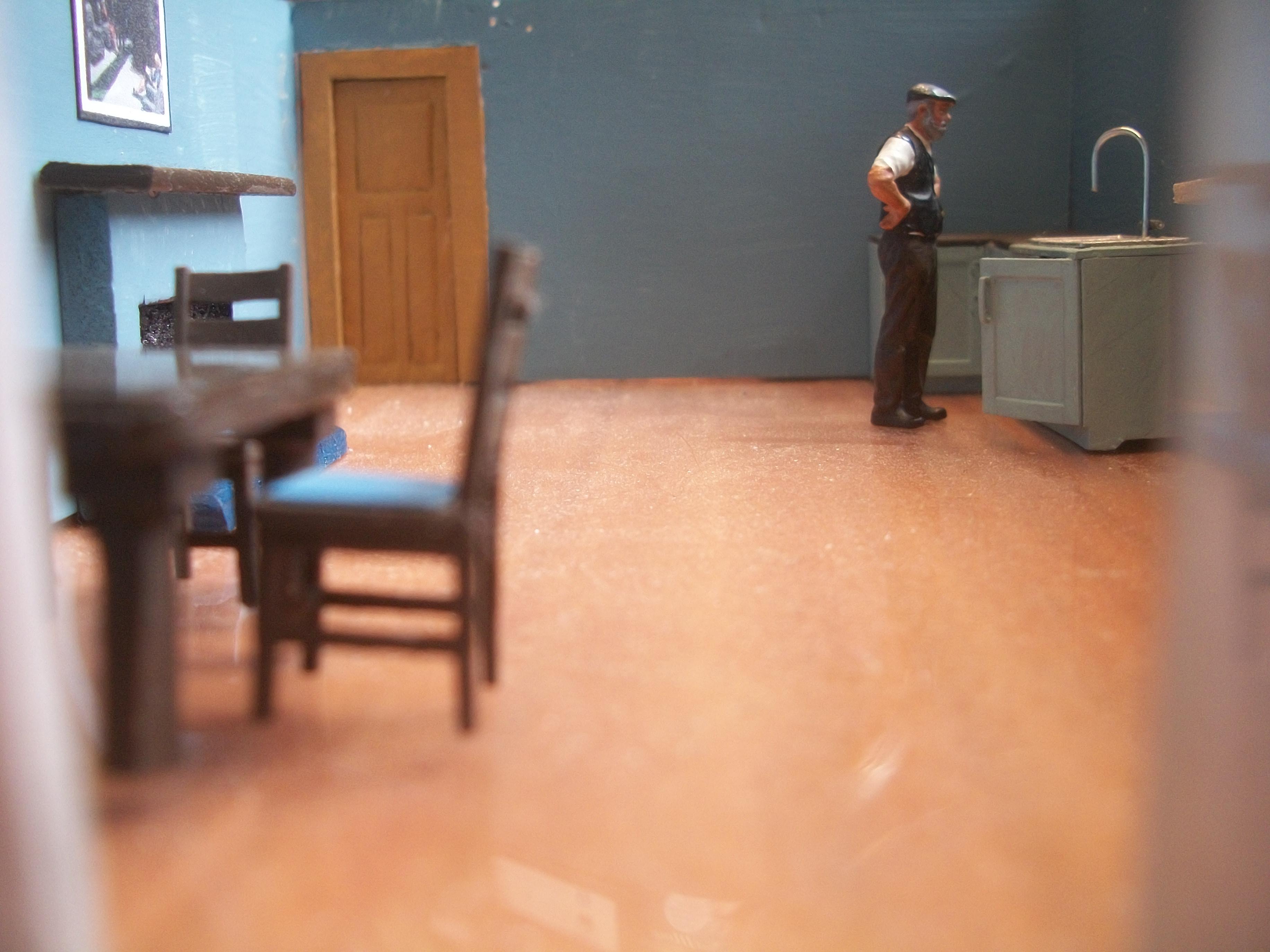

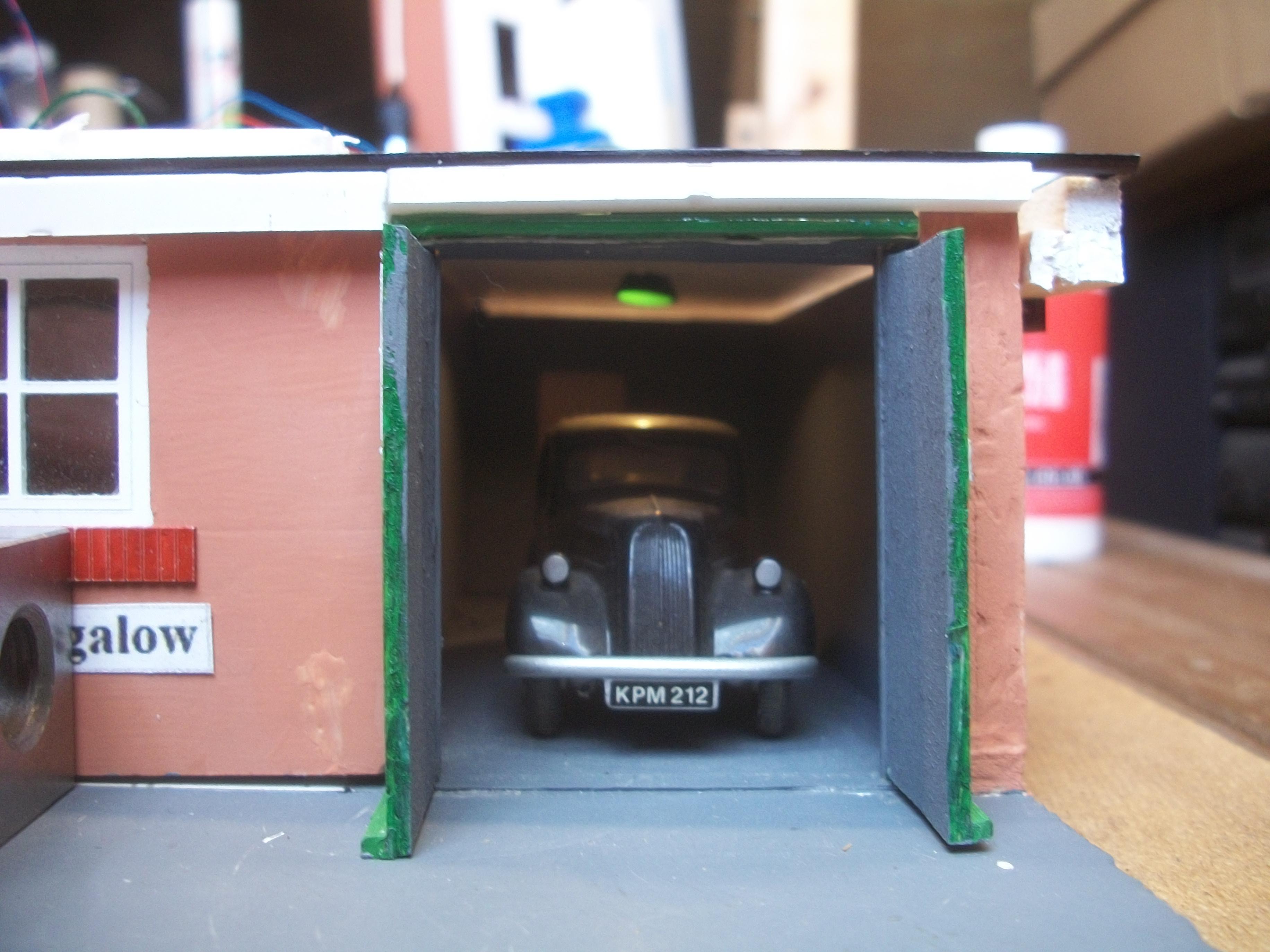

It has been decided that Harold's car for the bungalow garage is going to be this 1958 Ford Popular in black. This is because the 1955 Rolls-Royce Silver Cloud is simply too large for the garage, and the car would not fit properly through the doors. Harold does have several classic cars in his collection, and the other cars are secure storage, some distance away from his bungalow . . .
David

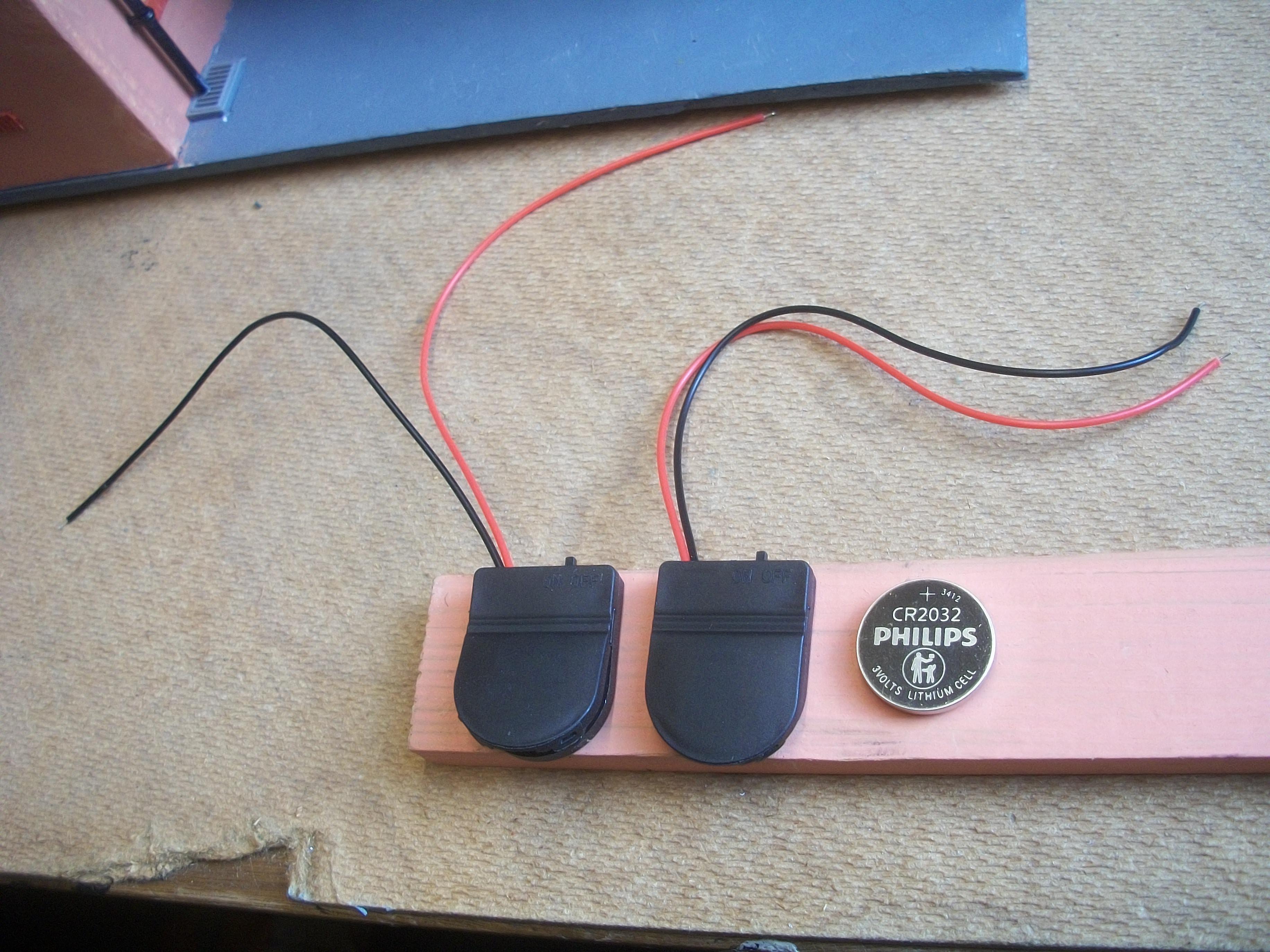

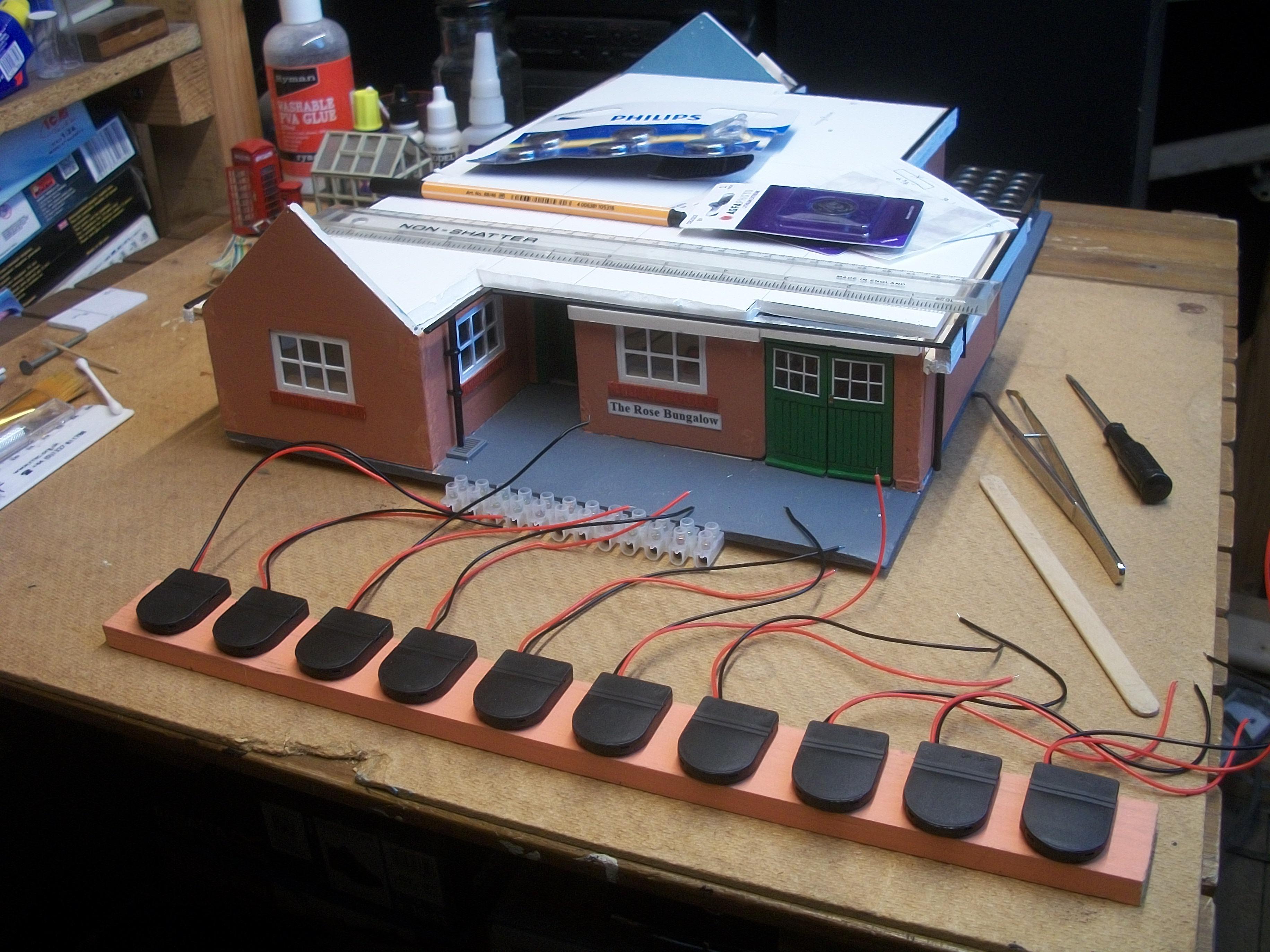

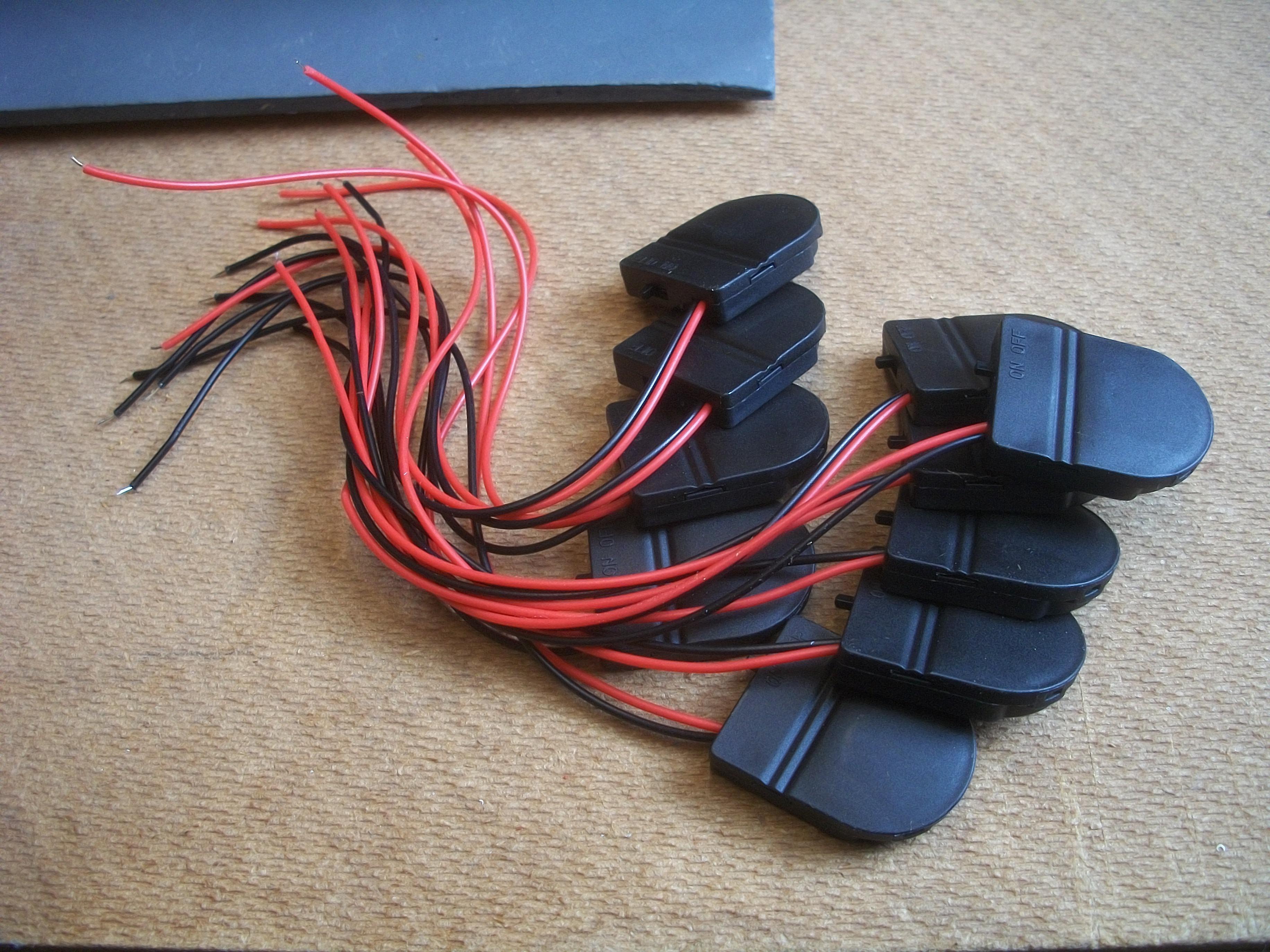

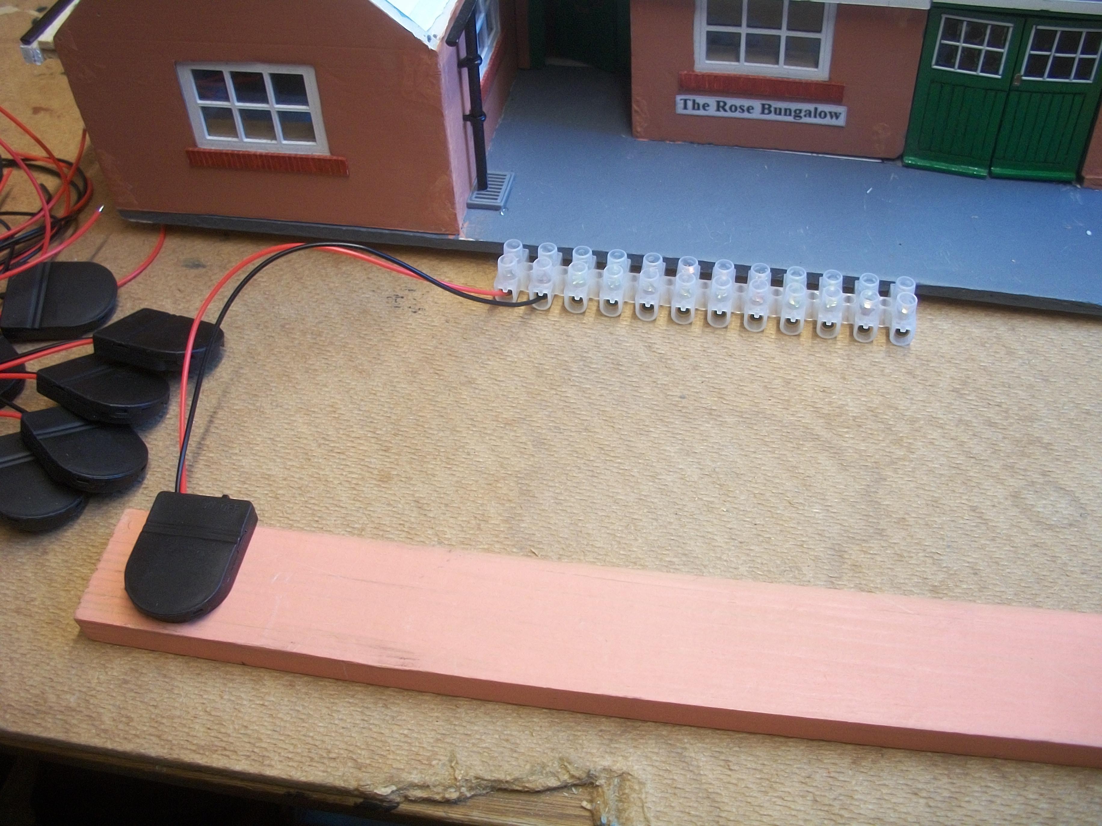

Well, surprisingly the first of the two Ebay deliveries arrived today ( Monday ) . . . The pack of ten battery holders with switches are as expected, and I found a suitable piece of wood strip to mount the battery holders onto. Also, I purchased a nylon terminal block locally that has 12 ports to it. Later, I was wiring up one of the battery holders and I realised that each of the eight holders would need two ports on the terminal block, so I shall need 16 ports. A second terminal block can easily be purchased . . .
I already have 8 coin cell batteries, plus the 10 battery holders, and shortly the two terminal blocks, so now I am awaiting the arrival of the 8 LED lamps . . .
I am fairly confident that this arrangement of the room lights should work . . . we shall see !
David

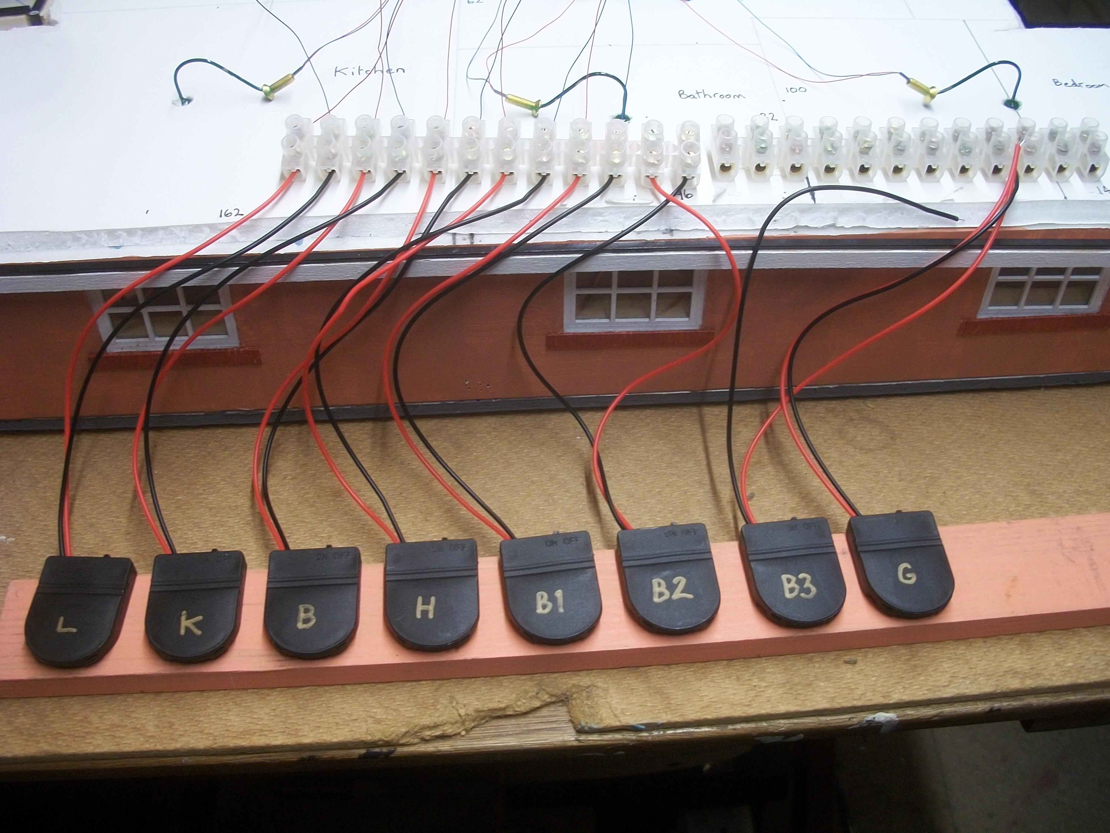

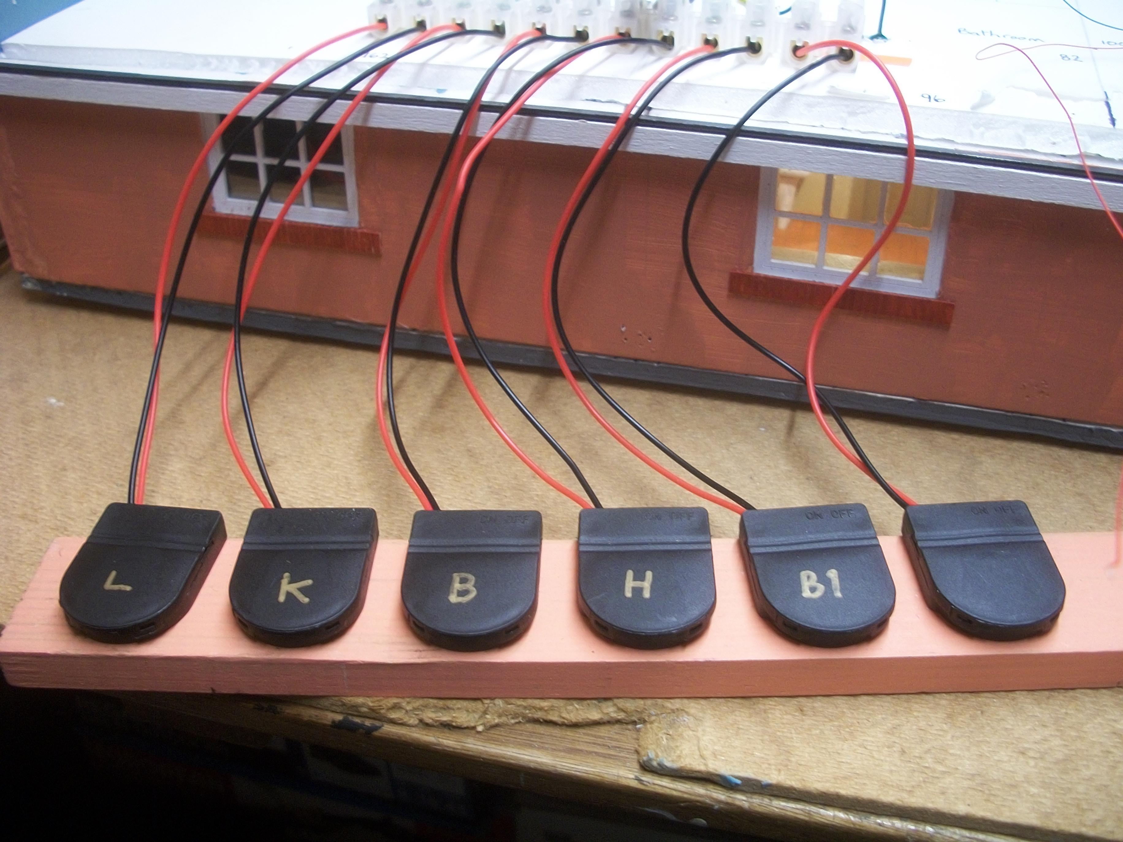

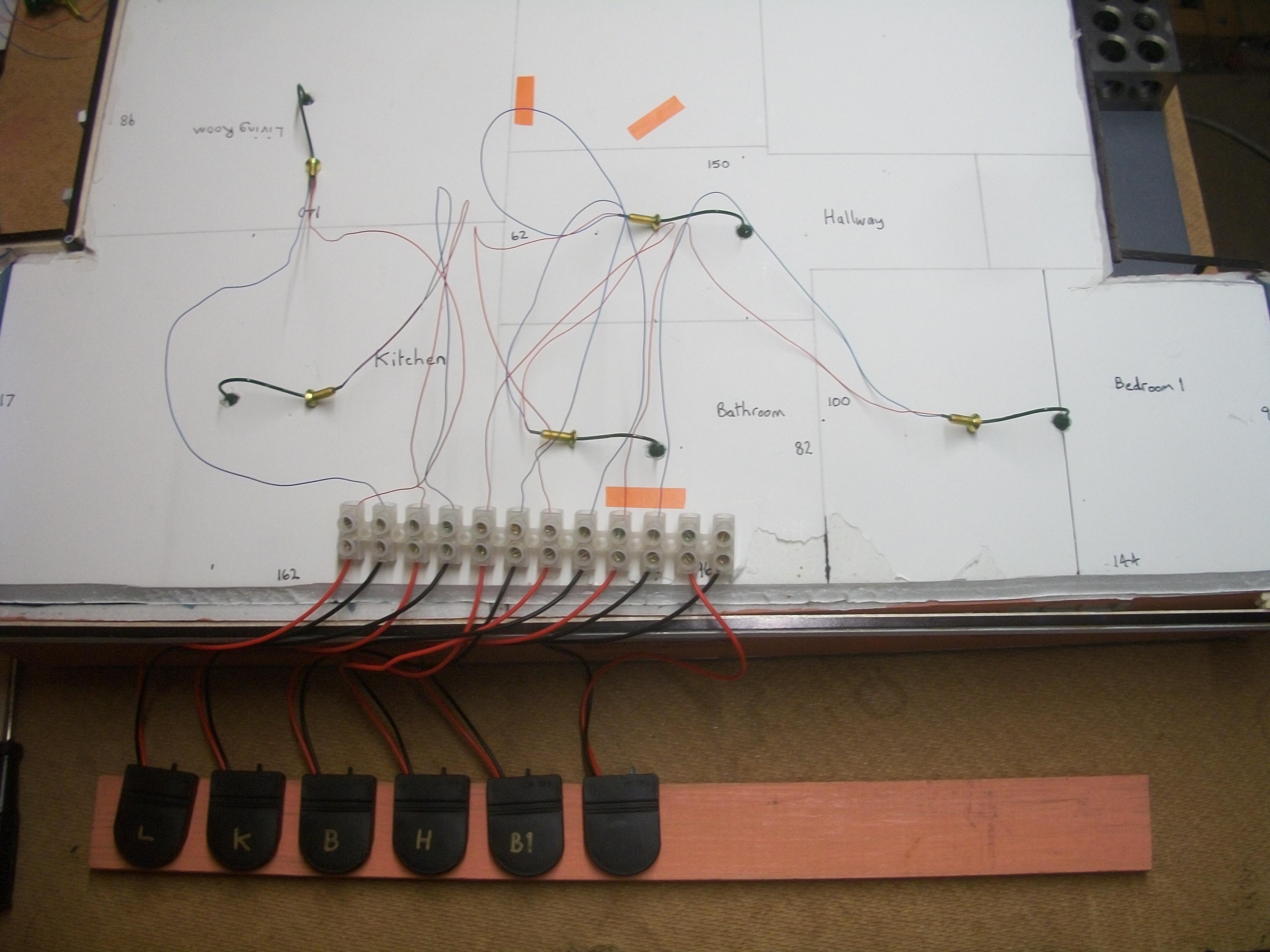

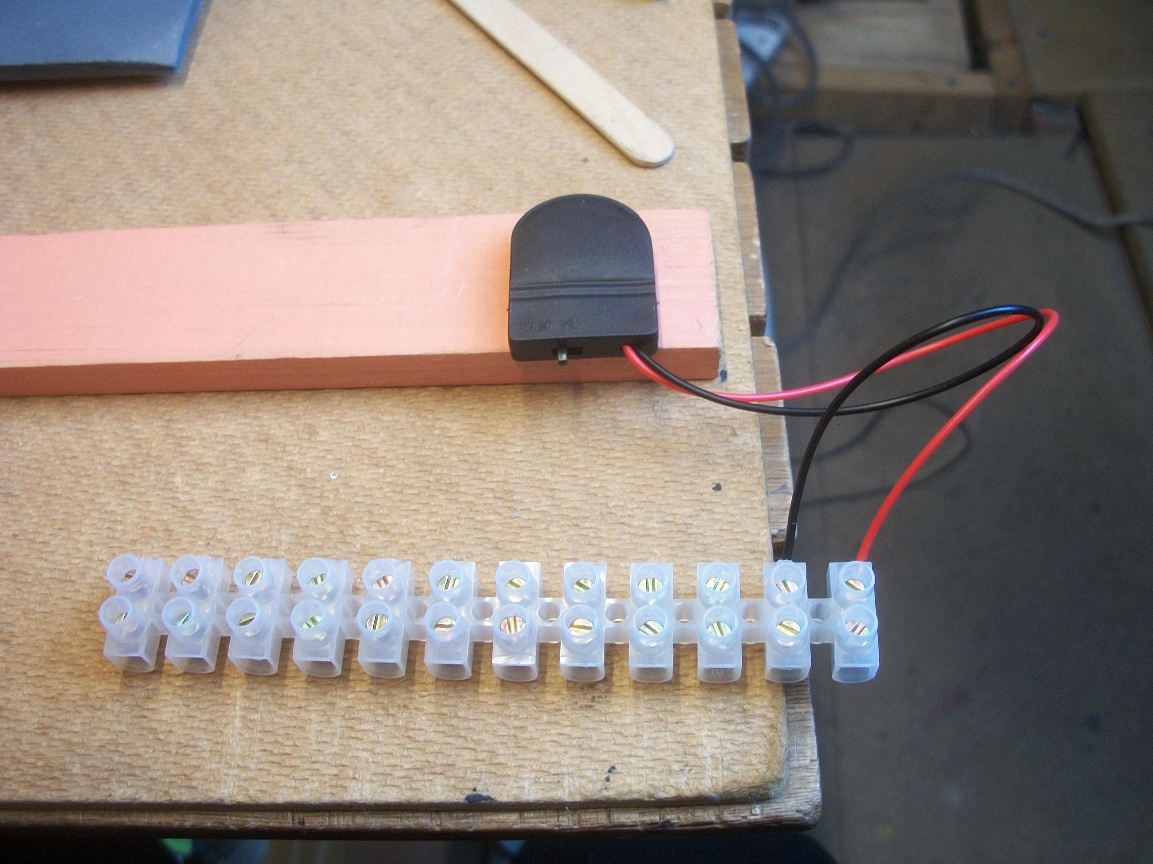

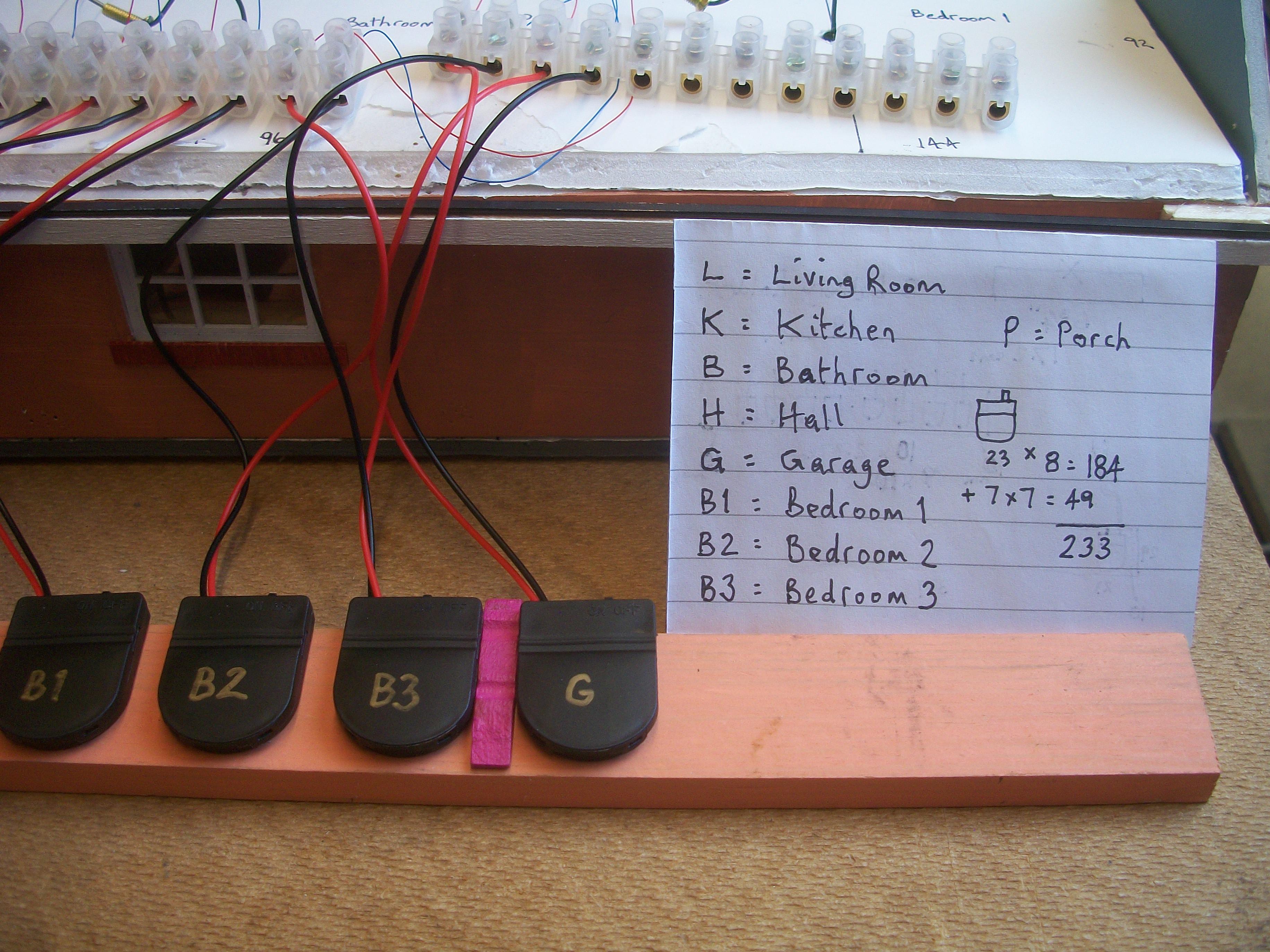

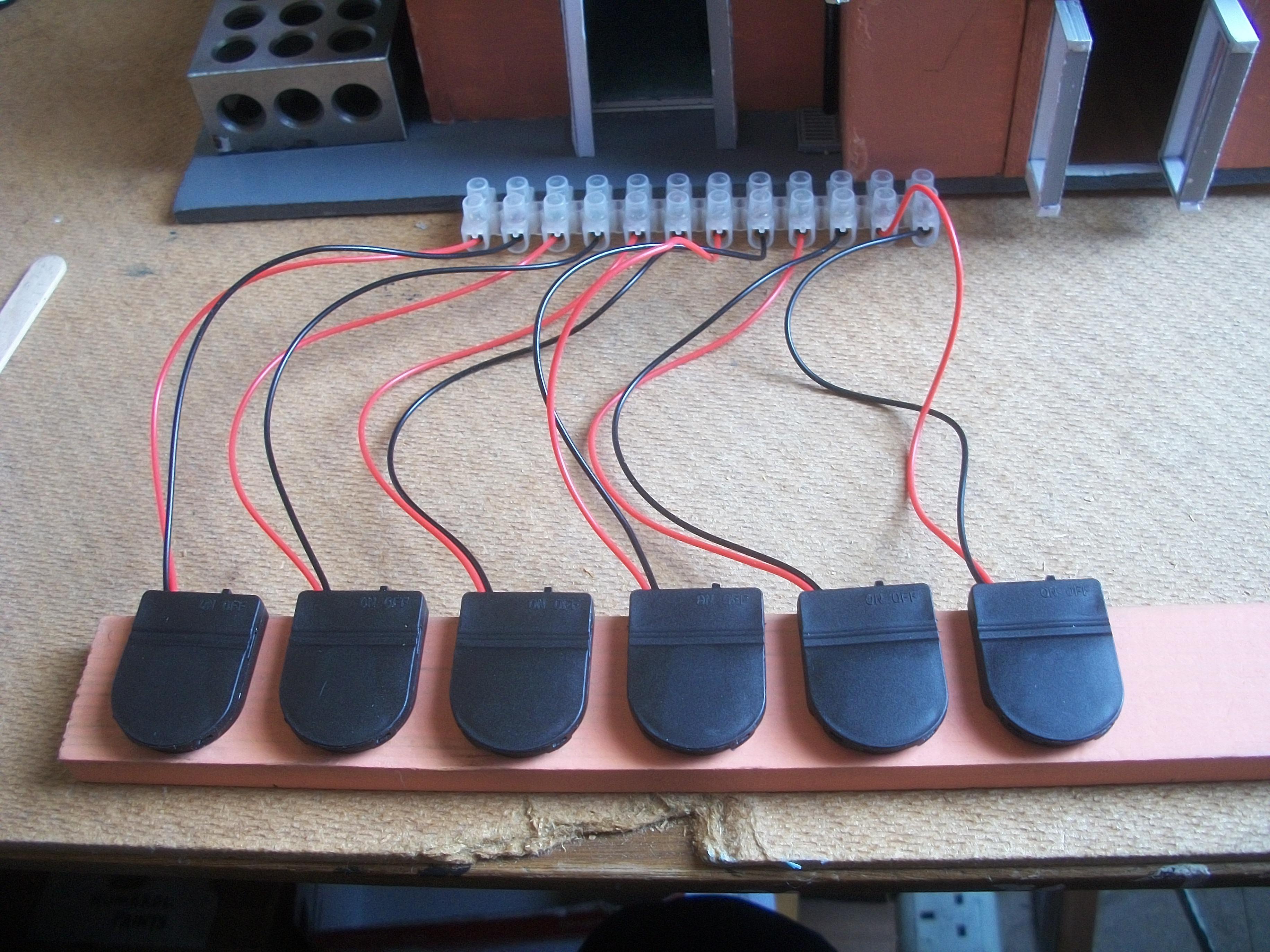

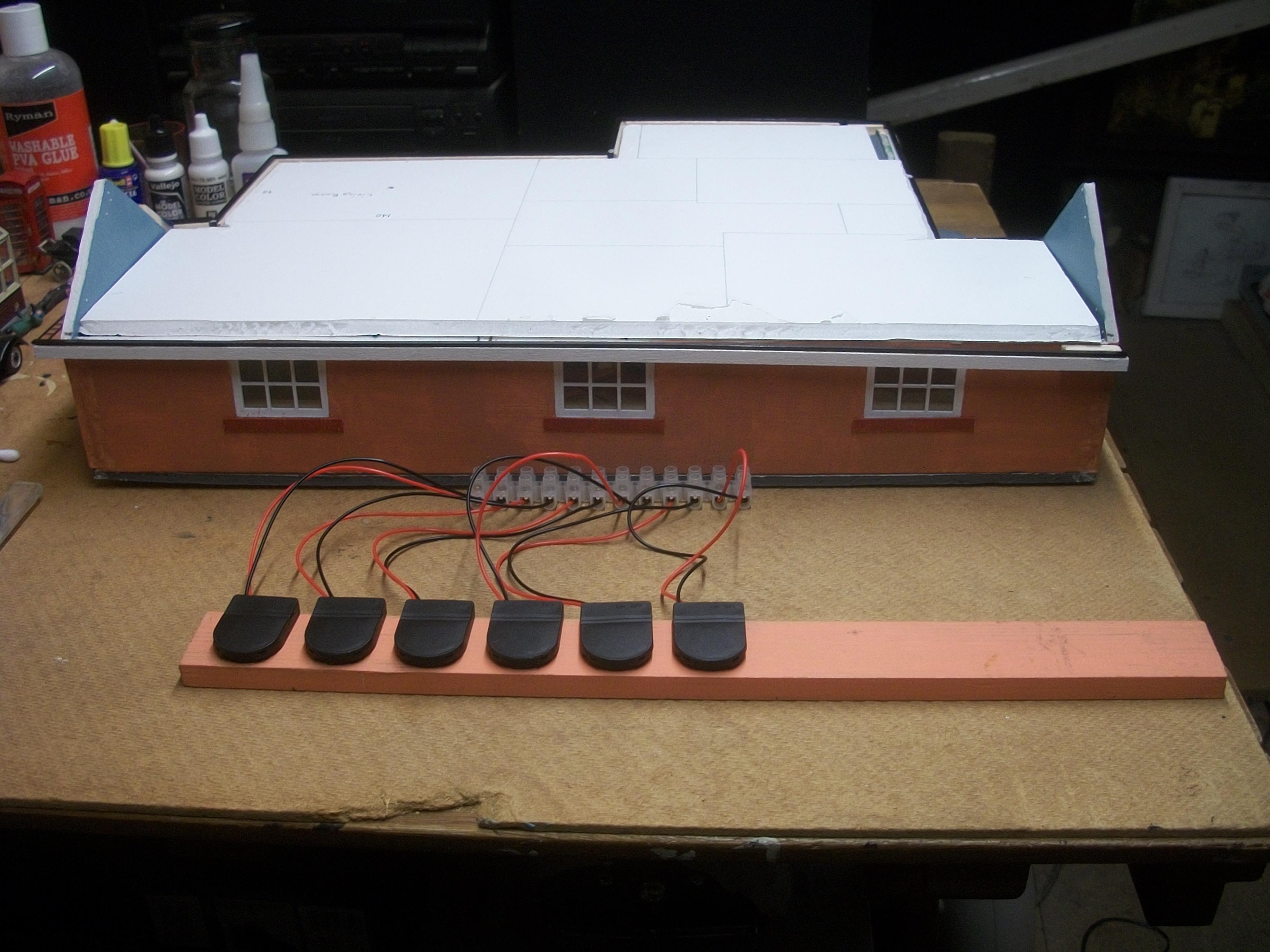

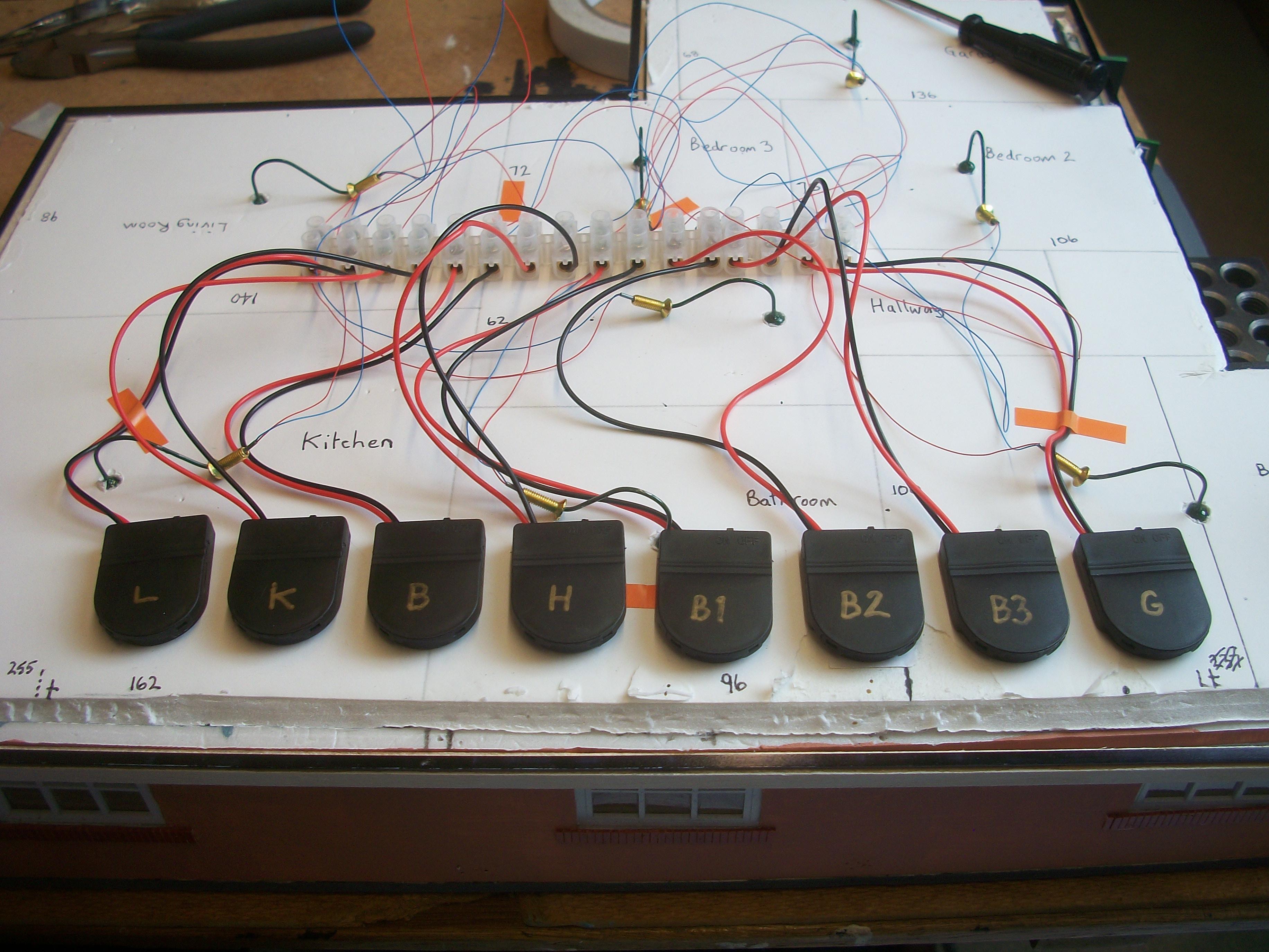

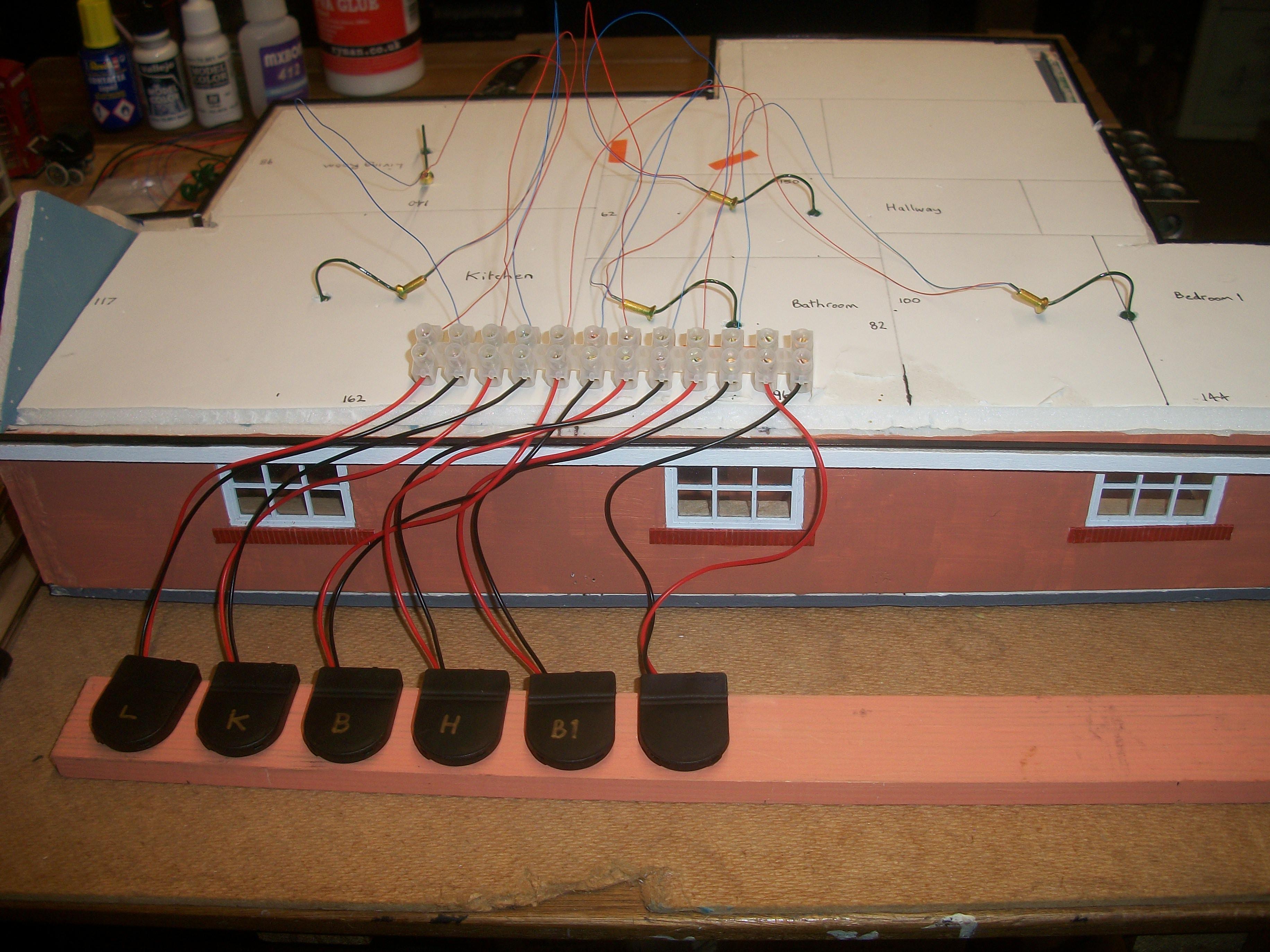

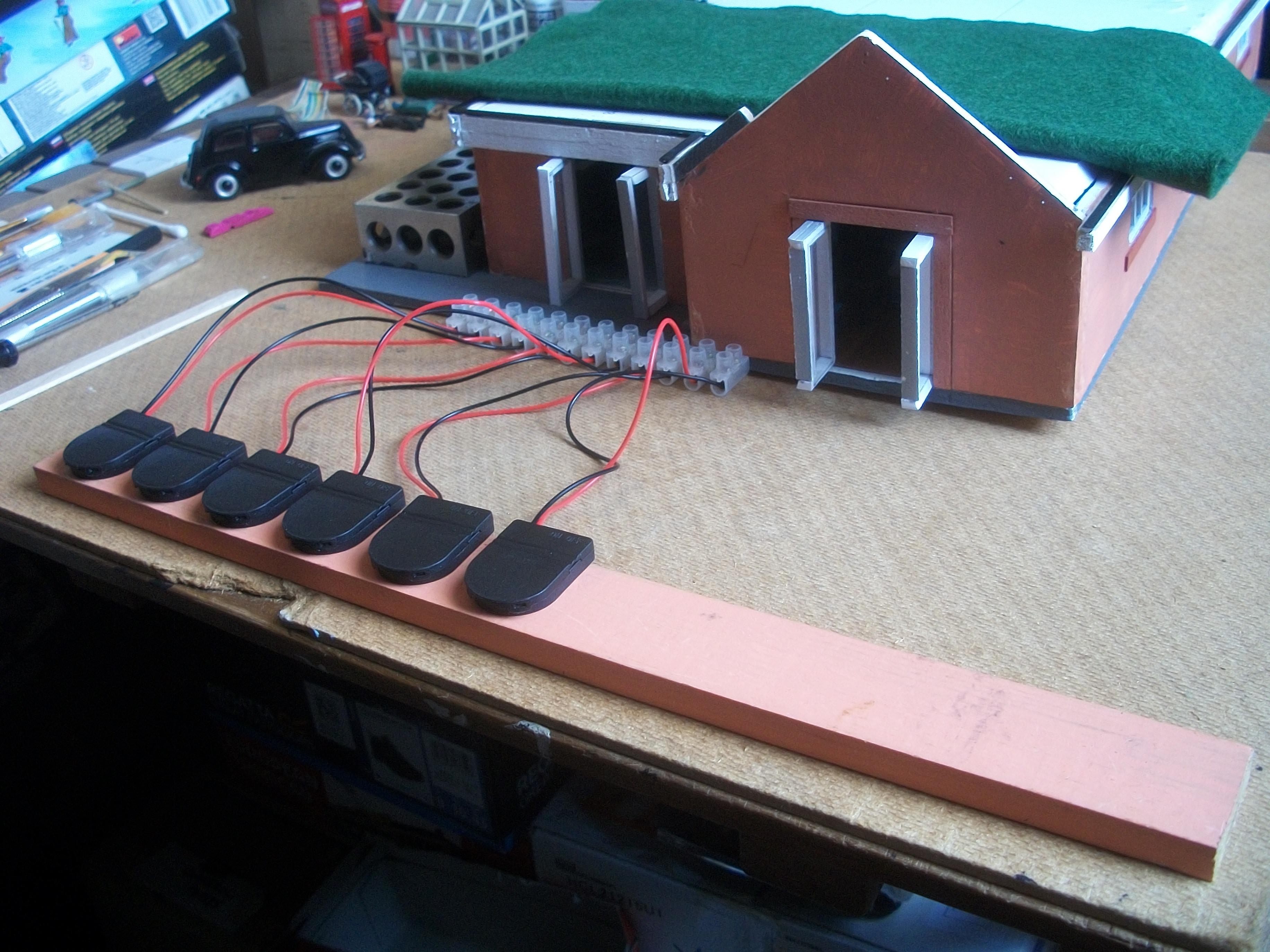

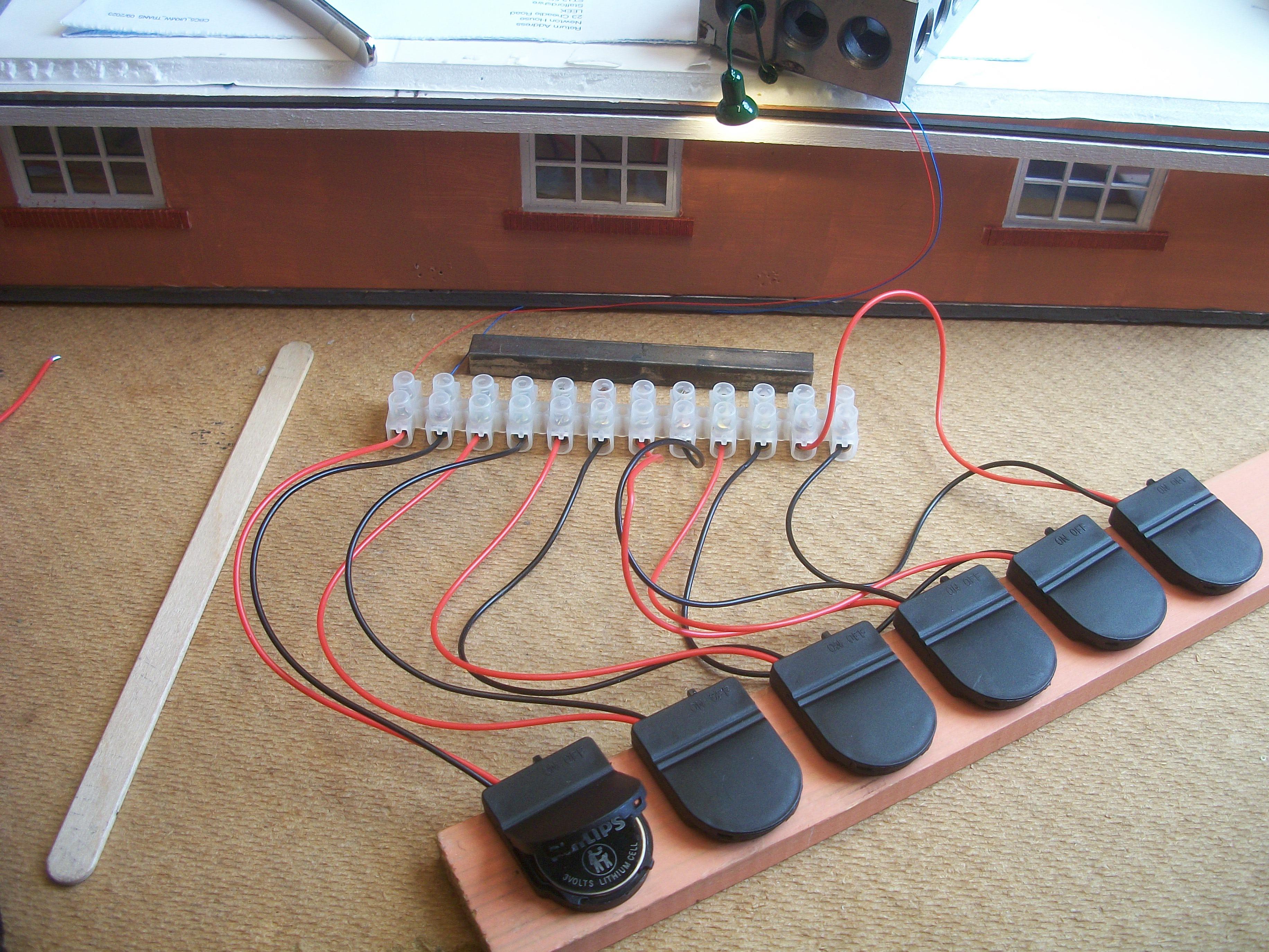

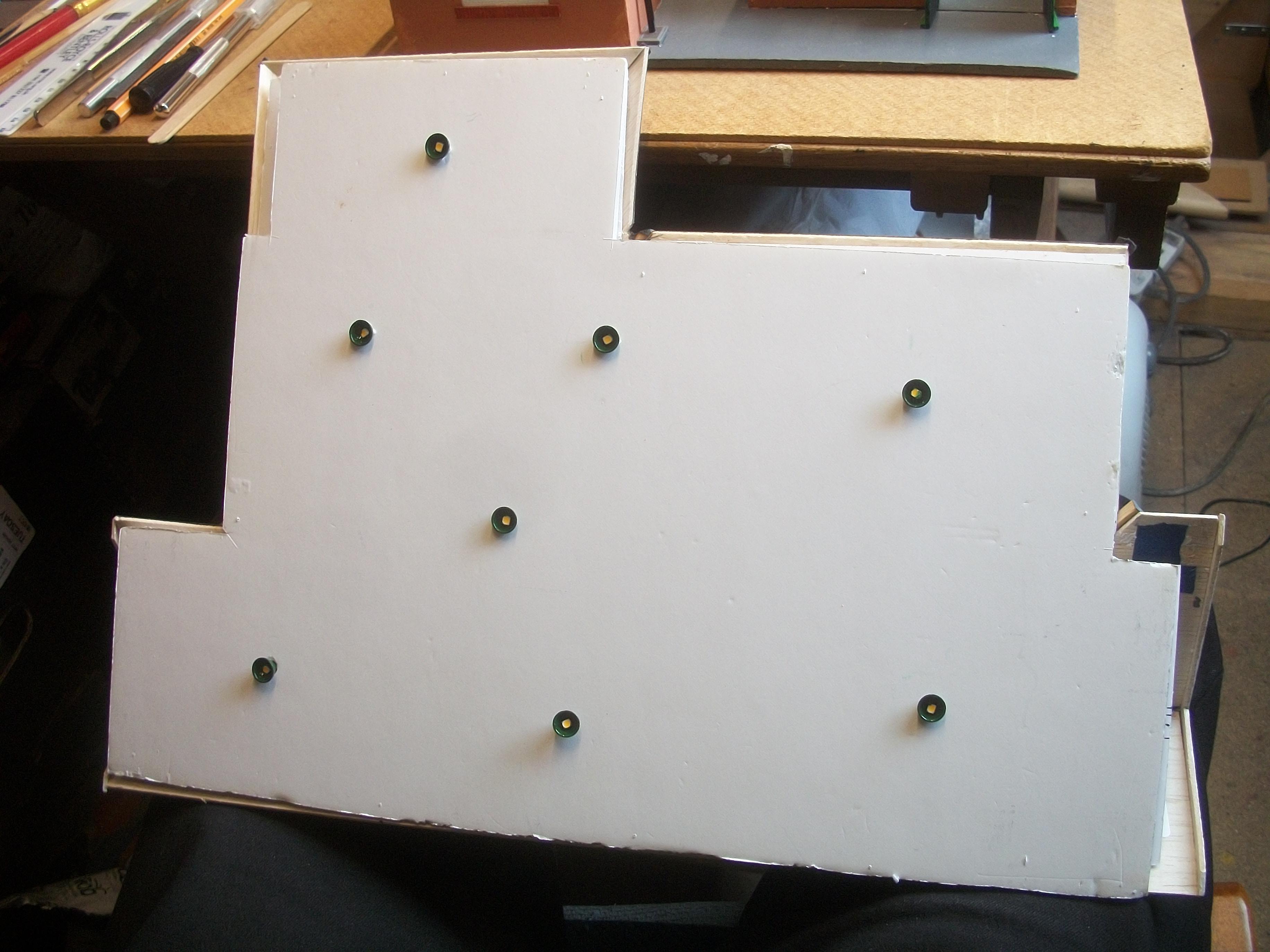

Today I managed to wire up six of the eight battery holders, with all twelve ports on the terminal block screwed tightly . . .
Also, having thought about the wiring coming out of the back of the bungalow where the two sets of French doors are, I think it would be better to have the sixteen wires making their exit on the long side of the bungalow, where there are three windows . . . As well as providing more space for the wooden switch panel and the two terminal blocks, I came up with the idea to cover the switch panel and the blocks with a sheet of green felting material. This green felt can simulate a grassy area, as well as hiding the wiring components from view . . .
David

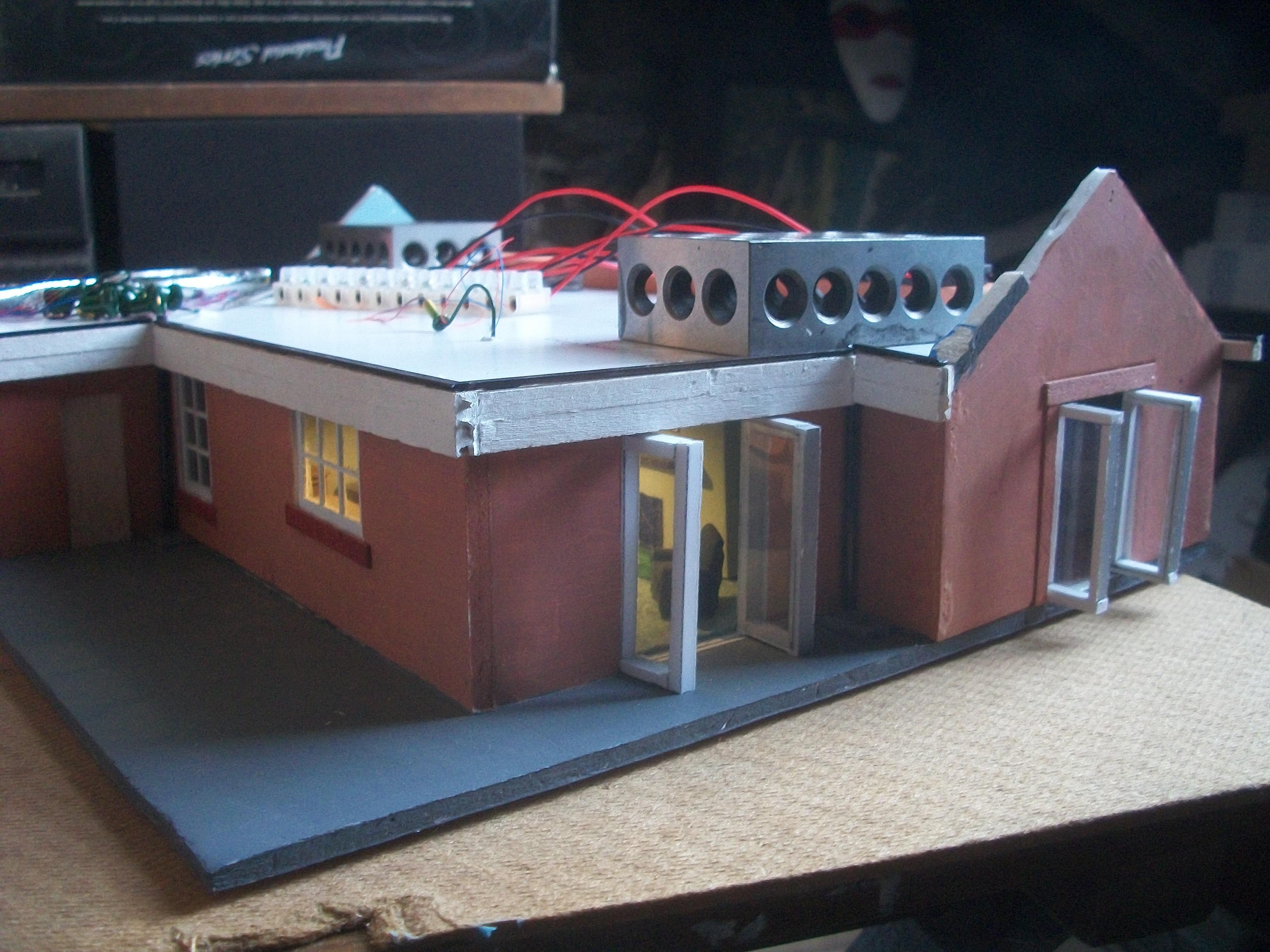

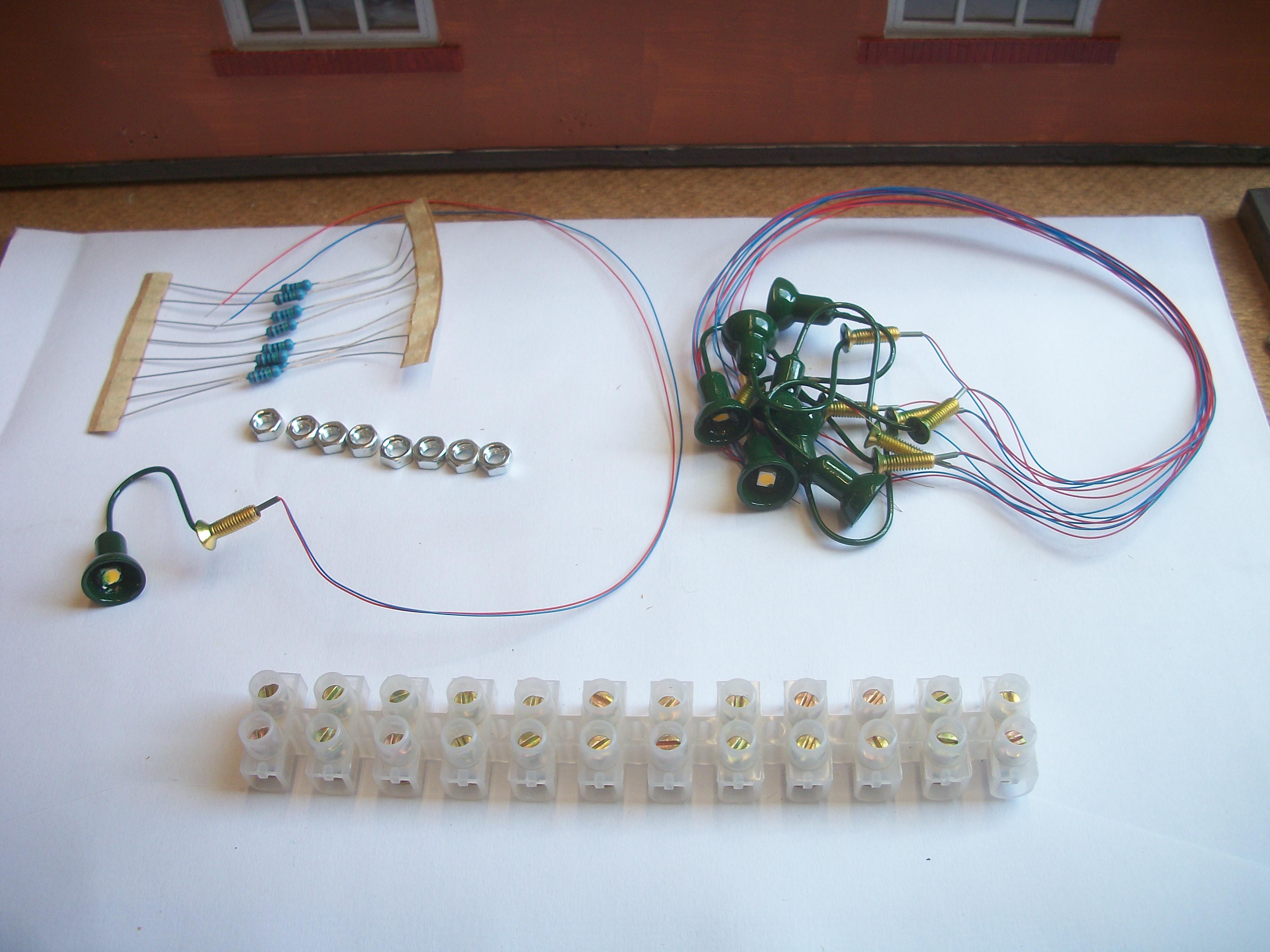

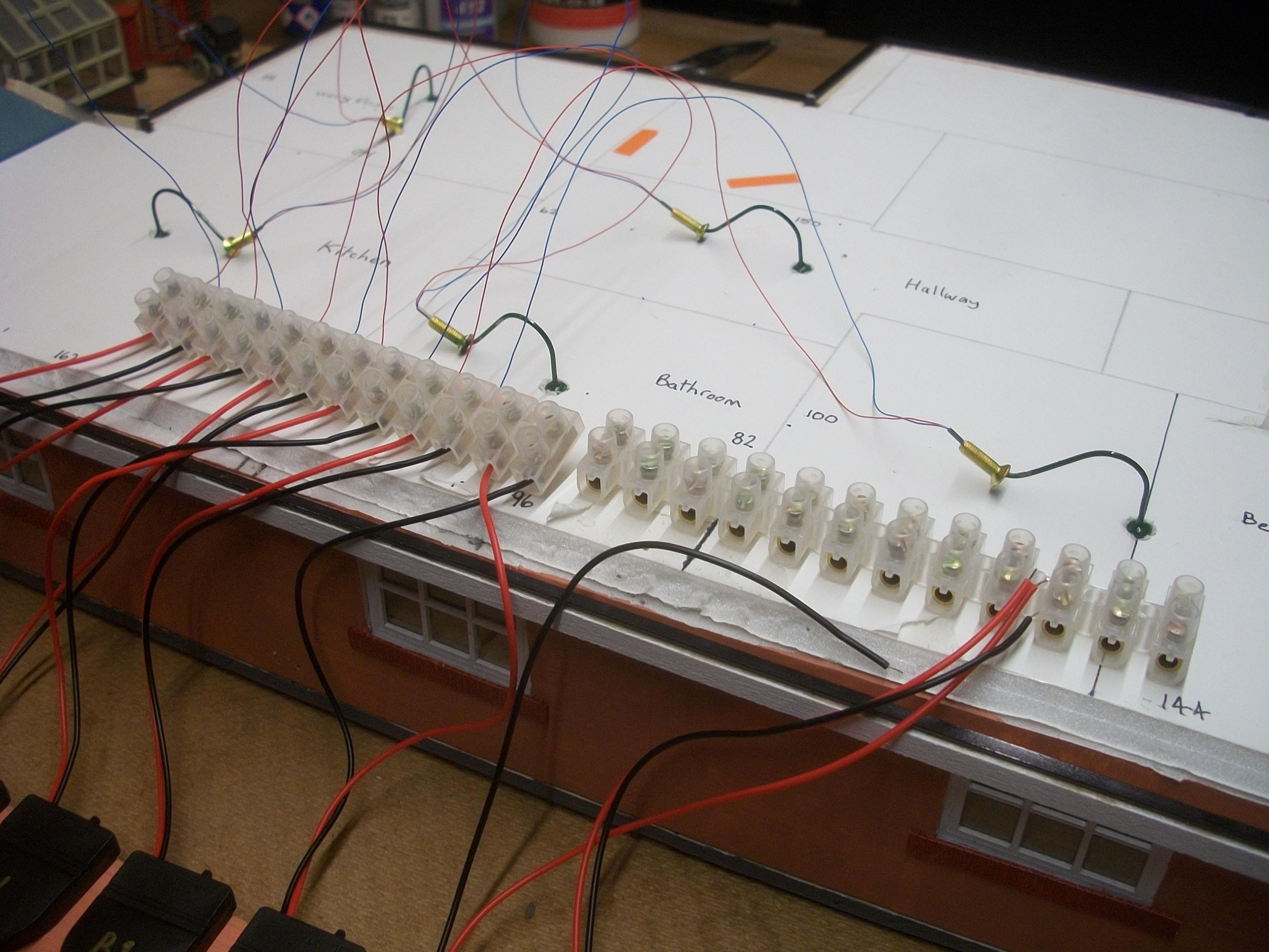

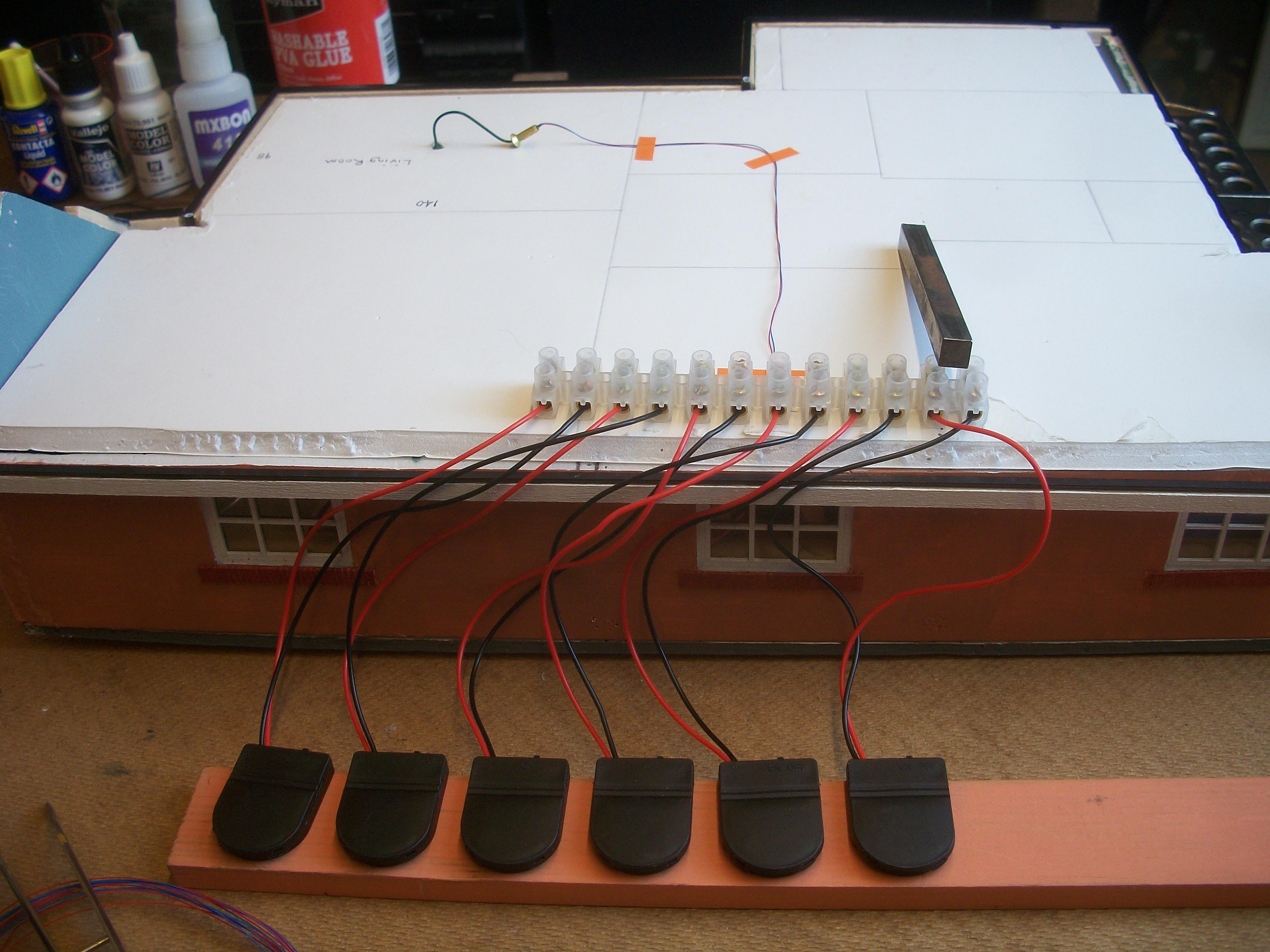

The eight lamps, resistors and wiring arrived today . . . These resistors are only required if using 12V DC model railway voltage, and reducing to 3V, but I am using 3V coin cell batteries as my power supply anyway.
The lamps are quite nice, but they have a couple of bends in the tubing, and also a screw that is fixed to the tubing with something strong. Setting up the living room lamp to get things started this morning, I found that by having a good sized hole in the ceiling panel the wiring and the screw head could pass through from underneath, and then by bending the tubing carefully the lamp pushed into the hole . . . Once wired up to the terminal block, this first of eight lamps lit up nicely.
The Ebay photos were a bit misleading, and the wires are not that long, which means the terminal blocks will most likely have to be mounted inside the roof of the bungalow . . . I am toying with the idea of cutting the 12 port terminal block into 6 separate blocks of two ports, so one for each pair of wires that feed each lamp. Not sure if this will happen just yet . . . I could then do the same with the second terminal block, to provide two blocks of two ports, feeding eight lamps.

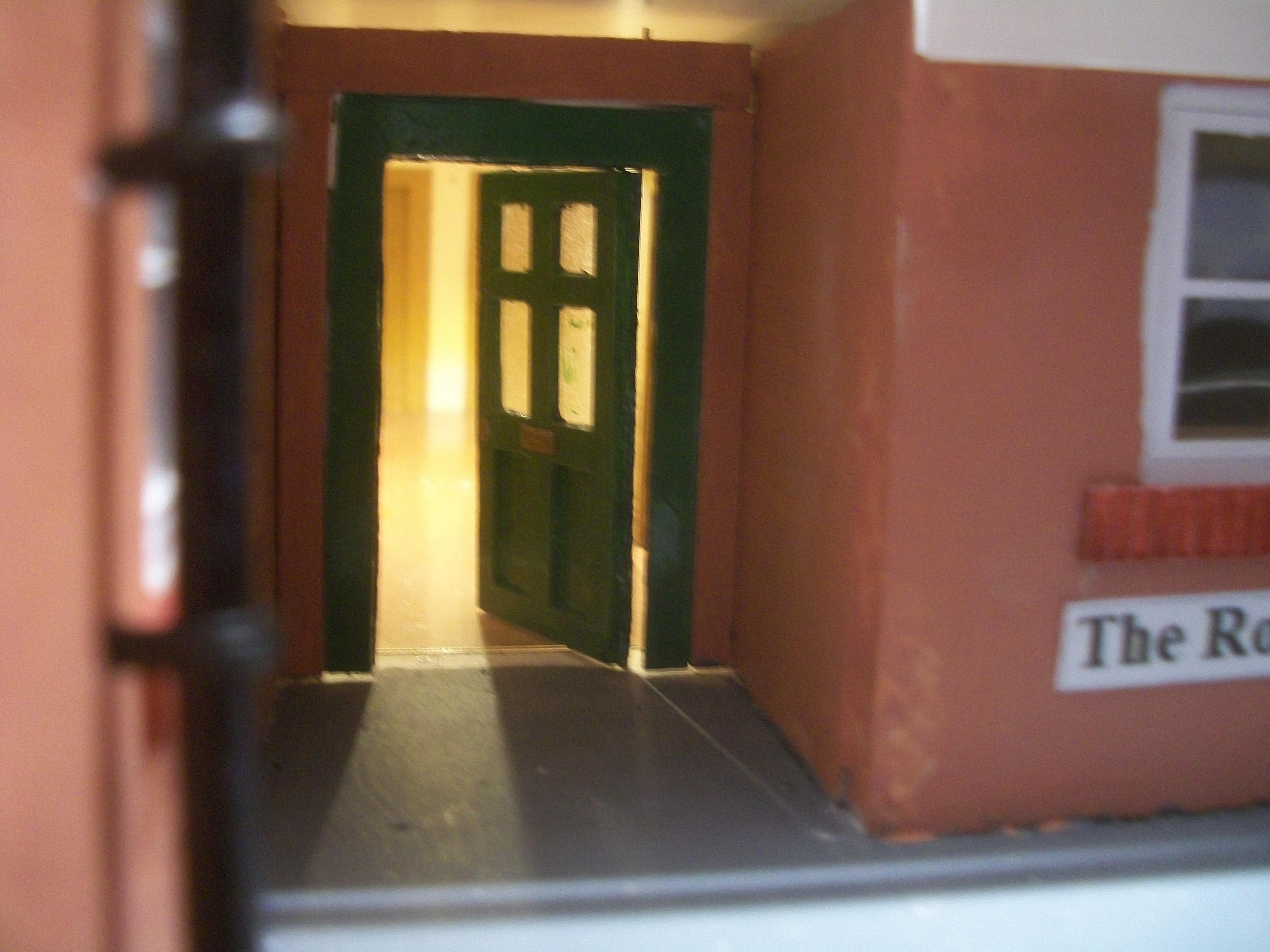

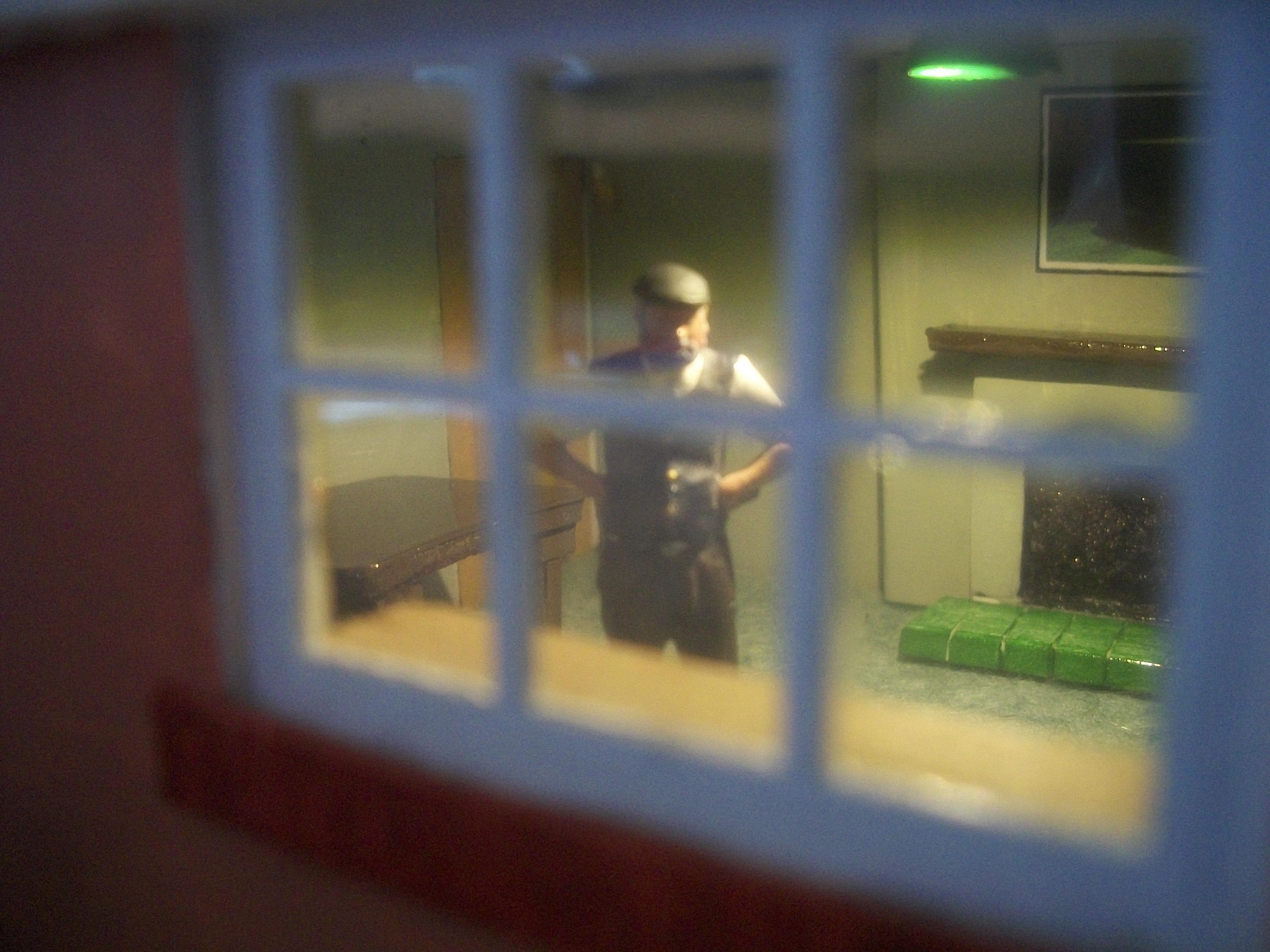

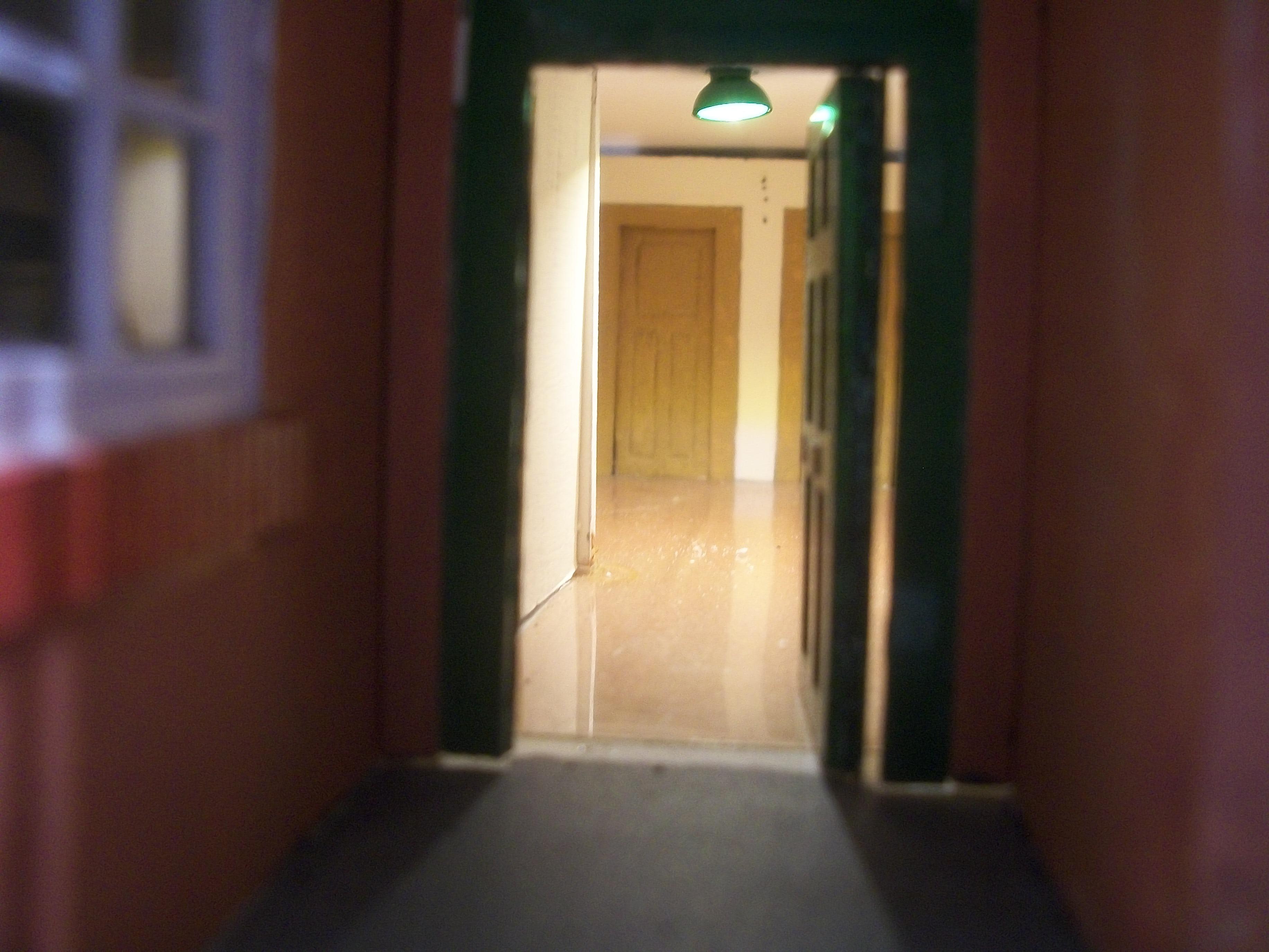

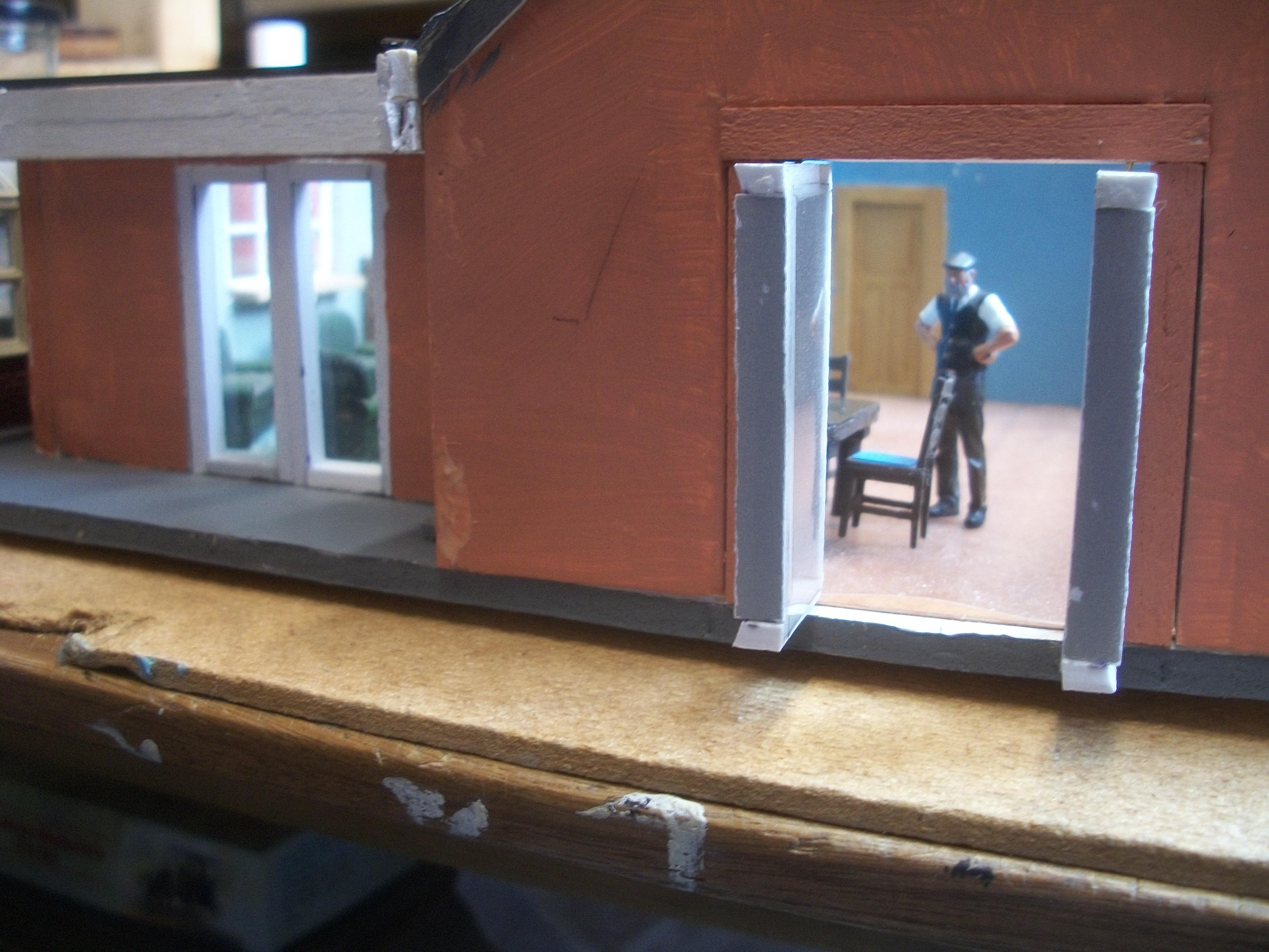

The photos taken later today have turned out pretty good, particularly the ones taken through the French doors. The furniture looks real and Harold appears to be part of the room . . . It will be necessary to cut out sections of the roof structure baseboard to accommodate the bends in the tubing of the lamps, and possibly the terminal blocks as well.
Although the wiring is a bit tricky, I should be able to figure out the best way of doing this . . .
David

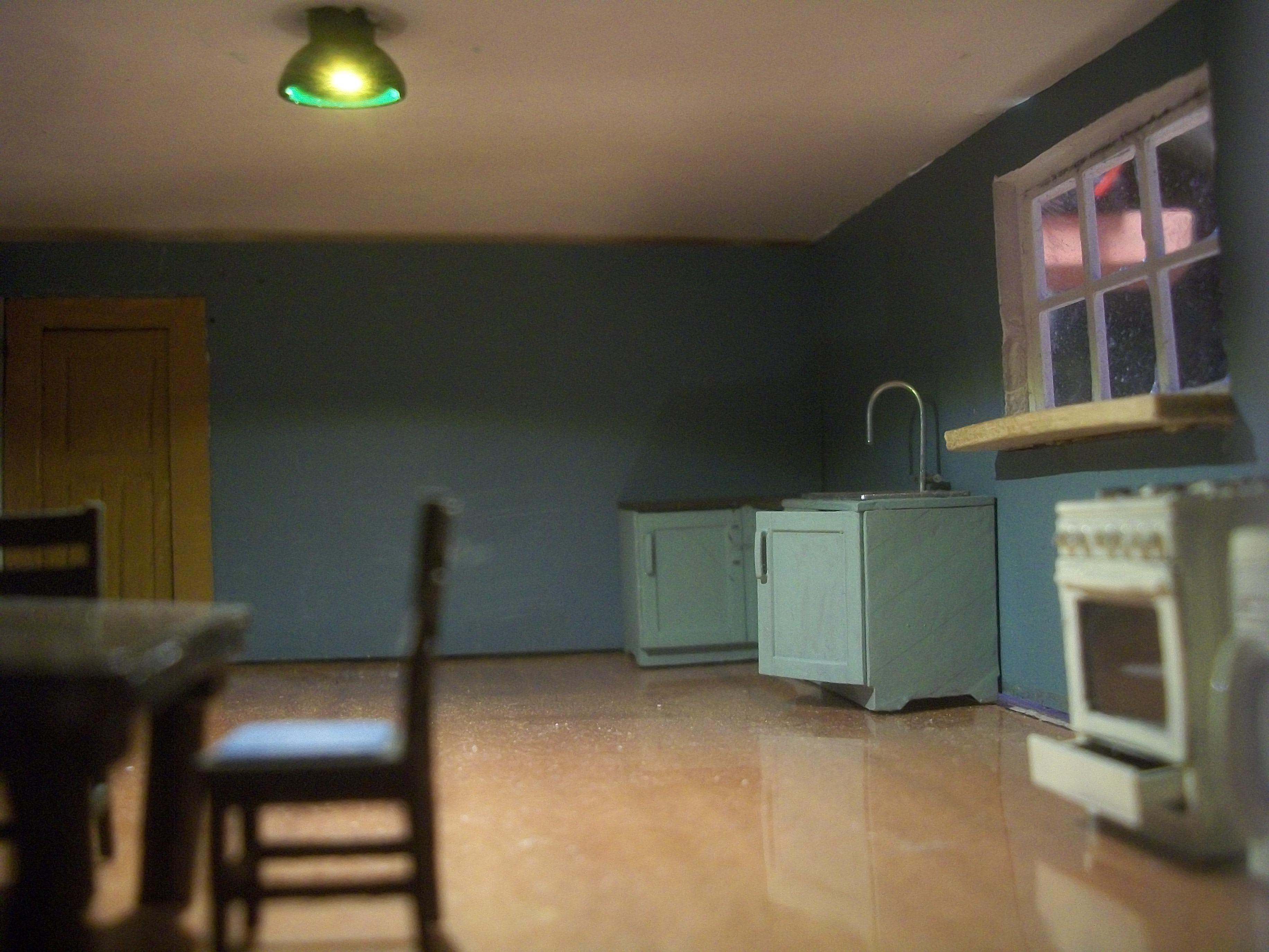

Using the same method as with the living room, the kitchen ceiling lamp was fitted in the same way . . . Tonight there were three further lamps fitted, these being the bathroom, the hallway and bedroom one. All five lamps were wired up to the first of two terminal blocks, and then tested for switching on and off . . .
There are three more rooms to light up, these being bedroom two, bedroom three and the garage . . .
I think I shall most likely not have the strip of wood for the battery holders, but instead mount the battery holders / switches directly onto the top surface of the ceiling panel, and also mount the two terminal blocks onto the ceiling panel. This will require a cutout aperture in the baseboard of the roof structure above, to allow the roof to sit correctly over the switches and blocks . . .
I used a gold Sharpie to give each switch a letter, indicating L for Living Room, K for Kitchen, B for Bathroom, H for Hallway, B1 for Bedroom 1, B2 for Bedroom 2, B3 for Bedroom 3 and G for Garage . . .

Availability would not be a problem Paul, but I can see a problem with those switches, in terms of how they would suit my build . . . The body of the switch needs to be inserted into the base, which in my case is only 5 mm foam board. That would place more than half the body of the switch inside the room below. Most of the switch would be visible as you look up at the ceiling from inside the room of the model bungalow . . . I agree that these switches would be good for a car, truck or industrial equipment application, but not really for scale model use.
Thanks for the suggestion anyway Paul, and I reckon these coin cell battery holders will be fine, once they are mounted on the ceiling panel top. Only the lamps are visible from inside the rooms, while the switches and terminal blocks are hidden from view, on the topside of the ceiling panel.
David

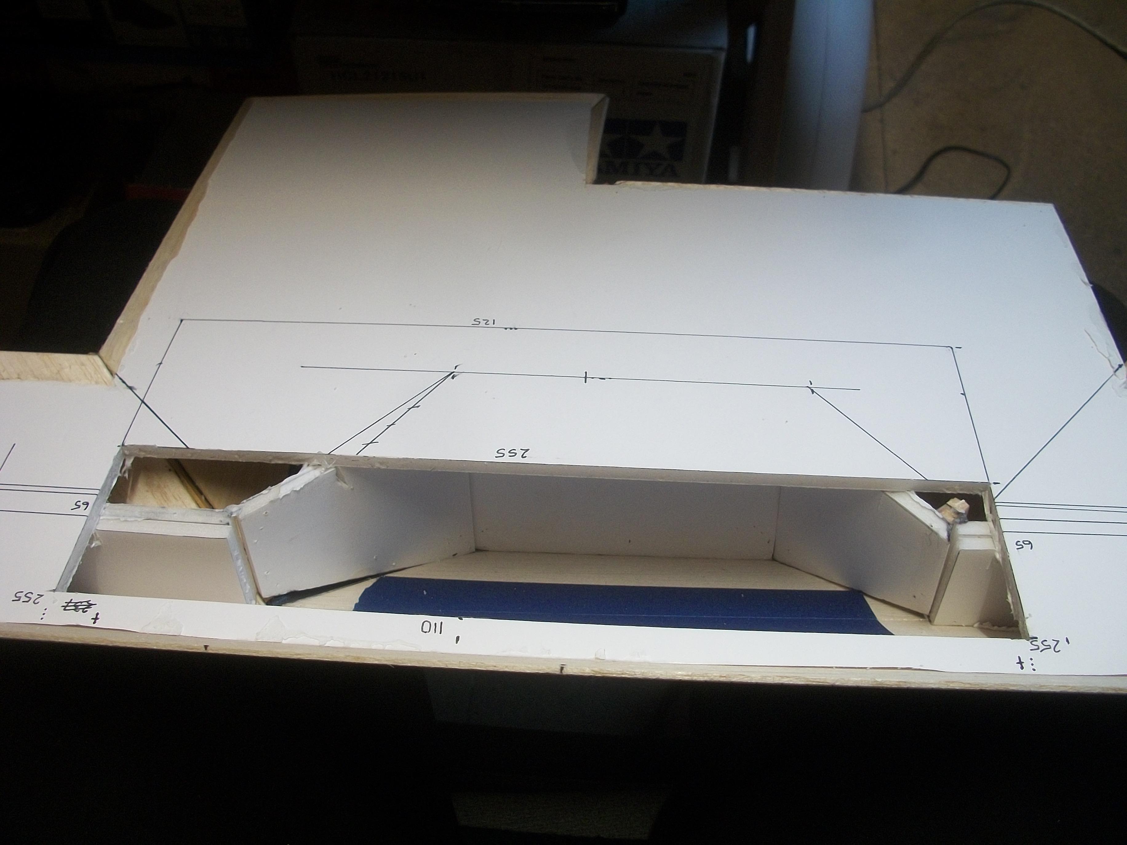

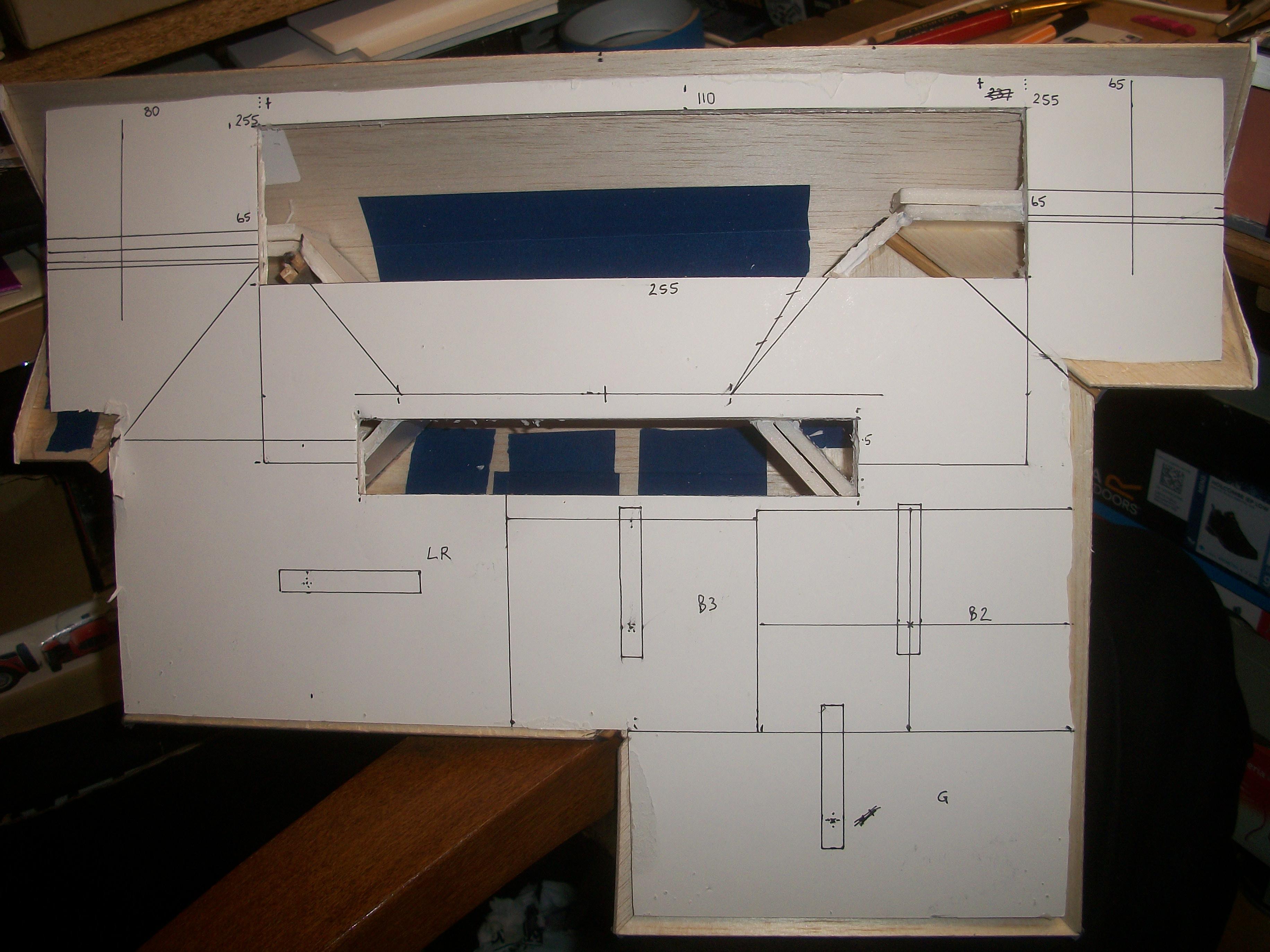

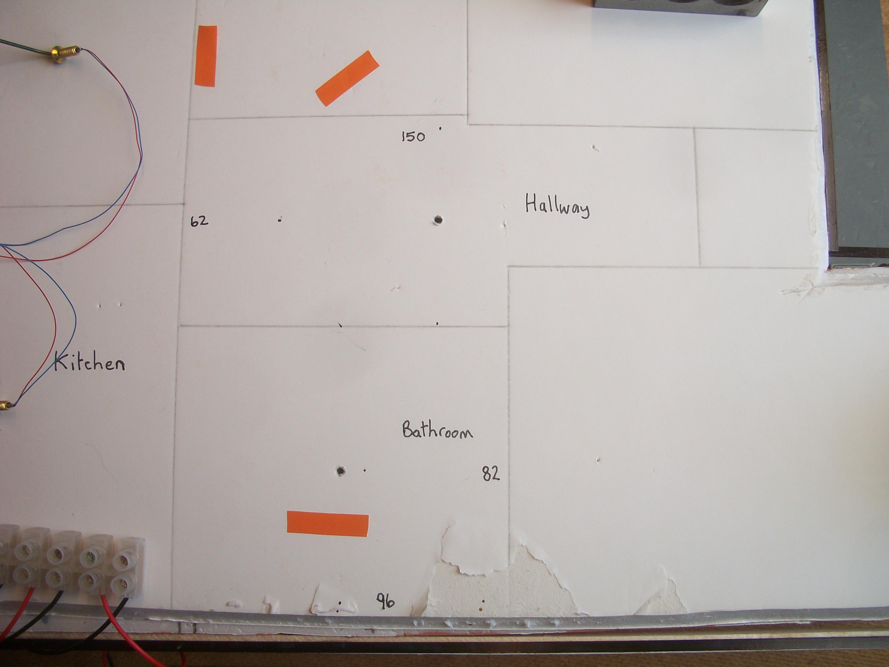

All eight rooms have working lights, and the second of the two terminal blocks has been cut down to save space, as it needs only four ports of twelve.

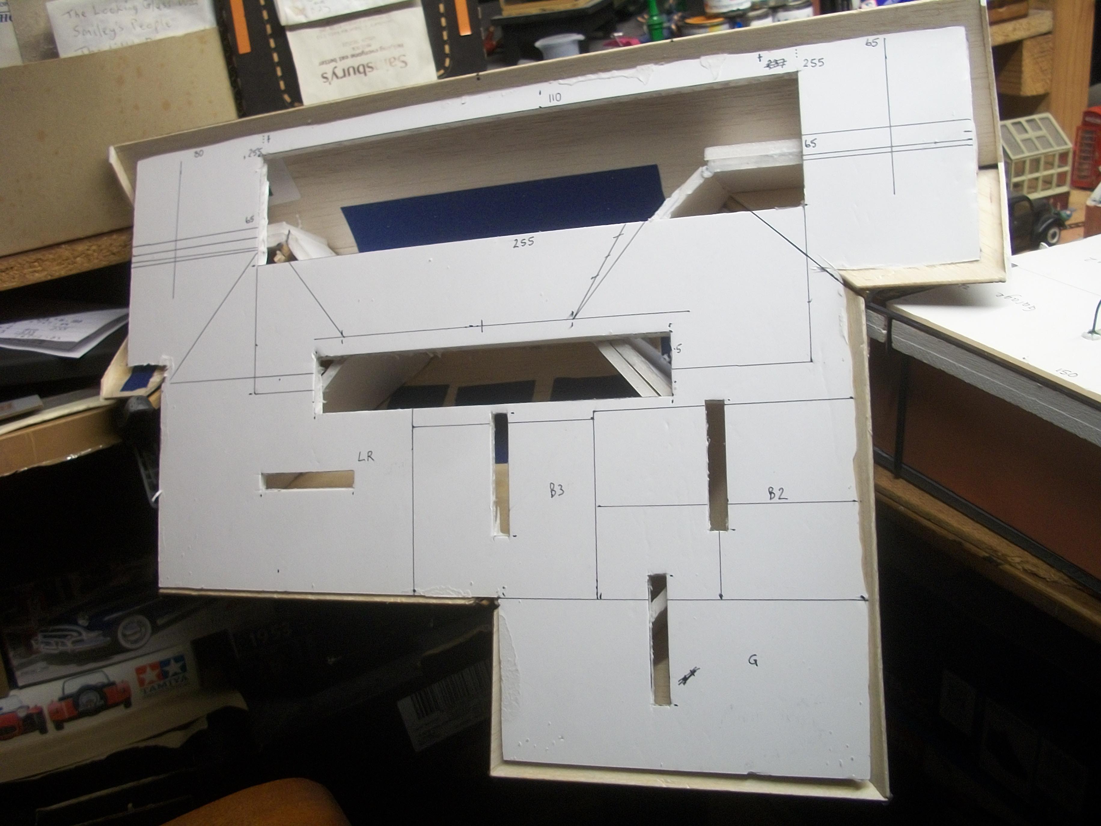

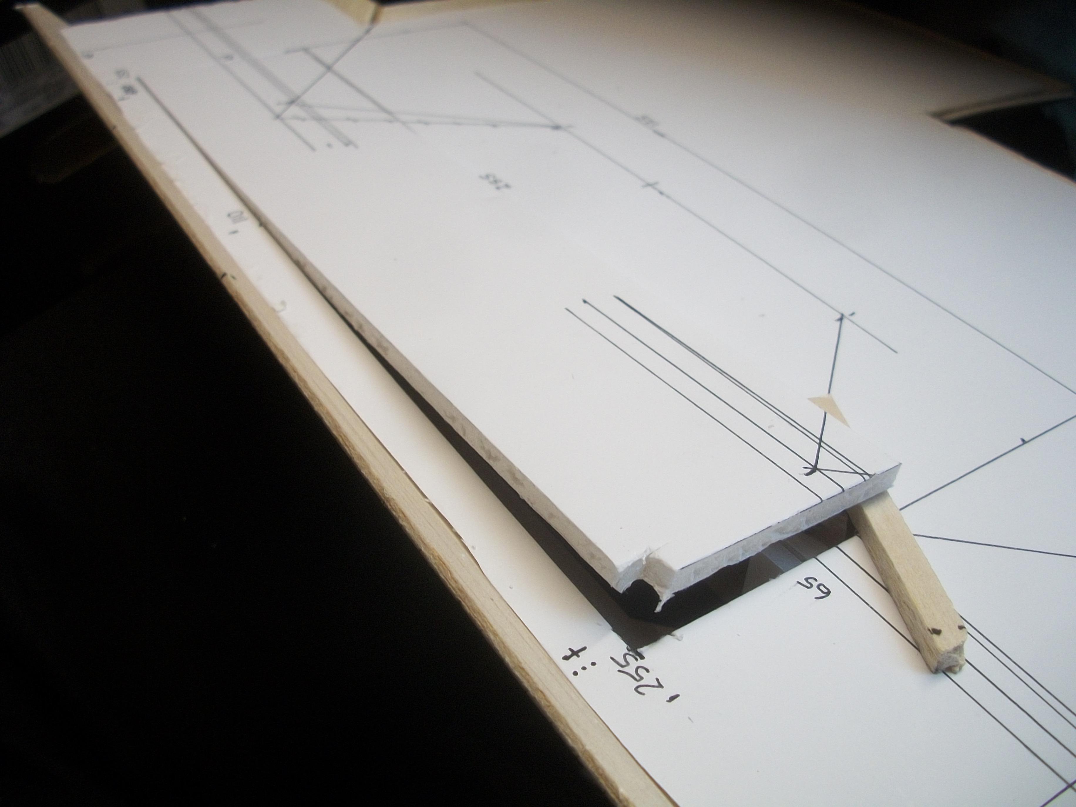

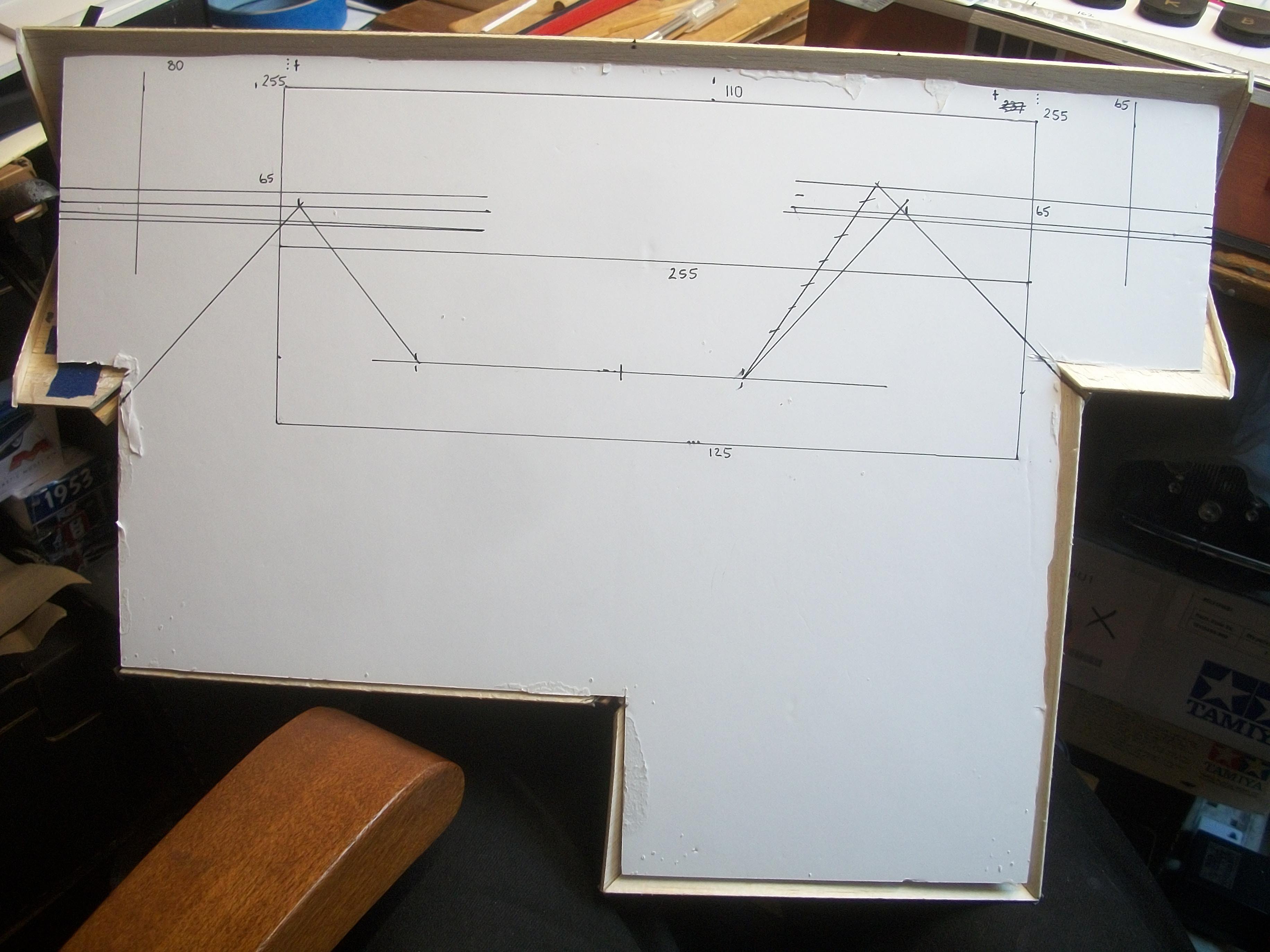

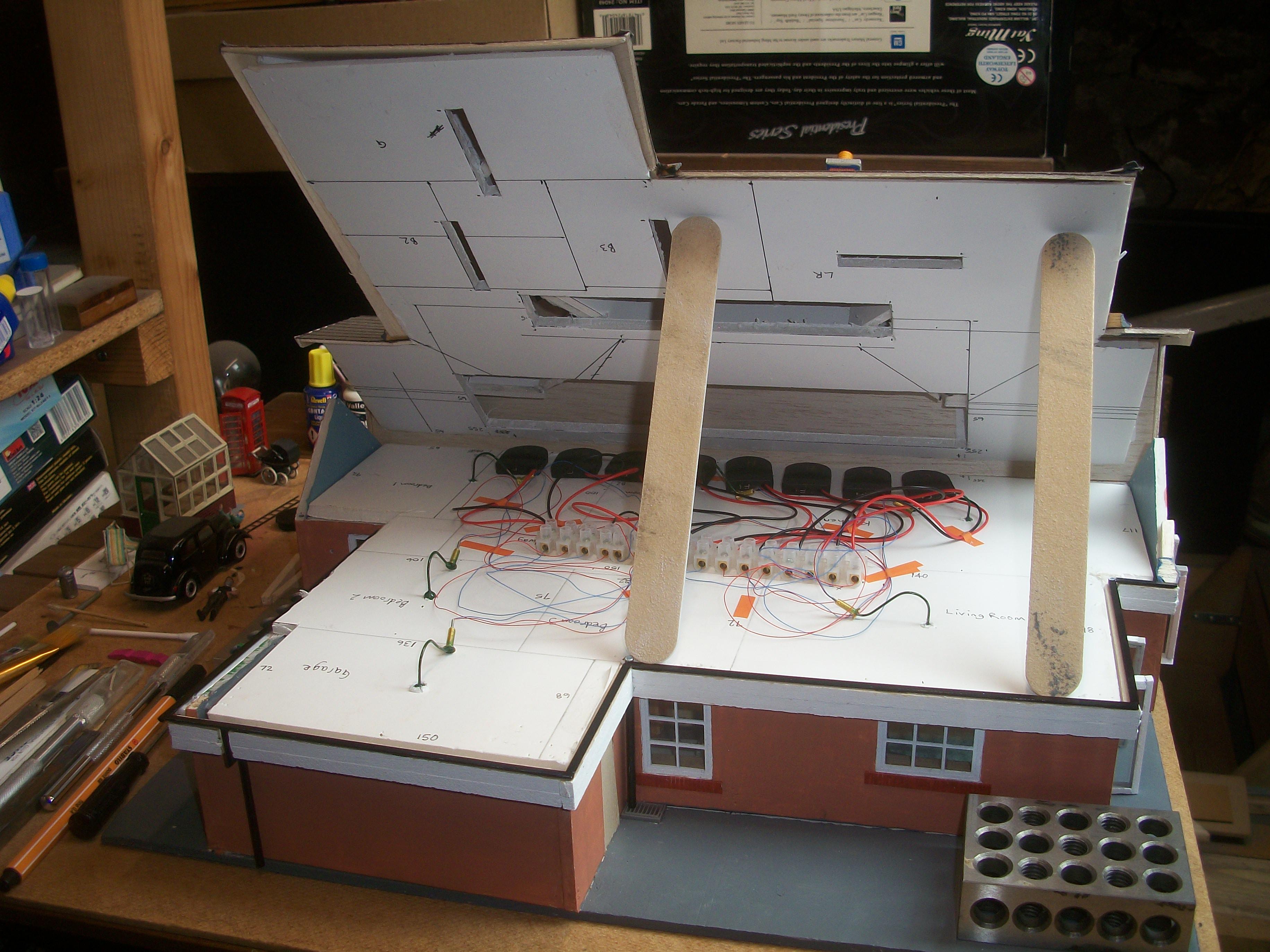

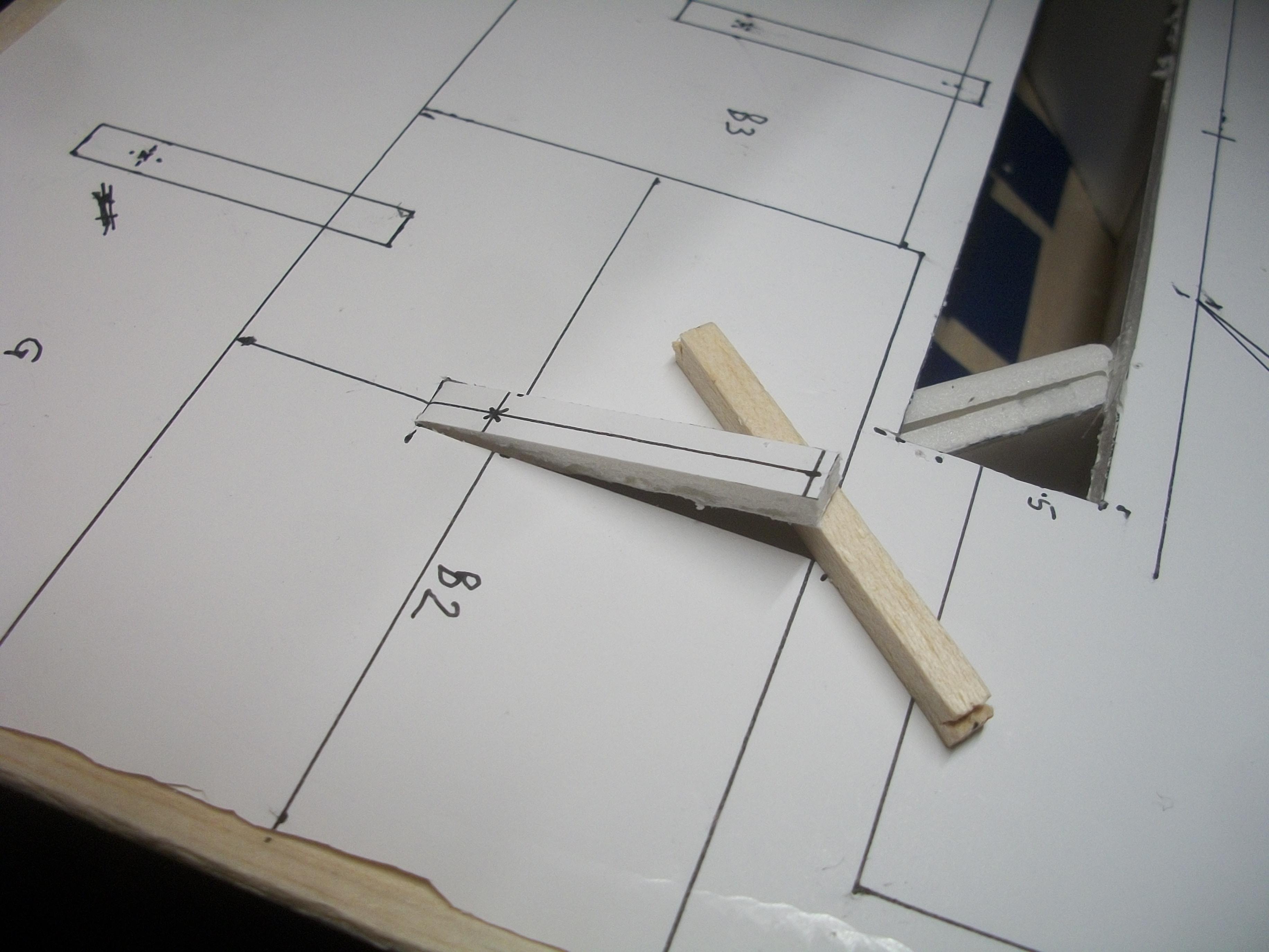

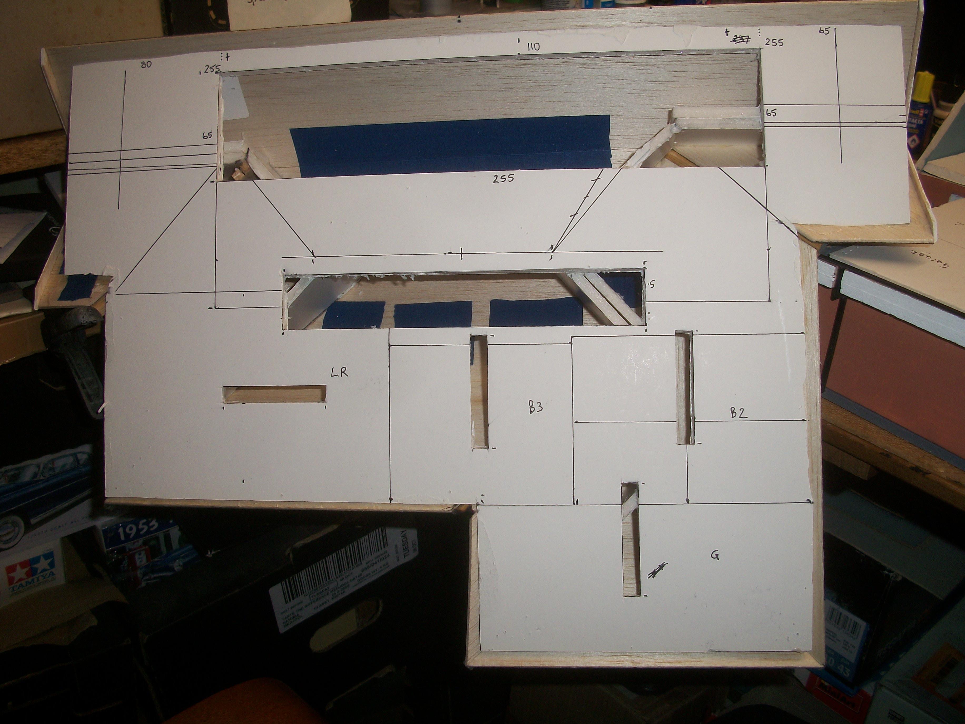

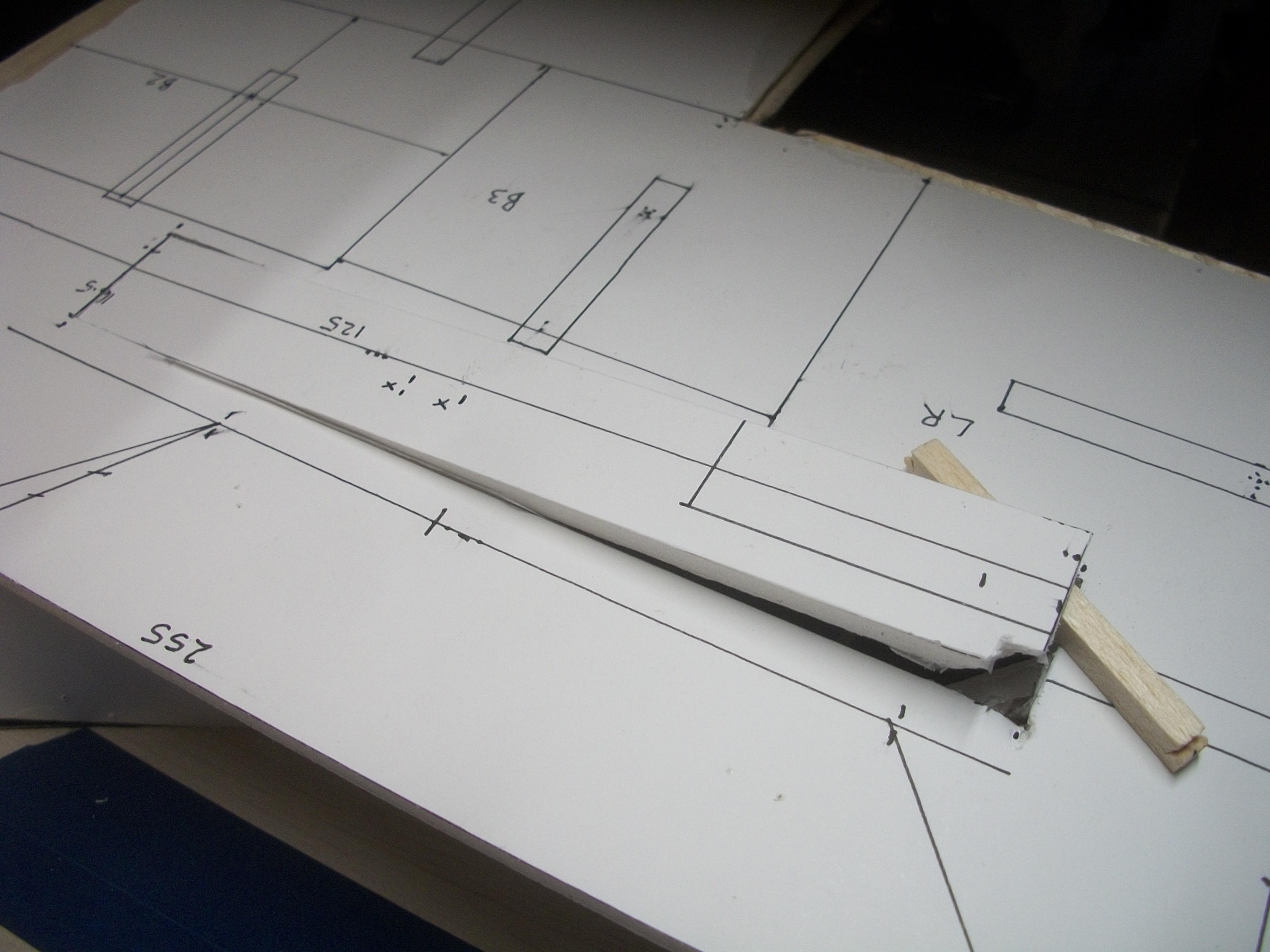

Then came the moment to tackle the roof structure baseboard panel . . . I was rather nervous about cutting into the panel, primarily because I could not be absolutely sure where the roof trusses were located, and I didn't want to compromise the overall strength of the roof structure . . . Following some careful calculating of the measurements and angles, I picked up the knife and decided to go for it . . .
As it turned out, this removal of the rectangular panel was entirely successful. I had been expecting the operation to be more difficult, but the end result is precisely what I wanted . . . The eight battery holders and switches, as well as the two terminal blocks are placed in their respective locations, and I need to cut out a second panel, plus four cut out slots to allow for the bends in the lamp tubes.
David

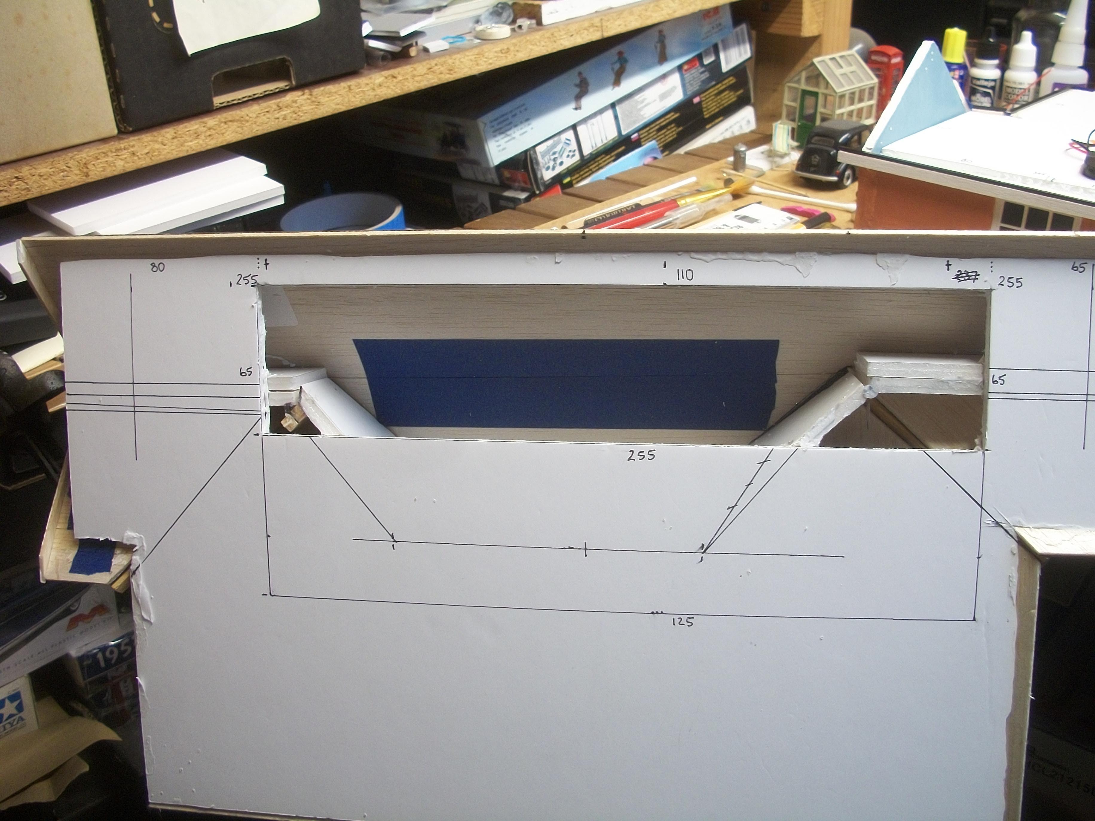

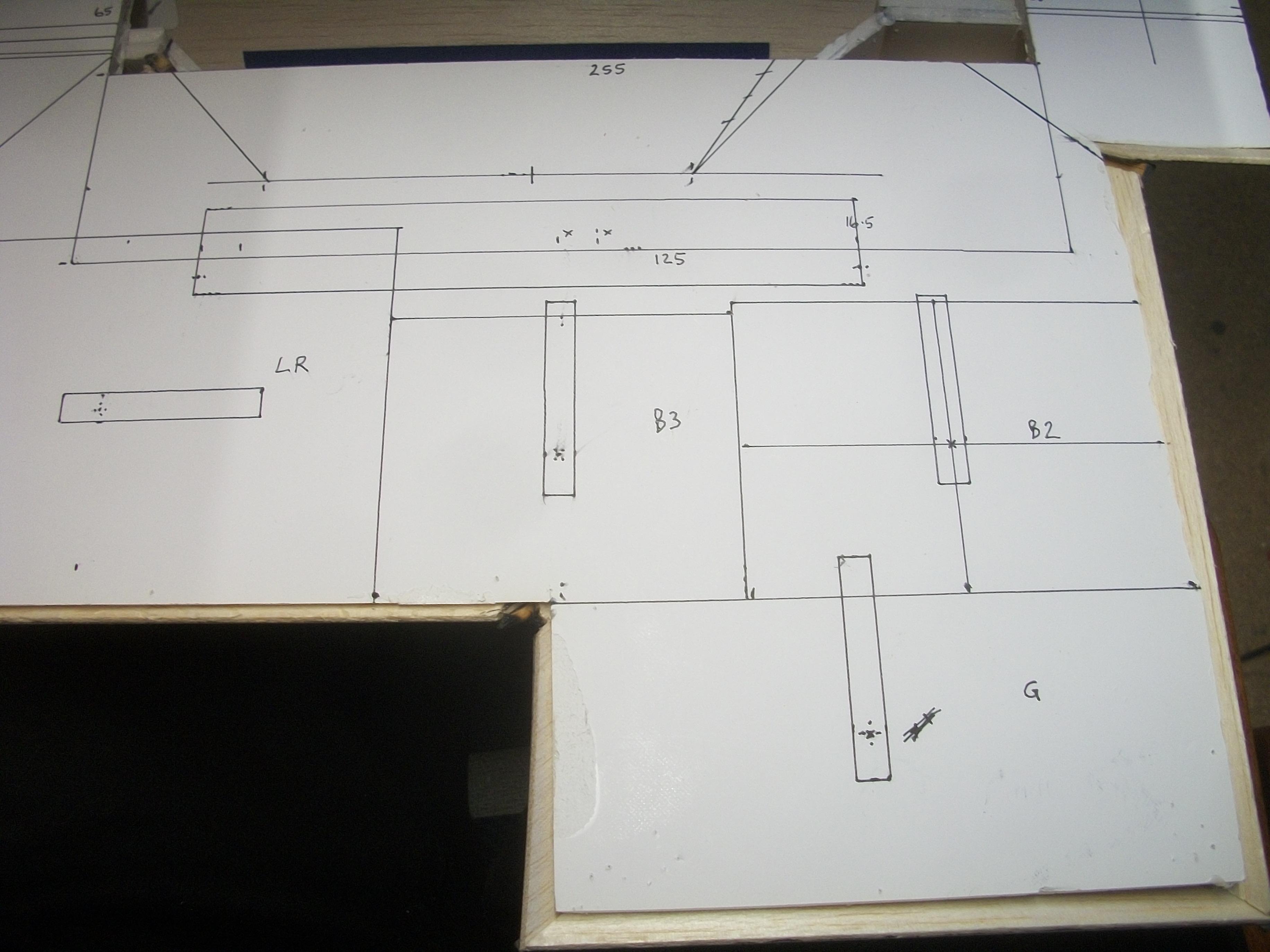

Feeling much more confident about these cutouts, I set about the remaining five cutout panels this evening . . . Having removed the largest panel yesterday, the second largest was removed today. This only left the four slot shaped smaller panels to be removed . . .
The whole process was straightforward, and I am happy with the result. Tomorrow, I shall fix the terminal blocks in place using double sided tape, and also check that all eight rooms have working lights, as the wires have been subject to a great deal of movement during the cutting out process . . .
Of course, the most important thing to check at this stage will be the fitting of the roof structure onto the ceiling panel. These cut out sections need to fit over the row of battery holders / switches, and also over the terminal blocks, as well as over the four lamp tubes and screws . . .
David

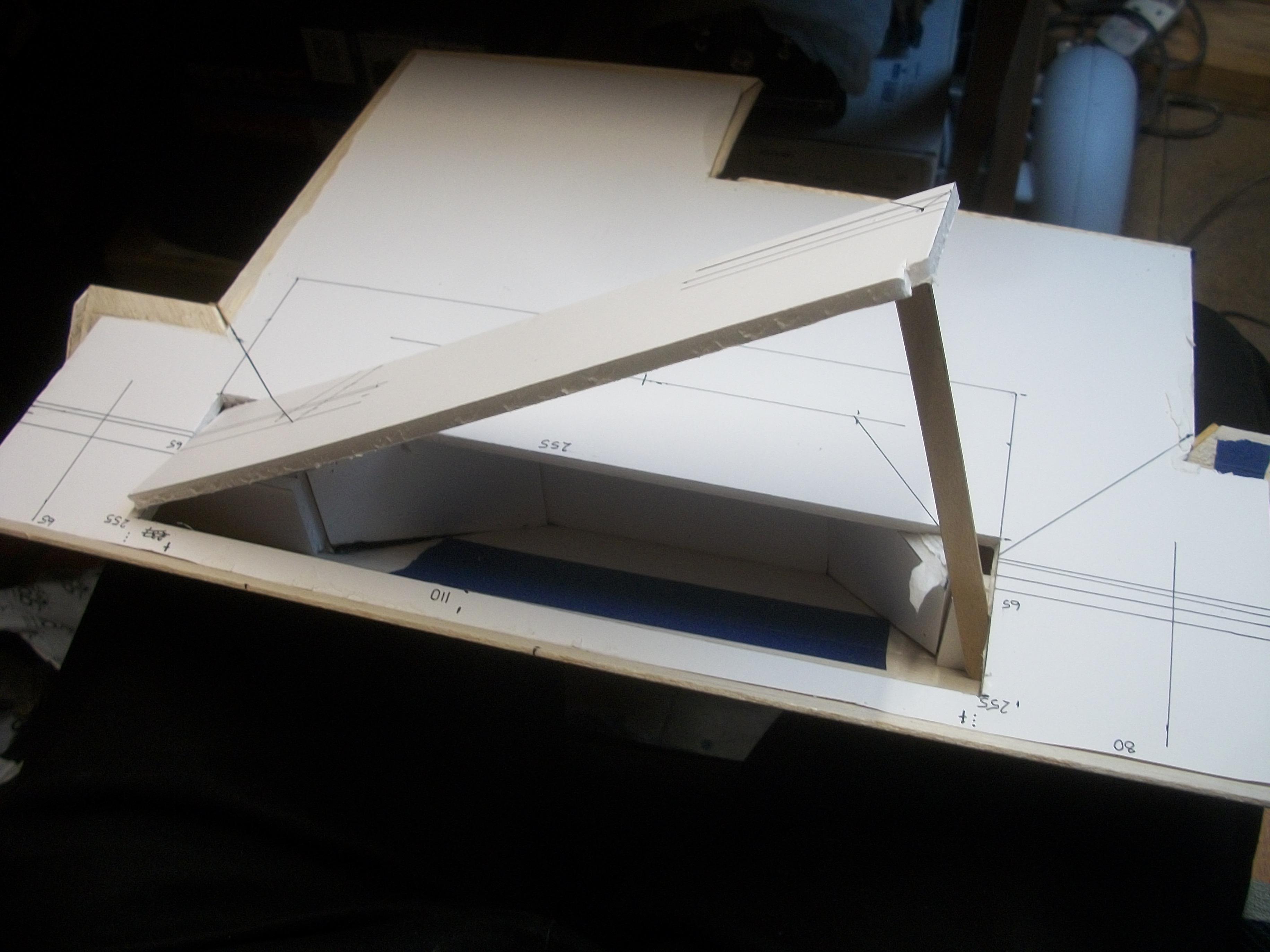

One whole day was spent enlarging some of the cutouts in the roof structure baseboard . . . Each one of these was somehow obstructing the objects on the ceiling panel, including the battery holders / switches, terminal blocks and the lamp tubes. Eventually I arrived at a close enough fit between the two panels to be acceptable . . .

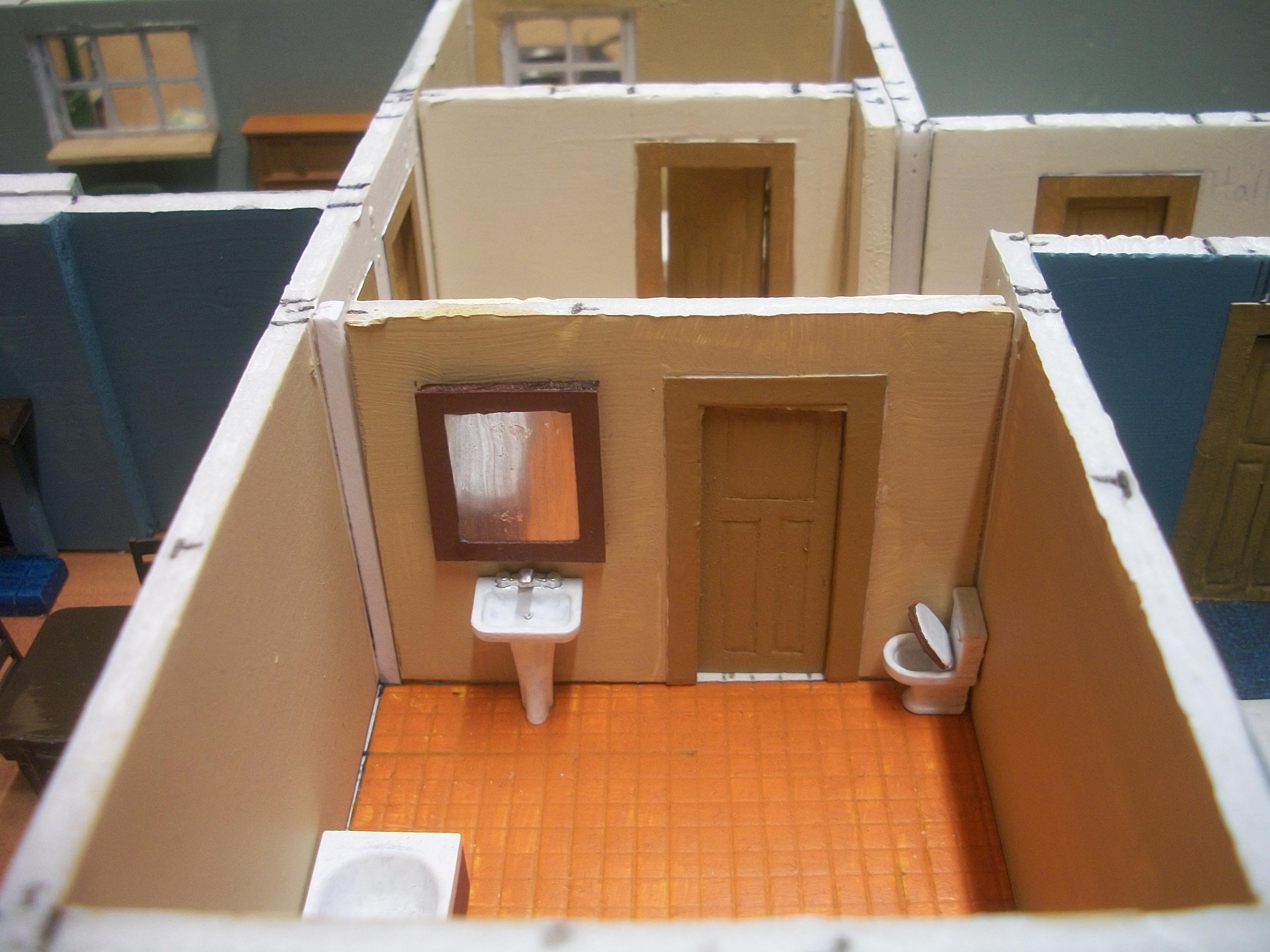

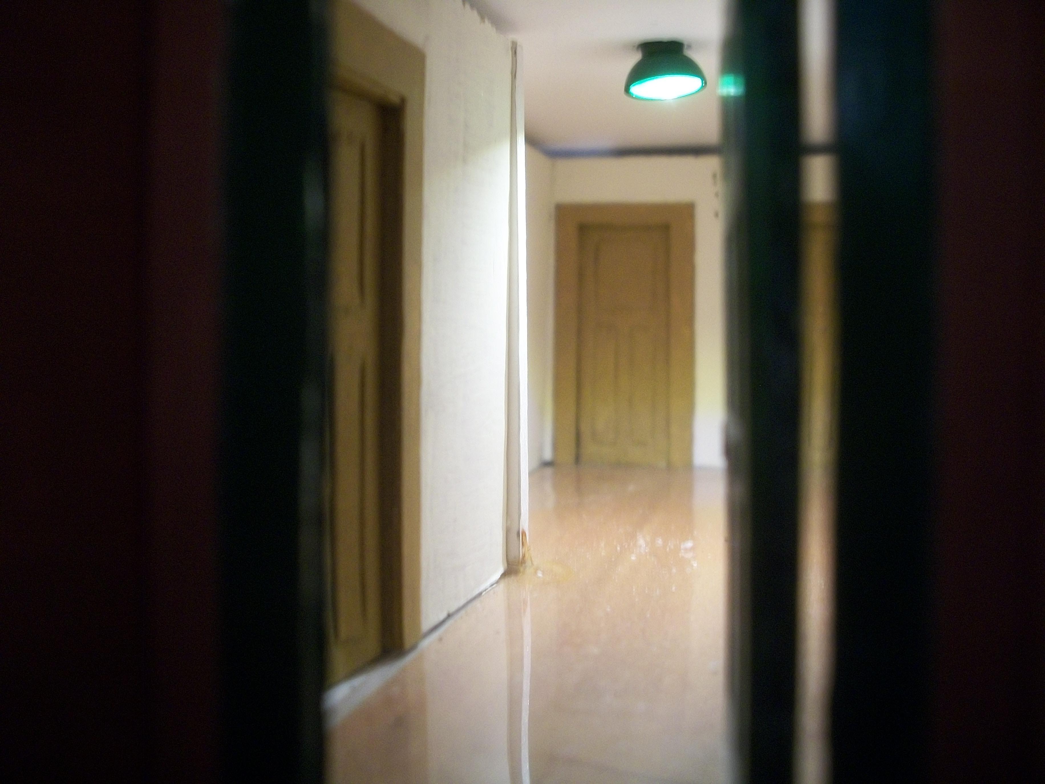

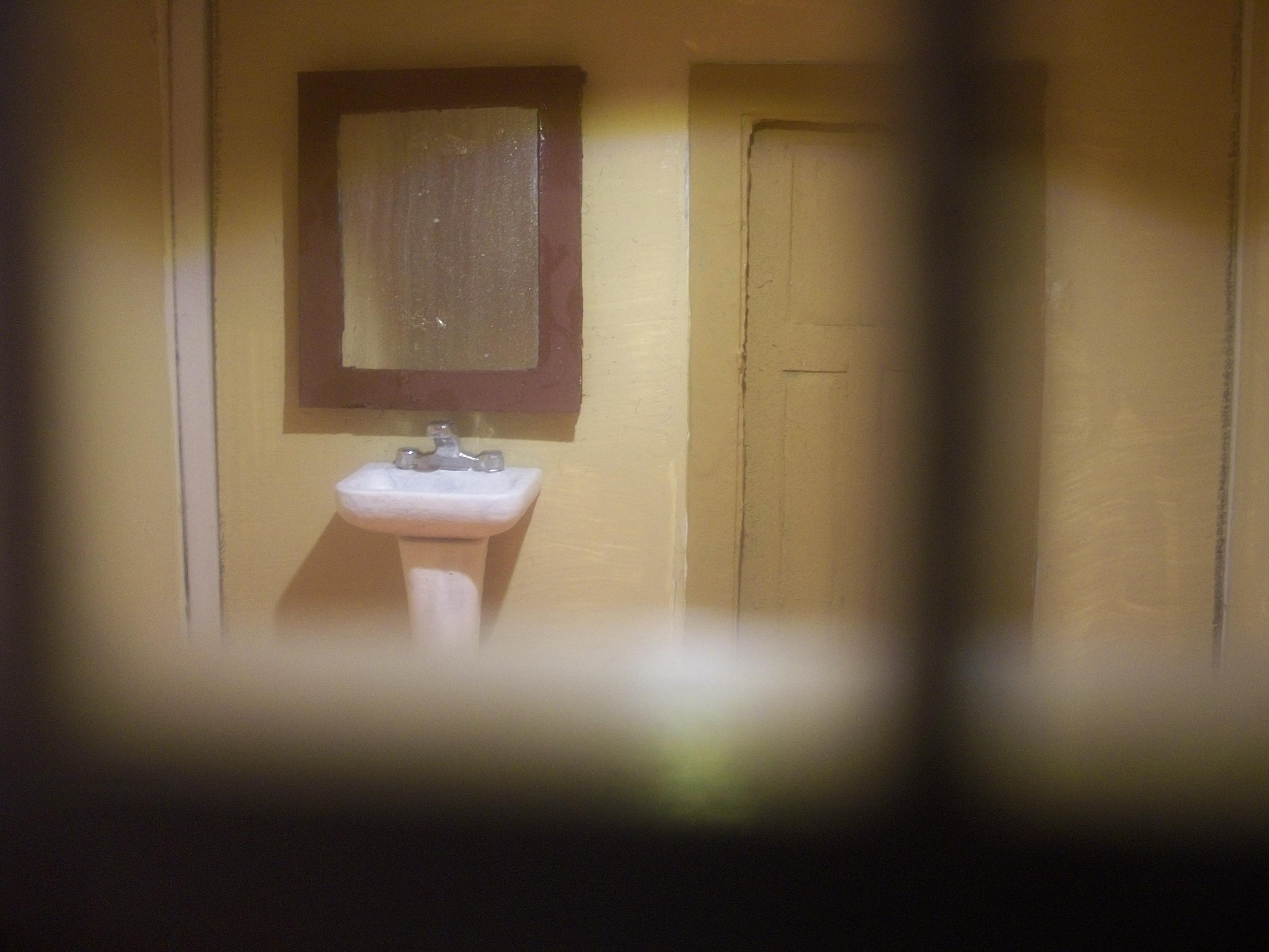

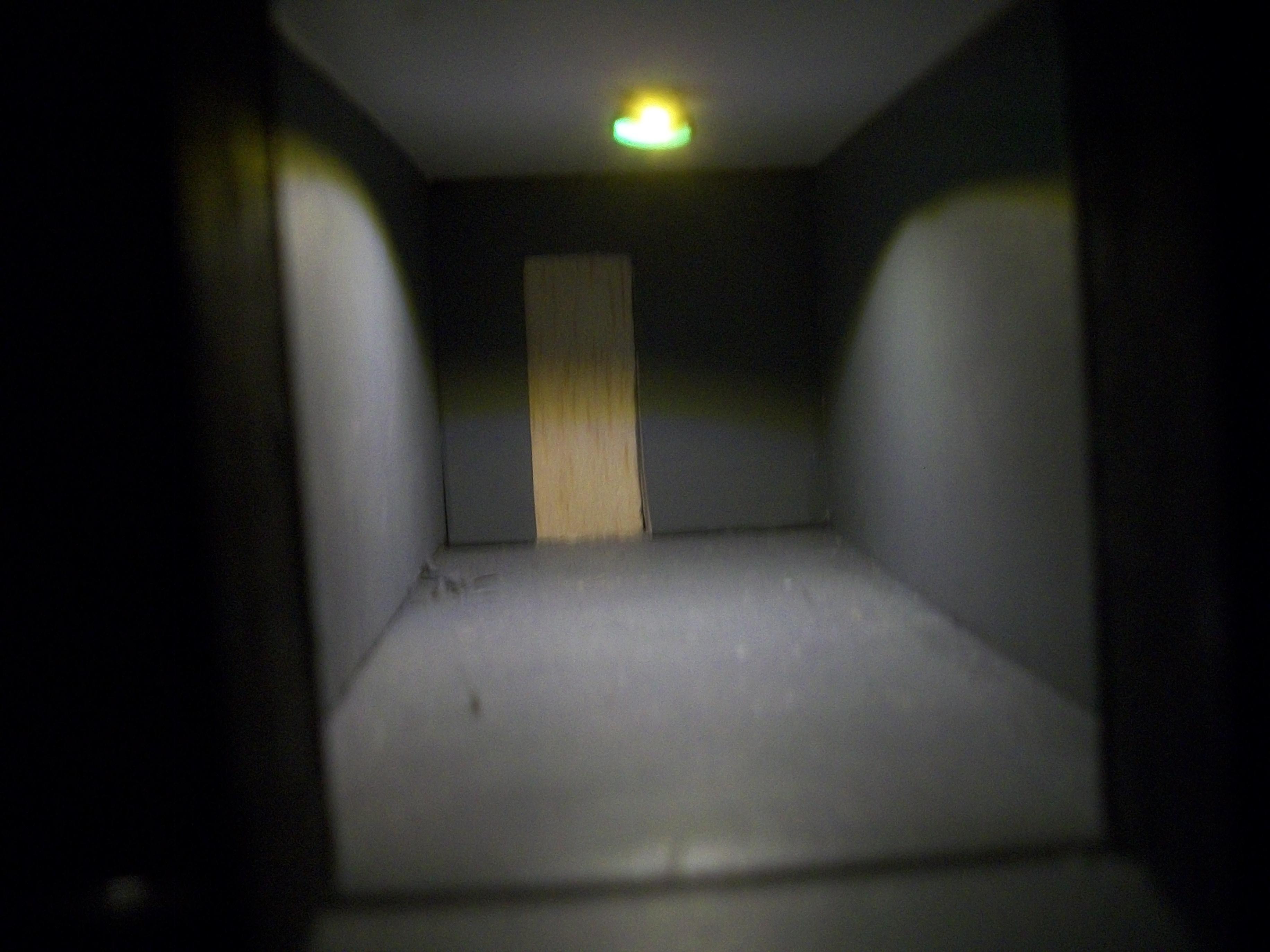

Then the roof and ceiling were removed as one unit, leaving me with access to the ground floor rooms assembly . . . Several further parts have been PVA glued to their correct position in their respective rooms, such as beds, one table, one of the four chairs, and the piano . . .

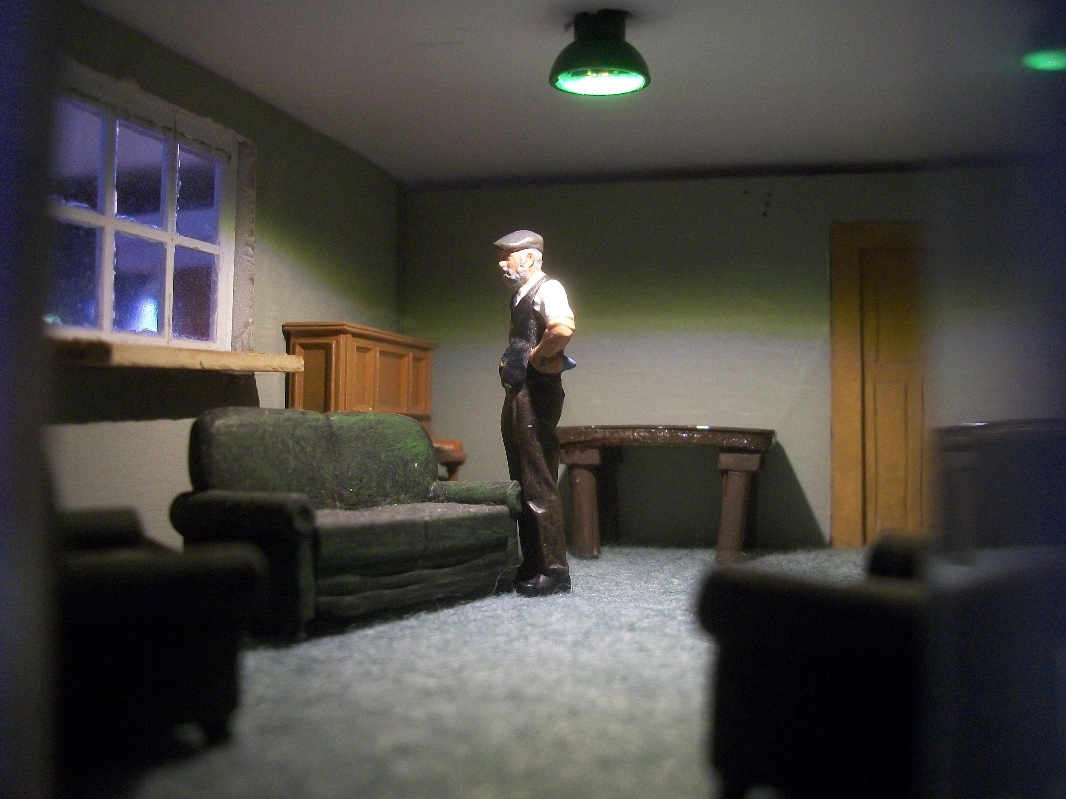

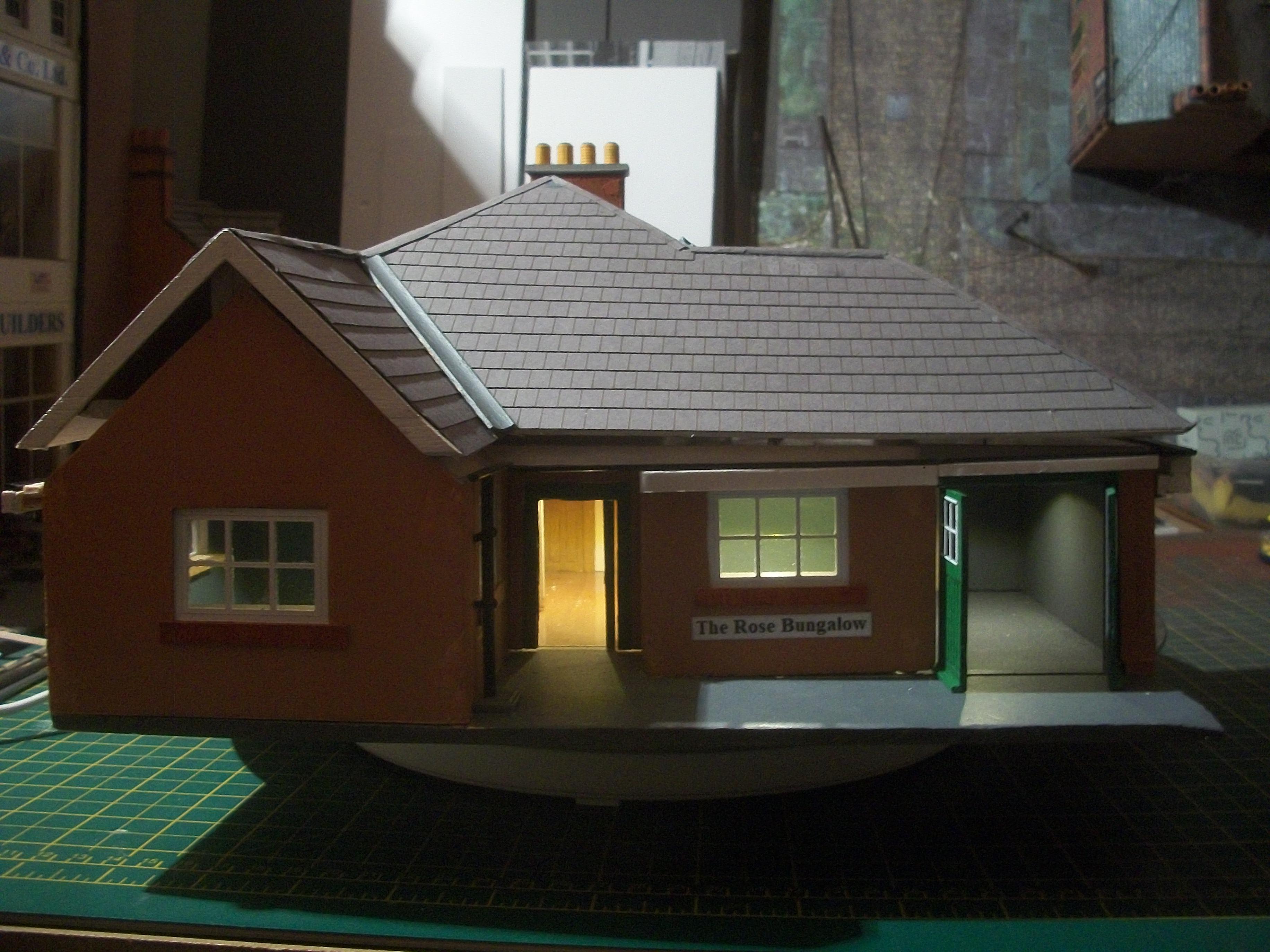

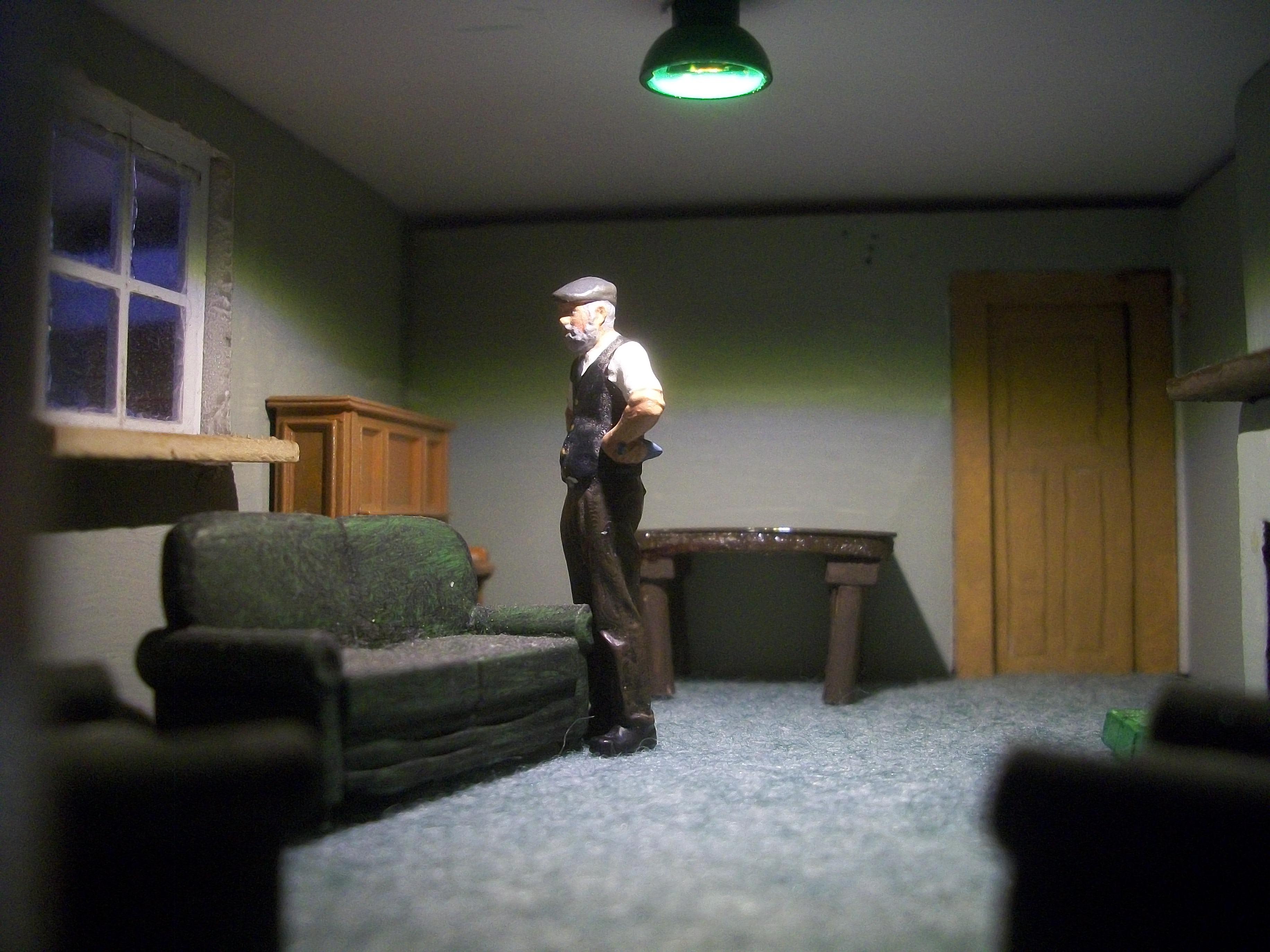

I did try out some photography using the revolving mirrored turntable, with external lights turned off. The internal lighting within the bungalow seems to work quite well . . .

Wow David! You've been going at quite a furious pace with this phase of the build!  😮 In the month I've been away from the boards you managed to get the whole house almost completely wired and lit.
Most impressive!
I really enjoy the interior shots you've taken with Harold surveying your handywork. They make me smile.
