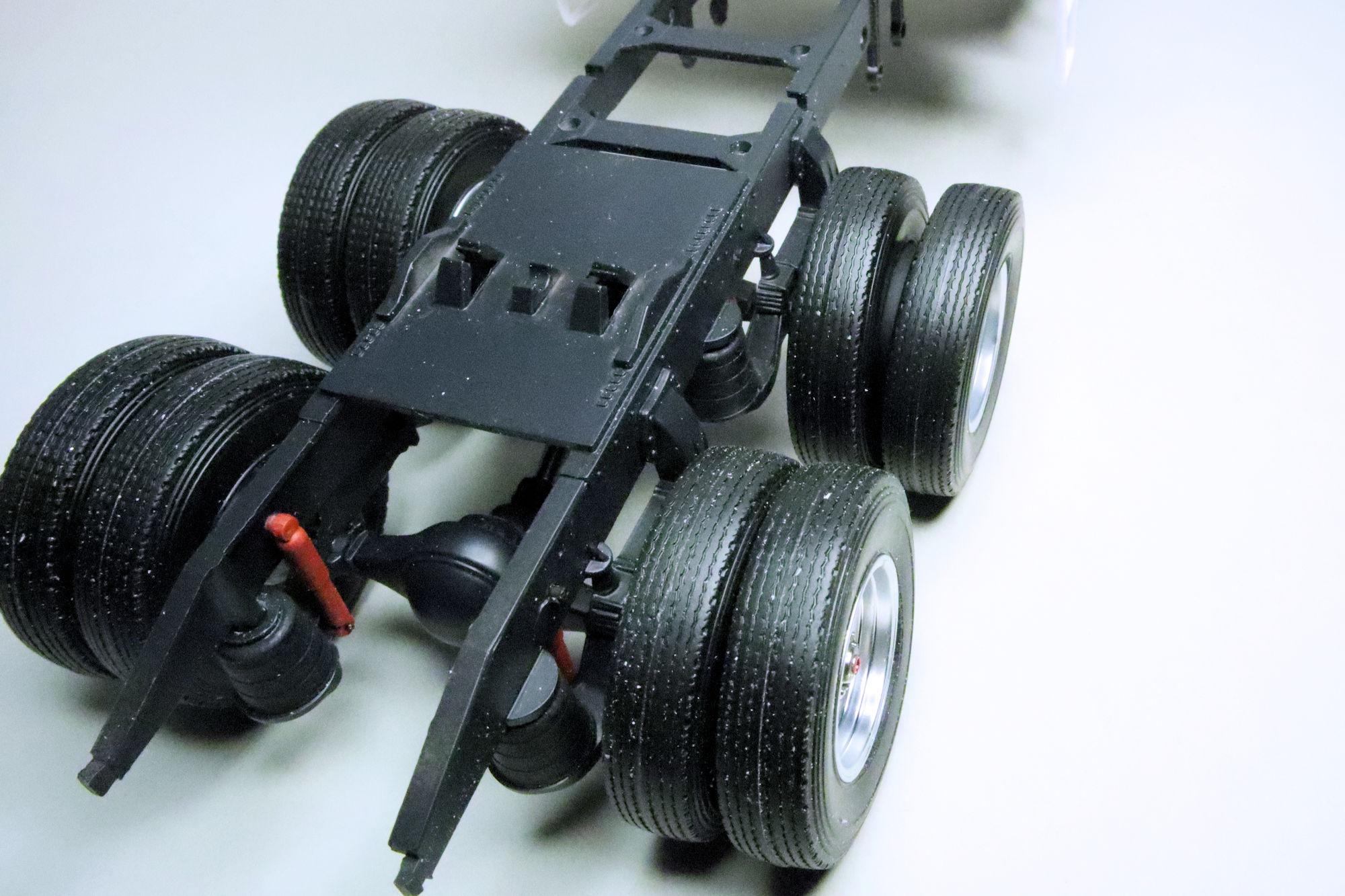

David G. Posted January 21 Posted January 21 Hello Everybody! As many of you may know, I'm currently building Revell's Auto Transport Trailer. As a companion to that trailer, I've selected Revell's Peterbilt 359. In just a couple of build sessions I have the basic chassis assembled with a test-fit of the engine. It's time to get some wheels under this mamma-jamma. For kit chrome I usually spray a dull coat first then do some detail painting and washes. I finished the wheel detailing and started to assemble the wheel sets for a photo. There's a little problem. The tires are warped which is causing a wobbly bent-rim looking effect. I can mount the tires without the center spacer but then they're too close together. It looks like I have a few choices at this point, I'll wait to see how it all looks as it comes together before I decide what to do. As always, I'm open to suggestions Thanks for taking the time to look and please feel free to post any comments. David G.

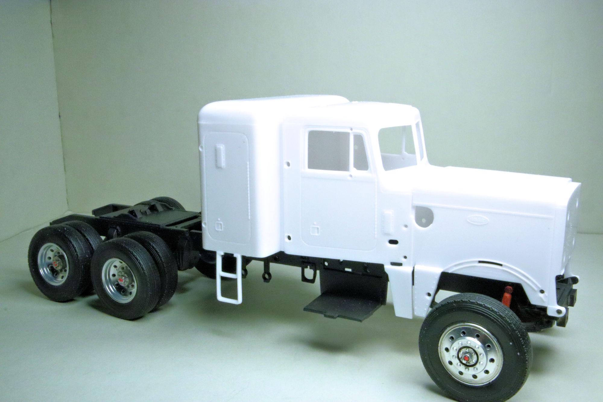

David G. Posted January 25 Author Posted January 25 Hello Everybody! I took a week off building to allow my fingers to heal up a bit. I've been having trouble with my finger tips drying and splitting due to the cold & dry winter weather. They're not completely healed but they're getting better. So to celebrate, here's an update! Test fitting the cab and hood so they can get used to their future homes. The wheels are assembled and look pretty good, at least from this angle. I'm still working to find a way of getting the dual tires to align properly. At worst, if I mount the wheels with the gap on the bottom it'll be less noticeable. But to me, that would seem like cheating. So... onward! As always, thanks for taking the time to look and please feel free to share your thoughts and impressions. David G. 1
BK9300 Posted January 25 Posted January 25 David, its hard to know for certain without having a tire in hand, but would a carefully placed cut(s) in the warped area, where rim meets the tire, help alleviate the warp and allow the spacer to function properly? If they are all warped similarly, might just be bad molding and another set of tires are in order as suggested earlier!

David G. Posted January 26 Author Posted January 26 19 hours ago, BK9300 said: David, its hard to know for certain without having a tire in hand, but would a carefully placed cut(s) in the warped area, where rim meets the tire, help alleviate the warp and allow the spacer to function properly? If they are all warped similarly, might just be bad molding and another set of tires are in order as suggested earlier! Yes indeed Brian! That's exactly what I ended up doing. After a few days of fiddling about, I came to the same conclusion. I cut about half of the circumference of the webbing and packed the warped areas of the tires with paper napkin. Once mounted, I massaged and smooshed the tires into a more realistic shape. I'll post all that in a future update. Great minds, eh? Thanks again, David G. 1

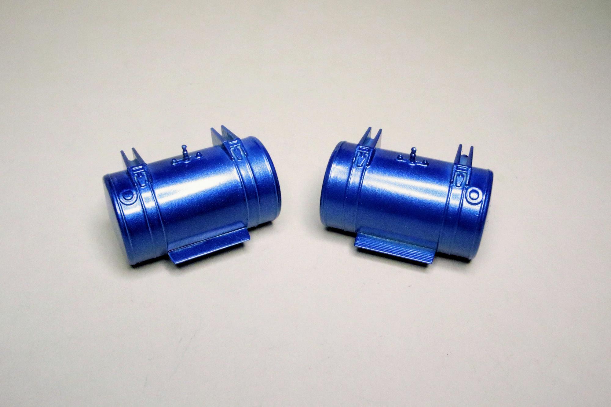

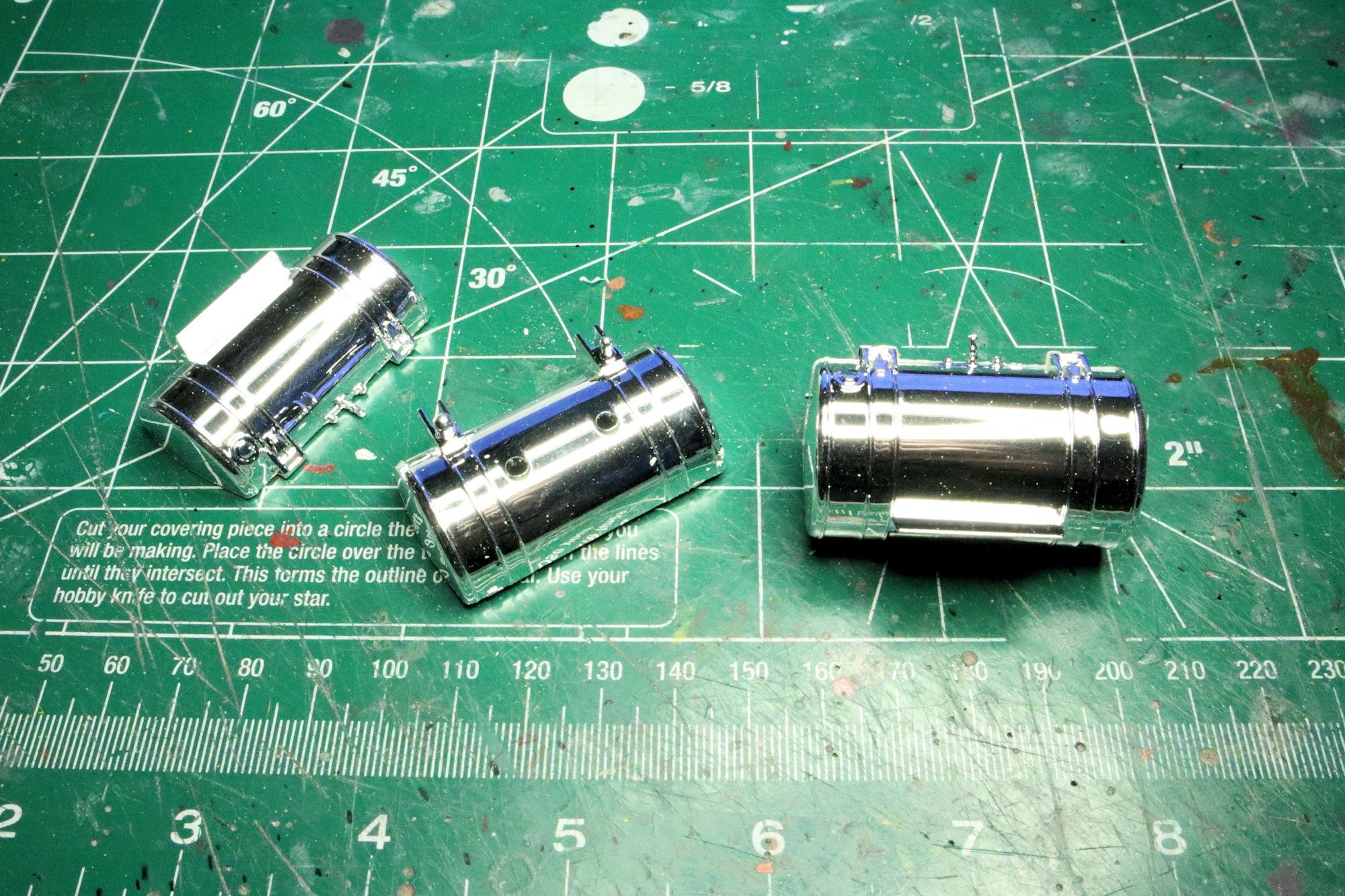

David G. Posted January 26 Author Posted January 26 Hello Everybody! While I worked out the details on correcting the warp on the tires, I turned my attention toward prepping these chromed fuel tanks to install on the chassis. I stripped the chrome plating and assembled the tanks. They'll need much filing and sanding to remove the seams and flash. Filed and sanded smooth then painted with Tamiya TS-19 Metallic Blue, the color I plan to use for the cab. With some detail painting and BMF for the tank straps, the tanks are ready to mount to the chassis. As always, thanks for taking the time to look and please feel free to share your thoughts and comments. David G. 4

Gary Chastain Posted January 28 Posted January 28 Wow, those tanks look outstanding, doing this kit justice.
David G. Posted January 29 Author Posted January 29 17 hours ago, Gary Chastain said: Wow, those tanks look outstanding, doing this kit justice. Thank you kindly Gary. I remember the amazing work you did on a couple of the rigs you built, so thank you. David G.
David G. Posted February 1 Author Posted February 1 Hello Everybody! I've worked out the tire problem! ....mostly. As I'm sure you all remember, the kit tires came with a significant warp that caused them to seat incorrectly on the wheel sets. All the tires had this though some were worse than others. @BK9300 and I seemed to come up with the same idea at about the same time, thanks for that! Cutting along the webbing about halfway around the tire help alleviate the warp . When mounting the tires to the rims, I stuffed the warped sections with some rolled-up paper napkin to help round them out a bit. The cutting and stuffing, along with some smooshing and massaging of the tires corrected almost all but the worst of the warps. As always, thanks for taking a look and please feel free to offer your tips, comments and questions. David G. 3

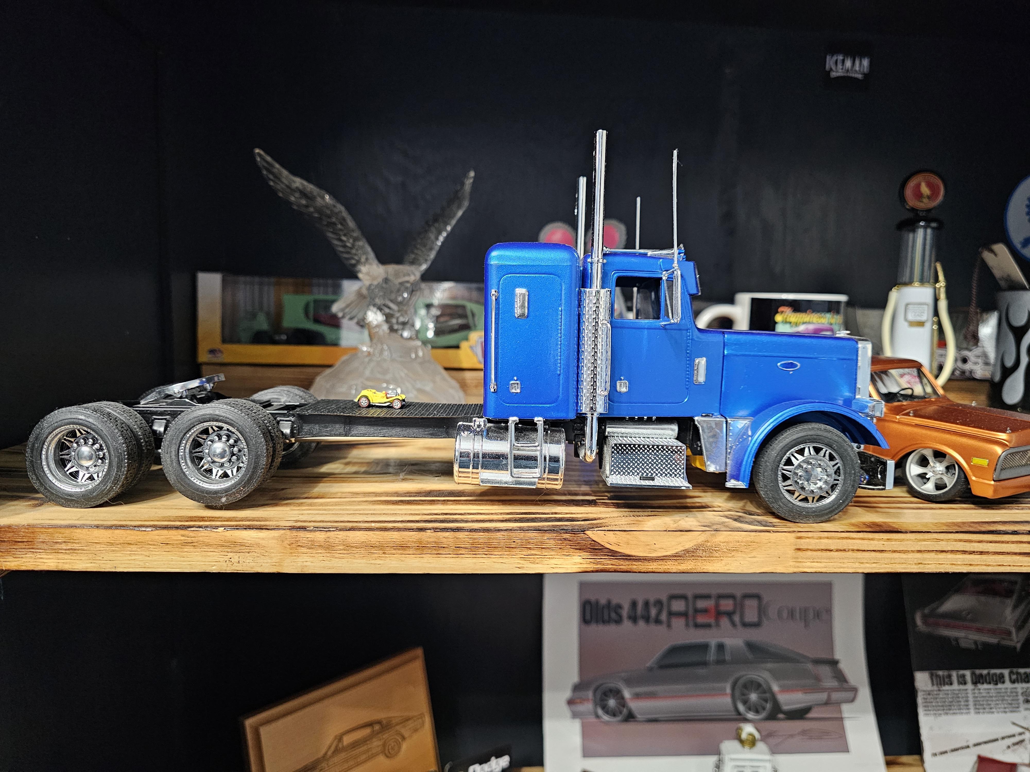

TopherMcGinnis Posted February 1 Posted February 1 Looking good! I bought aftermarket wheels and tires for this stretched/lowered girl. My finger tips do the same thing during the winter. I've found that putting Neosporin into the cracks with a bandage over it while sleeping helps. 1

David G. Posted February 2 Author Posted February 2 22 hours ago, TopherMcGinnis said: Looking good! I bought aftermarket wheels and tires for this stretched/lowered girl. My finger tips do the same thing during the winter. I've found that putting Neosporin into the cracks with a bandage over it while sleeping helps. I think I remember seeing that tractor before. I especially like the wheels you selected for it. Yeah, I do the Neosporin and bandages or "mummy fingers" almost every night. It seems that as a couple of the splits a few new ones start in other spots. It's an ongoing struggle for many of us this time of year. =D- 15 hours ago, Steve H said: This is looking really good David, especially considering you are not a truck builder. I’ve got 2 truck kits to build one day, hope I can do them the same justice you are here. The tire issue looked like a bunch of no fun, good solution you found. The BMF straps on the tanks look very nice! Thanks Steve. You should crack into those truck kits! They're fun to build but make sure you have a large work area, especially if you plan on building any trailers. Thanks again, I'm quite pleased with how the tanks turned out. David G.
