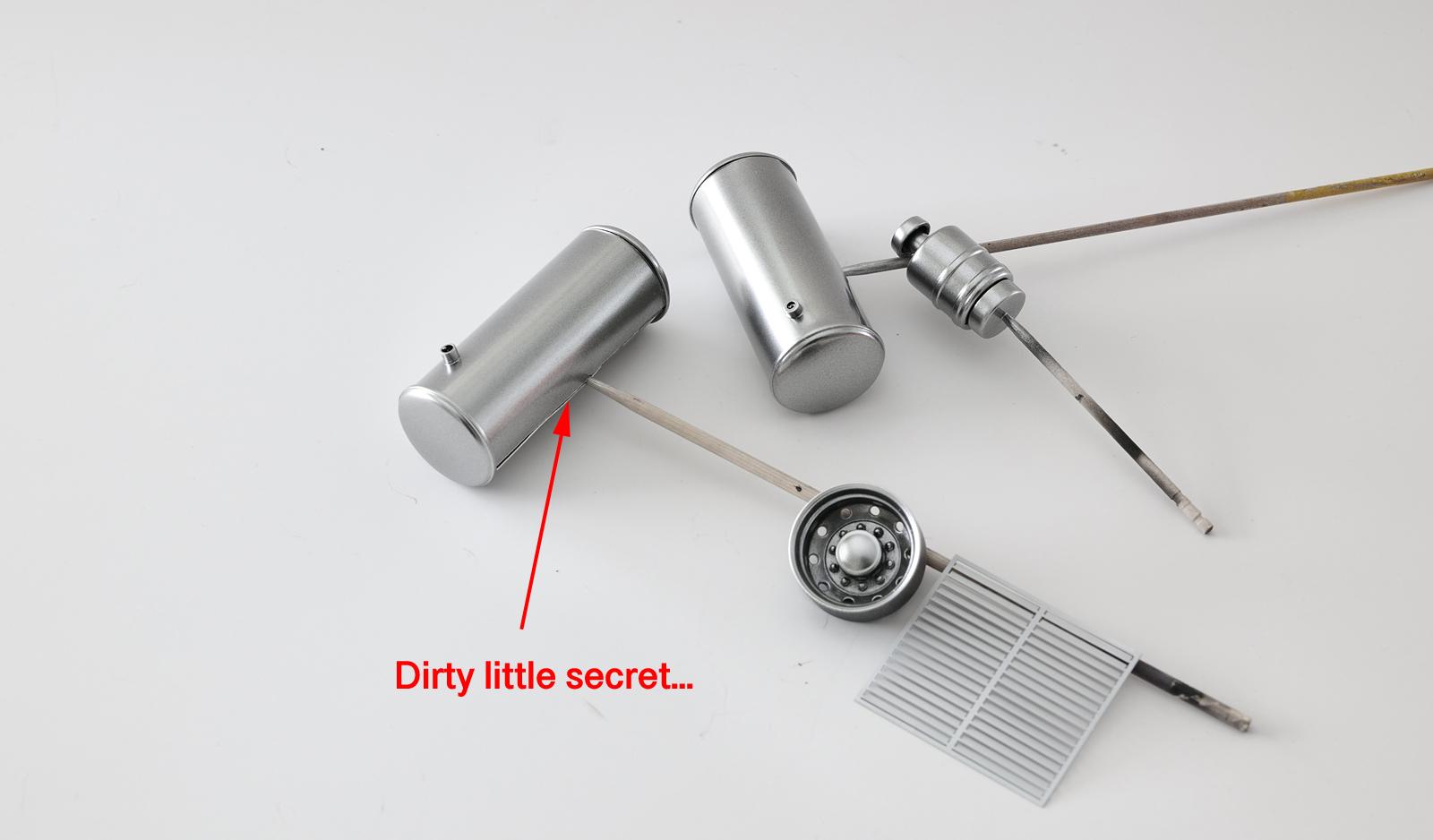

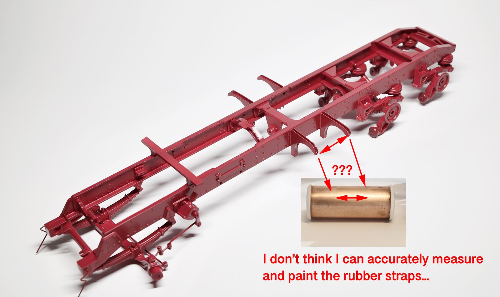

I have photo-etched tank straps for me to use for this kit, but I also would like to add some rubber gasket look to it.
I think there are multiple ways to implement this and for my previous builds, I simply painted in black to imitate the rubber gasket straps.
These are pictures from my previous build; I think the result of painting the strap black works quite effectively.  You can see the black gasket showing off.
The only problem with my current fuel tank is that I don't have any strap molding indentation on the fuel tank for me to paint it black (that is because I replaced mine with copper pipe).
If I don't align and line things up correctly, it will look odd.  Everything has to line up: the gaskets, straps, fuel tanks and the tank holding brackets.
While this problem may not be so serious, I just did not want to screw it up which can lead to bigger problems.
I suppose I can temporarily attach the fuel tank, mask it and paint, but I still didn't have the confidence that I can pull it off...
The photo-etched strap is shown here and my natural approach was to use decals to stimulate the gasket look.
I found some old junk decals with black stripes which I could cut into right size and slide around to position it.
Then I found a better material, a faux leather band (it was laying around in one of our bedroom drawers)!  Cutting it was easy too and it is thin enough for me to bend around the tank.
I rolled the strap using a small pipe and also attached the faux leather trim.
I conducted the fuel tank mock up testing and it passed. :)

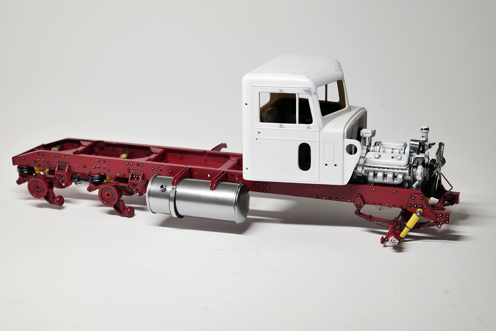

Once wheels were on, I test fit other components including the fuel tank and exhaust pipe.
As suspected, the extended fuel tank is hitting the exhaust piping.
I will have to modify the exhaust piping to correct this problem.  More homework for me, but not a big deal, I don't think.
In real life, could this be quite dangerous having a super hot exhaust pipe touching the fuel tank?  I would think diesel fuel won't ignite like gasoline, so it may be somewhat okay? ;)

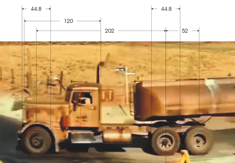

On 2/4/2025 at 9:14 AM, cifenet said:
CHALLENGE 5
The more I look at the truck, I think the wheels are just too small.  I don't remember seeing anyone mentioning this, so it could be just me thinking this way.  These are the same wheels I used on Revell's Peterbilt 359 and they feel right here as well.
Steve, I just found your thread, great stuff! I will comment on a few things. I'm slowly (slowly) converting a 359 to a 281, to build the 'Duel' movie truck.
First that wheel/tire size.
I'm very happy to read that you too think that the kit wheels and tires are too small. Most 'Duel' models looked wrong to my eye, and one problem appeared to be the wheel/tire size.
A photo analysis with two known dimensions, 202" wheelbase (measured on the front rear axle, since this truck has a tag axle), and 120" (119 1/4 actually) cab size. I kept measuring tires in the 44-45" diameter range.
The kit tires are the equivalent of 40.5" diameter. AMT's Part Pack PP028 'Semi tractor tall tires 11.00-22' are the equivalent of 41.4".
I did another photo measurement that established the wheels were 22", see the rest of the analysis here: https://robdebie.home.xs4all.nl/models/peterbilt-3d-1.htm
Therefore the tires must have been 11.00-22s. I looked for period tire data books on Ebay and Worthpoint. I found very little, but one brochure listed 44.1" diameter for a Goodyear Unisteel 11.00-22. Hakan Persson found a US supplier of 'old style' tires: 11.00-22 14PR G STA Super Transport TT listing a 44.7" diameter. Those values fit my analysis, and I'll go for 44" or thereabouts. Apparently no model truck tires are available with this diameter, but I'm happy you designed them yourselves. I'll probably do the same.
Conclusion: I agree with your 'larger wheels/tires' theory, at least for my movie truck. Of course I don't know what other Peterbilts had fitted.
And I'm happy that you have an eye for shapes, and noted too that the wheel/tires were too small.
Rob

Always honor to get positive feedback from you, Brian!  I am hoping those tank straps don't cause issues later on.
My work bench is super messy, I didn't want to show people how crazy it gets.  I just decided to have a dedicated desk with a white poster paper background as my "studio". ;)
On 2/25/2025 at 4:40 AM, Jürgen M. said:
Looks great! 👍
Try using cable ties as tank straps! They work for me pretty well.
You can choose the size any way you need it and they're paintable.
Don't want to hijack your thread but I'd like to show you a few examples for tank straps made of cable ties so you can decide for yourself:
Maybe it's a bit of help to you?
Jürgen, I think your strap idea will work also.  I bet those cable ties bend well and they can probably wrap the tanks easily.
But unfortunately, it actually doesn't address my problem as I was looking for "rubber gasket" backing for the straps. ;)
Nonetheless, your hints and ideas are welcome.
Rob

After Rob mentioned the asymmetrical wall thickness, now I can see definite discrepancies on them (circled).
To me, both my hood and cab have issues.  I think it is somewhat a minor of an issue that no one is going to notice unless someone pays close attention to it.
Initially not knowing the cause of the problem, I found a way to "spread" the low part of the cab (close to the front) on one side slightly to make it look aligned.
I thought I got it to look straight, but now I am thinking sanding out the wall to match the thickness may also work.
These parts will receive shiny metallic silver paint, I am trying to lay down a glossy black coat as my base.
Already found issues with my bumper, so many scratch marks are revealed.  I will polish out the scratches and re-apply the black paint.

This is my "quick-but-works" jig for assembling the mirror parts (this is the back side of catwalk plate). 😎
Measured the distance and mounting points on the truck mirror mounts and marked on the jig so I can temporarily assemble to create one unit.
Building it was somewhat tricky since the bottom support has slight upward slanted angle.
Luckily it fits well, now I just need to create opposite one ...
Not skillful to do some brass tubing/soldering work, I relied on aluminum tubes and CA glue...
Lastly, my tank straps are attached and now I need to complete the other side (which will make this truck even more heavier)...
  • Like 7
