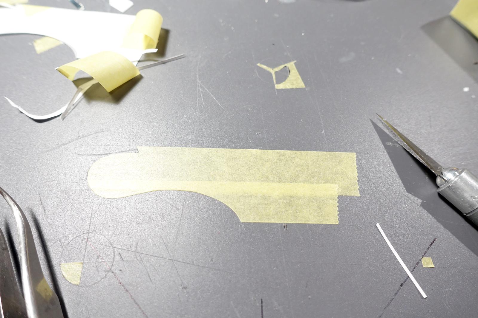

I was preparing for the contest mentioned above and could only make minor progress on Peterbilt 359 before this update.
I used clear smoke paint + flat black paint mixture to imitate diesel soot here.
For windows trim, it is easier to mask it with a template.  I made this template by tracing the window opening first.  Then cut the masking tape using the template to attach...
I know some folks also use a black Sharpie pen to color the trim and do very good job.

For the headache rack, as an exception, I want it to have some reflective shine, so I must prepare the surface to be more glossy black (it could be glossy white also).
For this, some polishing work is required where I start polishing the surface using 6000 polishing cloth working all the way up till 10000.
Once I am satisfied with the base surface, I gave thin layer of chrome silver paint using low airbrush pressure of 8-10 psi.  The idea is to expose the base coat to provide the shine as the metallic paint is applied somewhat translucent.
