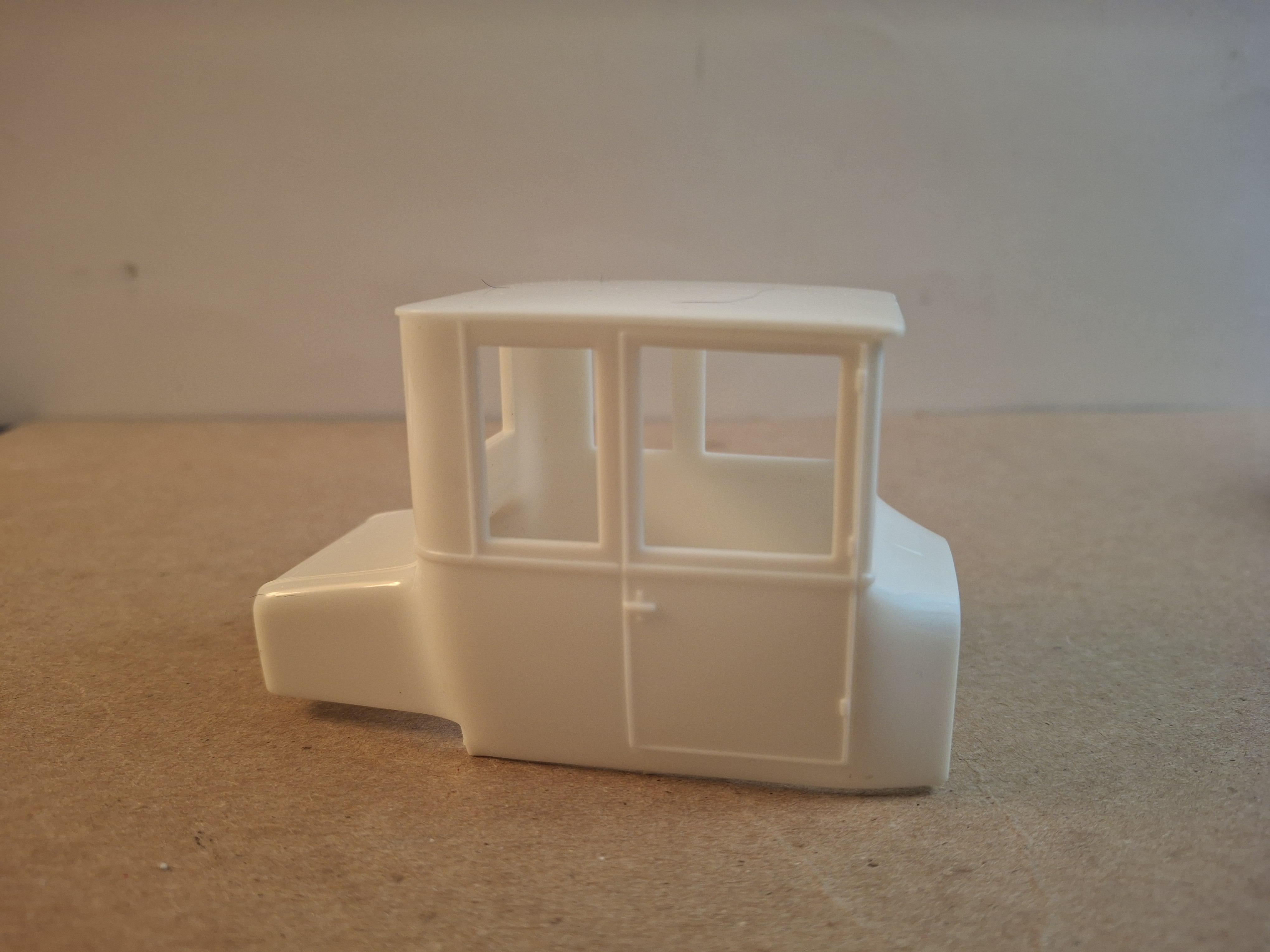

Some of you younger modelers might not know what a phone booth is. But you may have seen it in old movies. Anyway, a tall but tiny box dedicated for use as a public telephone station (a dime a call!). So my model I am working on right now is a tall model T. Actually a modified 1915 (about) Center Door. As it happens, I inherited this mostly as you see it below from my cousin Dale who passed away in a car accident 50 years ago. I have not done much with it over that time.

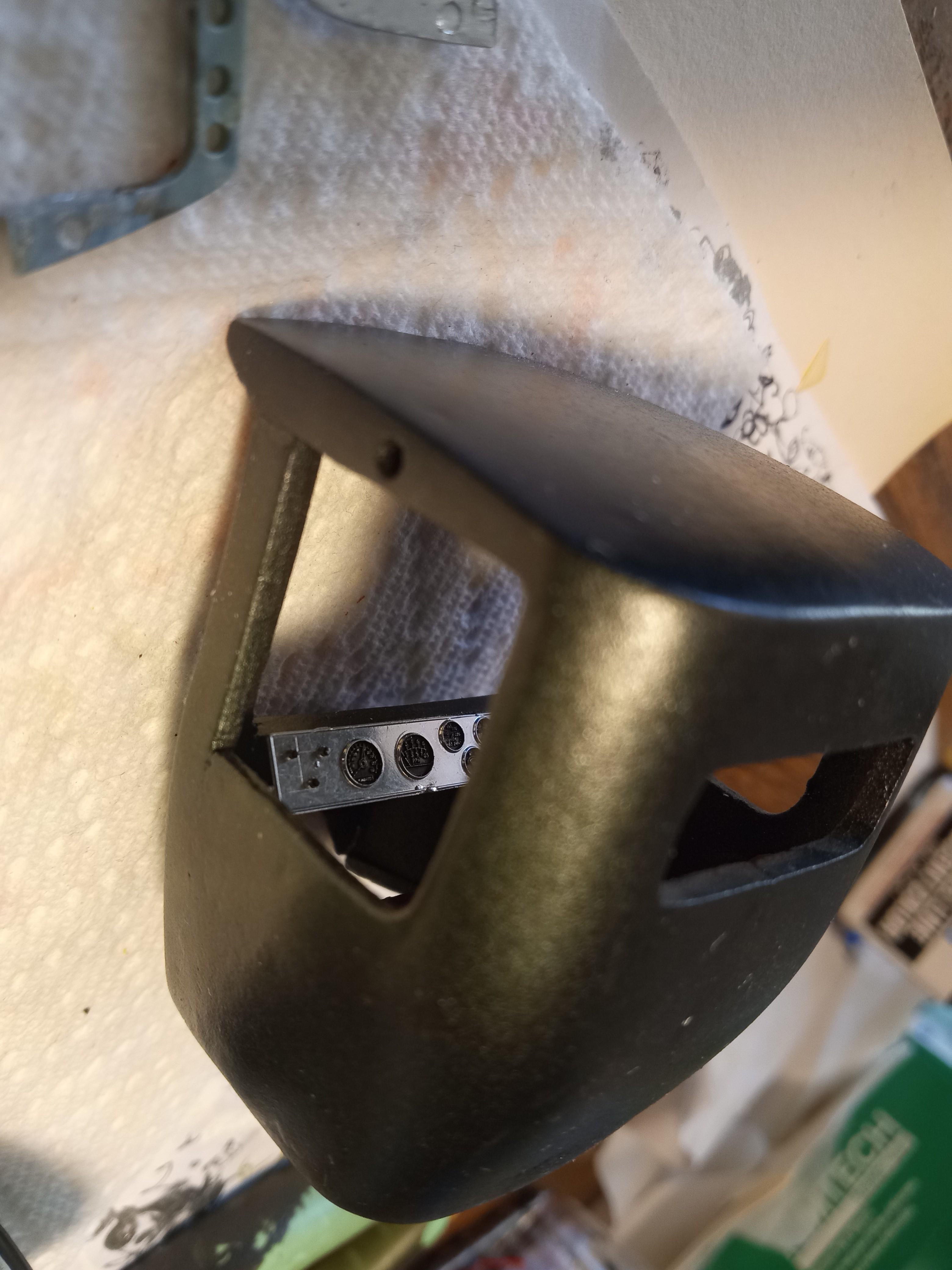

Dale was a very creative and quality modeler. I have several other projects I want to finish that he started. This one is very cute. It is also 143:1 or 142:1 as a guess. I will ask the forum if they recognize it. Below are the main parts I have from Dale. The last picture is a preview mock-up of the T. I added some parts from my junkyard that I might use.

Can you tell if that body is a 2 piece split down the middle? From the pictures it looks heavily modified. The closest I could tell Gowland and Gowland had a gift set with a 1915 center door Ford made in 1952, but the hood was attatched to the body, no motors. The 1st and 2nd ictures are from the the net, pic 3 is a 1/32 1915 Ford I built, pic 4 is a 1925 Ford in 1/25 and pic 5 is an MPC version of the Gowland 1/32 kits with a partial motor that went on top of the hood ,motor parts , tires and wheels were 1/25.
2 hours ago, BIGTRUCK said:
From Ken: "Can you tell if that body is a 2 piece split down the middle? From the pictures it looks heavily modified. The closest I could tell Gowland and Gowland had a gift set with a 1915 center door Ford made in 1952, but the hood was attatched to the body, no motors."
Thank you for the quick response. Good clues. Yes, the body is a split assemmbly, I can see the seam inside. Ypur pic of the drawing of the Gowland and Gowland center door looks like the best match. As you can see in my pic of the unmoded frame, it is 1 piece and no motor. I matched that to the modified frame and they are from the same kit. I can tell by the flashing and details.
I suppose the model is far out of production by now. Still, I have all the major parts I need to finish it. Thanks again Ken.
I am leaning toward it being an Aurora 1:32 scale (Maybe a kit-mingle?). They were all hotrods with different engines and induction systems. But the body has to be modified. None of the various scale and MFG. I looked at on Scalemates have that body, but the fenders sure look to be Aurora to me
  • Like 1
Harry, maybe I did not make it clear, there are only 3 parts I am asking about. The highly modified cab, the unmodified frame, and the highly modified frame. These are all from the same kit (well, 2 identical kits). All else is from other kits. BTW the cab is almost surely a Center Door as I can see the seams on the inside, and no rear trunk.
I think from the answers I am getting it is 1:32 and there are several kits possible. Gowland and Gowland, Aurora, Revell, and maybe more. I have the info I was looking for now. I had some help from the Question Forum too. Thanks for your help.

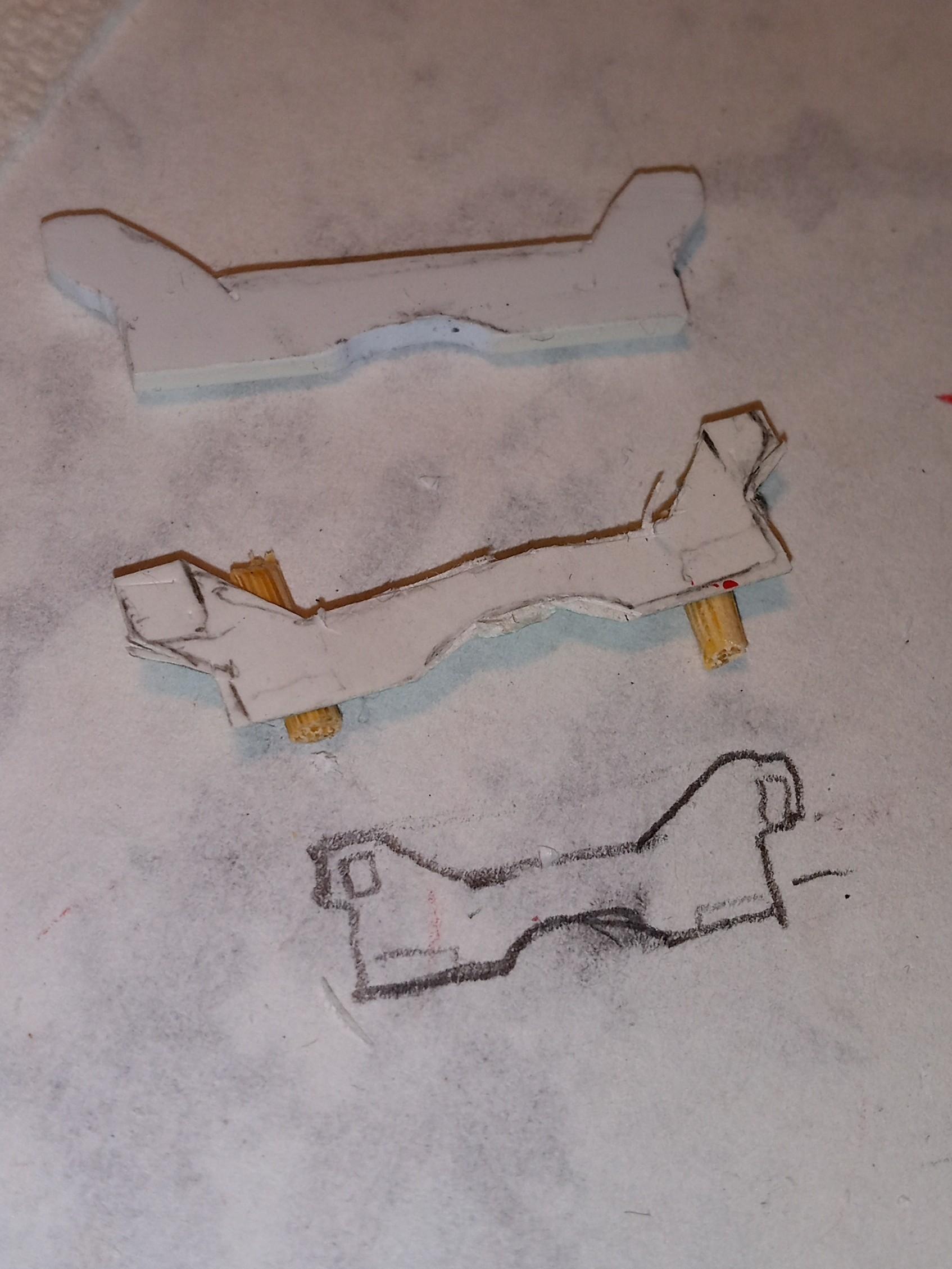

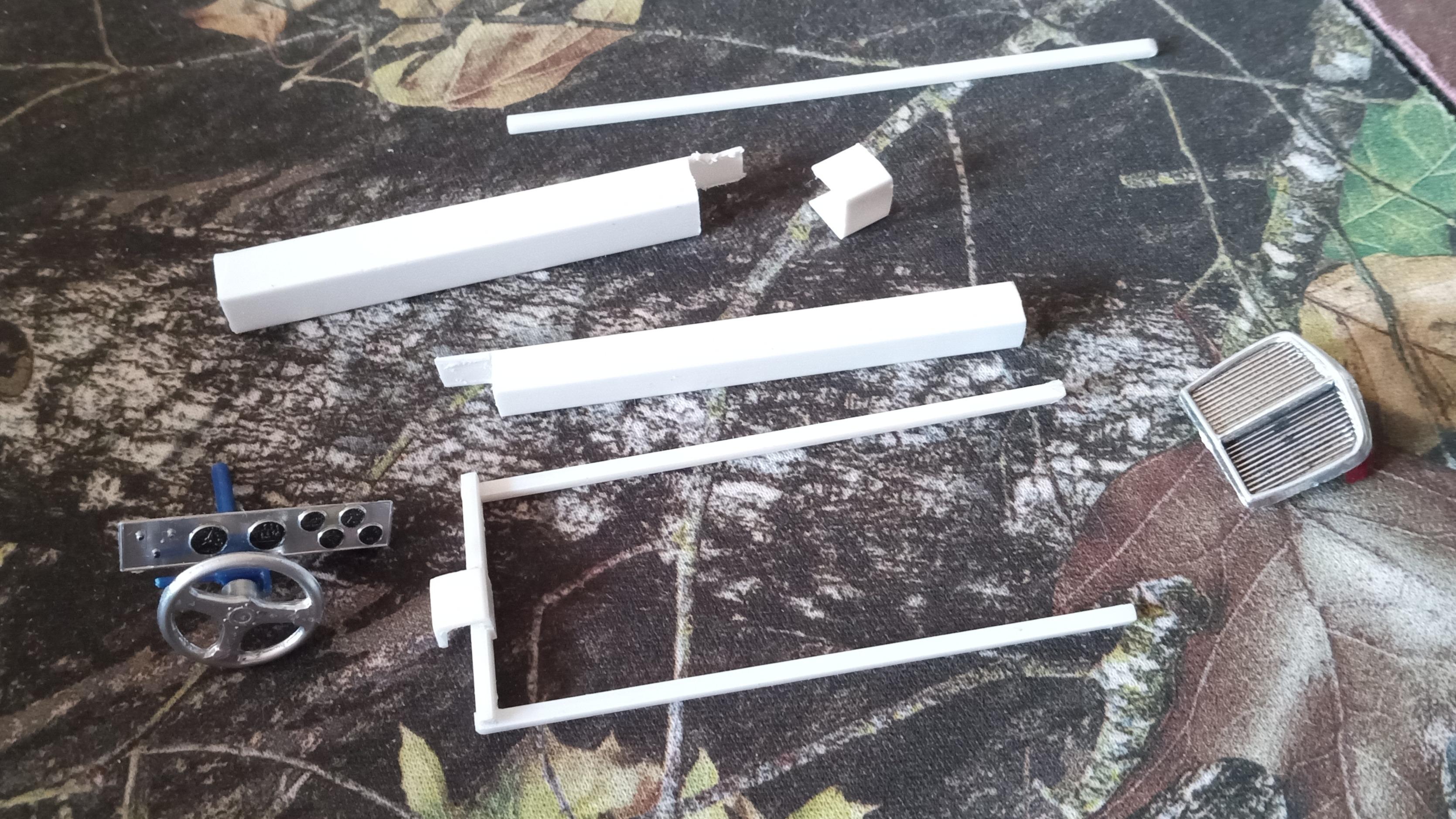

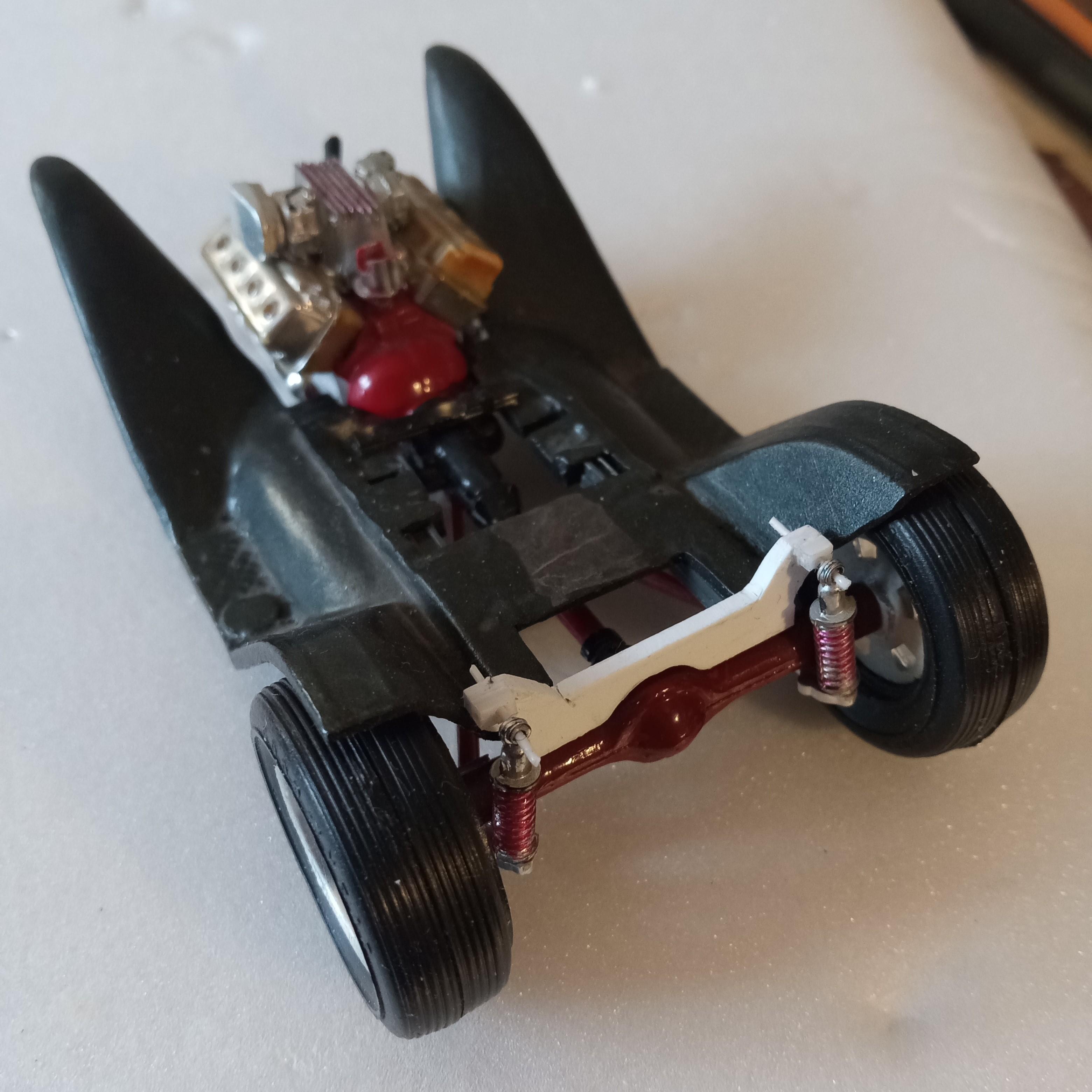

Done a little work on the T. Making the rear cross-member (3 pics below). You may just see the spring mounts at the upper corner of the member with 0.030"holes. The fine white plastic rod (leaning on the drill bit) will connect to the spring tips. I had to add a tiny spacer at the corners to separate the frame from the springs mounts (and drill a .030" hole in a cubic 1/16" spacer). See pic 3 for a mockup. Also in pic 3 are the front and rear "bumpers" I am considering.

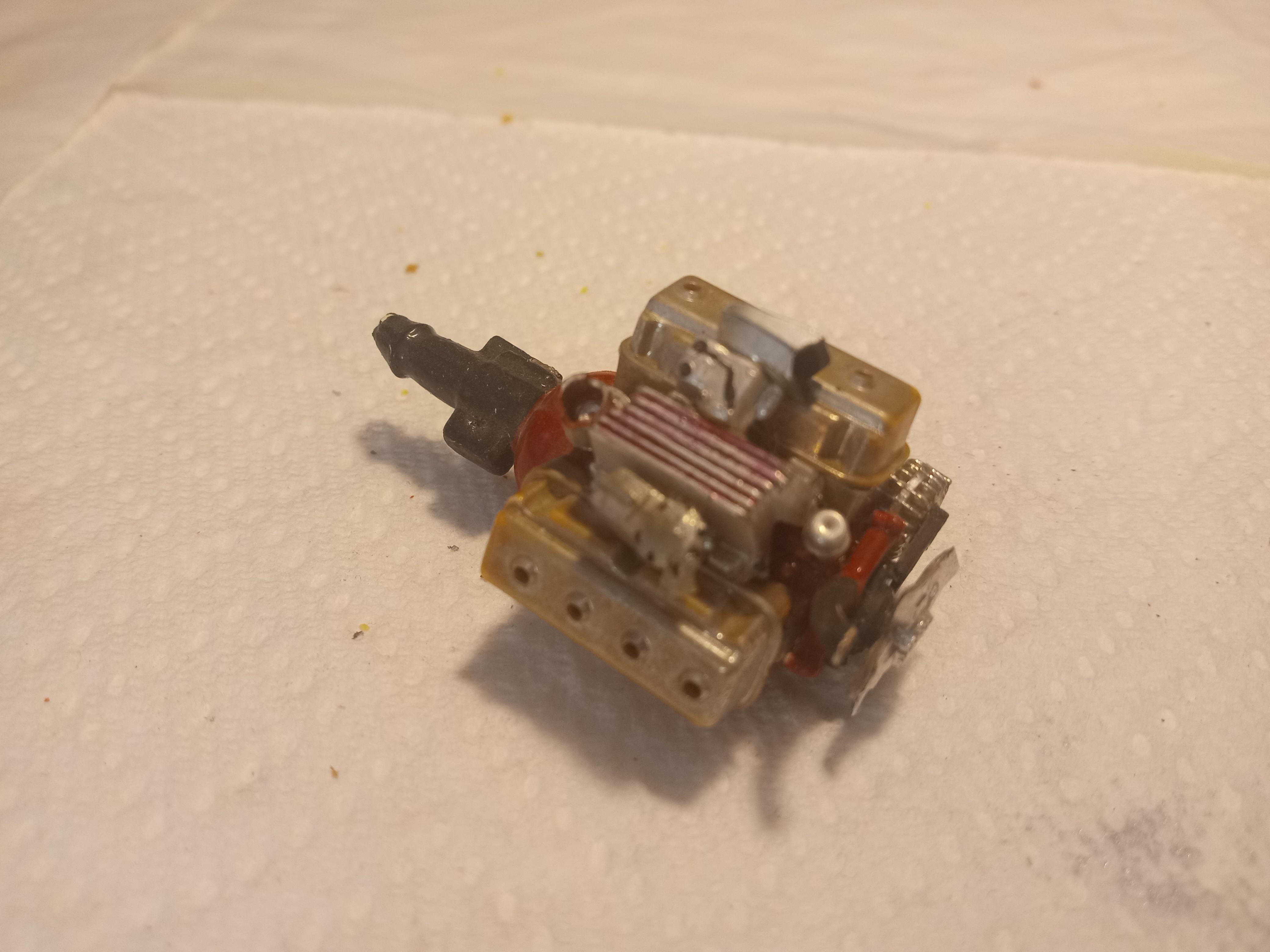

Pic 4 shows the drilling rig I use. No extra charge for the black tape holding it together  😉 Pic 5 and 6 are the Hemi with early Vette fuel injection. I had to break off the headers and reglue them a little narrower for the frame rails (TBD). I also replaced the alternator with a smaller one for the same reason. Took a lot of time for not much action, but I learned some things. Had the drill stand for years but could not make it drill straight. Figured it out.
The next step is the frame and front axle (see the first pics above (beginning of thread) for the potential red front axle.

OK, next step(s). I showed the rear cross-member but I added a tiny extension to the spring mount and drilled a .030" hole for a pin connector. See it below. I used a .030 rod so I can remove it easily as many alignments need to be figured out (cut & fit). The next picture shows the front frame subassembly. It is made of mostly 1/16" square rod wit h a cut-up piece of square tubing for the front mount. That mount straddles the frame and the front spring. The frame parts will be painted light gray. It also will mount the front radiator, shown there. There is a radiator on the back of the grill.  As a bonus, I include a dash mockup.

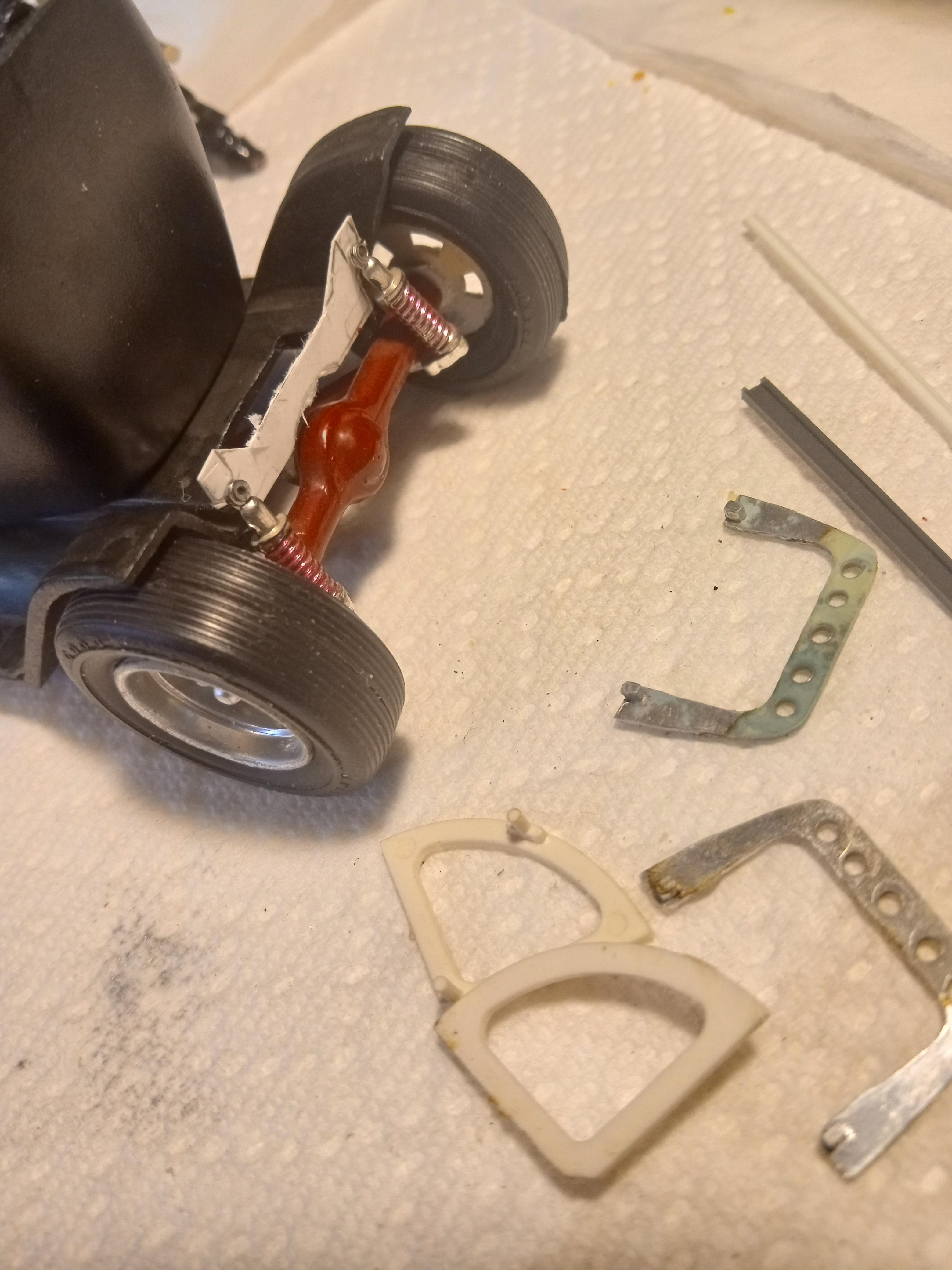

Nearly done now. A couple of views of the frame running gear and grill/radiator. You can see the engine plug wires. My first time wiring in a finished car. Sorry about some bluriness. Better views of the dash and grill in the next 2 pics. The Grill and front frame just slide together. Ready to glue the frame in and then glue the front axle to the frame. Top it off with the cab. Oh, and I have to make a short (1/16") extension to the radiator hose to the radiator.
