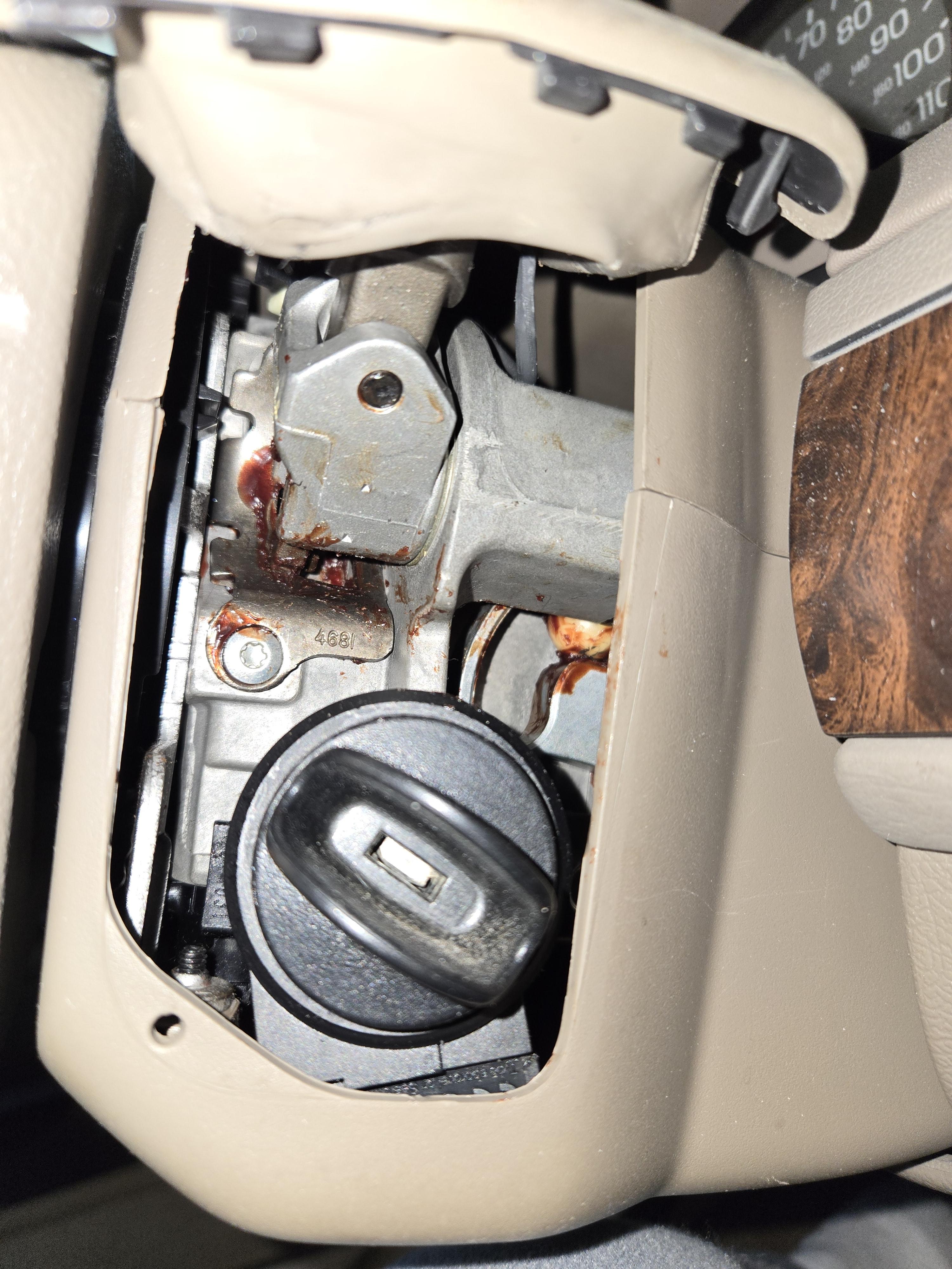

I am in need of some advice about getting a 2005 Mercury Grand Marquis with a dead battery into neutral so it can be push back enough from the garage front wall in order to access the hood and either replace or charge the battery. I went to YouTube with no luck, many videos but none that are exactly like the mechanism I'm seeing. I have the rubber access cover around the ignition and column shifter swung out of the way to view the internals. Most videos show a pin that needs to be pushed down to release the gear shift but I'm not seeing that pin. I've attached a photo of the internal mechanism. Any suggestions would be greatly appreciated... Mike

Moving the car back enough to get a charger on the battery is probably the best option, as the shifter interlock should work if there's juice to it, most likely with the key turned and pressure on the brake pedal.

Yup, and why there wouldn't be a non- powered emergency option is beyond me.
Just now, dmthamade said:
Some fords, turn ignition key to 1st position AKA accessories, shift out of park. Interlock not engaged on some with no power to system, not powered up until in run.
I don't know if there is or not. Not the stuff I work on generally.
I put a late-model FWD Caddy console in a '47, using the cable that came in the console to shift the 4L60E that came with the low-mileage Corvette C5 LS engine I put in it.
There was a powered interlock solenoid on the shifter in the console, normally activated by stepping on the brake pedal, and no dead-battery override.

I was curious and looked this up. Seems like there is an electronic interlock, no mention of an emergency manual option from what I've read. Lots of talk about blown fuses and it being powered off the brake light circuit. Try charging it as are and give it a shot.

Do you have the owners manual for the car?  There are probably instructions on how to release the shifter when the battery is dead.
I had to deal with the interlock when I had to repair the shifter in a 2004 Taurus.
Ok, so back in the day, fords had wiring problems at the brake light switch. Wire would break right at the connector, disabling the interlock system. Like i said before, turn the ignition key to accessory position, this unlocks the shifter and you can shift the car into neutral. This lets you start car or roll it around if it's dead for other reasons. Have to say, most newer cars have interlock systems fairly easily bypassed, usually can be accessed in less than a minute. Knowing how is the issue...
Don
With the key in and in any position the column shifter wouldn't budge. Speaking of budge, I took Les's (stitchdup) suggestion and jacked it up drag it away from the wall to access under the hood. Waiting for the battery to fully charge now. Thanks..

This may be unrelated,  I've seen certain early/mid 2000 ford vehicles have loose bolts under the column that interfere with the neutral safety switch,  and proper gear selection. If the park, neutral, drive ect. Isn't lined up, kinda halfway in-between park and neutral, it's a sure bet the two torx bolts are loose. Just something to check for, not sure if your vehicle has that common issue.

Update on the Mercury, after charging the battery overnight and hooking the car's cables to the battery again absolutely nothing, not enough juice to light up the headlights. Went and bought a new battery and she's ALIVE and well again.
Thank you to everyone for putting some insight into my debacle.
