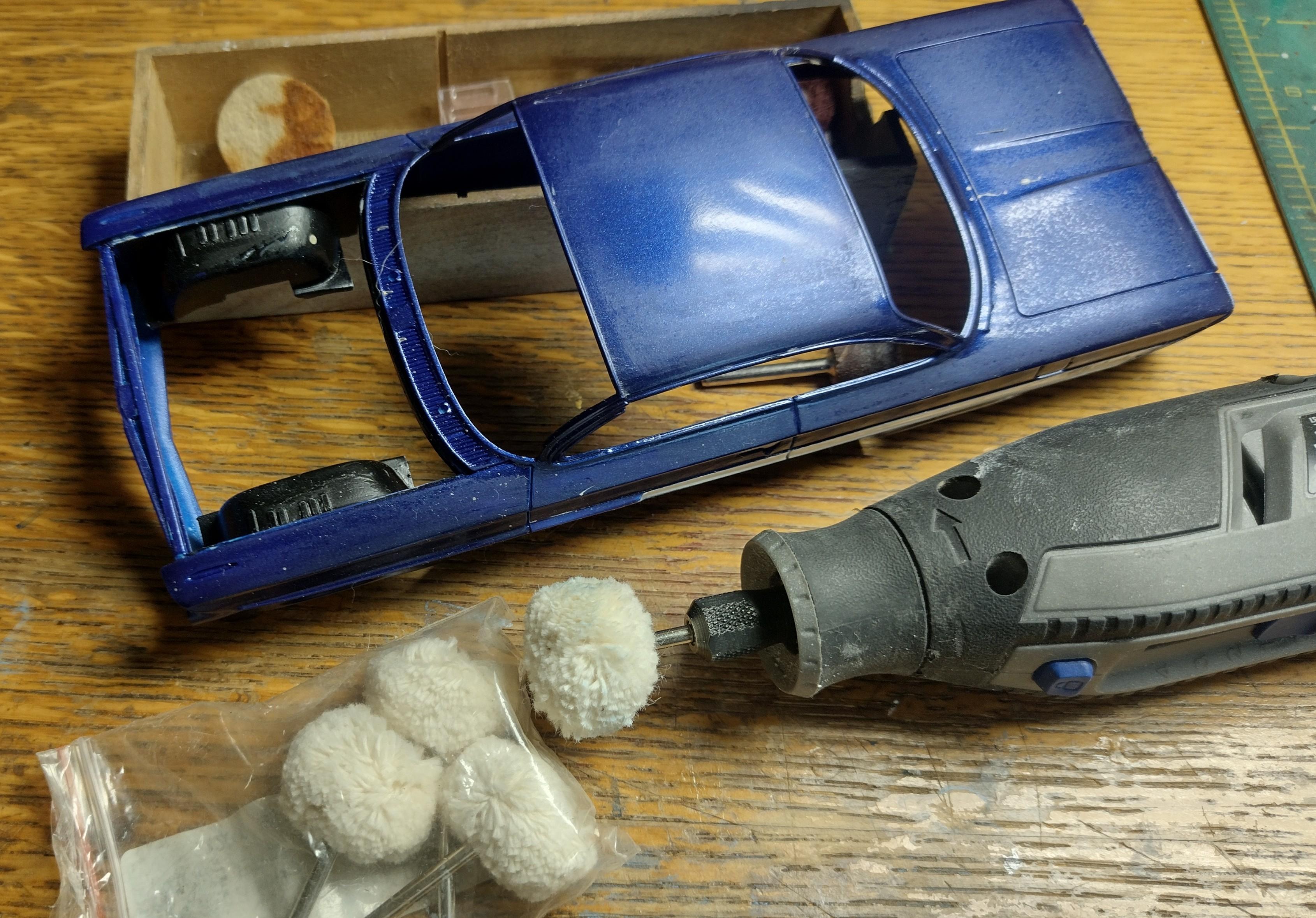

Belugawrx Posted March 3 Posted March 3 Just did a quick polish stripe on the middle of the roof of this '61 at low speed with Novus #2... Now,... I can't see this tool cutting thru a steel axle...it's not meant for that..... low speed low torque ! But as far as polishing and drilling distributors without melted plastic build up...it's perfect for me.

Mike 1017 Posted March 4 Author Posted March 4 21 hours ago, Belugawrx said: Just did a quick polish stripe on the middle of the roof of this '61 at low speed with Novus #2... Now,... I can't see this tool cutting thru a steel axle...it's not meant for that..... low speed low torque ! But as far as polishing and drilling distributors without melted plastic build up...it's perfect for me. Don't take this wrong. If you can do it so, can I. I have 2 bodies curing so I will definitely try it again Thanks Mike 1
