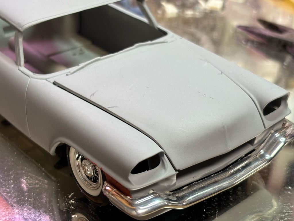

Moving right along, I’ve been continually refining the body work to get it perfected for paint. Got it in what I hope to be the final primer coat and while it was drying I mixed up a small batch of turquoise using Testors light blue mixed with a few drops of Testors green, then laid it on the engine after a quick primer coat. I did a little experimenting with Kosute Gin San on one of the headers, and I think I’m going to go ahead and clear the headers to get a shinier finish with the Gin San and make them look more like polished aluminum…. Time will tell.

Just got some bench time in this afternoon and evening getting the body imperfections sorted out, including cleaning up the vent window areas. Also turned some major focus to the engine bay firewall and inner fender clean-up. Mocked-up the engine and I'm glad I did because I need to make some reliefs for those dual 4-bbl carbs hanging WAY out on them long-rams! I do believe I'm on the last round of putty/primer, thus hoping to get it into paint this week if all the stars line up correctly. The devil is in the details, and I'm workin' him OUT!!

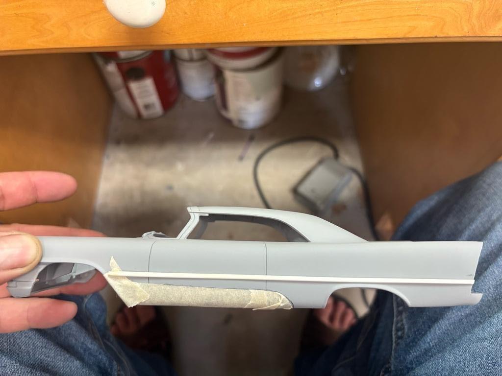

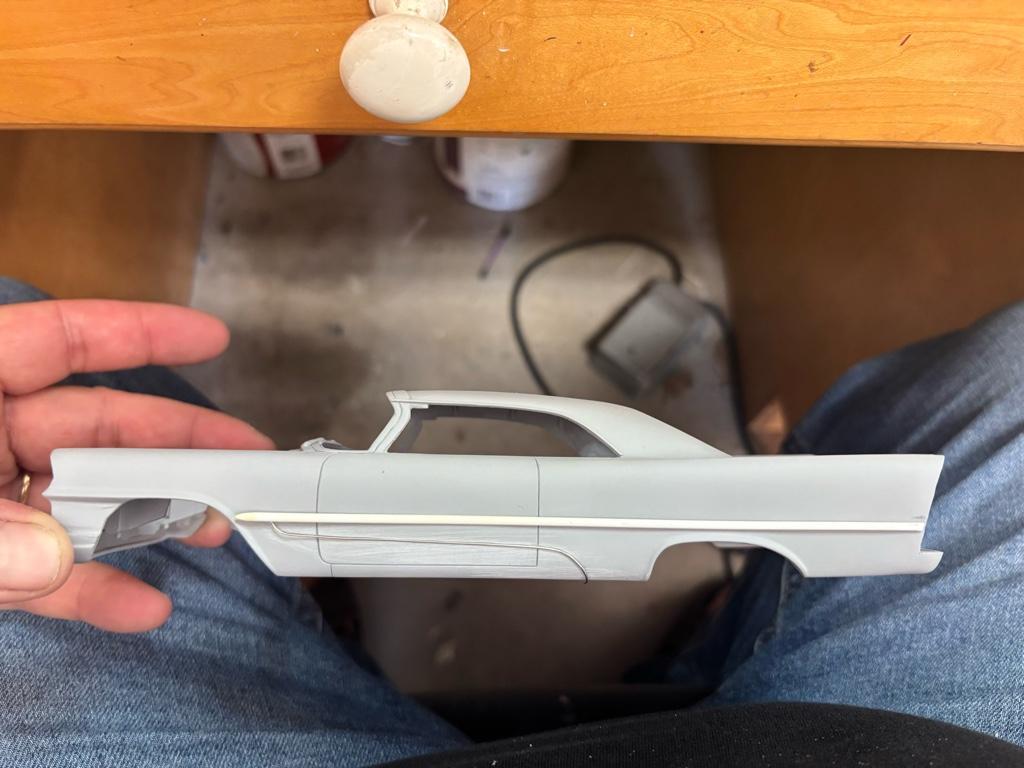

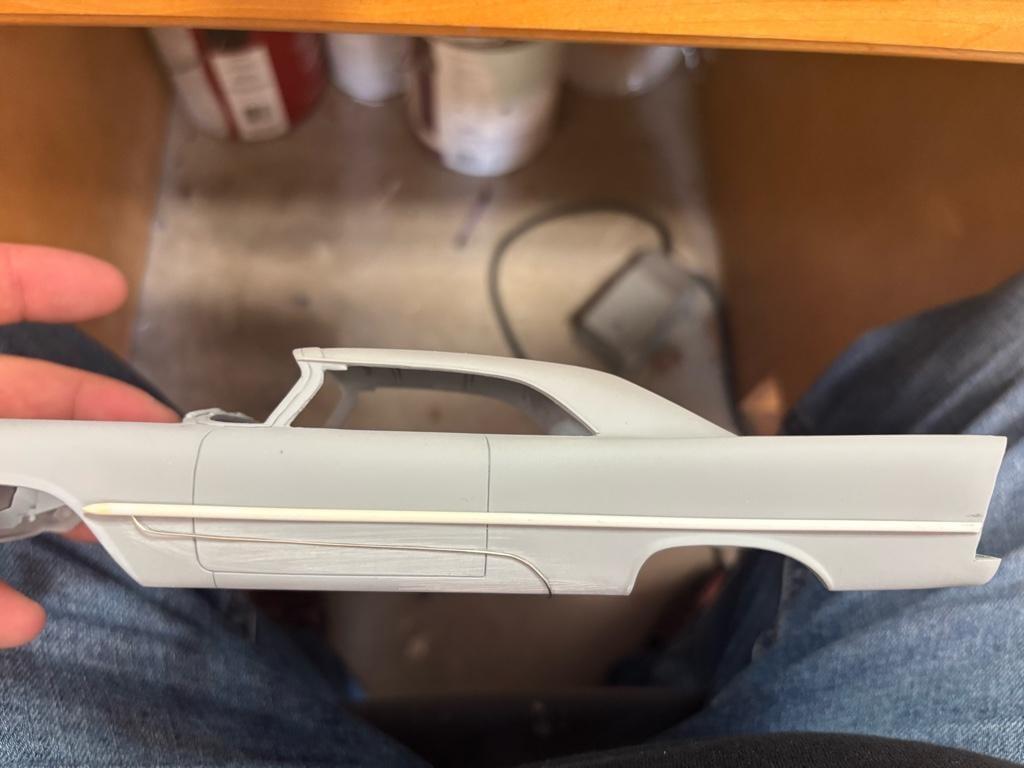

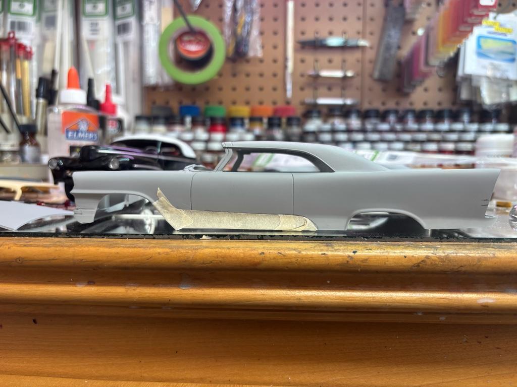

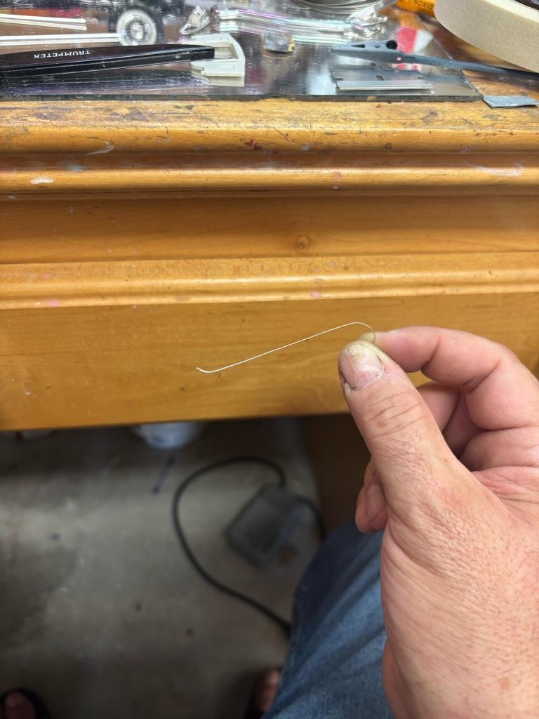

Well, life changes happen and they can come along sometimes with minimal warning….. That being said, I’m back to the bench after an unplanned hiatus and took to finalizing the body prep including re-installing the side drip rails along with fashioning the ‘57 DeSoto side trim.
I started with some Evergreen half-round #242, cut to length and “speared” at the front edge. This piece will have an indent ground into it, the primed/painted/cleared to make way for the final BMF finish.

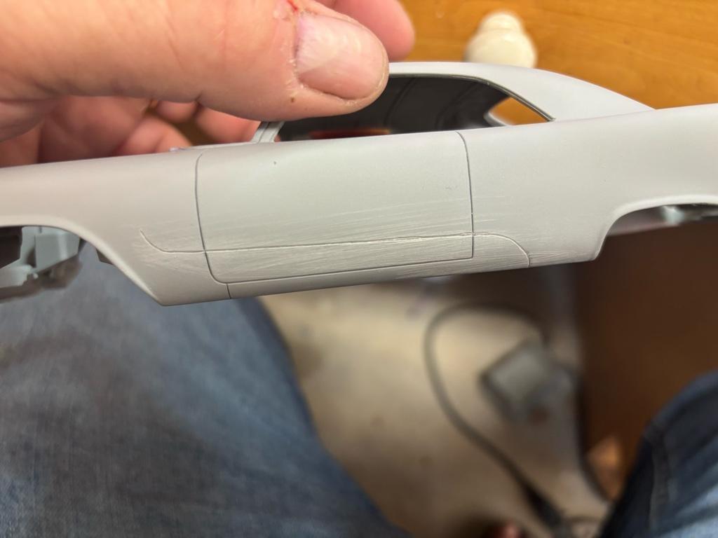

The next step was to mark out with a pencil the basic lower edge of the De’s trim. Once I had it the way I wanted it I edged it with masking tape and scribed a guide groove for the lower stainless trim, bent to shape from 26 gauge craft wire.
The groove serves a two-part purpose; as a place to set the trim as well as a guideline for masking the insert color, making life (hopefully) easier down the road. That was the easy part. Now I get to match it up on the other side.
I’ve also ash-canned the grand delusional idea of the long-ram 413 as it was creating unnecessary modification hardships and killing the joy of the build. I’ll use the kit Hemi and dress it up a tiny little bit and all will be right with the World. So with that, I’ll be filling back in the inner fenders to the way they used to be (roughly), and the only other thing on my list body-wise is to reverse-hinge the hood. Once those items are taken care of, I’ll sling some paint and get this baby back on-track.
