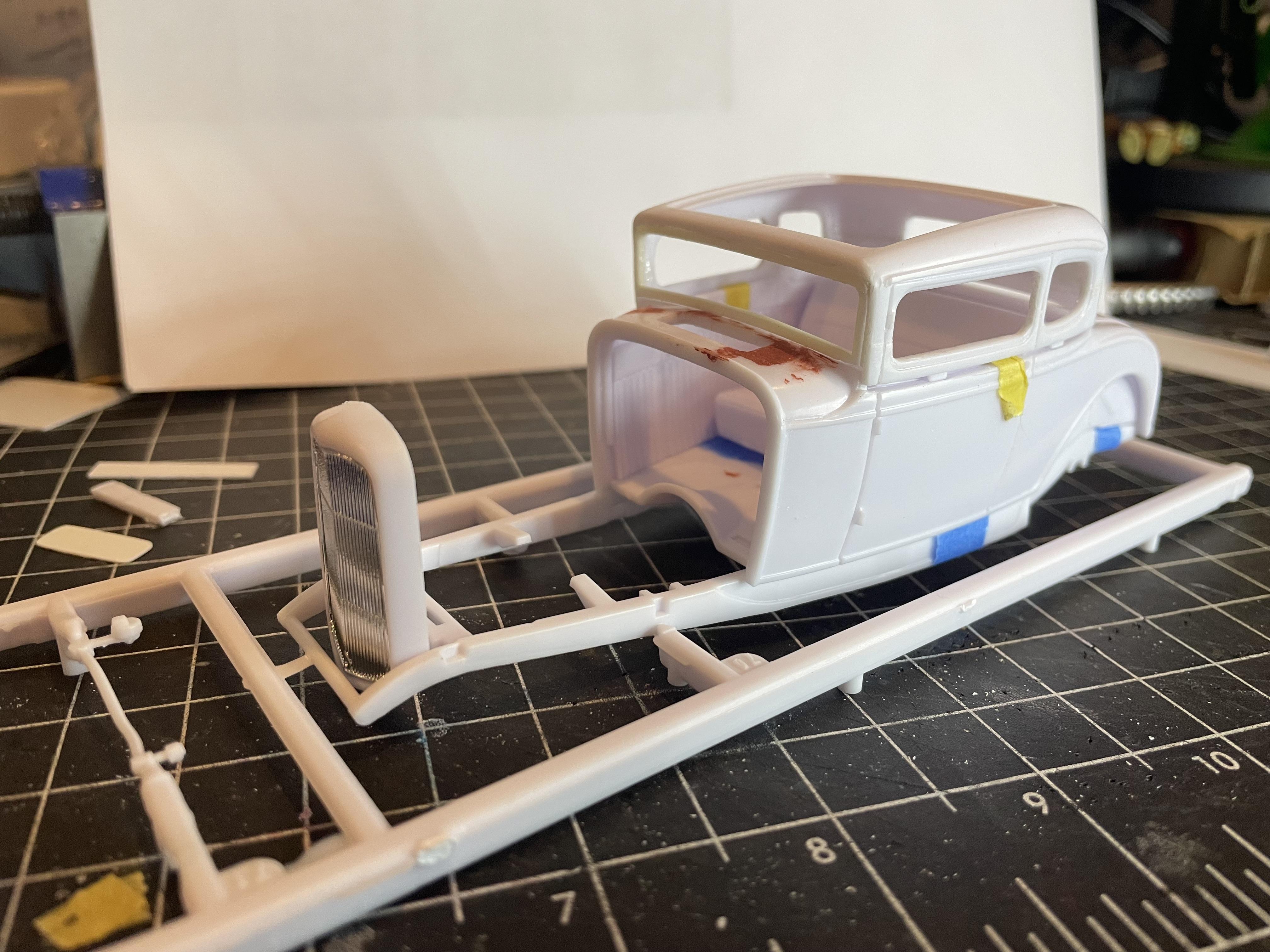

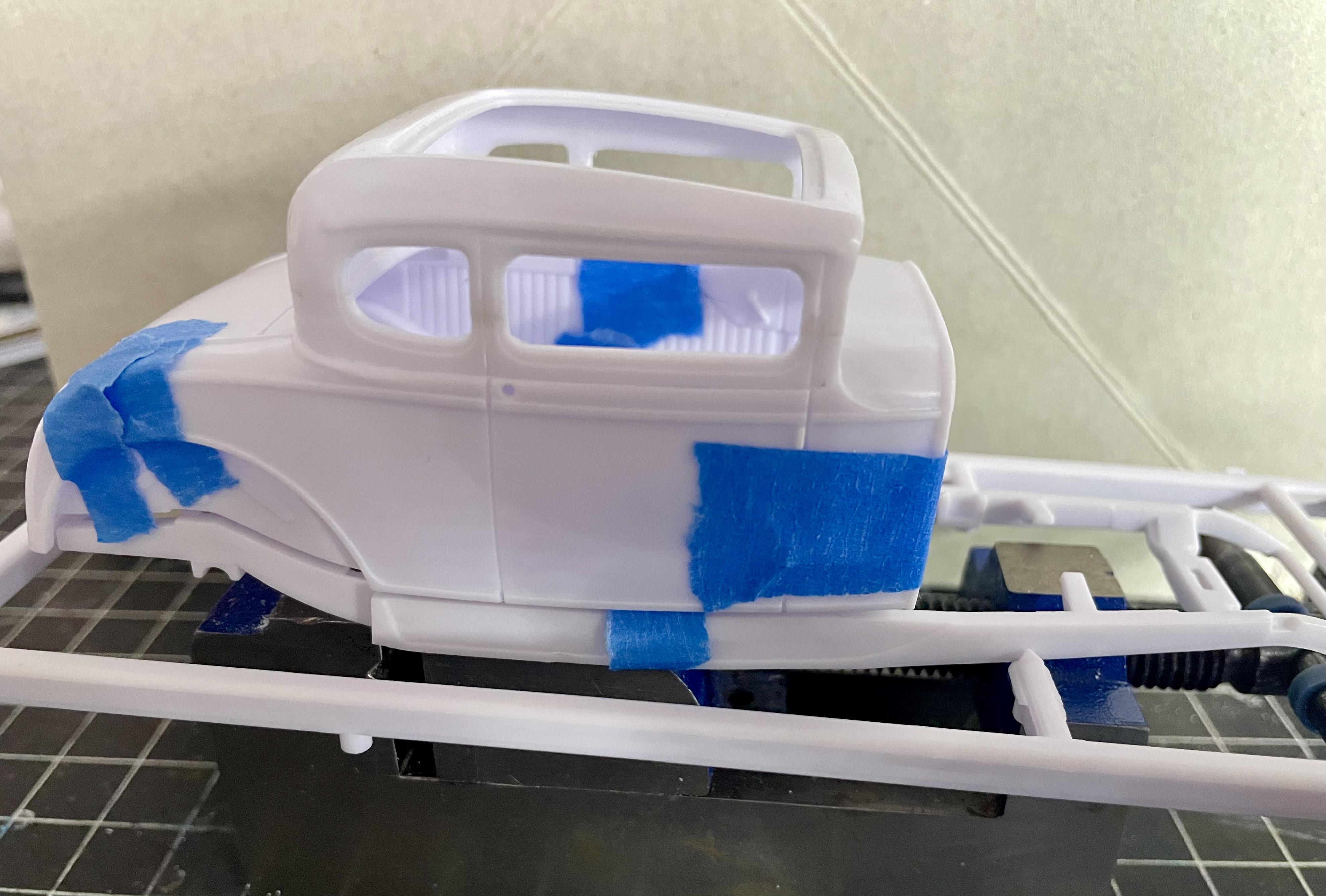

9 hours ago, Twokidsnosleep said:
Taped up dry fit of frame, floor pan, interior door cards and body
VERY nice. I'll say it again, the '30 is a good choice. The Revell '32 5 window was a pain in the biscuit to chop and have it look right.

Cheers man,  I hope to make the ‘30 respectable. There is a lot of chopping and hacking to do
I am laughing at the Ford vs Chevy camps; they must hate this b-star dized car with a Chevy engine and Ford frame and body.
I prescribe to a  pick from the best you can mentality and make something work vs blind support for one group or thing
