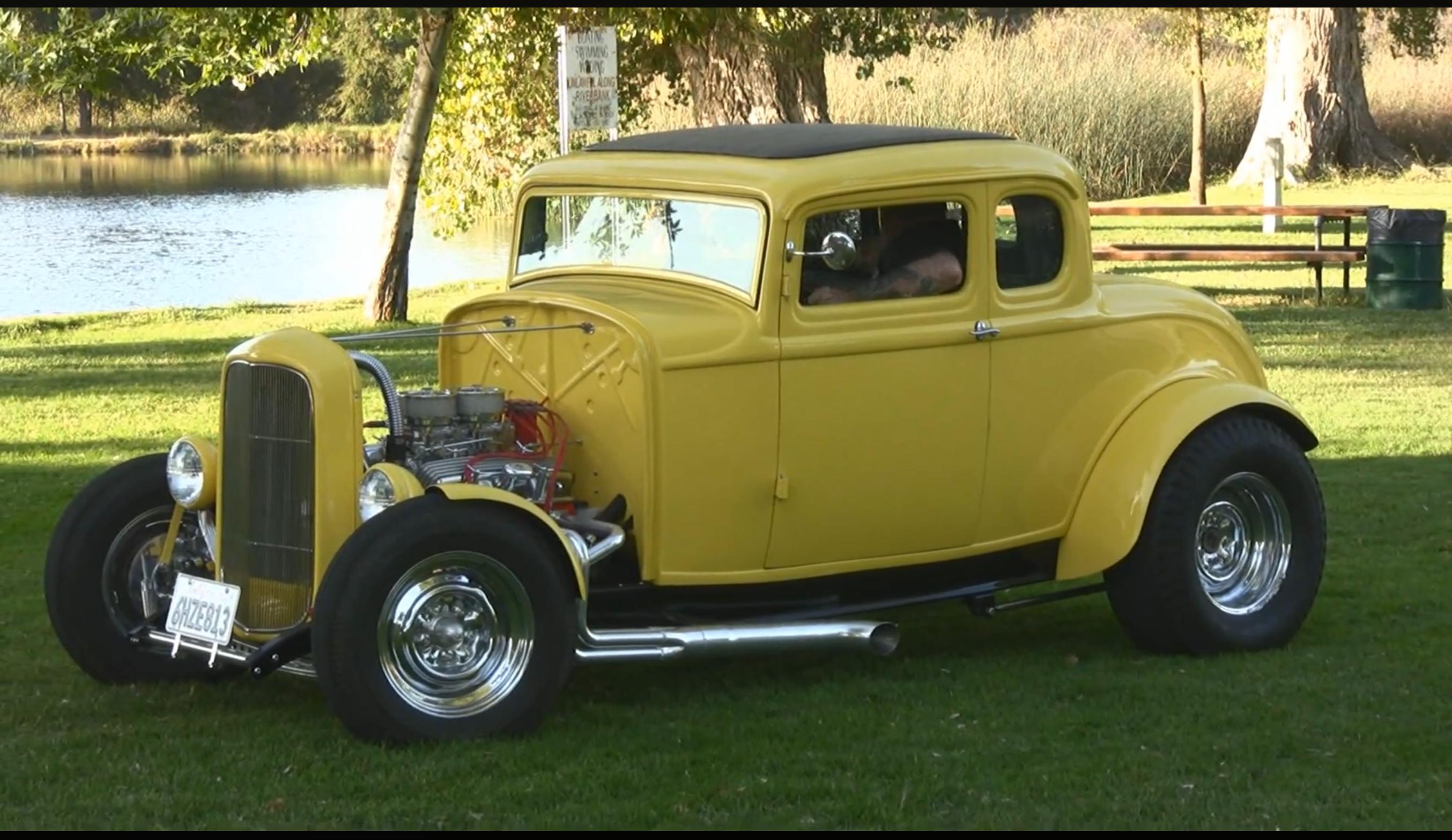

Twokidsnosleep Posted July 22 Author Posted July 22 (edited) This is a really nice tribute car photographed in a good setting A lot of intelligent hot rod guys modified the movie car and improved on it with suspension changes, replacing temperamental Rochester carbs and even keeping a bigger radiator to cool a larger engine. As I dive down hot rodding coupe’s rabbit hole, I can totally understand these mods to improve driveability, reliability and comfort. Edited July 22 by Twokidsnosleep
customline Posted July 24 Posted July 24 On 7/21/2025 at 10:10 PM, Twokidsnosleep said: This is a really nice tribute car photographed in a good setting A lot of intelligent hot rod guys modified the movie car and improved on it with suspension changes, replacing temperamental Rochester carbs and even keeping a bigger radiator to cool a larger engine. As I dive down hot rodding coupe’s rabbit hole, I can totally understand these mods to improve driveability, reliability and comfort. I know some will hate me for saying this but the iconic Milner coupe was kinda strange looking with the sectioned grille not aligning with the cowl. The car pictured above looks much better, IMHO. 2 1
Twokidsnosleep Posted July 24 Author Posted July 24 17 minutes ago, customline said: I know some will hate me for saying this but the iconic Milner coupe was kinda strange looking with the sectioned grille not aligning with the cowl. The car pictured above looks much better, IMHO. Yep I would agree The functionality of a larger cooling space was emphasized by one clone owner who had a larger displacement engine than the movie car and so wanted more surface area for cooling purposes vs smaller area to look cool. Many put in rear shocks and springs to improve highway ride and overall ride comfort. Cannot argue with that as they have to live with and use the car
