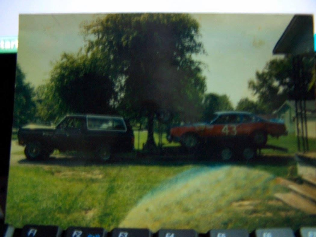

That's how we built the real ones too. The 70 Road Runner was the last drag car we ran. Full steel body 440, 727, 8 3/4 with 4.30 gears. That bad picture is a Plymouth Road Runner dirt track car. The other is a late model dirt car we ran. But that one is all tube frame, and all hand built, all race stuff period. Nothing like going sideways at a buck 20 with the LF about 8 inches off the ground. lol
