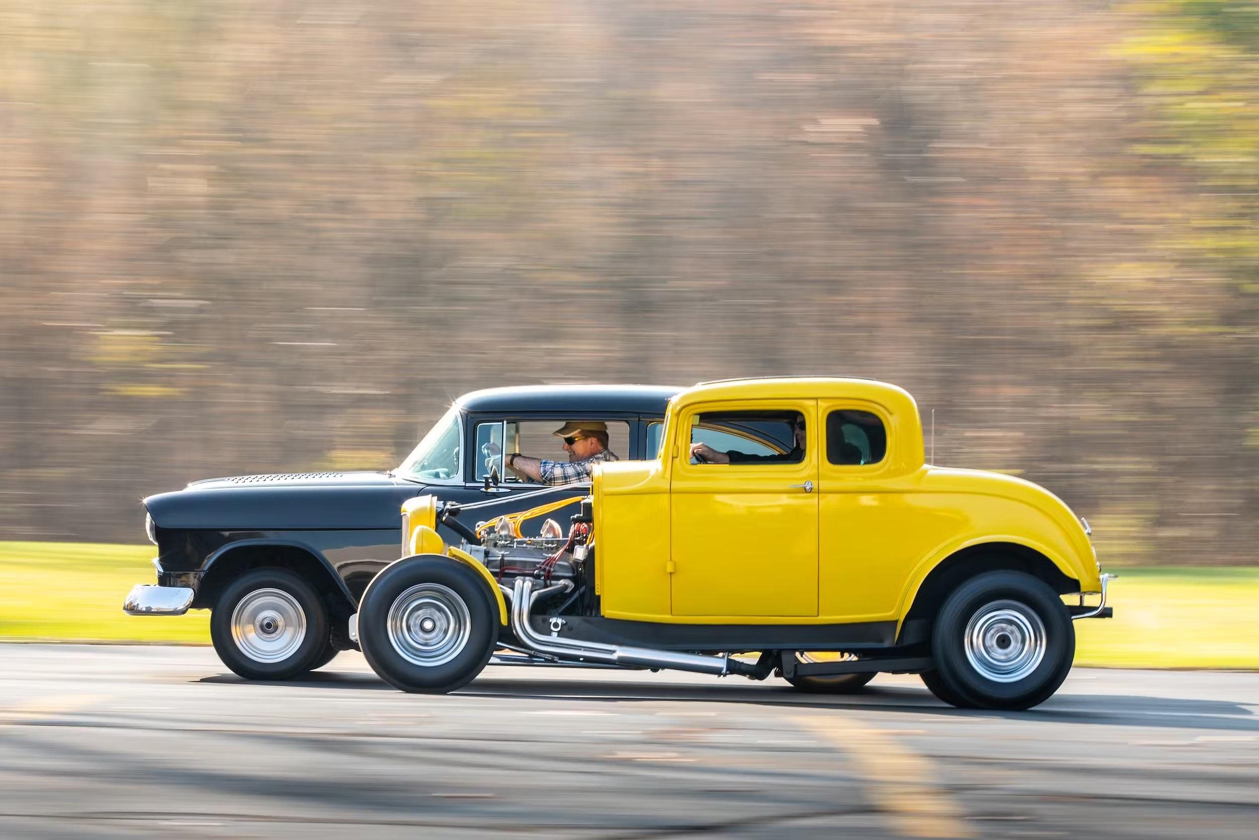

JerseeJerry55 Posted June 19 Author Posted June 19 (edited) Not sure. Haven't built a kit like this in like.......never so any suggestions would be appreciated. Kinda like the picture of Milner's Ford shown below. I like the full fenders look but am a bit timid to try it. The paint will be shiny. Edited June 19 by JerseeJerry55 Proofreading
sidcharles Posted June 19 Posted June 19 it's not the fenders; it's the running boards. fenders to the body in the rear/ cycle in the front. half-channel so enough frame shows to give the body some foundation. wheels are your choice; wouldn't want you to think i'm being manipulative.
