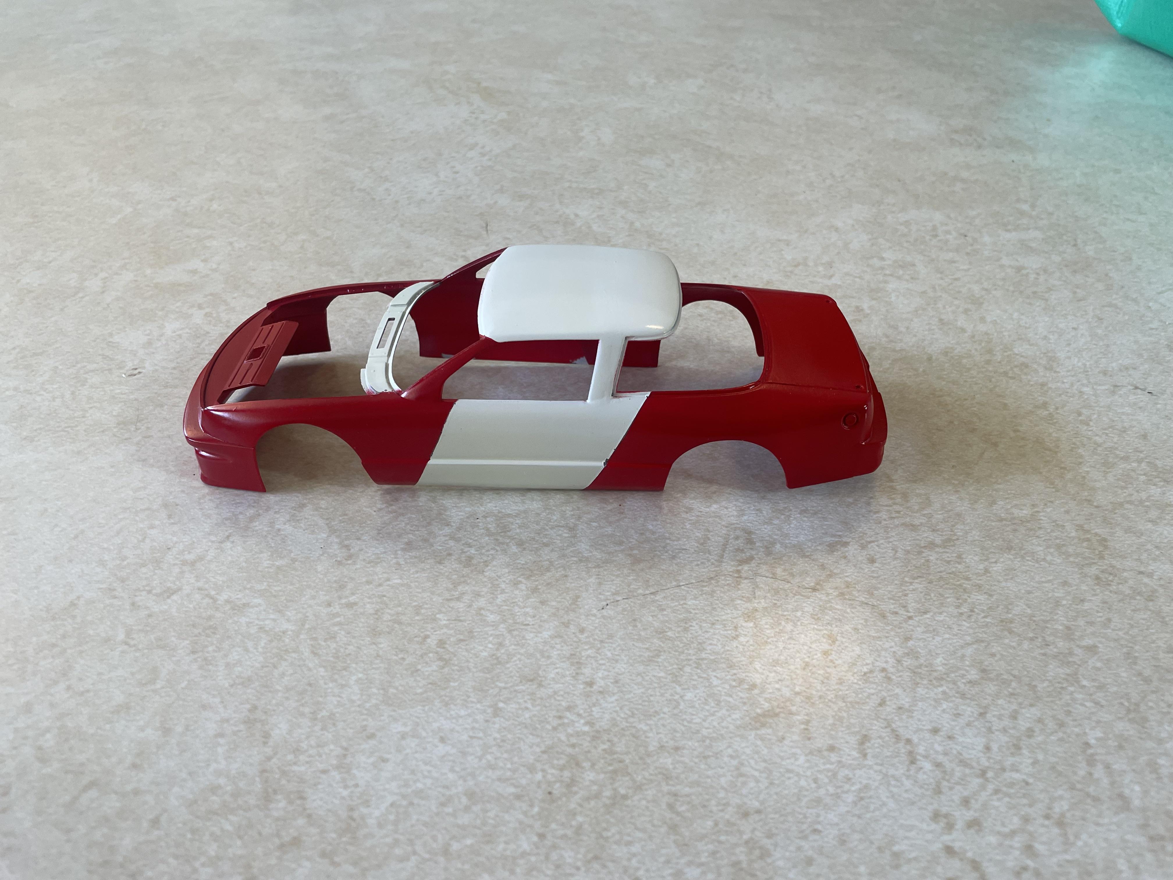

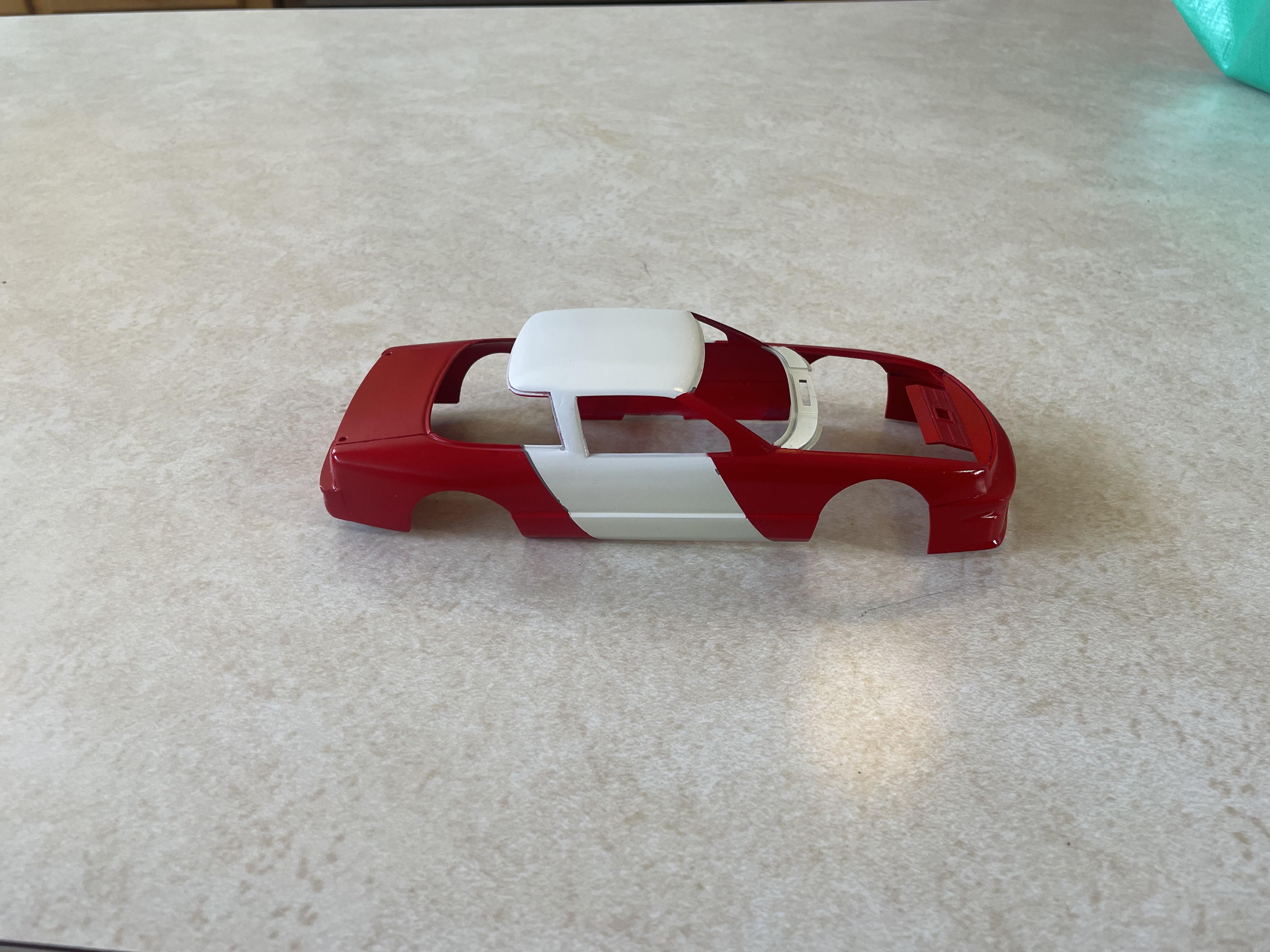

Ben269 Posted July 5 Posted July 5 Those of us that build the NASCAR kits know that this kit just isn't right. That back window on the Olds is not reflective of the real car. So what do we do? Saw this from one of the guys on Instagram, and decided to try and replicate it. 3

Ben269 Posted July 5 Author Posted July 5 I am building Buddy Baker's 1988 Red Baron Olds. I shaved the roof rails, and removed the side skirt to backdate it. 2

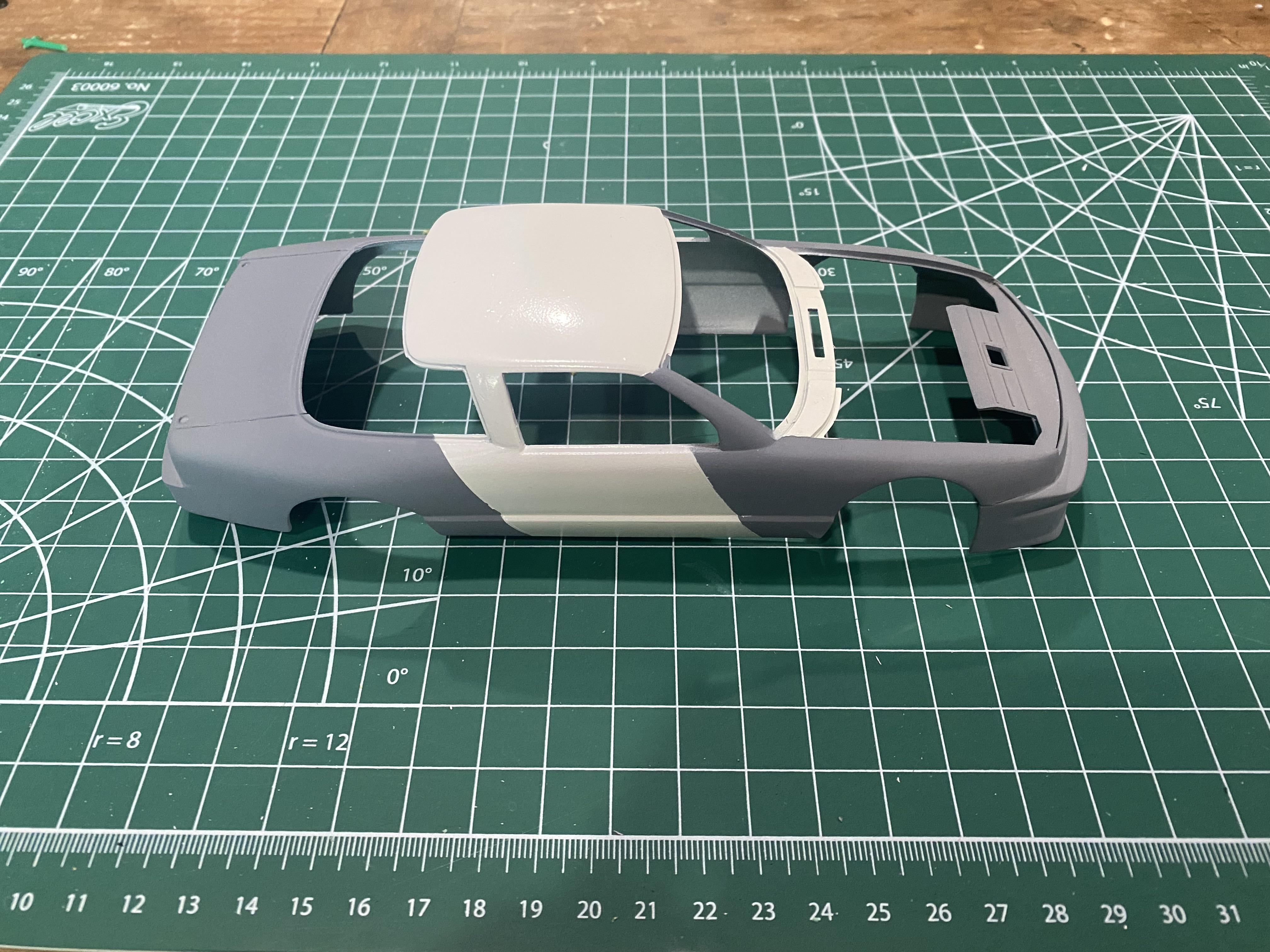

iBorg Posted July 5 Posted July 5 Curious question...how close in width is the AMT body? That would seem to be a much more common body for the swap.
Ben269 Posted July 5 Author Posted July 5 A few coats of filler and primer, and the seams were almost gone. I painted the white first, but that lead to some challenges masking. Should clean up ok with some light sanding and touch-up painting. the gold stripe decals will cover the masking lines. 3
Ben269 Posted July 5 Author Posted July 5 Mike, you are right about the AMT body, readily available, and inexpensive. I tried that one too, but unfortunately, its a bit too narrow at the top. I took a couple pictures of it. A guy could probably narrow the yellow roof and taper it down to the gray, and maybe add a sliver of plastic to widen the back part, but it was more work than the purple one. The purple one was also too narrow, due to the scale difference, but not as much. 2
Ben269 Posted July 5 Author Posted July 5 Its a shame, too, because the window on the AMT is better. The Revell window has these weird cloudy parts, not sure how I'm going to address that. Maybe sand it down and polish it? 1

Ben269 Posted July 23 Author Posted July 23 the yellow bled through on the sides, and the hood, so I think I will sand this one down a bit and respray. I used sealer primer the first time, but maybe needed a second coat or something.
