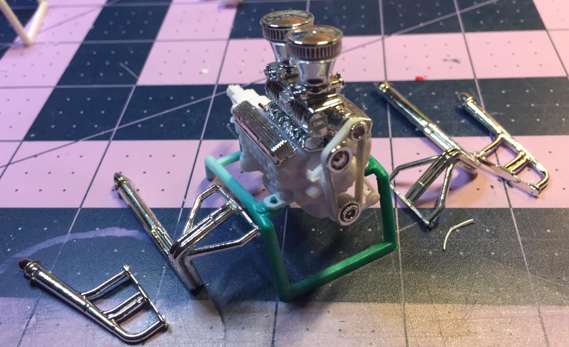

The engine in this kit isn't the greatest. There's one option on mounting the air cleaners directly on the carbs, which are poorly represented, or on velocity stacks. The entire intake assembly consisting of twelve pieces, all plated, was, for me, a tedious operation and kept me busy scraping plating from all the mating surfaces. I chose Testor's liquid cement to allow a little adjustment while fumbling with parts that have no alignment features except on the ends of the blower. I thought seriously about using the engine from a '29 roadster kit but decided to build this one anyway.

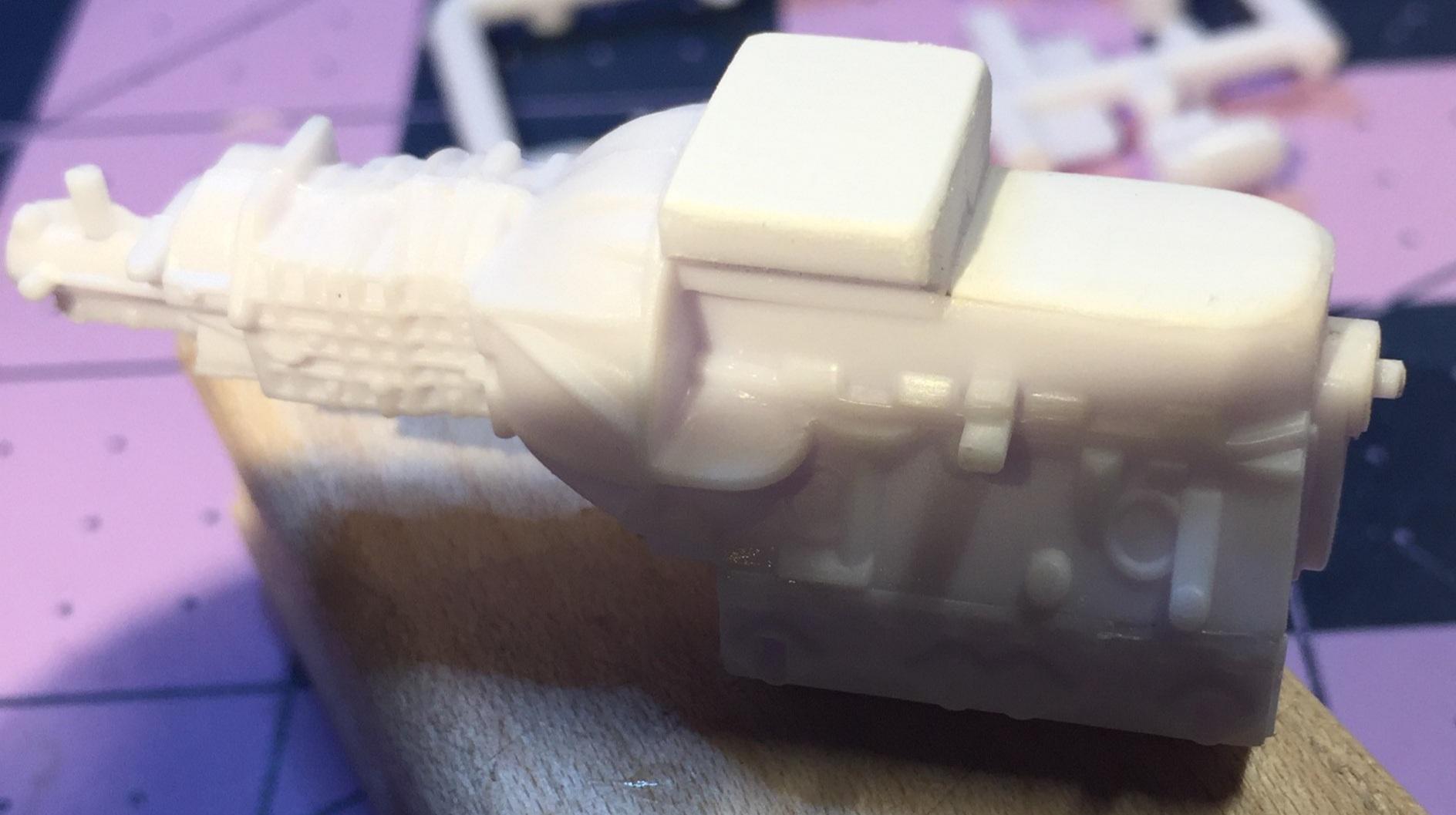

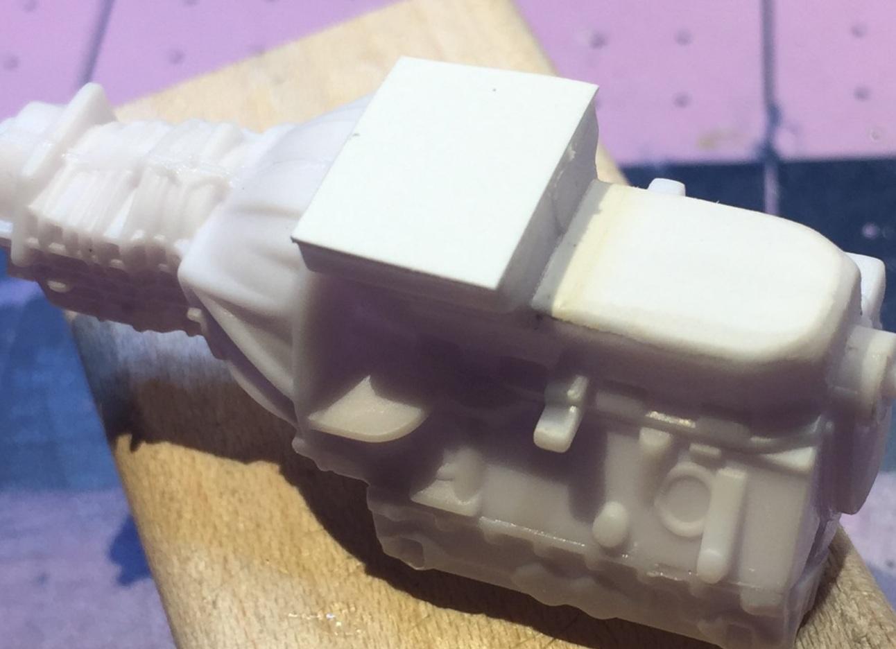

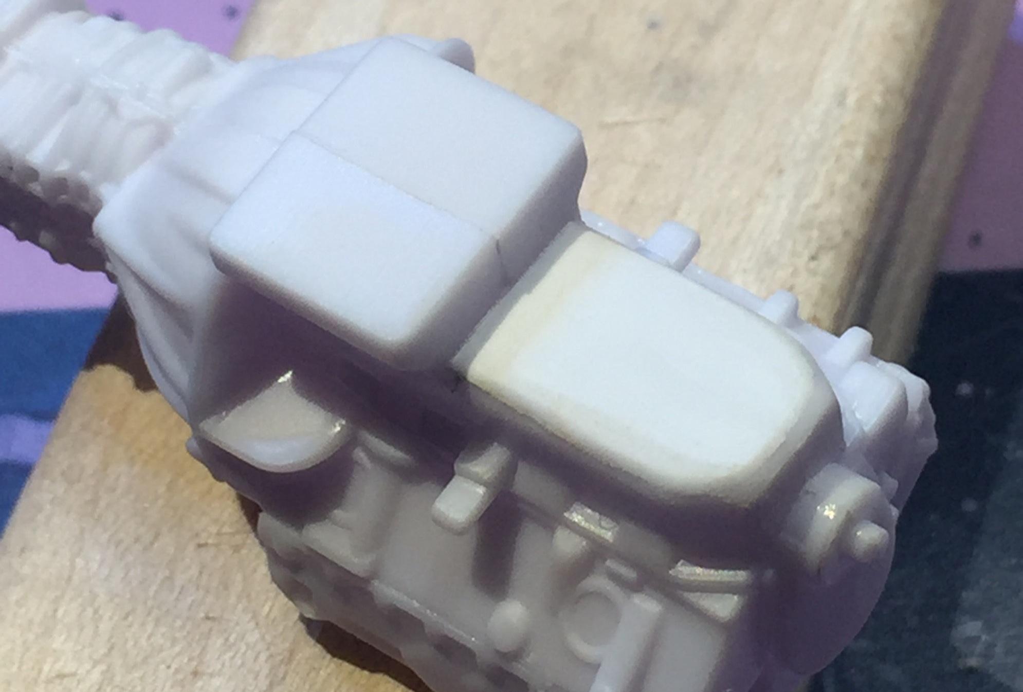

One reason for my attitude is the split oil pan, which is rendered as a high volume, racing style pan. I'm not sure how I should paint it. After sanding to try to make the seam disappear, I "skinned" over the pan bottom surfaces with scrap .010 or .015.  Bonded the scraps with thin cement, let it set up a while, then trimmed and sanded the edges.  I suppose you can just use a filler to smooth things out but my method is quick and done.
The "False bottom" is in place and sanded on the front portion. This piece of scrap, I discovered, had white paint on it 💩.
A nice clean scrap piece is shown bonded to the sump. I can't be the only one who does this.
Ta-da ! 😊.
The T-bucket headers are in the kit but not on the parts list, holdovers from a previous version. I like them, it's just the plumber in me. They must be assembled. That leaves a visible seam on the muffler that will need to be tended to. The kit also includes a set similar ( but not identical) to the ones from the '29 kit. Not sure which ones end up in service yet. 🤔
I will try to get it painted today. Thanks for looking in. 🤓

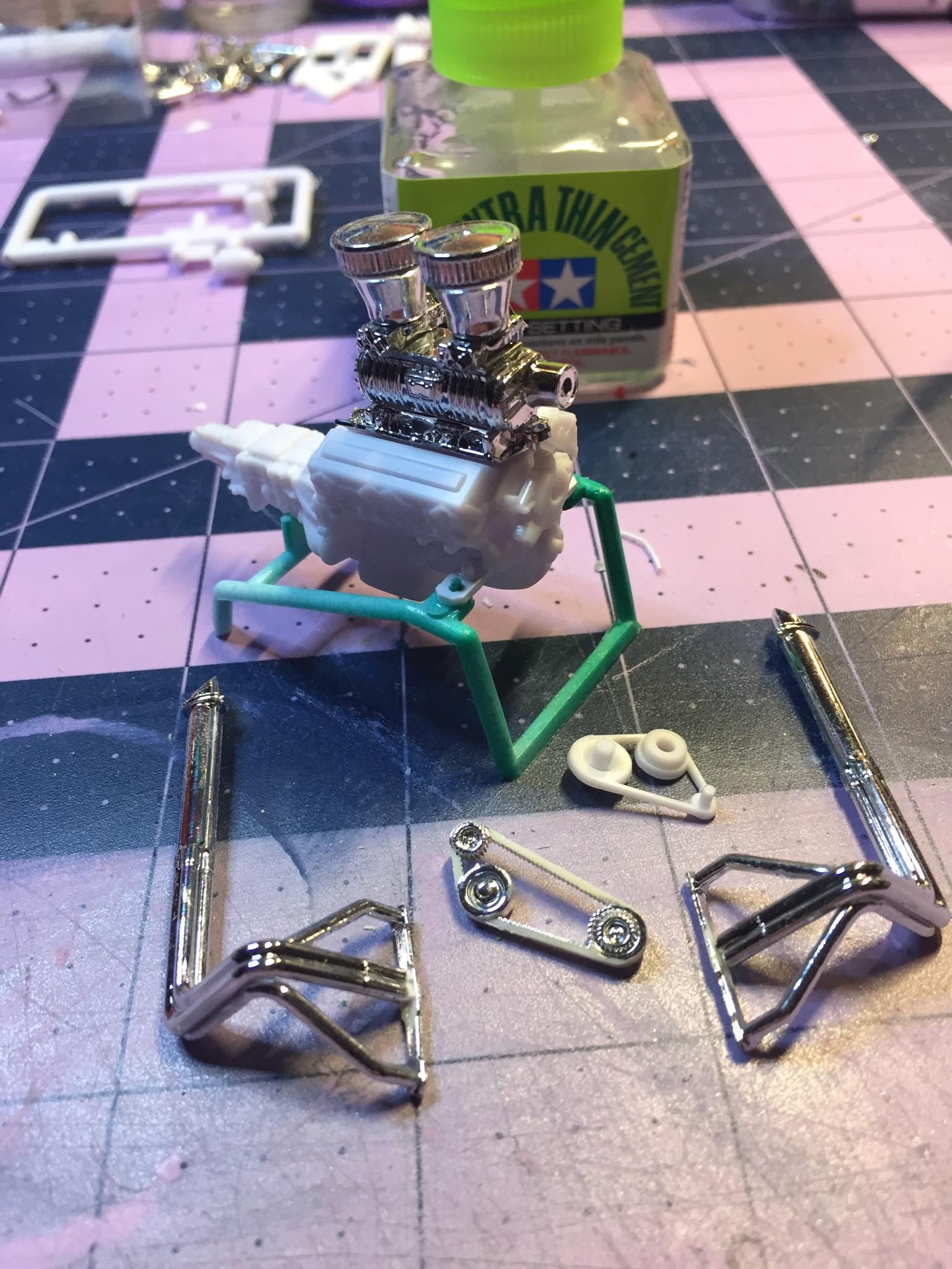

I did some things today that I've been avoiding. One of those is connecting the headers to the muffled system.  I like to handle small parts with my favorite spring-loaded tweezers and occasionally I will inadvertently launch an item into the ether. Such an event occurred today. One of the connectors disappeared as I was about to install it. Luckily, I have solder of the size needed to replace the lost part. I need to stop using those tweezers. Anyway, I bolted on the rear fenders, added the gas cap, installed the steering box (it lined up perfectly with the tie rod) and I glazed the Duval frame. The glass is much thinner than regular kit glass. The frame is pretty thin too. I usually like to scrape the plating in the glue surfaces but not this time. I used clear enamel to bond the glass to the fully plated frame. Wish me luck.

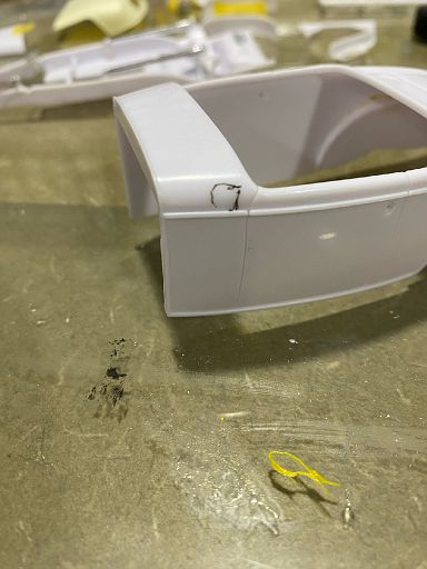

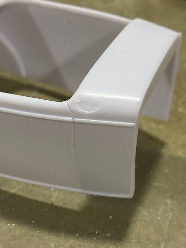

The arrow indicates how I totally missed this parting line. 💩 That's the solder job☝

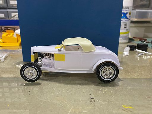

I thought it might be cool to do a one piece hood.
That was easy 😊
WDYT about 86-ing the headers and doing solid hood sides. Or custom louvered ones. It makes sense with the Duvall.  Oh, heck, that's the SO-CAL talking.
I'm gonna stick my neck out here and say I don't like all that empty space under the rear fender.  And that's a pretty big tire.  Should it be bigger? 🤔

Awesome work on pinning the windshield!  I'm thinking I shouldn't have said anything about the fender opening.  Maybe a set of scale, 33" Mickey Thompson, Sportsman Pro's for the rear?  Then again, not sure you should be listening to any suggestions from me!

Yeah but then it becomes a whole big thing trying to find wheels and adapting them and all that. I'm just not that ambitious. I listen but I hate buying aftermarket stuff because the added expense makes me unhappy ☹.

You can bring the rear down by simply shaving the top off the airbags. You'll still have that heavy rake, but it will close up the gap. You may have to do a little massaging with the coilovers, but there's no attachment point for them on the chassis so you can let them land where they land.
