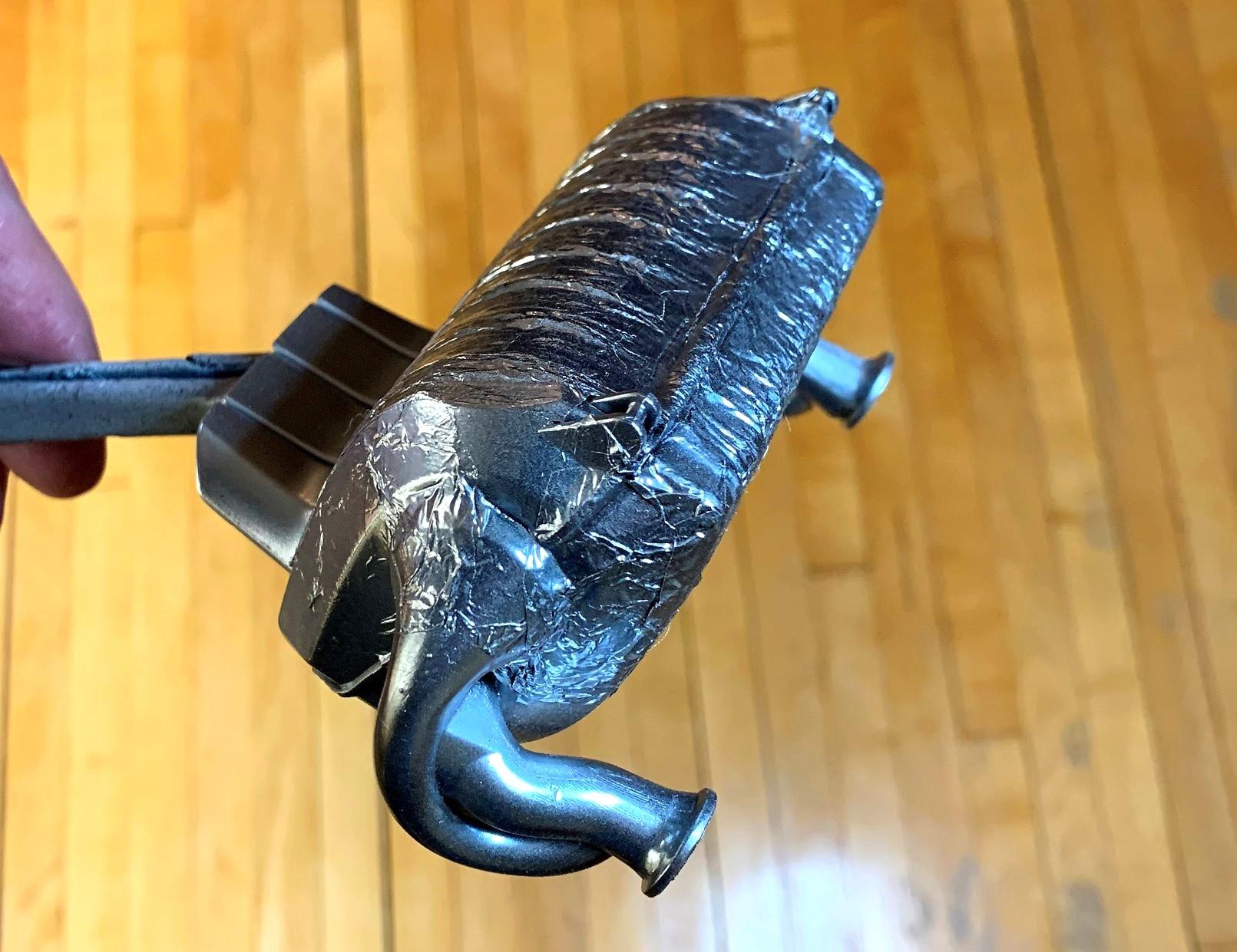

dino246gt Posted August 6 Posted August 6 Michael, after my father-in-law passed, my wife had to take ALL of his belongings and sell his home. Our house is STILL packed with his stuff, and Shelley, my wife, isn't ready to let it all go, 5 years on, and I won't push her. SO..............the Aventador project has been burried under boxes and containers of "stuff". HOWEVER: here's a few pics of what I did get done before it got burried!
mrm Posted August 7 Author Posted August 7 I'm sorry to hear about your loss. I totally understand. It is really cool what you did to the Lambo so far. I really like the effect on the muffler. How did you achieve that?
