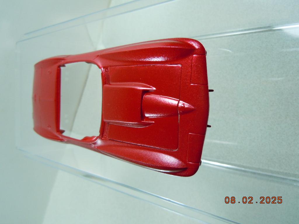

Bill Anderson Posted 23 hours ago Posted 23 hours ago (edited) Hi, I have Revell '57 Corvette w/427 kit. I finished the chassis, motor, and interior and IMO they came out nicely. So my next step was to paint the body shell. I used a Testor's rattle can and it was faulty, throwing out blobs of paint (subject of an earlier thread). So I cleaned it up (very little paint got on it) and ordered some Tamiya Mica Red. Yesterday I started to spray the shell with the Mica Red and it just wasn't covering. So I thought, what it needs is a primer. Not having any available, I foolishly decided to use some Testor's gold, which I had used successfully months ago on another model. Well, of course the gold covered with a fairly light spray, but when I hung it to dry I noticed the paint was bubbling in places! That is another first for me. Sooo, I scraped, sanded, and used thinner to clean up the shell. Then I ordered a can of Tamiya light grey primer. I "assume" the primer will cover nicely, but will the Mica Red lacquer cover over it? I've considered buying another kit for the body shell, but I'm hoping I can save the one I have. Honestly, I've had more paint problems in the last month than in all the previous decades of model building. Your comments are more than welcome! Edited 23 hours ago by Bill Anderson
