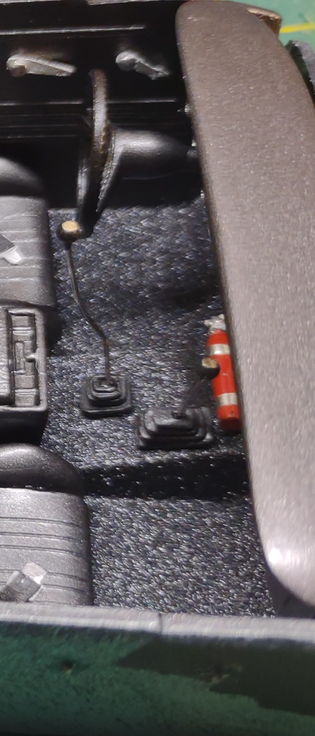

64SS350 Posted Friday at 06:37 PM Posted Friday at 06:37 PM This is what I have done for shifter boots, same principle but with discs cut out, ( I have a small die punch for this) glued together and a little extra paint to make them look like one piece. 3

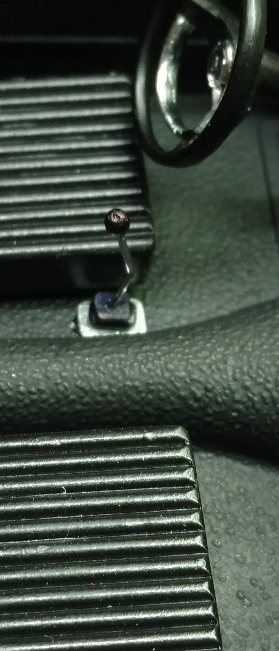

Leica007 Posted 6 hours ago Posted 6 hours ago Would this work? I used it for a shift boot, it's the end of the micro brush stick. 1
