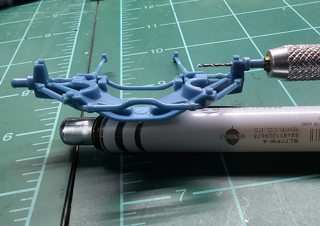

Ace-Garageguy Posted Monday at 02:07 PM Posted Monday at 02:07 PM I'm not familiar with that particular kit, but in general, any model with independent front suspension can be easily lowered in front by cutting the stub-axles off of the spindles and relocating them UPWARDS the amount you want to lower the nose. Measure. This duplicates in scale the effect of installing "dropped spindles" on a real car. Done carefully and allowed to dry very thoroughly (and possibly pinned) the reworked spindles will be strong enough, by a good margin, to still support the model. 4
NOBLNG Posted Monday at 03:04 PM Posted Monday at 03:04 PM (edited) That’s basically how I lowered the front of this Monogram ‘64 GTO. Edited Monday at 03:04 PM by NOBLNG 6
Shark Posted Monday at 11:27 PM Posted Monday at 11:27 PM Like Ace mentioned, I would go to the extra effort to pin them.

SpeedAndViolence Posted Wednesday at 02:35 AM Posted Wednesday at 02:35 AM (edited) Revell 69 Dodge Coronet Super Bee. Will be pinned with a length of sewing needle. Edited Wednesday at 02:36 AM by SpeedAndViolence 2 1

Carmak Posted Wednesday at 08:17 PM Posted Wednesday at 08:17 PM When I lower the front height of a Monogram kit I often reduce the track width a little at the same time. This is a personal tase thing. I don't care for the look of the front wheels too close to the front wheel openings that some Monogram kits have. I also use pins for strength whenever possible. 2
