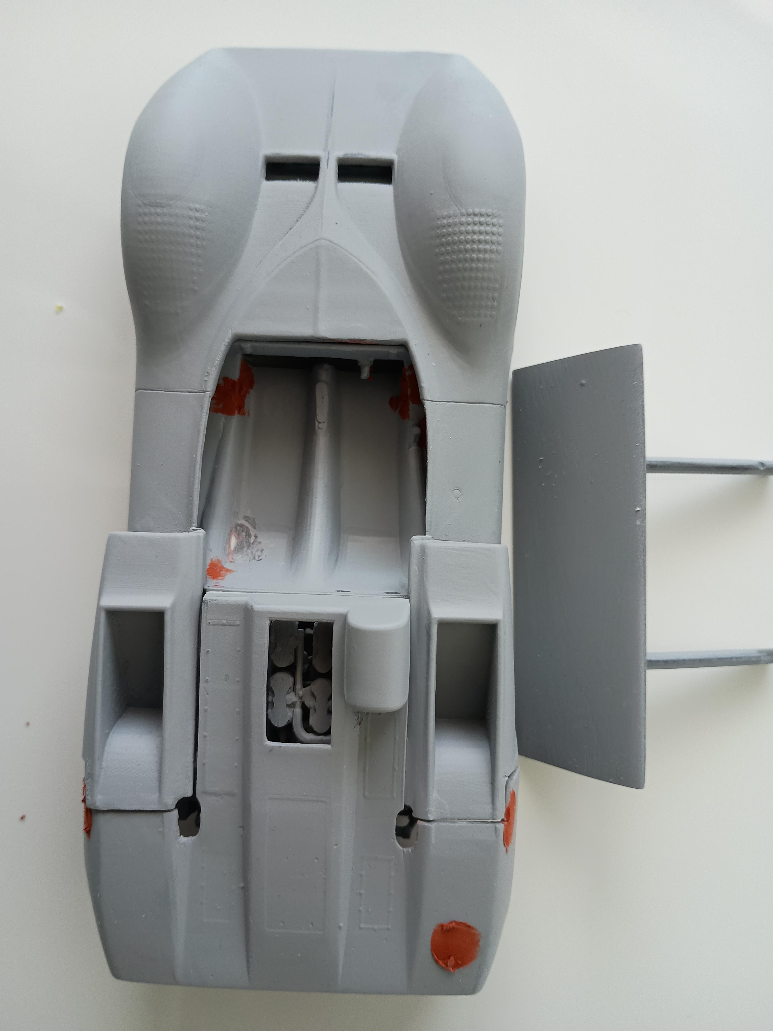

Dave B Posted August 27 Posted August 27 (edited) There was a 50% off sale a month or so back so I asked Phil to download this file for me. He surprised me a few weeks back by printing it for me. Looks good but a lot of work to do. Motor, suspension and interior look good but the wheels are a bit average. There are also 2 McLaren's available so might look at them shortly. Dave B Edited August 27 by Dave B text 2

Dave B Posted September 14 Author Posted September 14 Ok, I've finished the salt lake racer but have yet to post 'under glass' so I've started on the 2E. This is a nice file but needs lots of work as usual. Front end and engine detail is really good and it deserved the rear of the body cutting off to reveal it. I've put in about 30 hours so far and a lot more to do to get the nose sitting properly and the interior to fit. Loving it!! Dave B 2

Dave B Posted October 30 Author Posted October 30 I'm in a bit of a quandary at the moment. Because it's a resin print the fine details (mesh and air outlets in front guards) are almost nonexistent and after a couple of coats of undercoat they'll be gone. As it's resin it's a bit thin and fragile to cut the vents out. Have to think about this one for a while. Dave B
absmiami Posted October 30 Posted October 30 Dave - the resin looks thin - but maybe not too thin - do you have any diamond coated grinding tools bits ? Did you keep any ot the scrap resin that served as the base for the printed parts - you could practice on the scrap - I think the screened portions of the fender can be removed and replaced -

Dave B Posted October 31 Author Posted October 31 Hi Andrew, yes the resin is very thin and I have a good range of diamond coated bits, I'll have to think about it. Yes it's 1/24 and I only downloaded it because I missed out on Paul's. Bought the book a few years back at the right price. Just one of three Chaparral books, not bad for a Ford guy 😂 Dave B
Dave B Posted 8 hours ago Author Posted 8 hours ago So, after mulling over Andrew's thoughts I've decided to go for broke with the vents. Opened up all the rear vents, after reinforcing behind with spring steel wire and have decided to drill out the front guards. The worst that can happen is I stuff it and I'll need to get Phil to print me a new nose section. Hope that doesn't happen because I've just found out he's printing the McLaren M6GT for me!!! Once again Christmas has come early. Dave B
